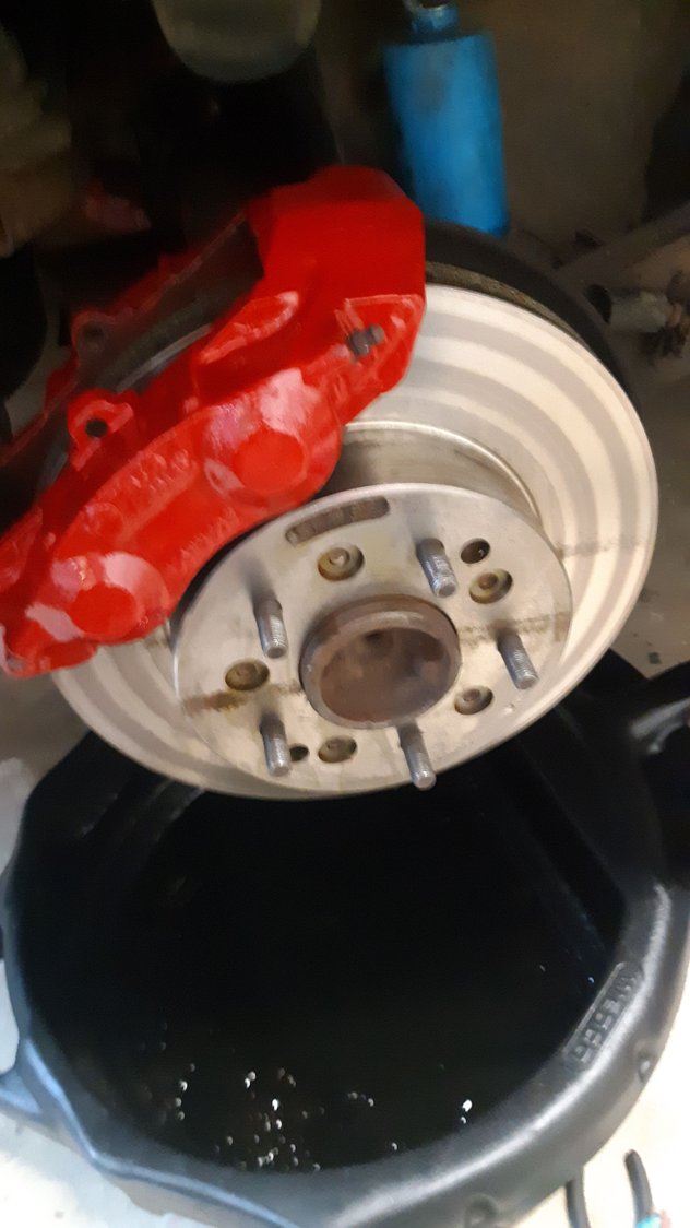

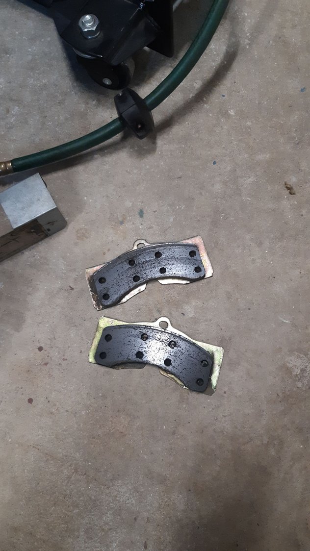

Right rear caliper. This past weekend i found the pads had worn to the rivets and a huge groove in the rotor. (I guess headers and flowmasters can mask a lot of noises!). I put a brand new rotor on and some all but brand new pads. This is from no more than 15 miles of driving, probably more like 10. Oh, also, the left rear pads and rotor had plenty of life left. My buddy says my RR caliper is seizing up. What do ya'll think? Could these darker spots just be the pads and rotor breaking in? Fwiw, i found this because i took the wheel off to put brand new pads on both rear wheels.
All but brand new pads. The one with the discolored arc is the outside pad.
Brand new rotor, less than 15 miles of driving

Rubber brake line collapsed?

After driving was wheel / rotor HOT , if so something is hanging up . Could be caliper but also it could be a collapsed internally rubber brake hose . The hose could be allowing brake fluid to the caliper , due to system pressure but not allowing fluid back through the hose when off the brakes . How old are the hoses ?

Remove right rear tire. Have a wrench ready that fits the bleeder screw. Push hard on the brake pedal then quickly open either bleeder.
If fluid squirts out instead of a dibble, its likely the hose has turned into a one-way check valve.

I would check the hoses and lines for kinks, you could have a frozen piston on the caliper but that should be obvious.
