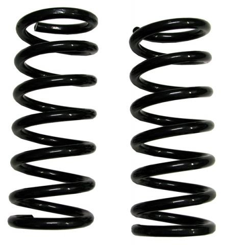

(Here is an example of “flat end” coils referred to above)

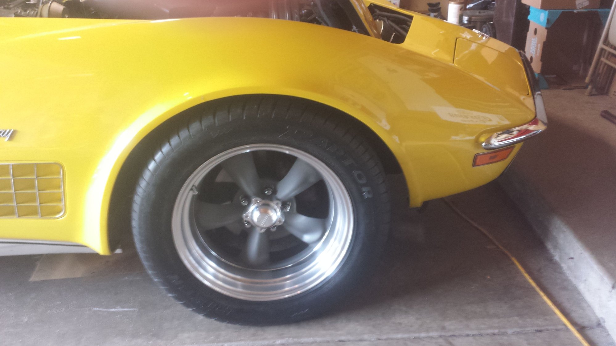

Old Mar 10, 2023 | 01:34 PM
3X2's Avatar
3X2
Joined: Jan 2000
Posts: 3,326
Likes: 523
From: home
here ya go:

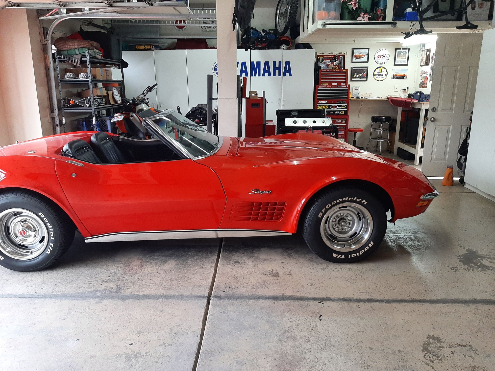

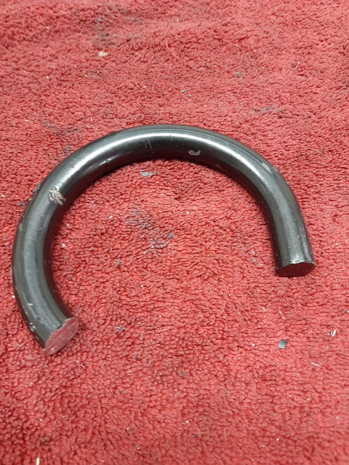

OP here with update.
Cut the coils which are assumed to be Moog 5758s. Wanted a 1” drop to 27” fender height, so measured .5” down on the spring which equated to about ¾ of a coil.
But saw how the original flat bottom didn’t align with the graduated cup or groove in the lower A-arm, and sat on the high section of the groove. Noticed that with the cut, the end of the spring would sit in the groove adding another ~.25” of spring drop. So, backed off on the cut to a little more than half a coil, and the cut spring ends fit perfectly in the top and bottom grooves ends, where the drain holes are.
The measurements (with pics below):
  • With the VBP 550lb springs (12” tall, wire of .692”) – fenders were 26.75” on 26.5” tires
  • With uncut Moogs (12.9” tall, wire of .651”) – fenders were 27.88” or right under 28”
  • With cut Moogs – fenders are now 26.625”
So, missed the target of 27” sitting .375” lower than that. Not a lot, but means floor jack can’t easily get under front spoiler, and have to set wood on the garage floor to get up the driveway into the garage without scraping exhaust. Also, lukewarm on front rake look.
The thinnest rubber spacers online are .375” so would add .750 of an inch at the fender to total 27.375" – too much . They do say “trim to fine tune height” but not sure how it's possible to get them to .25” thick to get .5" at fender.
Bottom line: The "half distance on the spring equals the fender" rule is only good if the pre-cut and post-cut coil ends are in the same vicinity in the lower a-arm groove. Otherwise, the cut coil end deeper in the groove will affect fender height which happened in my case.
This pic is of the ORIGINAL VBP 550s coils
Standard VPB 550lb coils.
This is the uncut Moogs.
Uncut Moog coils
Here is the cut Moogs.
The cut...
