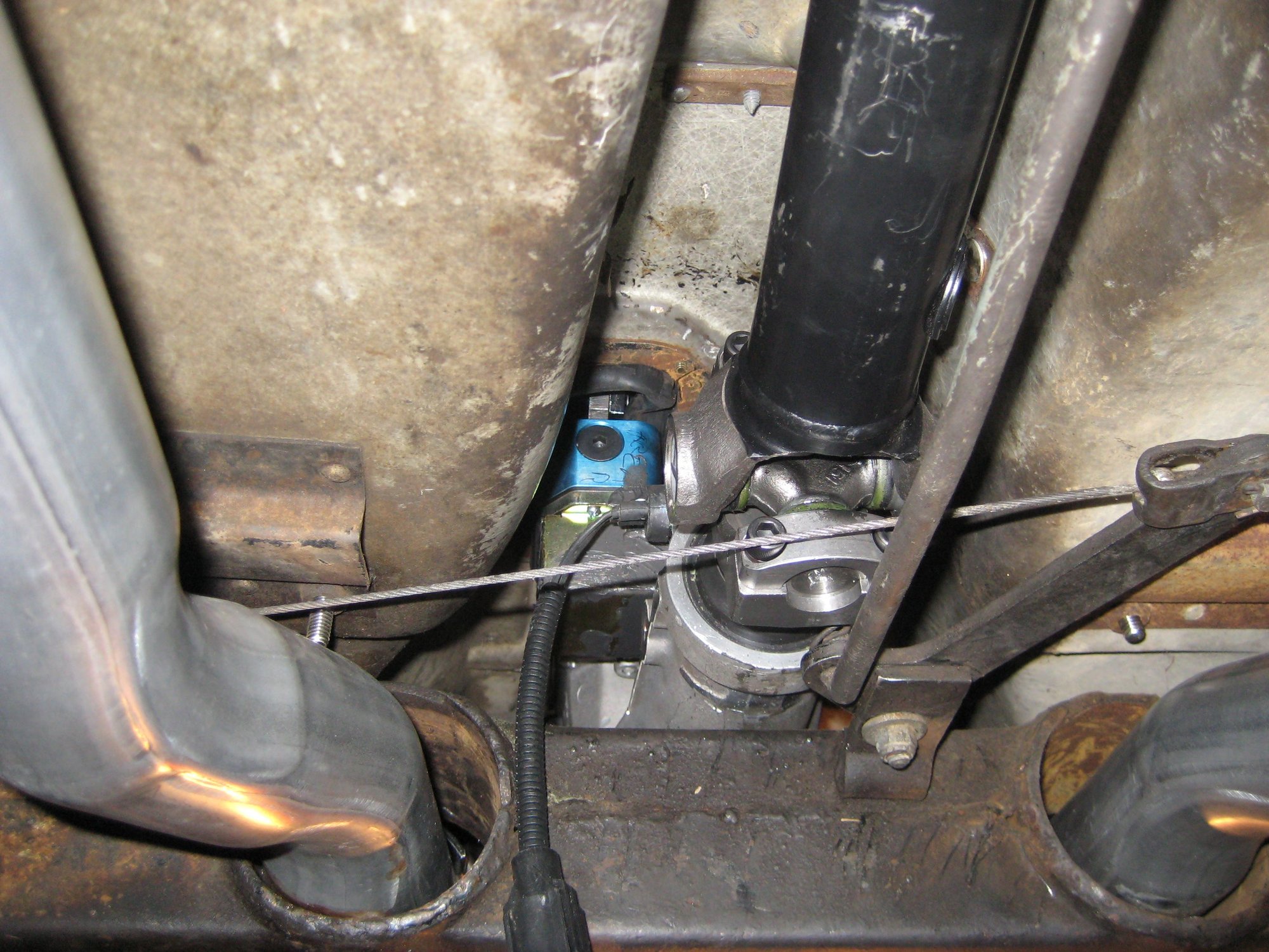

My 72 came with a tremec 5spd installed, I'm trying to replace the front parking brake cable (was removed at some point) and noticed that the cable will come into contact with the slip yoke, does anyone have a solution? I hear the tremec is a common trans to upgrade to. The tremec website states that you may have to bend the pulley bracket to clear. Any help is appreciated.

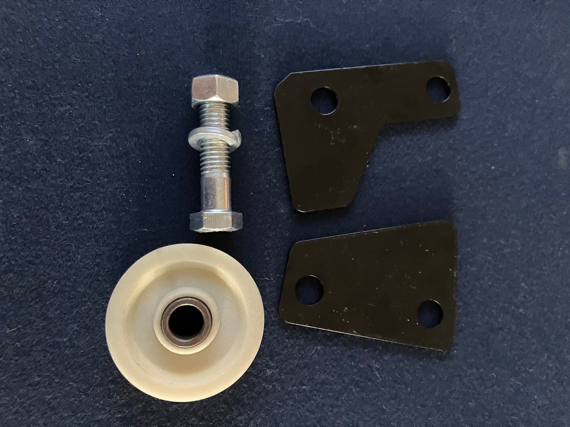

I am also putting a Tremec in my 72 in the kit is a bolt on adapter to alter the emergency brake.

The rear parking brake cable! Anyway my 79 has a loop tab on the tranny tunnel that hold the cable away to the side. The other option like I have done on other TKO 600 installs is to elongate the tranny cross member mounting holes off to the side and move the rear tail shaft away from the cable.

I just did a TKX swap ony 74 and had no issue with clearing the brake cable. The cable should have a metal clip near the top of the tunnel to keep it out of the way

Here is the bracket that came with my transmission. I will have it installed on my car this weekend and show how it is installed.

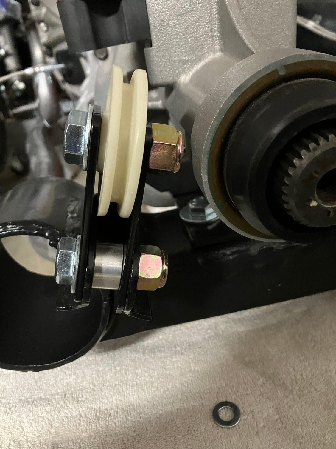

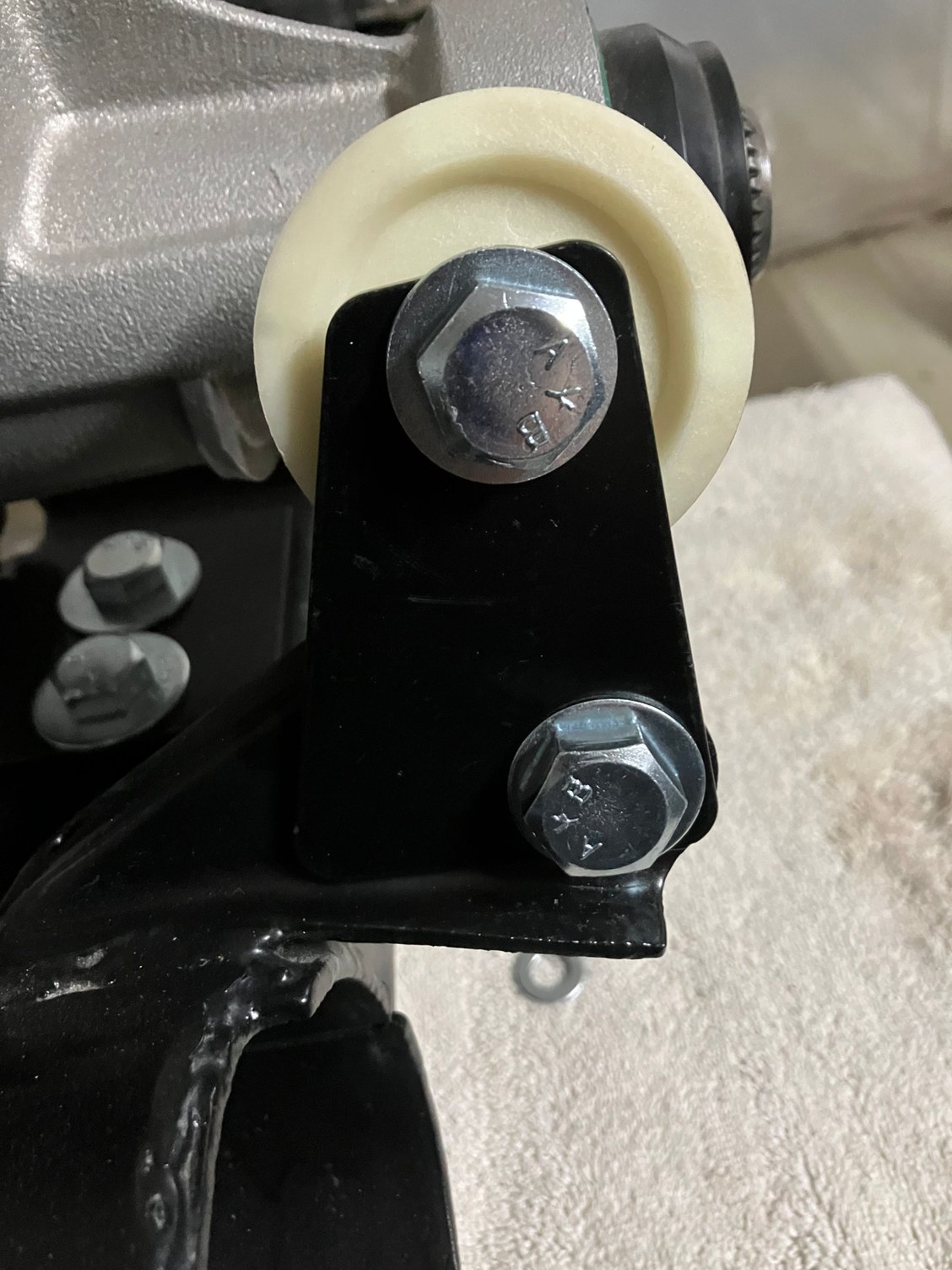

Here are the pictures of the adapter installed. I scanned the flat metal pieces so you could make the adapter from the template. I can also send you the directions. Hope this helps.
