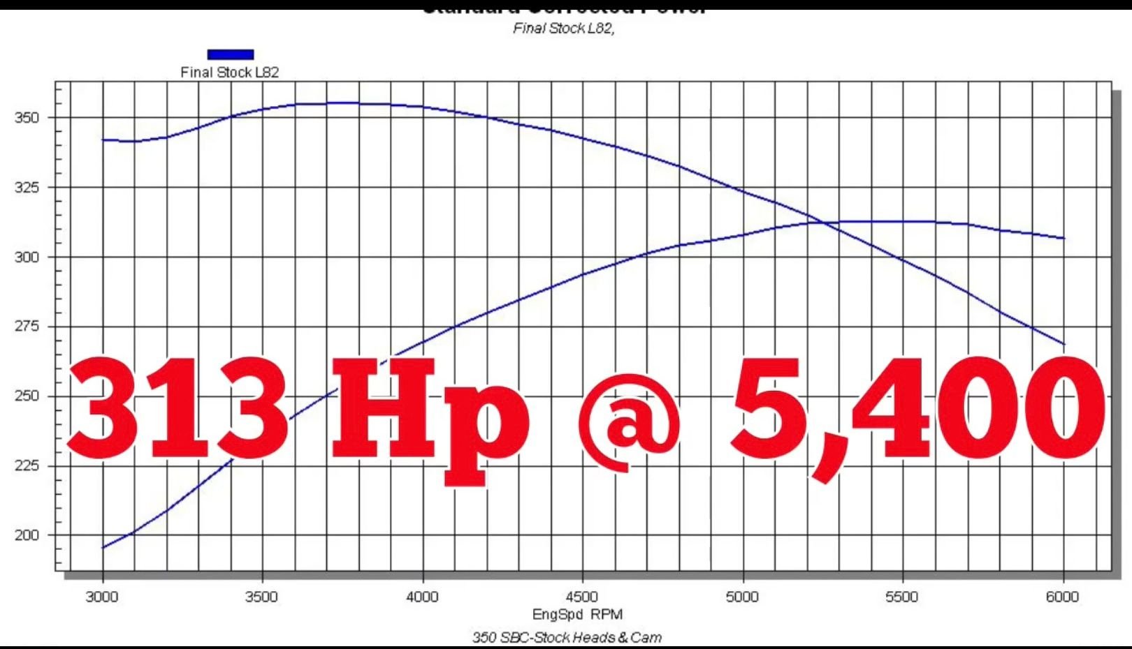

The L-82 setup will make over 300hp with just headers, duals, and a proper timing curve.....
But you are stuck with the stock exhaust....so freshen it and leave it alone....
It will never make any kind of real power through the pitiful stock exhaust system.

if i had an automatic i may want more power but 3.7 gears and m21 lars timed tuned stock L82 with duals no cat..is very impressive to me keeping 3-5500 rpm when needed. Can always mothball the original or just do the tune and leave stock.
l82 stock below as described above..
