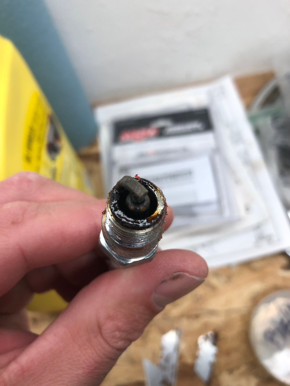

I rebuilt the stock 350 for my 71 last spring. Block was bored 0.030" by reputable machine shop. Heads were gone through with valve job and new comp seals that came with the cam kit. I used Hasting plasma moly rings and all were withing spec. Assembled using light film of motor oil. I have a flat tappet that required the 25 minute 2-3k rpm break in. First round on breaking cam in it appeared engine was overheating, slightingly, shut it down at 220. I have a 180 thermostat in it. Ended up running garden hose on radiator to get the cam broke in and keep temp below 210. Everything went well, no valve train noise, no obvious debris in oil when I changed it. So I began chasing this overheating issue. Changed thermostat, ensured no air in block, did cooling system pressure test. I eventually had Lars rebuild the orgininal carb, as I had bought one of the over the shelf rebuilt Quads and it was running lean. Each time I did something I would let the car get to op temp to see if that cured it. Last time was when I put the new carb done by Lars on and it seemed to still get warm, checked total timing, right on at 36 degrees. Ended up being that the stock sending unit was not compatible with the autometer gauge that previous owner install, so overheating was never happening. But all of the sudden now the car is smoking. I took it out for little maybe 5 mile drive and accelerated ect to load rings. I did a dry compression test and got the following results. 1=144, 2=152, 3=155, 4=155, 5=155, 6=155, 7=157, 8=155. I am hoping that the cylinders did not glaze when I was trying to figure out the overheating issue. All eight plugs look the same as the picture below. I read online from many that with plasma moly rings they seat before cam break in is finished. It did not smoke at all during cam break in. It didn't smoke after new carb, the smoking began after reving it up to check total timing ~3,200 rpm. I plan on removing PCV first and running it, the aftermarket valve covers have baffles but they are not as deep as stock, but it did not smoke at first, so makes me thing this isn't the issue. I am thinking of doing a leakdown test next, or am I worrying too early and need to get it out on the road and put more miles on it?

intake

Hmm. "Intake"...
Just spitballing here: Have you retorqued the heads and intake?
Is that plug representative of all the other plugs?

Yes, I agree it could be the intake. Get one of those borescopes you can plug into your phone and send it down the intake passage of each cylinder looking for evidence of oil intrusion. It will be shiny where the oil is the others will be dry and dull looking.

I have not retorqued anything. This plug is representative of all. There may be very slight differences, but none that stand out either way.
