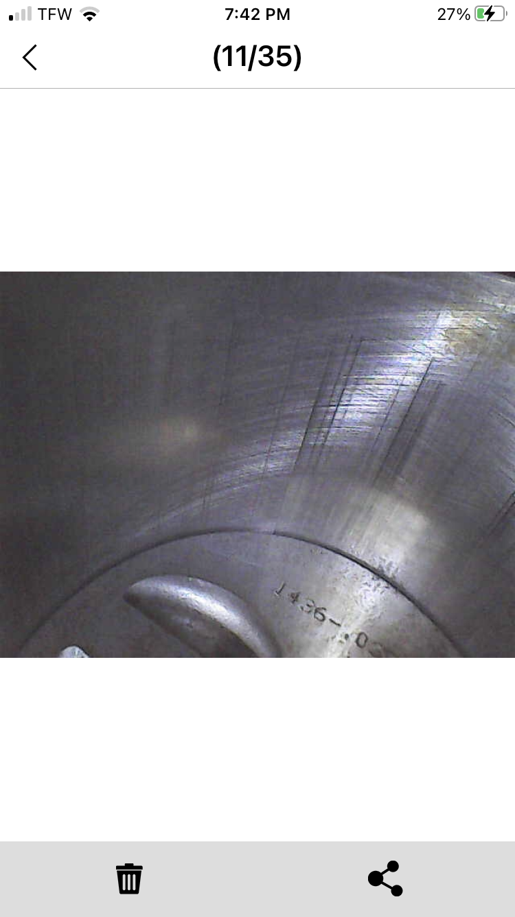

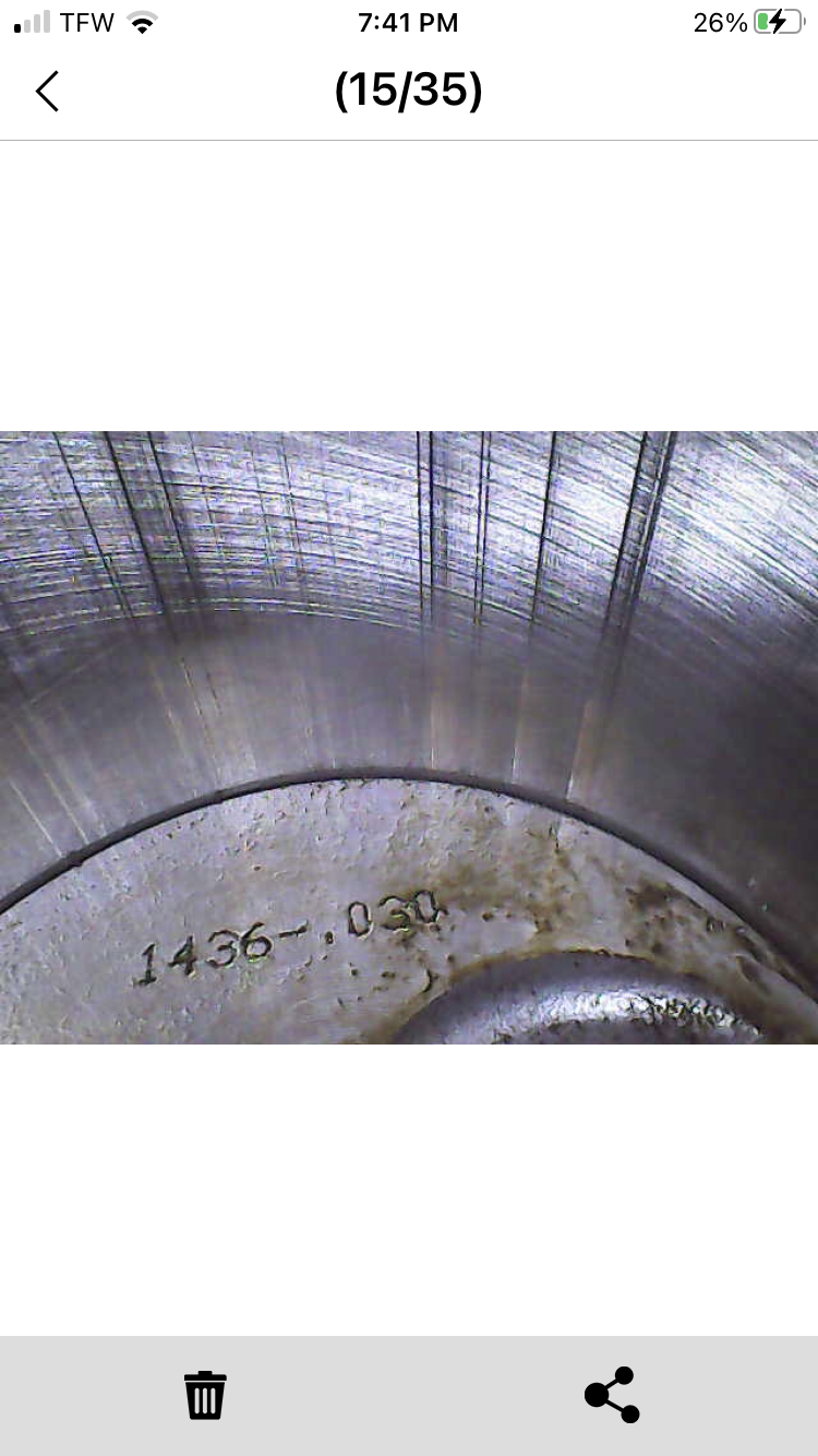

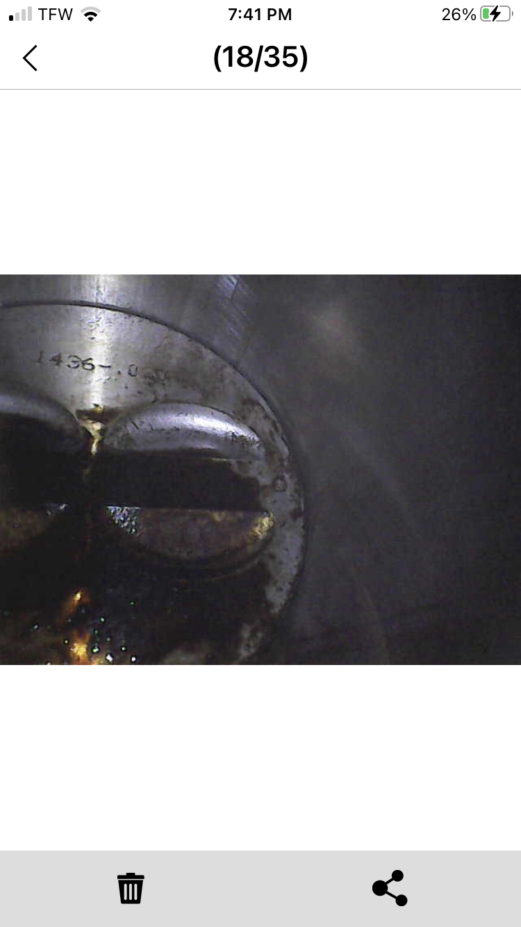

OK, so I was able to mess with the car tonight. The intake bolts took about 1/8 of a turn before the wrench clicked. I was able to snap some pictures of a couple intake runners. Deffinately looks like there is some oil in there. I decided to look into the cylinders as well. Is this typical for the oil to be in one place? Also, not a fan of some of these vertical lines. Could that be the root cause of my issue, scored cylinder! How could I verify this? You can see the cross hatch very well, so maybe these lines are nothing really? Do the cylinders look glazed?

That's some nasty scoring on the cylinder walls, I would not be surprised if you have some broken rings.
Old Mar 23, 2023 | 06:31 PM
1860army's Avatar
1860army
Joined: Feb 2020
Posts: 904
Likes: 569
From: Central NJ
The scoring is Any or all of the following...
Rings not deburred after gapping...There is an Awful lot of scoring for just this....
Cylinder Bores not chamfered and polished at the bottom....Causing scuffing
Dirty environment during rebuild...
There is also over heating and poor lubrication...
I think I'd pull the oil filter and see how much metal is in it...
Did you add oil to the cylinders as part of the compression test? There was a lot on top of that one piston...

I’ve read that moly rings tend to do that especially if heated when broken in. I’ve always just used Hastings cast rings in my builds. That scoring looks serious, if it continues I’d use some bon ami.
