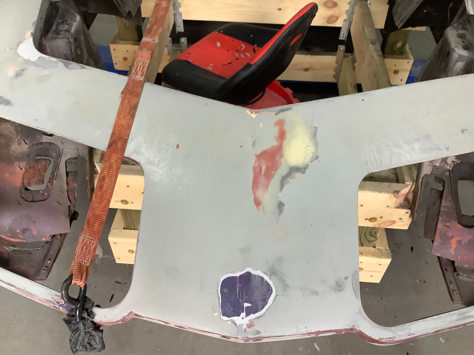

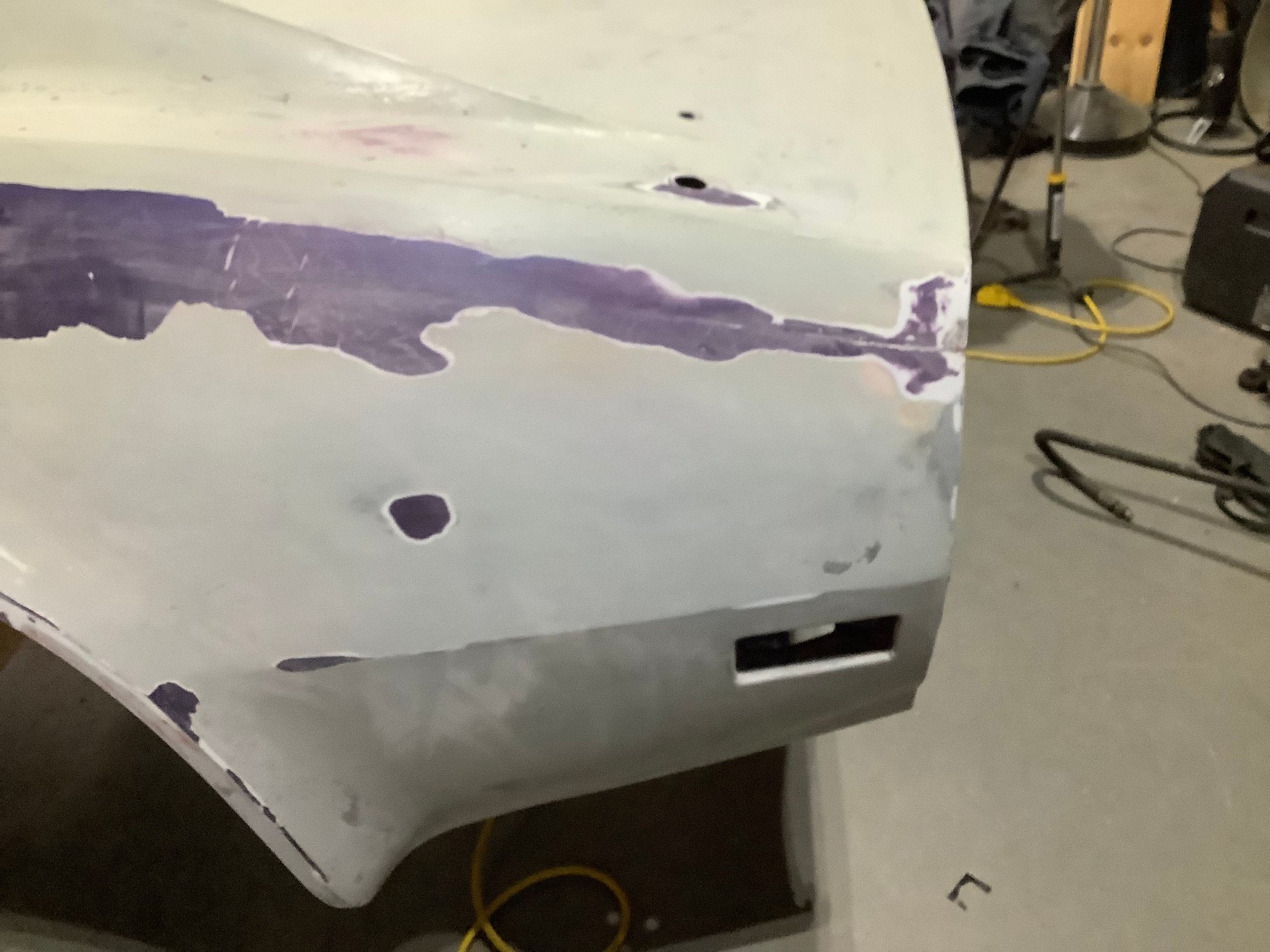

Old Mar 21, 2023 | 03:12 PM
scondon's Avatar
scondon
Joined: Sep 2012
Posts: 178
Likes: 26
From: Blue ridge Georgia
I can’t find anyone around me that does glass work on a c3. As you can see in pictures the rear panel is split at the bonding seam. Only the paint was holding it closed.
Old Mar 21, 2023 | 11:56 PM
69L88's Avatar
69L88
Posts: 3,394
Likes: 1,812
From: Apple Valley, MN
Fiberglass repair is a lot easier than working with bent/rusted metal. If you do decide to do it yourself, be sure to invest in a commercial grade particulate respirator.
Seam repairs like your situation is straightforward. Grind out a tapered “v” about 1 1/2 inches either side to the crack, down to the bonding strip. Layup with fiberglass and resin that is suitable for use with SMC (Sheet Molding Compound) panels. Do NOT use polyester resin as that is for earlier cars. Sand the new glass to contour.

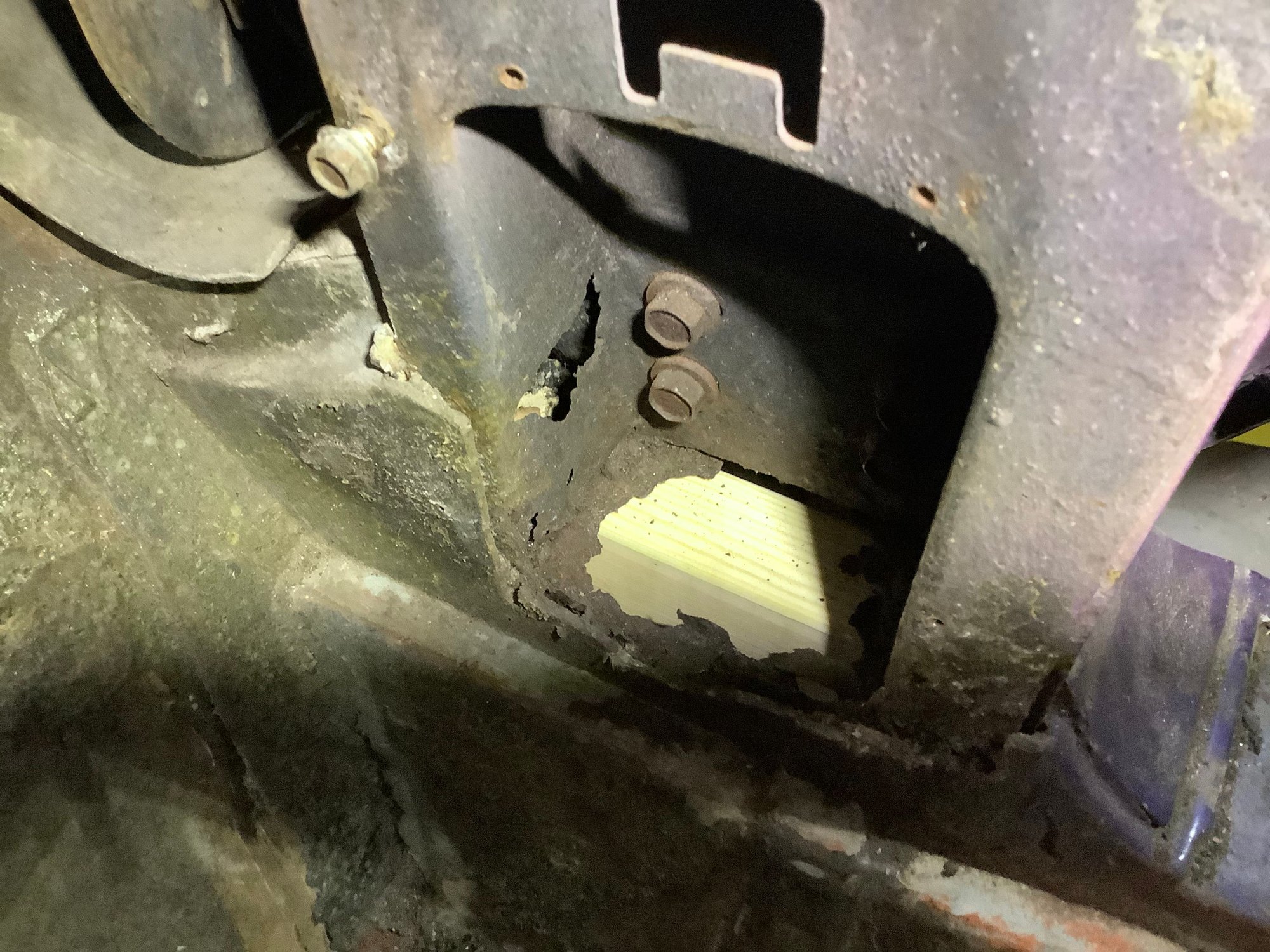

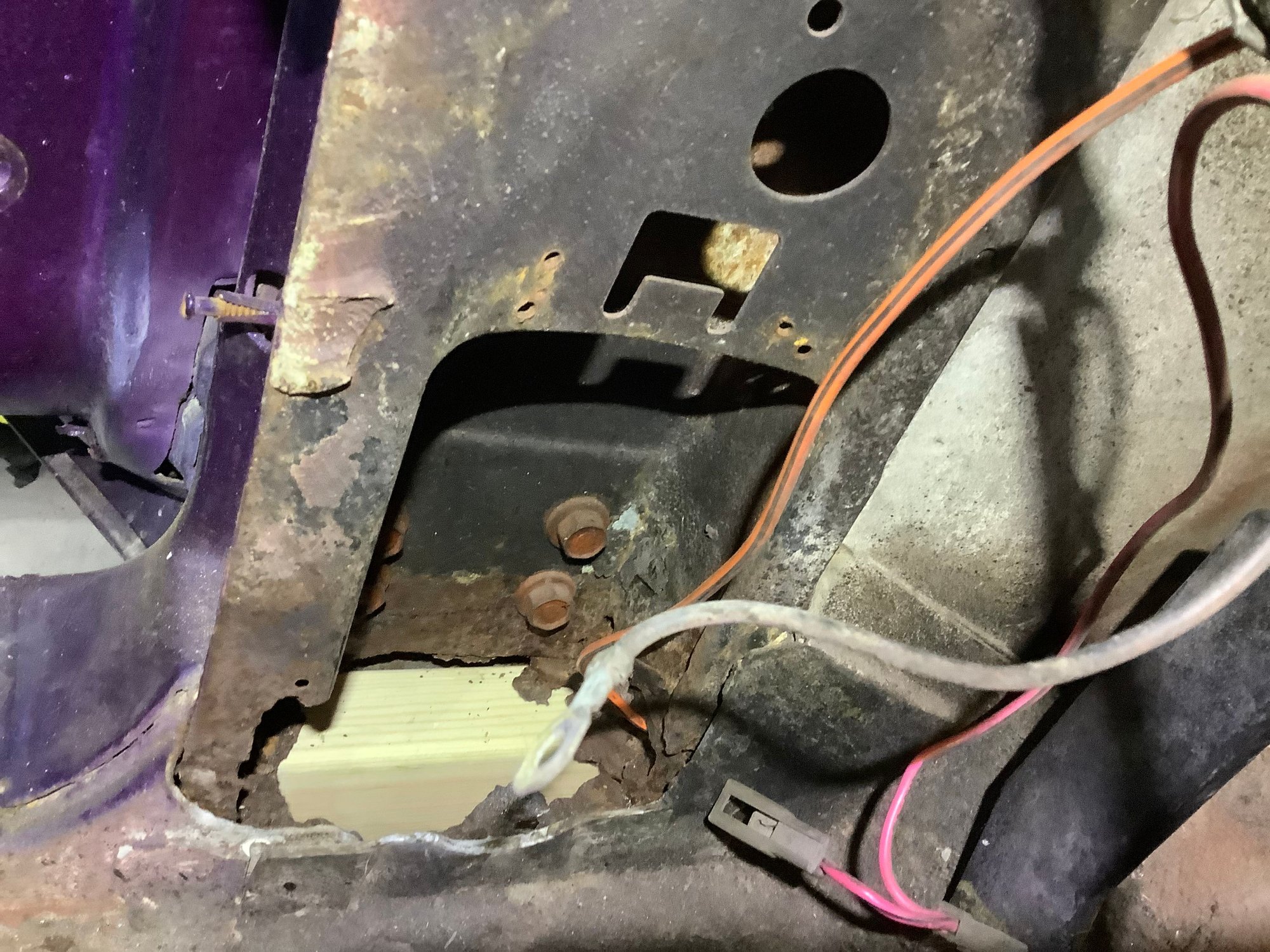

Old Mar 22, 2023 | 08:41 AM
scondon's Avatar
scondon
Joined: Sep 2012
Posts: 178
Likes: 26
Default 75 frame off restoration
#2 body mount
