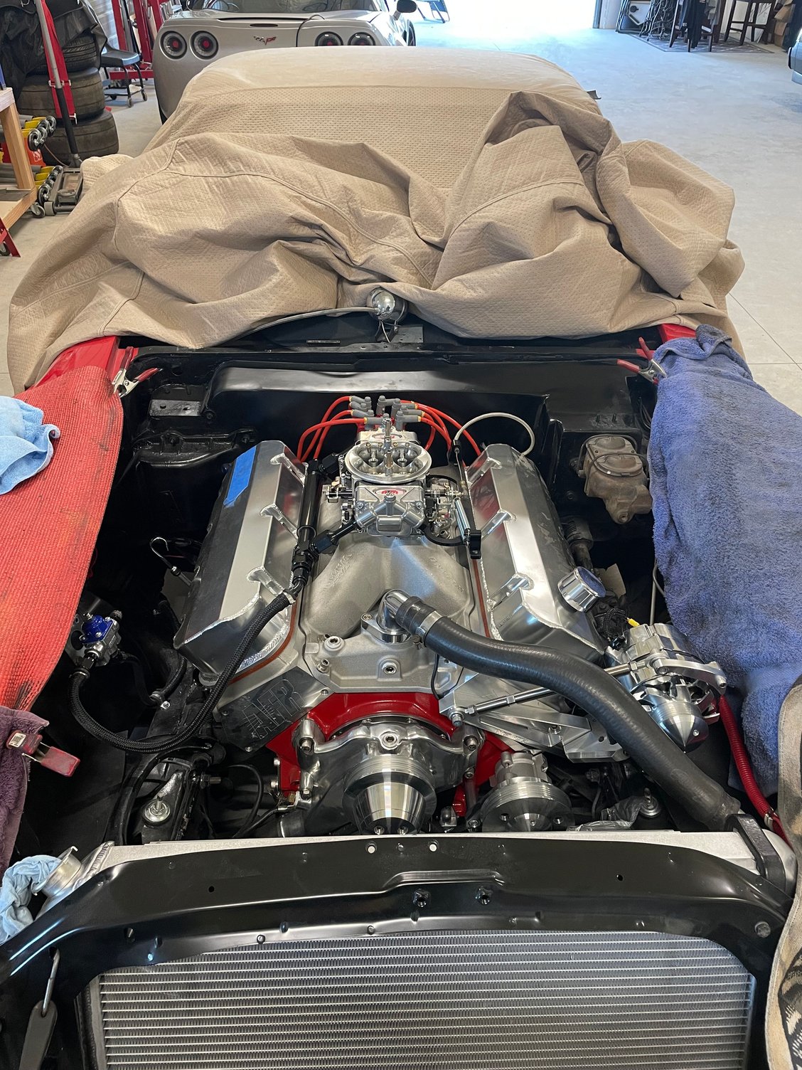

Originally Posted by Amelio
The March system is a nice kit, they do make it for AC and they also offer a black finish. I believe CVF also makes a kit as I looked at several, been very happy with this setup. They do offer an additional idler if you need more belt wrap. They give you the part number and placement in the kit.
@Amelio Many, many thanks for this! That's a spectacular looking setup you have... thank you for taking the time and effort to post the info and pics! My wallet is soon to be much lighter.
