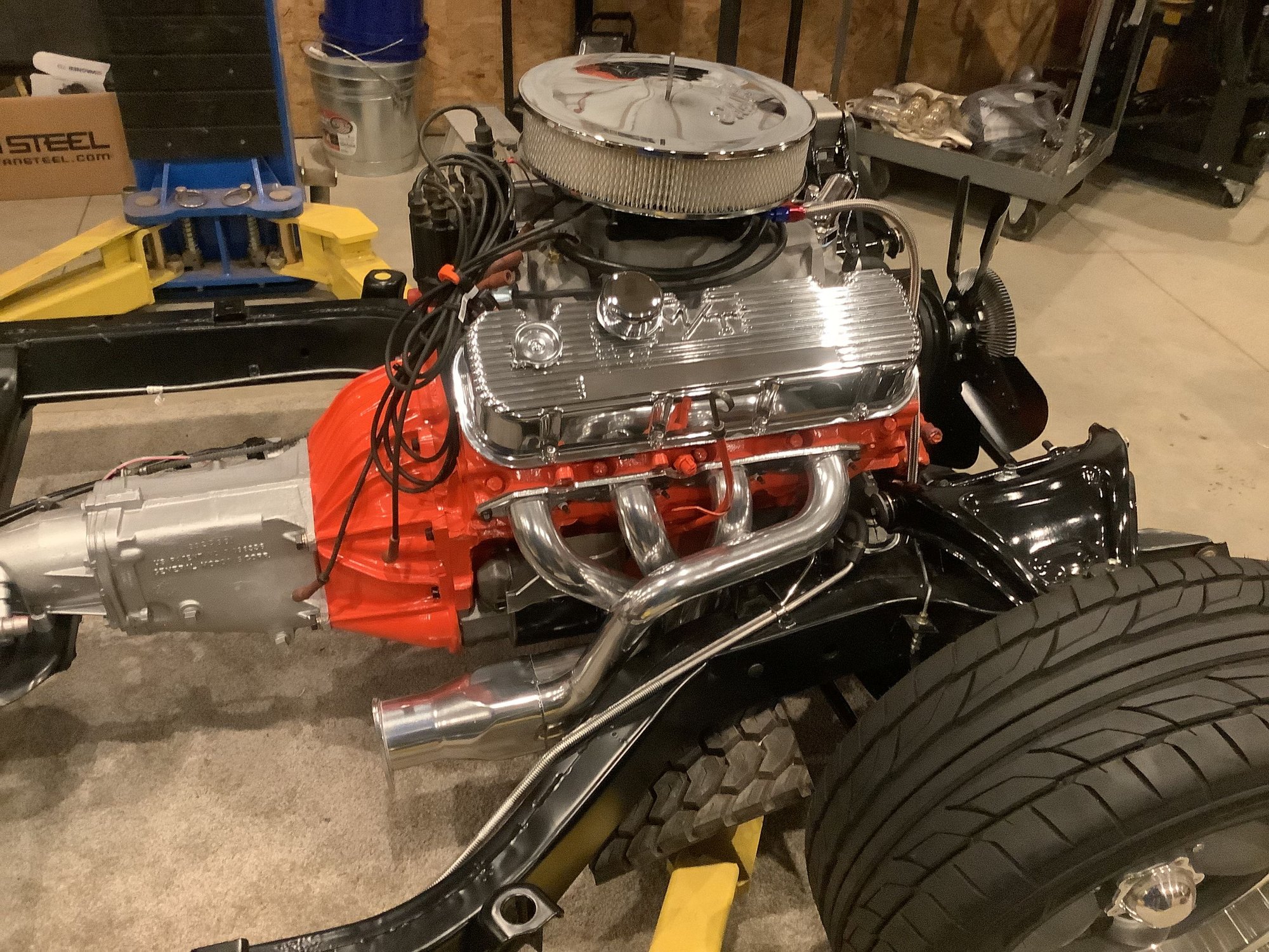

Time to purchase an complete exhaust system. It’s a 70 with 454 Ls5. Any recommendations​​​​​​? I need from the headers back.

OP, I do not wish to hijack your thread, but one quick question - Your Muncie is damn clean as they get. I've spent hours and hours on mine with various brushes, Orange de-greaser, water, etc and still can't get it looking that good. Looks like you may have painted it - Wheel paint?
I just painted my 4spd and bell housing. I used vht engine and drive train aluminum metal flat finish

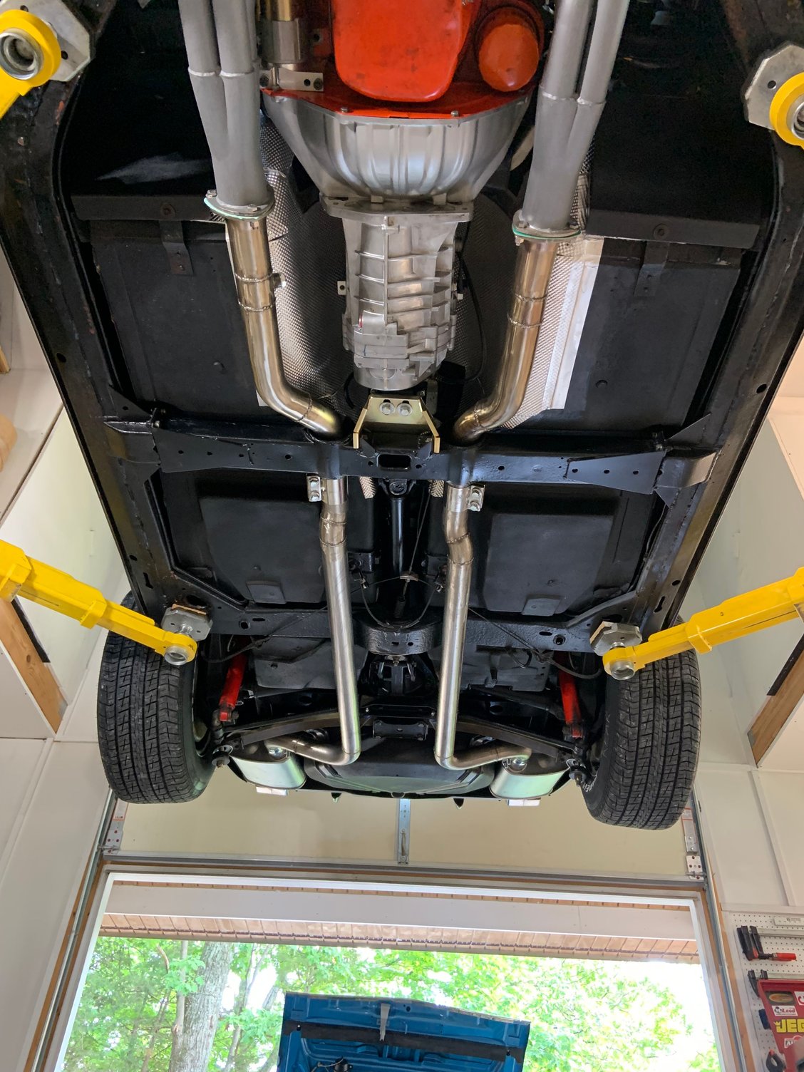

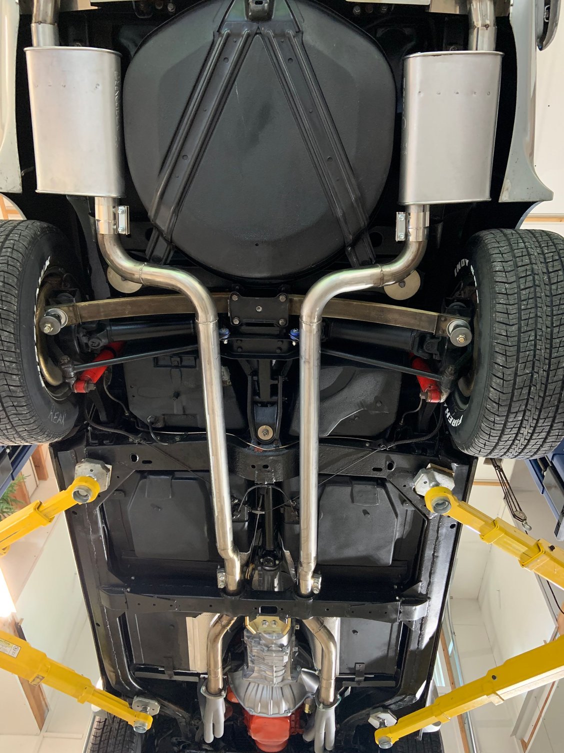

You look pretty handy, do you weld? If so you can build your own custom exhaust fairly easy. I built this exhaust above using Summit's basic stainless pipe set and FlowX mufflers.
In addition, with custom exhaust, you can build your system without all the factory kinks. Also, using band clamps is really helpful if you need to remove your exhaust system easily. I found that I have been routinely removing mine to gain access to the rear axle for suspension work.
