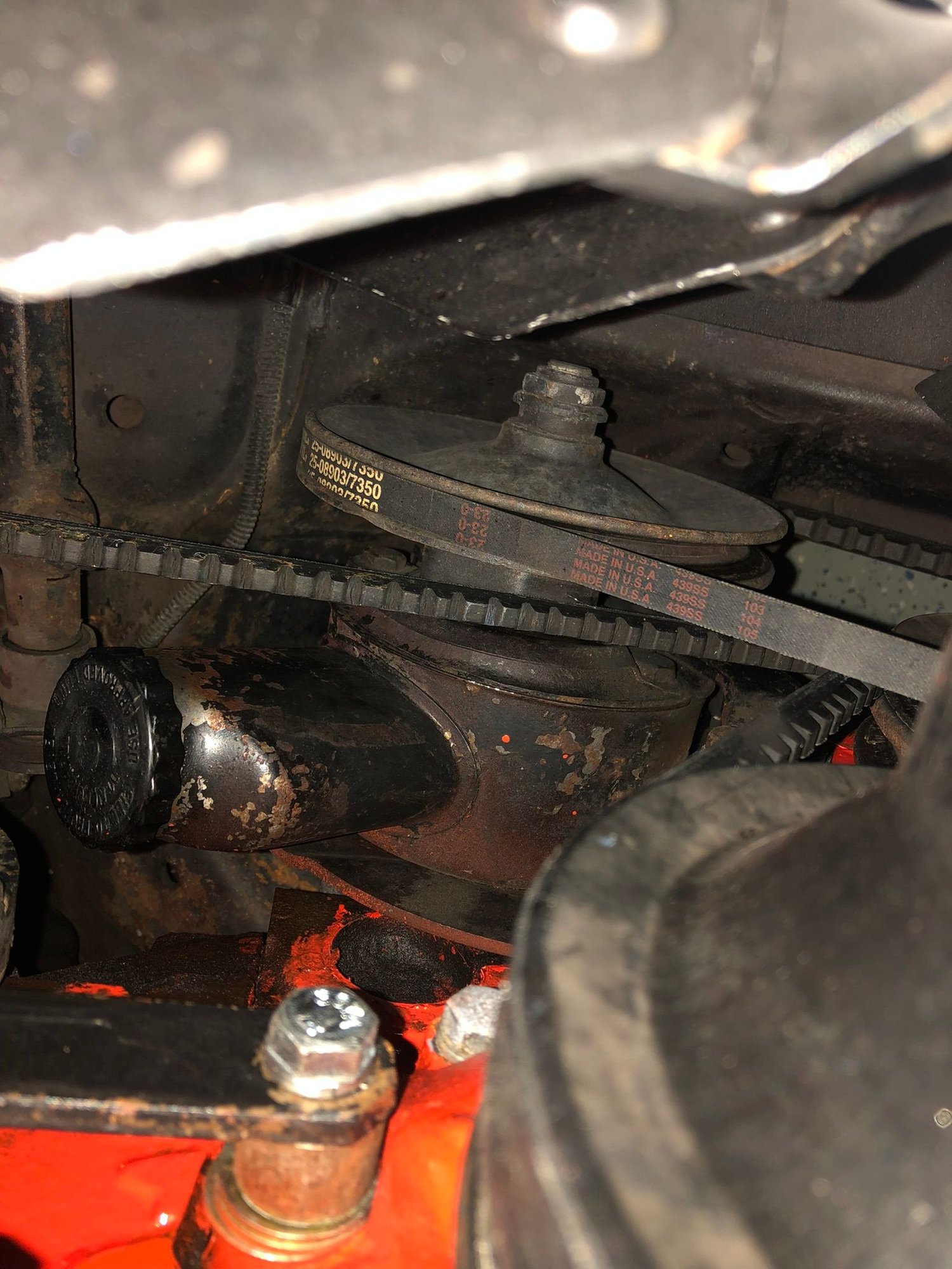

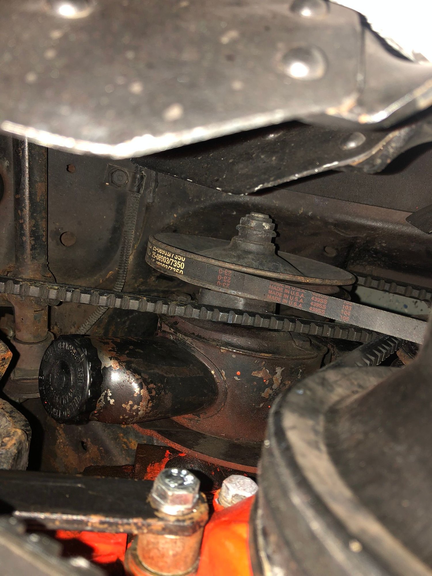

Here is a picture, I am sorry if it makes anyone sick.
Ugly
Disgusting

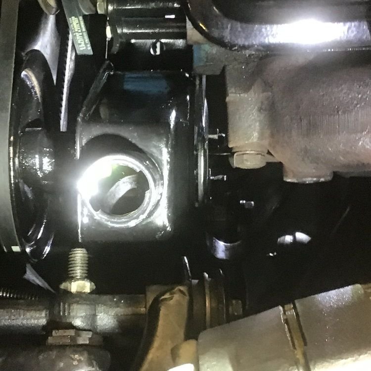

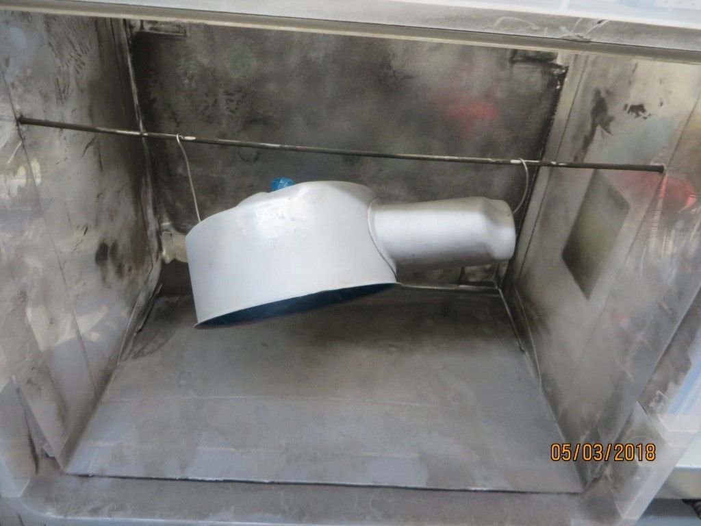

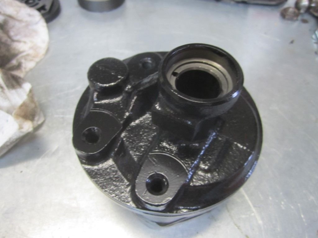

Mine was about the same
The pump is one of the most simplistic things going, right up there with the oil pump. If it's working fine, a reseal kit and a little paint (I powder coated the can) and some bench work and it'll look better than new.
No special tools needed. If you don't want to open it up then cap off everything and stuff some rags in the neck and tape it closed, clean and wire wheel / sand blast (carefully) and give it an enamel rebuild
M
Old Mar 25, 2023 | 09:43 PM
Mooser's Avatar
Mooser
Joined: Apr 2011

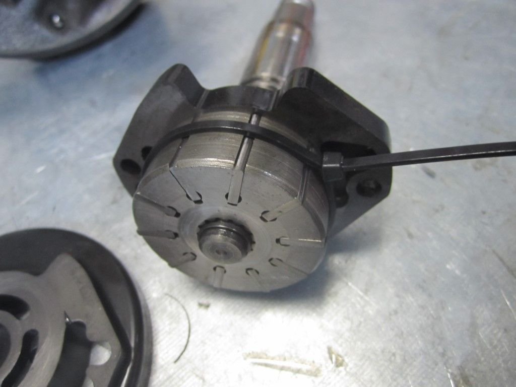

Posts: 11,183
Likes: 3,336
Complete rebuild
M
