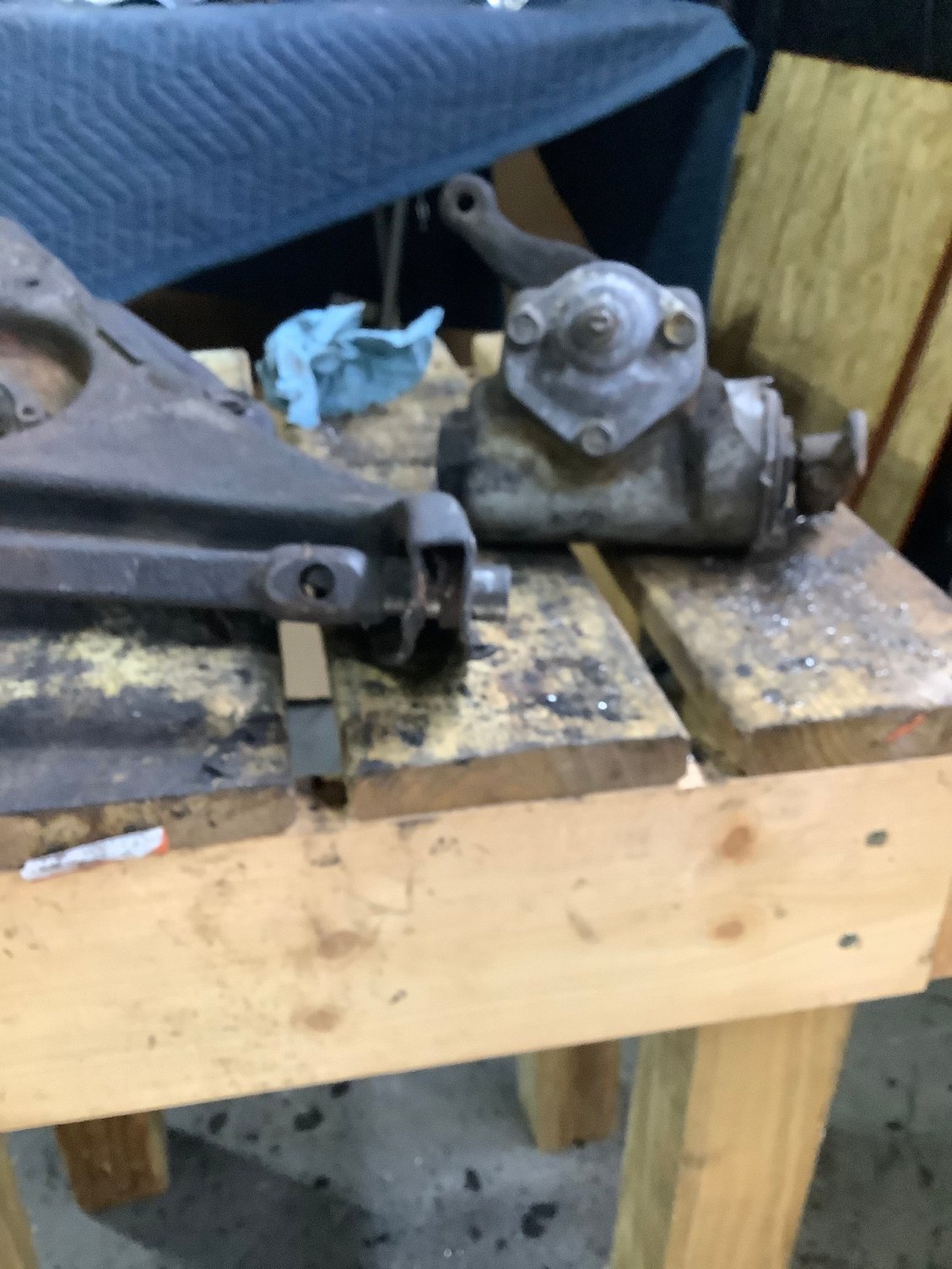

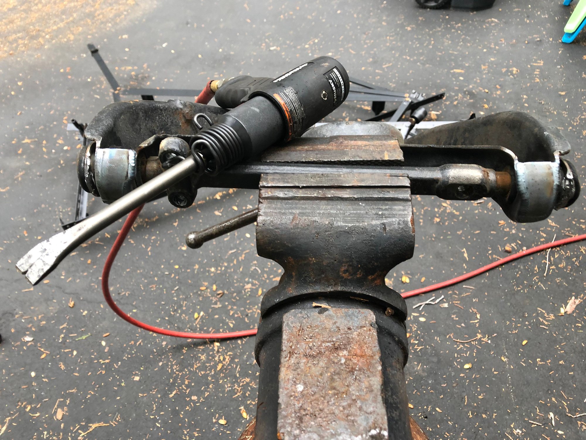

Here they are

I have a set for sale on the Parts for sale forum......Blasted and powdercoated. I will bring them to the top of the forum for pictures.

I bent mine a little so I know you can straighten them
use bushes as your guide
luck

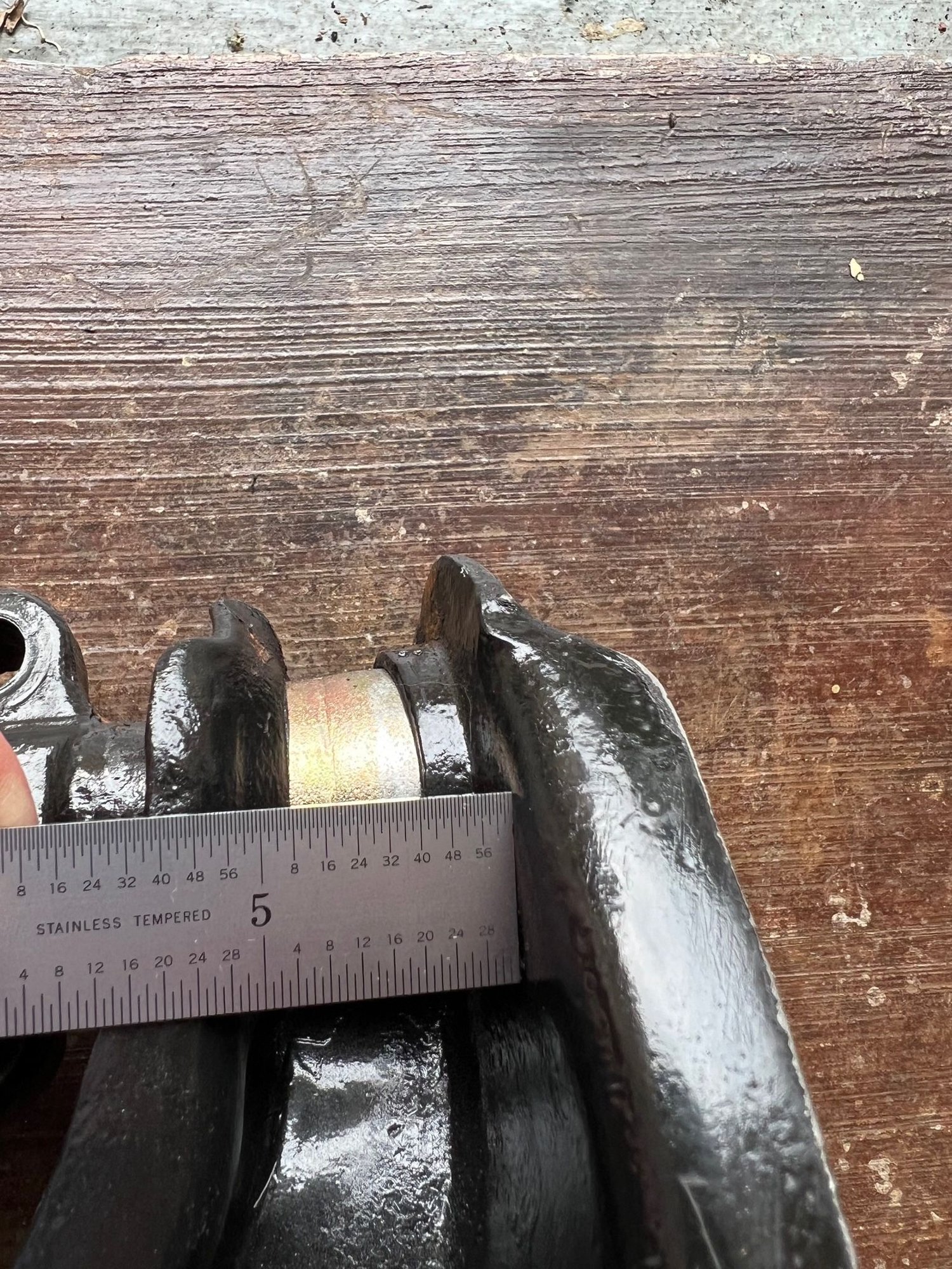

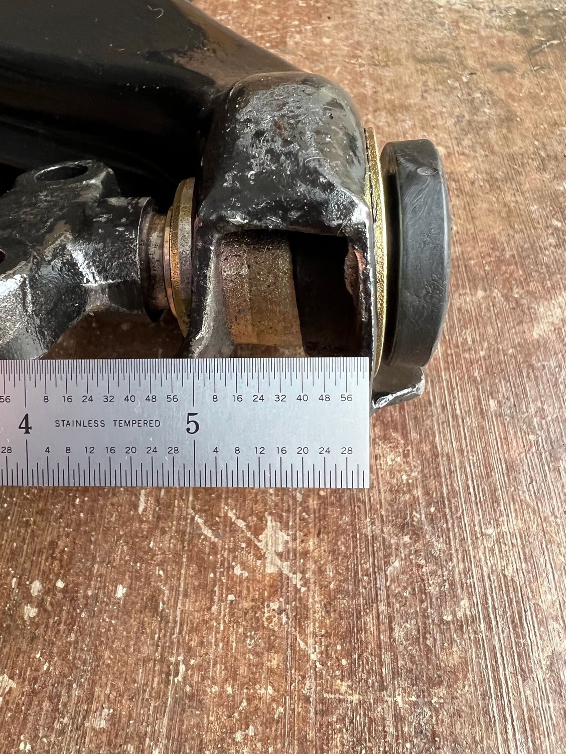

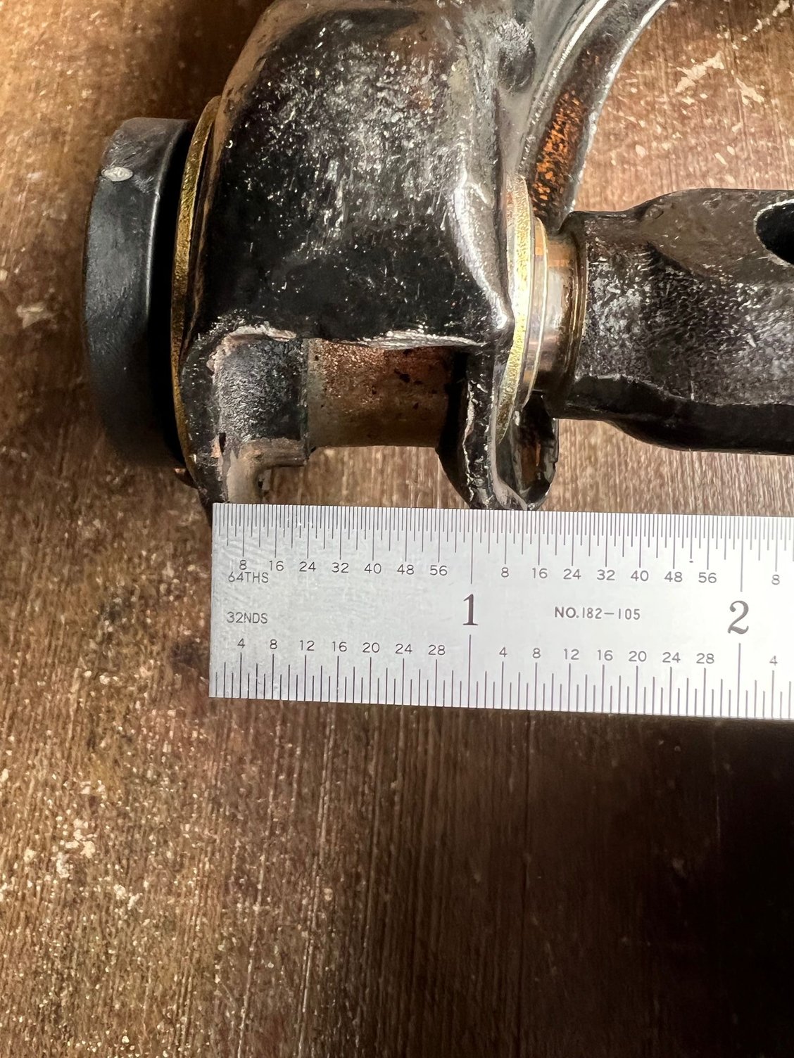

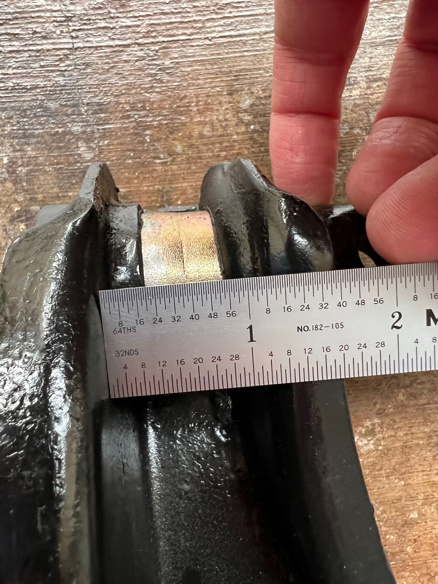

For what it's worth....I don't have an actual under but maybe these will help with how much the outer sleeves stuck through on mine
M

Trying to straighten them now will certainly weaken them. There pretty bad.
I would look at the offer posted above about the nice powder coated ones.
Next time, if there is a next time. Torch out the rubbers. (Yes I know it makes a lot of black smoke).
then while still hot knock out the sleeves with a air chisel. Done and no damage. Just some air pollution.

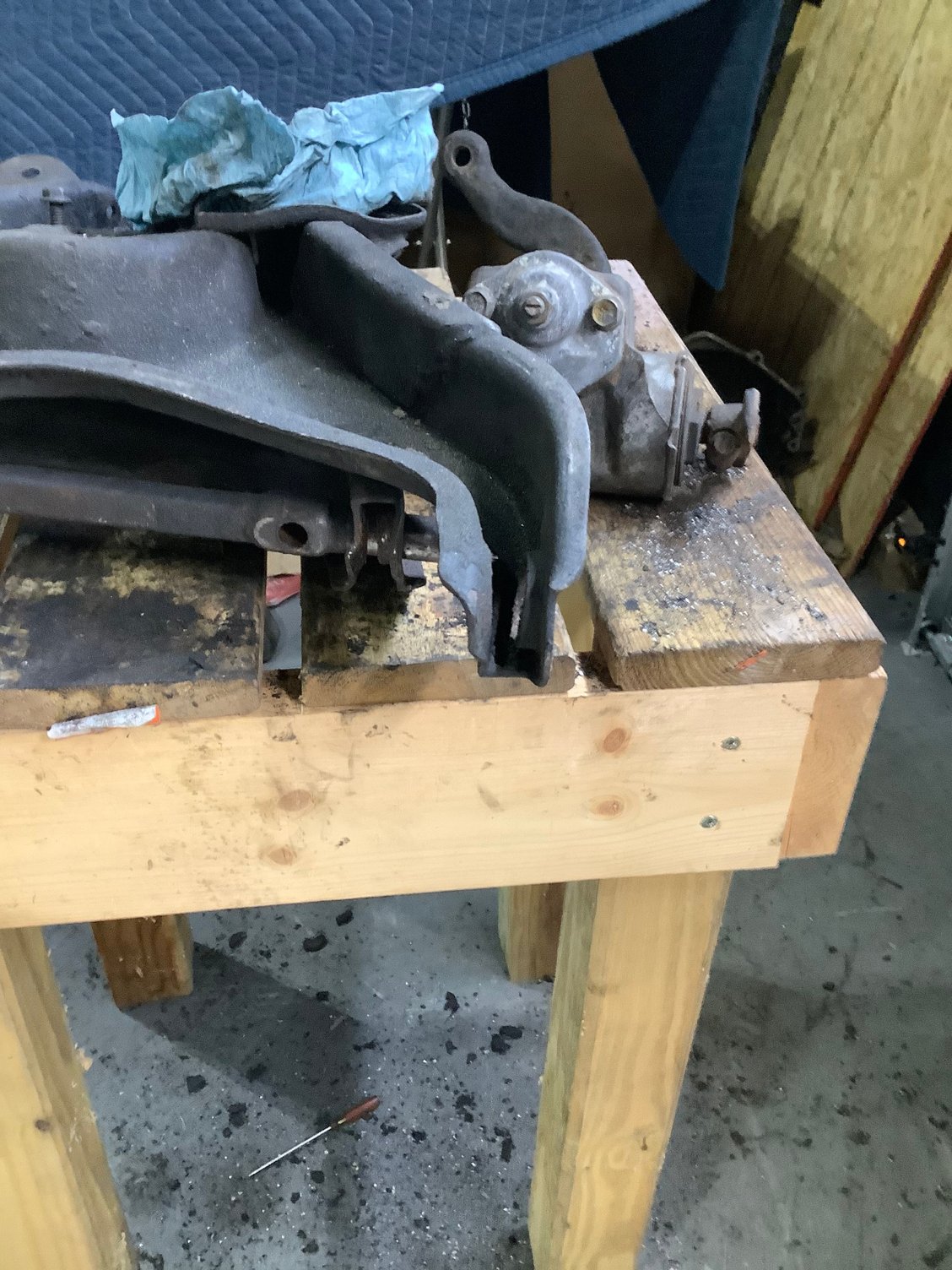

I made plates for mine and welded them in before disassembly

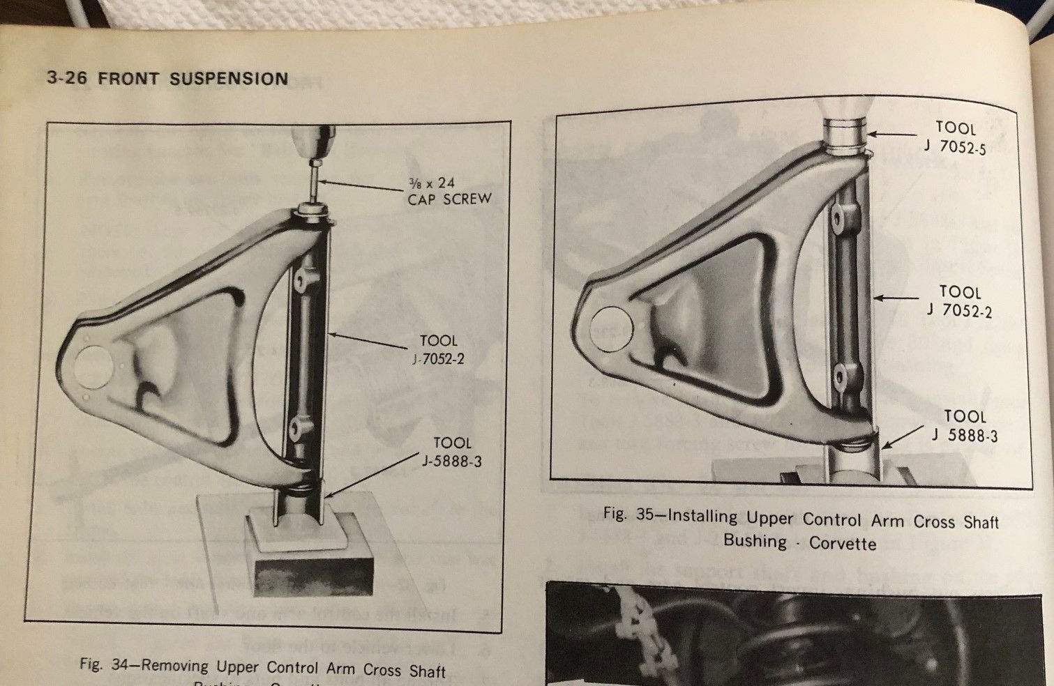

Buy new A-Arms, those are done. You can fabricate the tools GM used for this job to prevent this from happening.

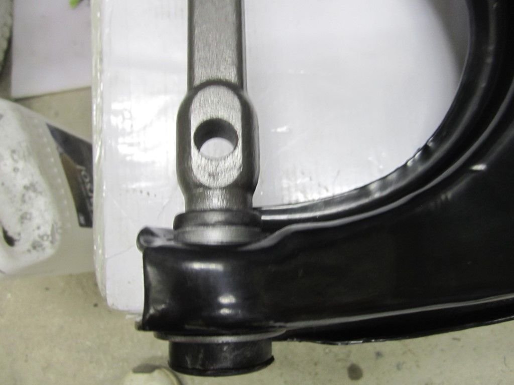

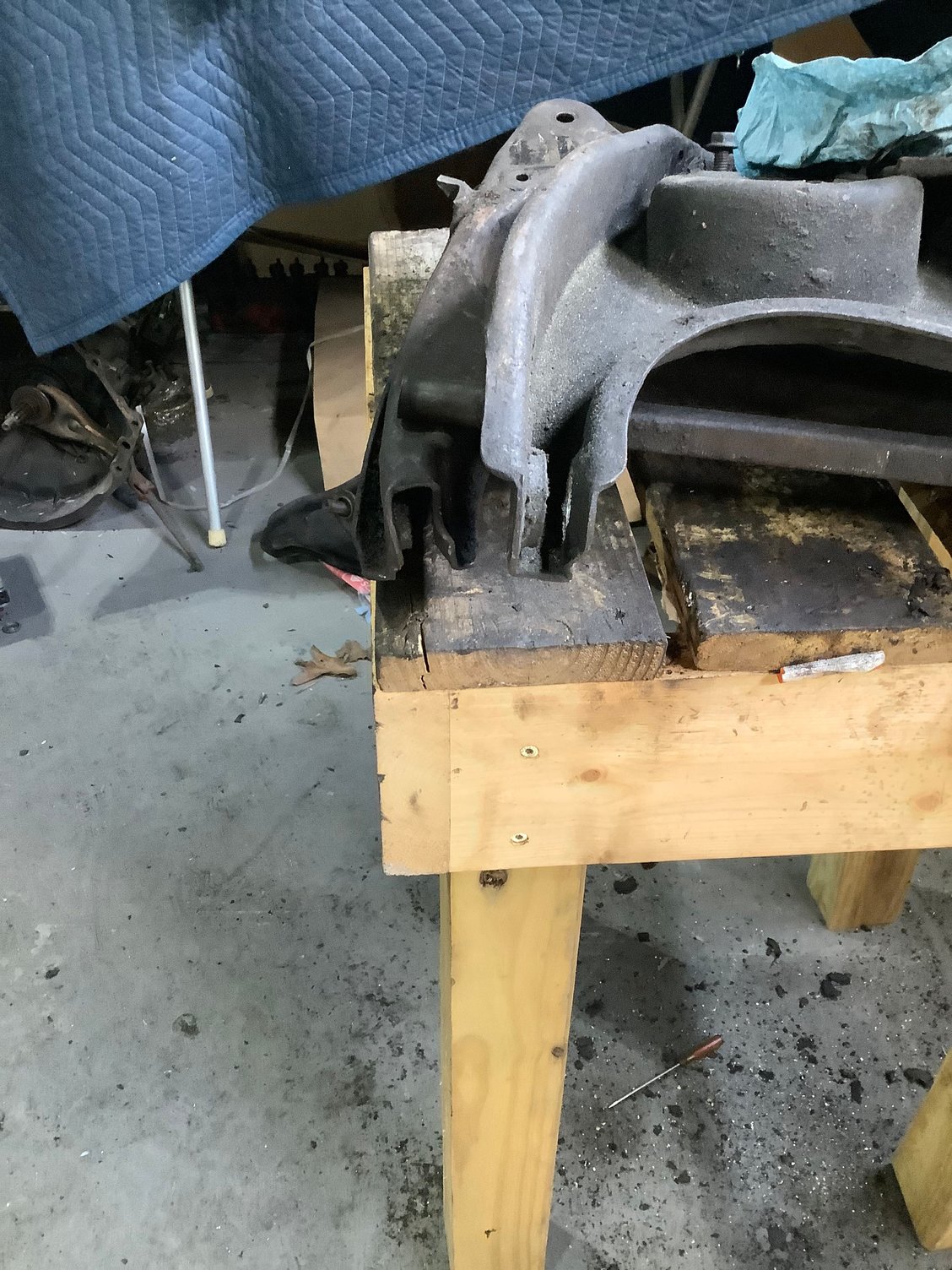

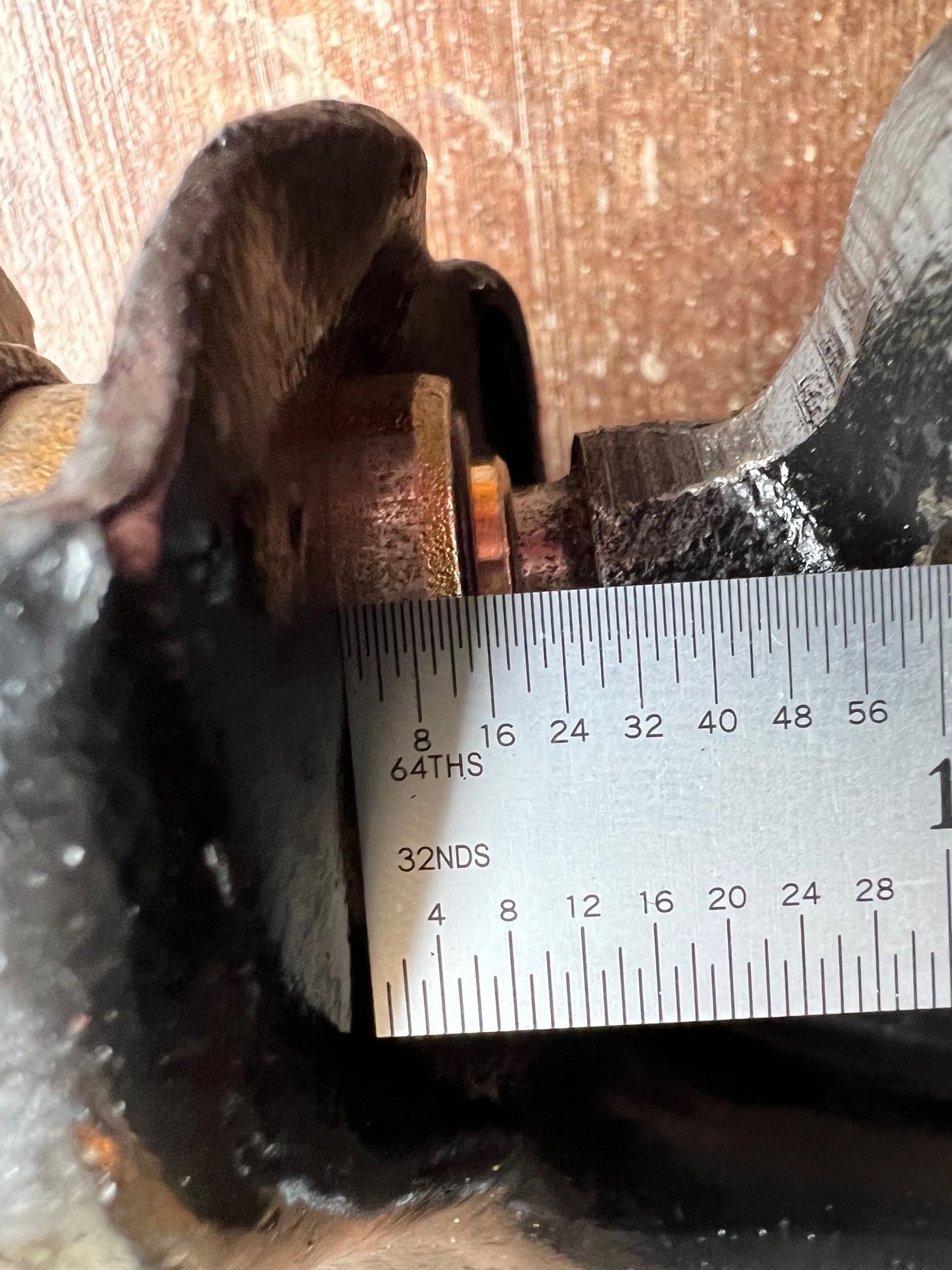

I'm probably in the replace them camp, but here you go since you asked. Btw, I did the air chisel getting them out. I think getting the new bushings in was more difficult than getting them out. Disclaimer: These pics are from the driver side of a 66, but should get you in the ballpark I would think.

Thanks texas c2. Yes mine are toast, I iam replacing them Thanks for the pics
