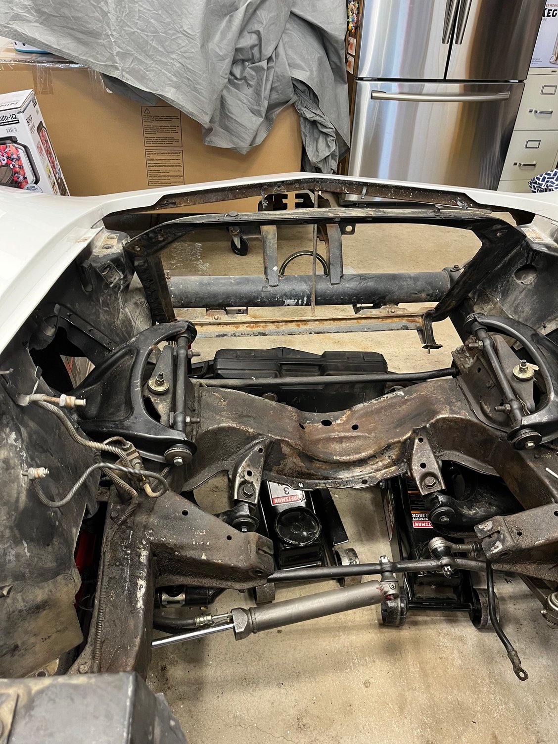

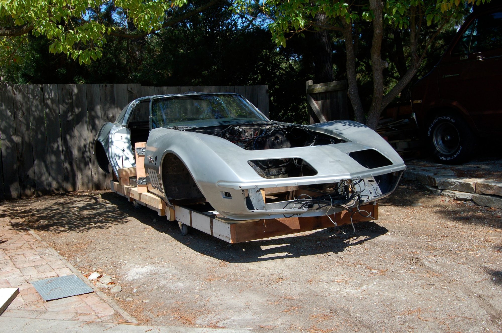

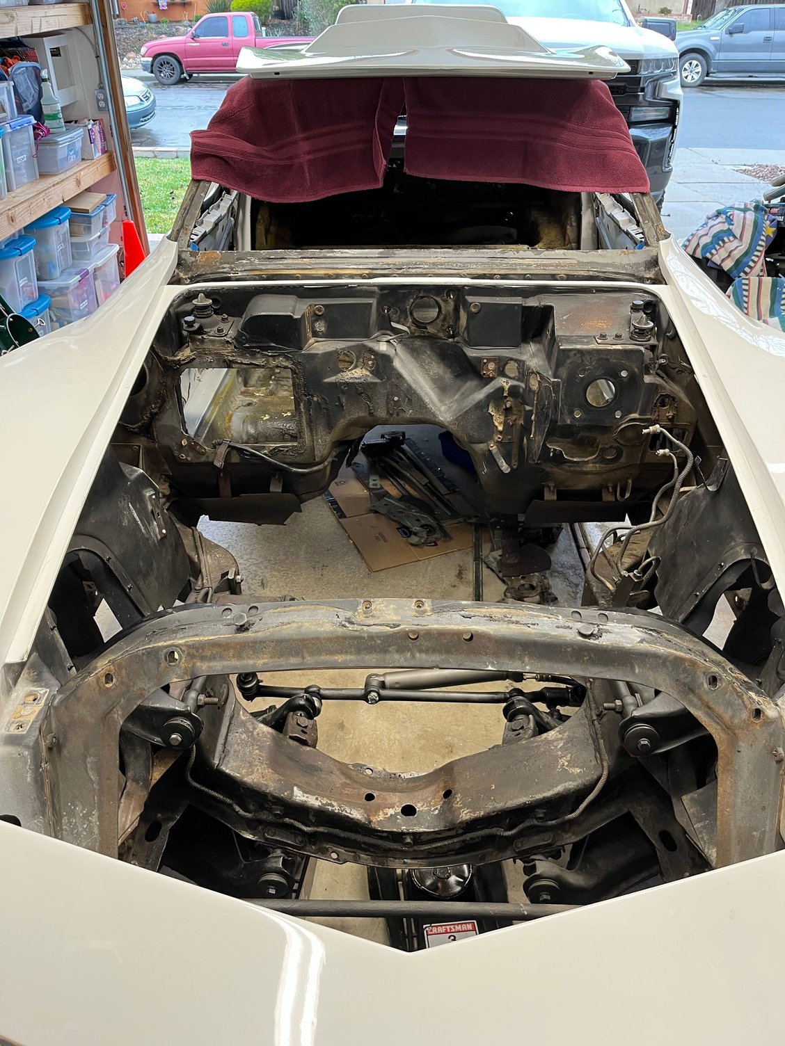

I’m getting ready to remove the body from the frame of my 73 Coupe and have a few questions.
The body is completely stripped and is a bare shell, see pictures below.
This will be a one man operation.
I’m thinking, instead of lifting the body from above, I could slide two 8’ 4x4’s completely across the underside of the body, at the body lift points, one at the front of the doors and the other just behind the doors.
Then jack the body up off the frame using my two 3 ton floor jacks a few inches at a time alternating from the front to the rear.
Once the body is high enough, I could roll the frame out from under the body, then lower the body onto the dolly.
I’m considering doing it this way so once the body and paint work is completed, I can reverse the process and not cause any new paint damage caused by lifting straps.

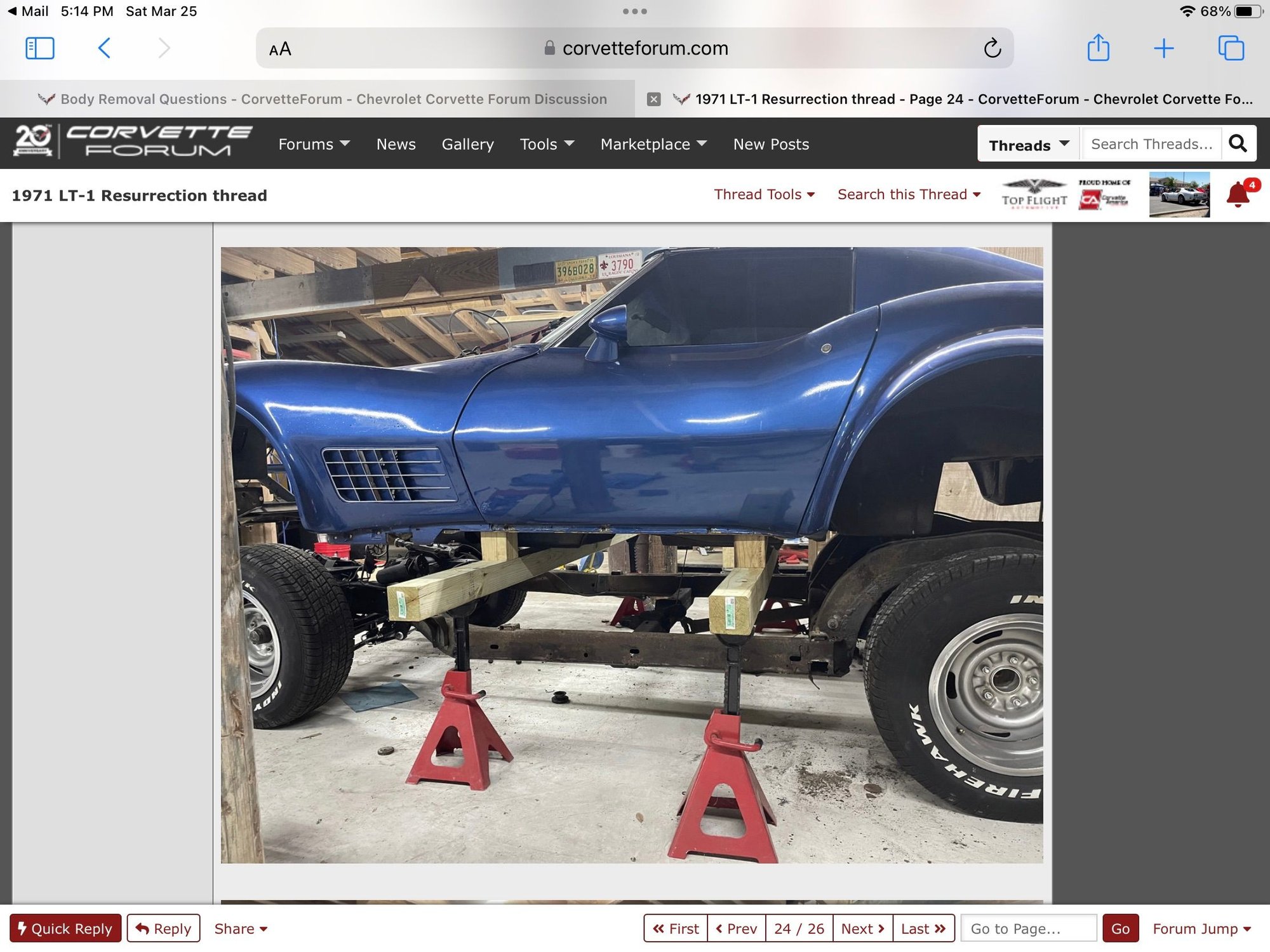

https://www.corvetteforum.com/forums...thread-24.html
Check out post #466. Also, notice how he supported the nose.

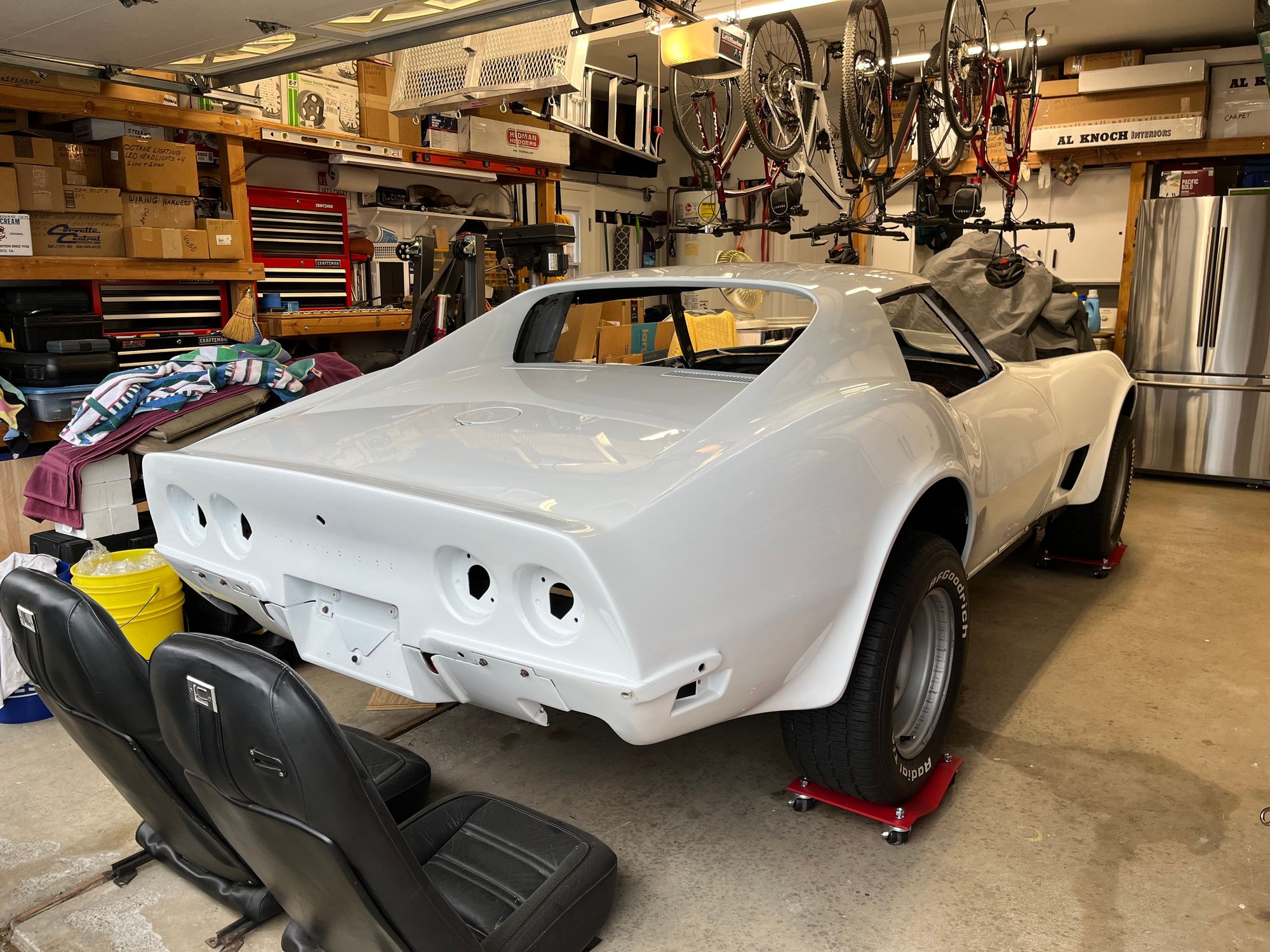

I have retrofitted a set camper jacks, that I used to take my body off. The jacks are at George’s shop, your welcome too them go by and check them out.
Bob

Have used camper jacks for years. Be sure to support the nose!
3rd time she’s been off the frame - this will be the last!

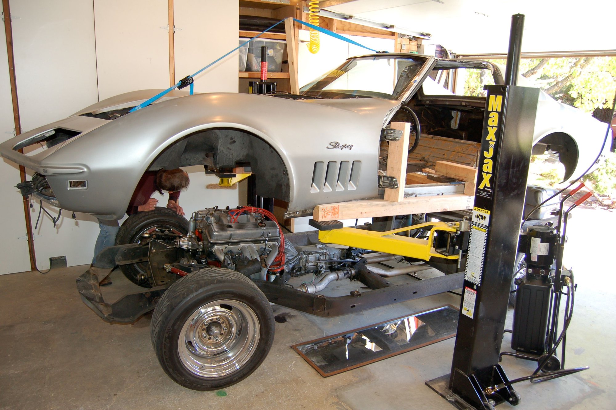

Here's my rig. Lifted the body off, rolled the chassis out and a body jig back under, and dropped the body down. I would guess most of the lifting force was at the door posts, which are pretty sturdy.
I was able to paint the car on the jig and then reverse the process. Actually did this a couple of times because my muffler shop wouldn't touch the exhaust (LS motor, etc.) until he had both together temporarily.

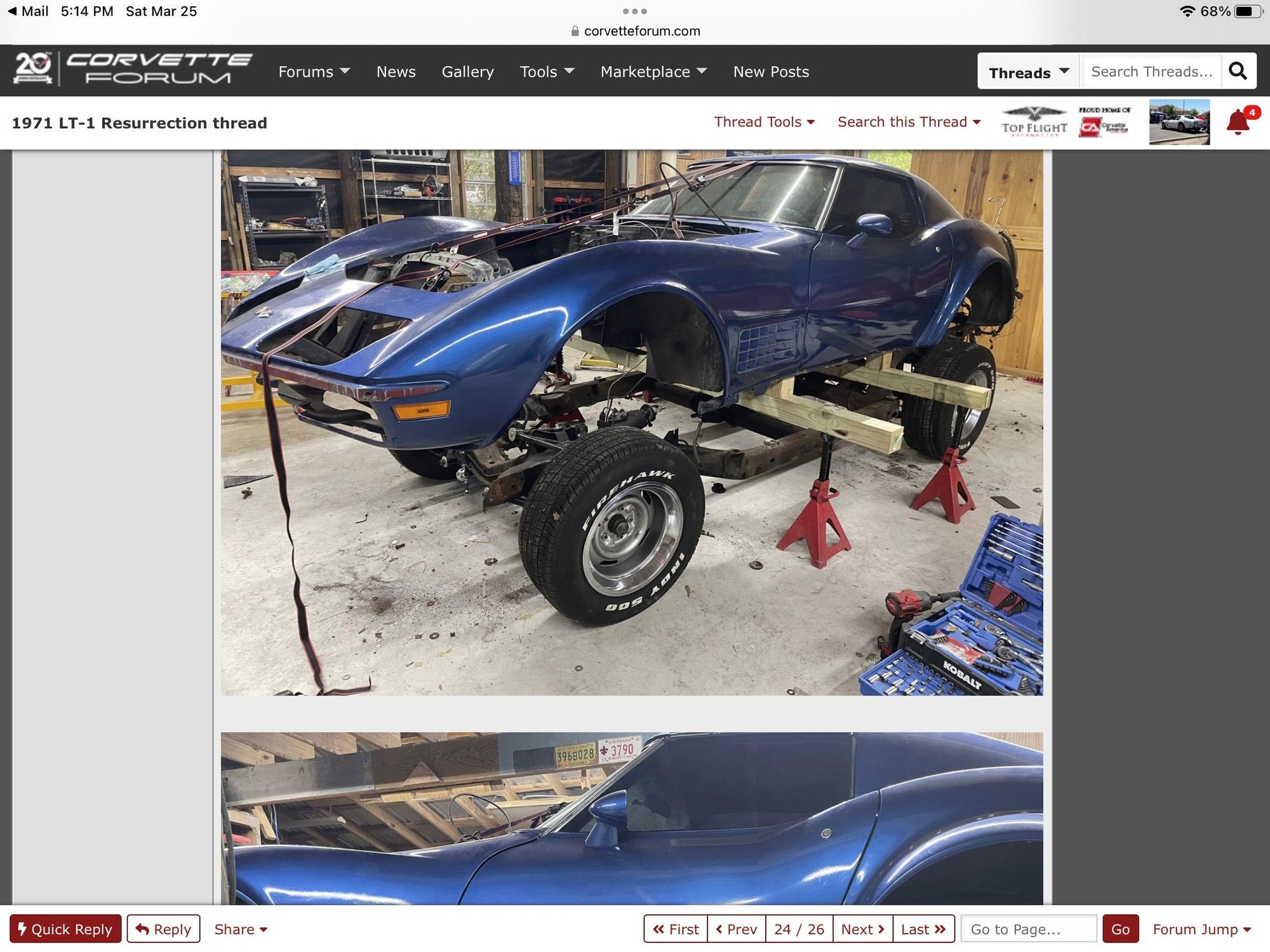

Taken from Arg0413’s thread.
Originally Posted by Arg0413
I used two floor jacks on the same side and had cut out 12" sections of 4x4 to lift on the body edge with the two jacks at the same side. I got the drivers side high enough to slide two 4" sections of 4x4 into the channel and sit it on the frame. I then did the same to the passenger side. I then went back to the drivers side and jacked it up high enough to slide in the 4x4's. and then worked side by side until I got it high enough to get the 4" pieces of blocks on top of the full length 4x4's. Took my time and worked slowly, but it wasn't bad to do! In retrospect, it'd probably be easier with body lift straps, but I didn't have a set and made this work.

You could probably do something like this with straps to the 4x4's at the rocker area. That way you wouldn't have to slide 4x4's under the car. This did take some wood cutting to get it all to fit properly. I wasn't sure if this wanted to rotate some, it didn't, so I didn't need the 'L' shaped piece.

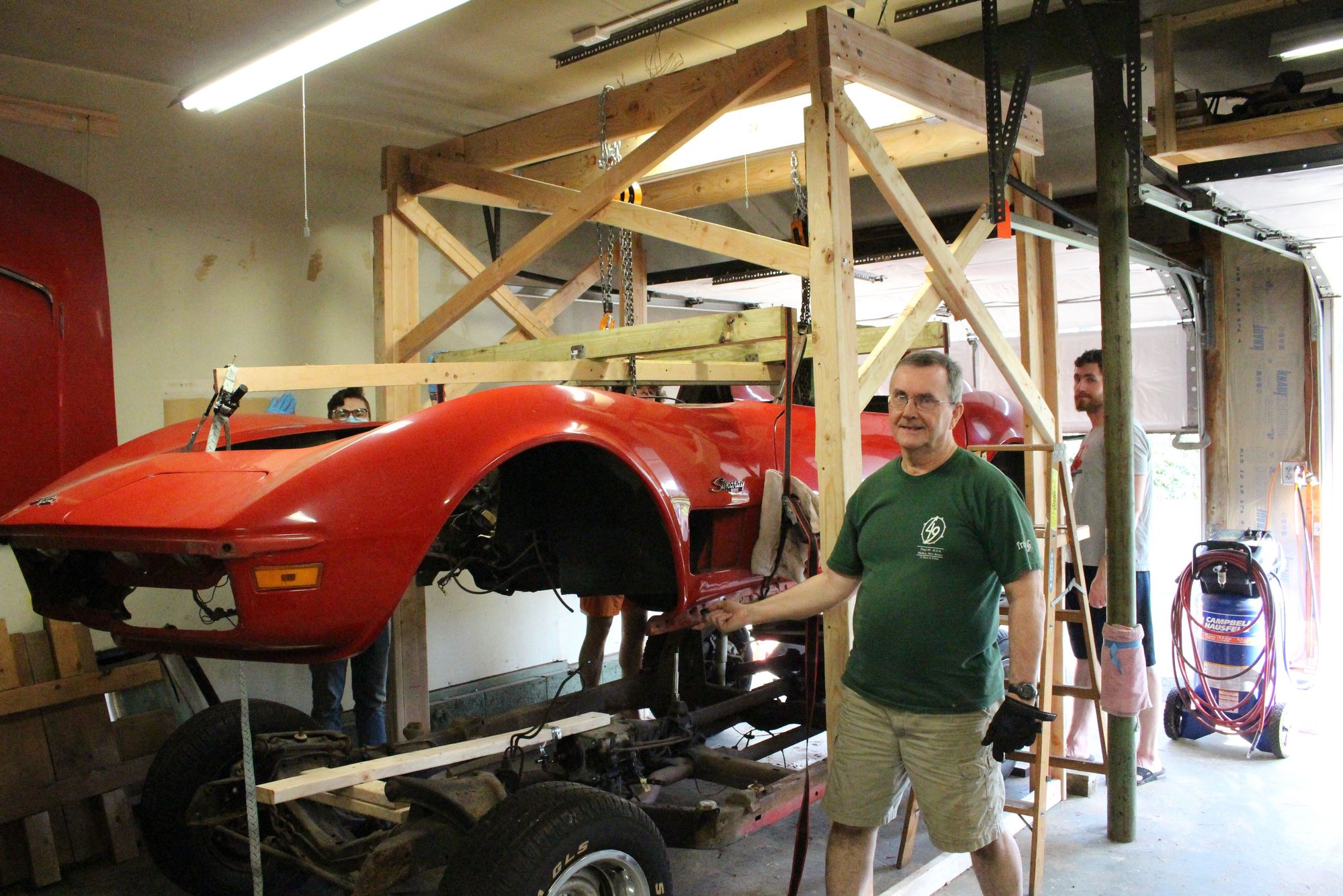

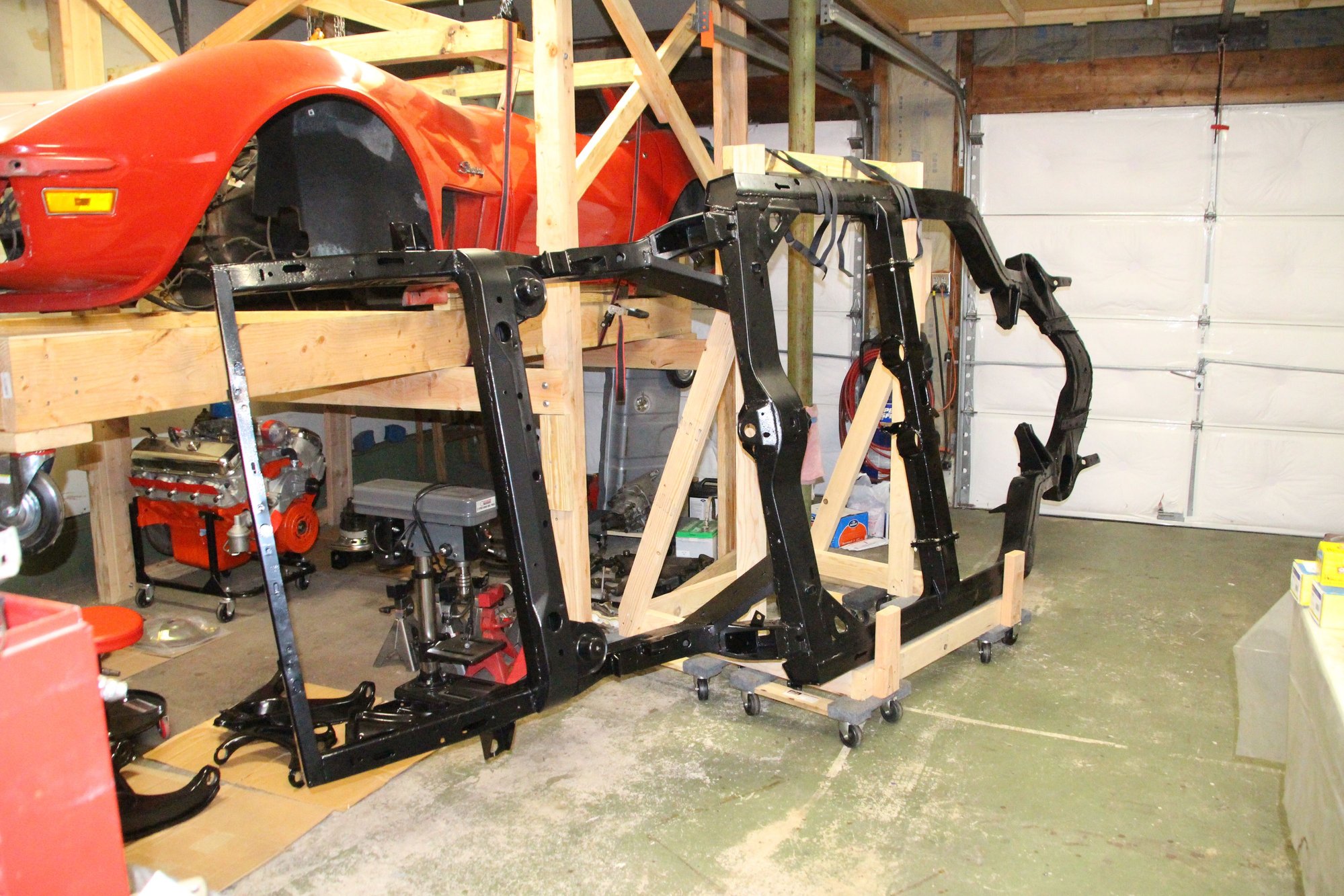

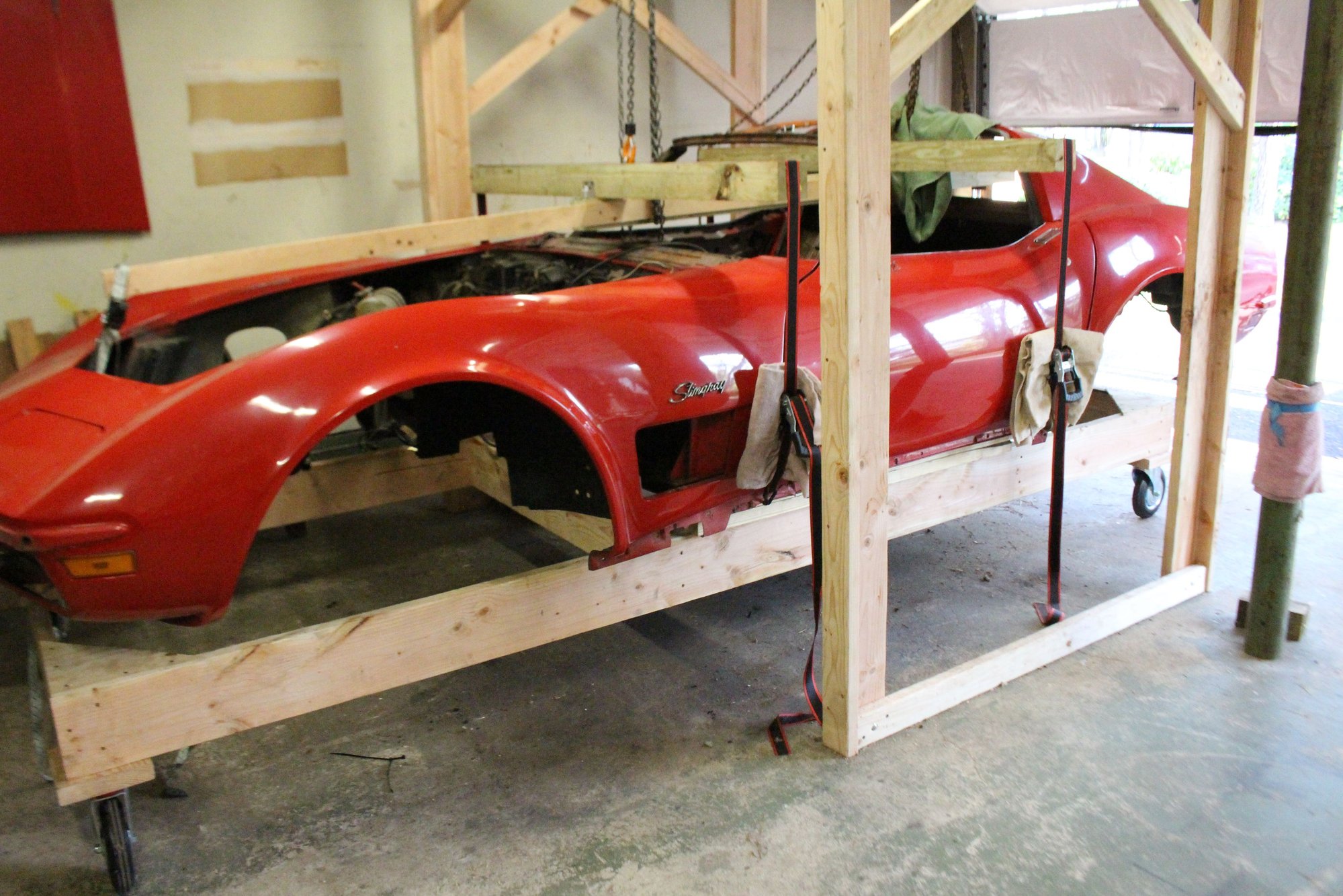

Here is the contraption I built out of 2x6s, & 4x4s. I like wood, it is very user friendly.
I used regular ratchet straps and spaced them out from the body with the 4x4s, so the straps were vertical and there could be no paint damage.
I used two chain hoists for the lifting itself.
I would estimate the bare body weighs about 450#. I will figure out a way to weigh it later. FYI a 69 Steel Camaro body weighs 900#.

Ok my main constraint was I had a 9 ft ceiling height.
I knew from pulling the BBC with a cherry picker that was barely enough.
Plus I wanted to store the body in the air, safely supported of course, to give me storage underneath for heavy parts.
While I worked on the frame in the other garage bay.
The uprights are just a pair of 2x6 nailed together at right angles to get rid of the flexing.
The main top center beam is a doubled (screwed together) 2x8. I used a beam calculator program online and it is strong enough to easily hold the 1000lb engine/trans if I ever decide to use it that way.
I estimated the body weight at 450lbs.
I added some more diagonals up top to stop the wobble. It's pretty stable now.
The T-Top practically goes to the 9' ceiling.
That is the reason I have the 4x4s going thru the window areas.
2 chain hoists/pulls allow very easy one man control. And the double hoists means it doesn't wobble much.
It would pivot slightly right to left on the chains.
We used 4 people during the body lift, but they really just held onto a corner with one hand to stabilize it and watched to make sure nothing hit.
I currently have the body resting on its wood wheeled cradle, and that is bolted to the "lift"
It is high enough now I can easily scoot underneath it on a mechanics stool.
Before the lift
Top details
4 of us during the lift, but no one working hard!
Back down on the wheeled dolly.
The body has been stored in the air like this for a couple years, while I store heavy stuff like BBCs under it. And rebuild all the mechanicals.
