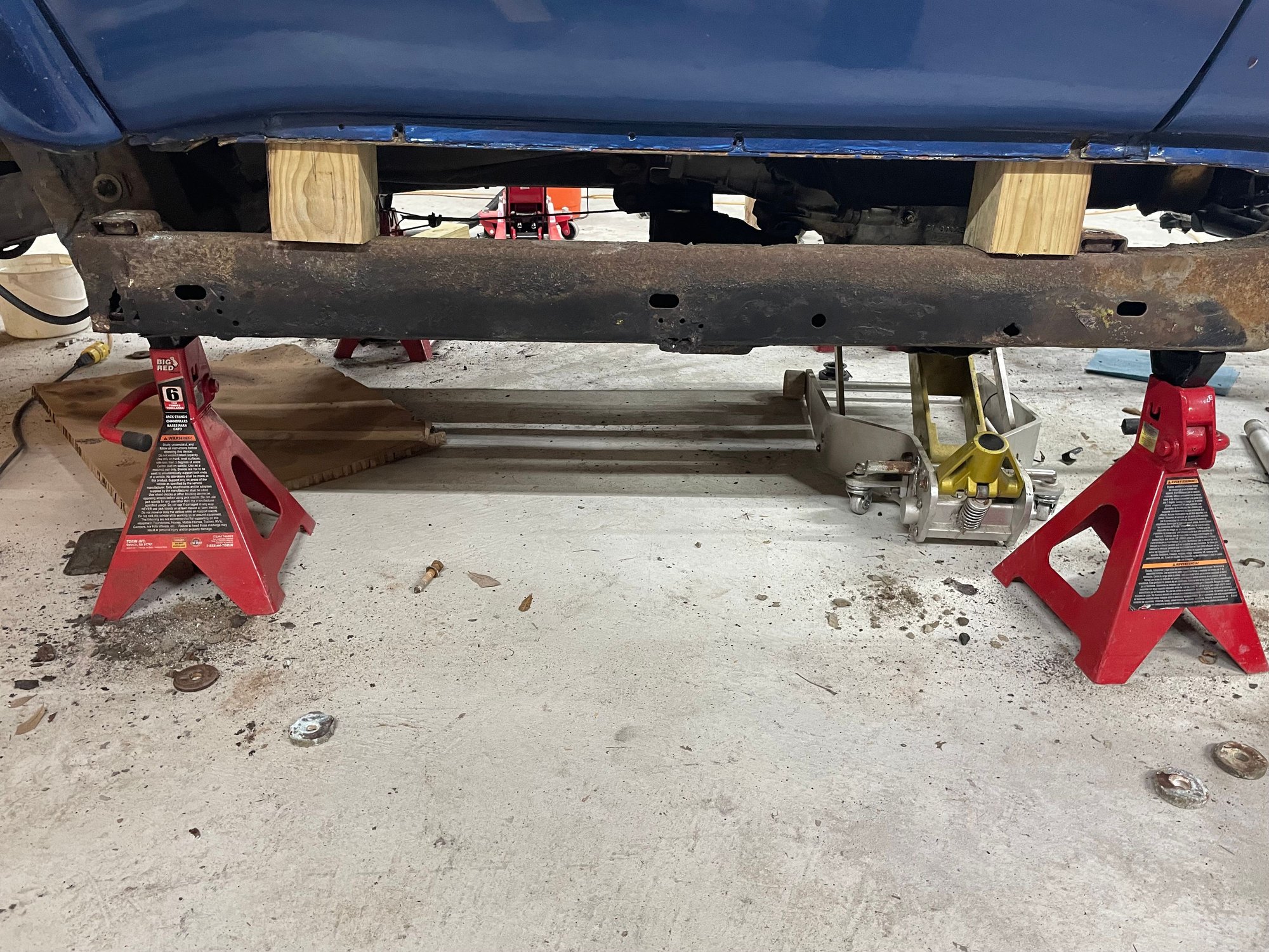

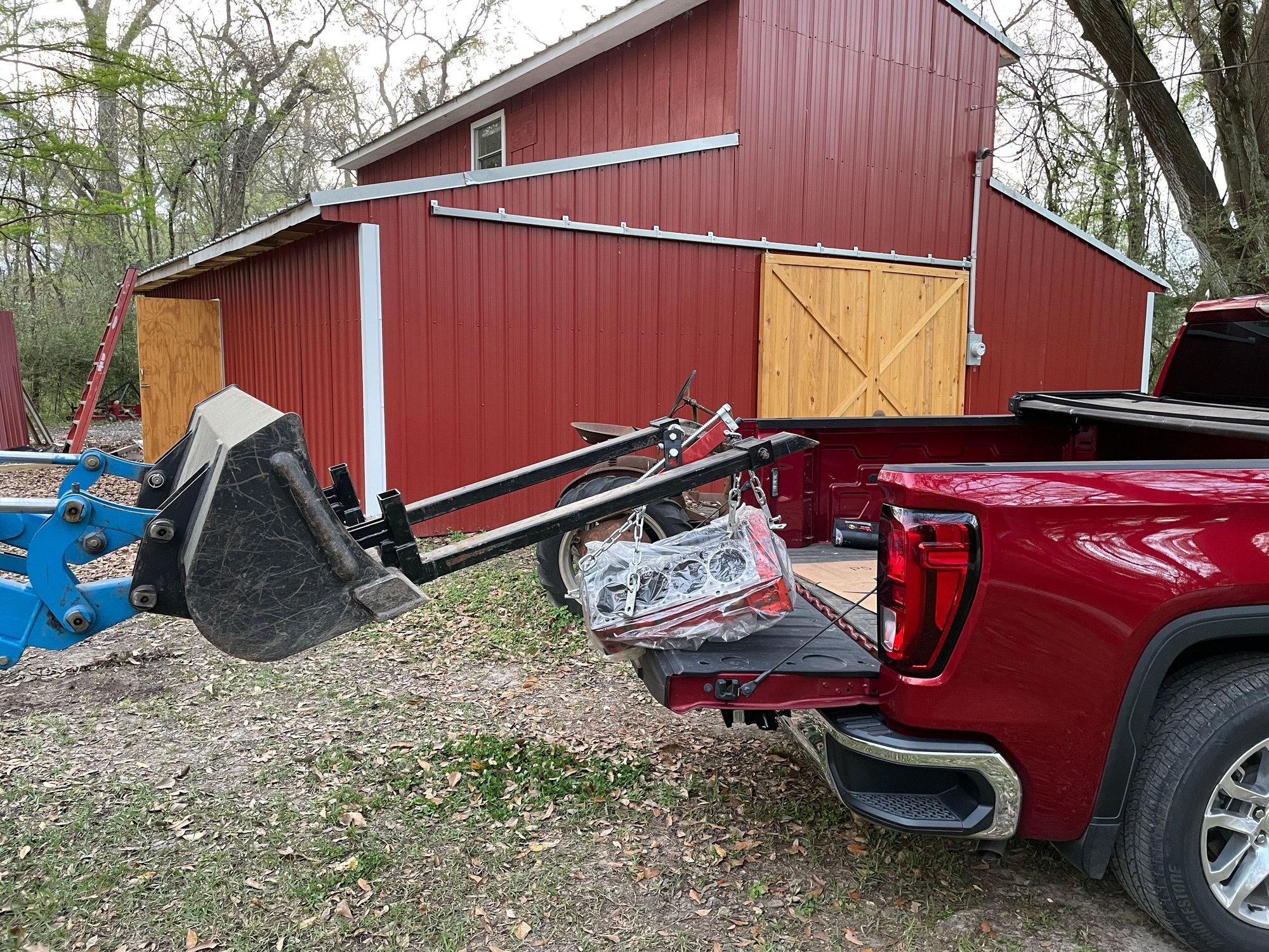

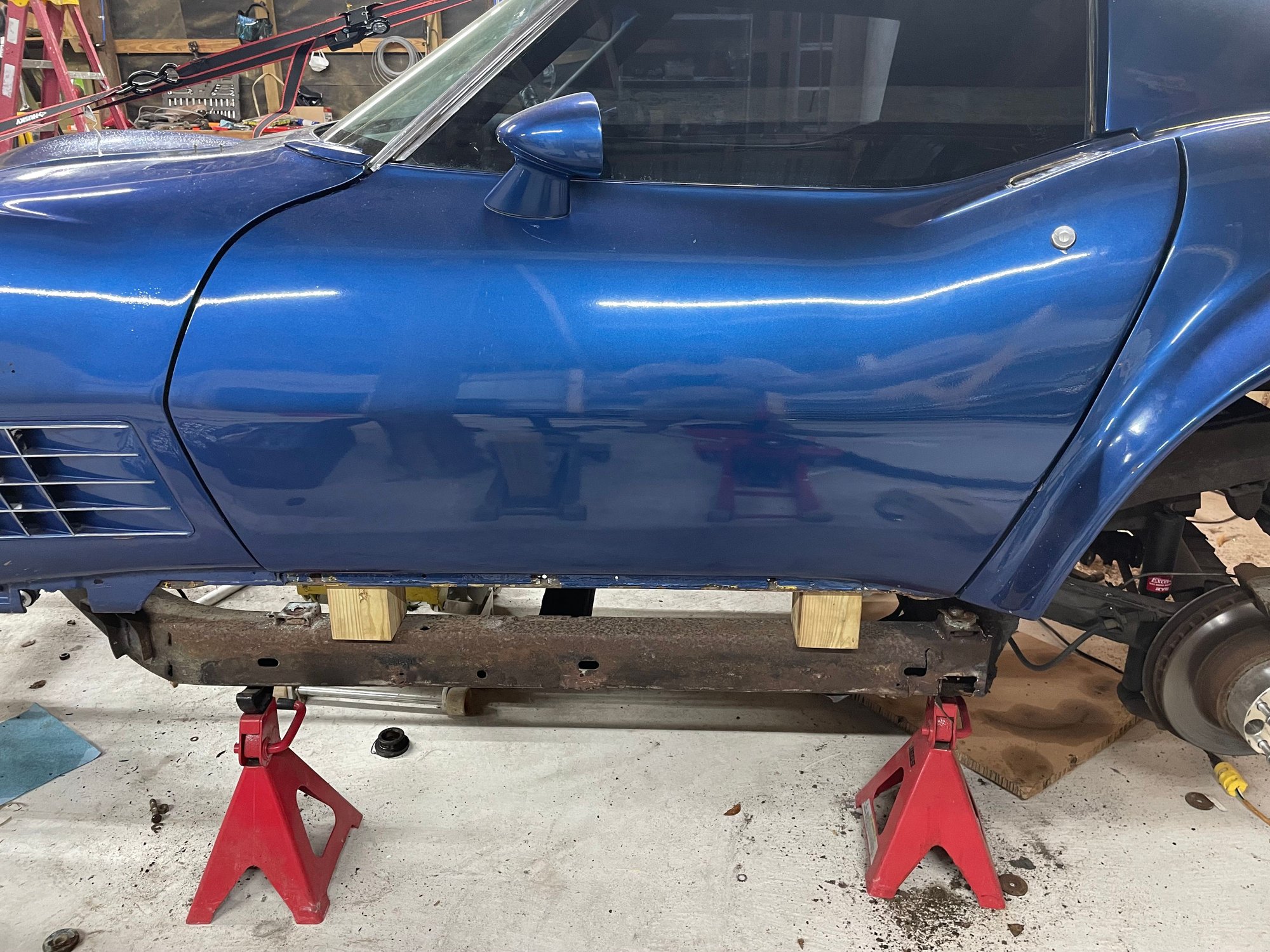

I was able to swing by the engine shop today and pick up my fresh block: she has a clean bill of health and everything is fresh and clean! I used my favorite tool, tractor with loader, to quickly get the engine back on a stand and into my shop to build.
I also picked up a 4x4 to make a safer setup to lift the body: cut two 12" pieces to lift with two jacks, and four 6" pieces to hold the body up on the frame. I used two jacks at a time on one side and very slowly started lifting up.. had some snags that were resolved. I put the blocks on the side and slid them in so that side would only be 3.5" up. then brought my two jacks to the passenger side to get it up to the full 6" . worked great!

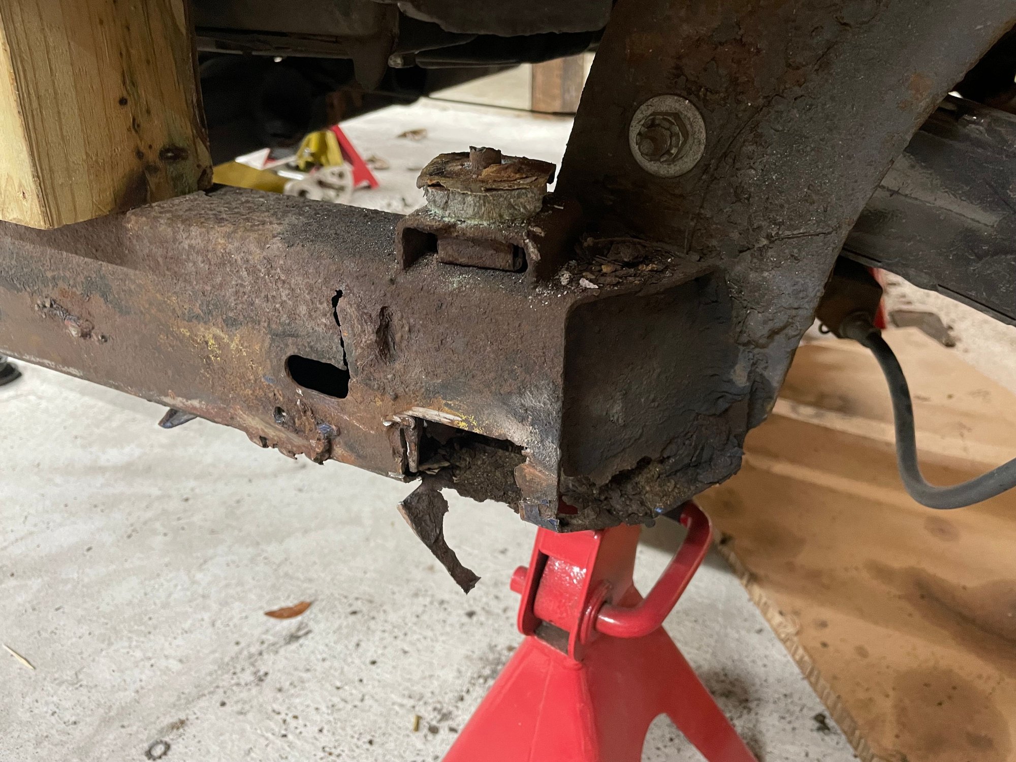

Here's the offending rust damage on the drivers side. Besides surface rust, i've found no surprises on the frame, and the kick up are really solid! The body channels are in great shape too!
This is what I did to support the front and keep it from sagging too much: simple ratchet straps
Sitting nicely on the 6" blocks

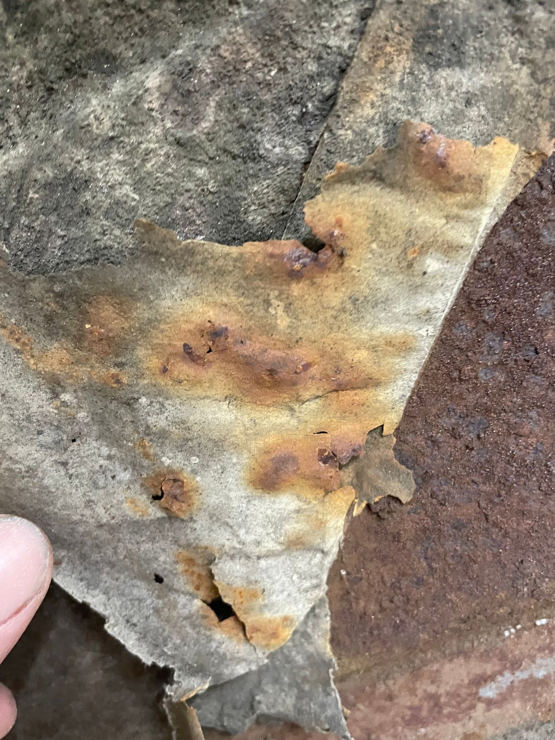

Below we see the remnants of the build sheet found.. unfortunately I don't think anything will be legible
How I left her in the shop tonight: Body and frame up!
Here's a look at the rust damage on the PS : not as bad , but still going to cut everything out and weld fresh metal in.
So at this point, I need to sand blast and weld in the metal repairs. I'd knock it out this weekend, but rented an excavator to landscape my pond and property... so we'll have to wait until the following weekend... I think I'm going to make a jig with 4x4's to hold the body up, and roll the frame out for blasting and repair. I need the weight off the frame tails before I start cutting and welding.
So that leaves engine painting then assembly next week. , then knock out that frame and we're on the home stretch!

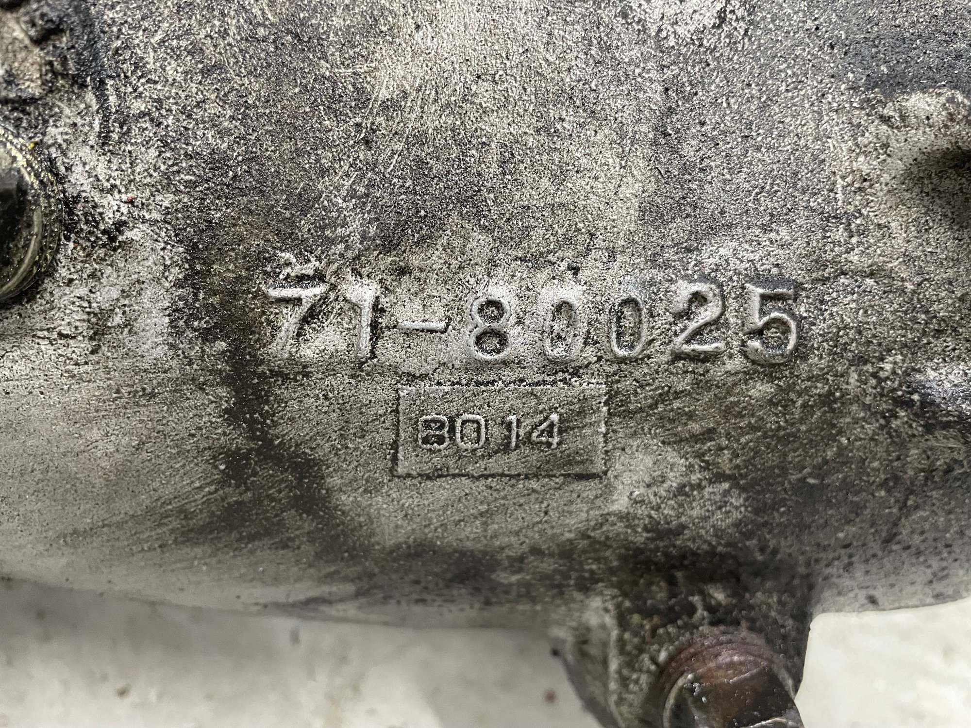

No 330550 is a cast crank
The LT-1 was an 1182 or a 3931182 etc.
check Jim's list
http://www.jimsperformance.com/cranks.html
But there is no significant difference in 350 forged cranks
$250 is a good deal, and already cut!
awesome reference. thank you!
I've got 6 or 8 cranks to I.D. from my fathers collection. Hoping one is an LT-1 so I can pair it with my N.O.S. pink rods in building a "hot" LT-1 when I restore my 70'

Looking good!
Nice job getting it up off the frame!

My frame measured 0.110" thick in many locations. You can use that as a check to see how much it has "thinned" due to the corrosion.
And these guys have the original GM frame molds, and can sell you any frame section you might need, up to a complete new frame.
http://www.vetteproducts.net/
How did you measure the thickness of your frame? Hopefully I don't have to order anymore metal, I got my frame ends today from Zip. I'll check out the link you sent!

How did you measure the thickness of your frame? Hopefully I don't have to order anymore metal...
Ya gotta Sawzall? That's the first thing you'll need! Take a piece out of the middle for your baseline.

I used both a digital caliper and a micrometer. Wherever I could get it to fit, holes, edges, etc.
The trick is rust has to be cleaned off your measuring spot, rust is way "thicker" than the original steel. Paint is OK tho, it's thin.

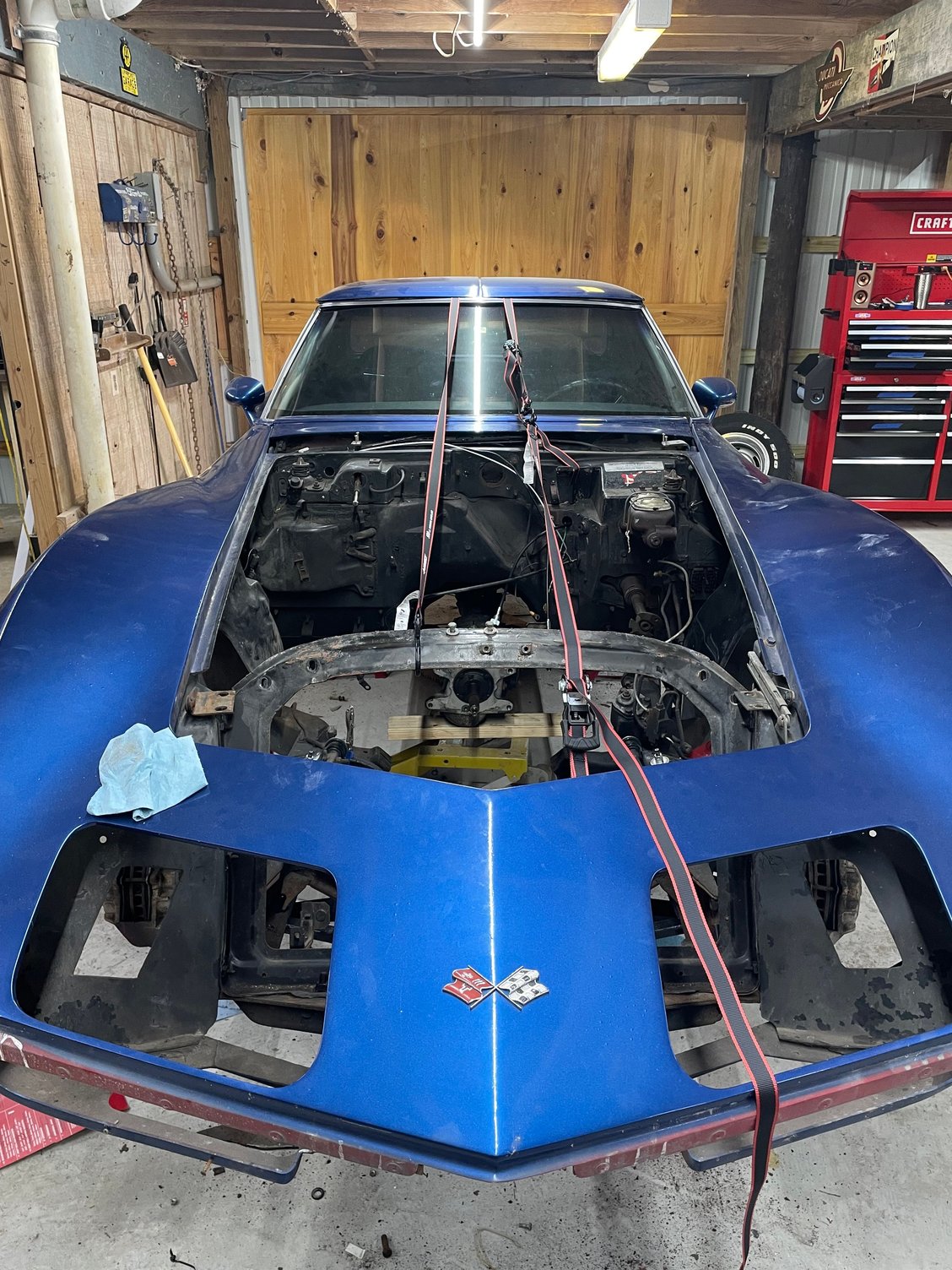

I like how you supported the nose
Out of interest, are you keeping the recessed headlights and fender flares?

Thanks! It's scary how flimsy the nose is once you unbolt it from the frame, and I wasn't comfortable with the flex so supported it like that.
I'm not a fan of the fixed headlights, and they'll never go back on! I do love the flares though. I'll eventually have some deep dish 18" wheels on it, one day....

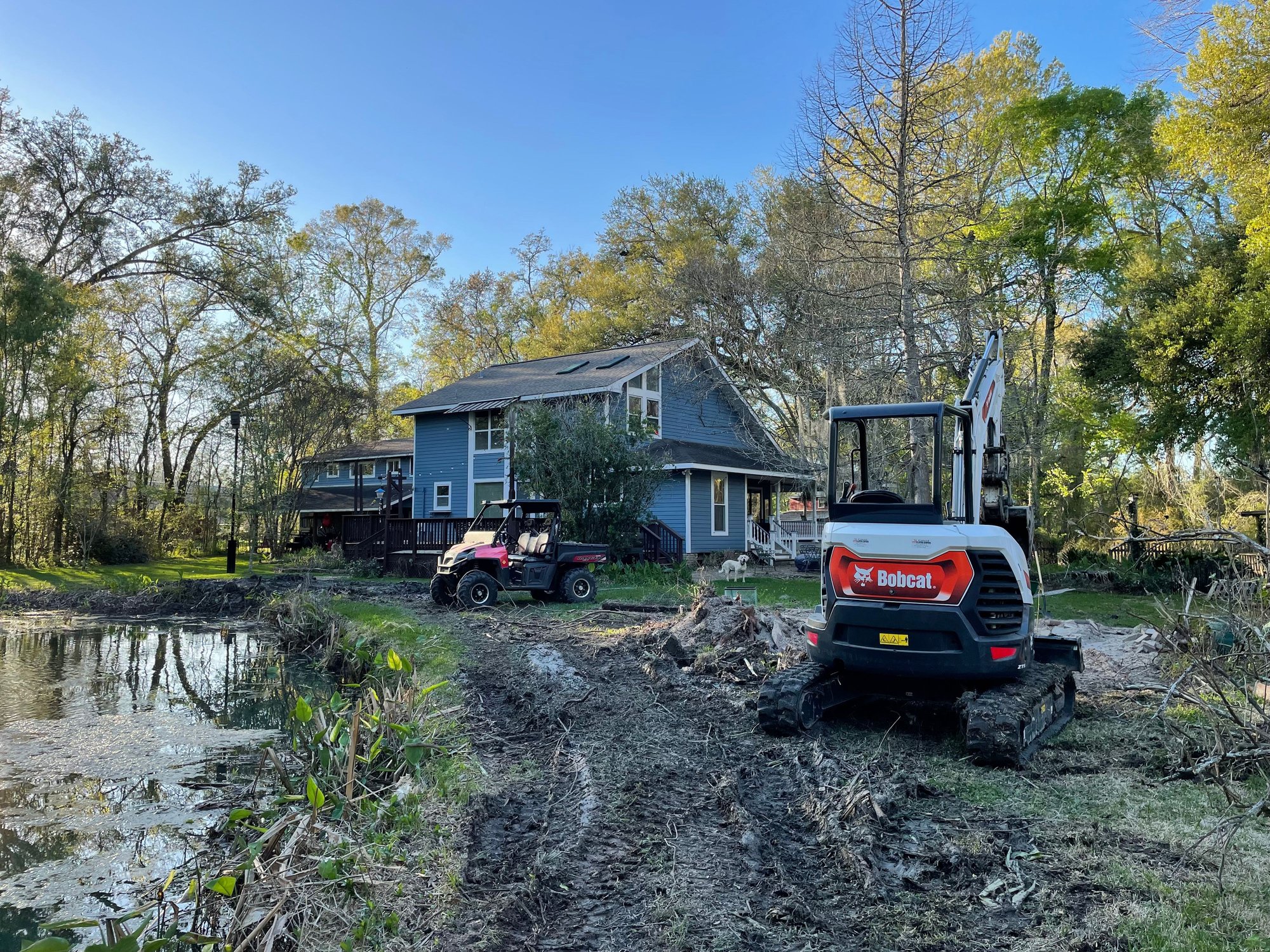

Had an excavator and a dumpster rented over the weekend, and worked my tail off on my property: landscaped and cleaned pond, moved landscaping, ripped out an old green house, and cleaned up my property. All I know is, I need an excavator now! lol

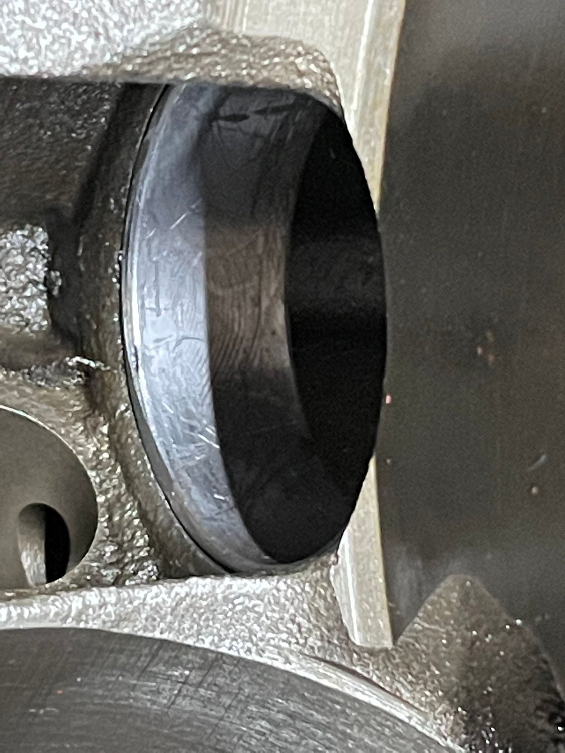

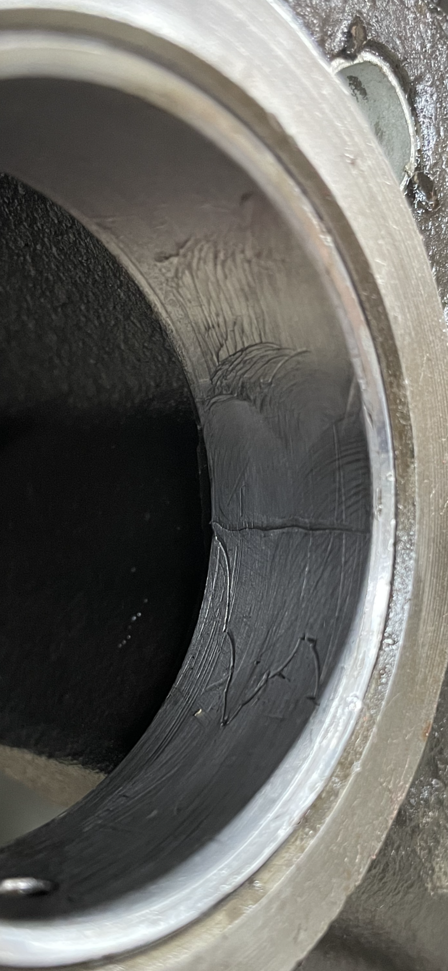

Had some time last night, and pulled my block out the bag to clean up and get ready for paint... I was shocked to find my "new" cam bearings installed by Ray Charles! I called the machine shop this morning and talked to the owner, he was surprised one of his guys sent it out like that but said he'd make it right and put new ones in himself. Annoying I have to bring it back, but at least he's standing behind his work.

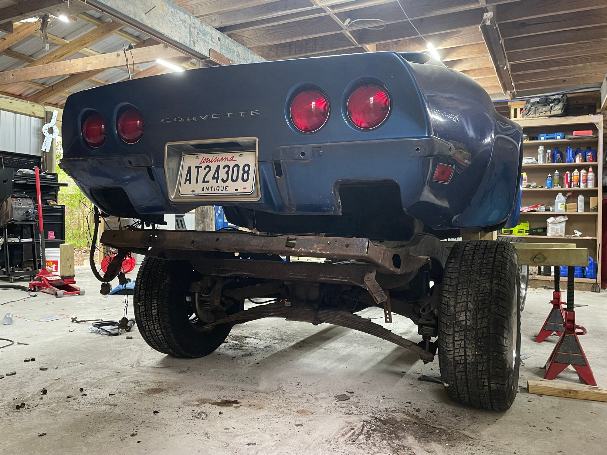

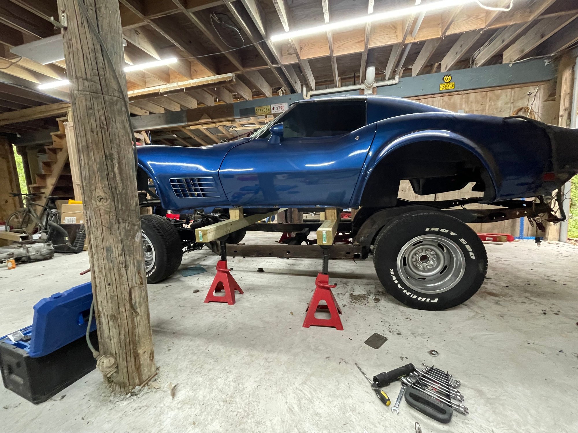

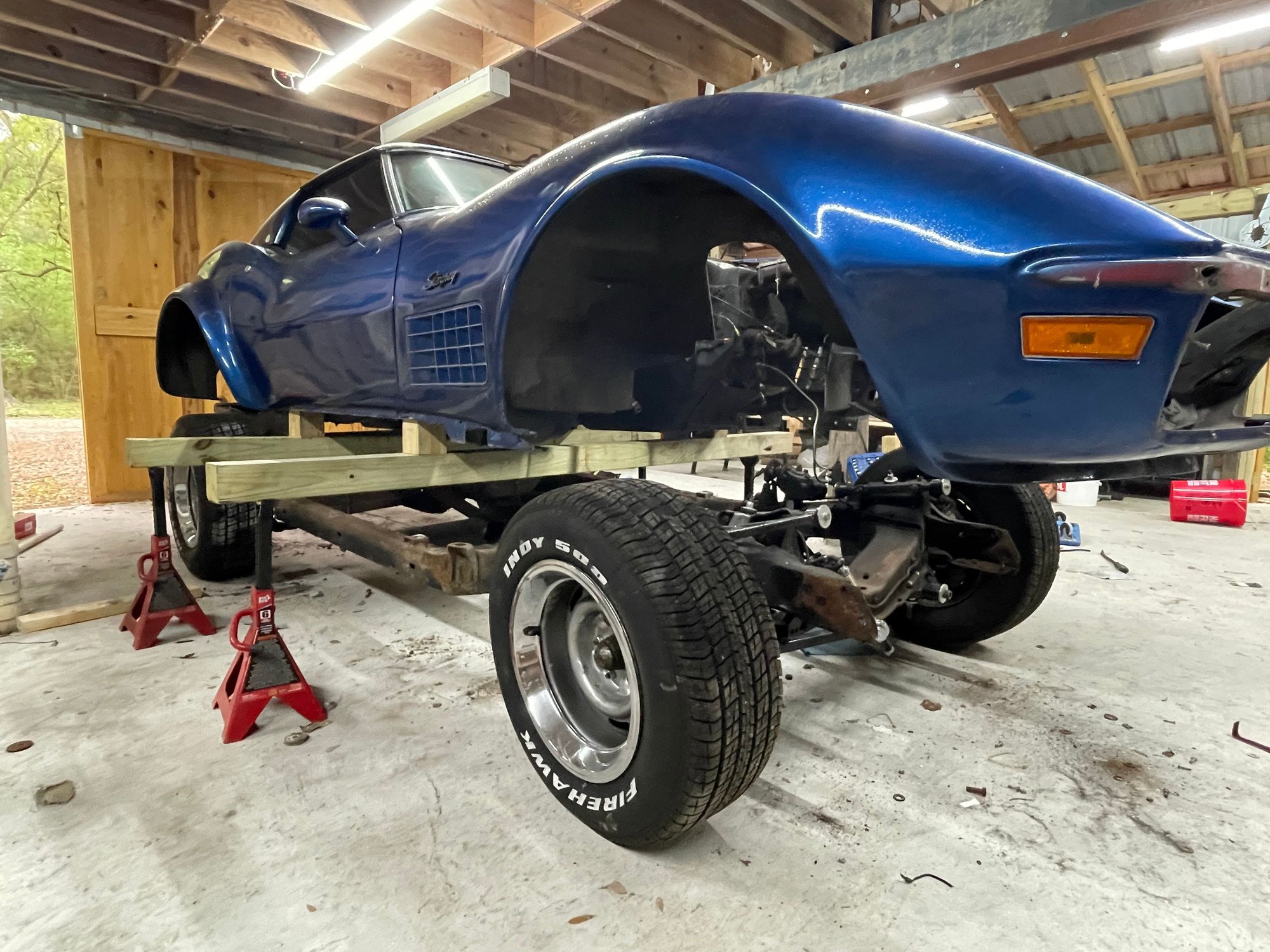

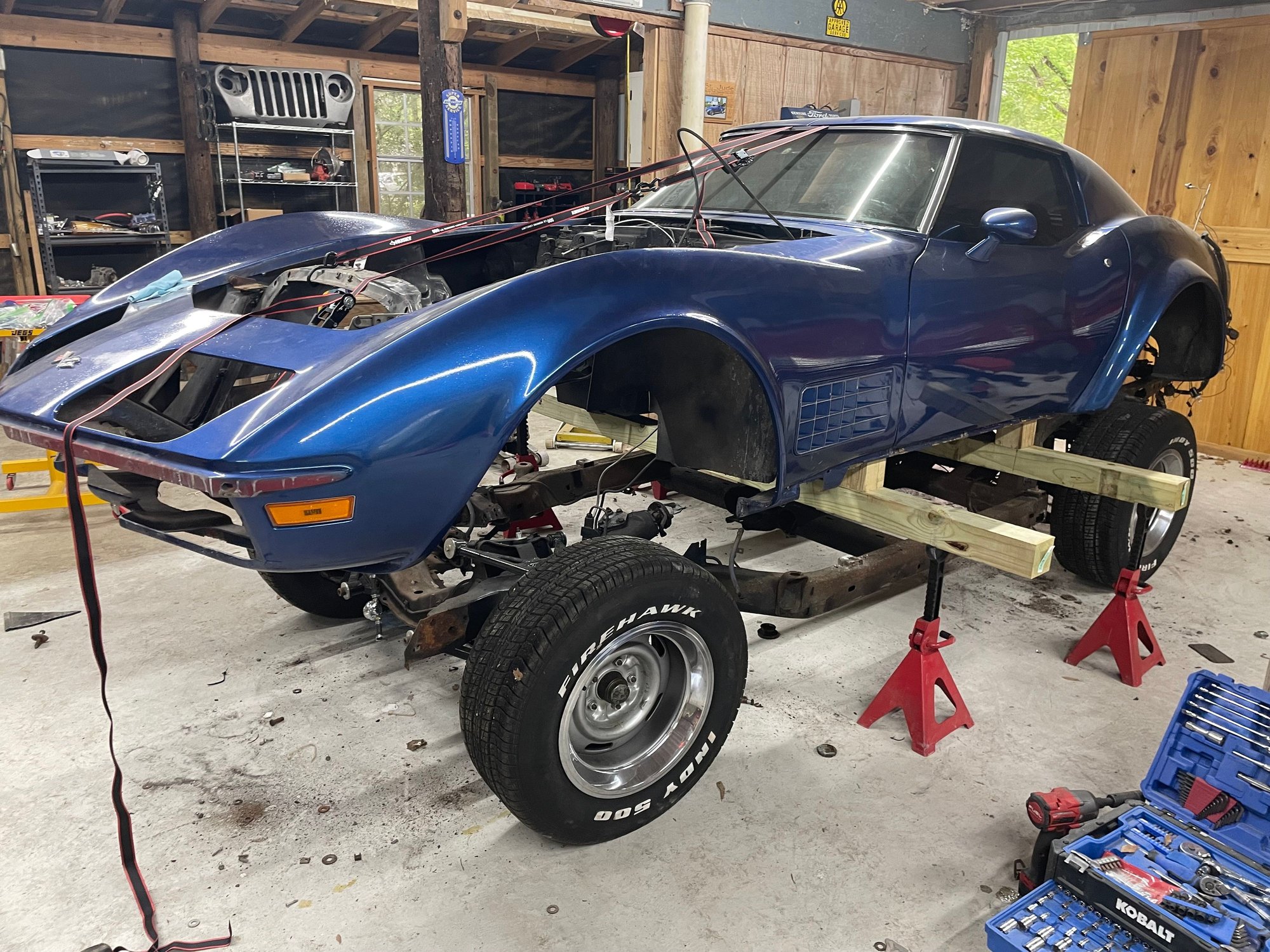

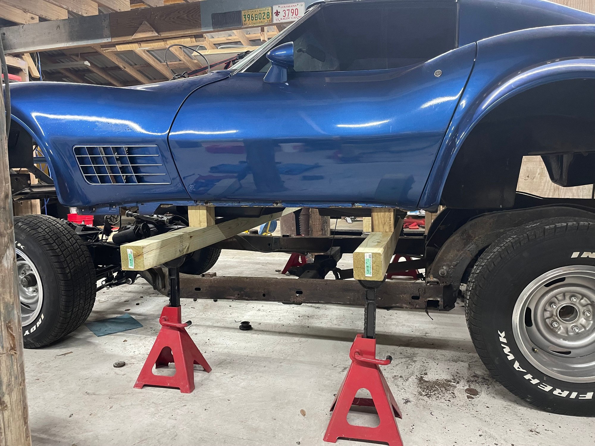

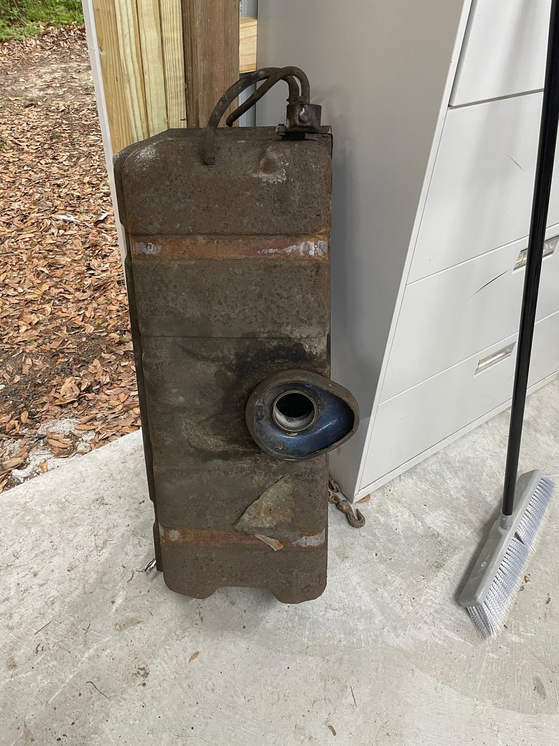

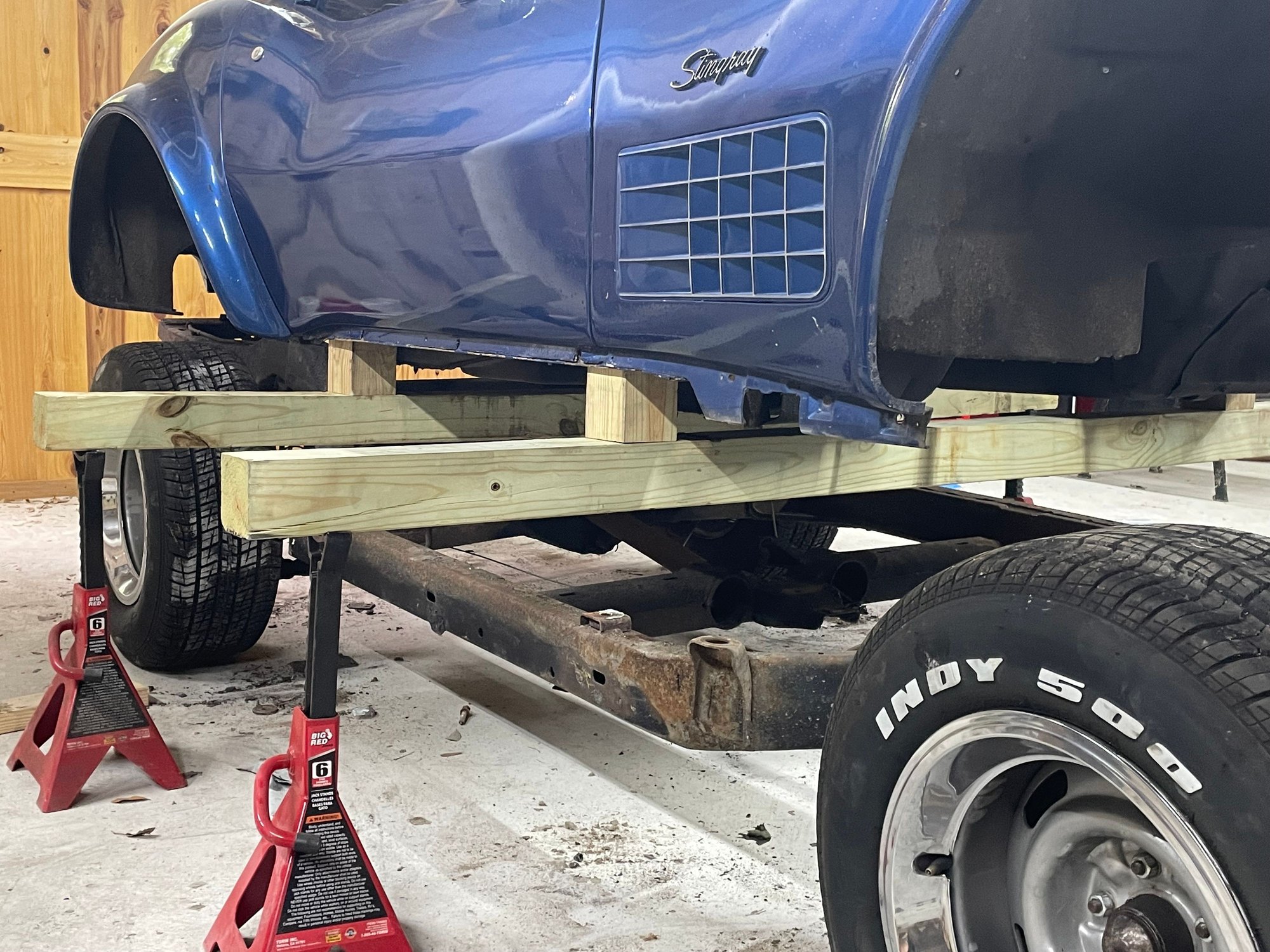

My objective this weekend was to get the fuel tank & transmission removed, then build a body jig that would allow me to safely toll the chassis
I started with the fuel tank, I wanted to get it pulled in order to give me clearance to roll the chassis out without having to have the body too high. I've suspected there was a leak in my gas tank, because whenever I'd fill it up, my garage would smell like gas, despite there never being a visible leak. Well as soon as I loosened up the straps, it started leaking away! (And yes I did drain all the fuel out that would come out!) Once pull I discovered a nice hole in he bottom.. New fuel tank added to the parts list!
I was hoping I'd be able to have a little bit of the build sheet legible: NO DICE

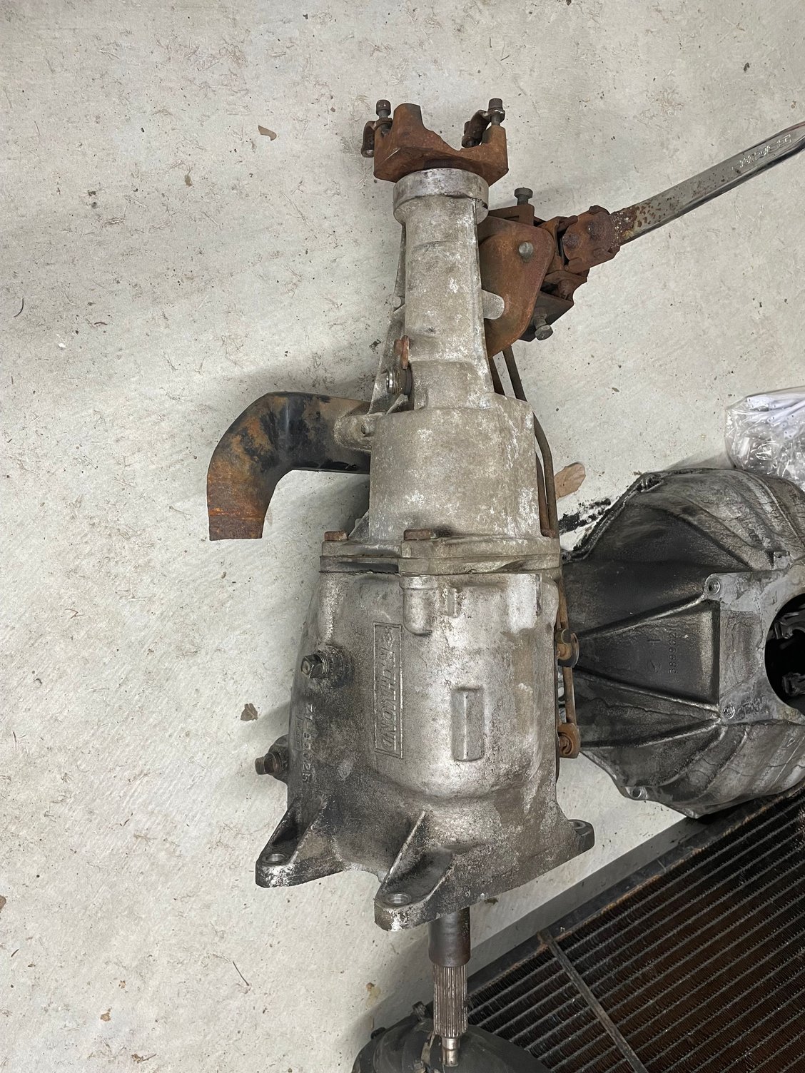

Went ahead and dropped the trans, since it was going to be too difficult to support it when I move the chassis around. Took two bolts, and was quick and easy to drop it out!
Those with a keen eye are probably wondering WTF is there an aftermarket Richmond Super T-10 in an LT-1?! Wish I knew...
Now everything was out the way, I could start slowly working the body up on a jig made with wooden 4x4's supported my jack stands:

Love seeing your progress and all the methods you use! Thanks for posting your pics!

Nice work of lifting the body.
