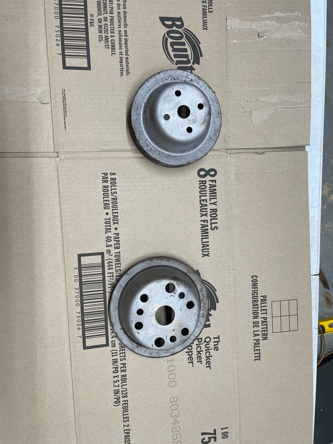

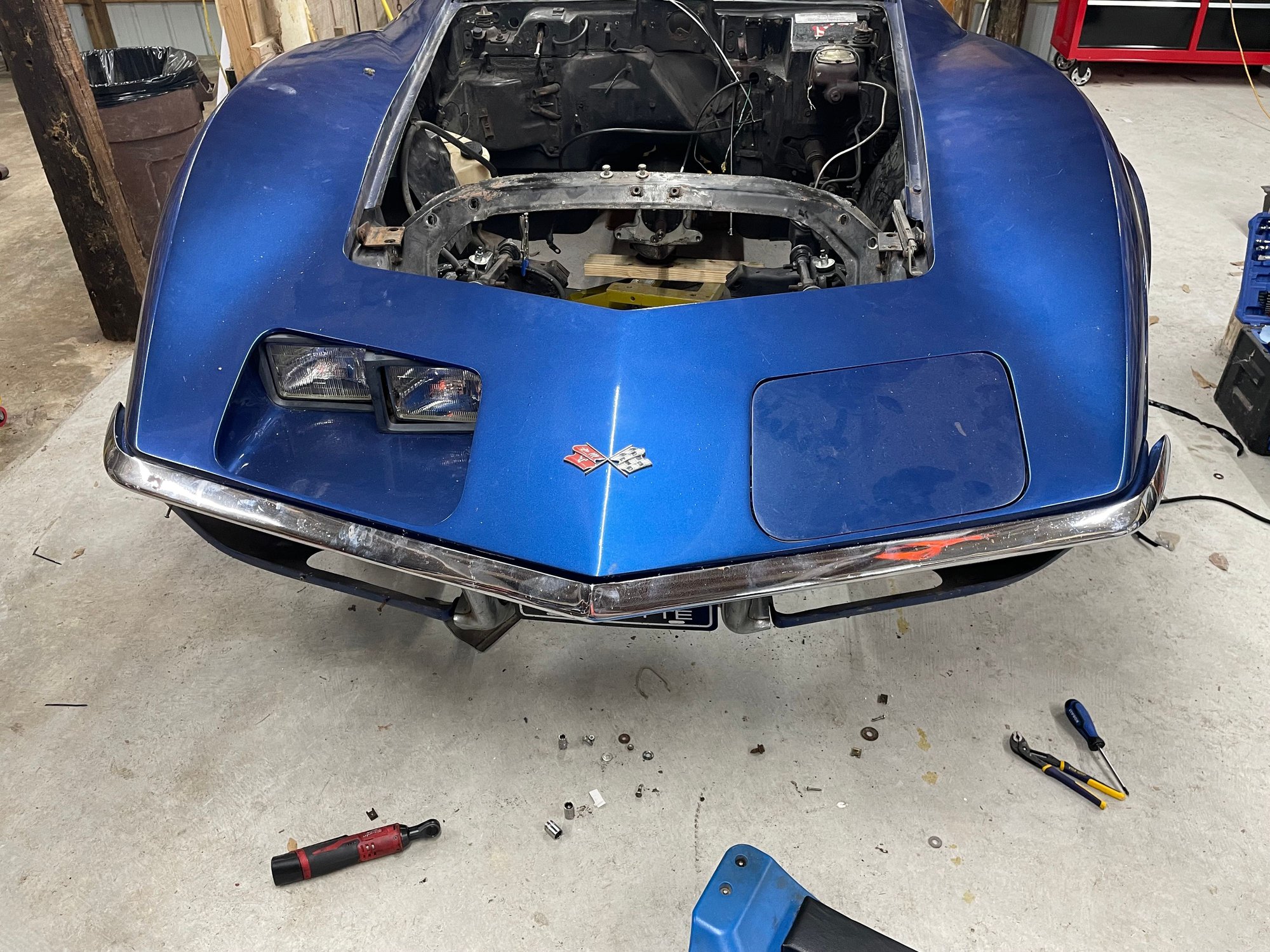

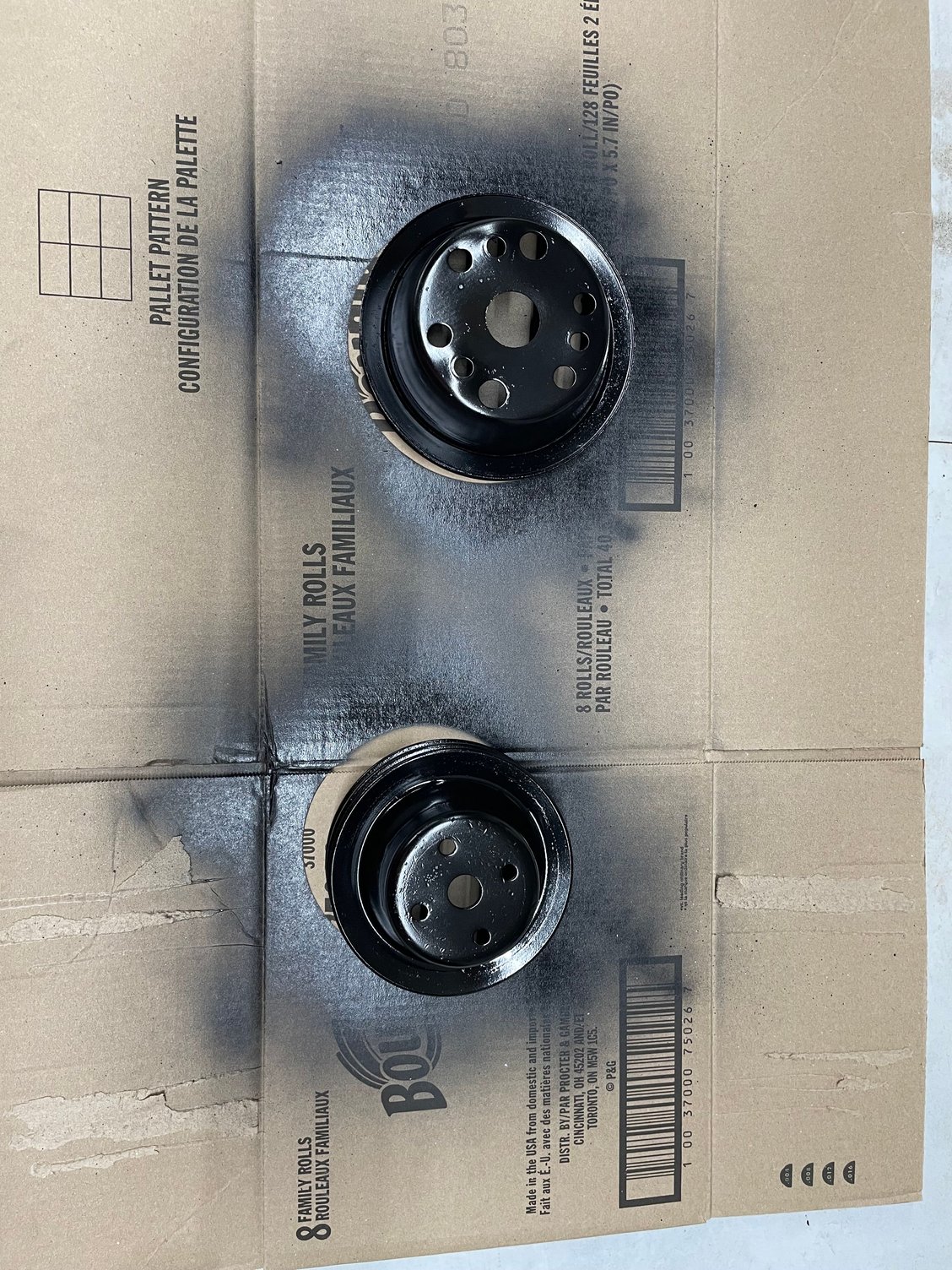

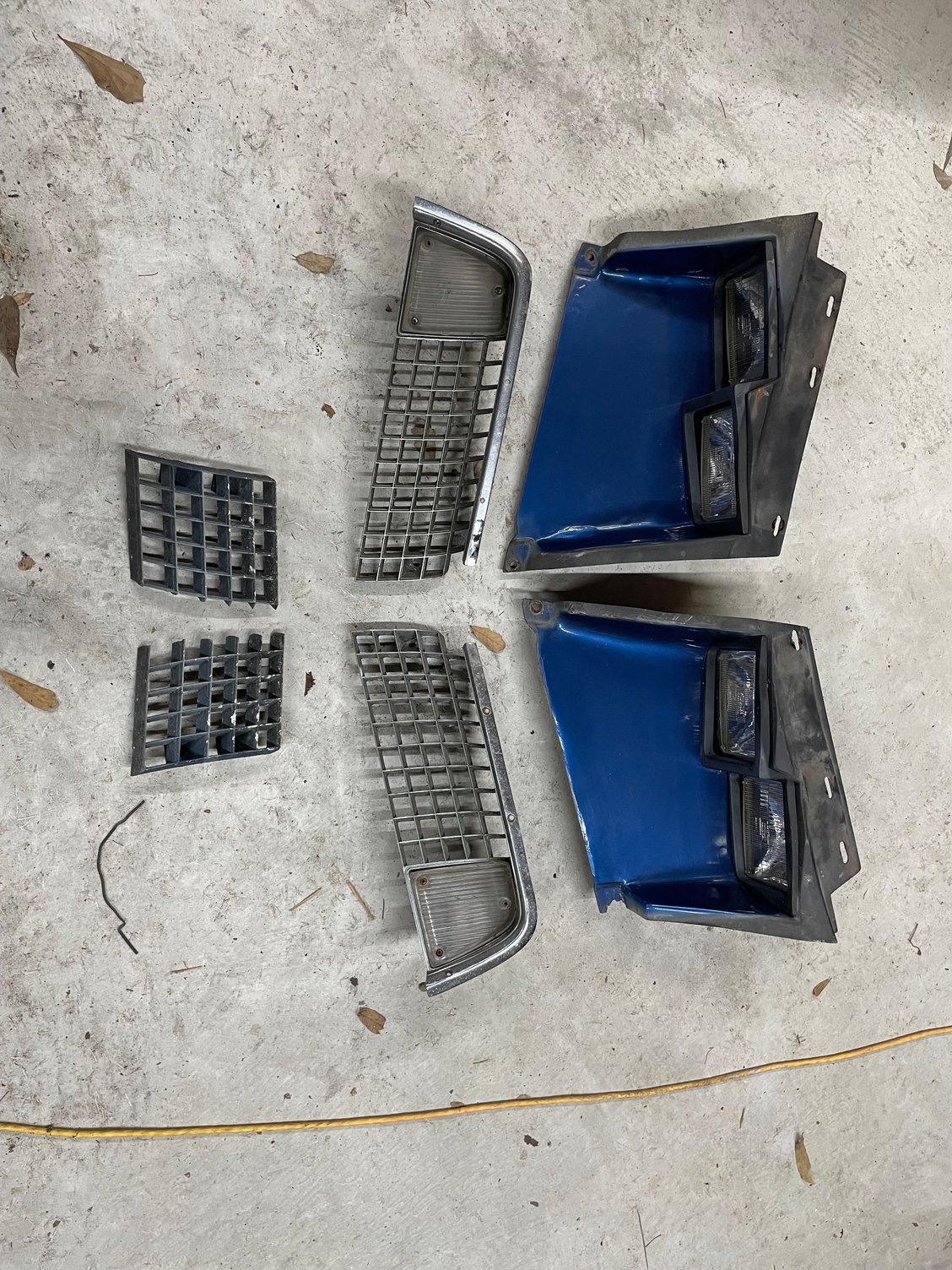

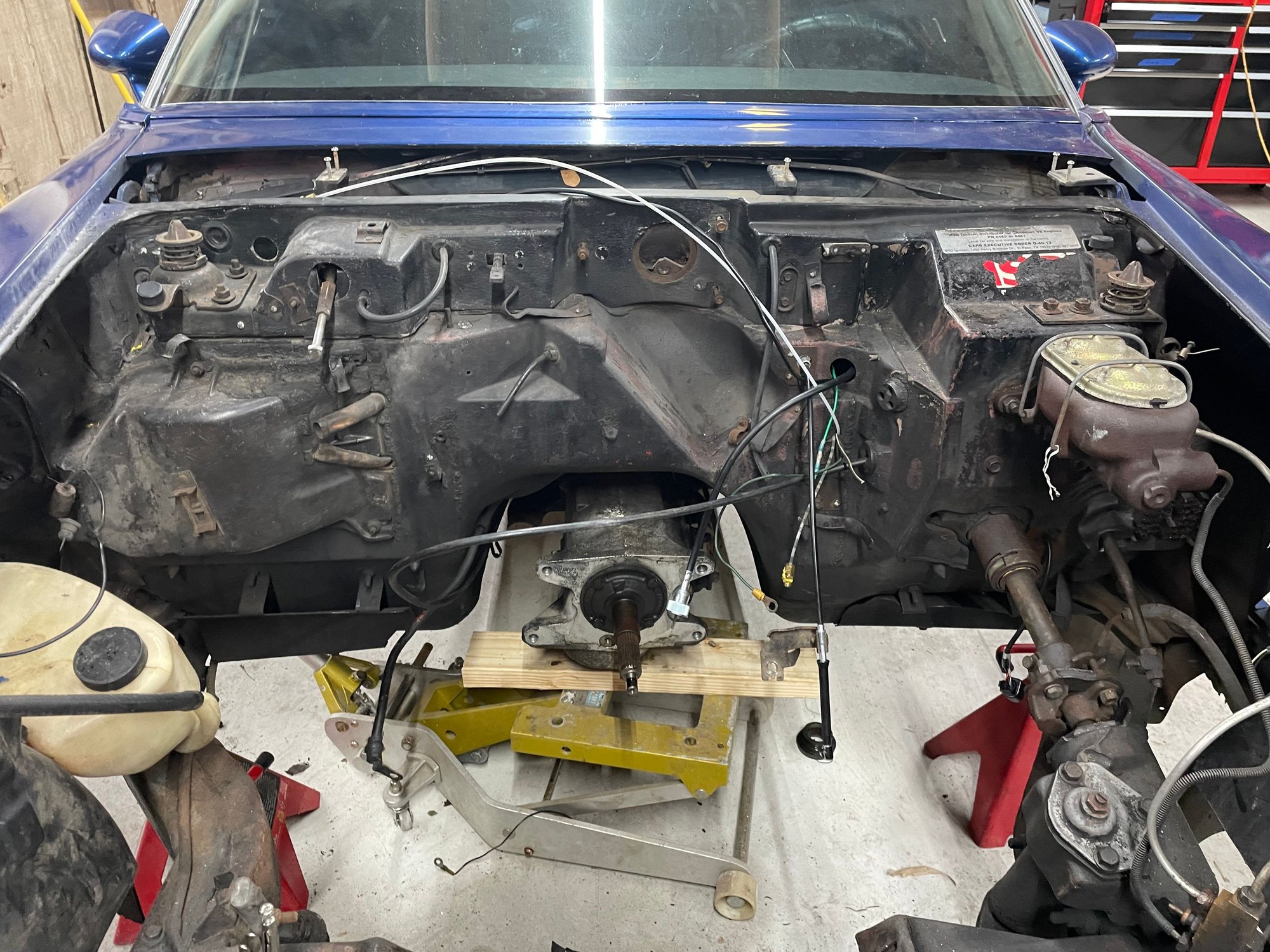

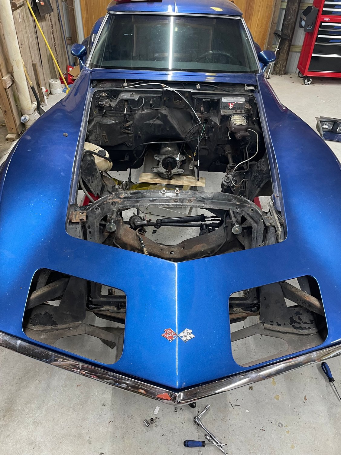

Engine is at the machine shop, and I was able to do some wrenching tonight. Of course I had to play with my new blast cabinet (now my new favorite toy!) . Blasted off some brackets and pulleys for my engine, and started to lay down some satin black paint
Then it was back off to stripping down the engine bay for paint, and the front end so I could get the body lifted for the frame repair. Started by removing the windshield wiper motor and the engine wiring harness:
Next I had to FINALLY remove those fugly fixed headlights, they'll never go back on this car! Chrome grills are in okay shape - one can probably be saved the other has chrome peeling.
I had to see what those OEM headlights were going to look like! Paint is a shade of blue off, but close enough until she's painted!

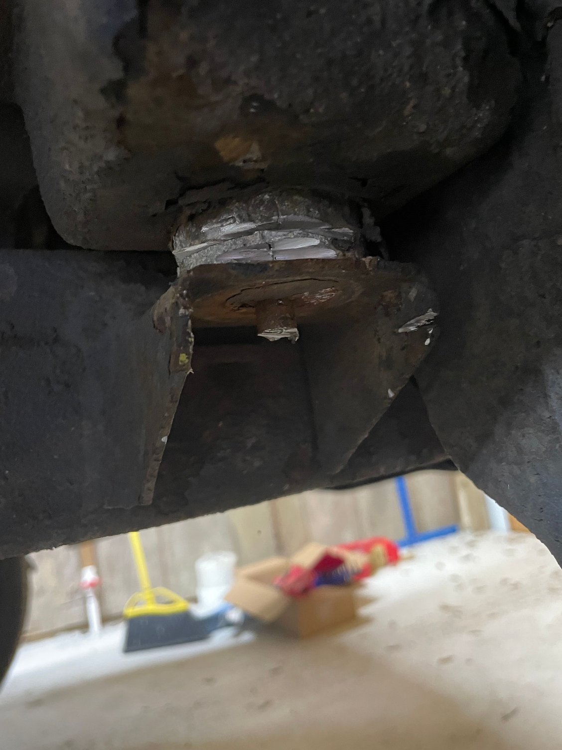

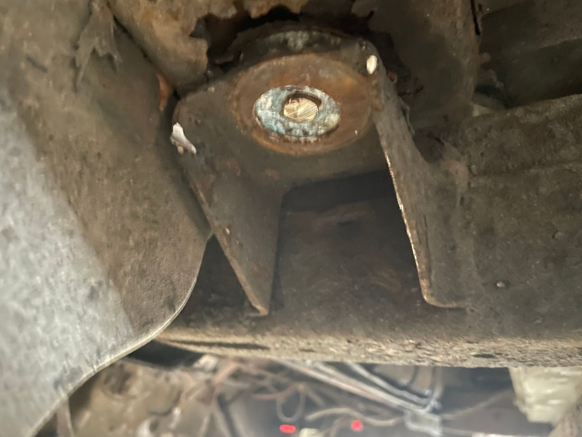

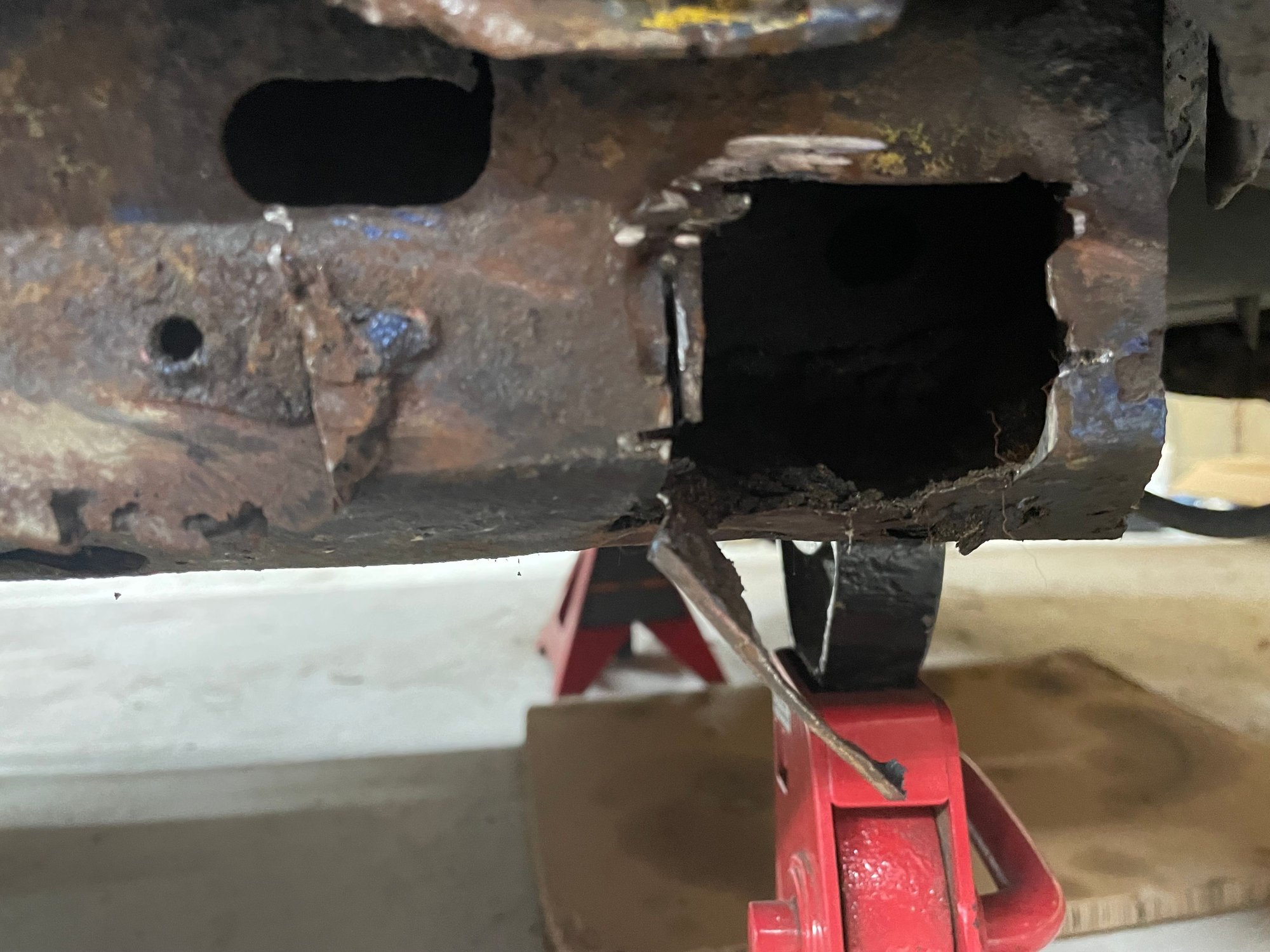

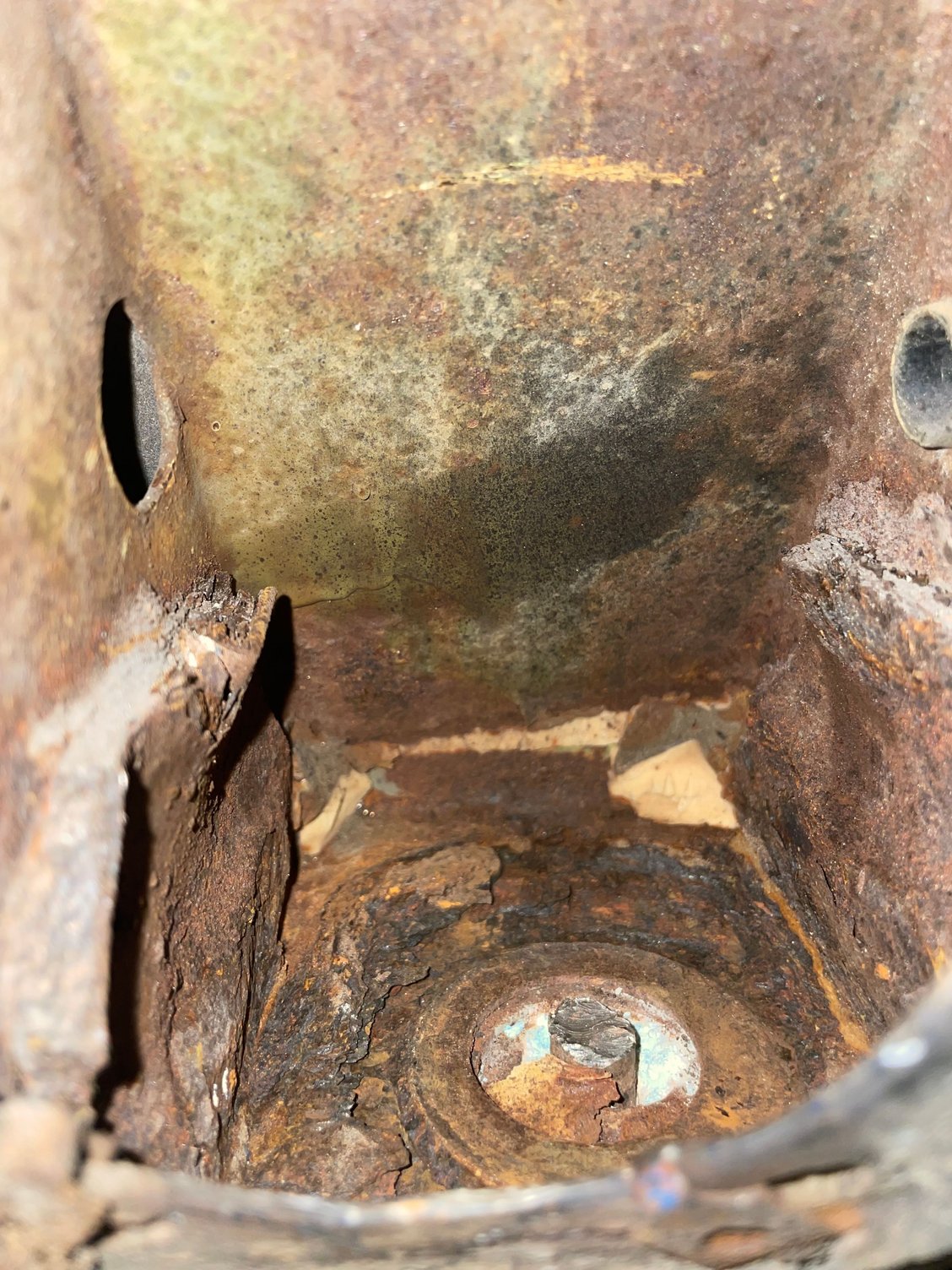

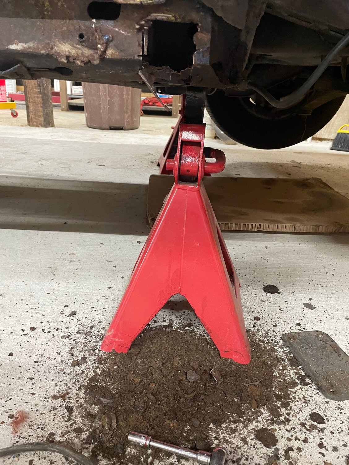

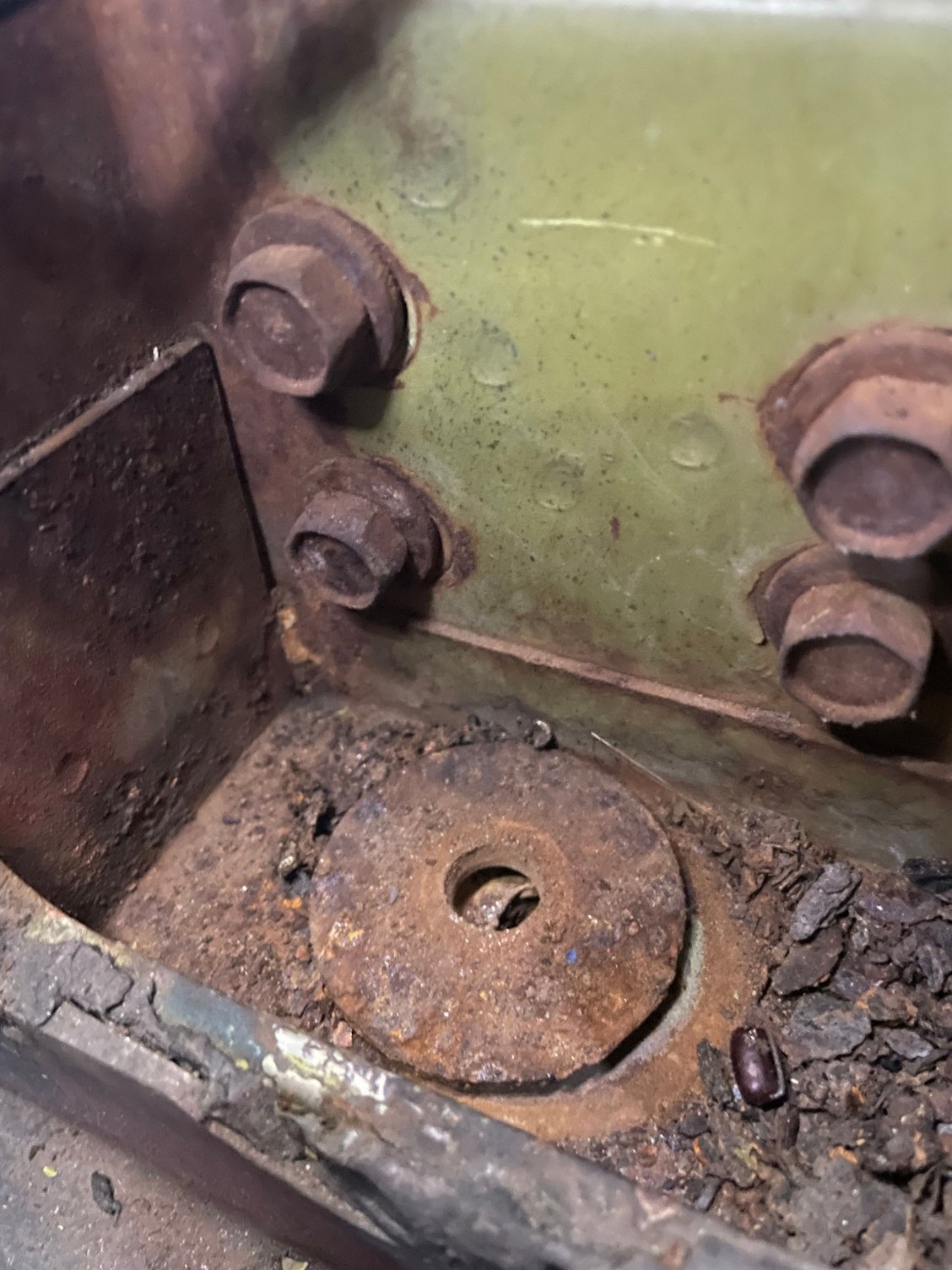

Today I started tackling the body mount bolts, and made some good progress after soaking them in Kroil all week:
The #1 mounts on each side came off easily, as they should.
#4 Mount on drivers side wouldn't budge, but was able to make quick work with a cut off wheel

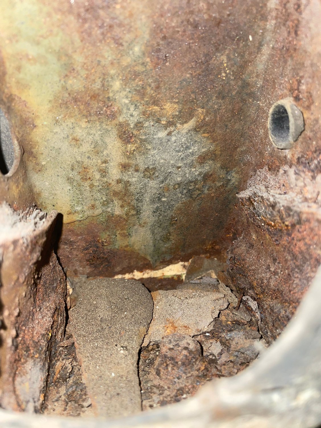

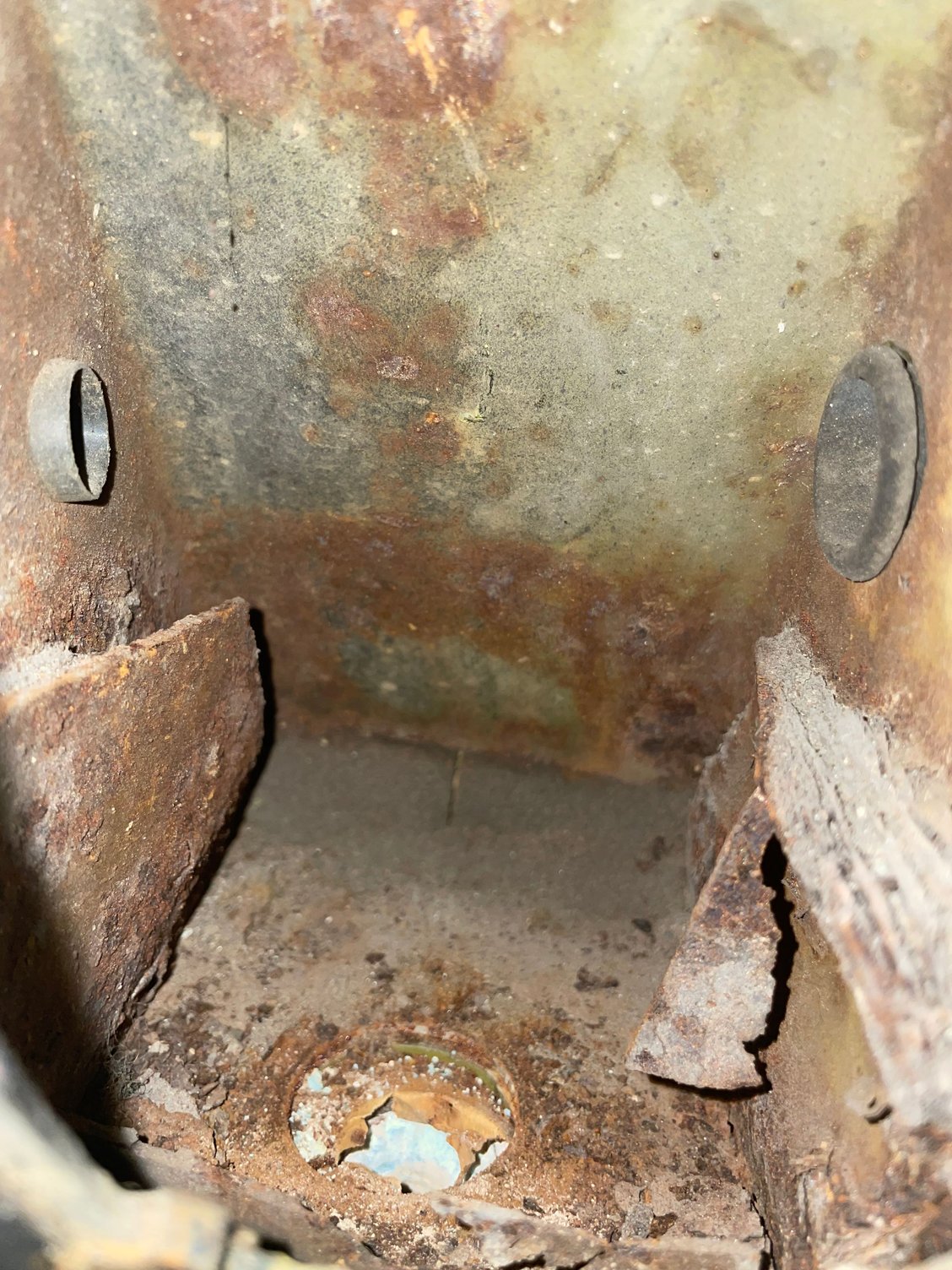

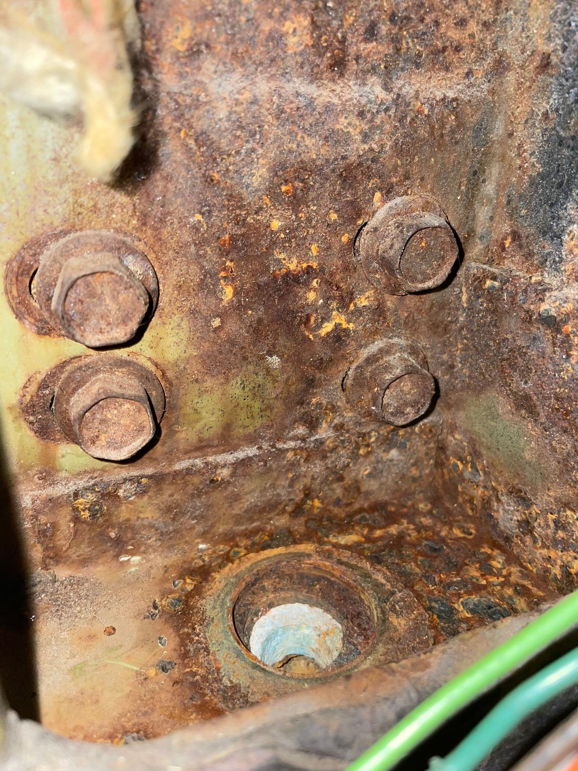

I then pulled off the access covers for the #3 mounts.. bolt look pretty awful! I think a carbide bit is going to be the best bet here
I cut out some of the rust on the frame rail under the #3 mount, and to get a better assessment of the damage: not that bad, and easily fixable
A whole lot a crud from 50 years of driving came out
It's warmed up here in South Louisiana , and thought brought out a welcome visitor in my barn today: Rat Snake! Hope he's good at hunting! This big ole guy was creeping through my rafters all afternoon as I was wrenching

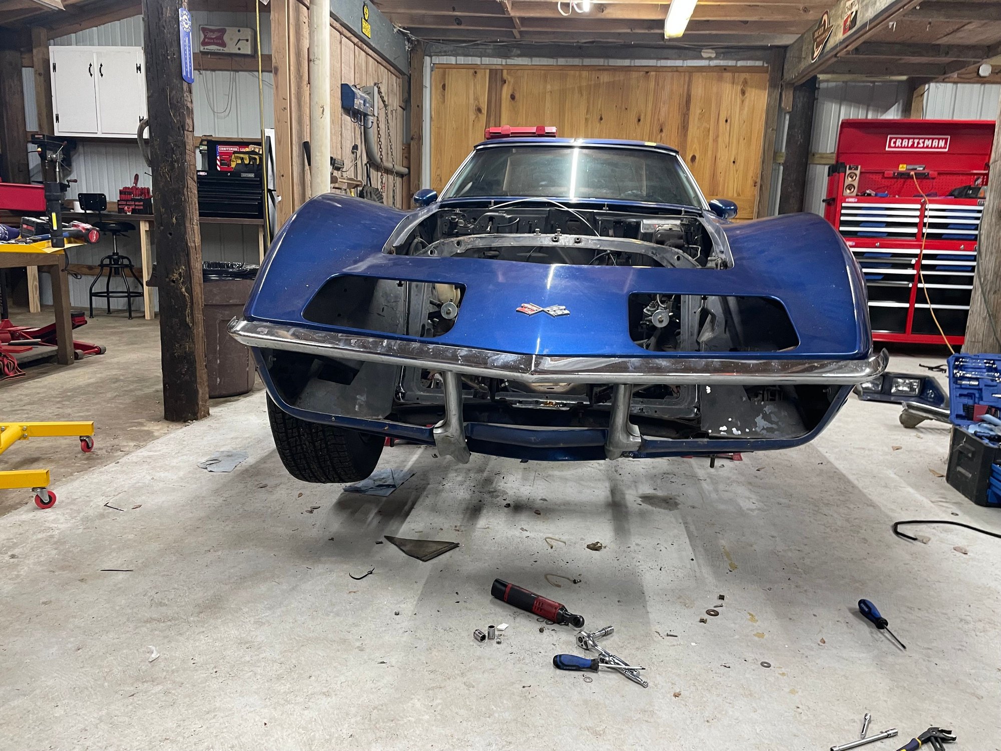

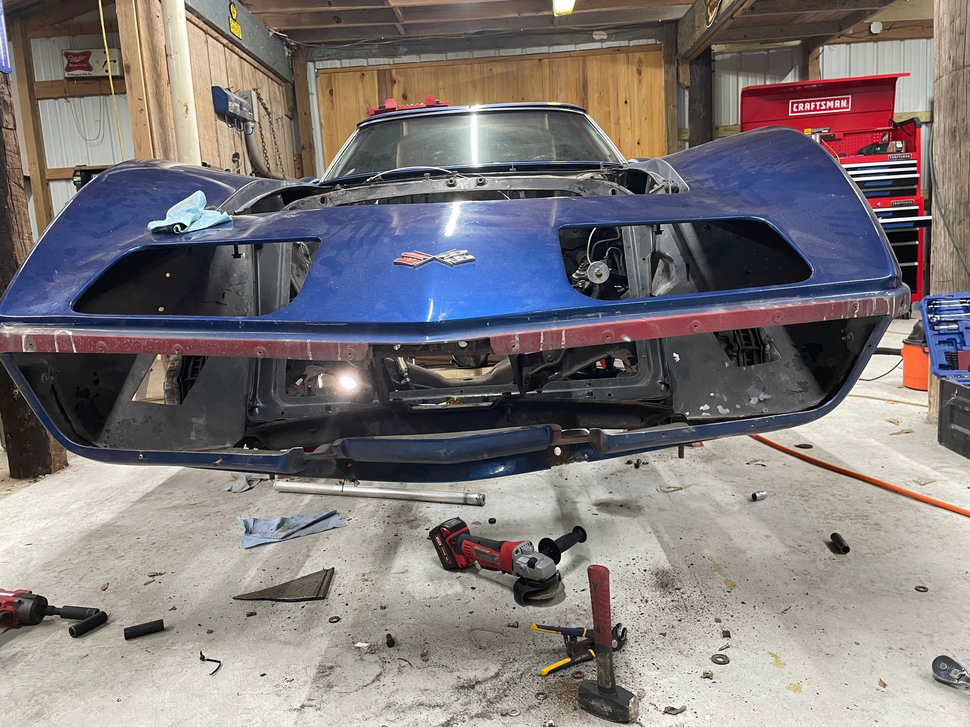

I went a grabbed an extended die grinder from Harbor Freight at lunch today, and a quality carbide bit from my hardware store to grind the top of the bolt off on the DS #3. As soon as I got off work I tackled it, and got it done quickly with that nice bit!
Next it was time to finish the driver's side and tackle #2. I tapped on it really good with a hammer to agitate it , which worked and I was able to crack the bolt with a breaker bar. I then was able to remove it with a ratchet: success!
I used the same method on the PS #2, and it came right out with a little finesse!
By some miracle I was able to get the PS #3 out with a socket!!! I agitated it with a hammer, then cracked it loose with a breaker bar, and she came home with my ratchet.
Now it's time for the PS #4: the cage on this one is badly rusted and has to be replaced. It just spun with my torque wrench, so I just cut it right off with a 3" cut off wheel.

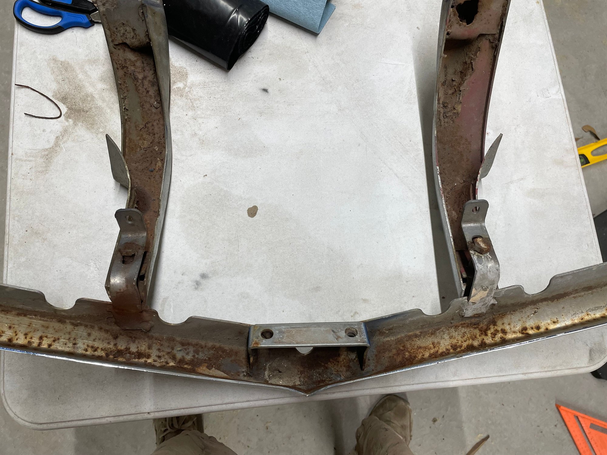

All those pesky body mount bolts are removed! Now I have to finish getting the front bumper and brackets off. This is where I really started cursing bubba: He had [half} the bolts half in and welded tacks on the bolts to the brackets.. then tacked the brackets to the frame!! So he couldn't figure out how to align the bumper and just tacked it in!!!! I went to work with my new Milwaukee grinder and was able to break it all loose. At least the bolts on the frame support easily came off with some Kroil and my torque wrench!!
You can see red paint behind the bumper.. so did they weld it and then paint the car?! so many questions of the shady past of this poor car LOL
