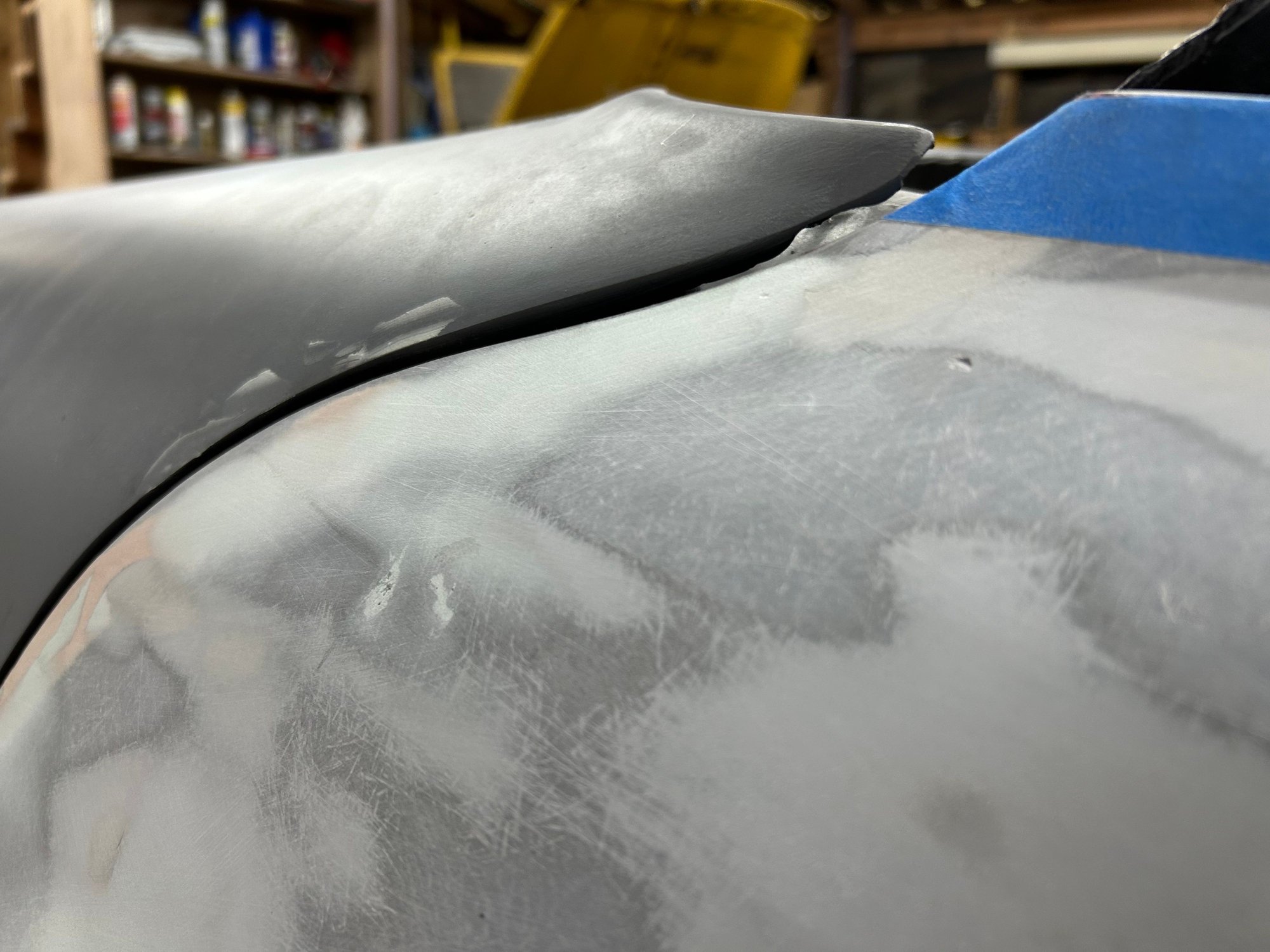

I remember someone else posting about that area. The feedback was that in that area they were never really gapped well, even from the factory. If I ever do a repaint on mine my ocd will have me looking at it as you are, and would probably want to better fill that gap as well.
I've read that too, but it still bothers me lol I'm going to have to figure out a way to signifigantly improve that area.

I can’t remember if you rebuilt or replaced your door hinges.
It seems that if the door is even slightly sagging it would open the gap at the top!
It could also be caused by the door latch pin and latch mechanism not being correctly aligned.
If I remember correctly, there was a discussion that over time the front clip could have dropped slightly at the nose which would cause the larger gap at the top of the doors.
NCRS Judging Manuals have a ton of information about weird little things like this, especially how they came from the factory, how they expect things to look over time and the causes.
My door hinges don't seem like they have play, but at this point I should go ahead and put new bushings in!

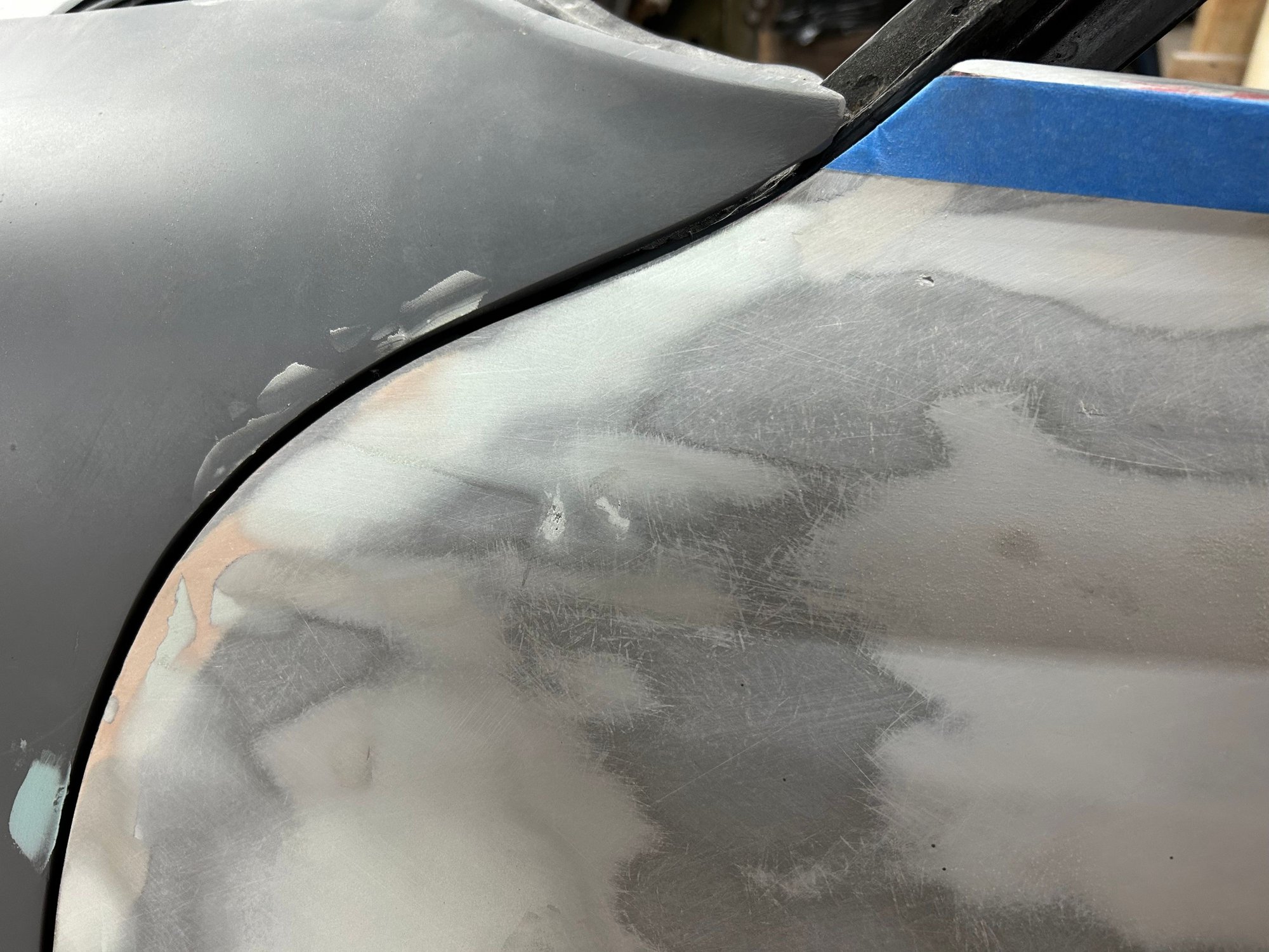

Did some research and talked to some people today and got some good advice on the fender to door gaps:
  • Car needs to be sitting on the tires before analyzing so the front itsn't drooping
  • Front clip needs to be shimmed up
  • fender corner obviously isn't glued to the body anymore after my work, can heat up and bend down then bond back on
  • can build up door with glass/filler to improve
None of these things will make huge moves but all combined will definitley make improvements! I'm going to get it on all 4 wheels and start playing with the above tips to improve it.

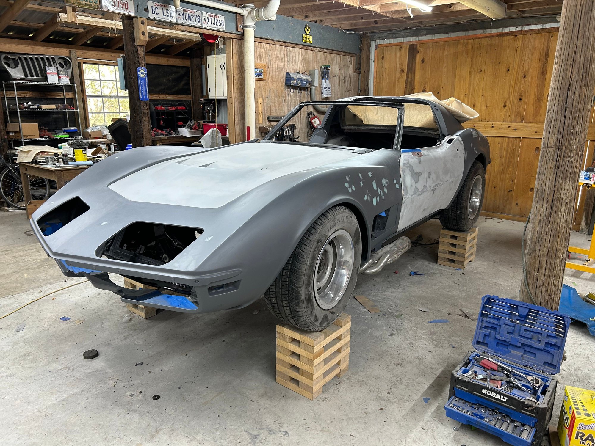

Started working on that door alignment today by getting the car bar on it's wheels to get the sag out the front end and see if it made the gap better:
The gap did indeed improve! But I still had a long ways to go before I'd paint the car!

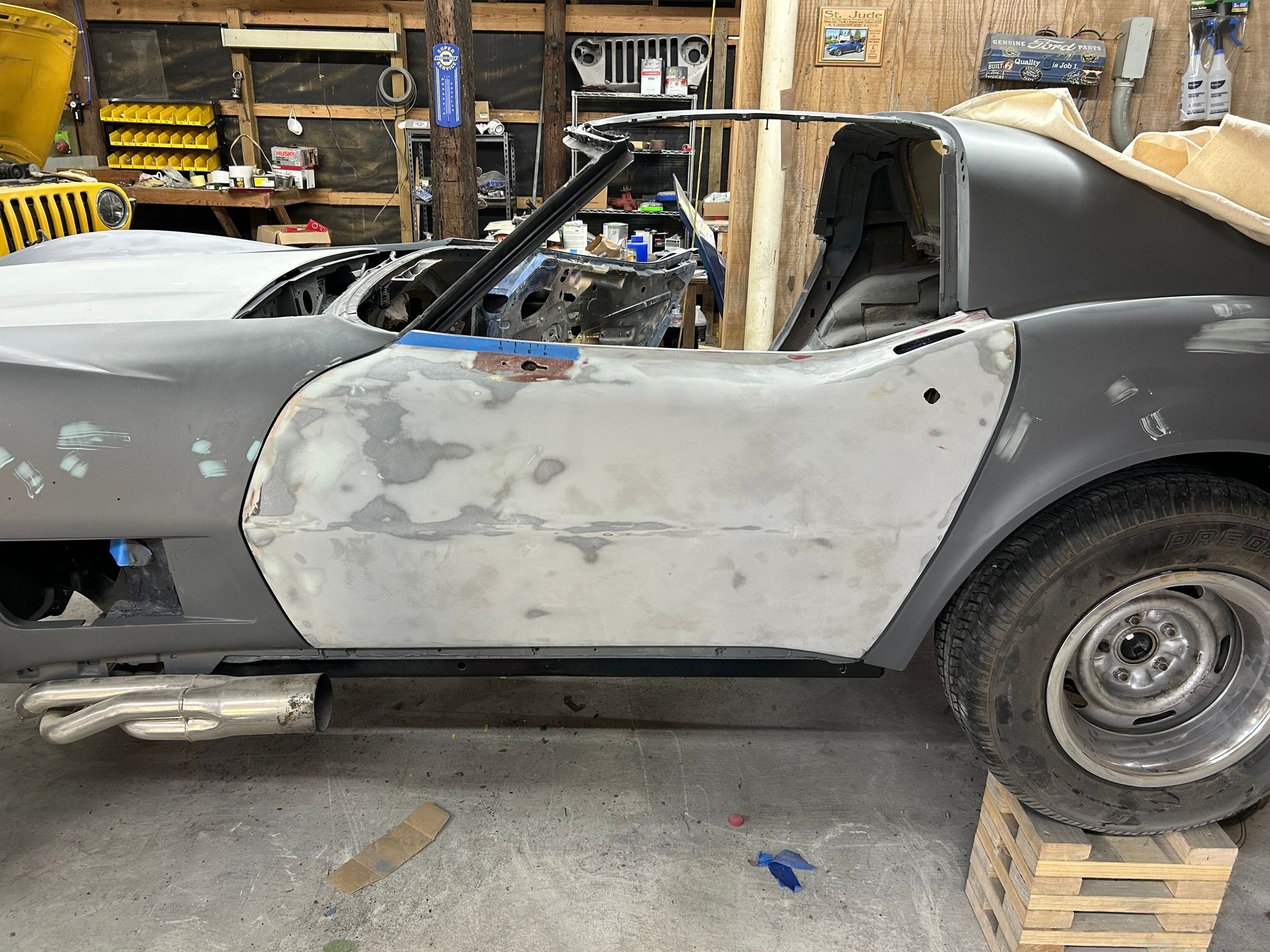

Next I wanted to see what I could improve with door hinge adjustment. I loosened the hingle to birdcage bolts while the door was shut and I had a jack supporting the door from the bottom. I then raised and adjusted the door until I found a HUGE improvement in my gap and the best alignment:
Pretty huge improvement from where I started now! Only a little filler on the door now will get it perfect!
