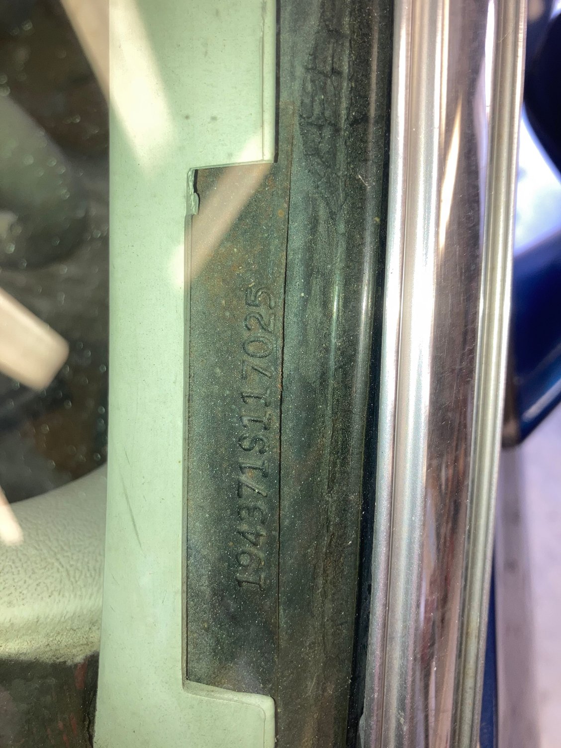

Thanks, I didn't think I could get a chrome bumper that wasn't a wreck for this cheap either. When I saw the ad for this car, I called and got the vin and block numbers: Confirmed it was an LT-1 and went straight to the bank and picked up my trailer!
VIN and Block numbers below, to my knowledge everything is correct, hopefully you experts don't see any red flags:

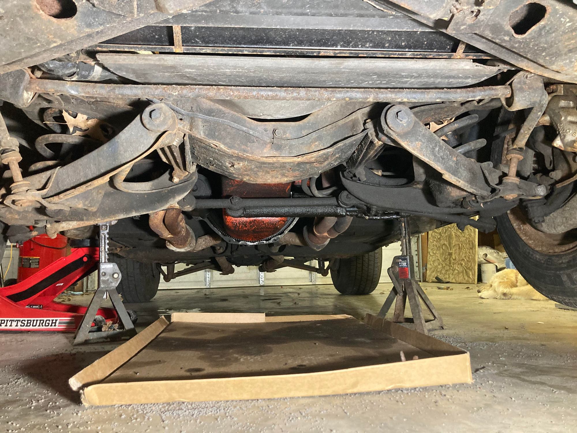

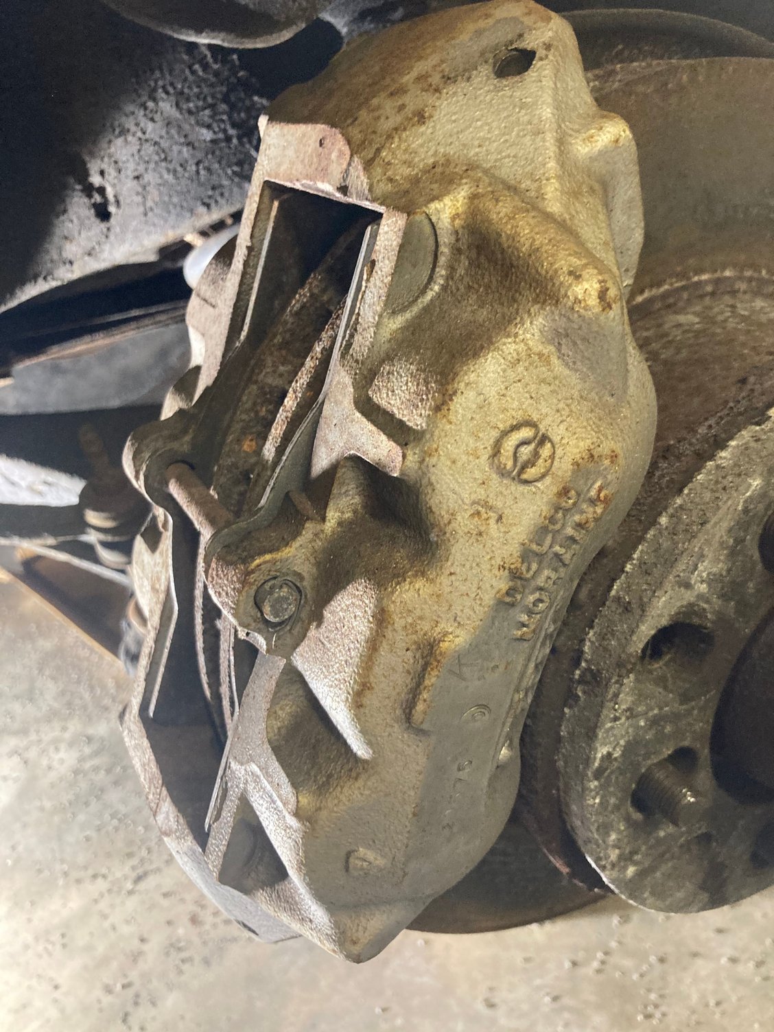

I put the car on Jack Stands tonight and pulled the wheels off to start doing inspections of the mechanicals. To my pleasant surprise, the PO completely overhauled the brakes before the car was parked! (including the rubber lines) no leaks and they work great, hopefully they stay that way! Then when I got to the back: Has freshly rebuilt trailing arms, with fresh black powder coating!!!! Car just keeps getting better!!!
No rust on the frame, body mounts, bird cage, floors, etc: car is solid!
Control arms look original, but ball joints have been changed at some point, because they're bolted in. Control arms will be easy to overhaul when I need to!
Has power assist steering and the ram is leaking fluid, will have to overhaul this.
