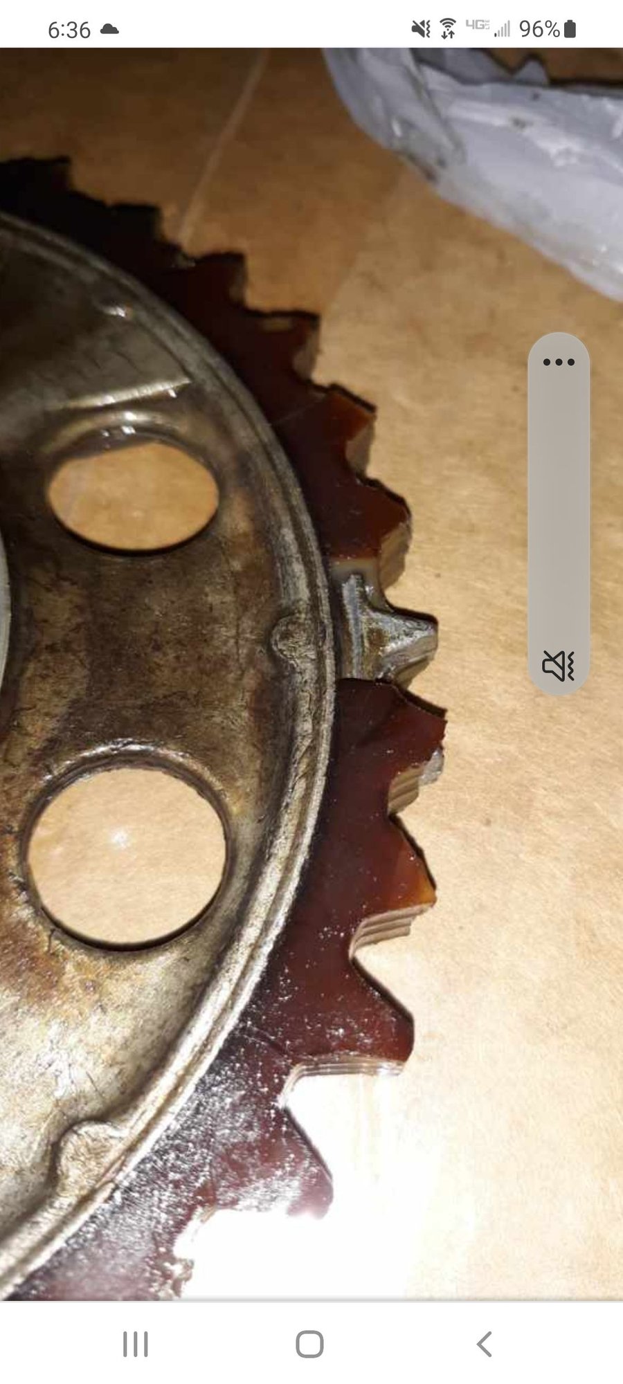

Do you know if the timing chain and gear have been replaced?
The original is nylon and the one in my 71 LT1 with 45k miles had 3-4 teeth which were nearly chewed off when I replaced it last august.

Wow they used nylon timing gears on a SBC?! That's ridiculous! I think the engine may have been rebuilt - or at least a cam put in it. Pulled the valve covers off and it looks mint, and has roller rockers. Sounds like there's a little cam as well - so I'm assuming the timing set was replaced. Going to have to double check and make sure now!

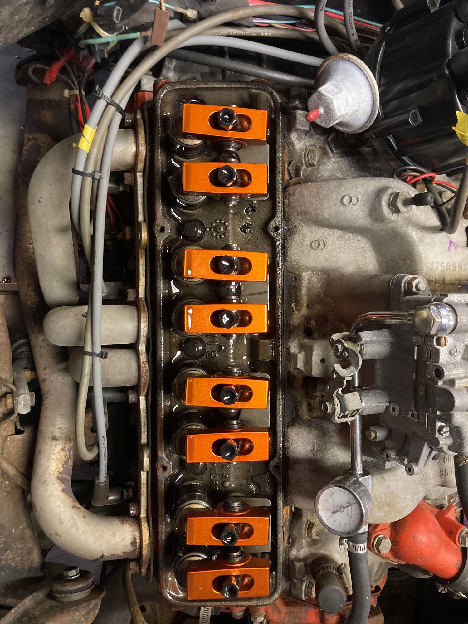

I got the car dialed in nicely, and running great! Finally got to drive her around the neighborhood, and the car certainly has some power! With the 4.11 gears and 4 speed, it gets through those gear quickly, no way this car will ever see the interstate lol But it's a lot of fun to drive, going to be a great weekend cruiser!
When I pulled the valve covers I found nice Harland Sharp Roller rockers under them! Someone did some work to this car, I think there may be a small cam in it. Here's a video of her idling, what do y'all think?

Here's a peak at the roller rockers on the heads.

Well more like plastic coated gears.
I'm guessing to cut down on noise.
