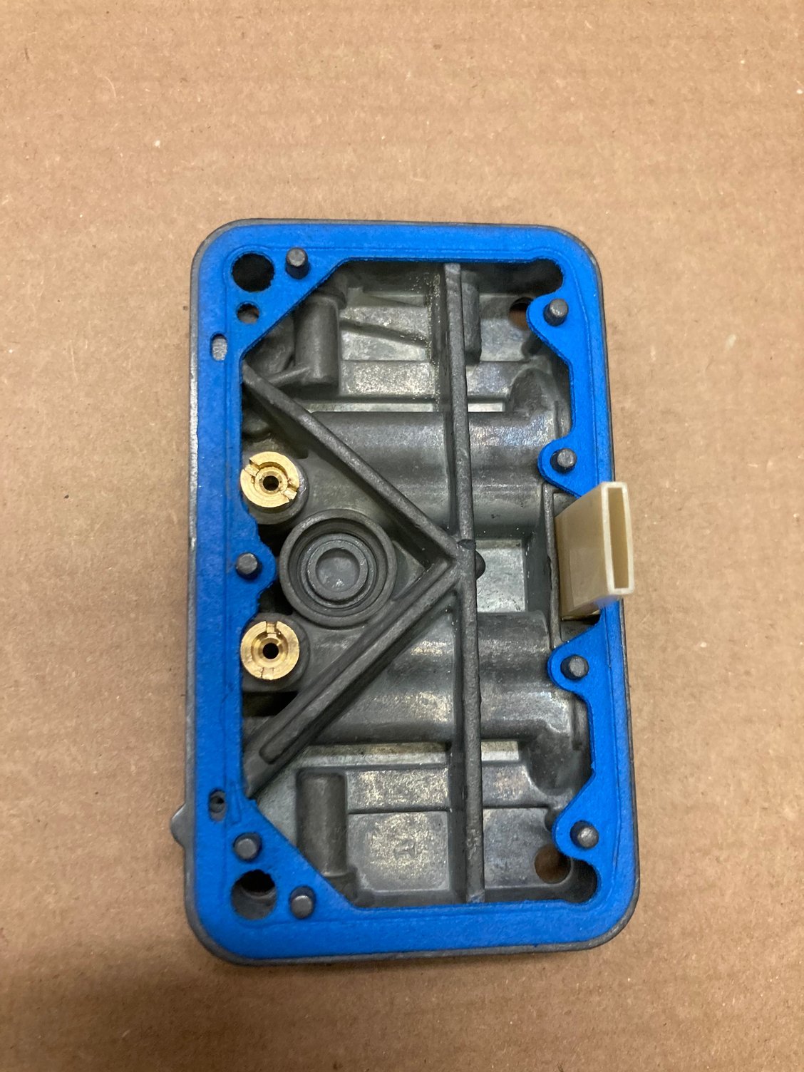

Geez it just struck me like lightning: I'm getting two big of an initial hit on my secondary accelerator pump, because I have a power valve in the secondary dumping fuel when I stomp it!!!!! There was a block off on the secondary when I got the carb, but the Holley specs said there was a PV in the secondary. I'm going to swap the block off and see what that does when I stomp on it!

Nice find!!!! You may have to go back and re-adjust after that since you will be pulling alot of fuel out!!

Well I went to block off the PV in my secondary, and stripped the metering block when putting the jets in! I had to order a 1/2-32 tap fix it, and once it came in I was able to do a quick fix:

#64 ,8.5 PV, #29 squirter, orange cam
Secondary:
#86, PV blocked, #25 squirter, orange cam
So the big changes were the 8.5 PV in the primary, and blocking off the PV in the secondary with a big jet up. I knew #86 would be rich, but it's all I could get locally so I wanted to get a look at what it came in at. The 8.5 PV is helping the throttle tip in and the engine likes it. Blocking the PV in the secondary definitely helped with my rich bog, and the car really takes off now when I stomp it! When cruising at 55 MPH I was in the 13's , but still when I lightly tip in the throttle I'm having a lean spot..
I decided to put the #67 back in the primary because throttle tip in was much better, then the chinesium fuel like leaked again! It was storming raining, so I'll warranty it out tomorrow and throw it on there! I'm thinking an #82 will get me closer on the secondary - do more testing. I ordered a nice fuel line kit from Jegs, as I'm fatigued by this crap that leaks when I do jet changes! I also found they sell full jet kits 60-99 for $55! Wish I would of done that from the start!
