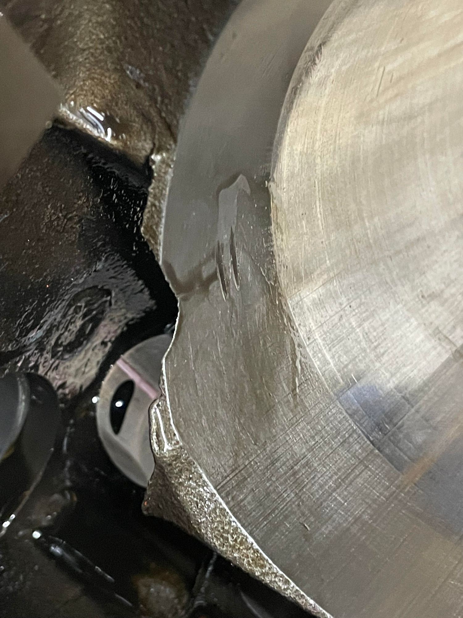

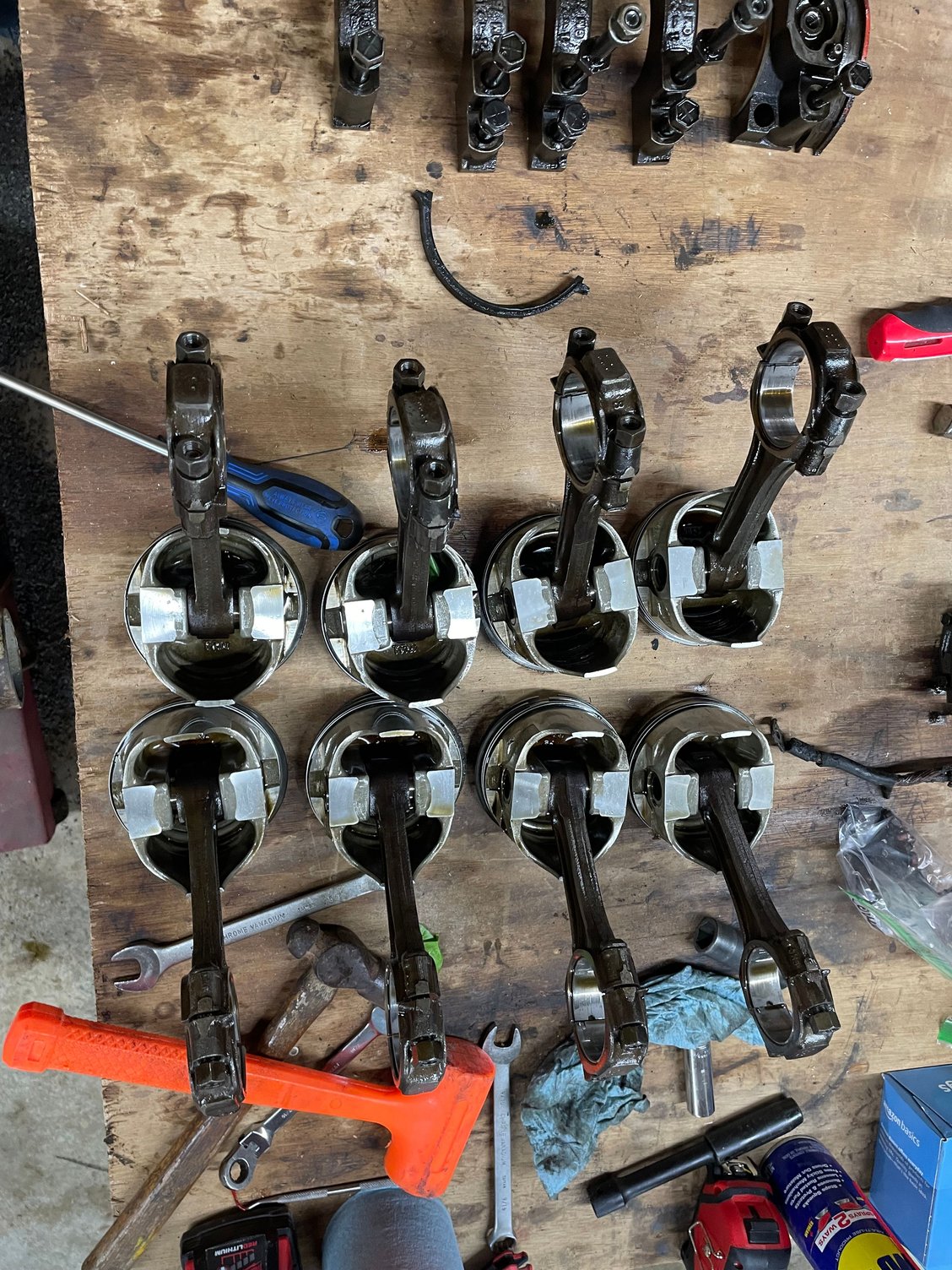

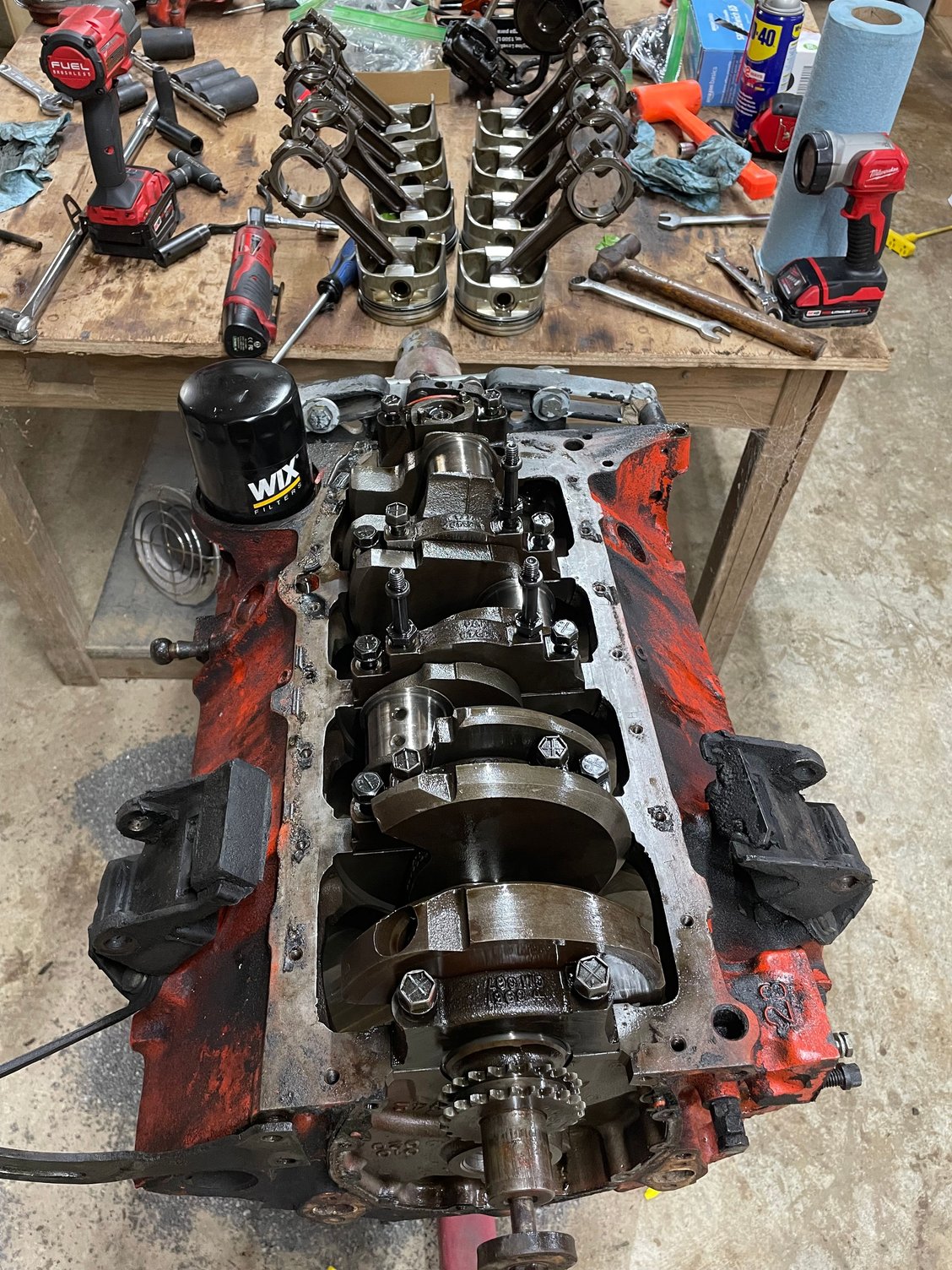

Got the time this evening to remove the pistons and crank, and everything went well:
Pistons were all in good shape, and I was easily able to gently remove them from the bores.
All the crank journals are in excellent shape, and can spin the crank over a couple of times

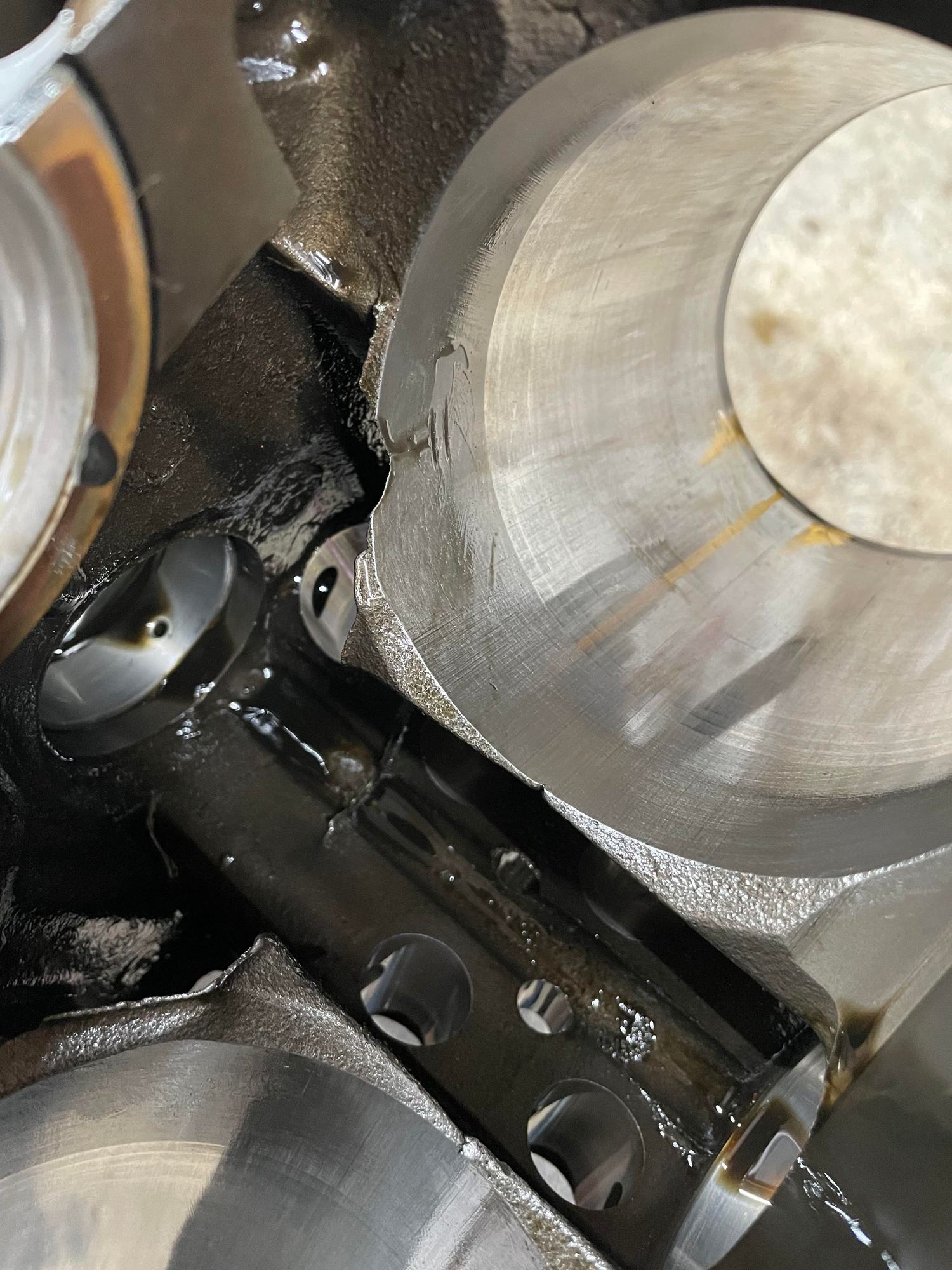

Everything was going GREAT, and then I wiped off the bores for a closer inspection.. I noticed a nick at the bottom of cylinder #7, and after closer inspection found a small crack! Take a look and let me know what y'all think, looks like I may have to sleeve this cylinder:
This is pretty disappointing, but it sounds like it can be saved and isn't that big of a deal. I'm hoping for the best and getting the engine to the block shop this week to see what they say!

Dissapointing!
Chipped cylinder,a crack and copper bearing showing. Hmmm...
Could be a sign of a rod / bearing problem in the past.
Maybe something else is bent. But sleeve is no big deal.
Best to have your local machine shop inspect everything to see if OK.
It should have eight forged rods with pink marks. And they should be straight. Crank too.

Considering the engine was rebuilt and doesn't have the LT-1 crank anymore, rod problem was my assumption. But after talking to some engine builders this evening, apparently that cylinder get's damage at that exact spot in an SBC from two things commonly: 1) factory machining of the distributor , 2) when being bored, the bore caught the lip and damaged it.
Where would these "pink" marks be? How can I tell if they're stock forged rods?

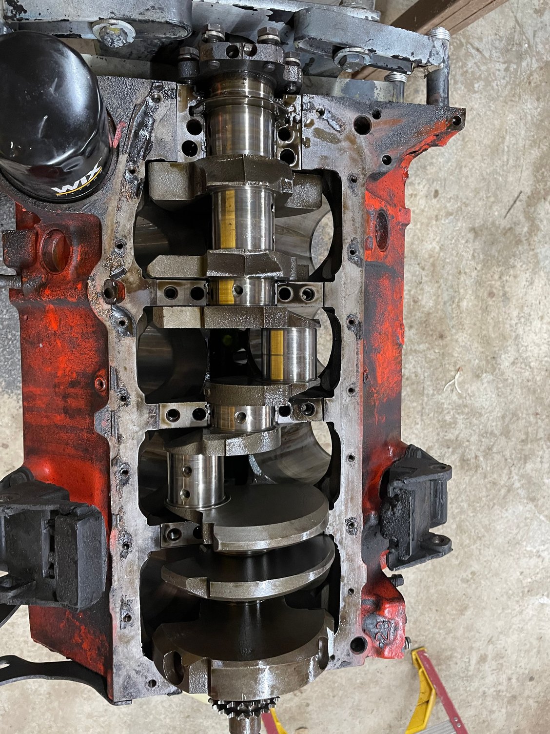

I did not notice before that you no longer have the LT-1 crank.
When I looked closely at the pic in post #422 I could tell.
You reported a 3932442, which unfortunately is just a standard cast crank.
It could be out of a 305 or any garden variety 350.
If I were you I would consider finding a forged crank if you want to spin it past 6000 rpm very often.
The forged cranks are at least 36% stronger, or more.
That is the real "heart" of an LT-1.

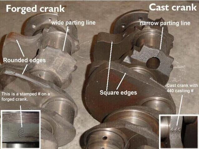

And here is a pic of how to tell them apart by a quick look. Just look for the wide parting line.:
The rods are much less special. They were basically just standard chevy rods that were magnufluxed, and given a pink stripe on the middle of the rod to tell them apart. Anyf 50 year old rod at this point should be magnufluxed and checked for straightness anyway at this point, if you are going to run it hard. And with ARP bolts added you will be good for 7000. The factory rod bolts were the weakest link. They sometimes let go around 7000. The ARPs won't.

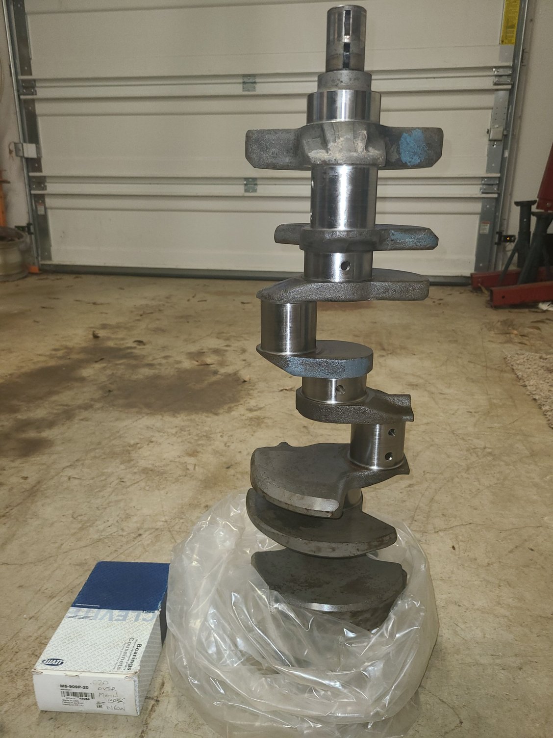

I have a fresh ground forged 350 crank ready to install. I will probably never need it. I can let it go for $250 plus the ride. Send me a PM if you are interested in the details.

What's the casting number on it? Is it an LT-1 crank or aftermarket? The LT-1 is an 1182

No 330550 is a cast crank
The LT-1 was an 1182 or a 3931182 etc.
check Jim's list
http://www.jimsperformance.com/cranks.html
But there is no significant difference in 350 forged cranks
$250 is a good deal, and already cut!

1182 crank
Forged GM 350 crank. Ground 30 mains, 20 rods. I can throw in a set of Clevite main bearings to go with it.

Originally Posted by stingr69
1182 crank
Well I'm definitely interested then! As long as I don't get any bad news from the machine shop, we'll work something out on this crank.
