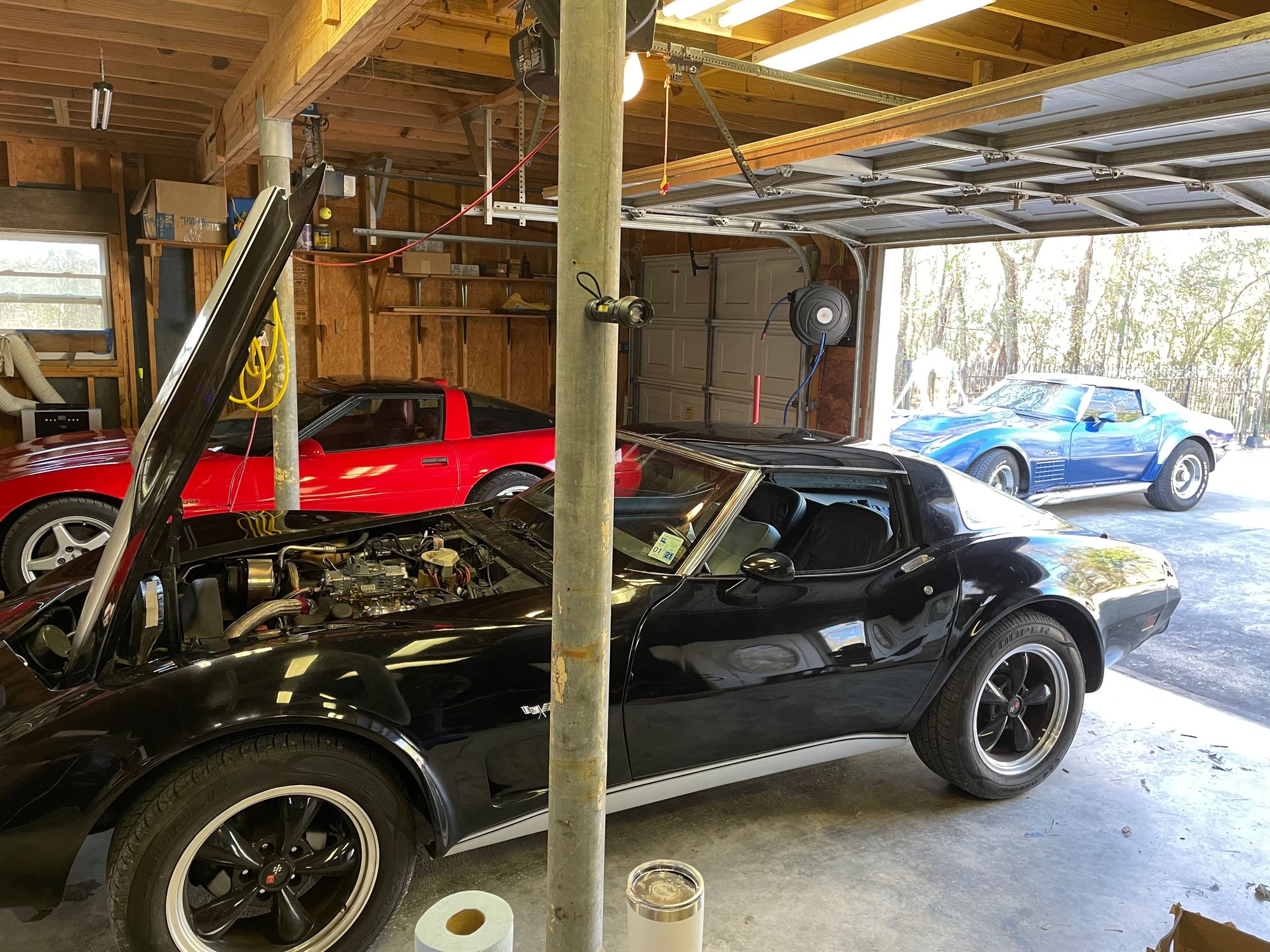

Before I moved into the new space and started taking my car apart, I wanted to help my step dad get his car tuned up. He took me for a ride in it a while back, and it's a total PIG! Makes no power and won't rev up. I thought setting the timing and tuning the carb up would fix it, but looks like it has more issues than expected.. We're still working on sorting it out, and we'll get it right!

All nice cars and a nice shop with lots of space.

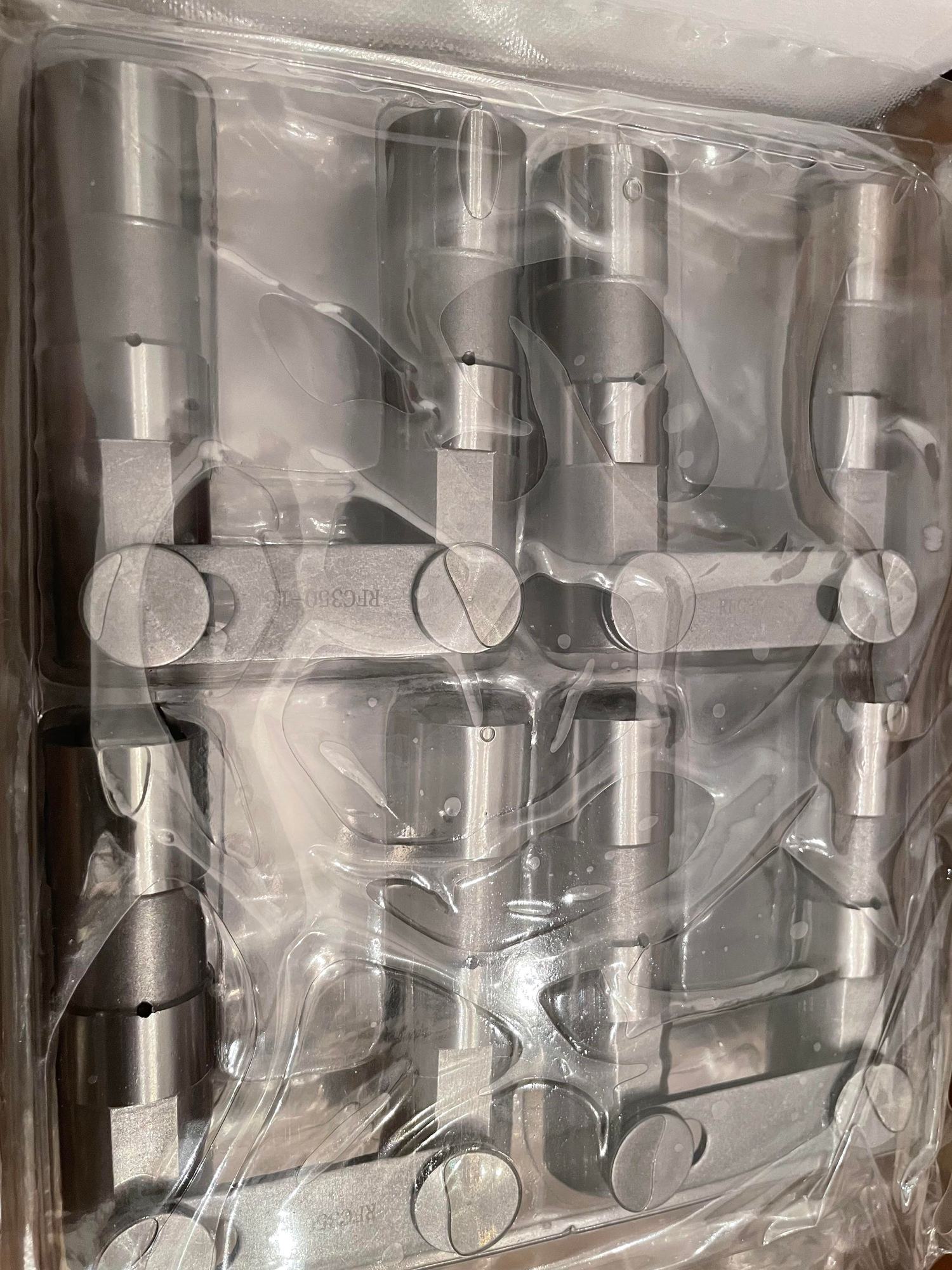

Got home from a week long work trip in Charlotte to some new parts waiting on me: cam and lifters
Everything looks well finished and high quality! Engine will be pulled in February, and we're gonna put a new top end on the LT-1!

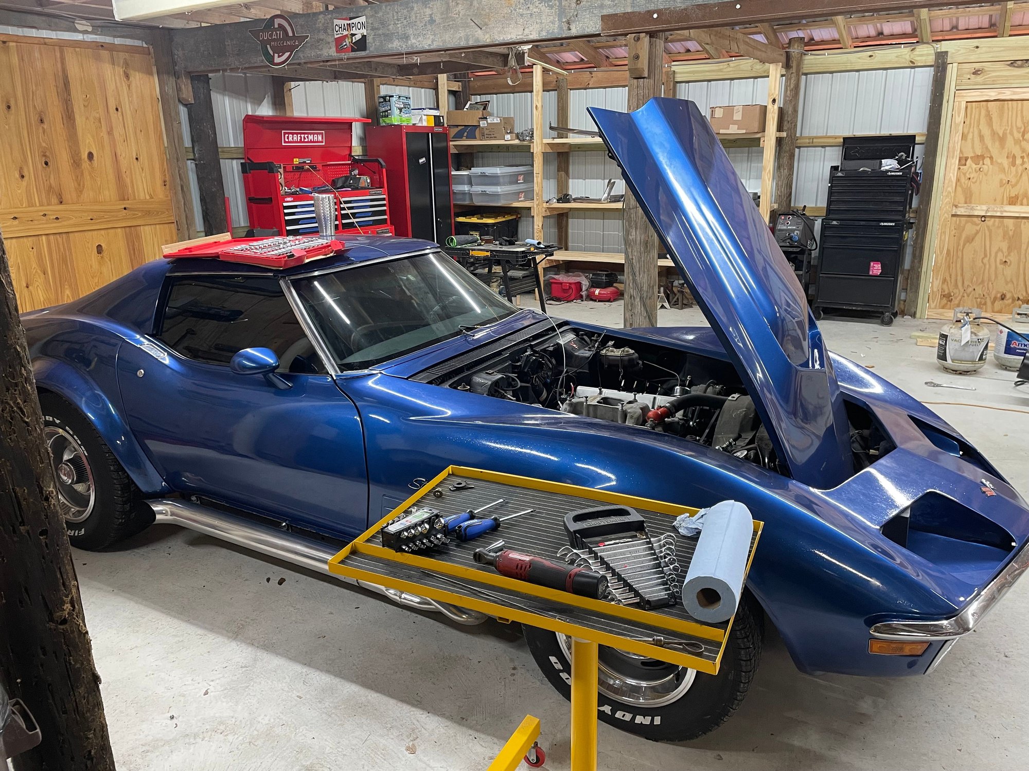

Well gents, after spending 4 months building a shop, today was the day I could finally move my tools and cars over to their new home! Spent every night after work this week finishing all the little things that needed to be done, and then got up early this morning to move ALL my tools, and organize them in the new tool box. Now I was able to get my C3 in , so did I let her rest peacefully for a night in her new home? HELL NO!: ripped her apart and kicked off this project: pulled everything off around the engine and got her ready for lift off!

Like I've been sayin', just another guy with too much free time on his hands!
Nice shop, too. Well done, Sir.

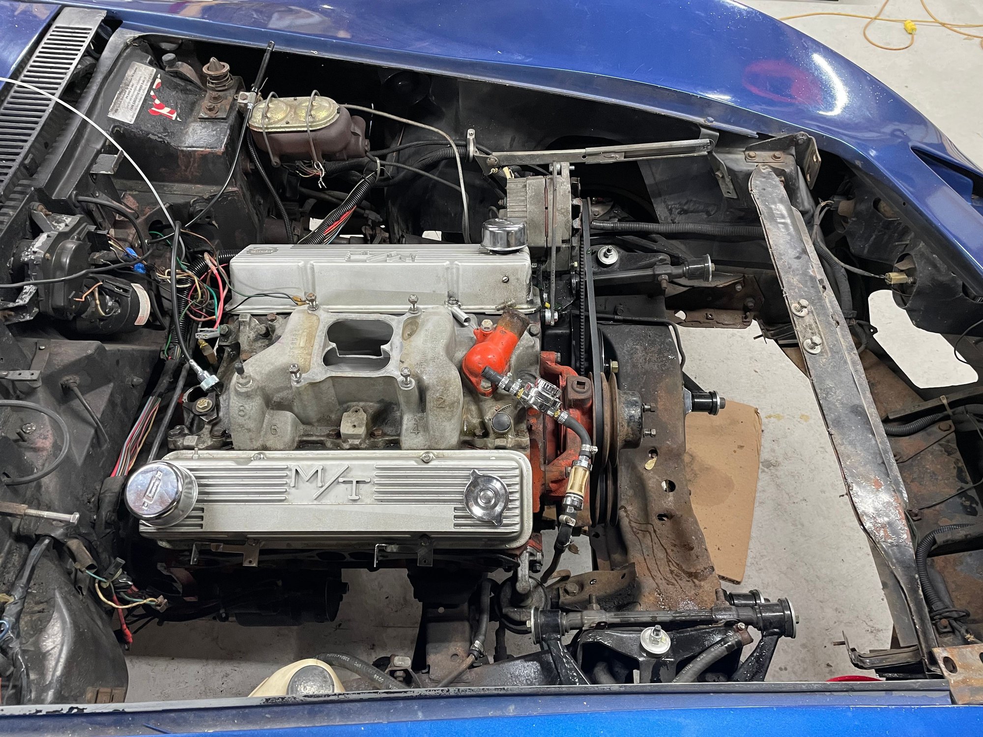

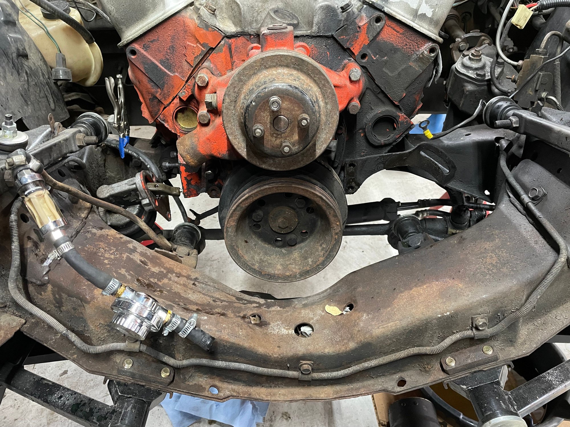

Got up early this morning, and went to help my stepdad work on his C3: did a compression test, changed the plugs, messed with the timing, then installed a wideband . He's waiting for my nephew to come over this afternoon to help him put the wheels back on , then he's going to start driving with the wideband so we understand what's going on and can start tuning it.
Came home and got a little work done before the Super Bowl: pulled accessories, fuel pump, starter, grounds, and wires off so the engine is 100% ready to be pulled.
The radiator support, frame, and everything else up front is in really good shape. Has typical surface rust, but zero rot up front. Media blasting and POR15 are going to go a long way with all these parts! Engine definitely needs to be resealed with fresh paint, I'm glad I'm yanking it out. Looks like I'll be breaking in my new blast cabinets with all these little parts and brackets. It'll be a lot of work, but going to make a dramatic improvement at the end!

Exciting time in your project! Good for you!
Interesting - heater is blocked off. Though I suppose there's not a great need for it in Louisiana!

Yeah, no need for a heater in Louisiana: our winters normally stay in the low 60's, and when it's colder than that the corvette just stays parked! Now would be the ideal time to install Vintage Air, but it's just not in the budget at the moment.
