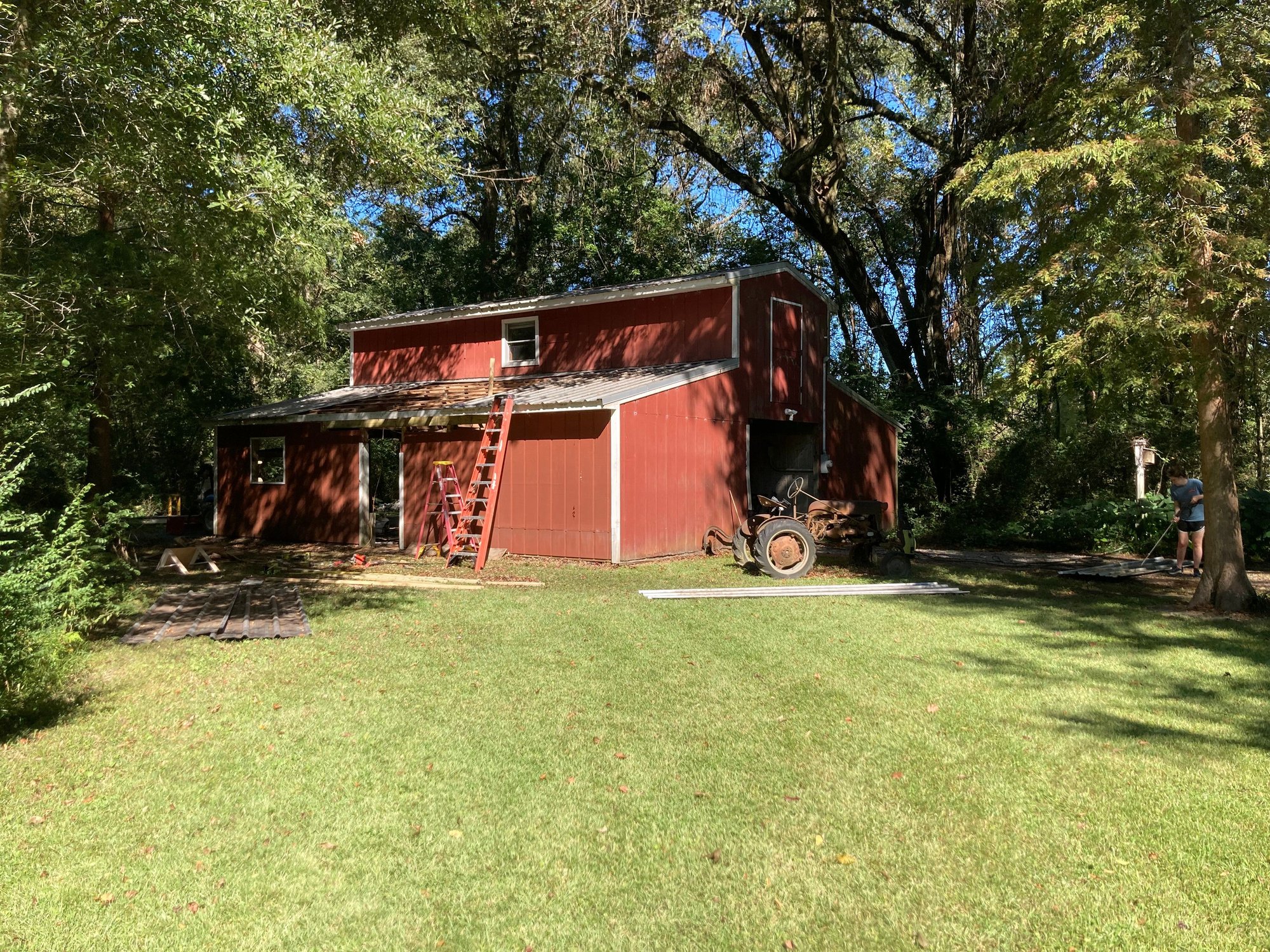

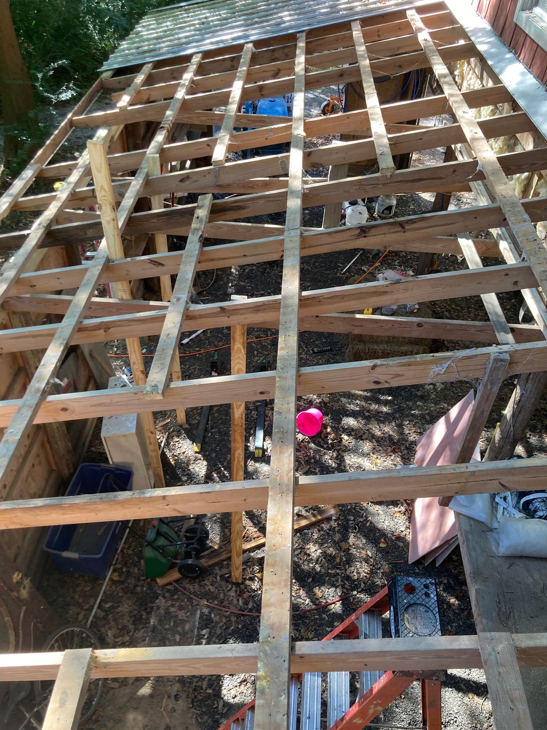

Well gents, I know I've slowed down on my C3 project, but it's for good reason: getting my rock crawler ready to hit the mountains next weekend and renovating my barn into a car shop But don't you worry, I have plenty of plans for my C3, and parts waiting: Tach drive distributor, antennae, CAS bluetooth kit, console side panels, and a new accelerator cable. I put the cable in last night so I could drive my car, but realized I'm supposed to have a retainer and the new cable didn't come with one! So now I have to wait for that to come in! These little tidbits will be icing on the cake going in to our Louisiana fall for prime cruising season and car shows. But I do have big plans and parts i've gotten killer deals on and stashed for my Jan/Feb project when it's freezing here:
  • VBP fiberglass rear spring to put on and match my front VBP suspension
  • 64cc 190cc/72cc aluminum heads
  • Lunati Voodoo cam : 233/241; Gross Valve Lift (Int/Exh): .504/.525; LSA/ICL: 110/106
  • Correct flip up headlights (found matching blue ones a while back!)
More to come on my plans for the heads/cam swap this winter
Here's a glimpse at my 40x40 pole barn i'm renovating for a new Corvette Haven: (extending 16', slab, lift, fixing all rotten wood, redoing roof)

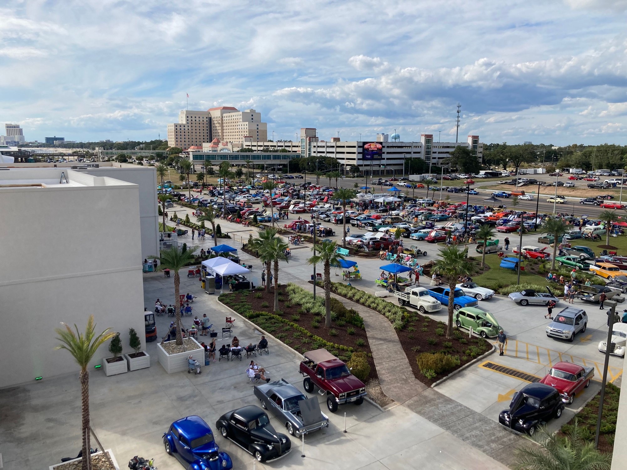

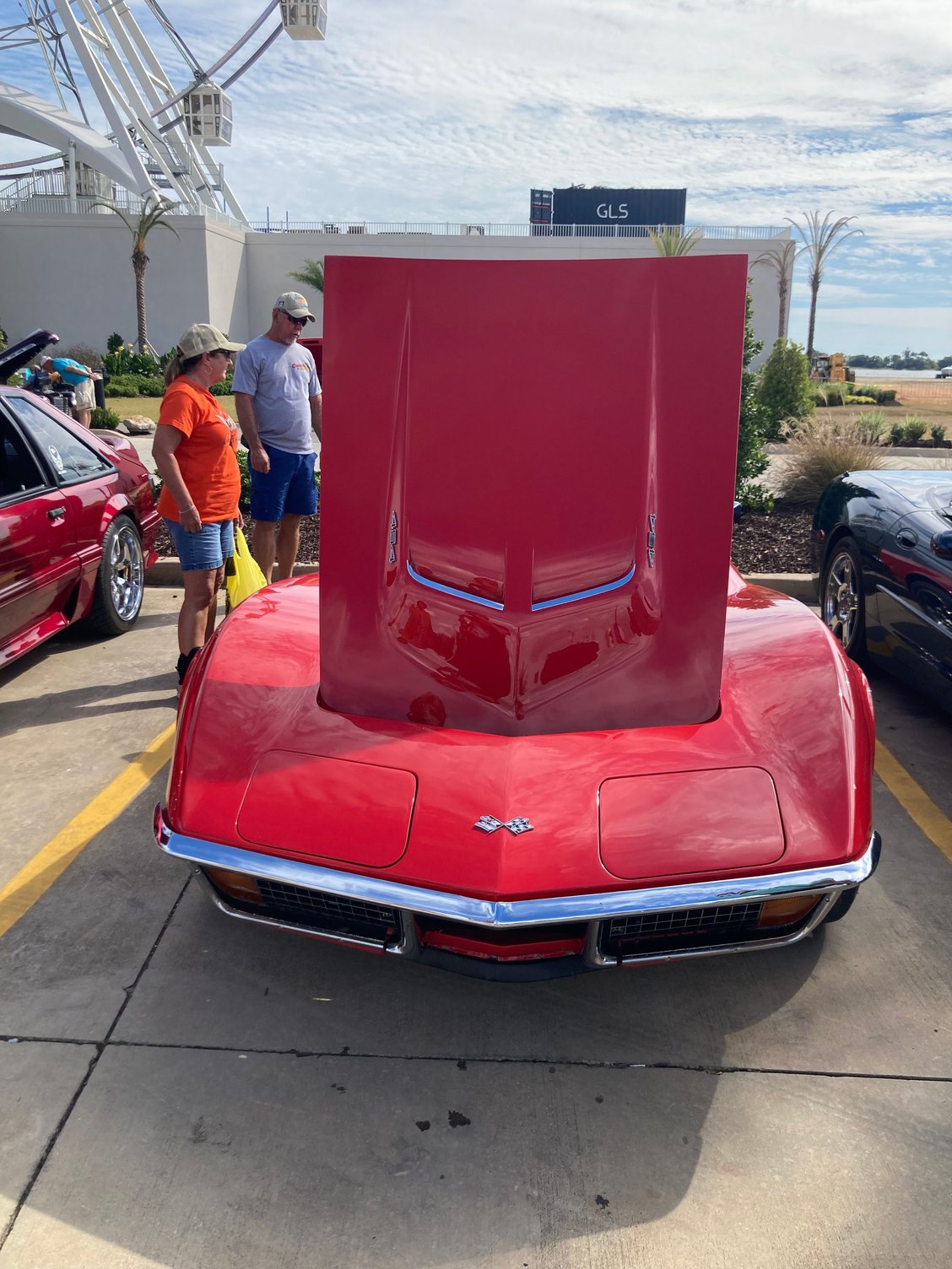

The most exciting thing this week was I got to go to Crusin the Coast for the first time! I was able to get away from work on Tuesday and ran over to MS with two good friends to drool over all the cars. We saw thousands of amazing cars, met some great people, and Mr & Mrs Mercury20 met us for dinner in Ocean Springs! Very successful day, and I'm definitely taking the RV there next year for a couple of nights!

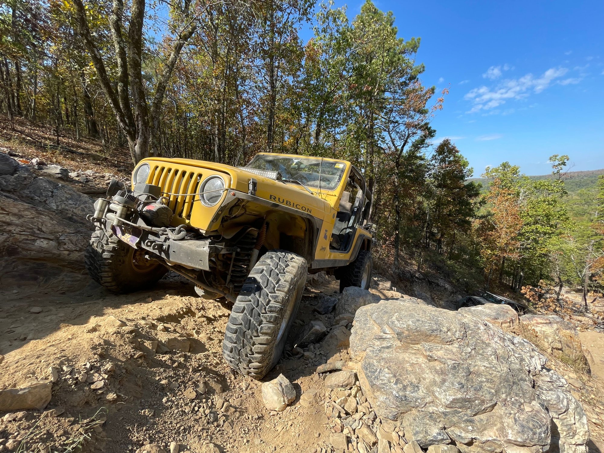

Well Jeep Trip to Hot Springs was a great success: beautiful weather, tons of fun, and got see spend time with great people! Here's a few pics for anyone interested, then I swear we'll get back to my C3 project now I'm done with my Jeep LOL

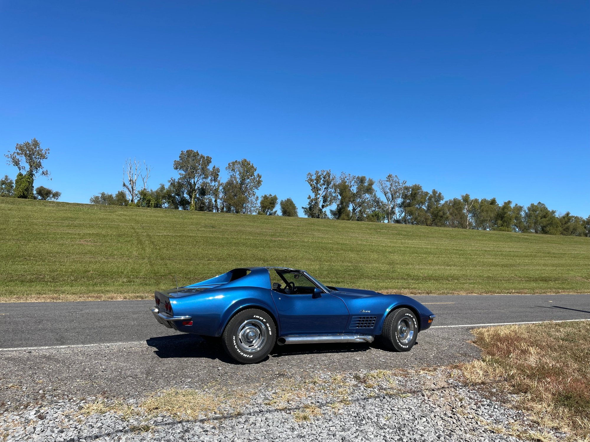

I did put my new accelerator cable in my C3 tonight, and tinkered with her. Putting new HEI in next, will update soon.

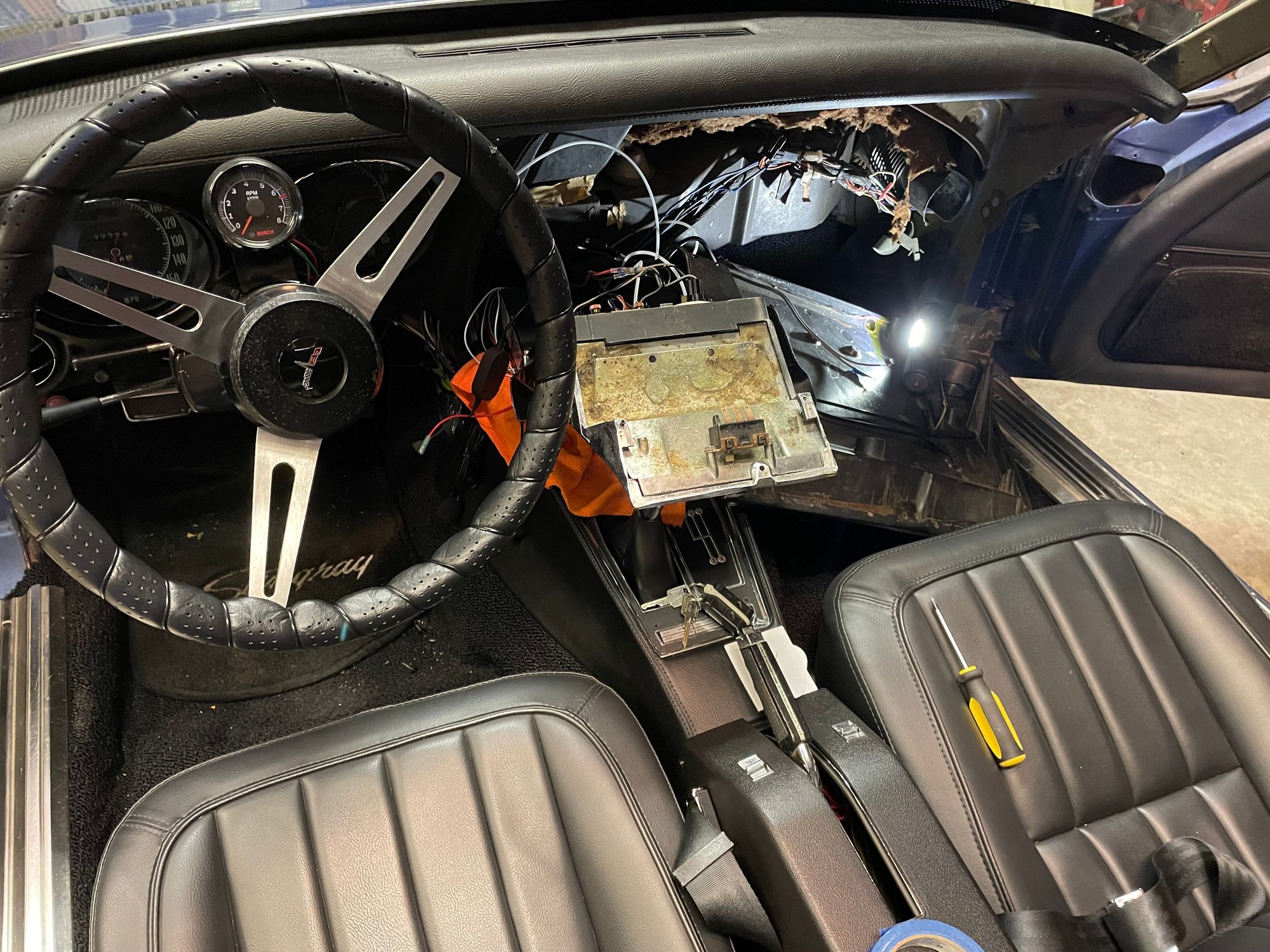

I got back to working on my C3 this week, and decided to get my CAS Bluetooth installed so I could listen to music as I cruise. The CAS unit is surprisingly big, but able to mount it on top of the stereo with the supplied double sided tape. It just plugs into the CD changer input, so it's a really simple install. When testing the unit, it was quick and easy to connect to the BT, and the audio sounded nice. I did notice that my passenger side speaker sounded off.. played with the balance to isolate it, and discovered that it was blown! My cheap *** recycled the speakers the car came with, and it bit me in the butt! lol Luckily it's just the passenger side so I was easily able to replace it with a Sony 4x6 the local Wal-mart has in stock... ended up using the zip tie method to secure to the grille brackets lol! Now the music is sounding GREAT, so i put the car back together. The next day I couldn't wait to take it out during lunch down River Road with this beautiful sunshine and 68F weather: car ran beautiful, but radio cuts in and out! Radio or Aux does this, and I noticed its only when the car is driving, so it has to be some kind of Alternator interference. Any ideas here?

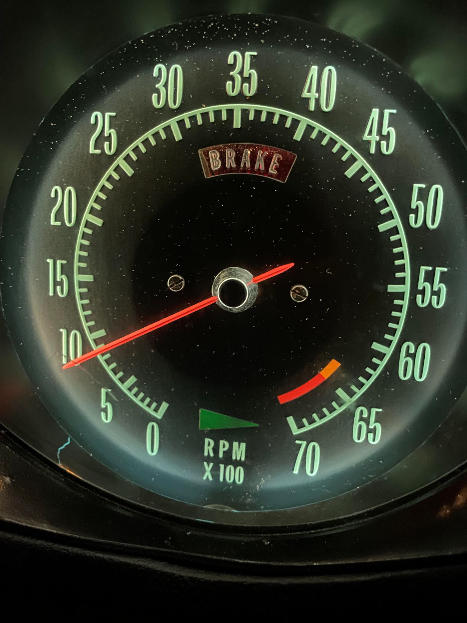

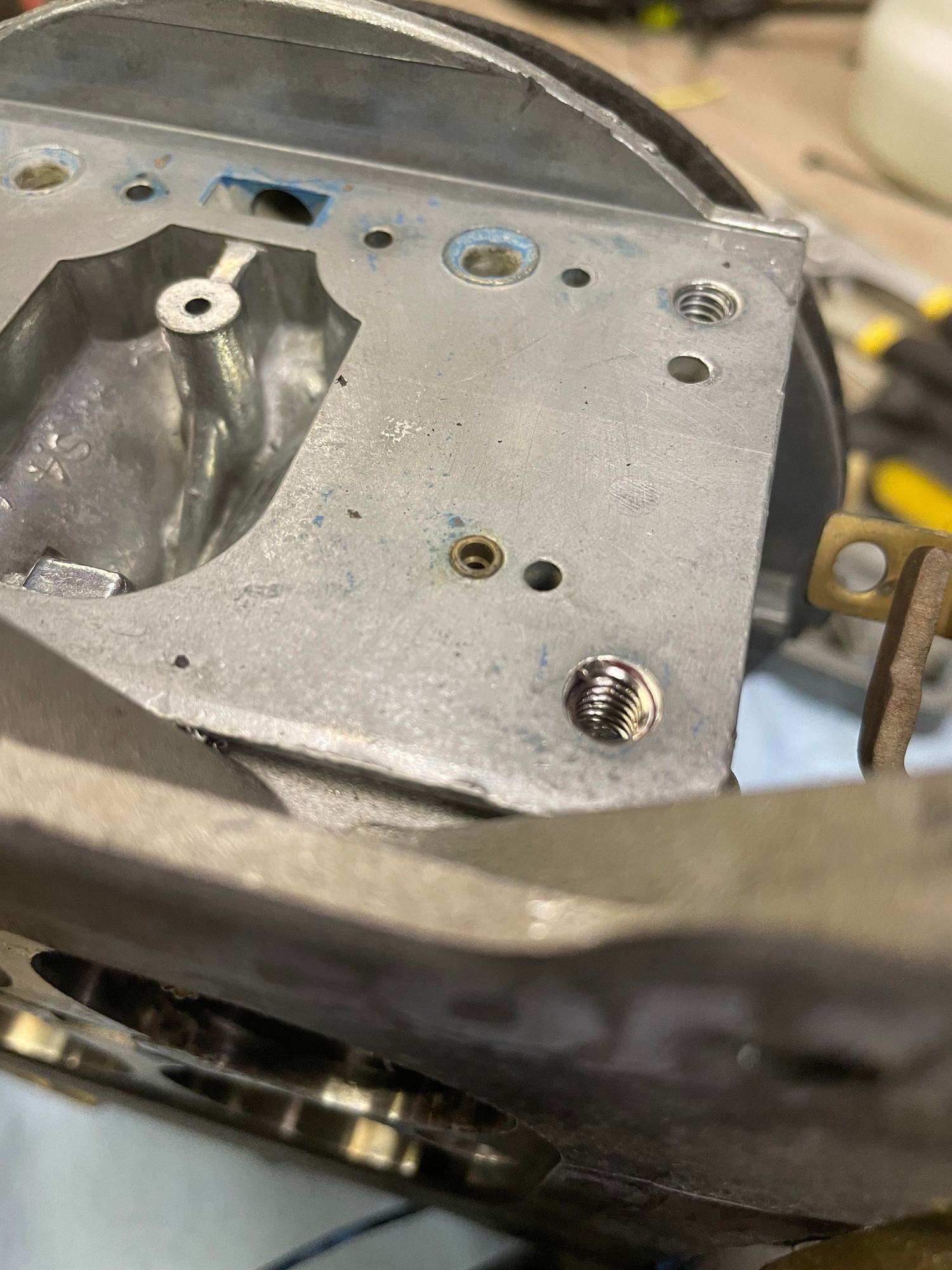

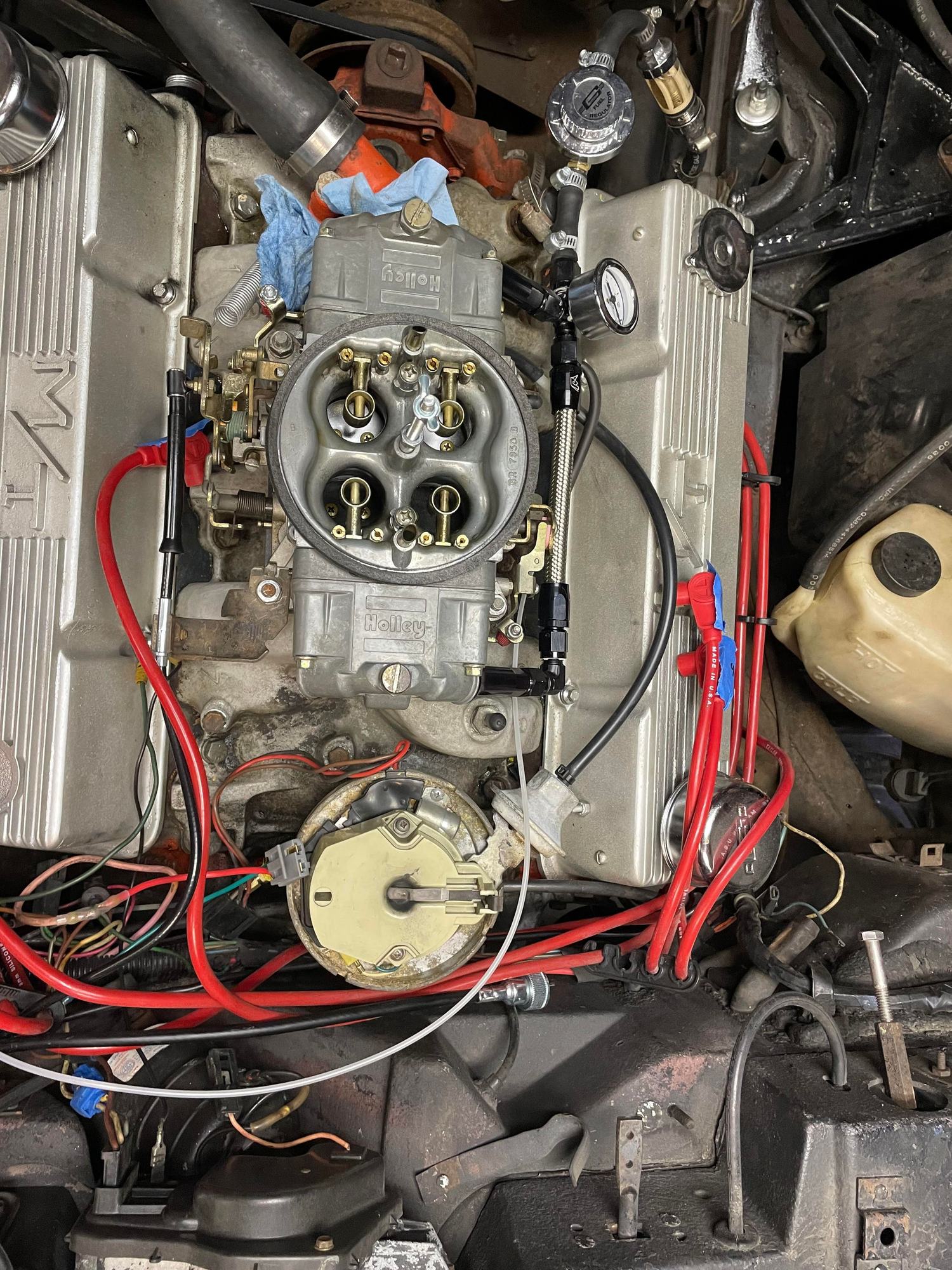

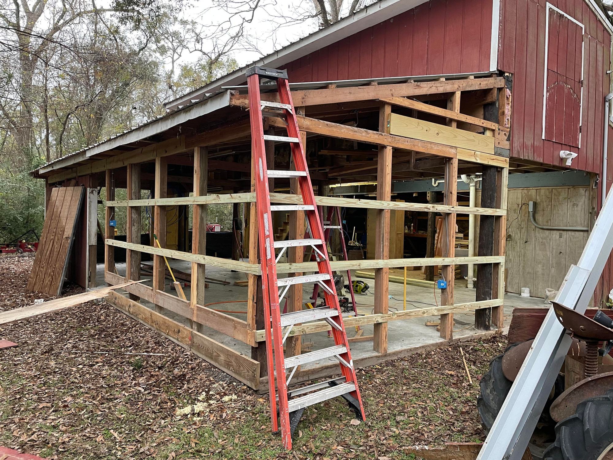

It's been a month since, I've updated, and tonight was the first time I've driven and worked on my car in the past month! Been tied up doing my barn reno, so I'll have a nice 40x40 shop for my Corvette!
I decided to finally get that tach drive distributor in, so my stock tach will finally work. This was a pretty easy job to get the new one in and wired up in 10 min. I went to start her up, and noticed a leak from a bowl bolt.. So I'll just pull the carb off real quick and put in a heli coil..
So put that Heli-Coil in, and giving it time for the loctite to set
Ain't nothing better than working on you C3 on a nice Tuesday night with your friends Hank Jr, and Jack Daniels!
I had been having a throttle tip in issue in some throttle situations that I could never get right, and convinced myself that I needed to enlarge my PVCR.....Well removed the Power valve on the front one, see something missing???? I had NO working PV this whole time!!!! I had to switch this one with the rear, and that one did have PVCR holes! Wow, what a brain fart when assembling this carb!!!
Put the car back together, set the timing , tuned the carb, and now she's ready to cruise
Here's a peak at what I've been doing with the barn:
*Dug up and move/re did plumbing
*Re wired building with new LED lights, switches, and power outlets
*Had a slab poured in the barn this week too
*ripping off old T1-11 siding and replacing with metal siding
*Replacing any damaged wood
