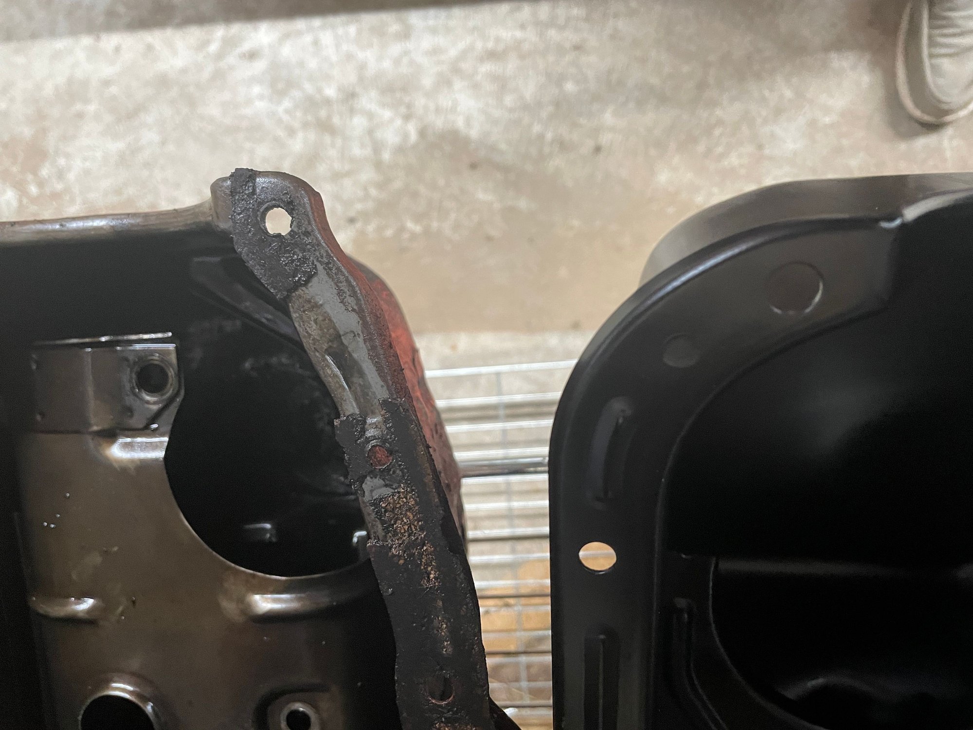

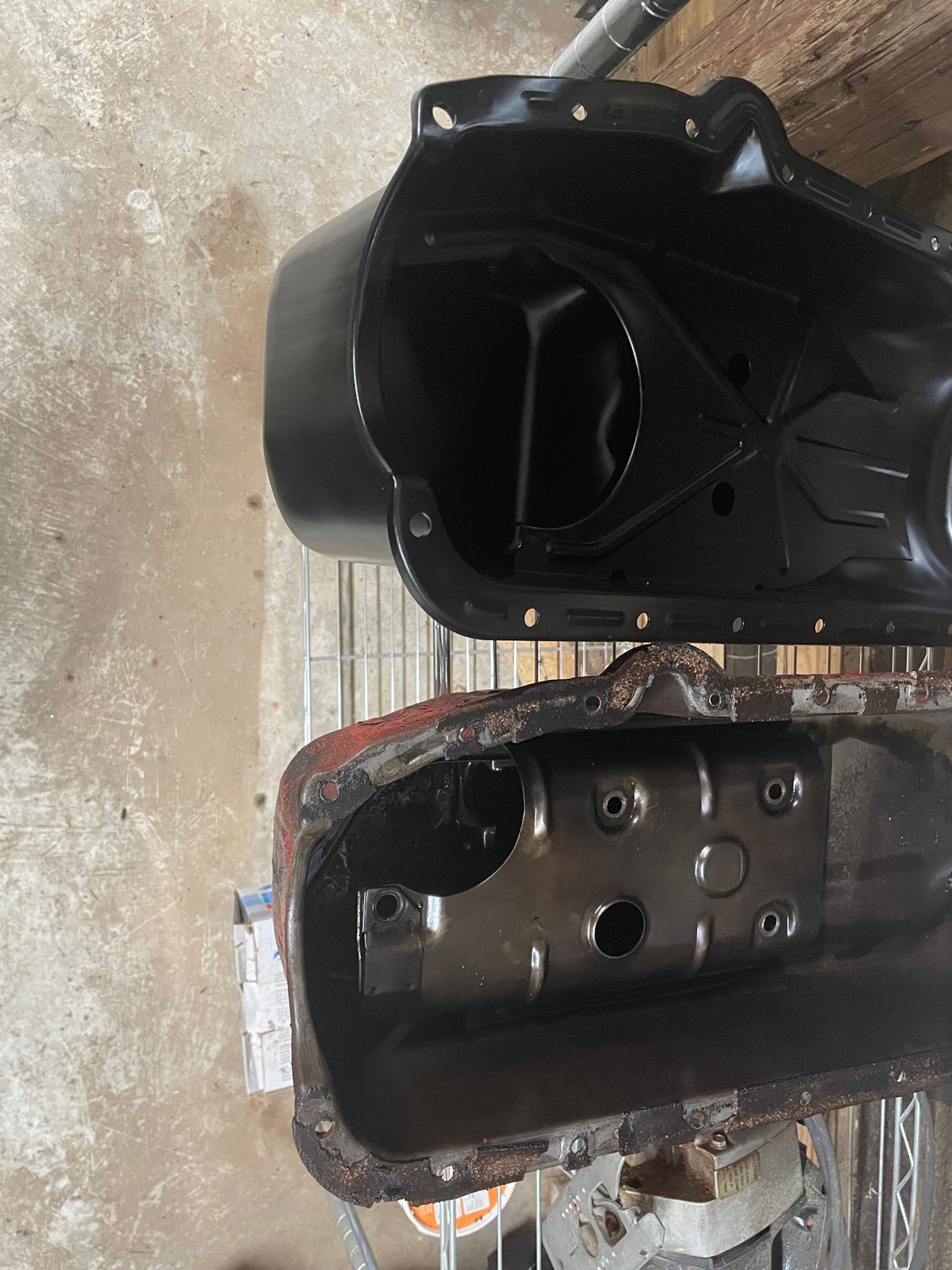

Just went outside to take pics of old oil pan, and fit new one.. removed main bolts with studs, and put new oil pan on: doesn't line up at all! I bought the Dorman 264-104, why is it see different? see below -

There's some info in this thread:
https://www.corvetteforum.com/forums...g-dilemma.html
about a change in small block oil pans.
It might be what you're running into.

That's an interesting read! I may need to refurbish the original pan! Thanks for sharing!

Ive learned the hard way with Milodon and Moroso racing pans to use their gaskets. Why the new pan doesnt line up is anyones guess. Must be made on a newer block or just a manufacturer's mistake. Maybe its a one piece rear main seal pan
If it were a big block i could tell you the different generation changed the bolt patterns on the pan when they changed seals
Yeah you're reinforcing that I should stick with the stock pan!

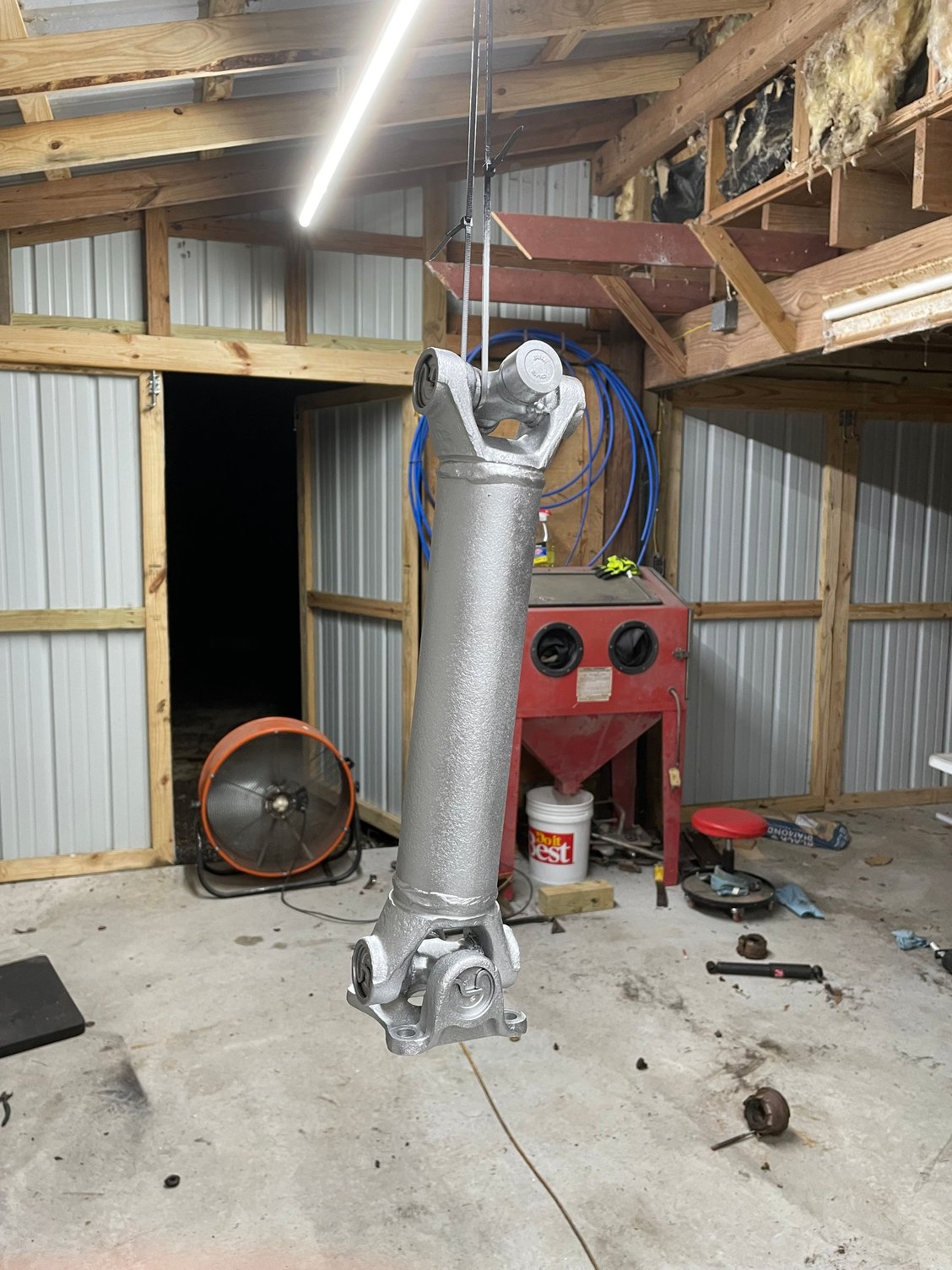

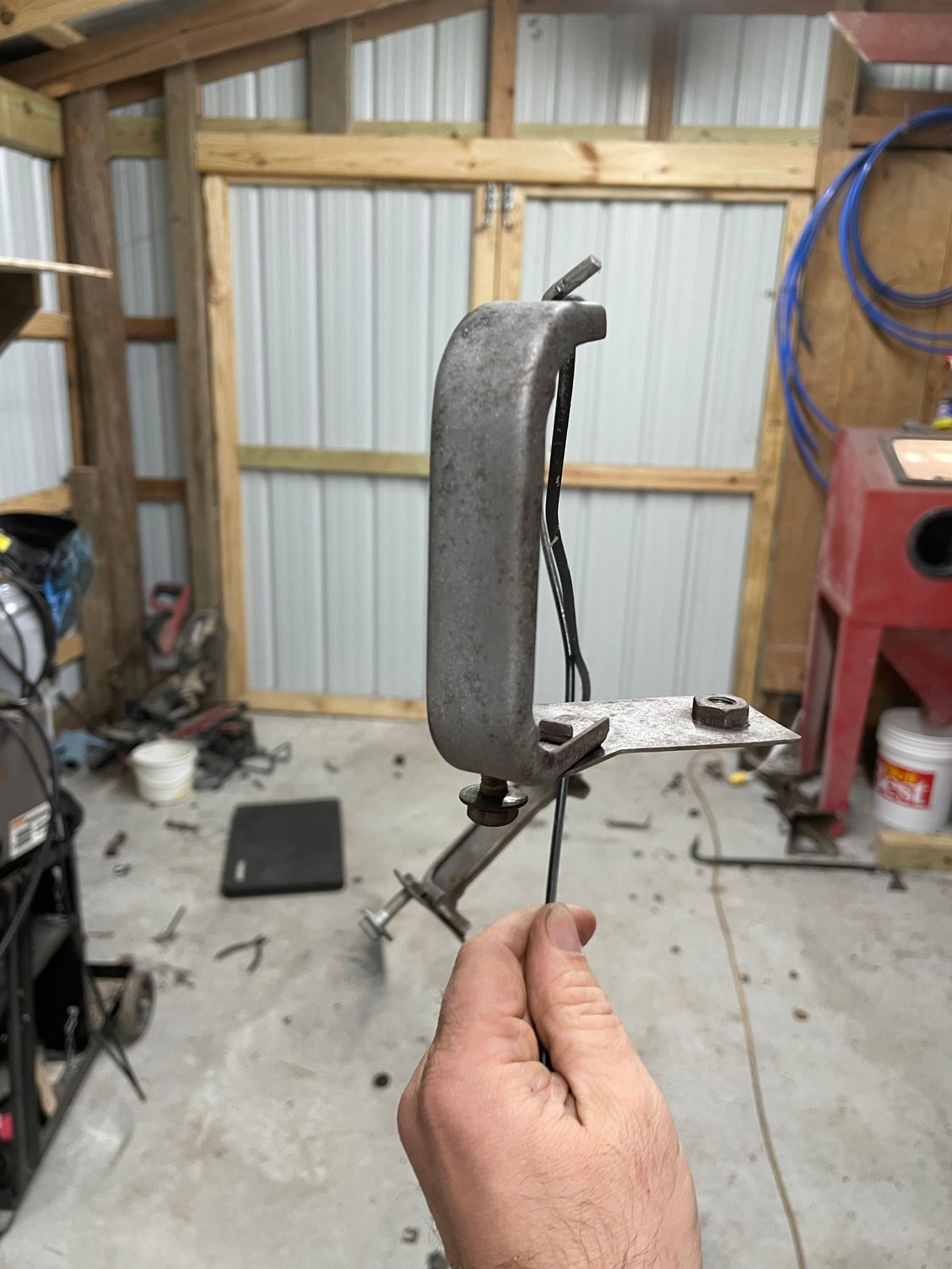

Still waiting to get my frame back from powder coating, but I got started on blasting and painting some brackets tonight. It's amazing what some elbow grease and spray paint can do!
First up was radiator brackets.. these have been sitting in my blast cabinet, and started to rust again. Blasted again and hit them with some fresh satin black
Next up: Half shaft
This silver paint is brighter than expect, but I think it looks pretty good

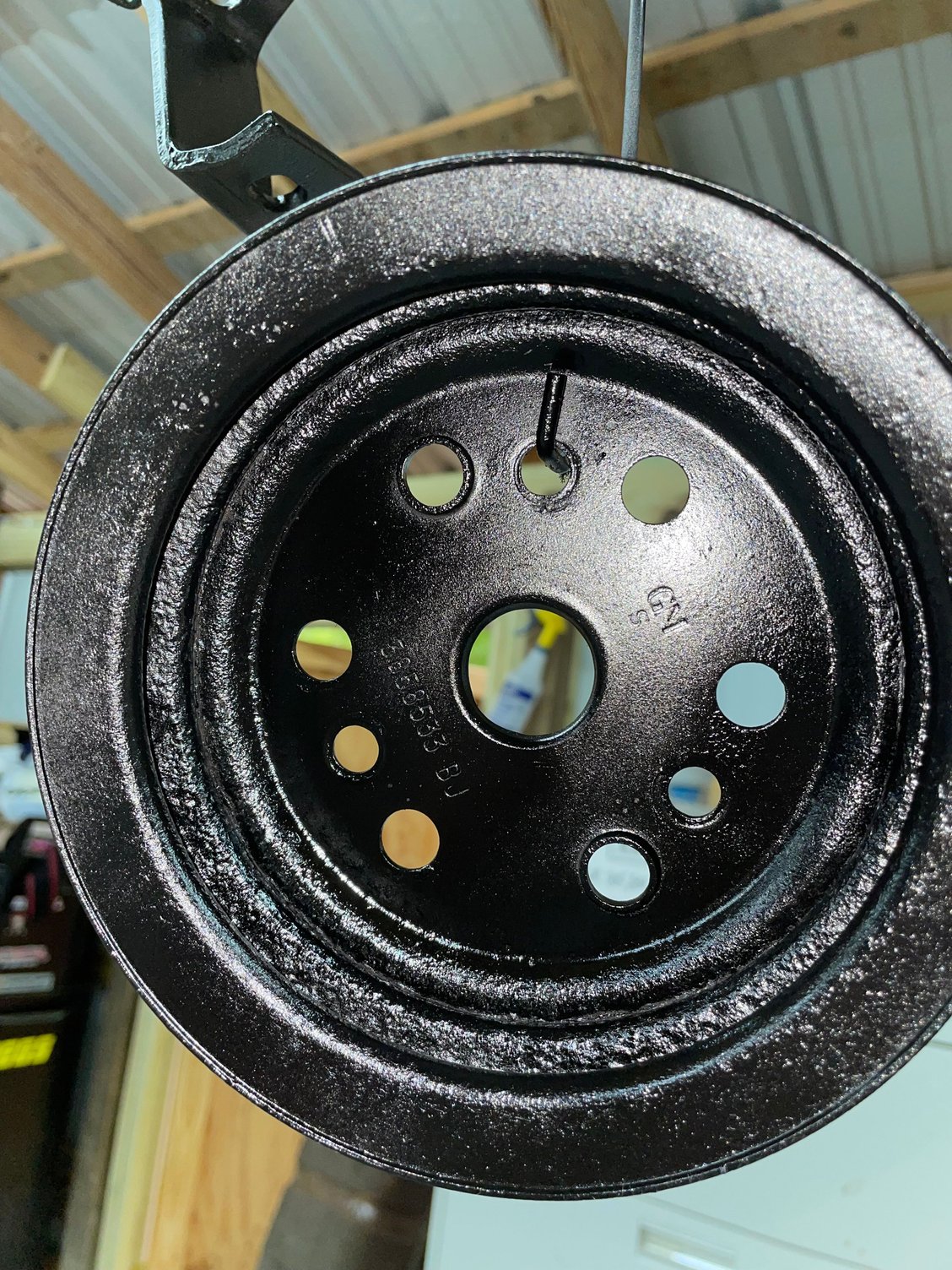

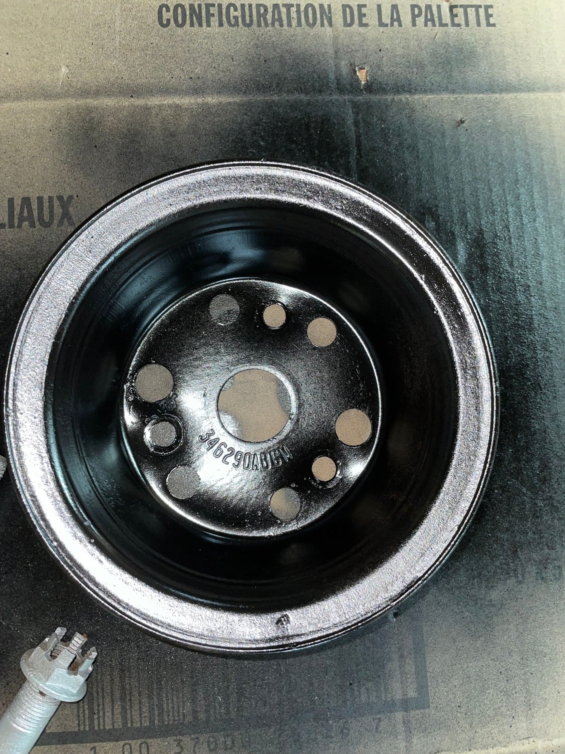

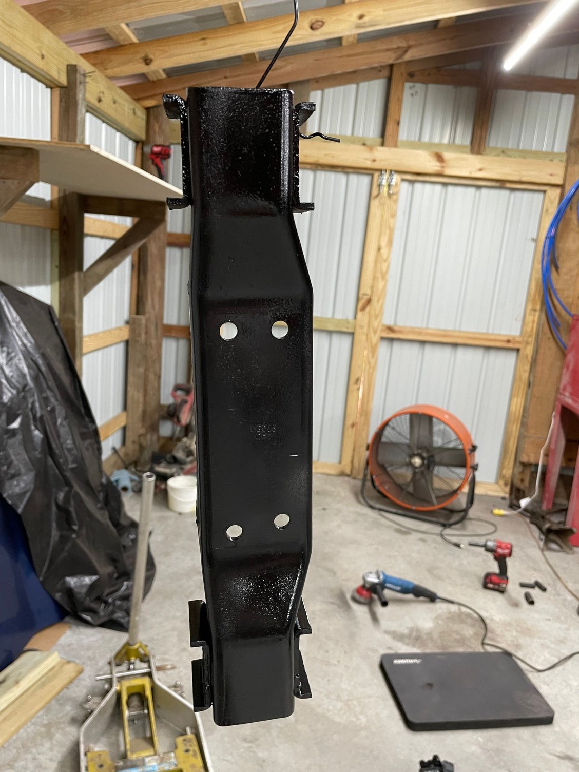

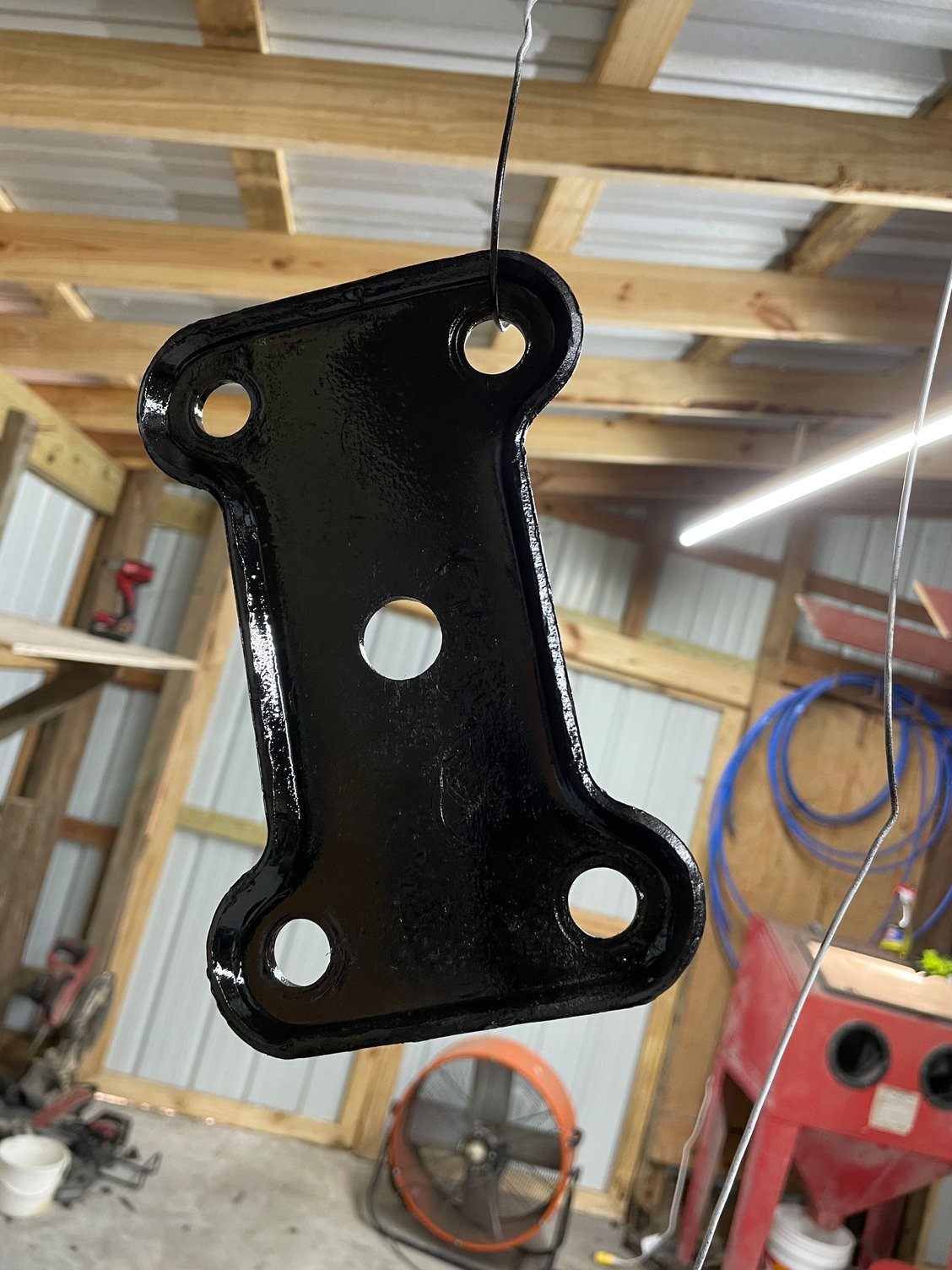

Today was a rainy Saturday, so I got to lock myself in the shop all day and get a lot of work done! I blasted and painted parts all day, in preparation of getting my frame back:
First up was the biggest one, that heavy differential! I went to work with a wire wheel on my grinder and brake cleaner and was able to strip it down nicely. Removed all the bolts and put them in "Evaporust" for my first experiment with it, and removed the strut rod bracket to put in the blast cabinet and paint.
I went with satin black, because I wanted the contrast with the silver half shafts and I like that it hides everything in the future!
Next was to finish blasting all the pulleys and brackets for the engine, and get them painted in preparation for assembly. Confirmed they are all the original GM brackets too!
I also got the shock bolts off the trailing arms. Blasted and painted: came out nice!
And the rest of the brackets for the diff cleaned up
While messing with my engine, I checked the aftermarket oil pan I bought again: fits perfect!!!! I had it on backwards last time LOL!!! So I went ahead and painted it and my new water pump. I used the Duplicolor Ceramic Engine Enamel, and I liked it a lot better than the POR 15 Engine Enamel I used on the block.

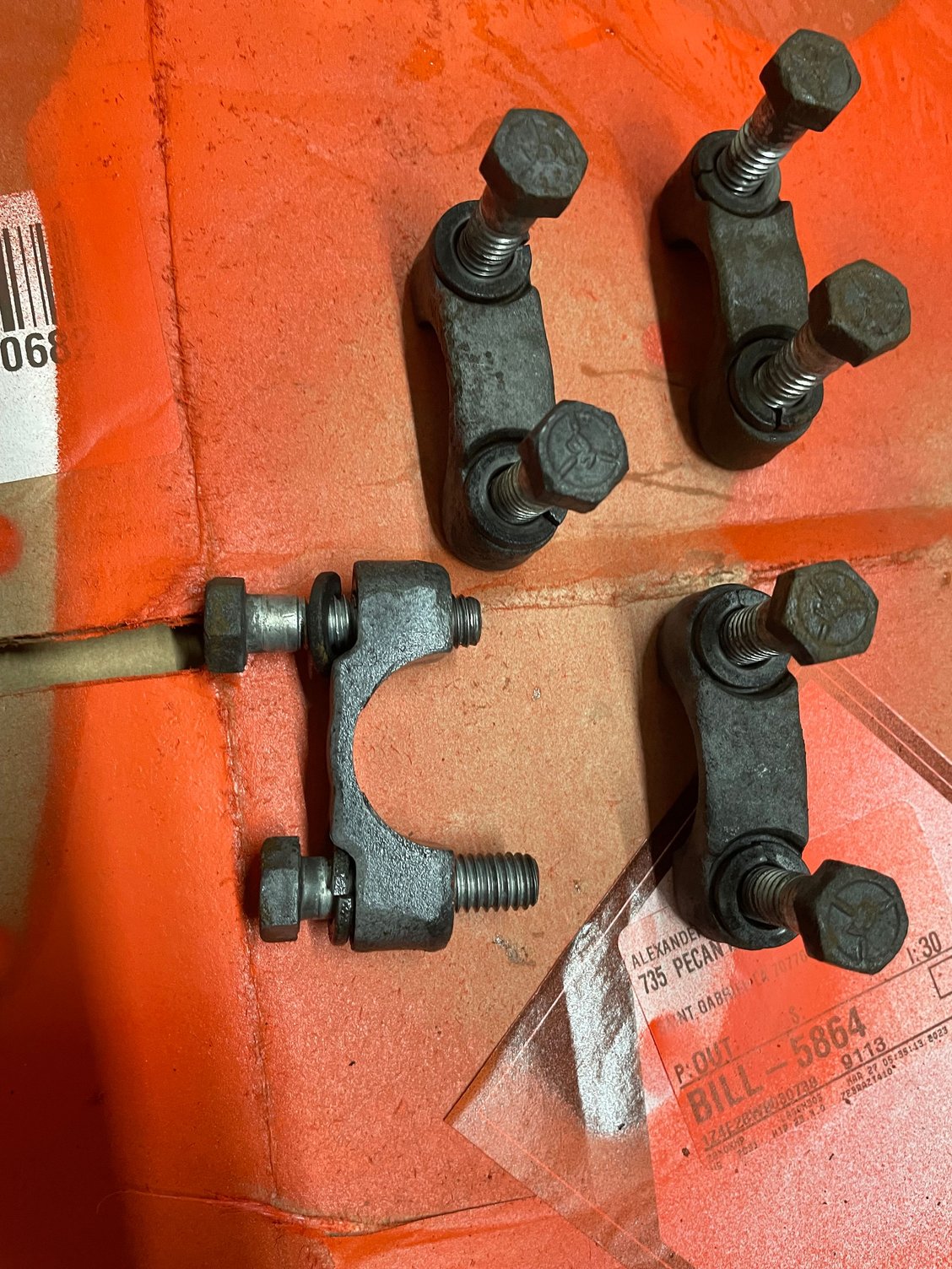

I bought some EvapoRust and experimented with it last night: put all the hardware from the Diff in some cups to soak over night. I was pretty impressed with the results :
Here's are factory LT-1 Bearing caps for the half shaft U joints - what color are these supposed to be? Raw metal or painted silver?
U joint straps for DS came out nice
