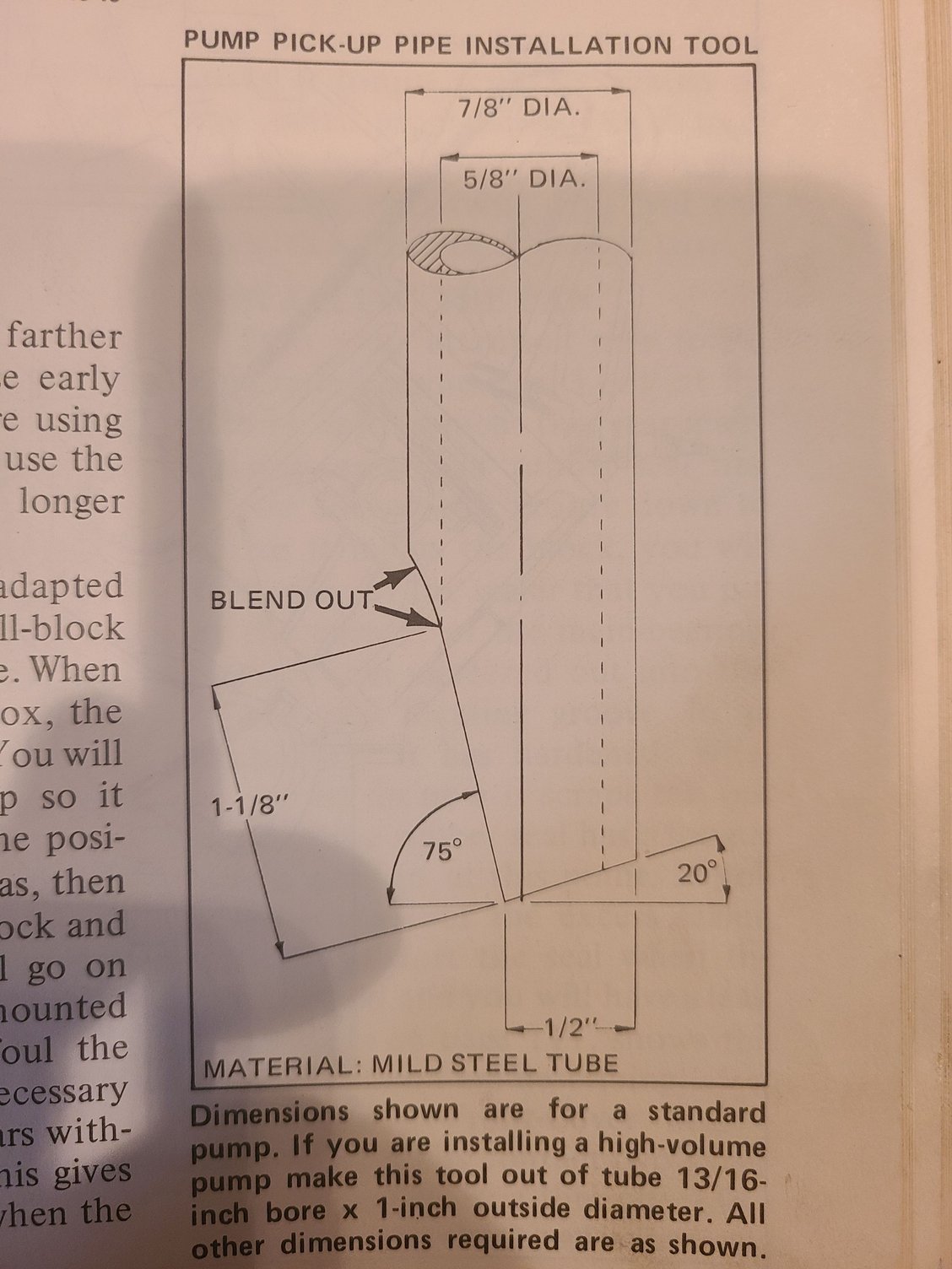

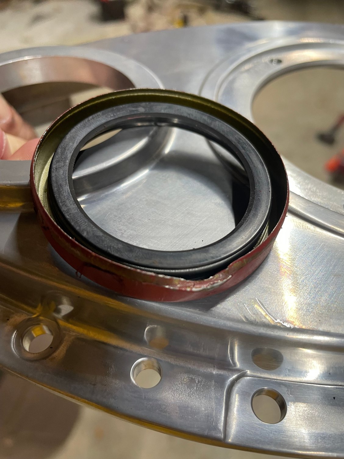

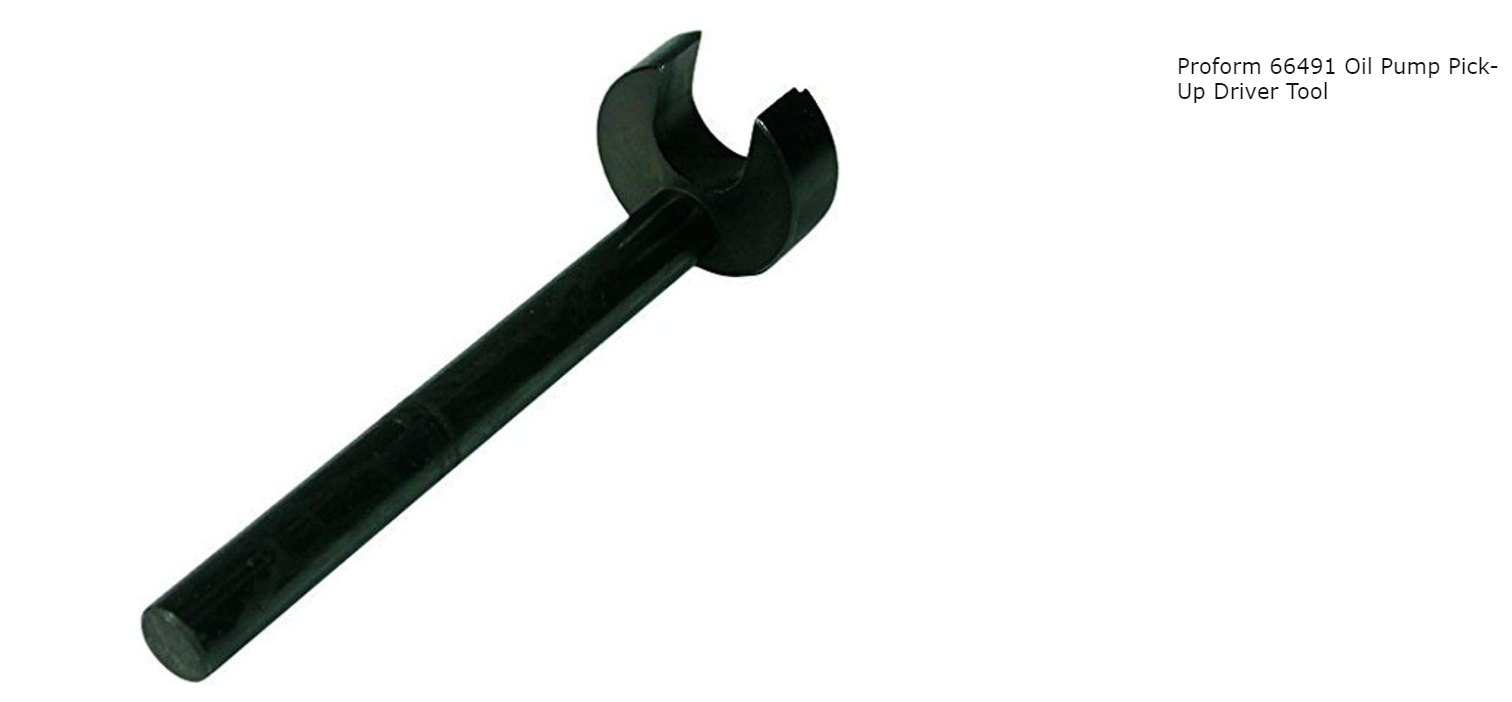

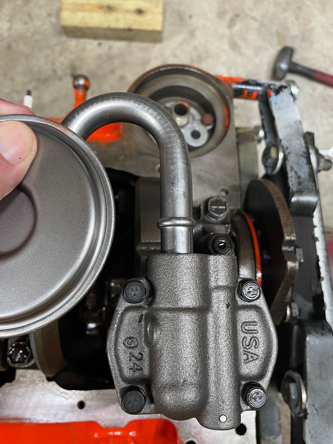

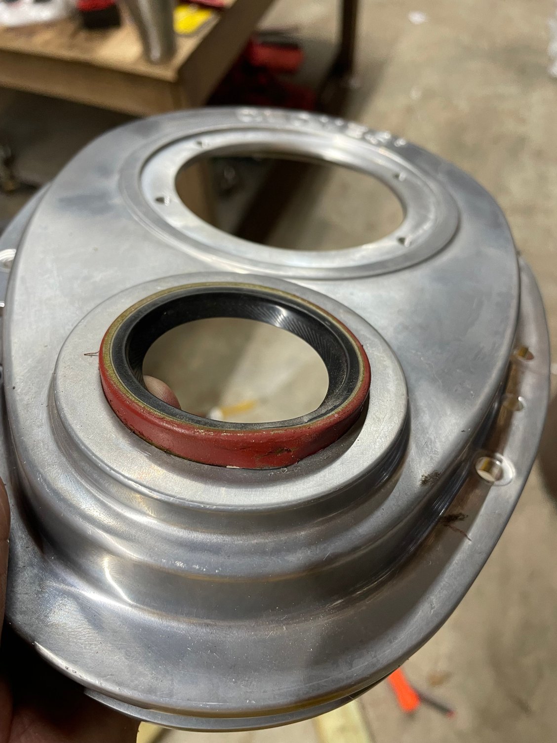

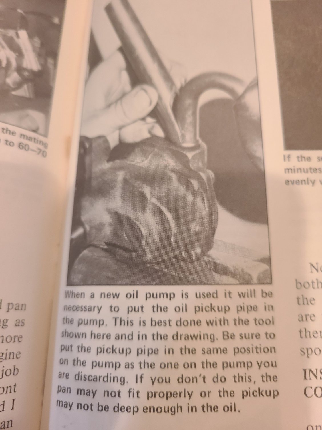

I went to wrap up some of the simple things left to do on my engine. of course they didn't go smooth ! New timing cover seal came in and I tried to install it: Once again it wouldn't go in straight, and damaged the seal! What in the world is going wrong with these seals?!
Then I went to install the oil pump pick up: it won't fit inside the oil pump! I kept trying to tap it with a dead blow, and it wouldn't go in.. It's obviously a press in fit, but it won't even start into the hole..

I actually use a "split collar" tool but this one can be fabbed up pretty easy. Its not the only way to do it.
I usually fit the pickup and then adjust the height (pivot the pickup up or down) so the bottom of the pickup is 3/8" from the bottom of the pan. Once that is established, you should drive out the roll pin holding the bypass spring and remove the valve out of the pump assembly before brazing the pickup to the pump.

As stated above by Stingr69, don’t forget to braze the pickup to the pump.
Go to the website for the cover and see if they list a specific seal for it
This makes sense for installation! I found this tool on amazon and ordered it:
Went and checked their website and it says nothing about an non standard seal.. So either my cover is out of round , or I'm cocking it wrong while installing it..

Well I had to order a special took to install my oil pump pick up, and another oil seal for my timing cover, so started installing the front suspension tonight:

The chassis and new suspension look great.
Are you installing the new seals in the timing chain cover that came off the old engine, or is it new?
Could there be an issue with the cover and not the seals?
If that’s a Crower or other aftermarket cover, you may want to call them and see if they recommend a certain seal, because in the picture you posted, that seal doesn’t look like it will fit.

It's new OEM seals on a brand new Cloyes cover - suspicious it could be out of round too. I searched their site, but going to call their tech line tomorrow before I try to put this third new seal in!

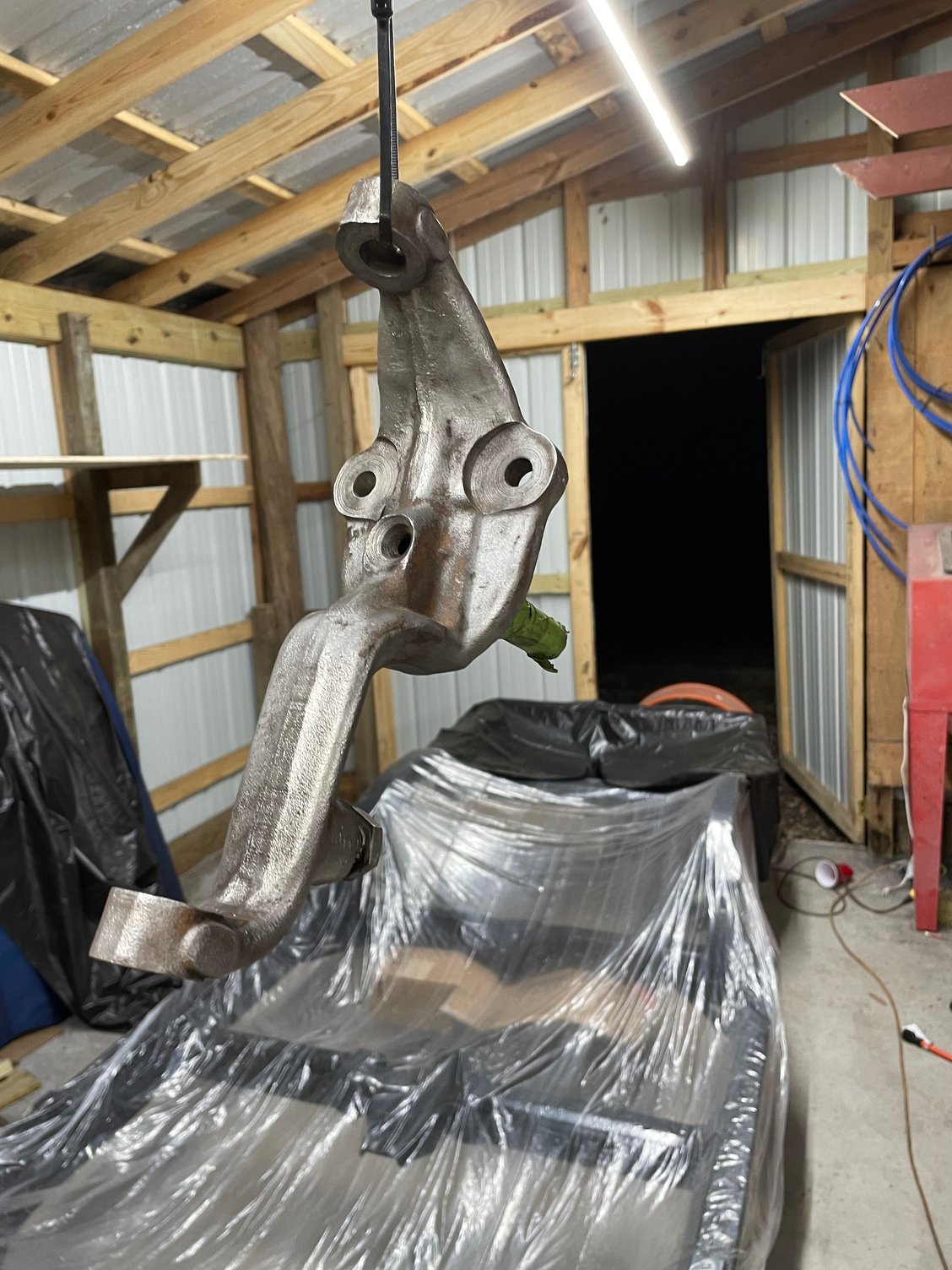

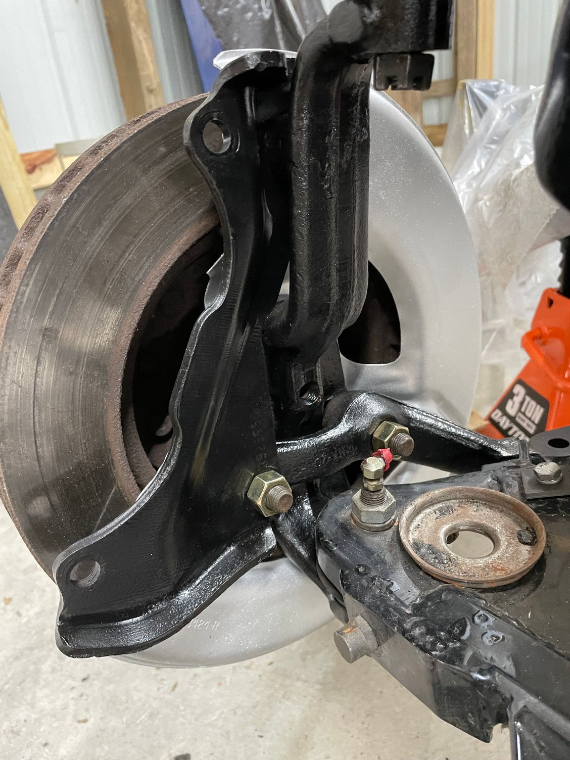

Still waiting on stuff for engine, so tonight was another chassis night:

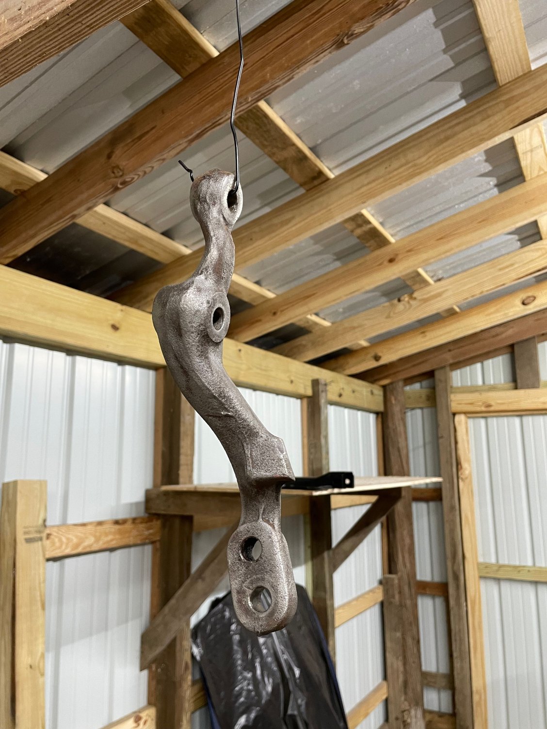

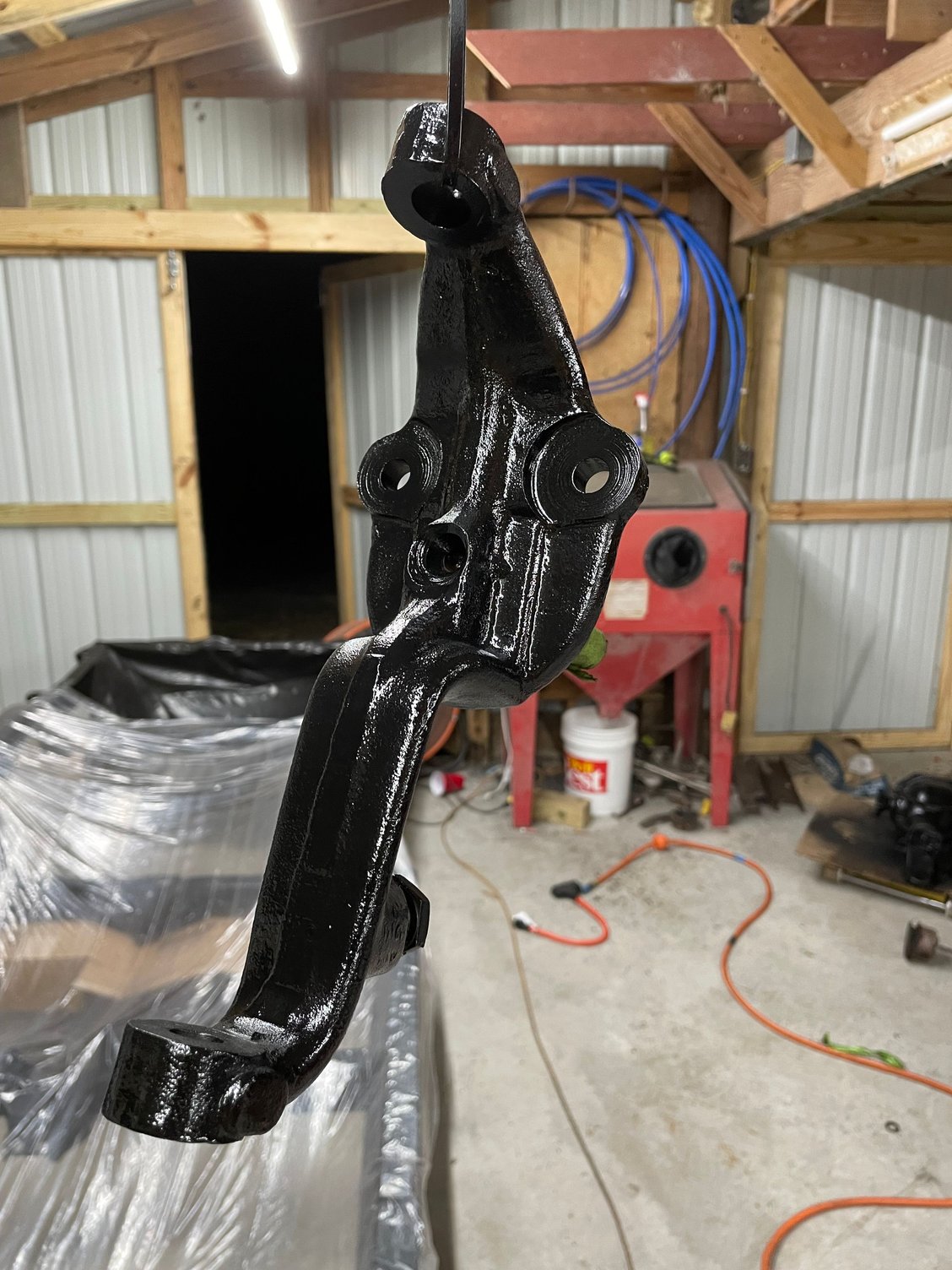

Installed passenger side spindle, and got some new grade 8 bolts on it. came out nice!

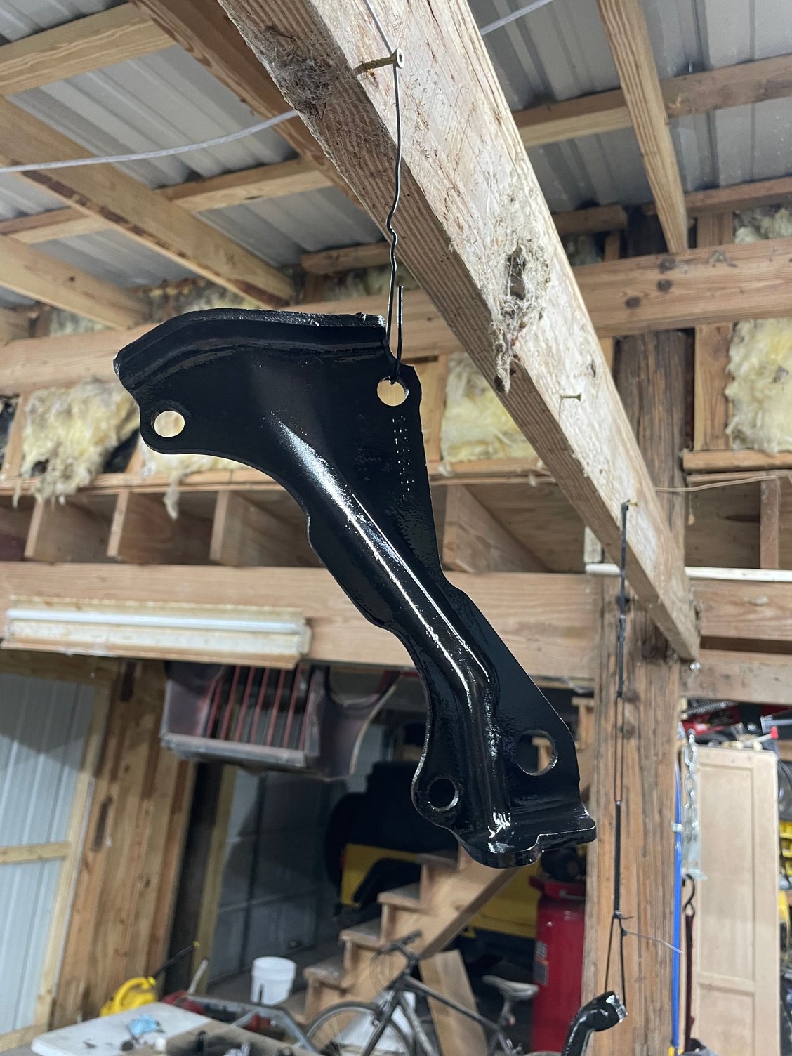

Then I cleaned up the driver side so I could get it painted tonight. I found a wire wheel first to get the baked on crud off before the blast cabinet is a big time saver to get these parts stripped down. Then clean them with brake cleaner and it's a nice surface for the paint.
And work that rattle can magic

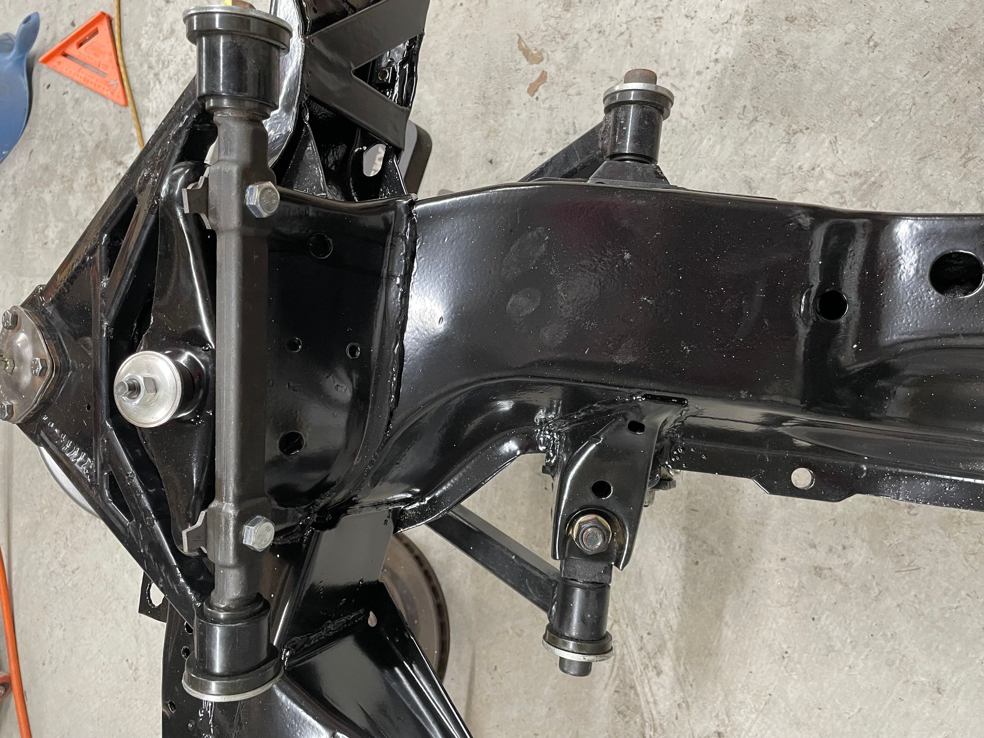

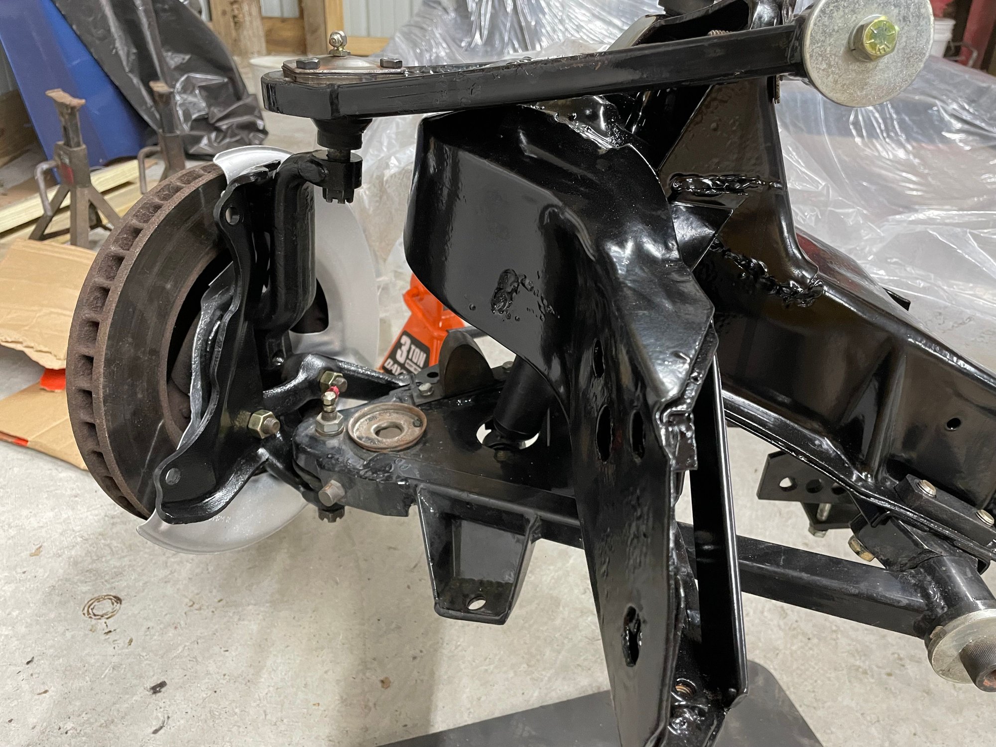

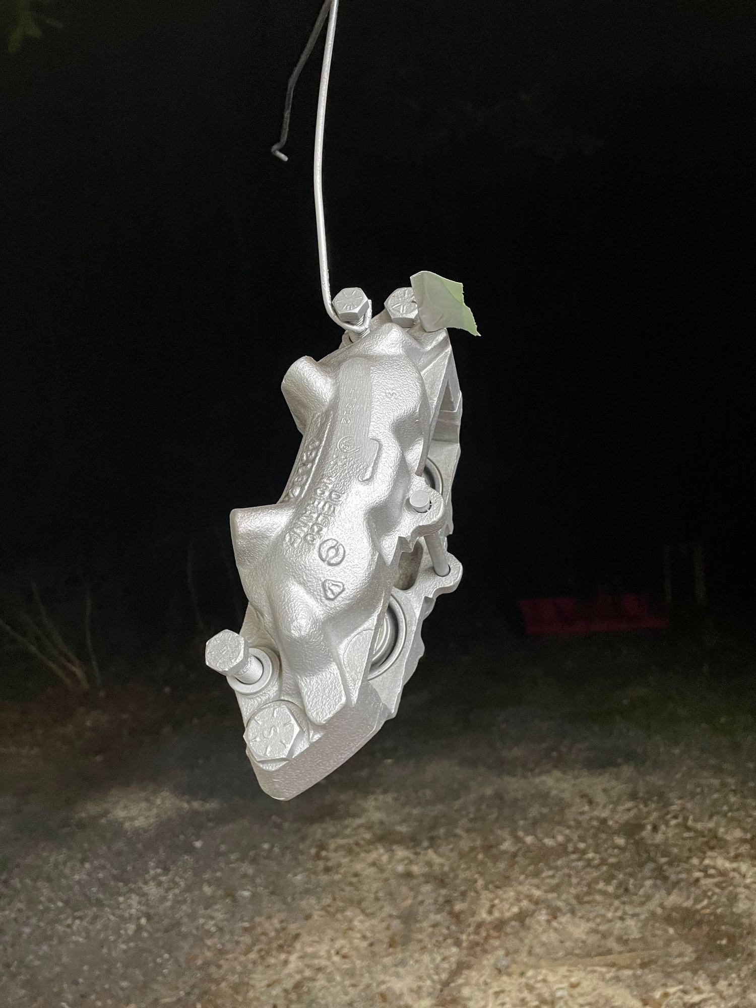

Driver's side spindle was dried today, so I could assemble it and finish the other side of the front suspension. I do need to re-grease my wheel bearings - any tips on that procedure?
I'm loving having a full set up of new hardware in my shop: Put fresh nuts and bolts on the top A arm and, mostly everything else. I took all the alignment shims, blasted them, soaked in WD40, then put them in place. Everything is so fresh and so clean!
Next was to finally clean up, blast, and paint the front calipers. I put them in the blast cabinet, and they were pretty easily to get any rust removed and cleaned up. I then thoroughly cleaned with brake cleaner, blew out with high pressure air, then paint time! I used VHT Brake caliper paint in silver, and it laid down easily with great results:

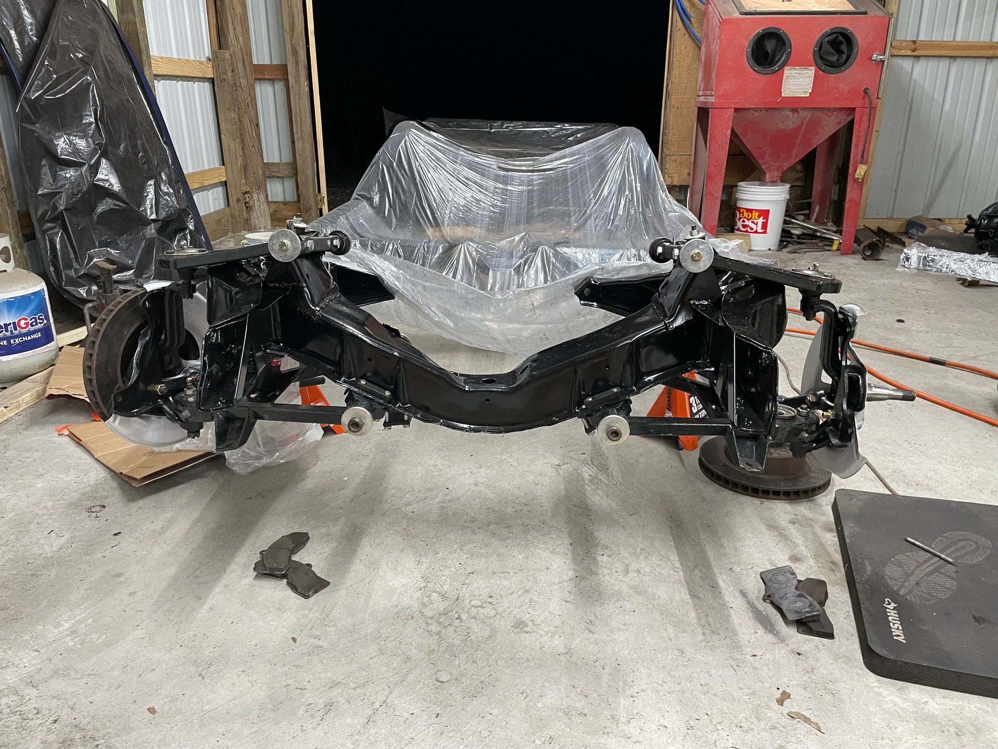

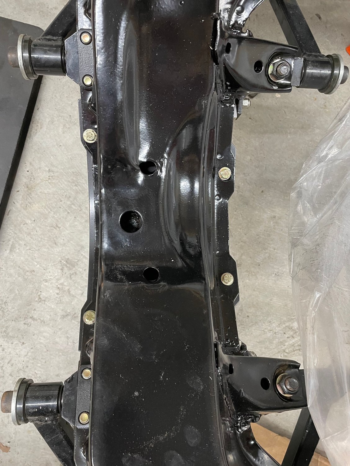

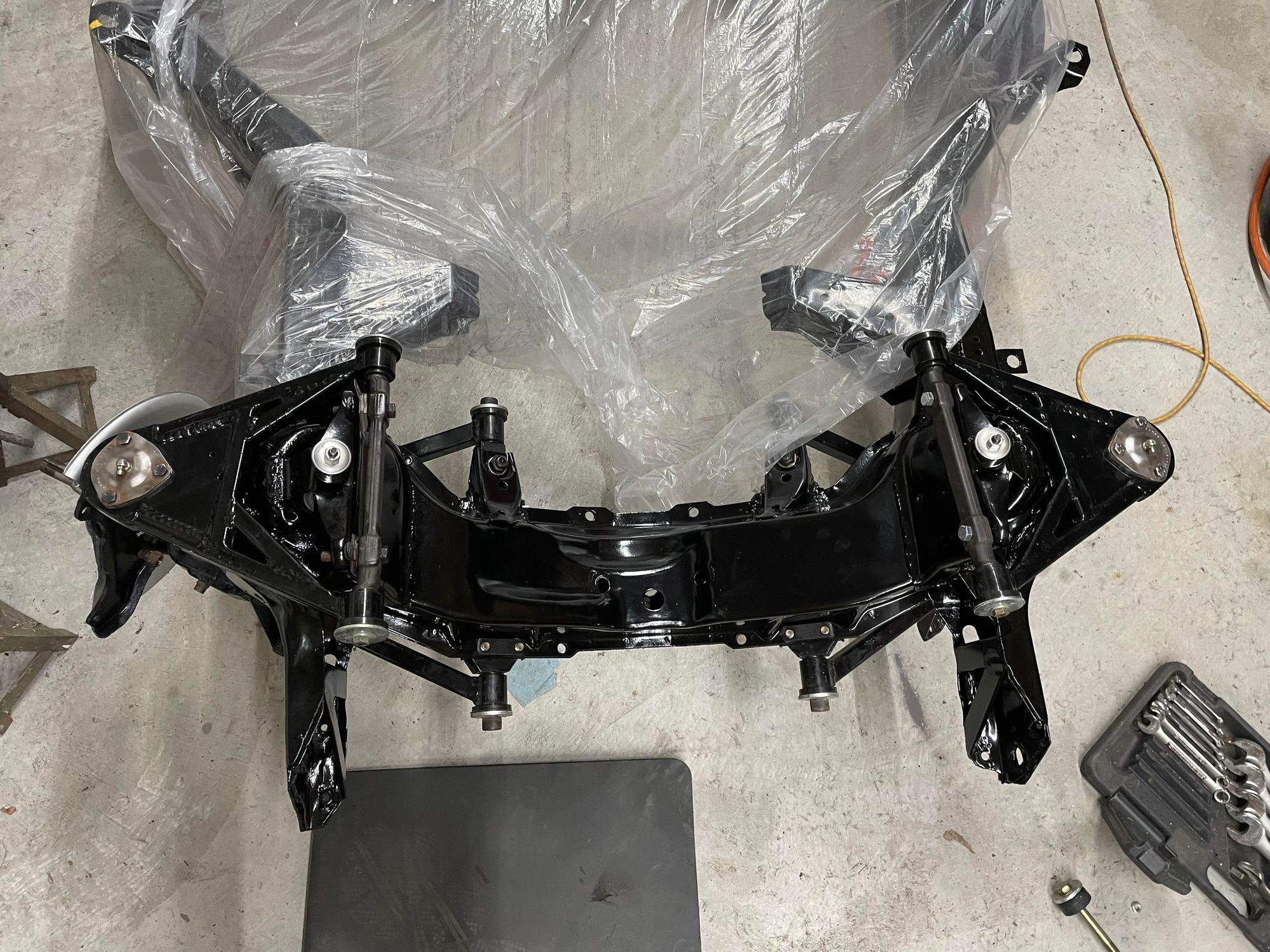

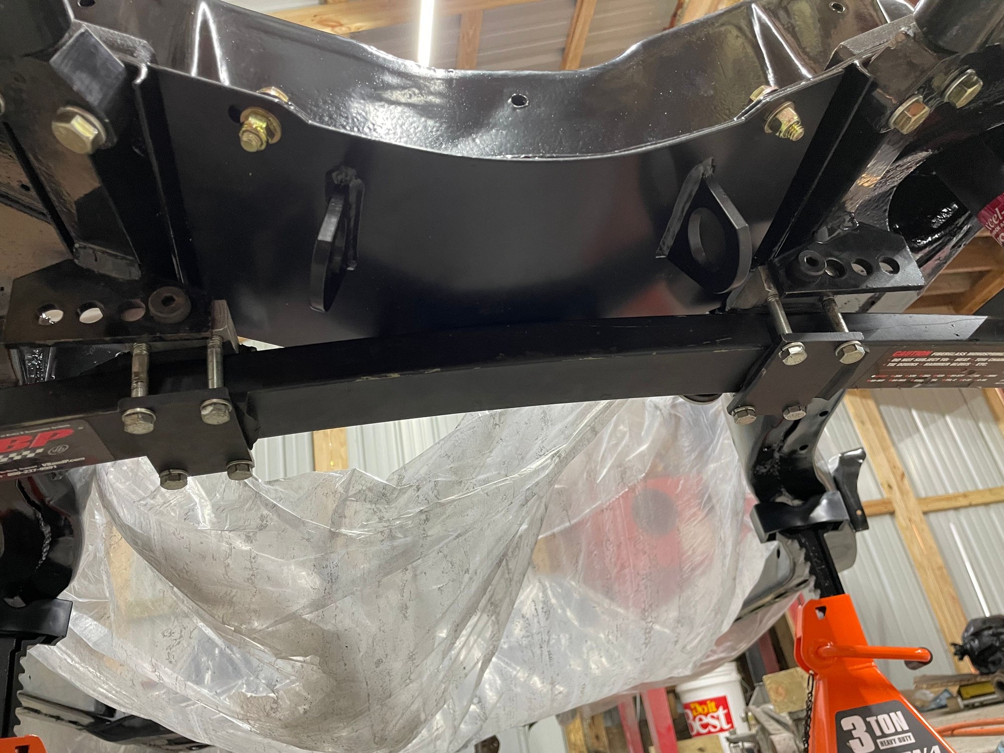

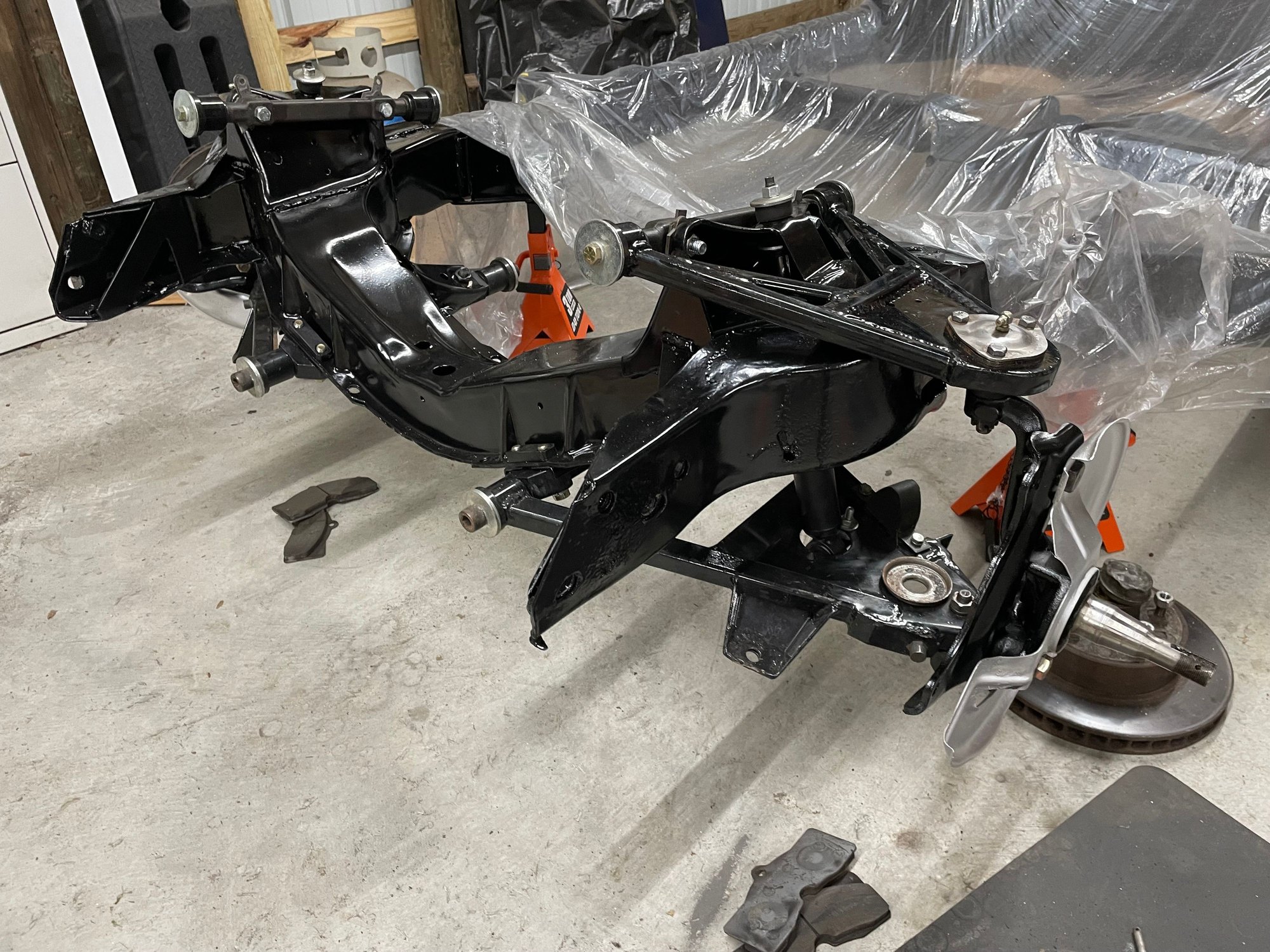

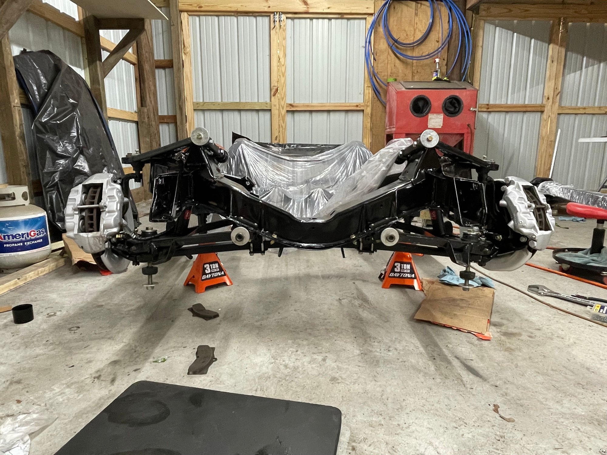

Got my front suspension completed: wheel bearings packed, and brakes on. Are the brake hoses on the front calipers supposed to be oriented up or down?
Nothing prettier than Grade 8 bolts on fresh powder coat
New Front cross member installed: love the look, and tow hooks are a nice touch!
