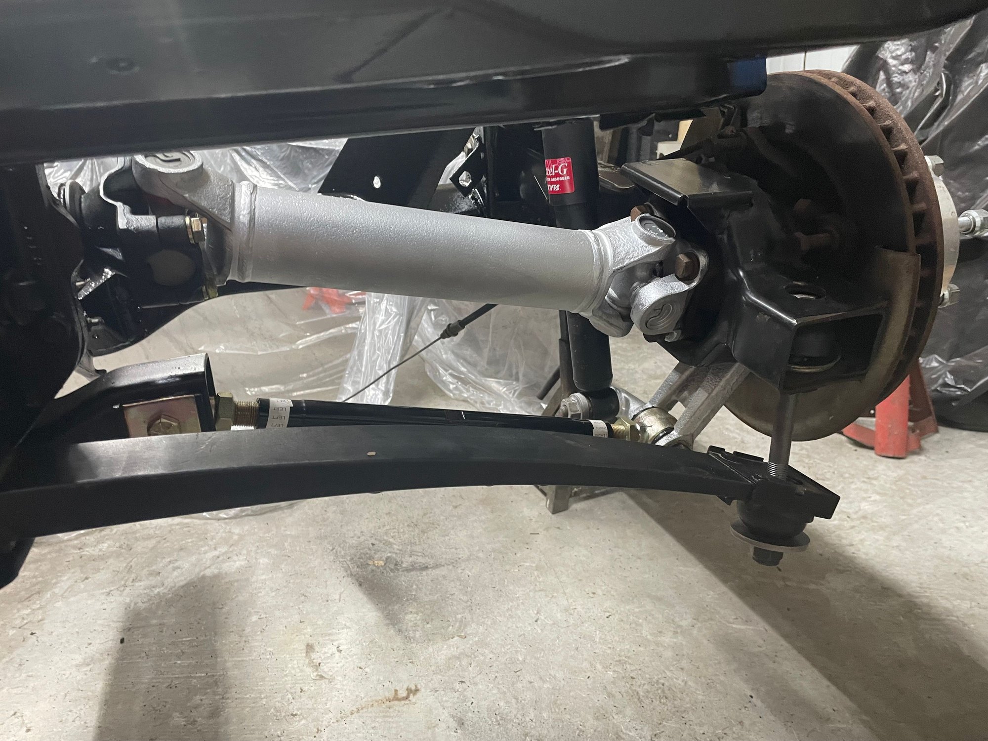

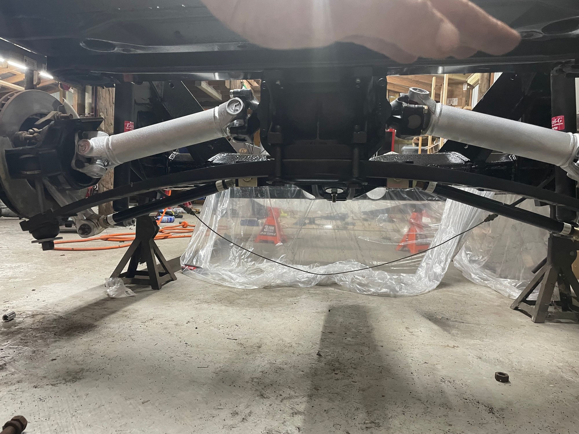

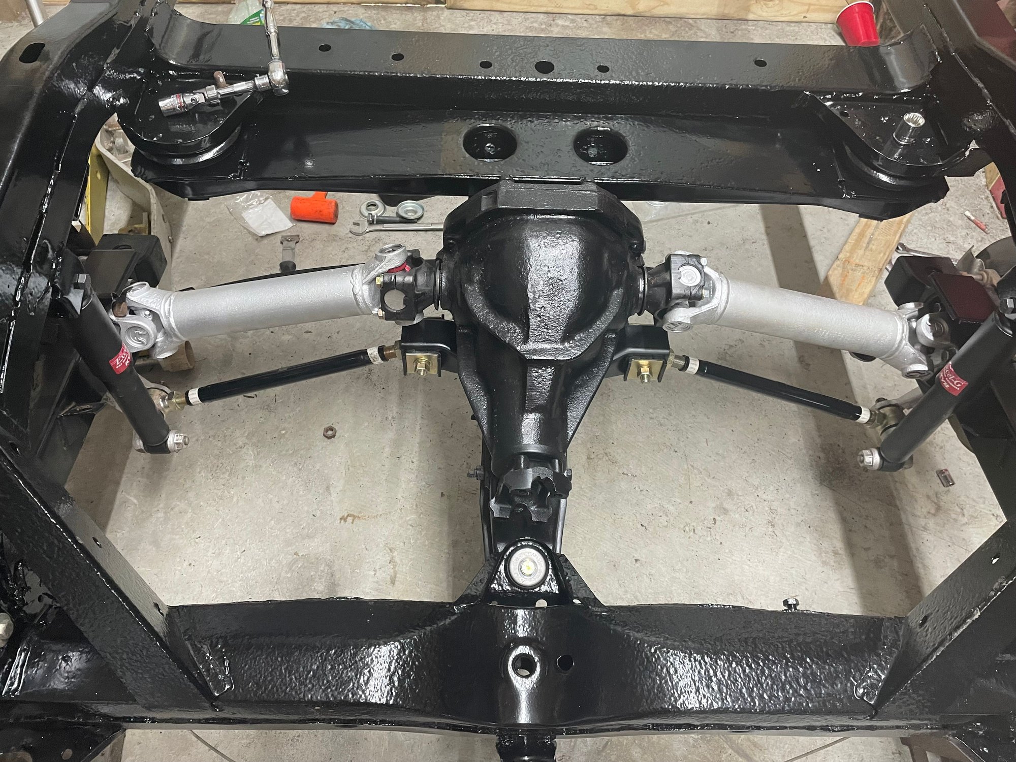

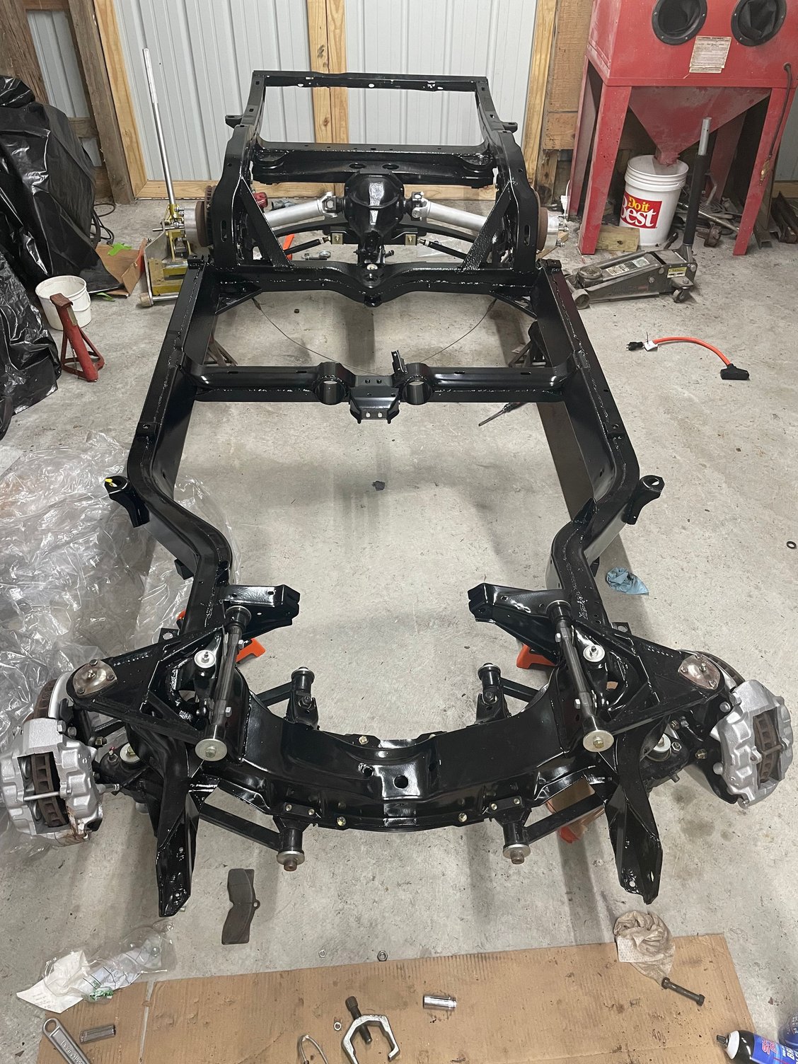

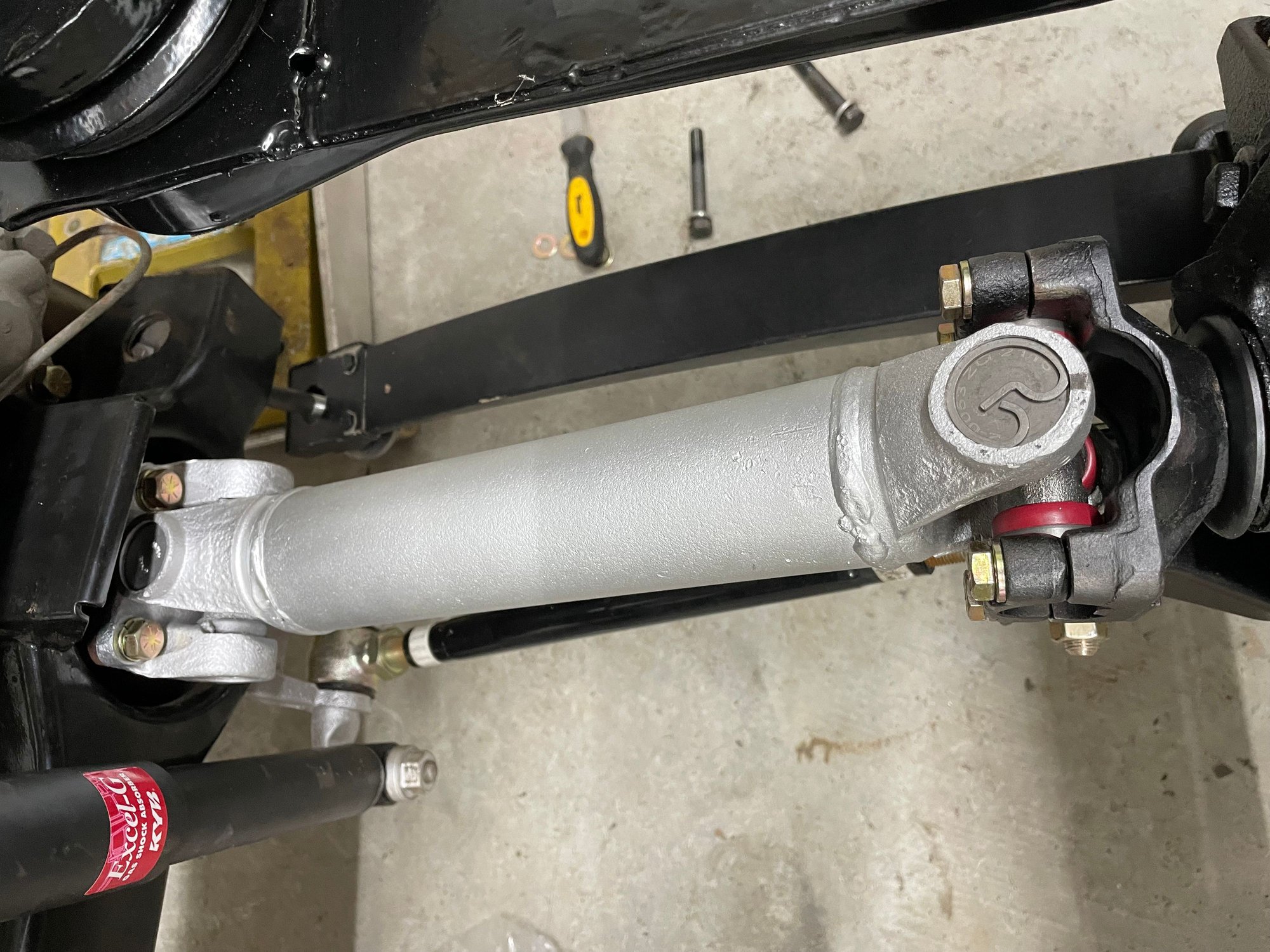

Got to finish the rear suspension tonight: struts, half shafts, and VBP glass spring all installed:

Man, your chassis is looking professionally done!
Good work!

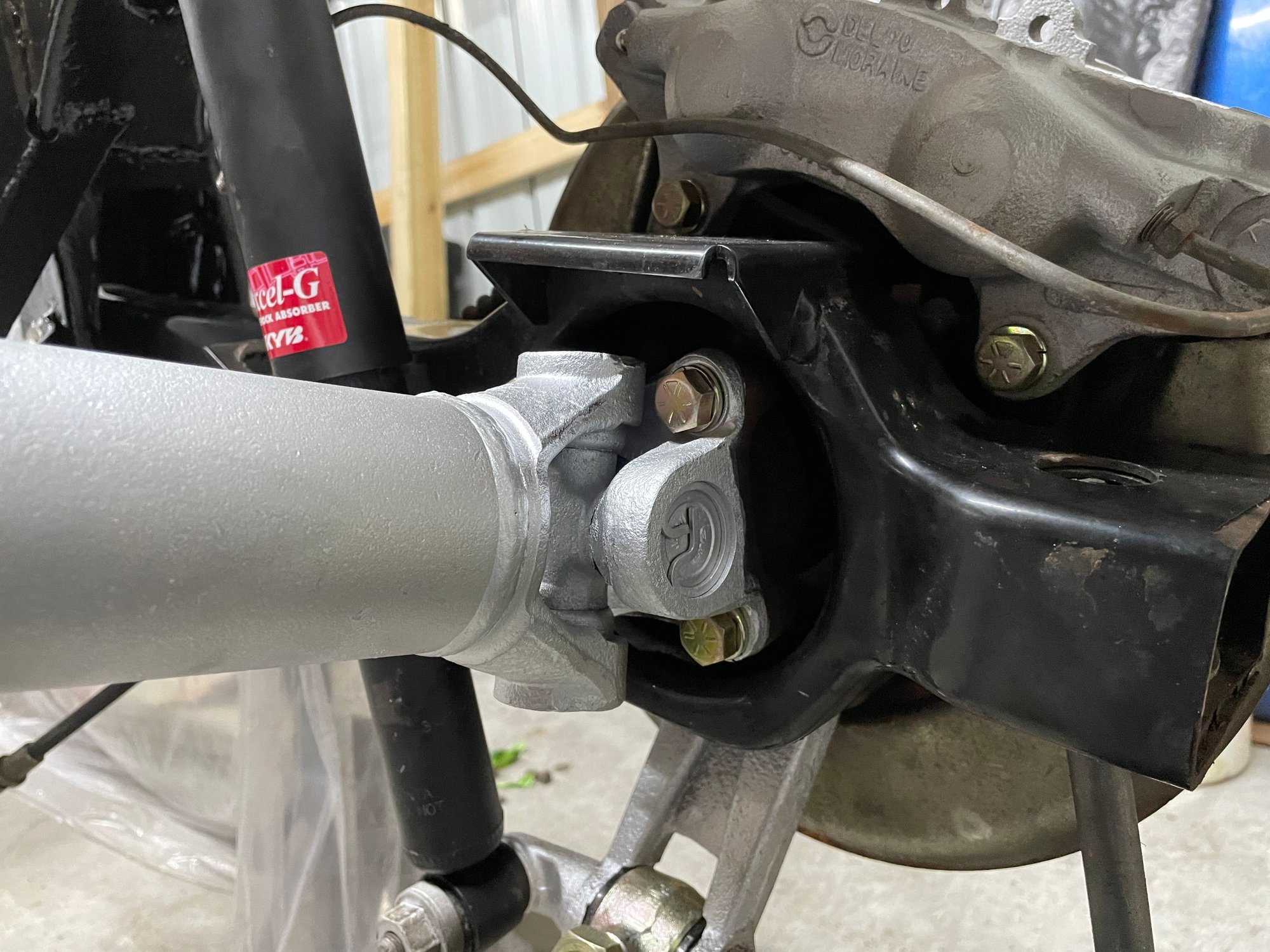

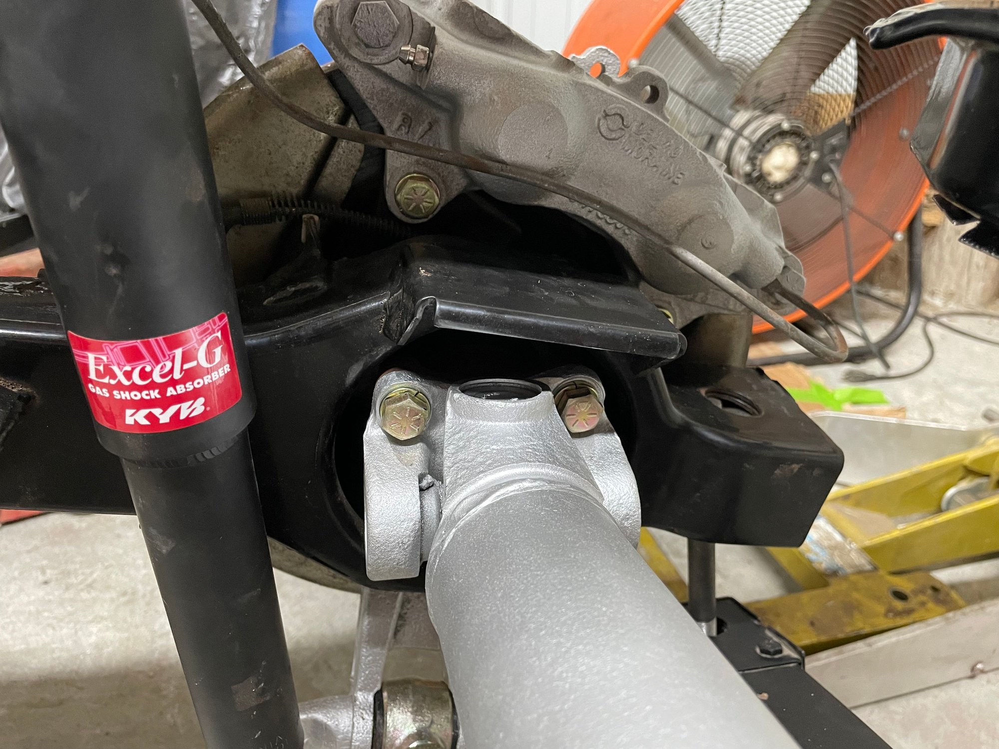

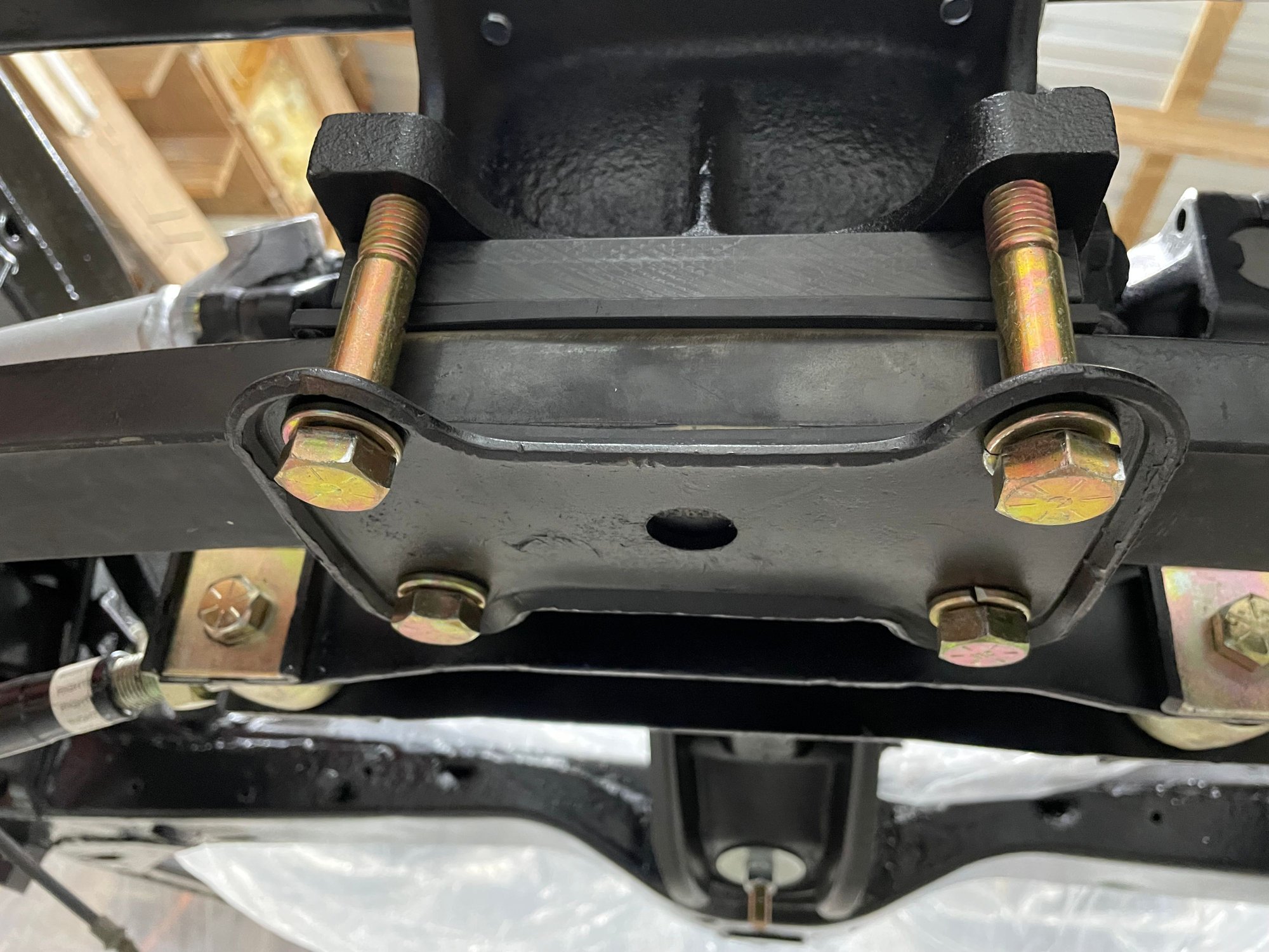

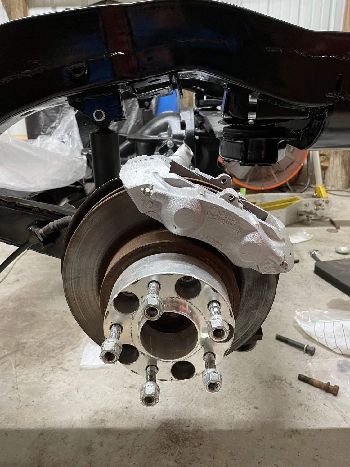

Sand blasted and painted my rear calipers last night, so I could install them today : big improvement! One thing that bothered me last night is the half shaft and brake caliper bolts were rusted - that ain't gonna fly here! I went and got some pretty grade 8's: both of these were 7/16 - 20 fine thread bolts .
Another issue that came up last night was the spring plate bolts: I ordered reproductions, but they were an inch longer than my stock bolts, and wouldn't fit in the front of the diff! So I set out to get some replacements at my local hardware store that has three isles of bolts! These were a 9/16" bolt, and they only had them in grade 8... Which was about $4/bolt!!!! But the gold contract on the black is amazing:
