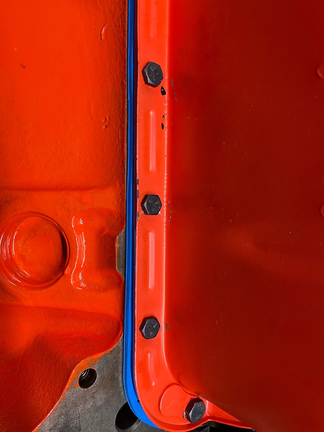

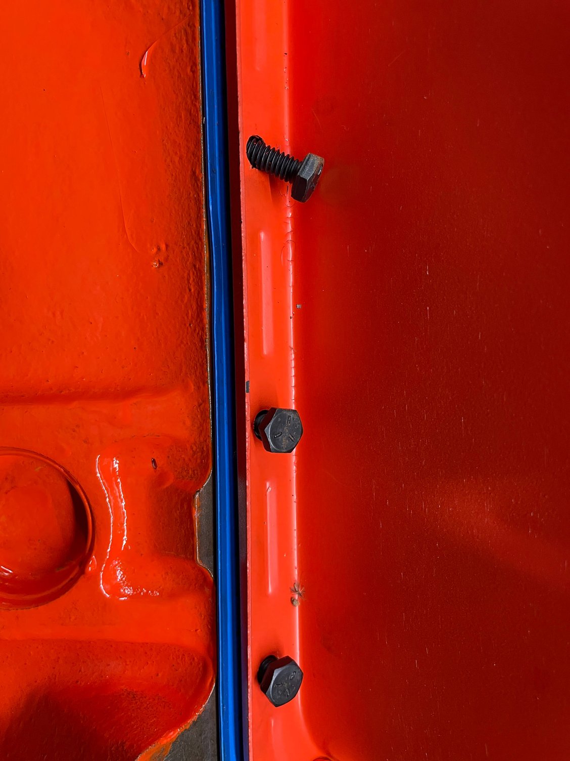

Well now the boat has a clean bill of health, it's time for me to catch back up on my other Stingray. Tonight I worked on some details that I needed to finish on the SBC so it could be completed. Some of the bolt holes in the oil pan didn't line up and needed to be wallowed out (others had to do this in the reviews I read too). I pulled the pan, and made some small enlargements with my dremel so it would fit and seal properly.
bolts not lining up
After holes enlarged and bolts torqued down

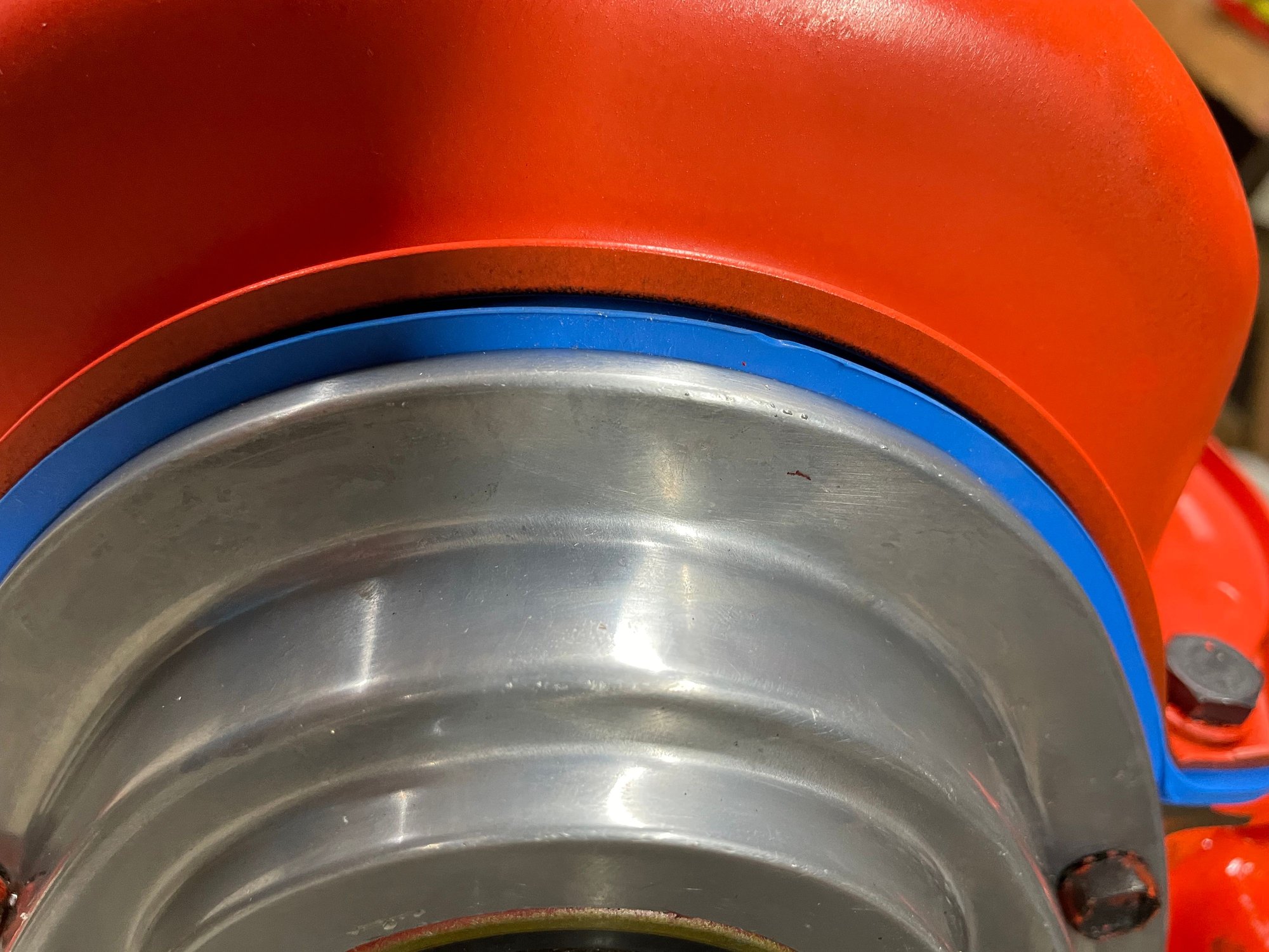

Don't like this gap between the seal and pan - what say you?

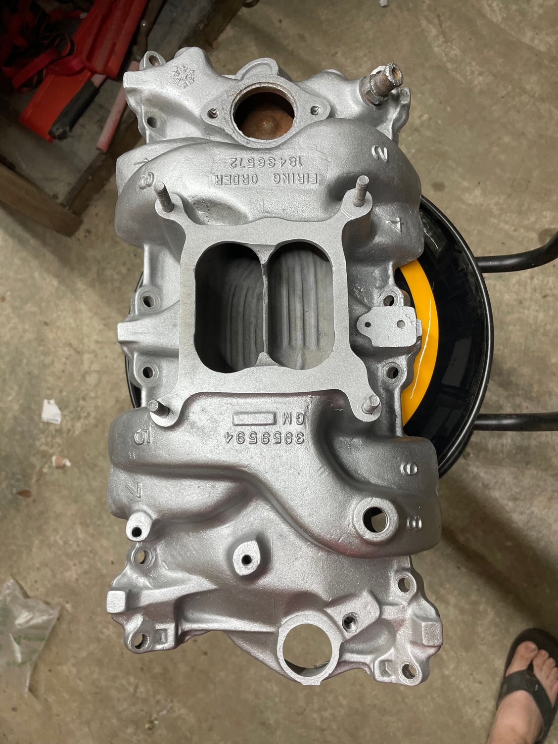

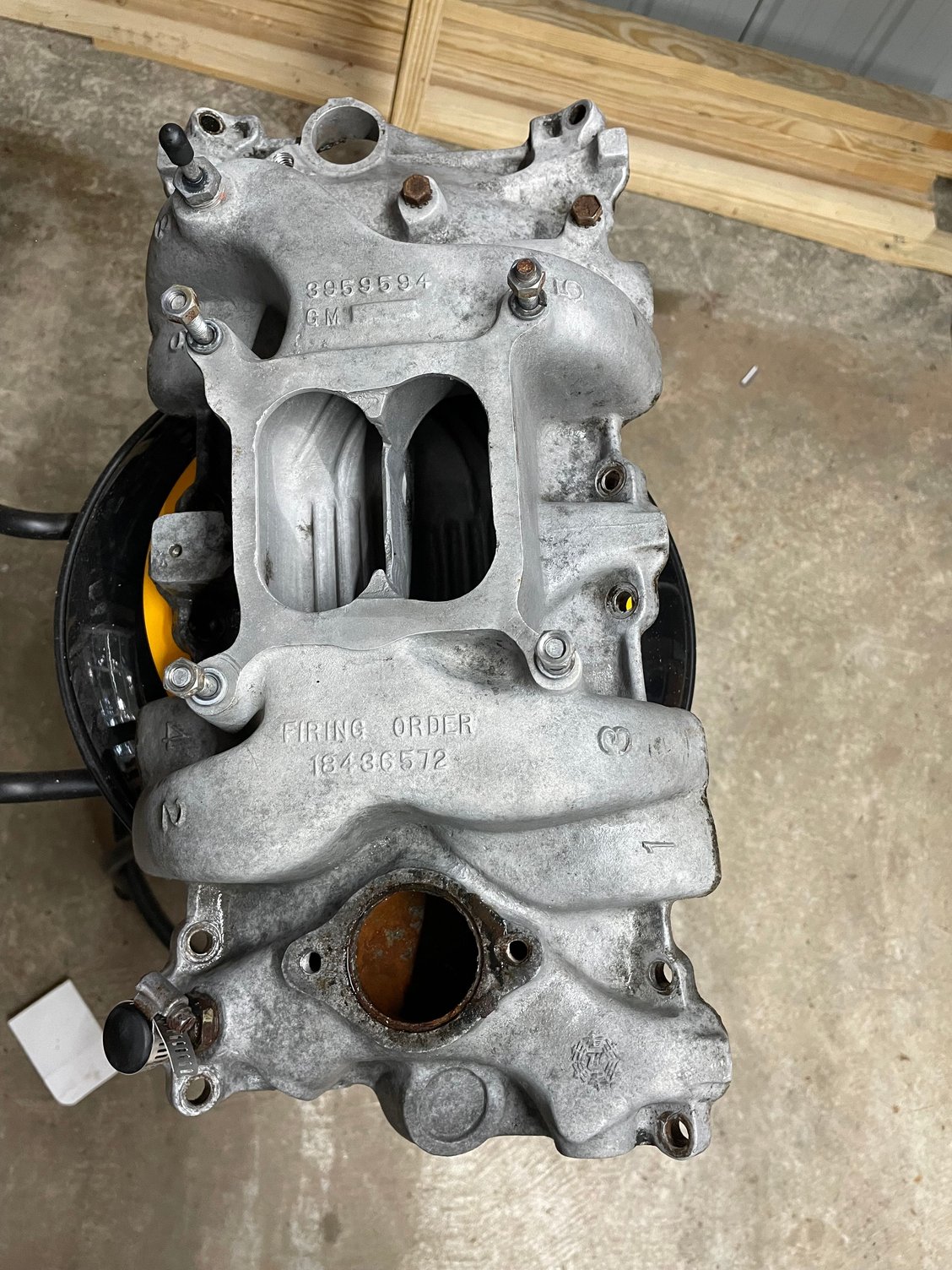

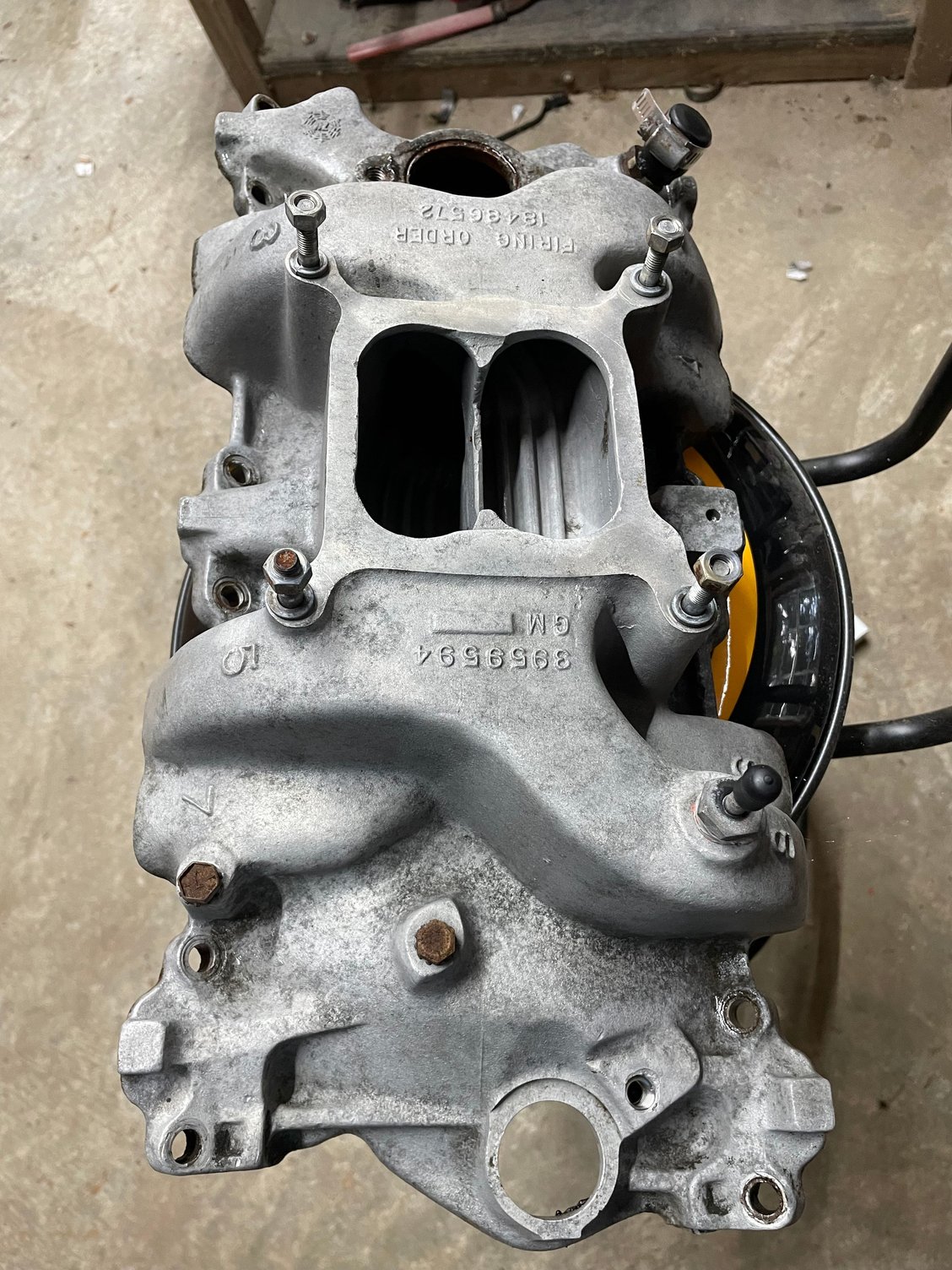

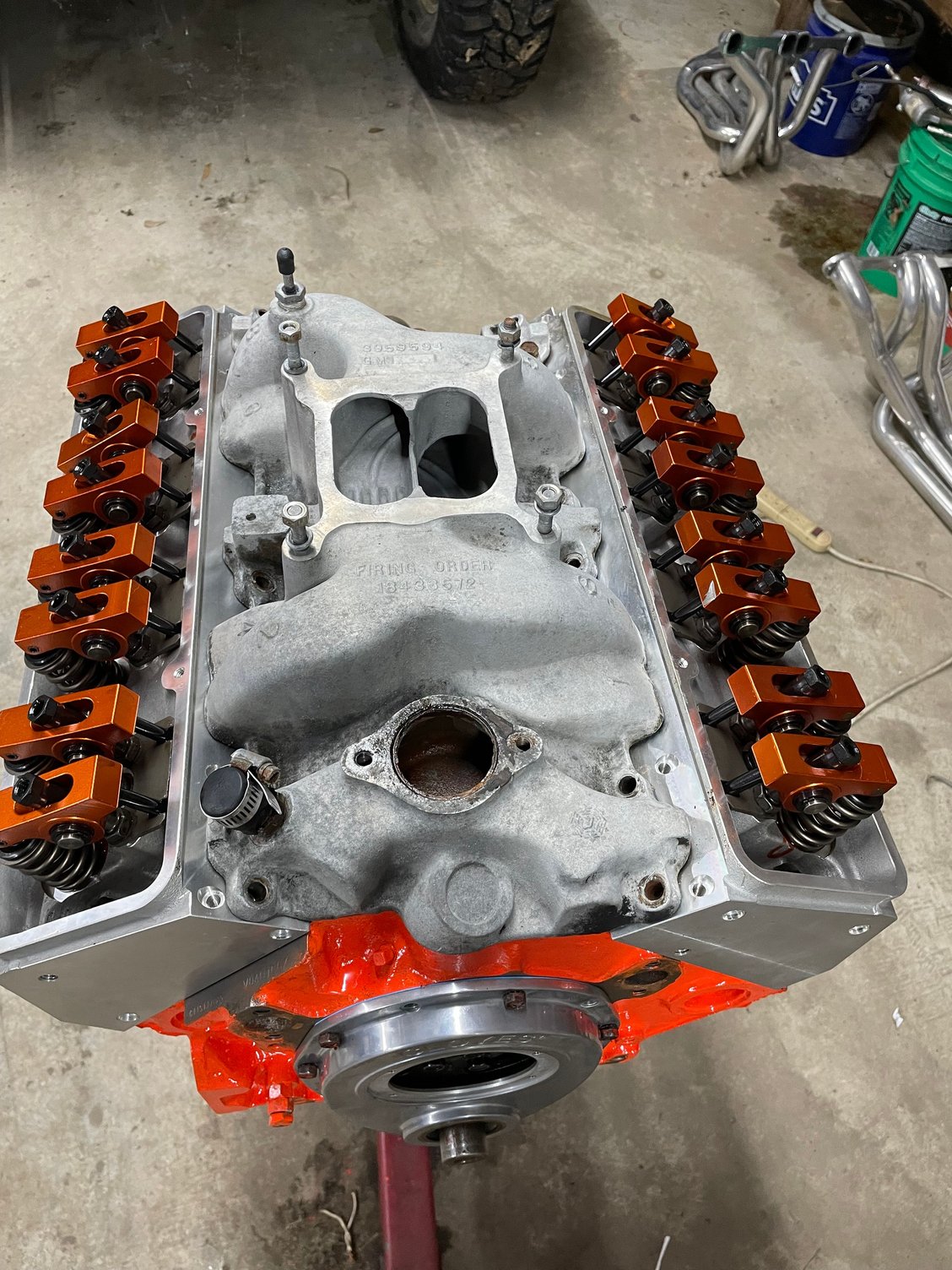

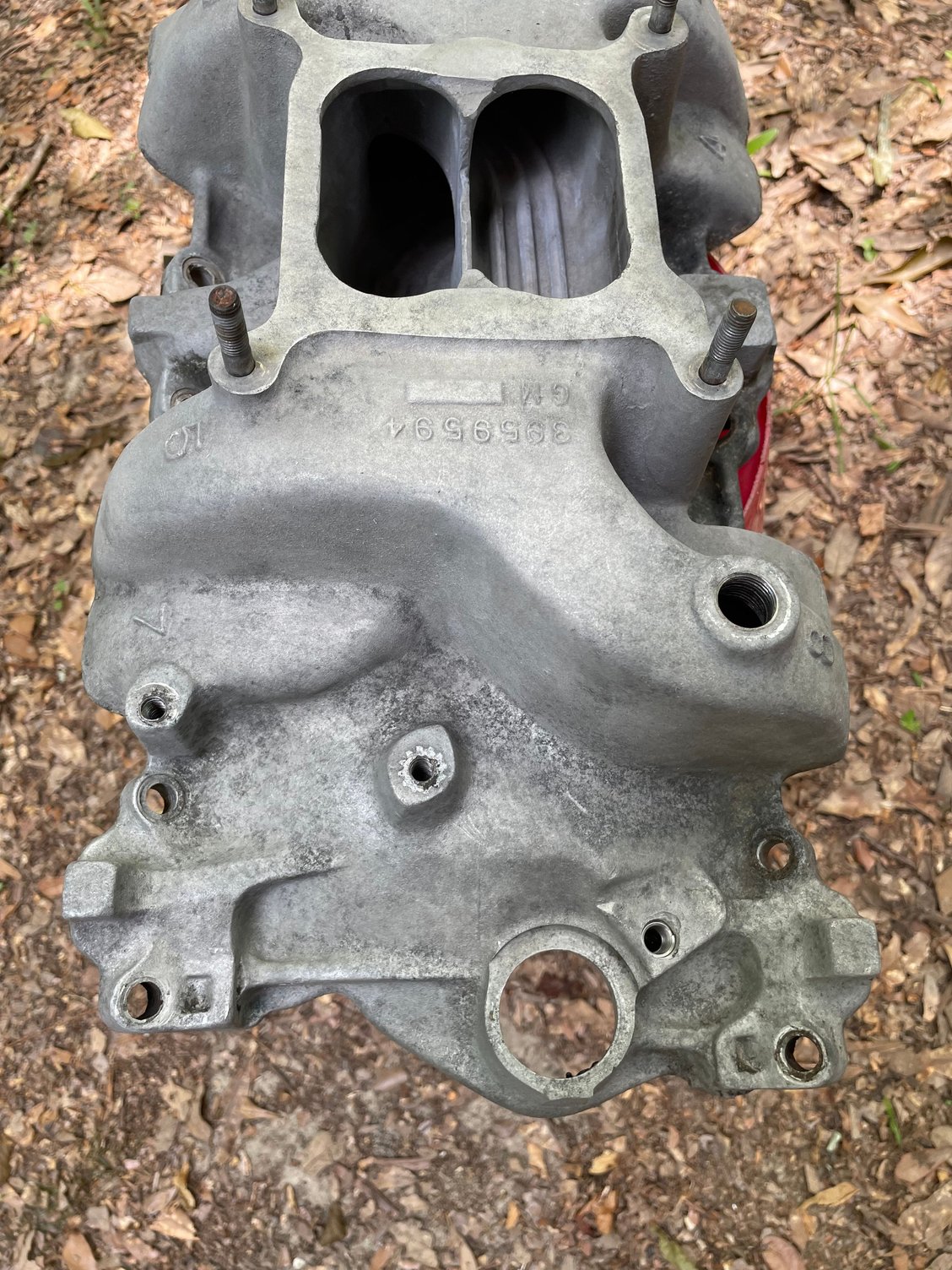

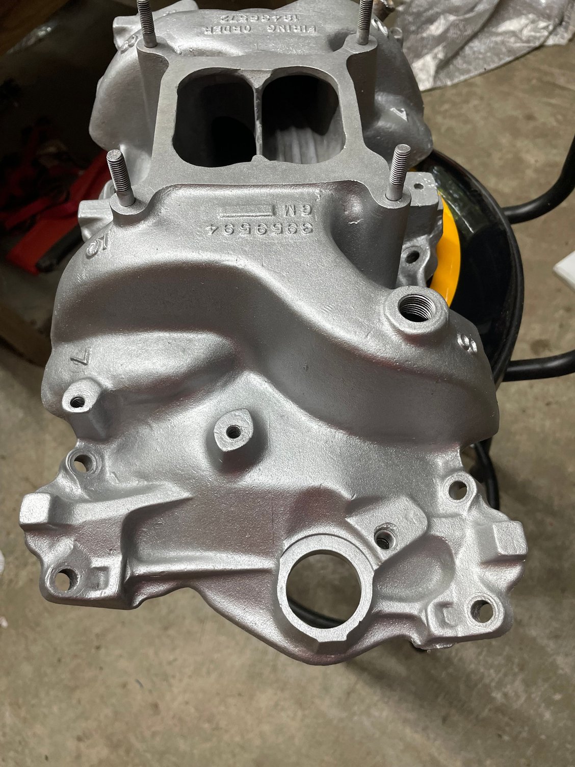

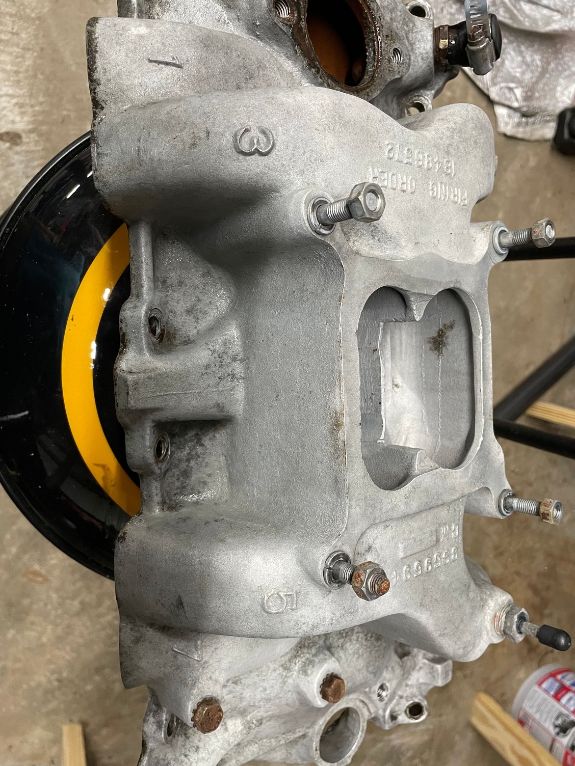

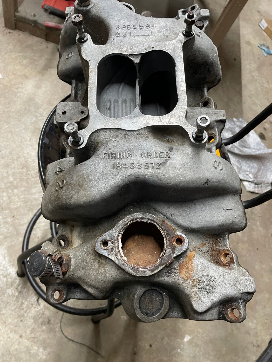

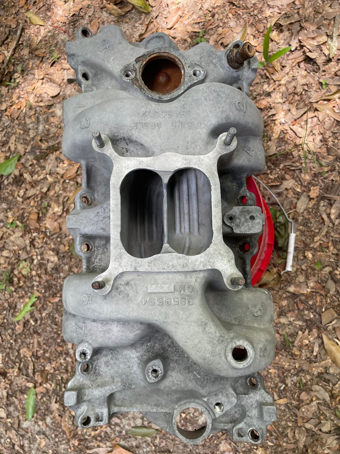

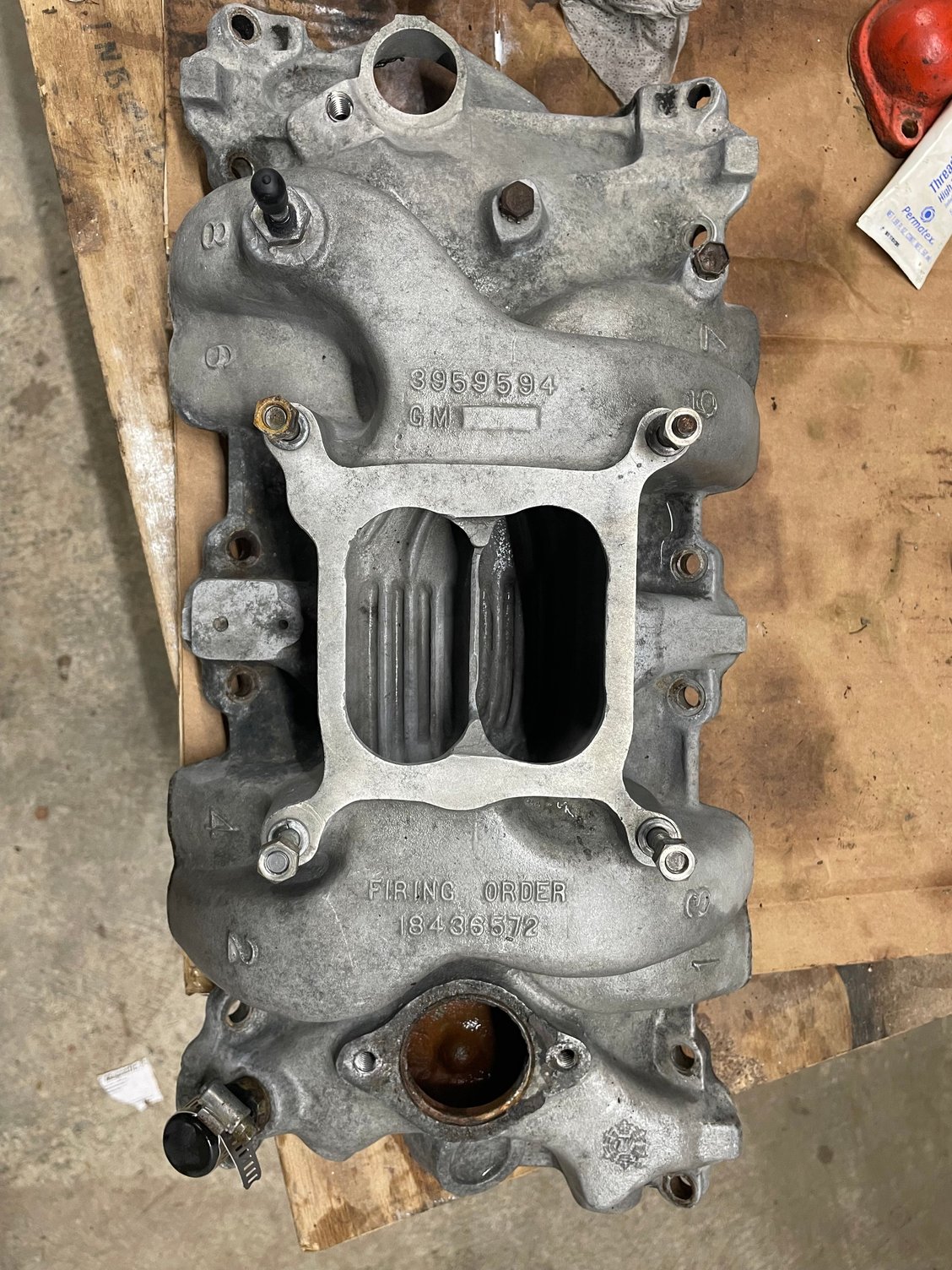

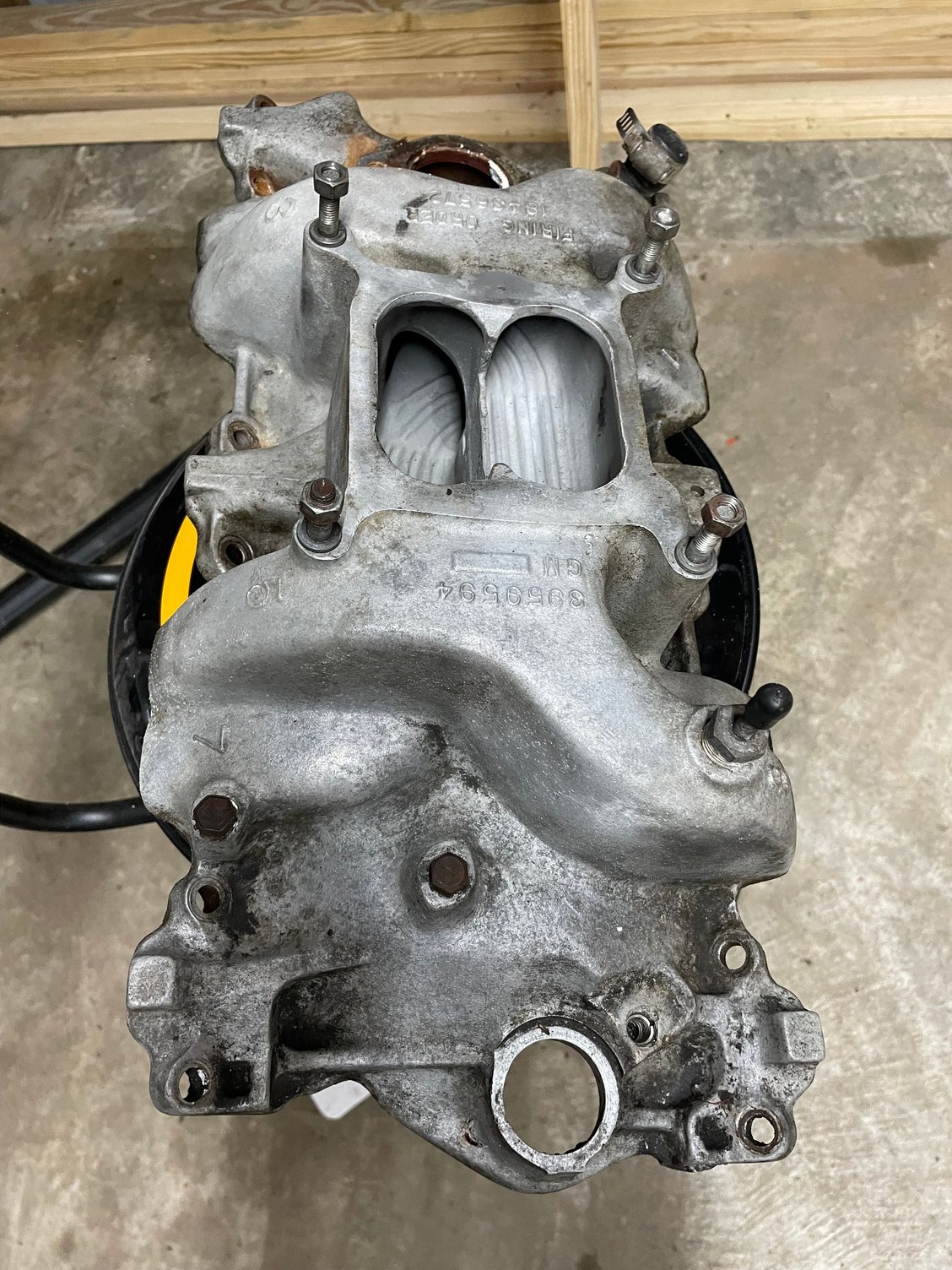

Next job this evening was to work on getting the original Winters intake cleaned up so I could install it. I had already degreased it, but had ordered a product called "AlumaBright" to attempt to get it looking much nicer.
Here's some before pics of the intake:
I followed the instructions on the Aluma Bright, diluted with water at 1:1, and the sprayed it all over the manifold and let it soak for a minute, followed by a rinse and pressure washing. Below are the results after three treatments:
While it's a big improvement, it's certainly not restored and as good as I'd like it. I might try some more, while working it with a brass brush to see if I can get it better. Any other suggestions? Worst case scenario I could always send it to the powder coater - but it just won't look quite the same as original, but would be super clean!
Below is what it looks like on the engine currently:
bolts not lining up
Wrong oil pan seal. They changed the pan gap abot 1975 and newer i believe. I found that out the hard way as well on a expensive Aftermarket pan

I wouldnt dilute it that much. I bought some air craft aluminum cleaner and kept it pretty potent and soaked my wheels in a garbage can of it. Did a L71 intake that way as well. Dont use a brass brush unless its a very soft brass brush. Most are steel with a brass coating.
Old Jun 7, 2023 | 07:30 AM
  #645
toylman's Avatar
toylman
Joined: Dec 2006
Posts: 979
Likes: 254
From: Bethlehem, PA
Default intake manifold
Use Eagle one raw aluminum mag wheel cleaner. Wheel Cleaner, Etching MAG EGO E1TMG23 | Buy Online - NAPA Auto Parts (napaonline.com)

Rescue is correct, and I would put some washers under those pan bolts.
Well this makes sense! Easy fix! Thanks!

On your intake manifold, I would just paint it with duplicolor cast aluminum engine paint. It resists stains much better than bare aluminum, and is durable enough. That is what I have on this intake below.
Man your engine looks fantastic! I like this idea, now I have the intake completely cleaned and stripped down, this is an easy solution to make it look perfect. Going to have to try this out!

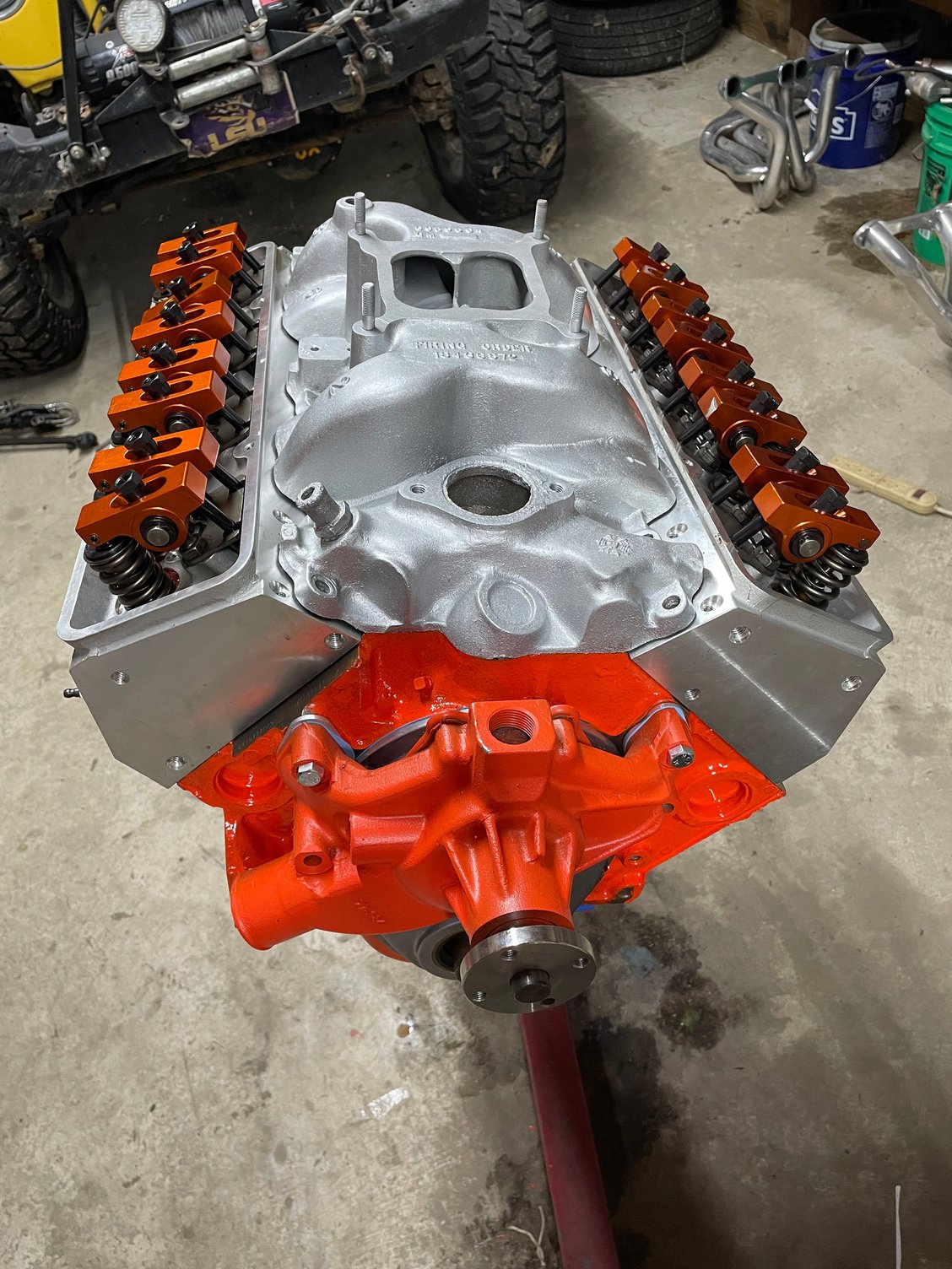

Well I tried one more attmept with the Aluma Bright, and didn't dilute it this time: barely any difference from what I did last night. Below is where we sit after the treatment tonight . I do like the above idea to use cast aluminum paint, and I'm going to try it out if I can find some locally.

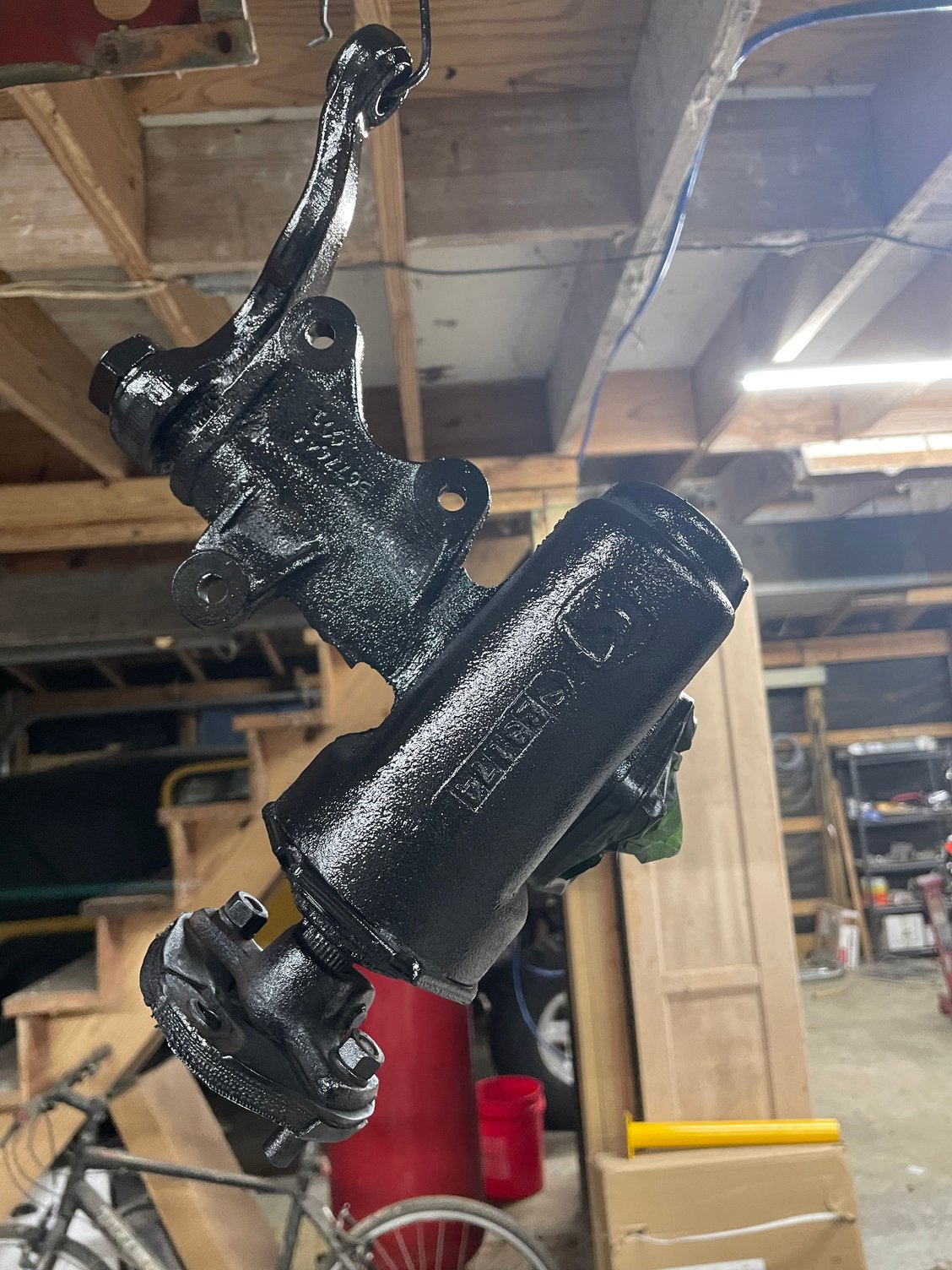

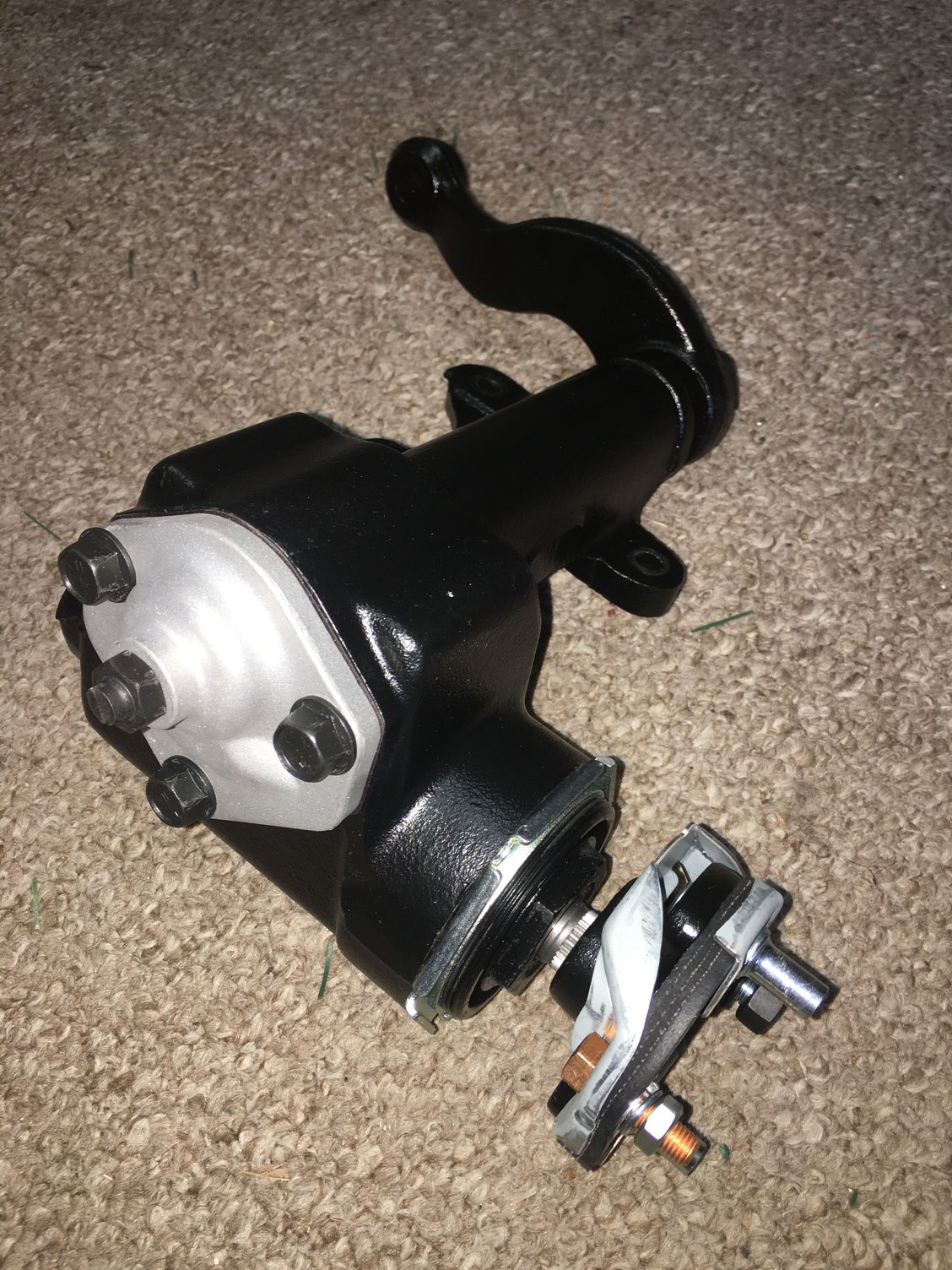

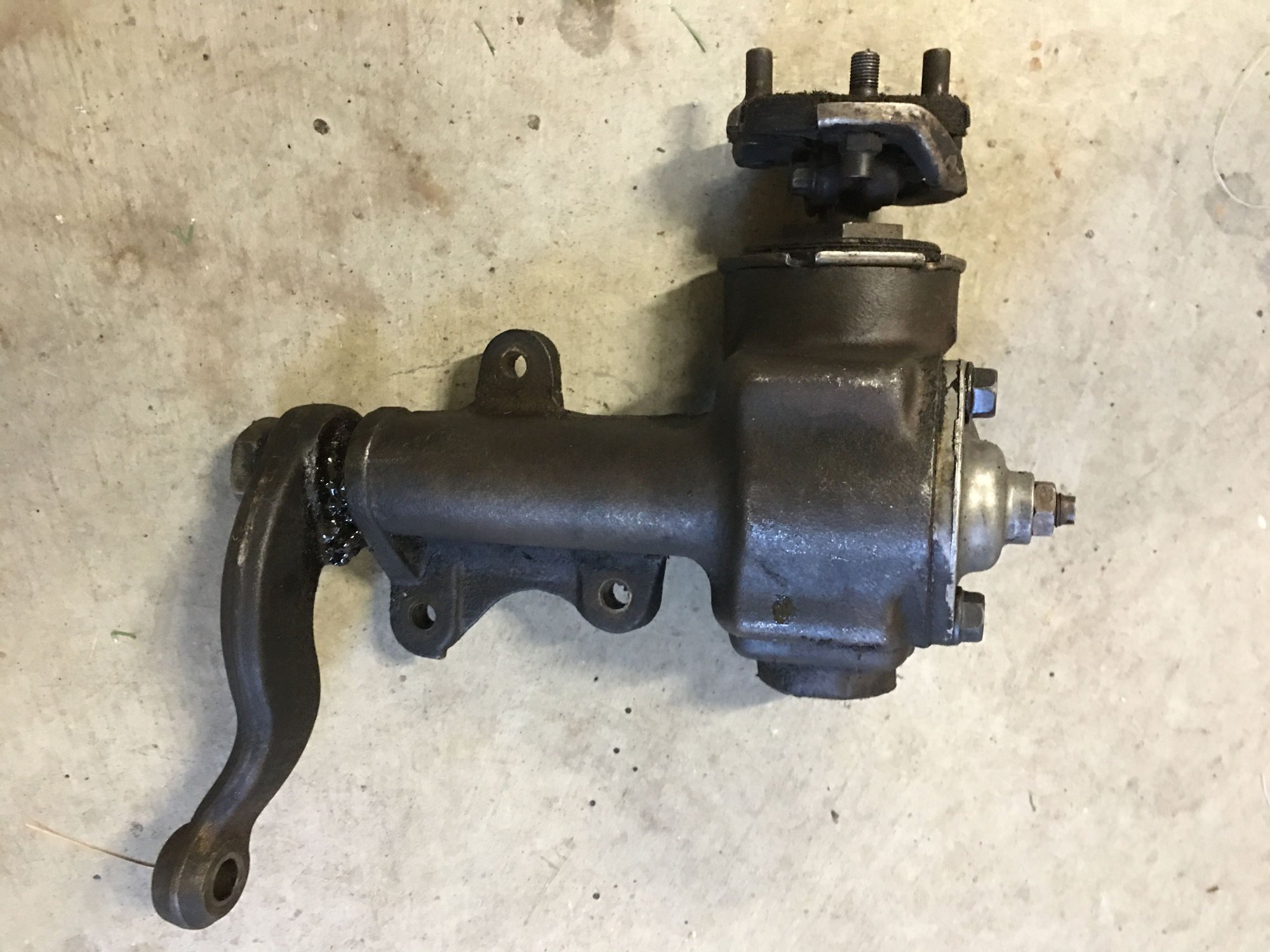

Next part I decided to mess with was the steering box. It spent a lot of time in the parts washer with a metal brush to get all the grease and gunk off, but still needed a lot of work. The wire wheel on my 13K RPM grinder was able to strip the part down to bare metal. After a thorough degreasing and cleaning, it received a few new paints of satin black in anticipation of being installed back in the car soon.

my 81 alum intake was factory painted

Everything looks great; nice work!
Can I make one suggestion - since the steering gear is out of the car, check out Bair's Corvettes (http://www.bairscorvette.com/) and then send your gear to them for a rebuild.
Here are before and after pics from our 1972 LT-1. What the pics don't show is how much better the car's steering response was - a lot of free play in the steering wheel disappeared.
IIRC, the cost (3 years ago, mind you) was around $200. (I know, I know...I'm 'spending your money'. But, since it's out, right...?? )
Larry

That's certainly something to consider for that price! My steering was really tight - think it should still be done while I'm at it?

If the steering wheel was "tight" you are probably good to go.
I have seen 3-4 inches of movement at the steering wheel on a loose box, with no response from the car. Wanders just like an old truck.
On a really good box, the car responds with 1/4" of steering wheel movement.

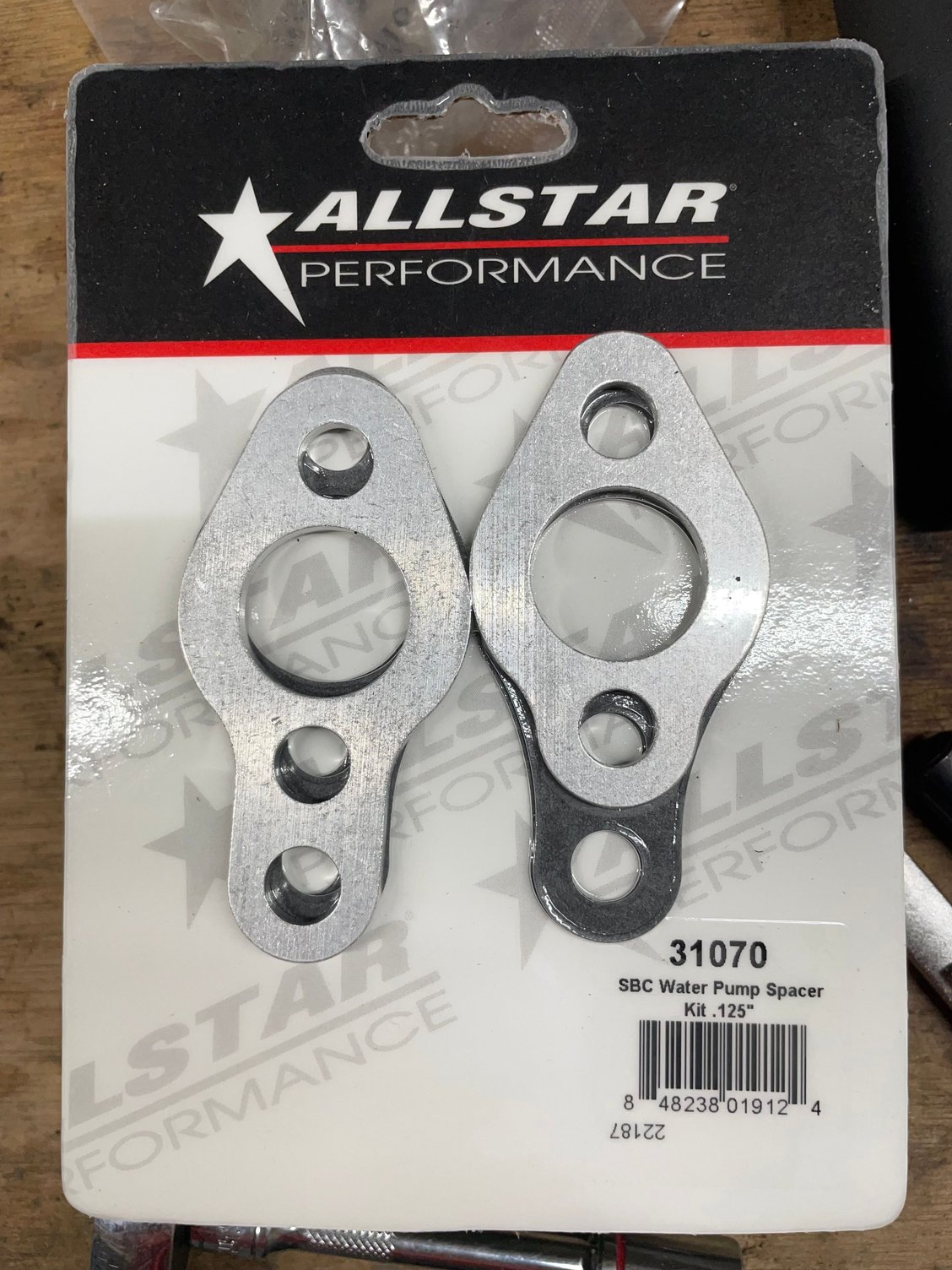

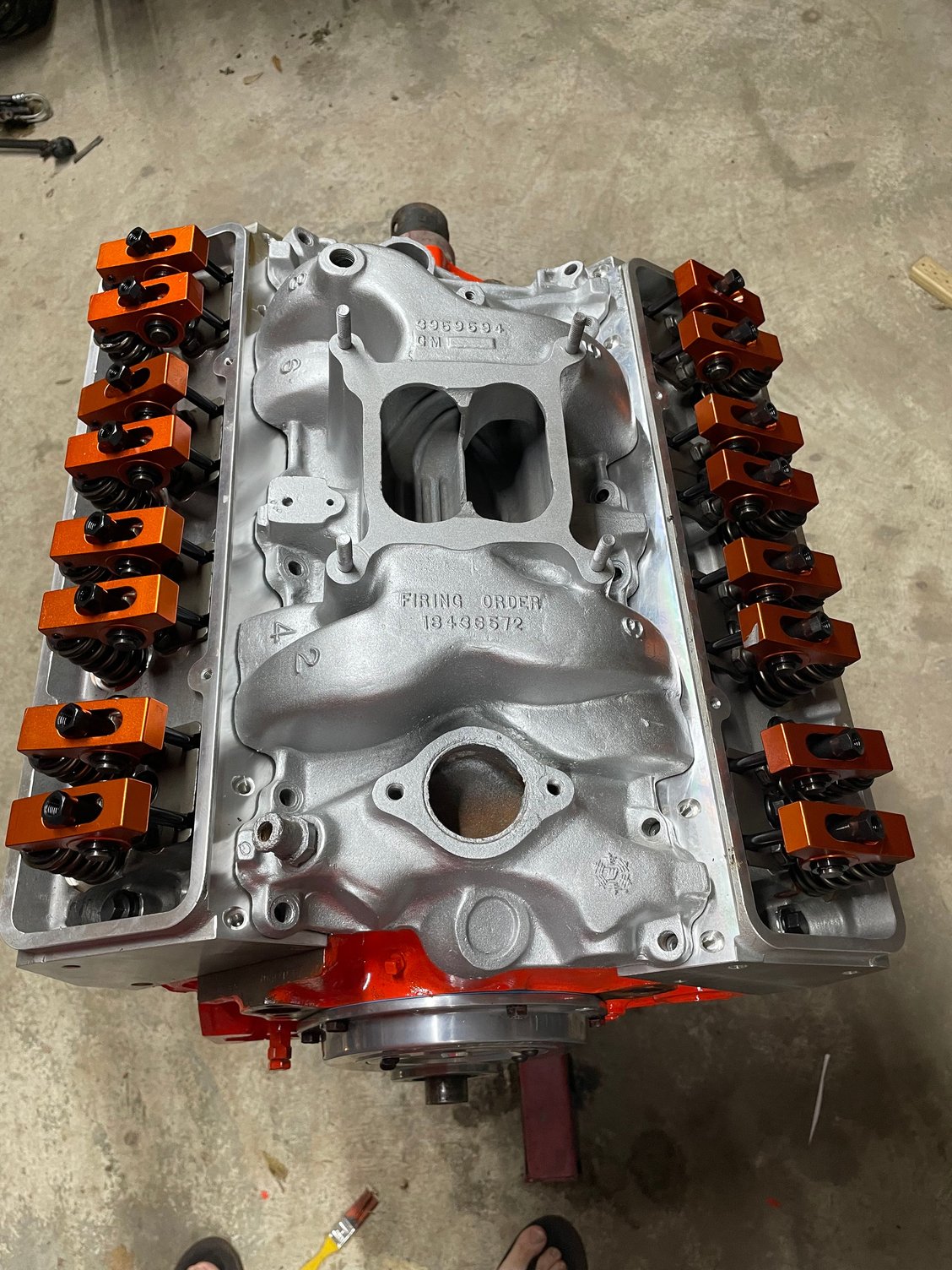

I gathered some parts and got back onto the final details of finishing my engine. I decided to try the cast aluminum engine paint on my manifold to get the new look I wanted:
Here's some before pics, this is the best I could get it after degreasing and aluma bright
Here's my results, i'm quite happy:

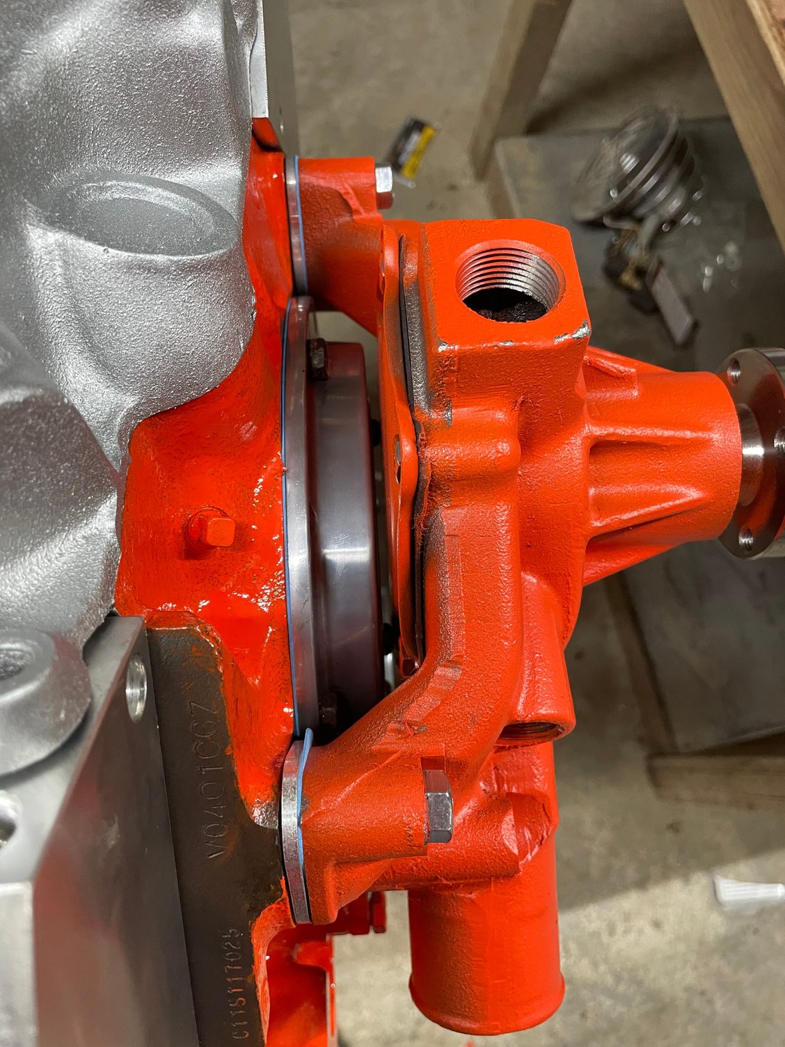

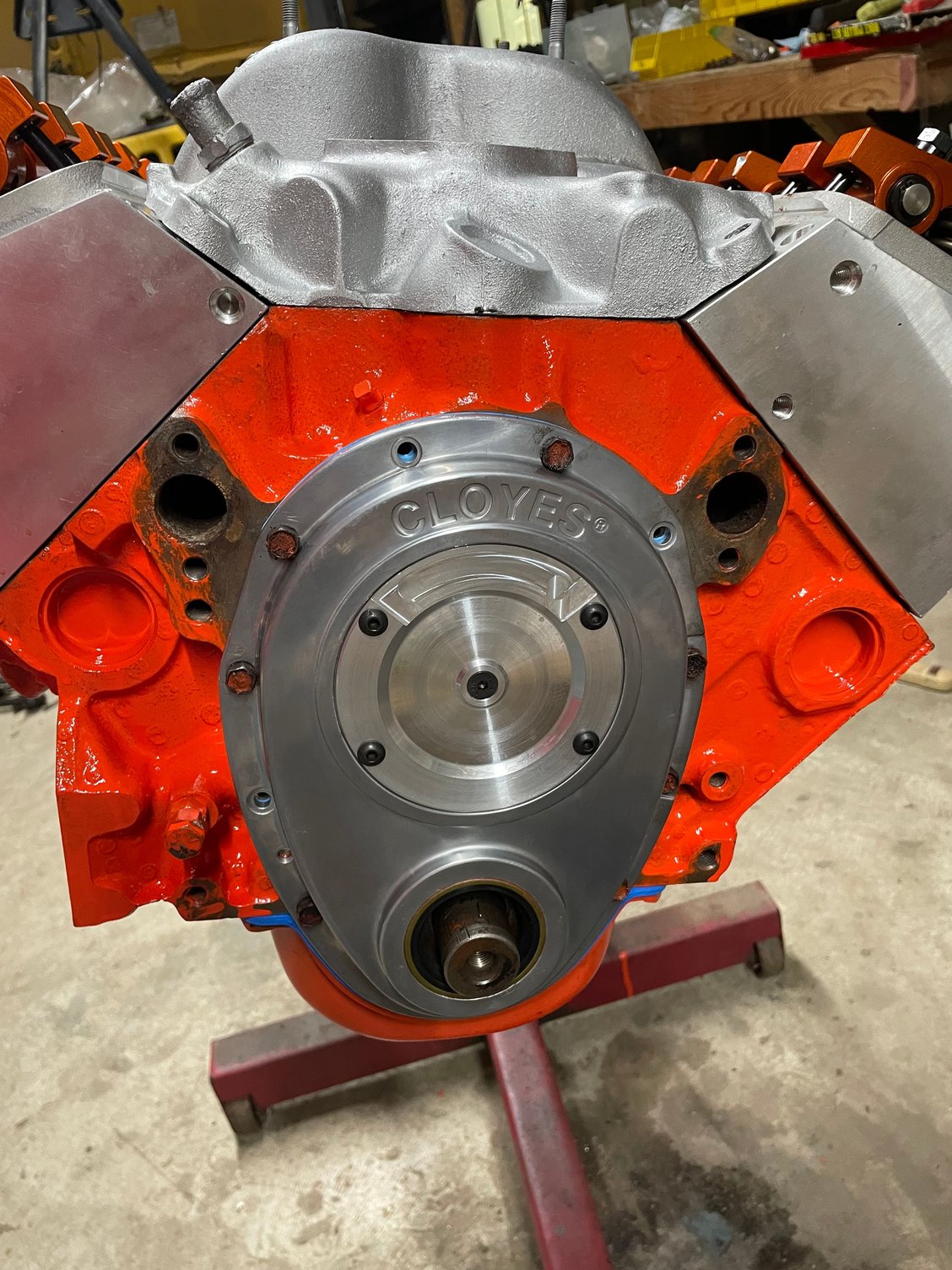

My next issue to address was the water pump clearing my timing cover. This timing cover is needed because it has a built in adjustable button for the roller cam , so I decided to use 1/8" shims to make it work. I know I'm going to have to shim all my other pulleys, but engine is on a stand and shims are cheap!
Found these on Amazon: nice quality and came with decent gaskets
Cam button adjusted and locked in (yeah I gotta find some timing cover bolts today!)
mocked up and beautiful clearance!
Starting to look like a finished engine!
