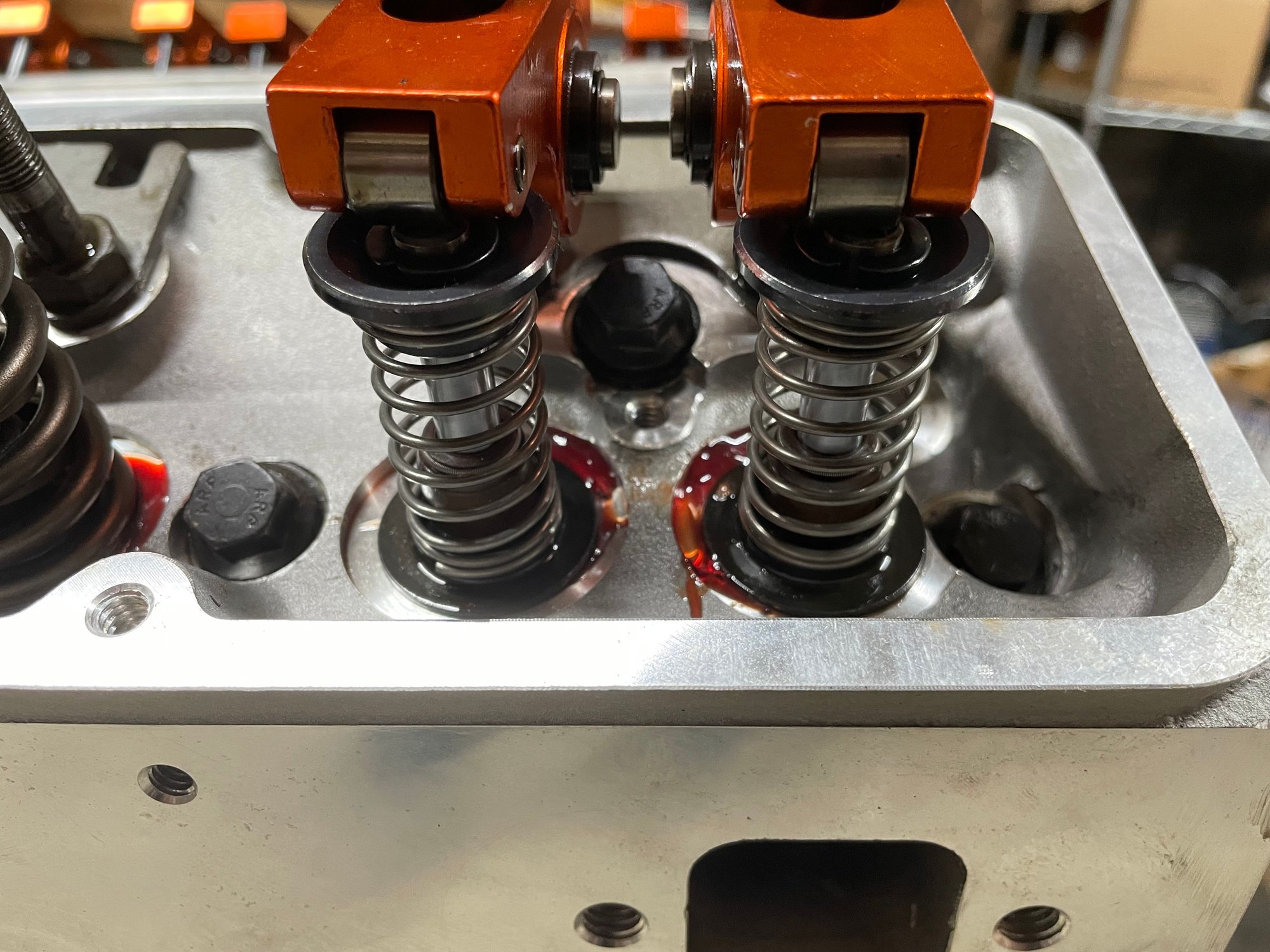

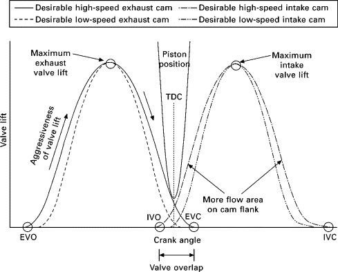

You can do this with a hydraulic lifter and with the heads on. No need to take them off.
I would use some very lightweight "checking springs" on two of the valves.
Rig up a dial indicator on the retainer.
A degree wheel helps if you have one or it's OK to just approximate.
Rotate the engine slowly near TDC. Not the compression stroke but 360 degrees later on the overlap stroke.
Tap the valve down with your finger and note how much movement it has.
You want at least .100" everywhere to play safe.
The tightest point is not at TDC, it is somewhere around 20 or 30 degrees before or after.
It doesn't matter "where" the tightest spot is.
Just as long as it stays above .100" in that whole area.
It will be larger at TDC, smallest at ~20 degrees, and then start getting larger again.
With that lift cam you are probably fine, but, it is not hard to check.
I guess the exhaust will be tight before TDC and the intake tight after, or maybe I have it reversed, it's late.
Note piston position in the center.

Yeah you are probably fine.
But it is easy to check.
And if you are not fine, the downside is big $$
So peace of mind is worth it!

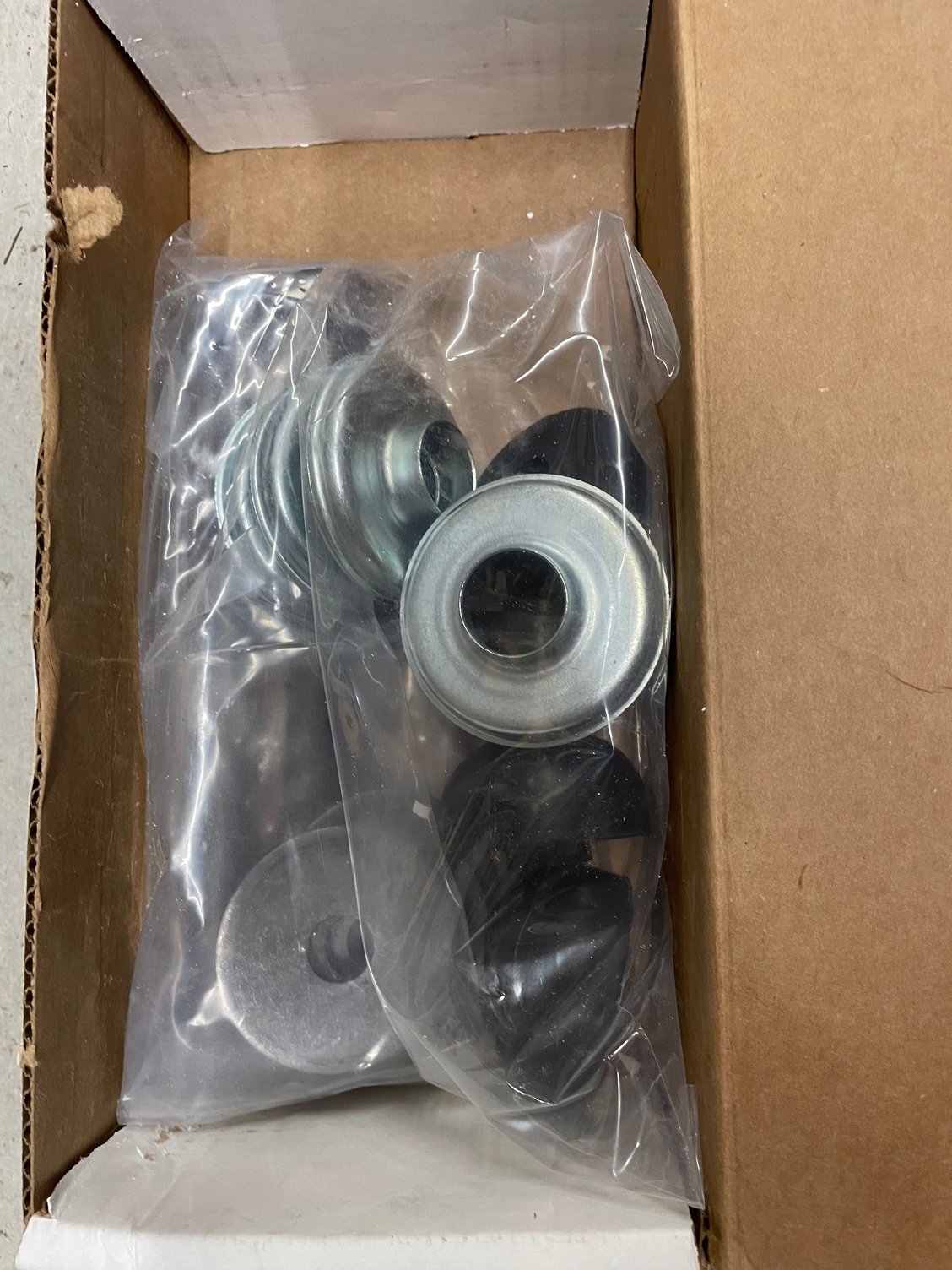

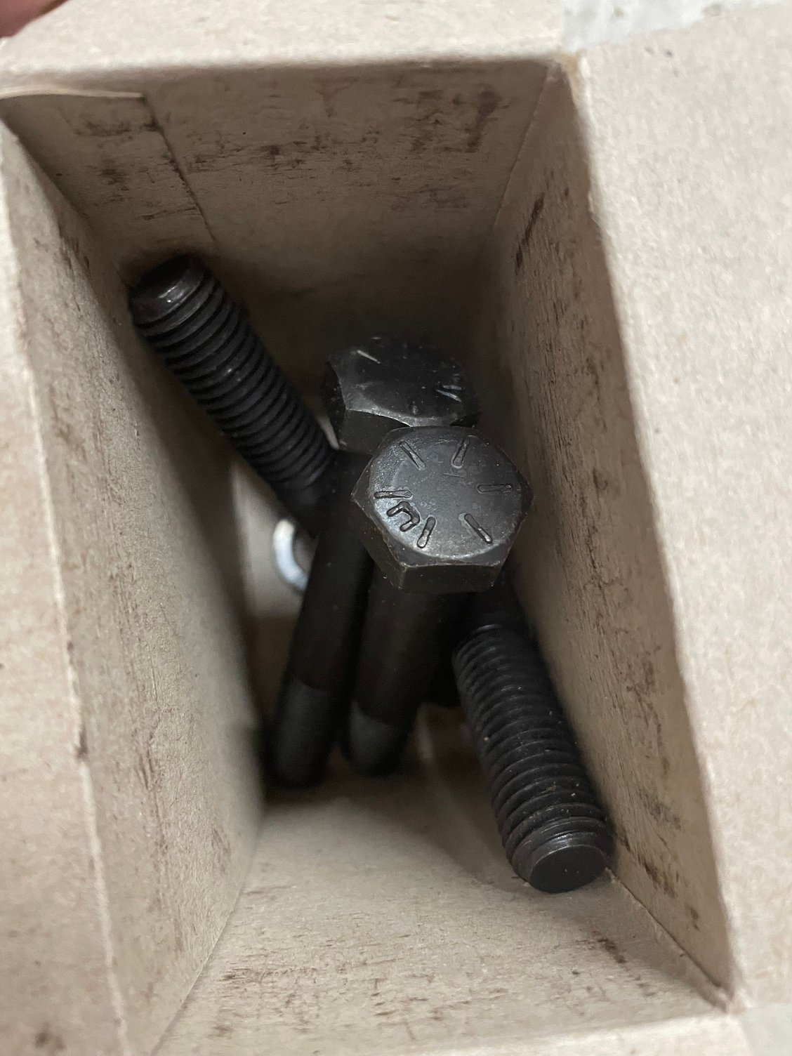

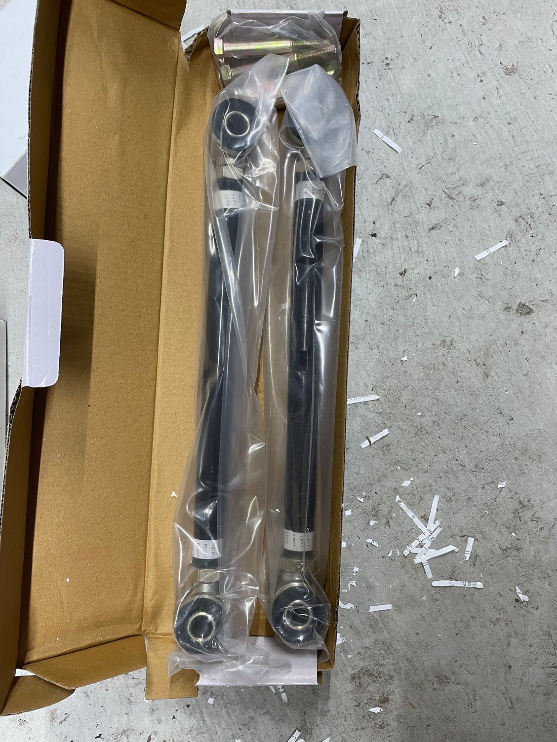

Should have my frame done this week, and I've been collecting and restoring more parts foe reassembly. Brown Santa came today with some goodies:
First load up was I discovered that Tractor supplies sells bolts by the pound for only $3.59/LB! Stocked up on some new hardware
Next is some reproduction bolts to hold on my new (used) VBP fiberglass spring on the rear, that'll match my VBP setup in the front:

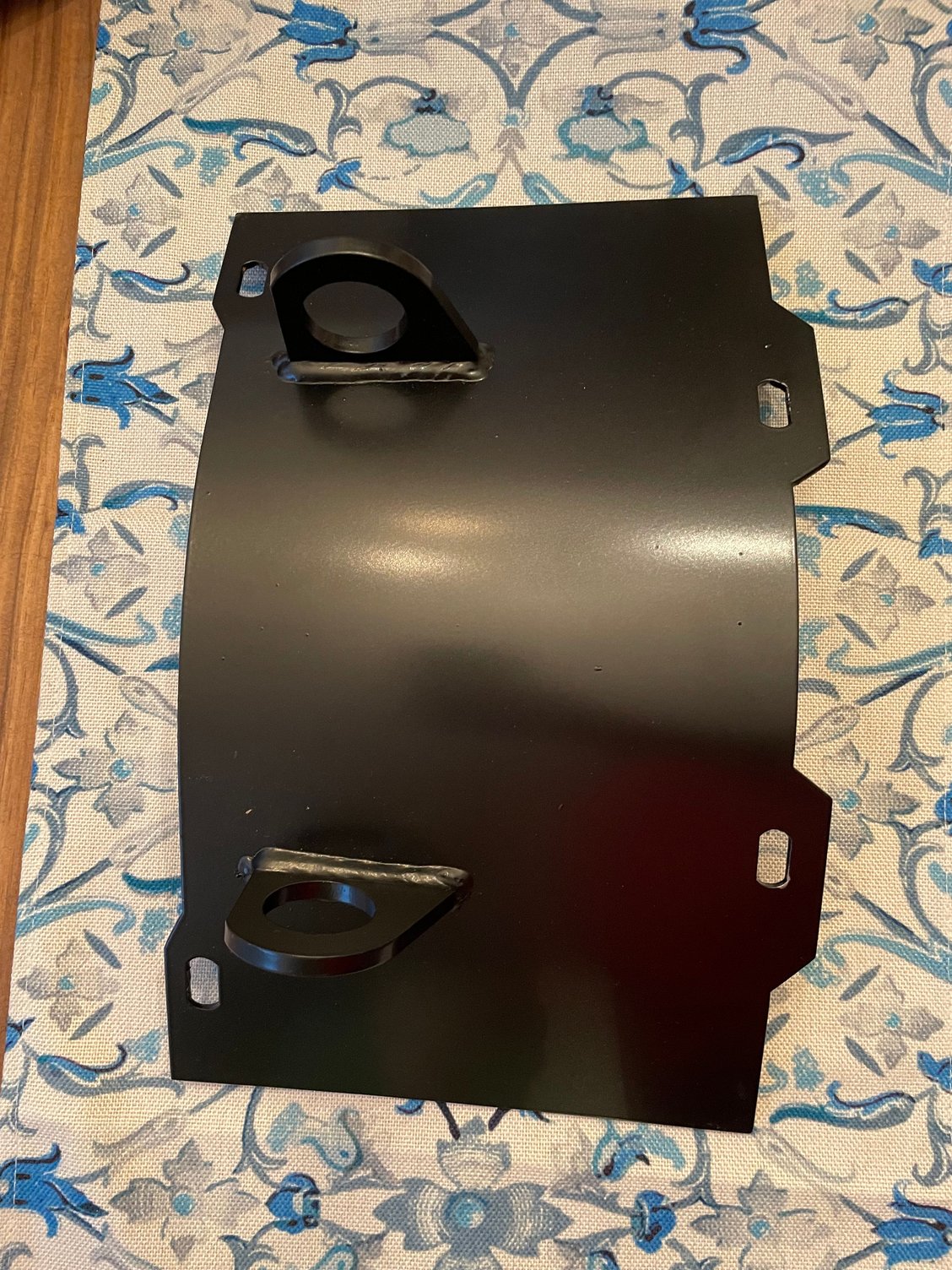

Bought this beautiful front crossmember plate with tow hooks from David Howard, it's a top notch piece and will hide my dent!
New cups, bolts, and bushings for the rear spring
New adjustable strut rods

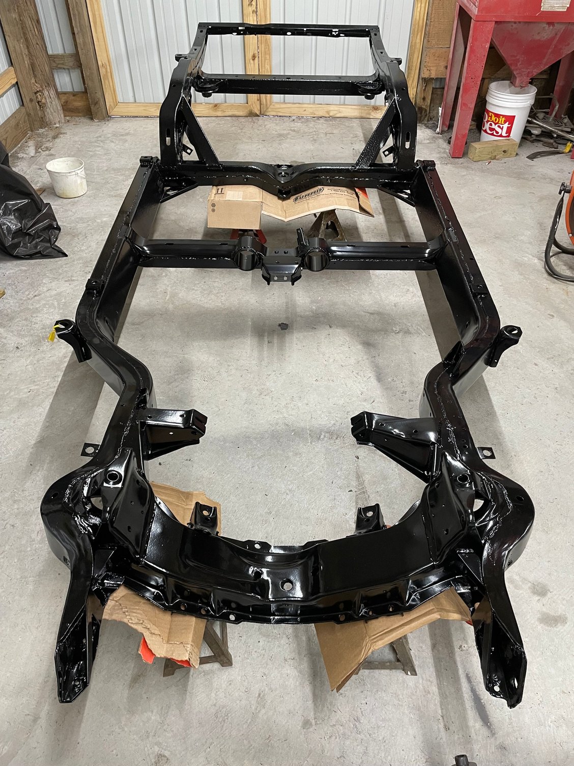

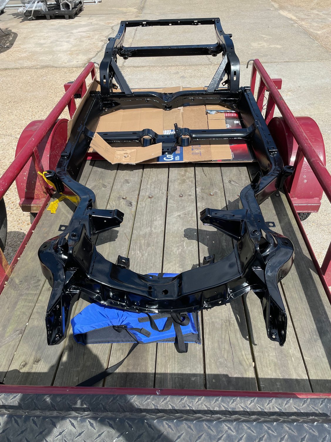

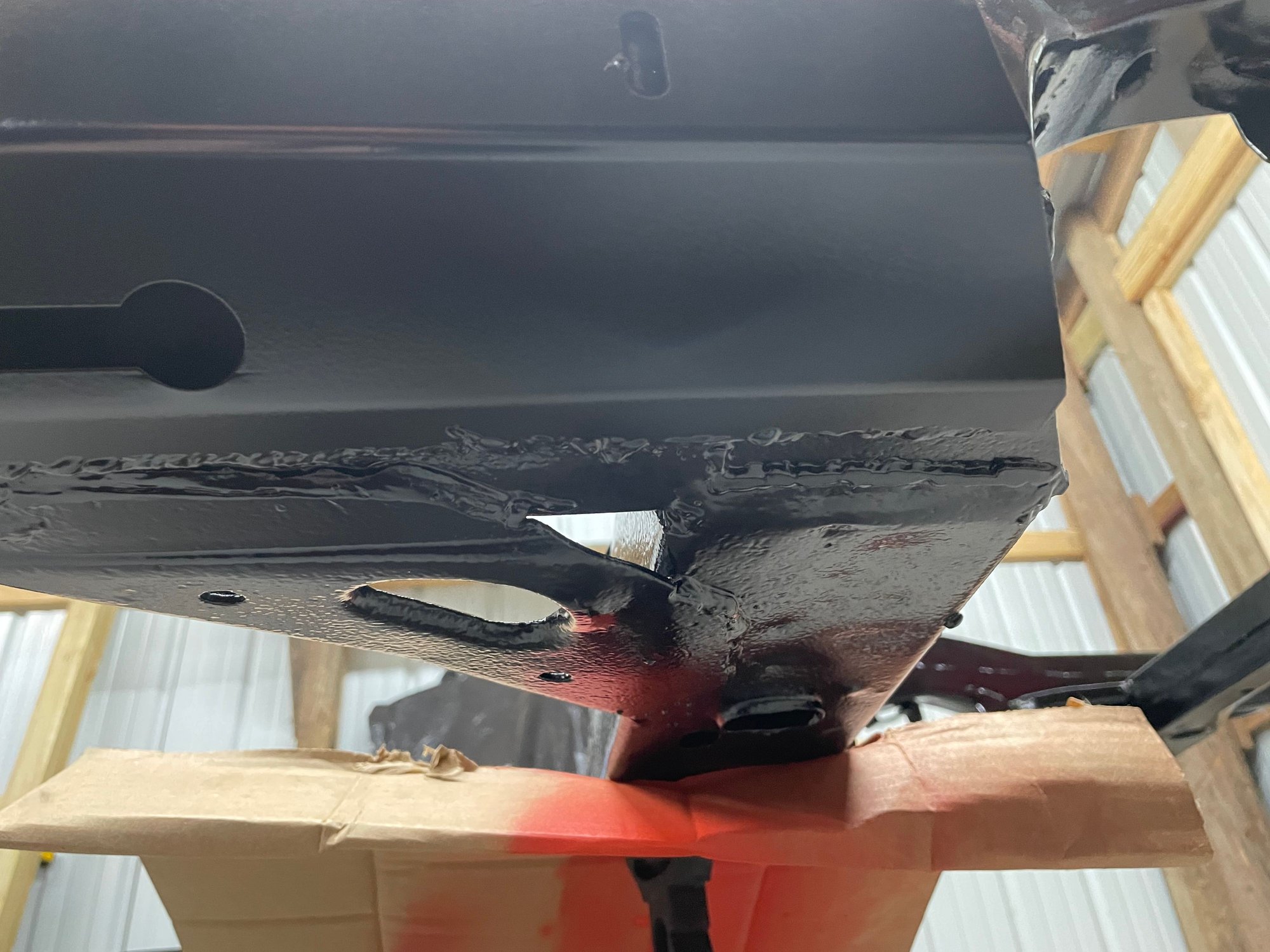

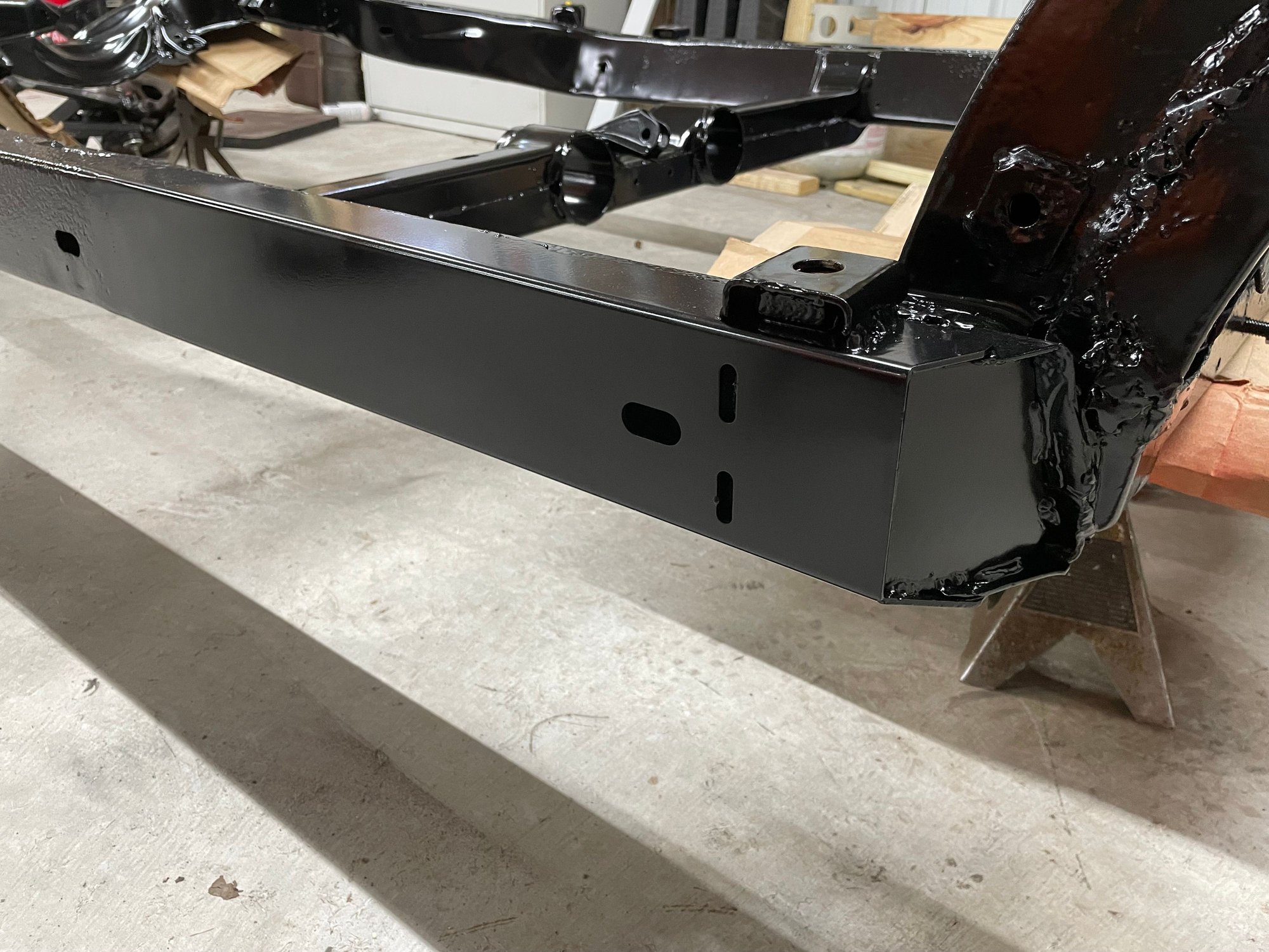

Well my frame is finally done , and I picked her up this afternoon: Results are Stunning!!! I'm sold on powder coat!
Loaded up in my little 5x10, with plenty of card board to protect the fresh finish
Buddy came by to help me unload the frame, and drink beer and admire it lol
This was one of the rotted out corners, pretty big improvement!
New bottom of frame end rail where it was rotted
Started to prep the front suspension to be put back on, gonna be a busy weekend!

Yes, very nice, I see you didn't go with a removable transmission crossmember.
Old Apr 21, 2023 | 09:26 AM
  #569
Arg0413's Avatar
Arg0413
Joined: Feb 2015
Posts: 1,440
Likes: 1,031
From: Baton Rouge Louisiana
Its so nice to work on a rust free, clean automobile....it will be easier than you think. Just chase all the theads before assembly.
Yes, I'm looking forward to it!!! Fun part is putting on all the new parts too!
Yes, I did consider it in case me or a future owner wants a 5 speed, but decided against it, because I just don't see the value in a 5 speed swap. I'm not going cross country in this car, and spending $5K for an OD just doesn't make sense to me. Car cruises just fine at 70MPH with the 4 speed.

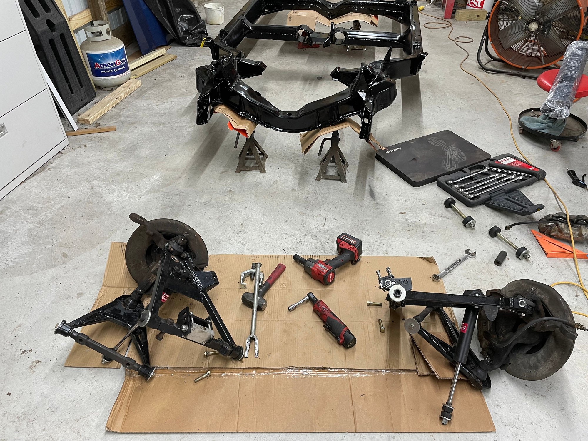

Today is Friday, so that means only a half day at work, and the other half on my Corvette!

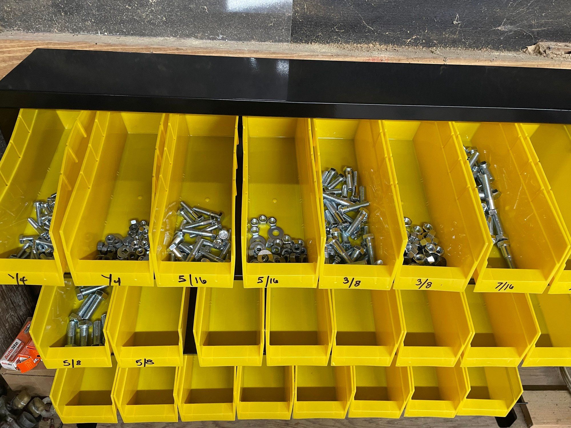

Started with a field trip to Harbor Freight - needed some organization for the hardware collection I'm building. This was cheap, and feels cheap, but it works well:

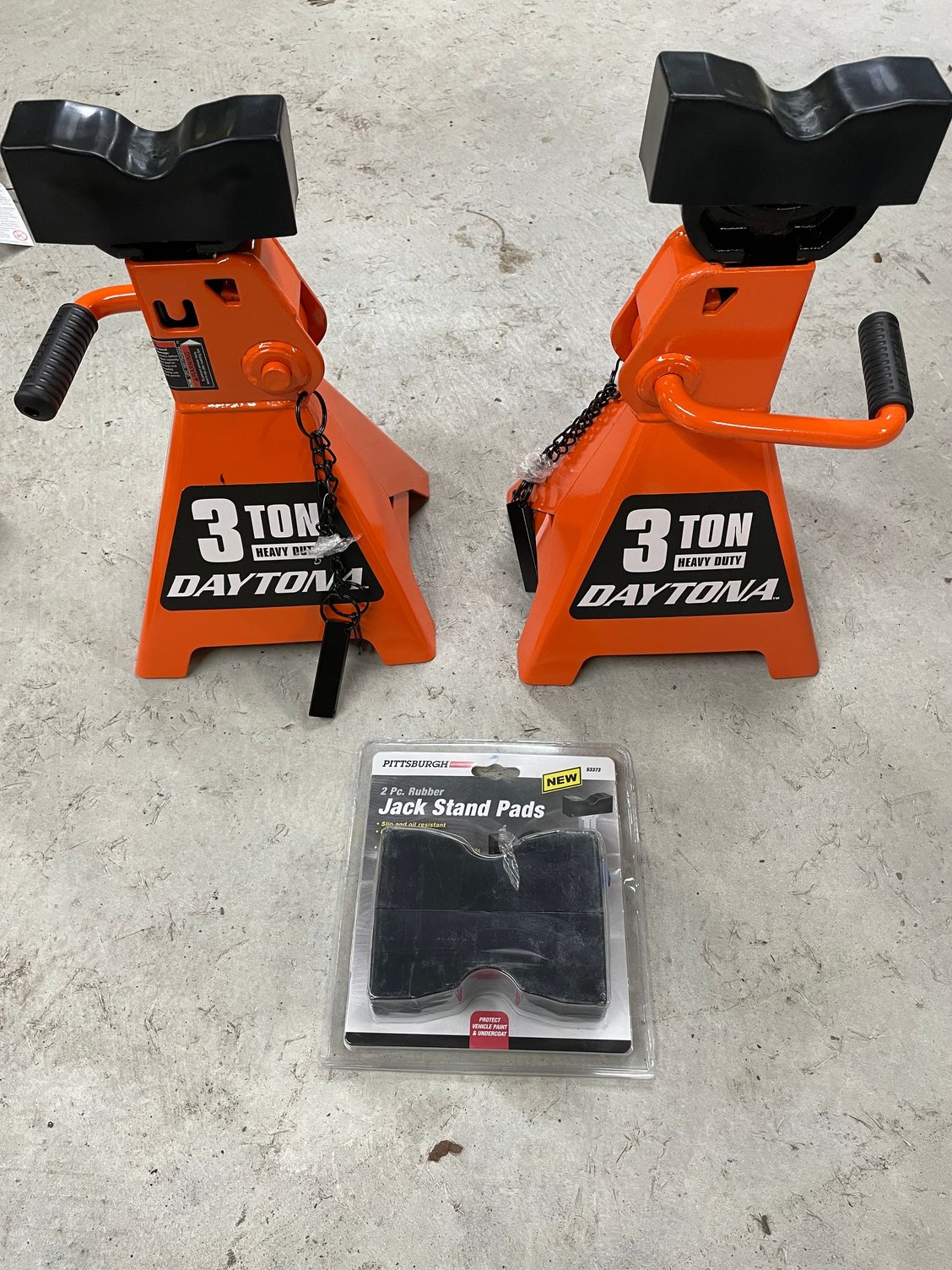

Jack stands for $29?! Yeah I'll take a pair! And I found they had rubber jack stand covers, so I bought some to protect my frame:

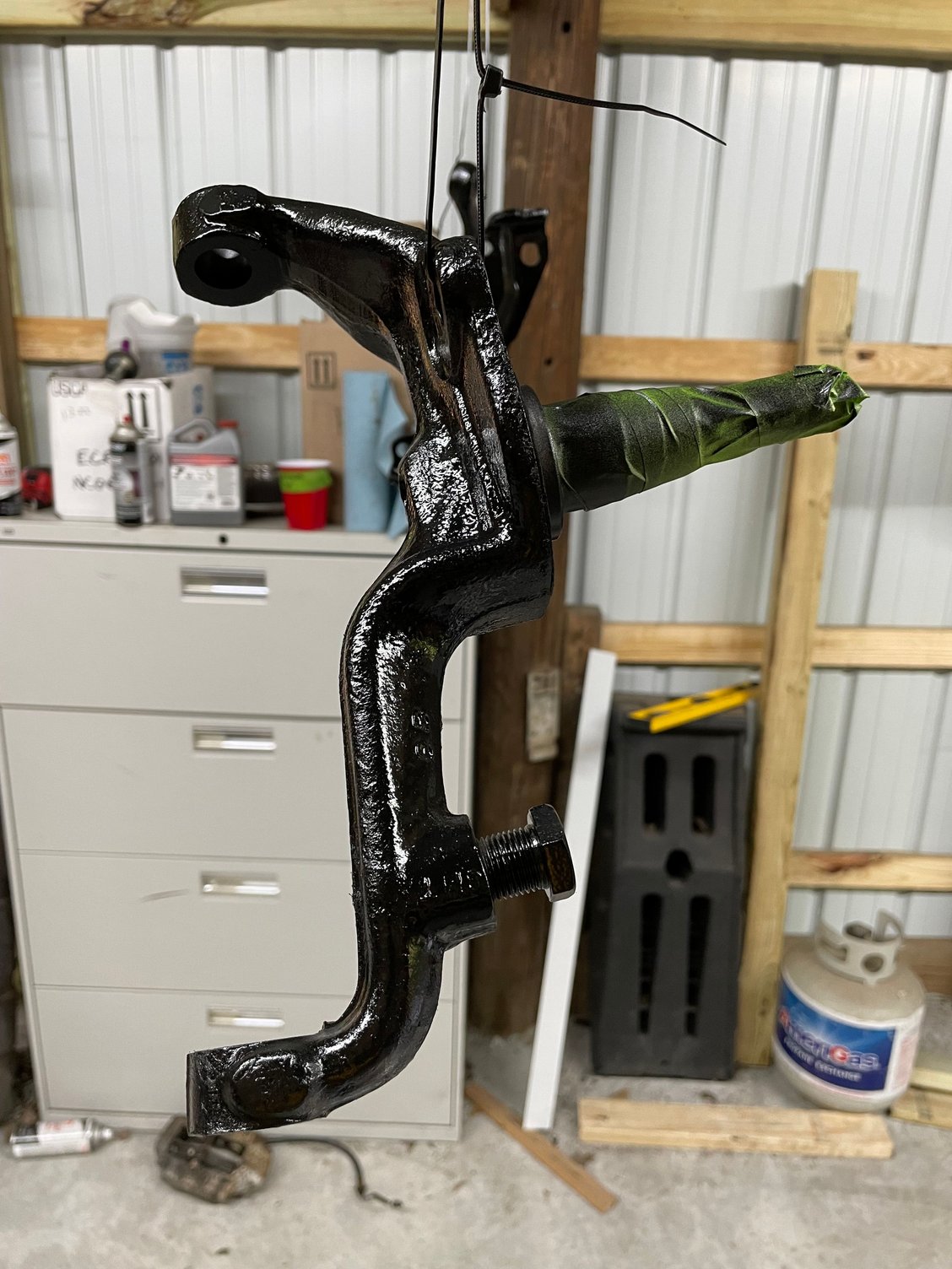

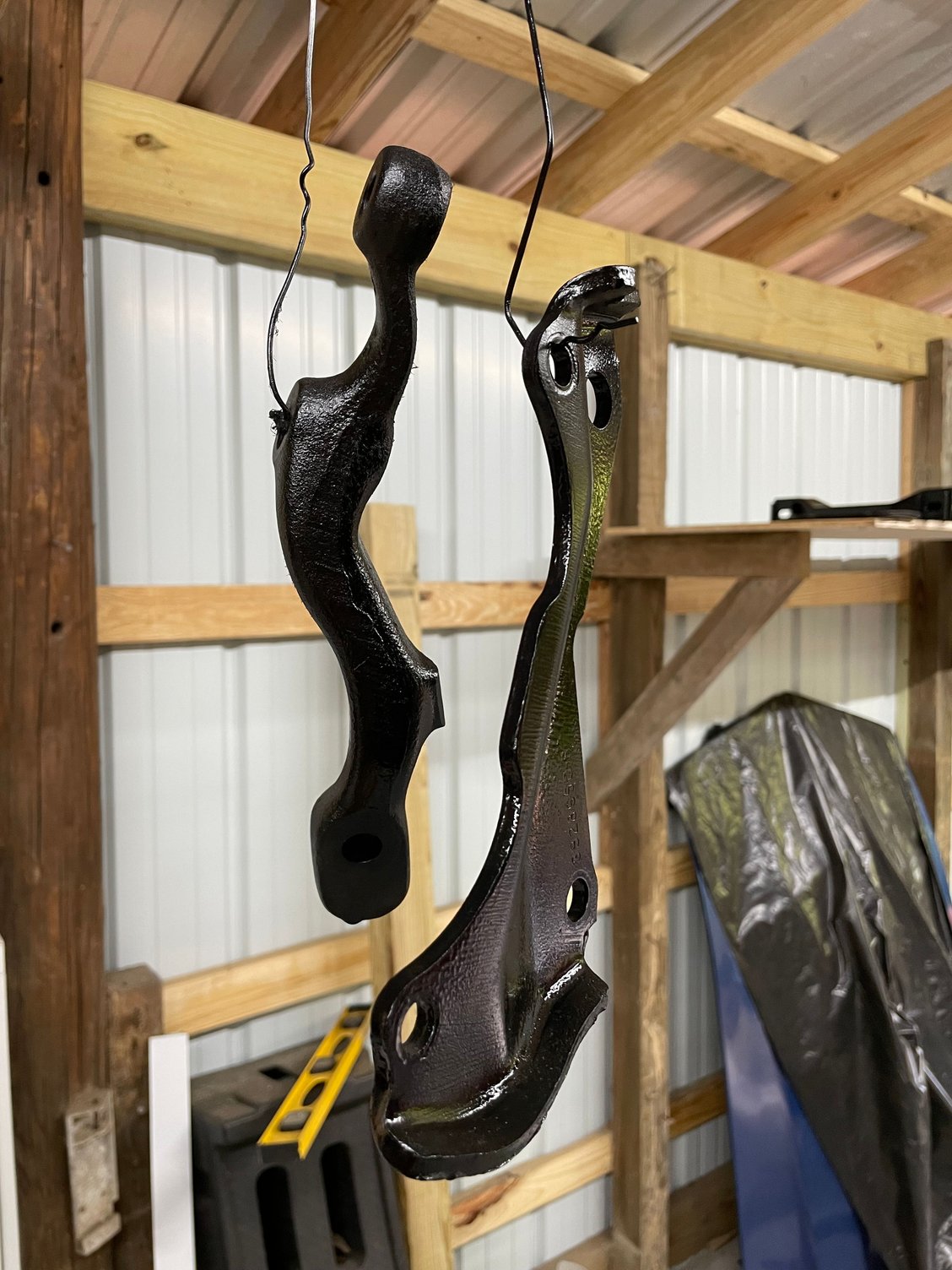

Spent the rest of my day disassembling, cleaning, and preparing the front suspension to be reinstalled. Broke it all apart, cleaned the A arms with soapy water, then touched up the chips in the powder coating with POR-15. This was all mostly new VBP front suspension, which highlighted that the spindles were original and needed to be restored. So I broke them apart, degreased, then put them in the blast cabinet. Results were great, and I was able to get them painted. it's pretty interesting how the spindles come apart in three pieces!

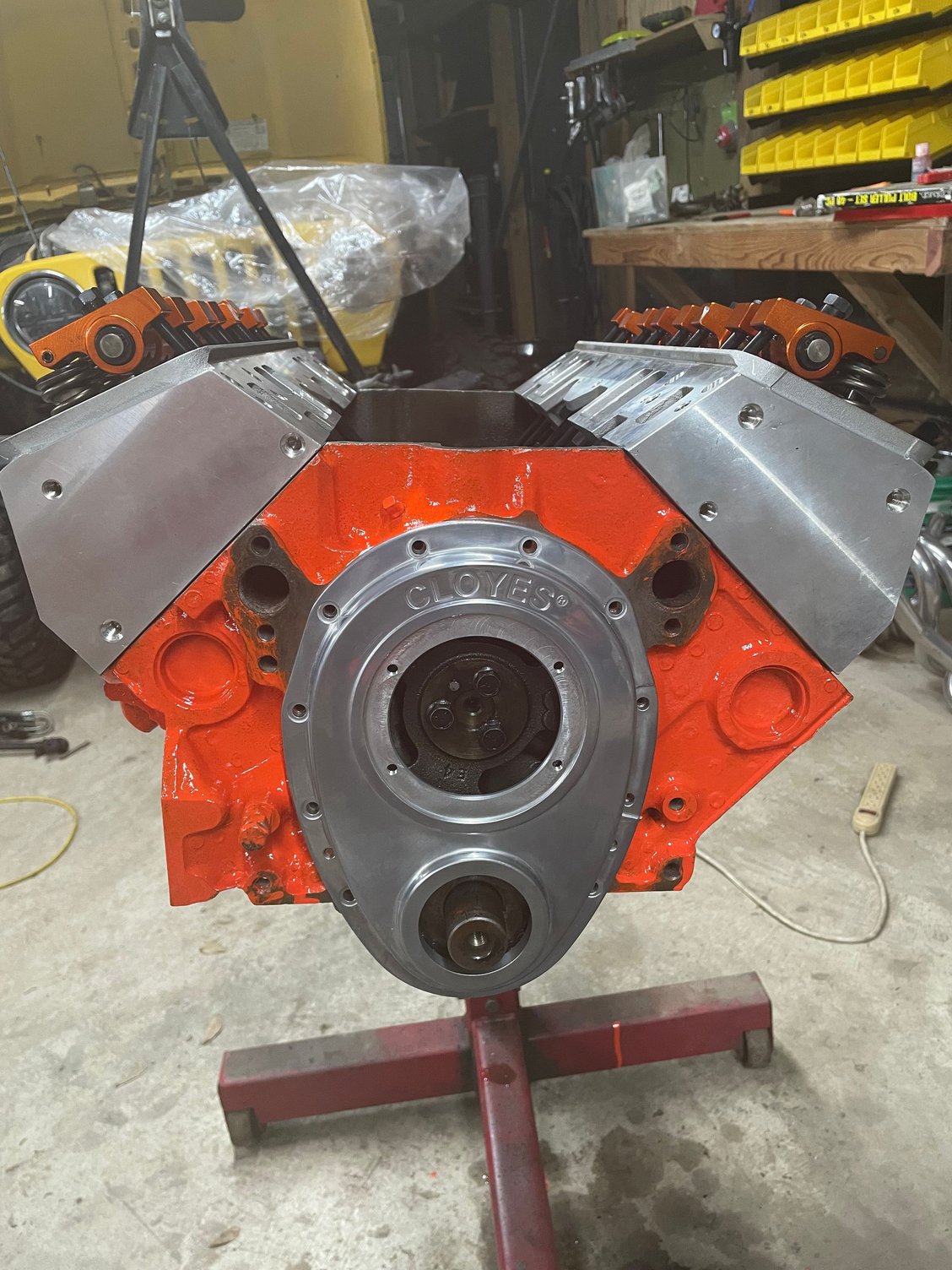

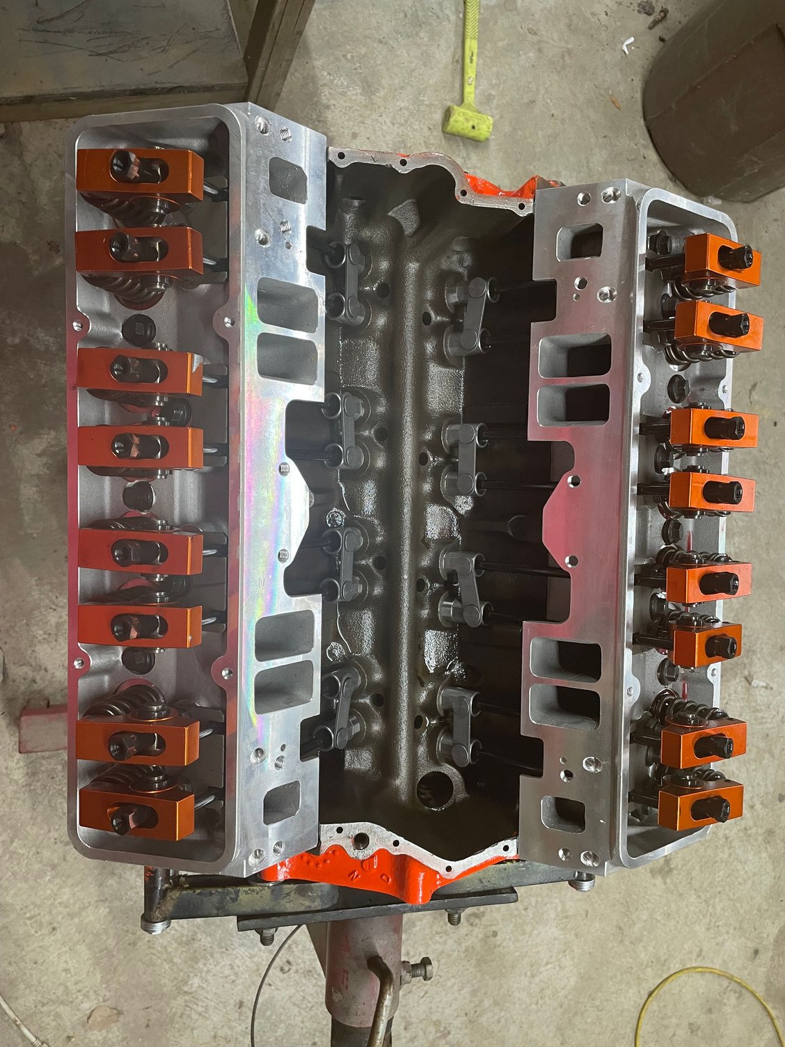

I got most of the little odds and ends in to button up my engine, so focusing my attention towards it before I get back into the chassis. Stingr69 was kind enough to send me the main bolts I needed, and even threw in some lagniappe: and ARP oil pump stud. Got the mains torqued in properly:

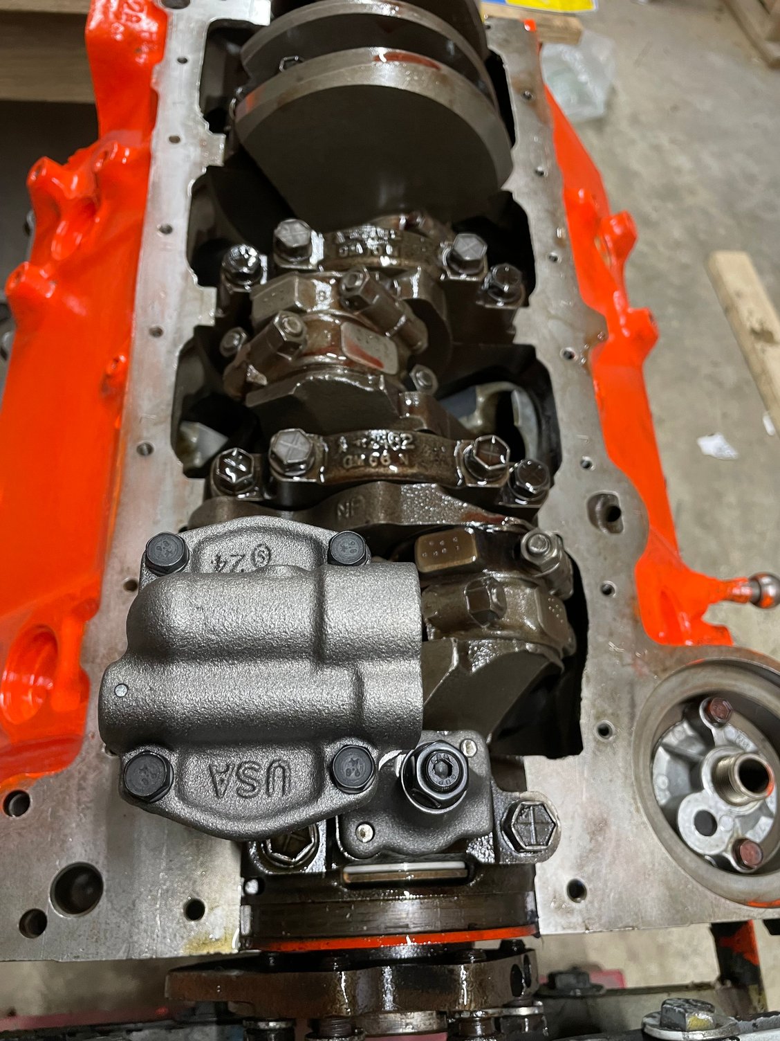

I put in the ARP stud, then installed the new Melling M55 oil pump. I have an oil pickup on the way, and I'll be able to put the new oil pan and gasket on

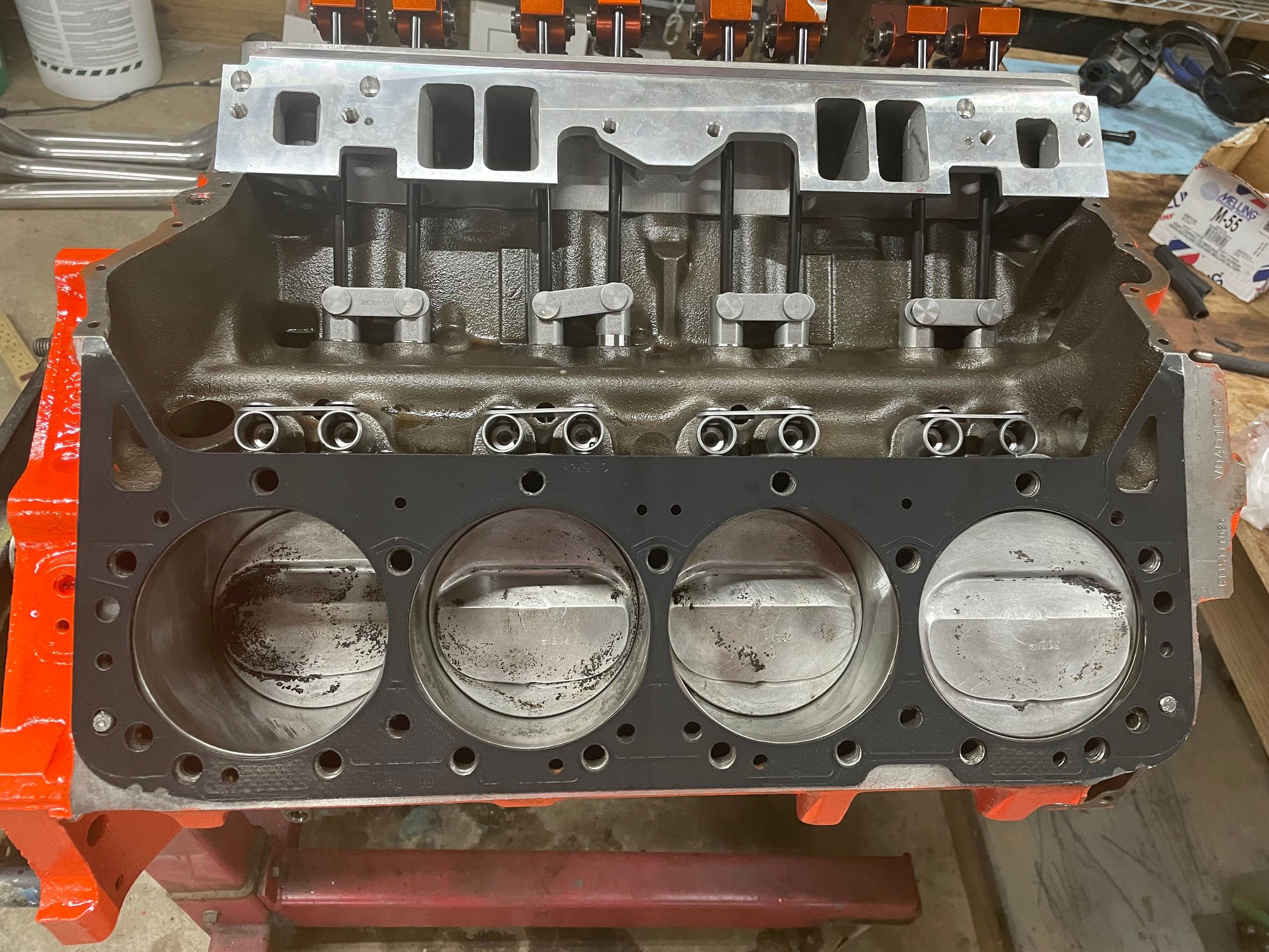

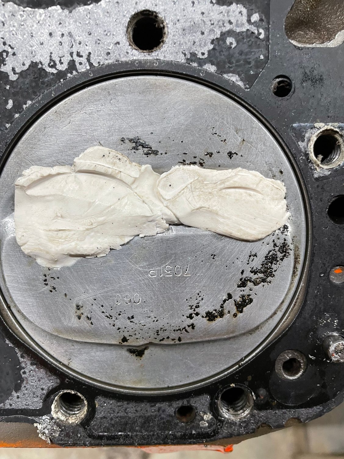

Also got the valve spring compressor in, so I was able to install test springs to test PTV clearance:
Did a clay test , and turns out I had all the clearance in the world!

Pulled out the new Cloyes timing cover, it's a really nice piece! Adjustable to hold the cam in too.

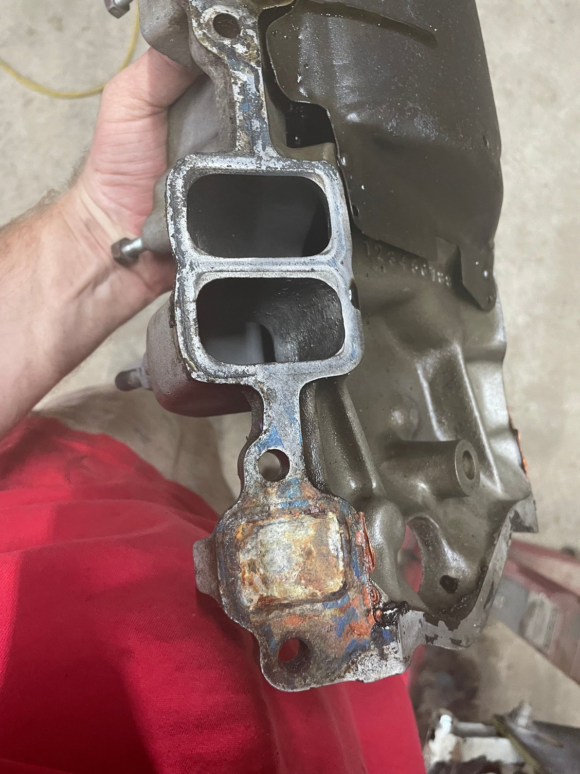

Pulled my LT-1 Winters intake off the shelf: Going to need some serious cleaning before it's bolted down!
Why is this water passage in my intake closed in, and does it need to be opened up?
Questions I have:
  1. Had issues getting the crank seal in the timing cover - what's the trick here?
  2. Best way to clean up intake? Stingr69 recommended Simple Green to me today
  3. what's the deal with the closed/clogged coolant port on the intake?
Old Apr 25, 2023 | 10:55 PM
  #580
AKjeff's Avatar
AKjeff
Joined: Apr 2010
Posts: 603
Likes: 249
From: Carson Valley
That's the rear of the manifold, there is no coolant cross over there.
I've used WD40 and a scotch bright pad to scrub aluminum, Simple Green would probably work as well.
