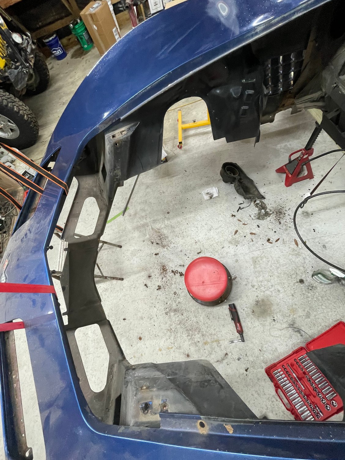

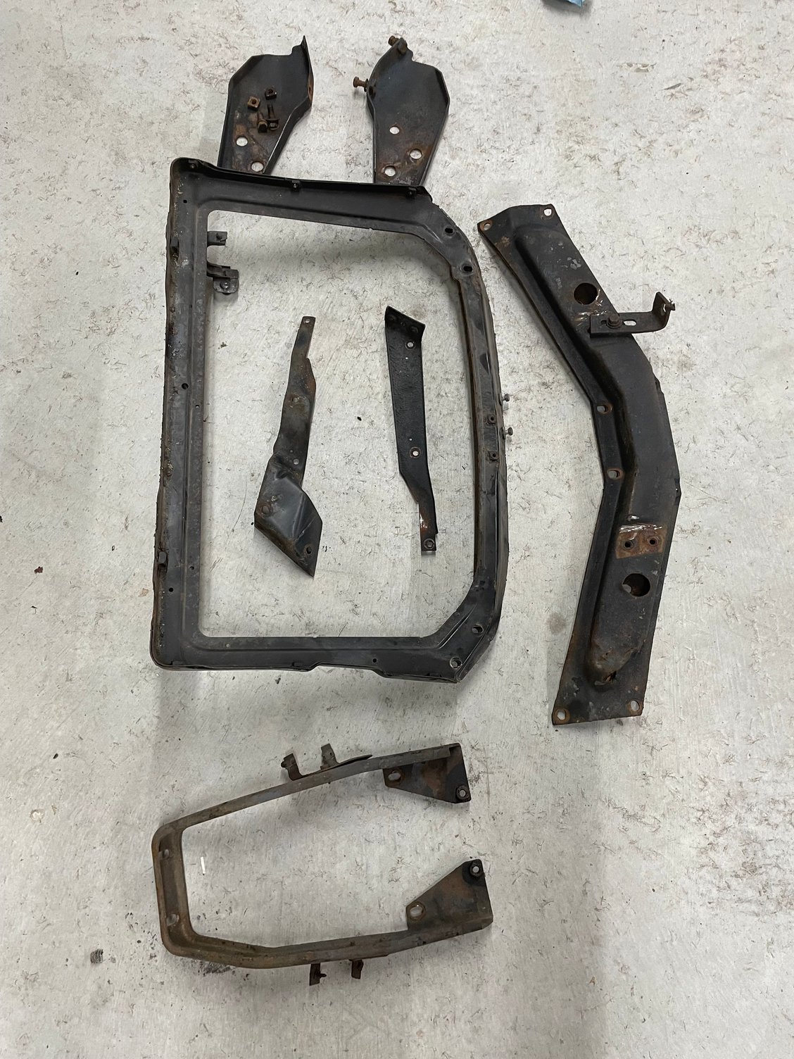

Went ahead and pulled the radiator support and remaining brackets off the front end. This was luxurious: sitting in my roller chair, smoking a cigar, listening to podcast, and sipping beer while I wrenched with my Milwaukee power tools! Wish more wrenching was this relaxing lol All the metal is in good shape. I'm going to sandblast and paint to refresh all of these pieces. It's amazing how light the front is with all this steel removed too!

Make sure to check for cracks in the fiberglass around where the radiator surround bolts in.
I found a couple that my painter is fixing and reinforcing.
He said it’s not uncommon to find small stress cracks in this area.
I need to check closer in that area, thanks! I did find that the drivers side fender liner separated where it meets the lower valance area. Looks to be an easy fix with fiberglass.

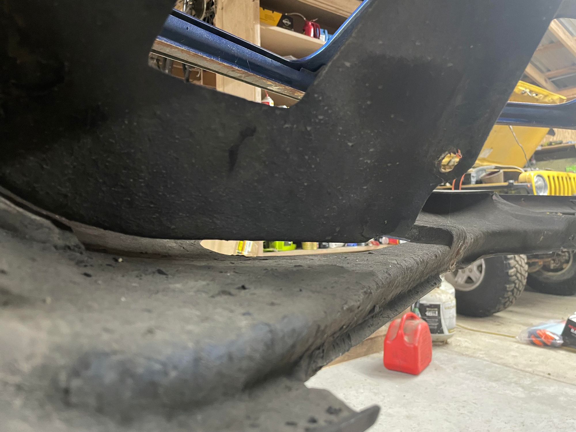

Below is where the fender/valance seams have separated on my front clip. Just going to clamp and fiberglass back together.

Shouldn't that be bonded with the uerathane there?
I think that is the way my inner fenders are attached to the uppers.
I'm not sure what's supposed to be there. What kind of urethane would be used?

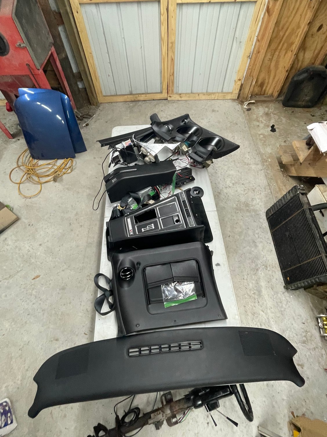

Tonight I got the interior gutted. Bagged and tagged my hardware, and tomorrow I'll be boxing and wrapping up all the parts. What have y'all used to preserve the big stuff (dash pad and seats)? I'm thinking of just sealing them in contractor trash bags and putting what will fit in rubbermaid tubs in tubs.

I used the big rubbermaid style tubs. But I got clear ones, so I could see inside. And flip top lids so I didn't lose them.
Walmart. I gutted the entire car and wound up with 22 of the big ones.
Don't forget to make a index list so you can find stuff later!!!!
They stack well, and there were not that many things that would not fit.
Some have 2 dozen labeled bags inside, etc.
I'll attach a copy of my spreadsheet if you think it'll help.
I would recommend removing the old glue with a heat gun and replacing it with new brown one like I did here: Three... two... one... lift off! - Page 26 - CorvetteForum - Chevrolet Corvette Forum Discussion
This clarified a lot! How was you fiberglass so clean in those pics??
