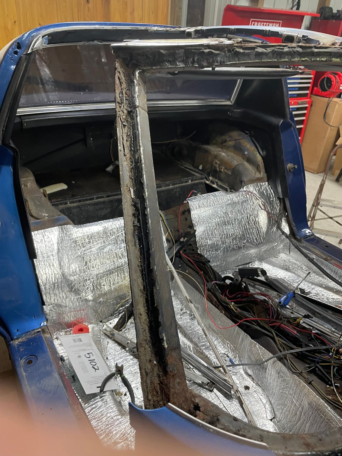

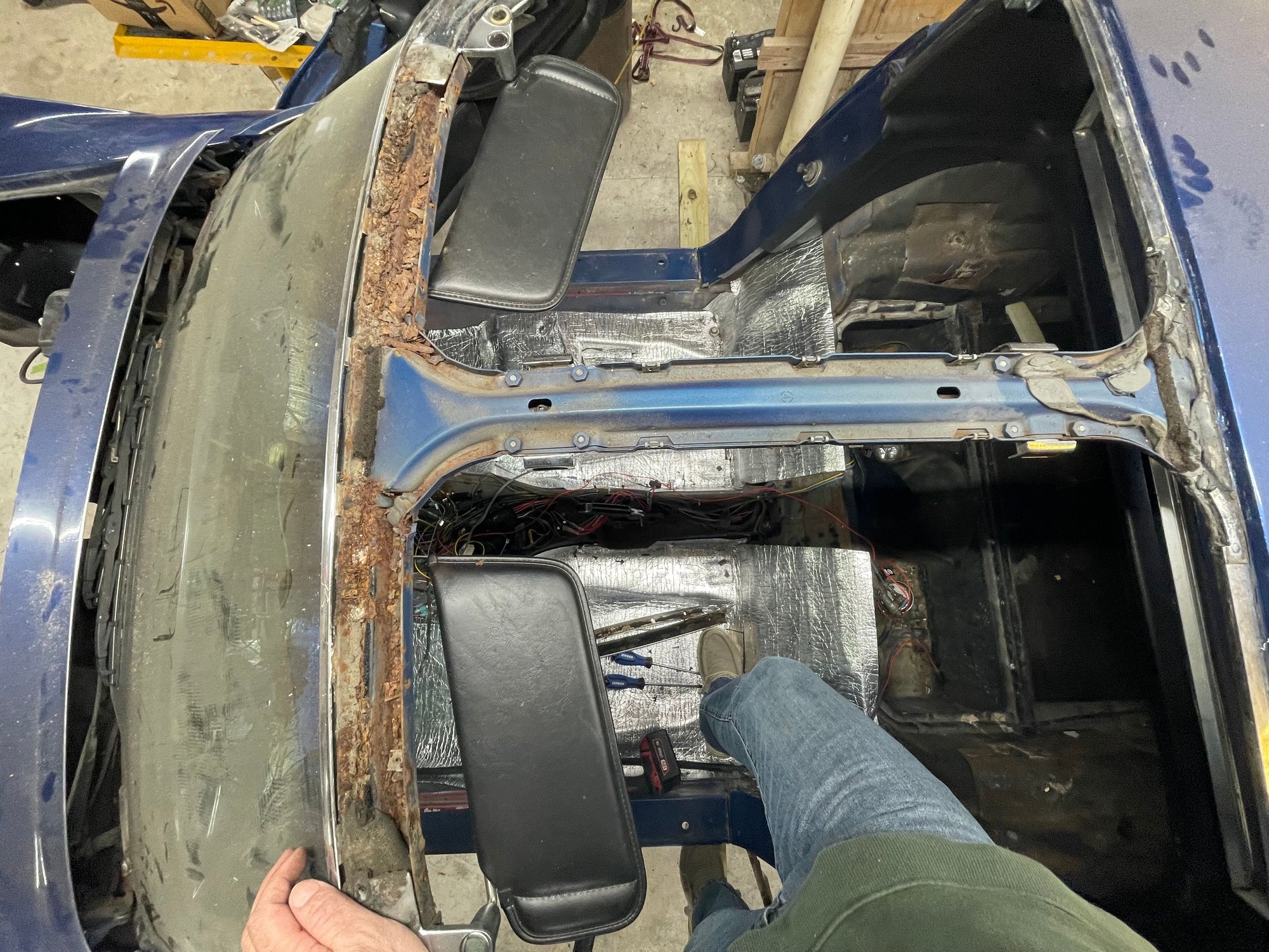

Now the engine is tucked away in the corner with one last task, I could get back to the body work. I wanted to go ahead and remove the windshield to access the rust damage and corners before I stripped the paint. Figured a weekend of welding and fixing this, then I can spend the following weekend stripping paint and I'll be back on schedule!
I got the molding, trim, and weatherstripping off from around the windshield last night. Typical corrosion found, but nothing unfixable so far. I bought a cheap windshield removal wire cutting tool from Wuhan, and the cable would last about a minute before it broke. so stopped there for the night..
Next day a picked up some high quality wire for windshield adhesive cutting and went to work: With the proper wire I made quick work of cutting the windshield, and was SO close to not cracking it!!!!

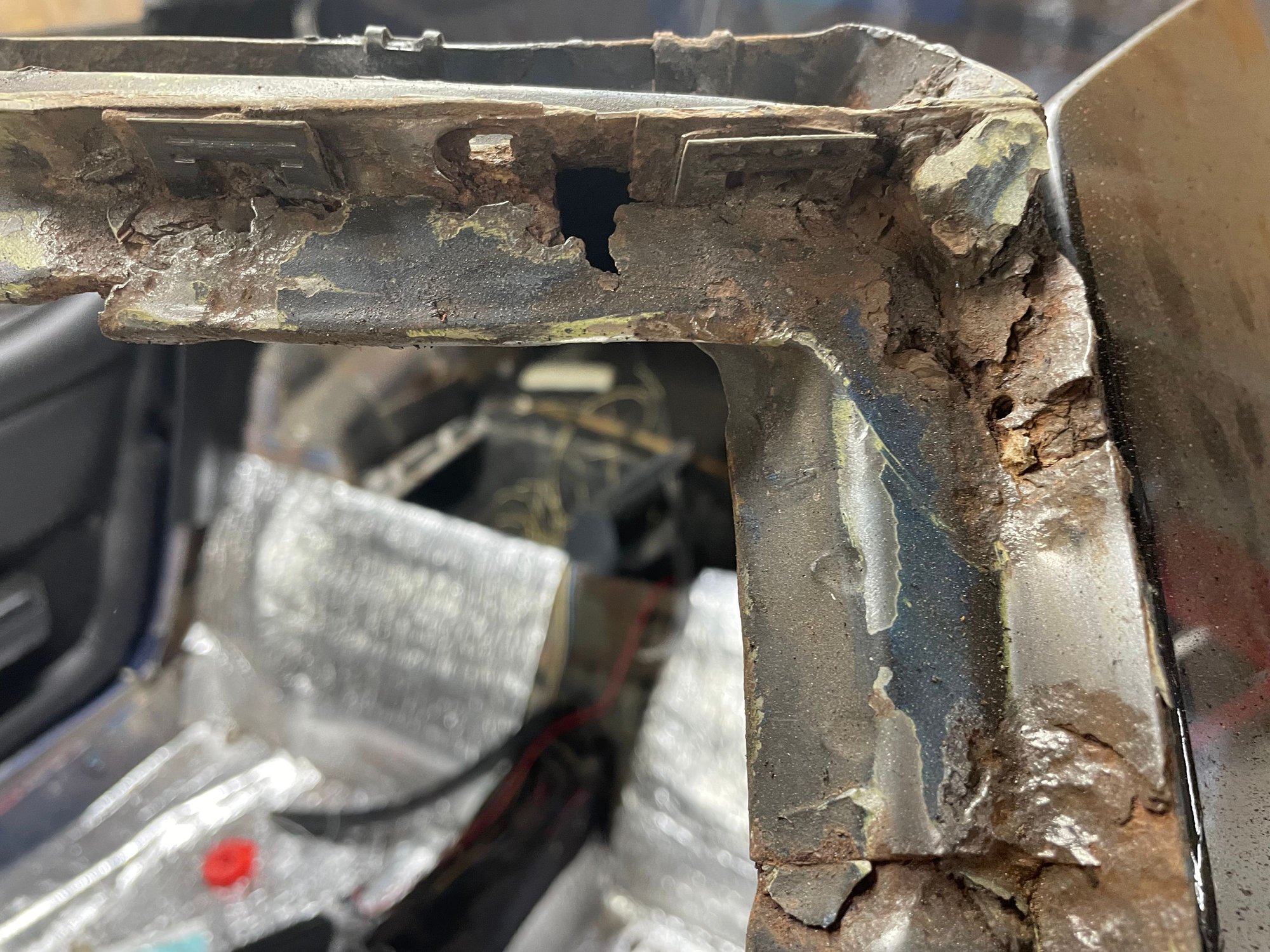

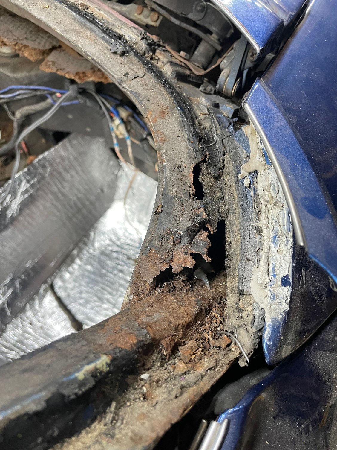

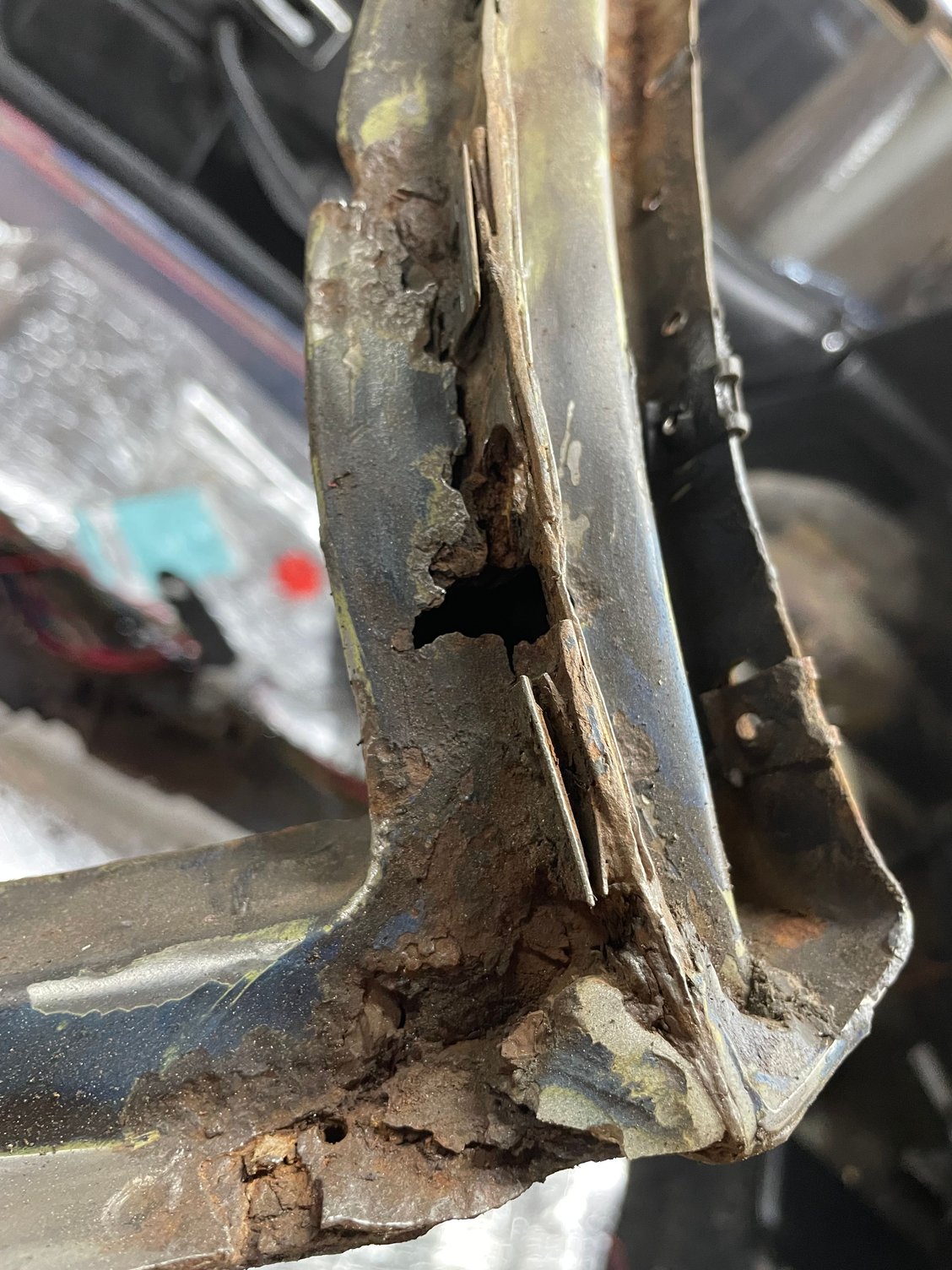

Starting with the drivers side front corner, we have corrosion and a couple of holes, but all looks to be fixable.

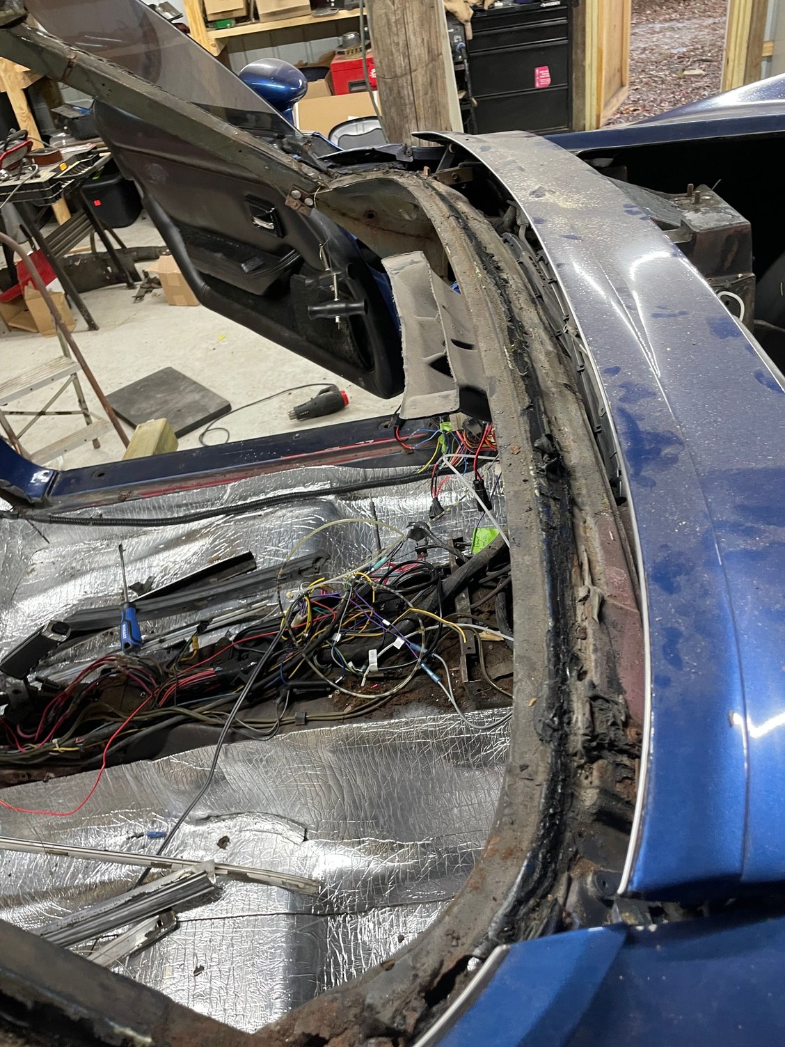

Then about the same for the passengers side top corner:

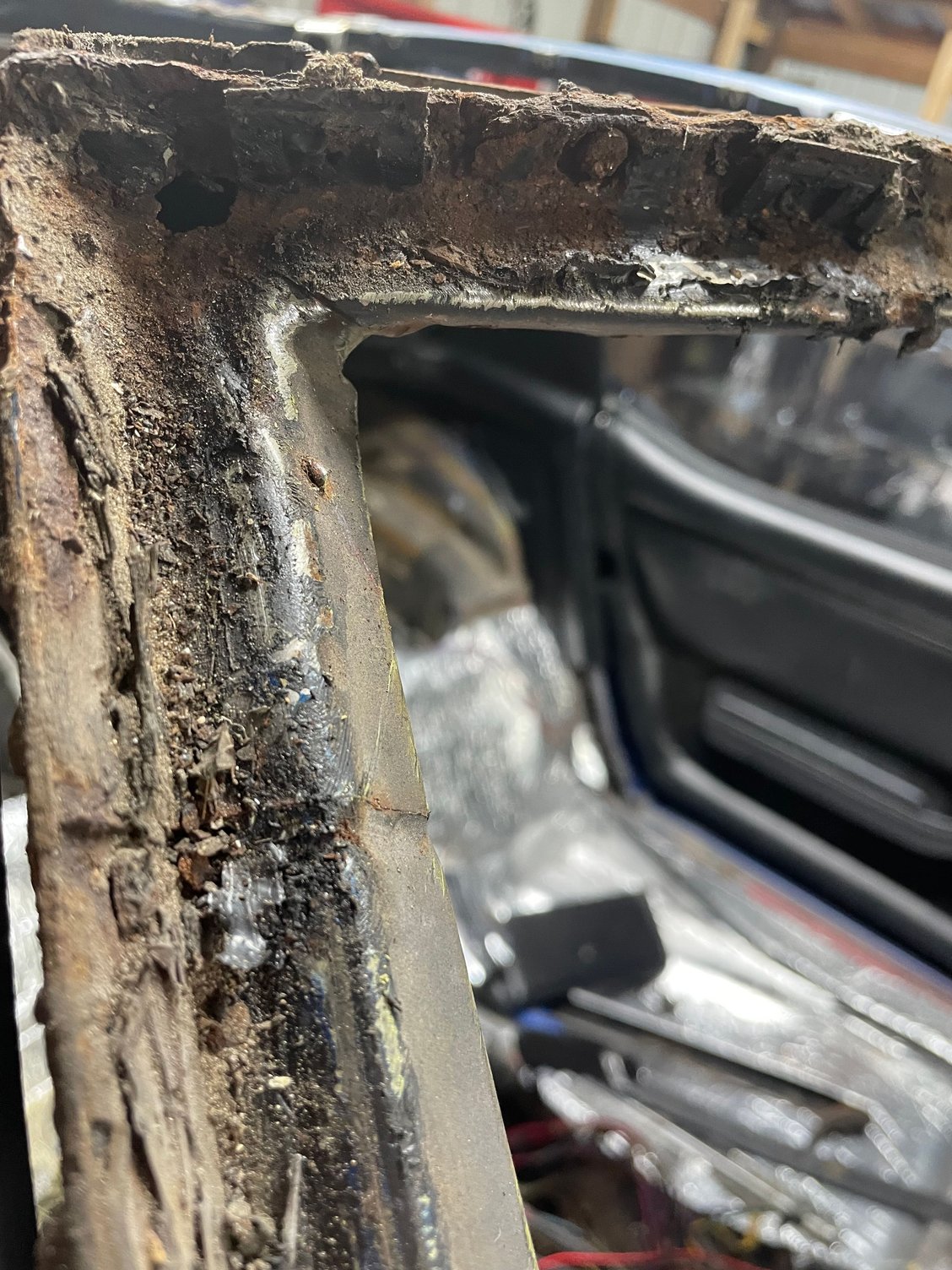

THen next is the rust damage on the passenger side frame lower corner, which isn't that bad either
So I have to wire wheel and clean up everything to get a full inspection then make a plan with two choices:
  1. I can buy a full used frame from a salvage yard and weld that in
  2. I can buy that frame and just weld in the corners that are needed
Old Oct 18, 2023 | 12:23 AM

I can’t give you advise there, but if the replacement frame is in better shape all around, I would just replace the whole frame.
But again, I don’t know what replacing the whole frame in tales.

That's my thoughts too: just cut the whole frame and weld in a new one. Only three cuts and three spots to weld and done in an hour!

As long as you can get the new frame at the exact angles and position as the original so the windshield, side glass and t tops fit as they should.

Well you do have to cut the tops of the fenders, to fix the bottom corners, or pull the front clip..... so maybe not an hour.
My current dilemna exactly!

ya, the front end has to come off so I dont know why anyone is telling you its going to be quick and easy
Oh my hour is only for the upper windshield frame! lol
I talked to Mercury20 in depth about it , and he cuts the fenders when he does it then puts the corners back on with VPA. He said he saves a weekend of work over removing the front clip and the nightmare of aligning it and putting it back on. So I'm likely going to take his advice on that lol
Have y'all done the lower corner repair or removed the front clip ?

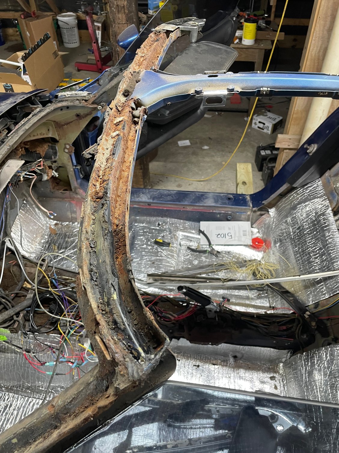

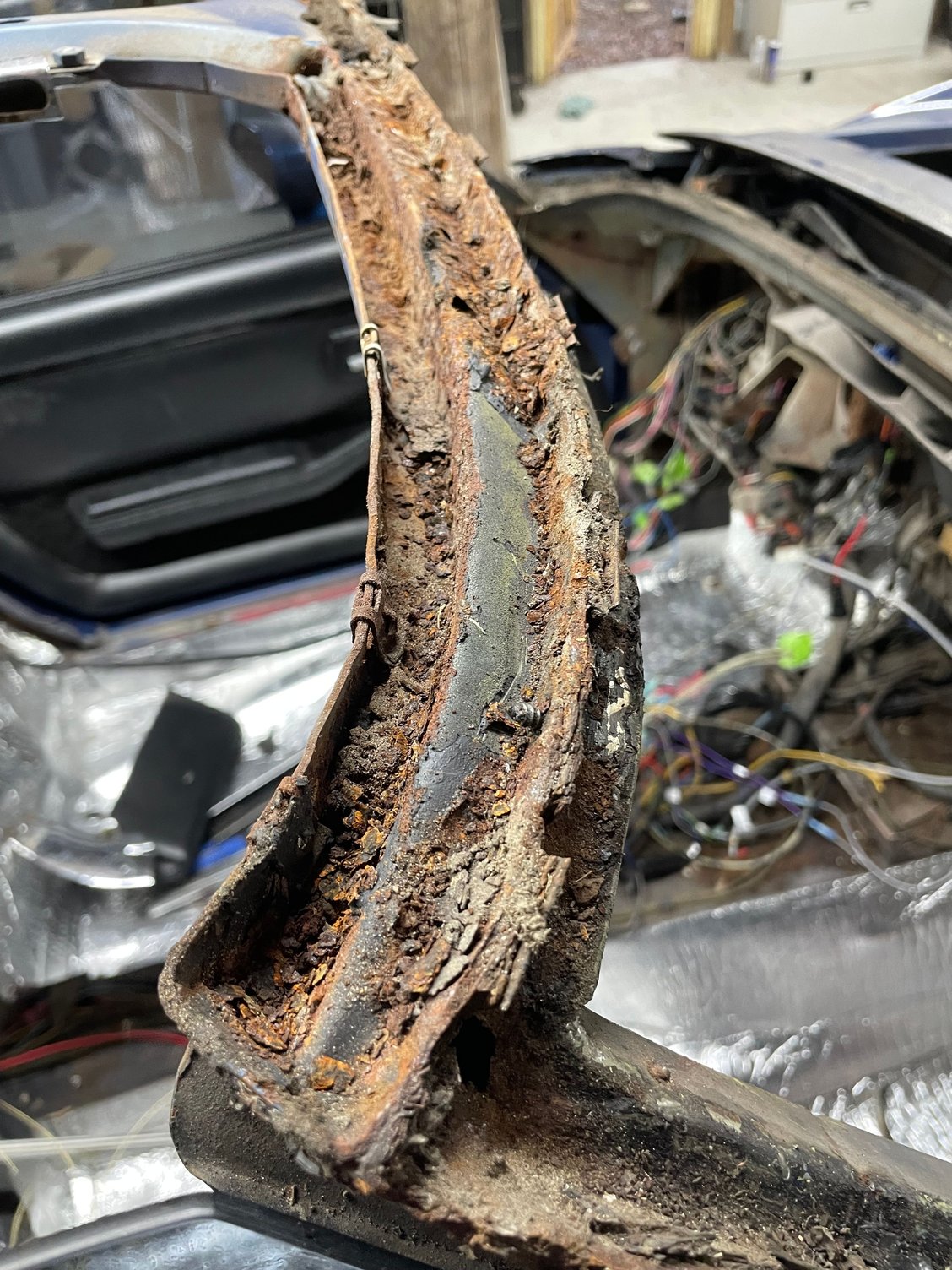

Got back on the C3 tonight, and wire wheeled the rust off my windshield frame to get a better idea of what I'm working with:

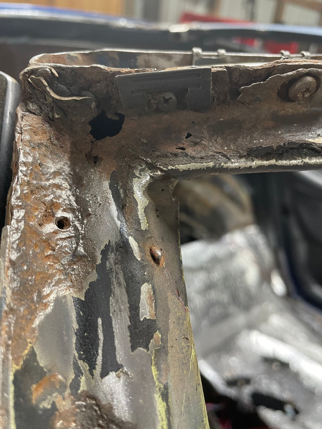

Drivers side upper corner needs to be replaced - the rest of the frame on that side and the lower looks good

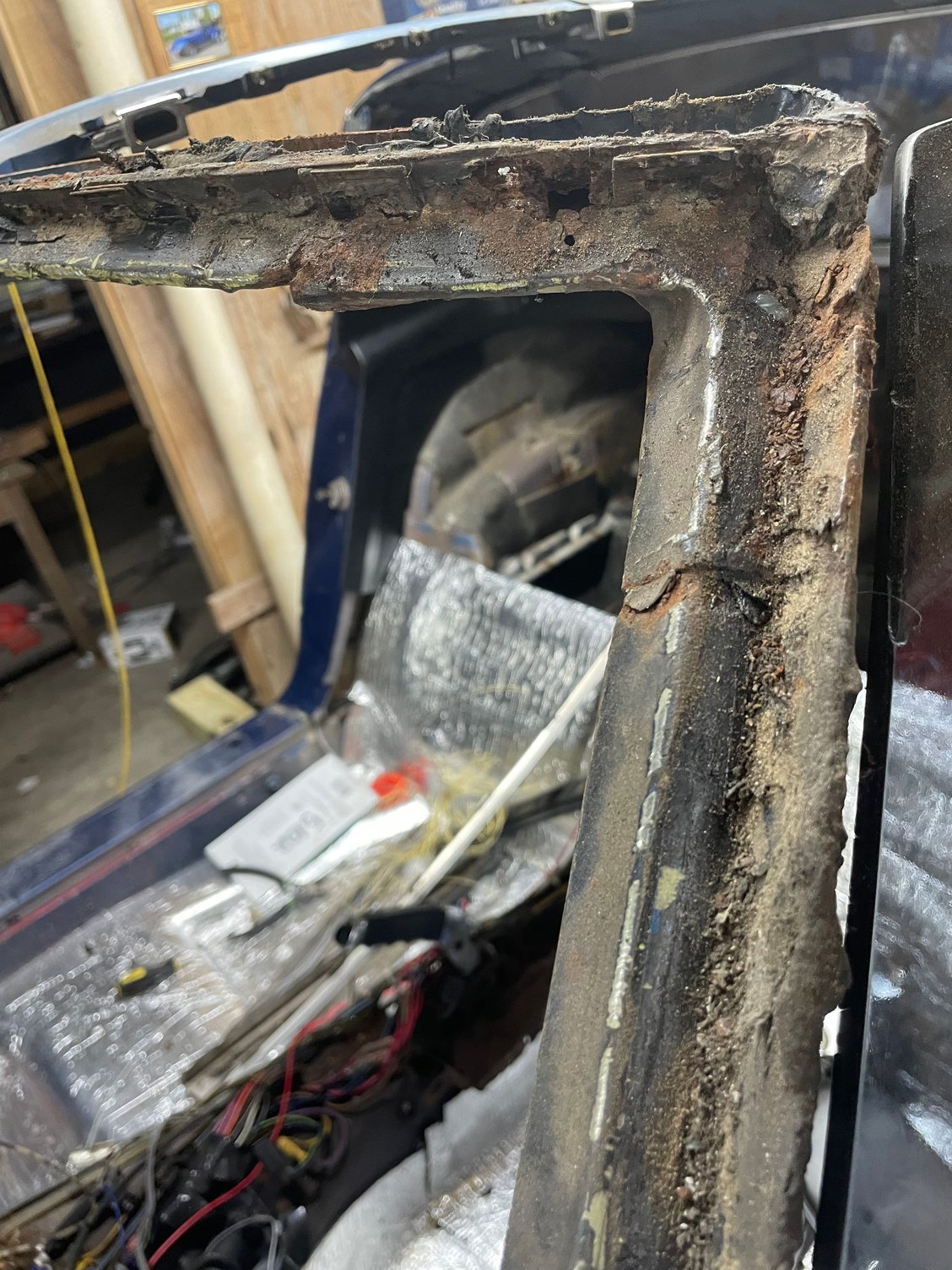

Now to the passenger side, which has more issues:
Upper corner has to be replaced here too
Top of the frame has a lot of cancer too
And the cancer is all over the top passenger bar
After seeing that the corners have to be replace, and that it needs a dozen little patches, I'm not going to do all that tedious work trying to fix all those tiny spots! Going to go grab that complete frame I found for $150 then cut the frame off half way up and burn a new one in this weekend. As always, comment section is open for this plan!

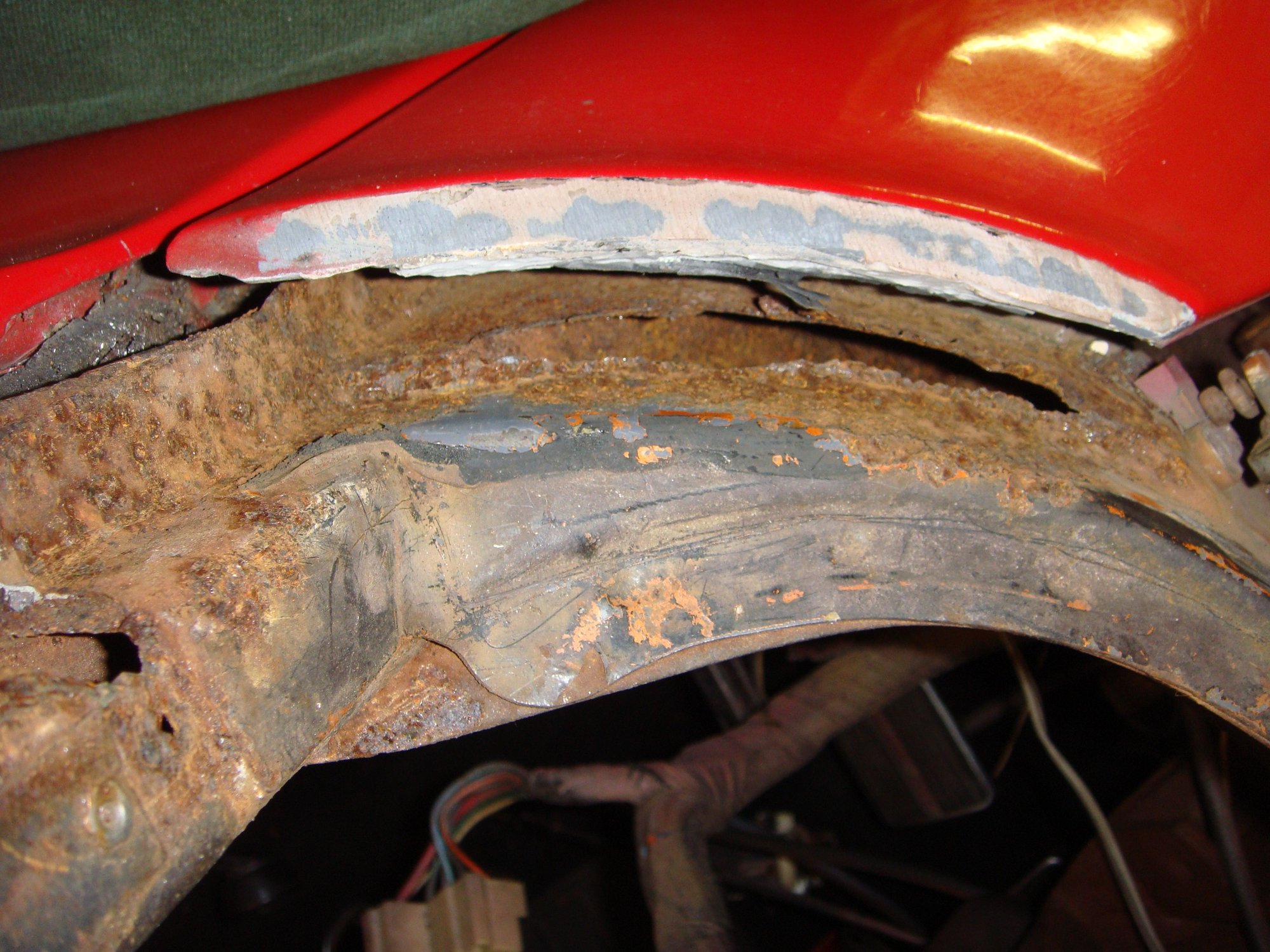

check the lower corners carefully where they go under the fender lip. hard to see but water puddles there and then it just eats.
my top corners are actually better than yours but the bottom is not good.
my bottom corner

I think you have the right idea.
Like Leigh said, check those bottom corners.
my bottom corner
My passenger side lower corner is bad , I posted pics of it above last week. The C3 recycler I found is giving me the lower corners for another $50! I'm likely going to cut the corner of the fender off to access the lower corner and weld new metal in. Mercury 20 has told me it's too much trouble to remove the front clip and get it back on correctly. I've seen others on this forum use this method. How did you access and repair yours?
