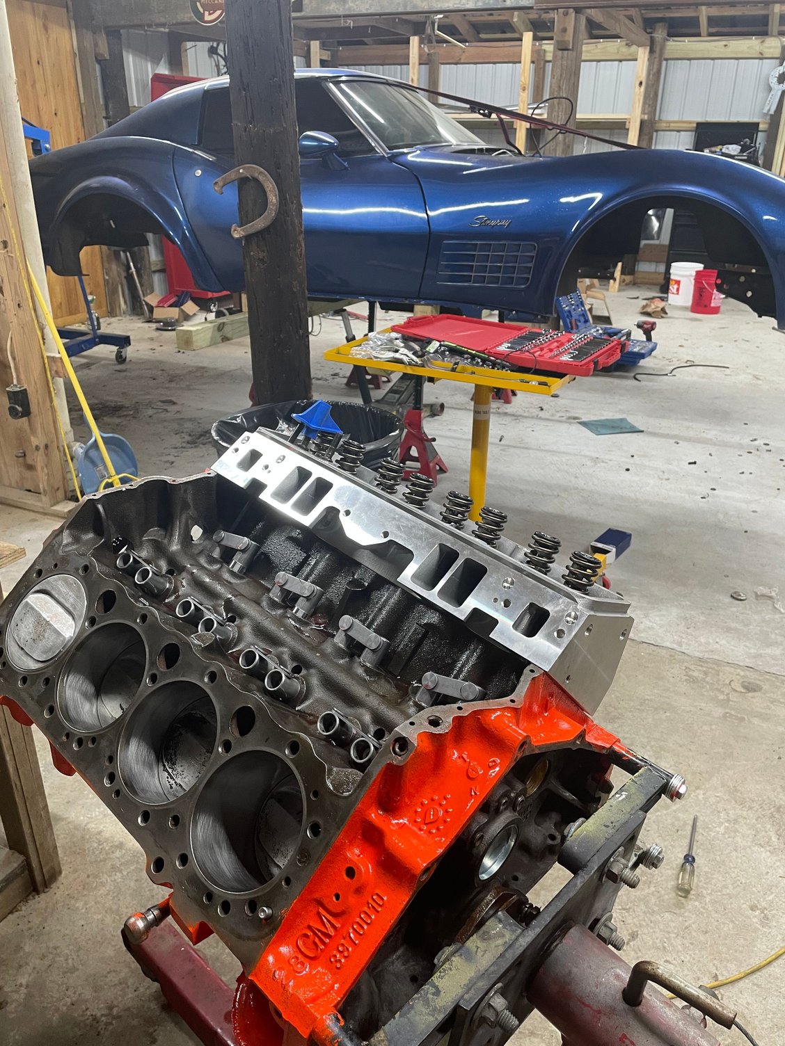

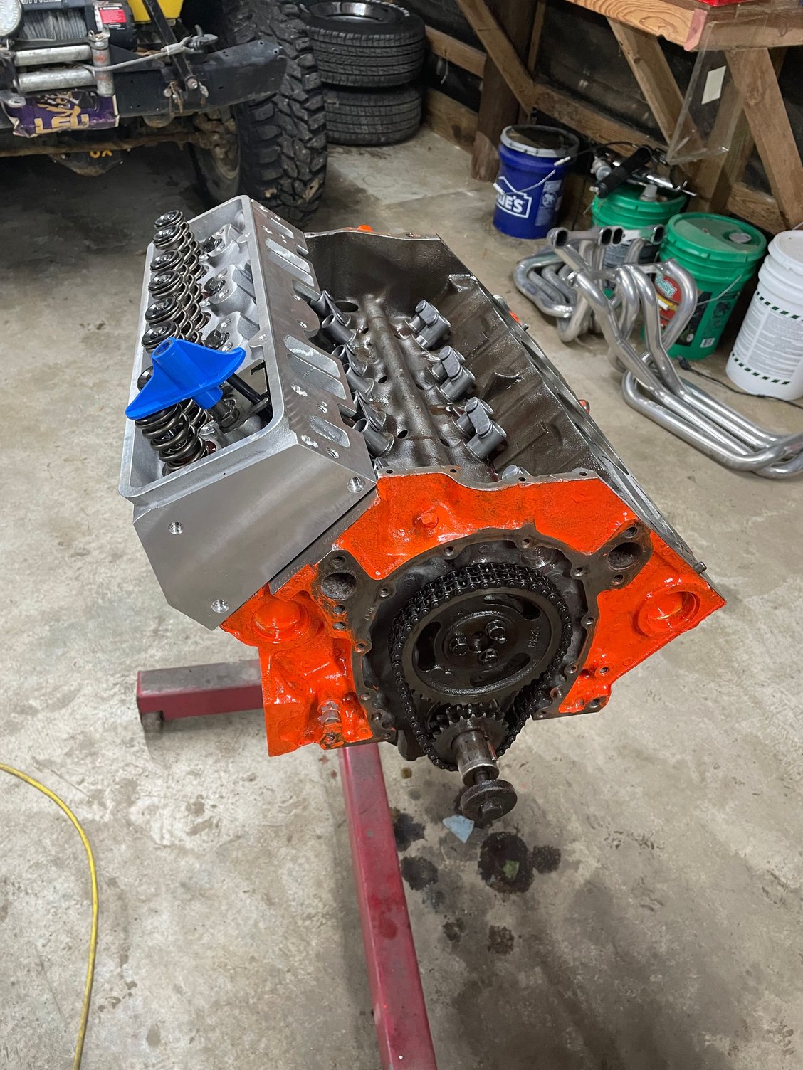

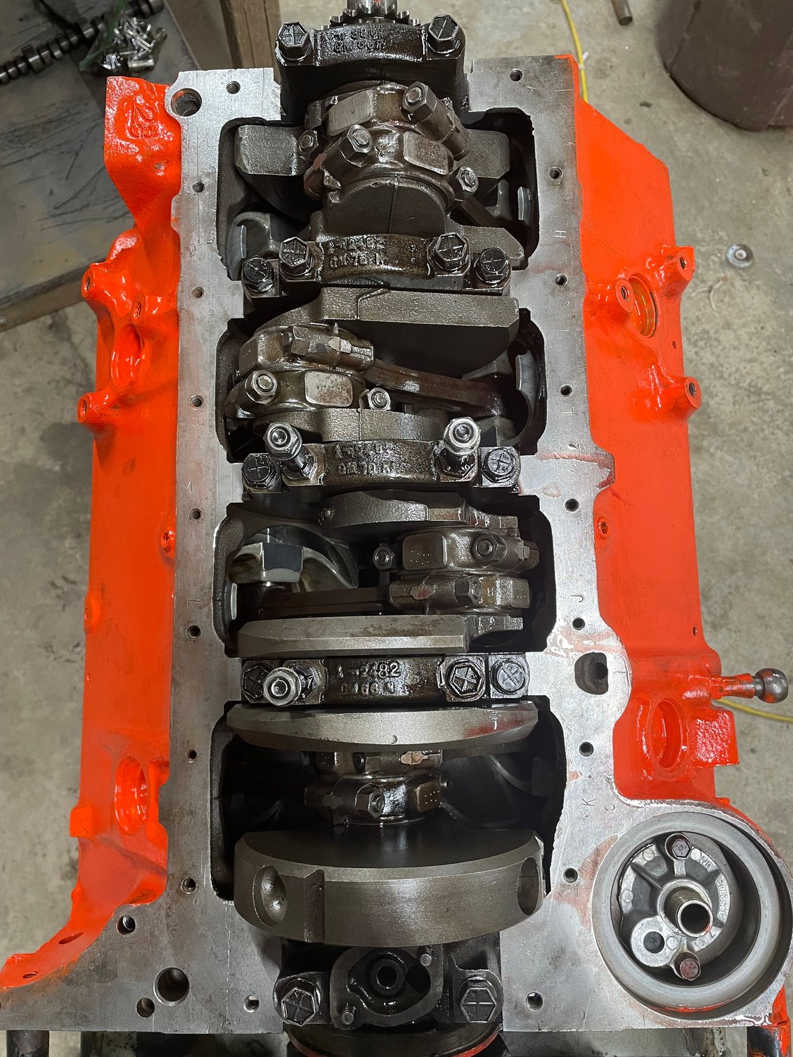

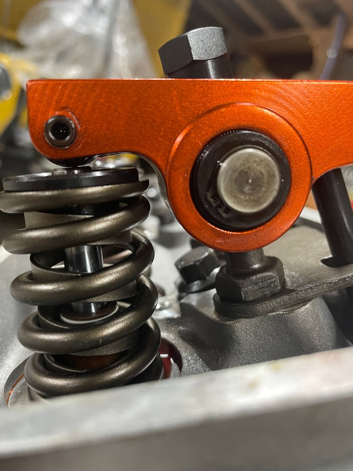

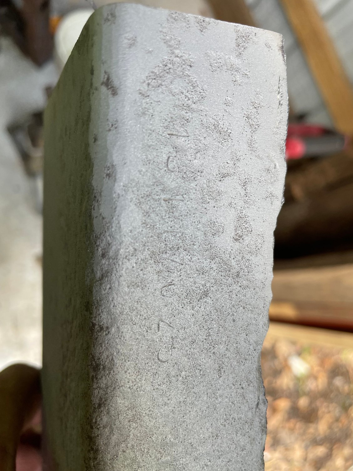

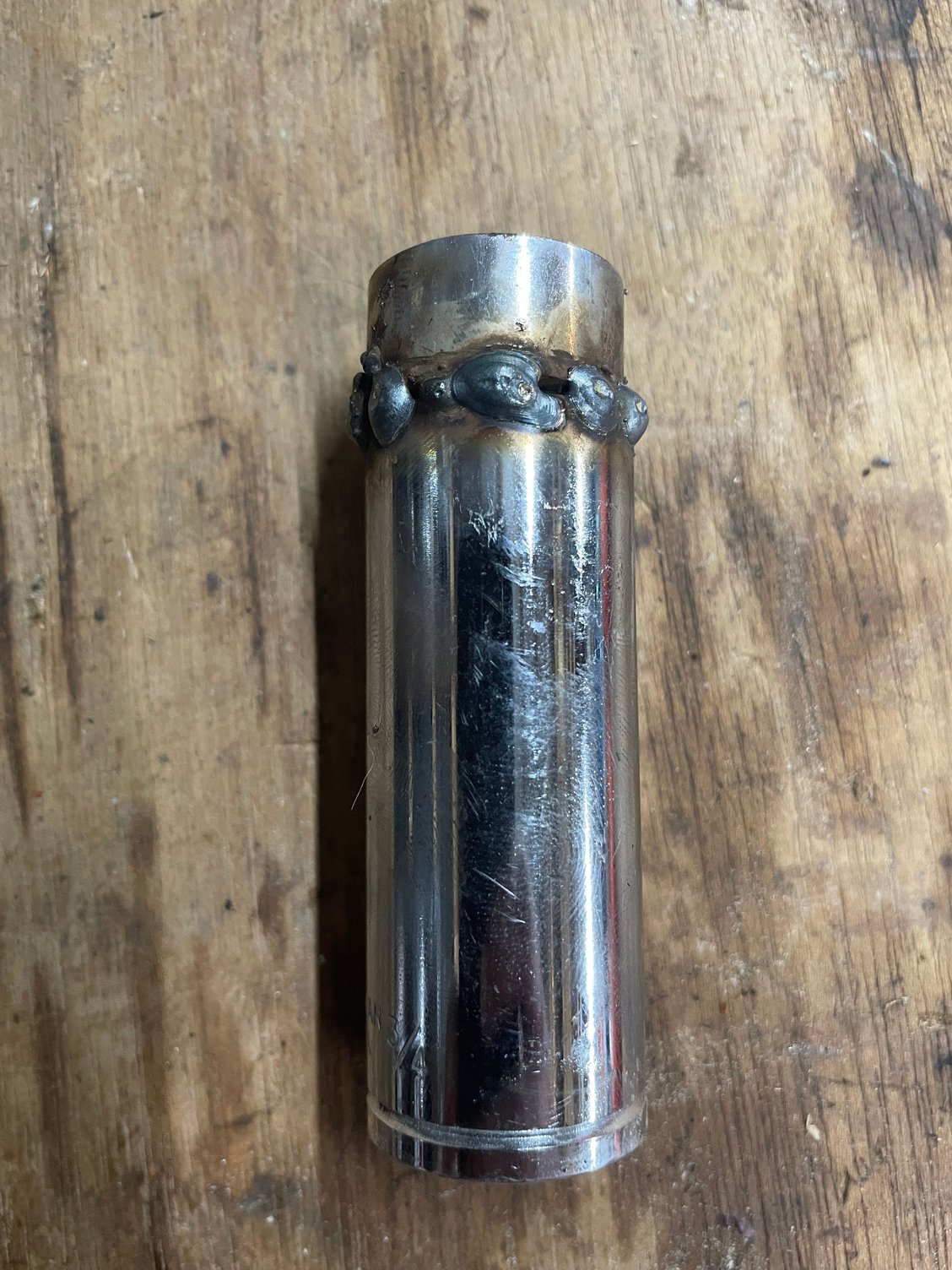

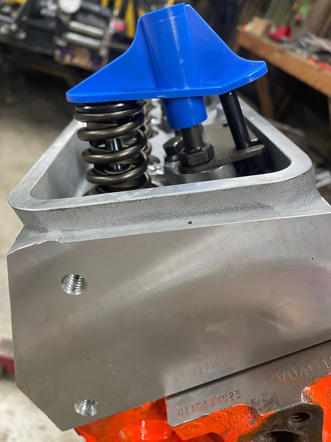

I got some new parts and tools in, so it was time to get to work assembling my engine. Rings, connecting rod bearings, and main bolt tools are in. My issue with the main bolts is that I have the long ones in the middle for the windage tray. A deep socket isn't long enough, and I had nothing that would fit. My first attempt was at crow foots wrenches on my TQ wrench.. second one slipped and rounded the edge of the bolt: NOPE! My buddy had stopped by after work while I was doing this , and had a great idea: "do you have a MIG and some sockets you can sacrifice?!" so we made an extra long socket!
Our "custom" socket lol
Now my mains were properly torqued, it was time to move to my pistons: The new rings had proper gaps (averaging 0.25) - so it was time to get them installed on my pistons:
I had a new tapered ring installer for my 4.060 pistons, as I've been wanting to try them out: OMG what a time saver! It compresses the rings right on the piston and you can easily tap the piston home! I was able to easily get all the pistons installed and rod bolts torqued down.
Next was to figure out my pushrod length - I started with this tool, which was a first for me too: made it super easy, and the pushrods came out to 7.250" just like Howard's recommended!
I also measured my Piston to Deck clearance once I had them installed - I checked all the pistons and it was different on the DS vs PS : 0.18" on the DS and 0.21" on the PS.... I guess it was decked different amounts? Any recommendations on head gaskets?

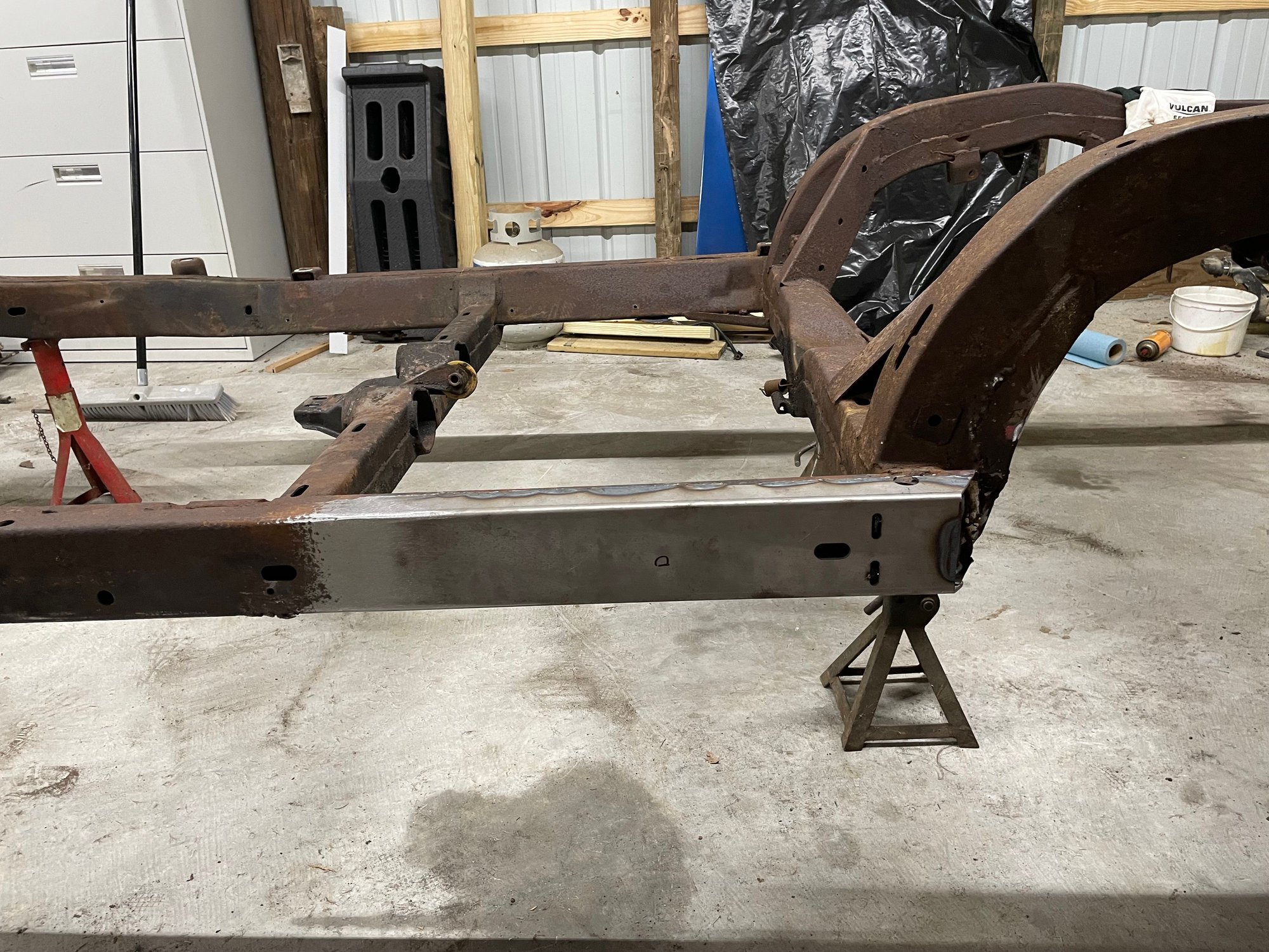

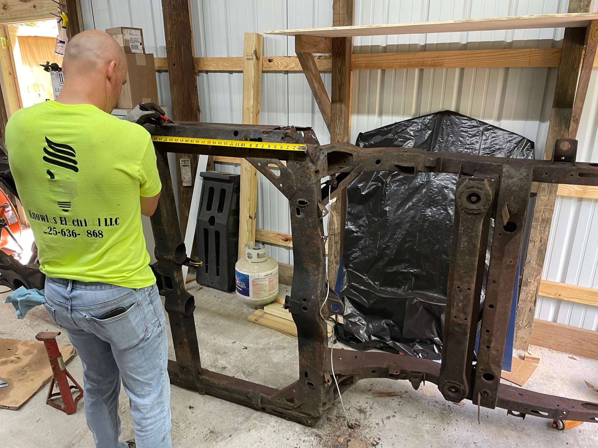

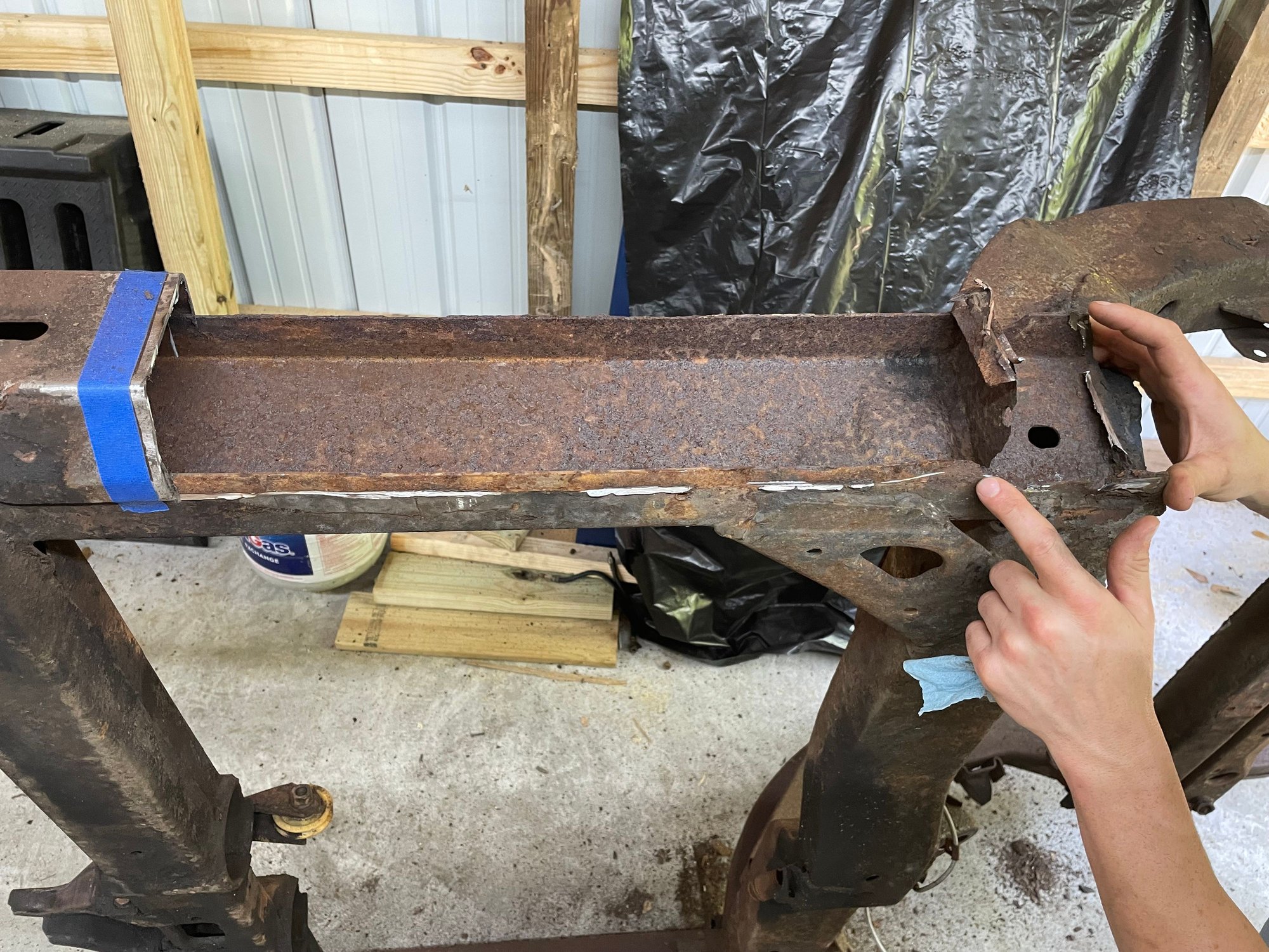

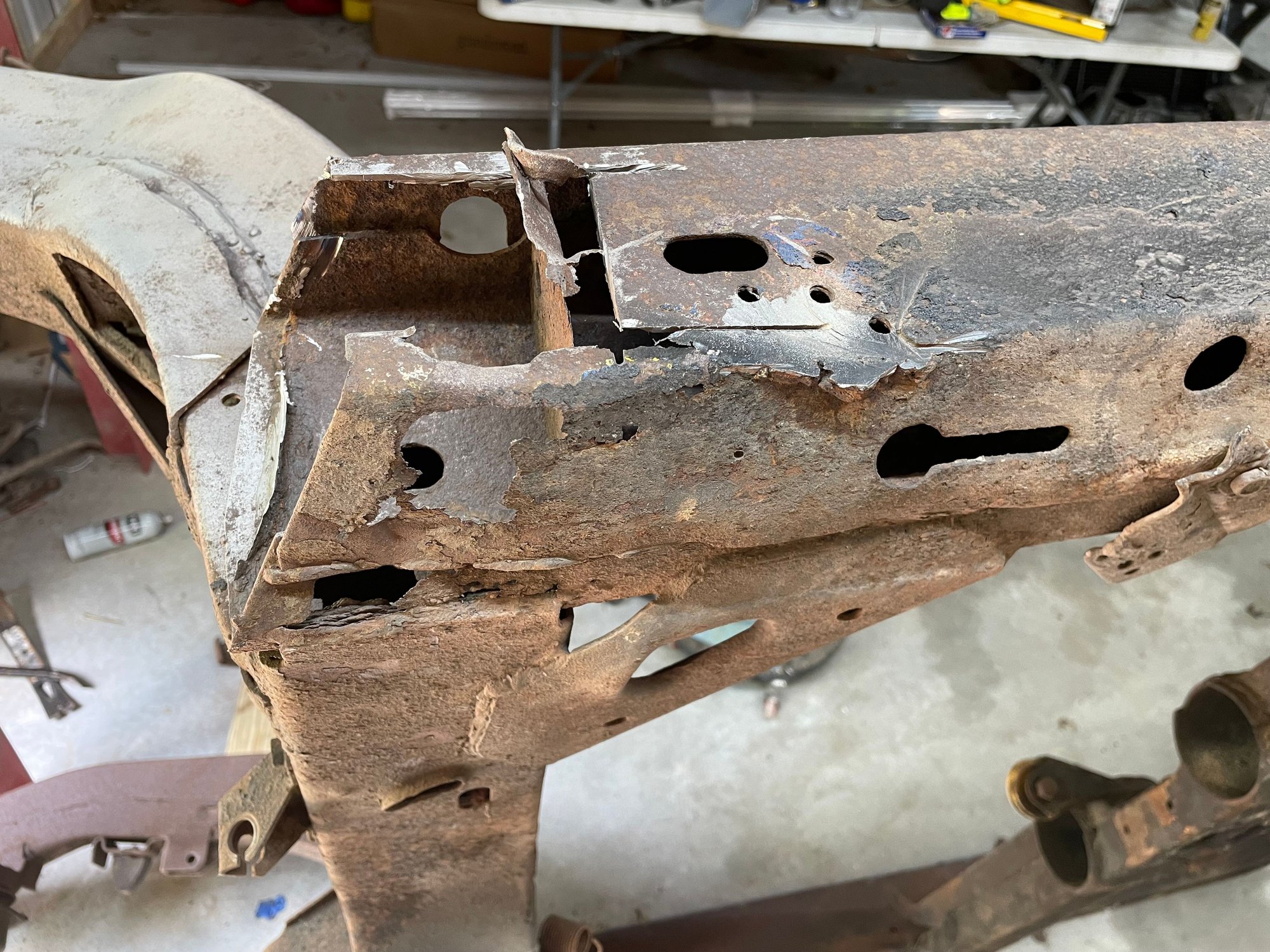

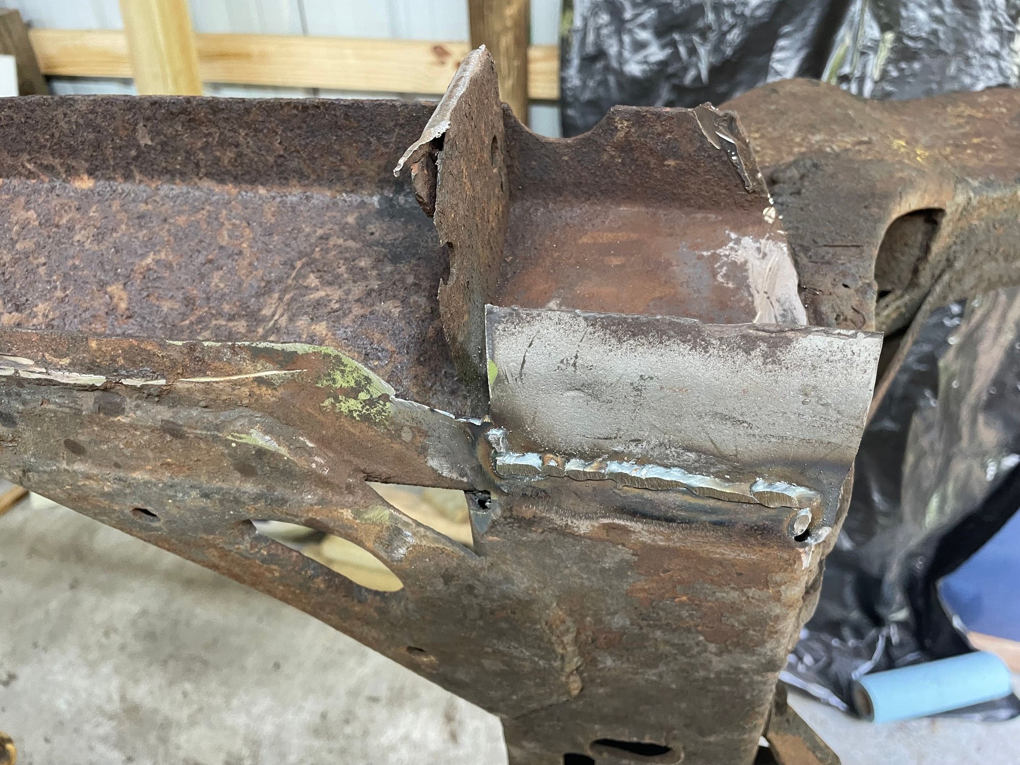

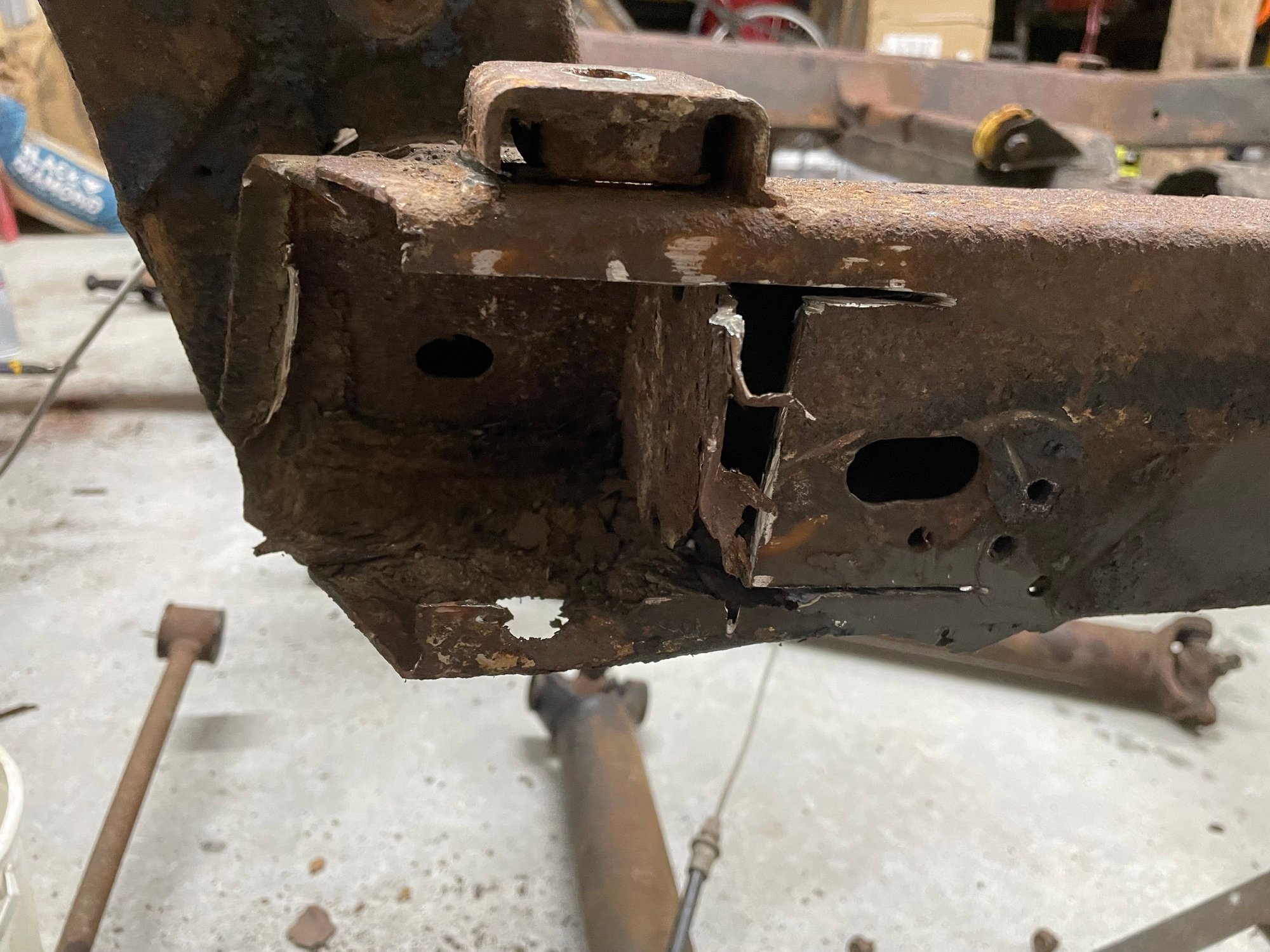

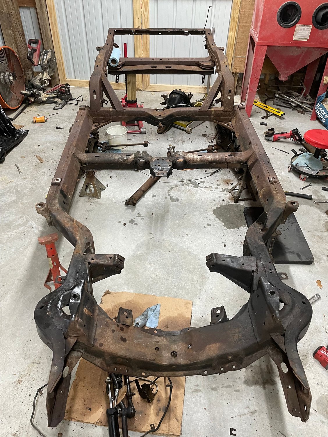

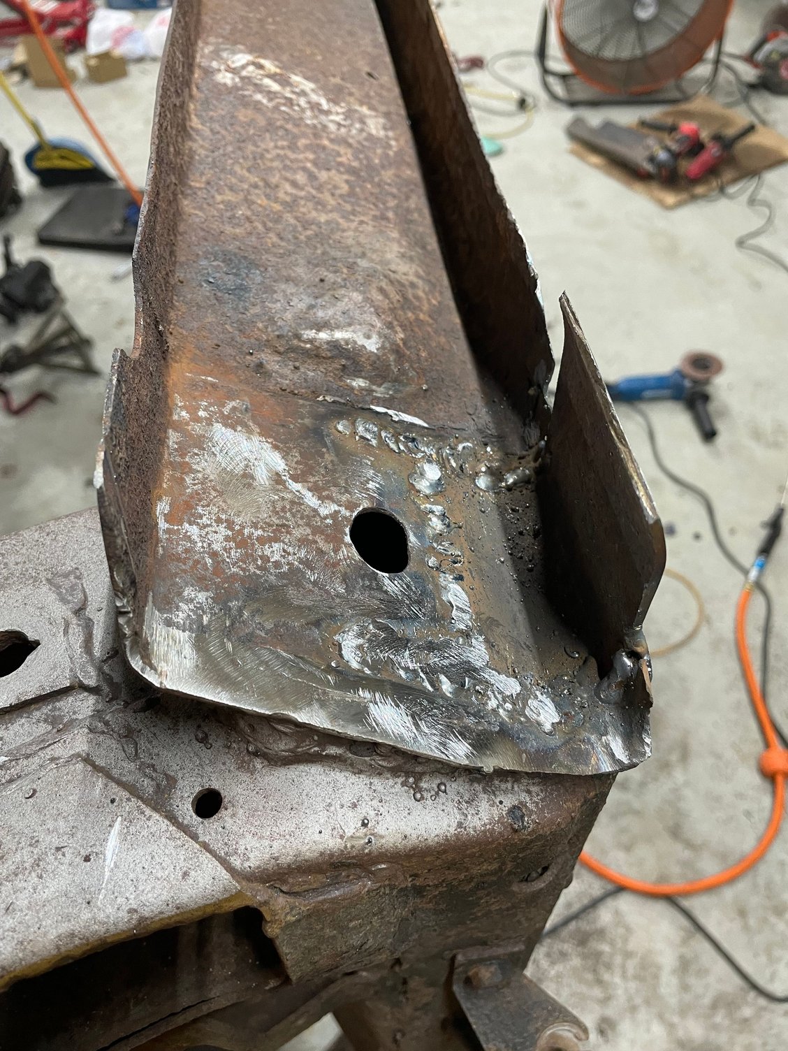

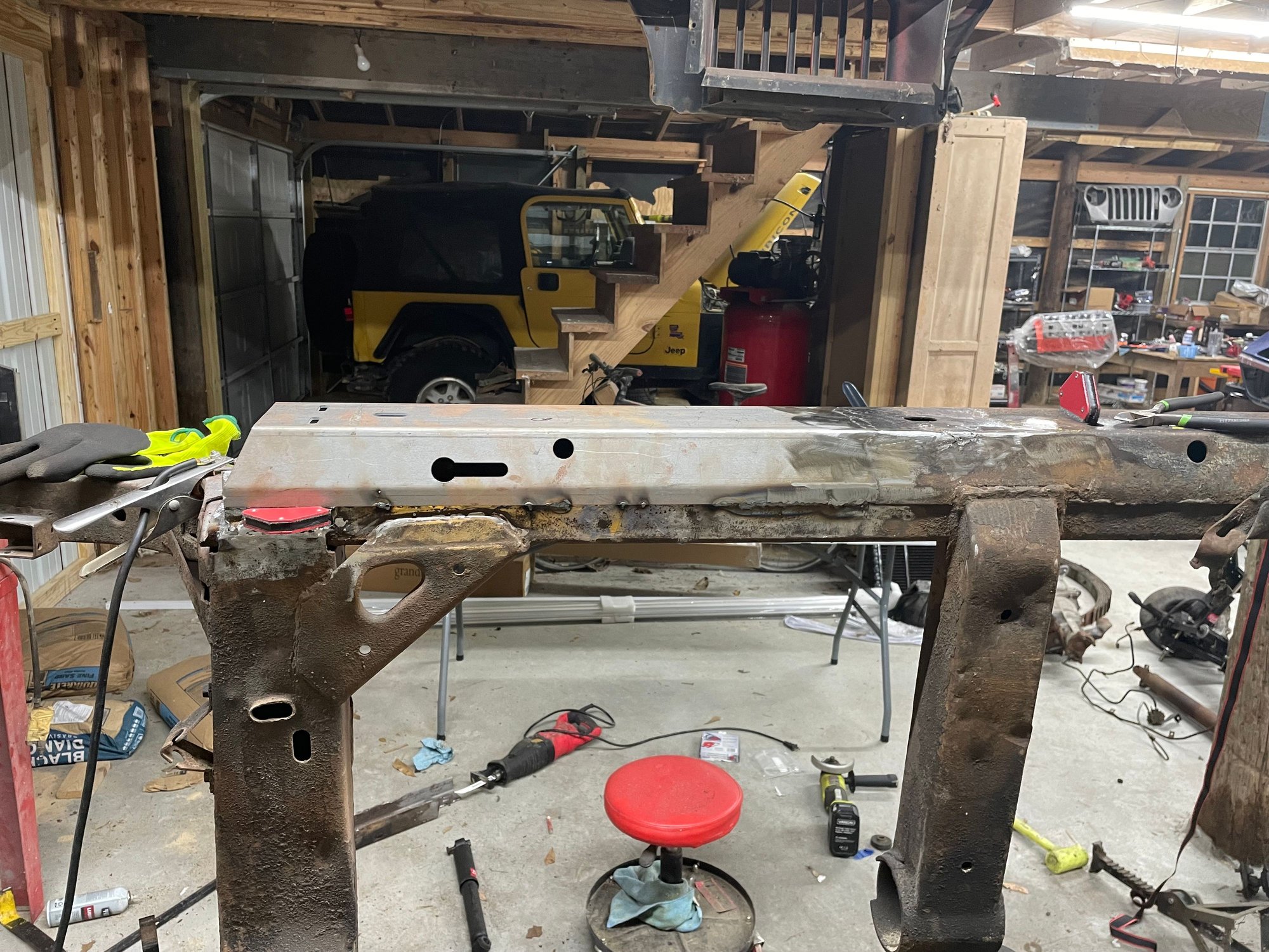

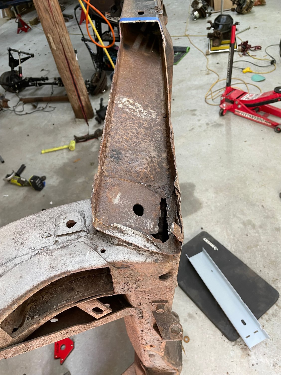

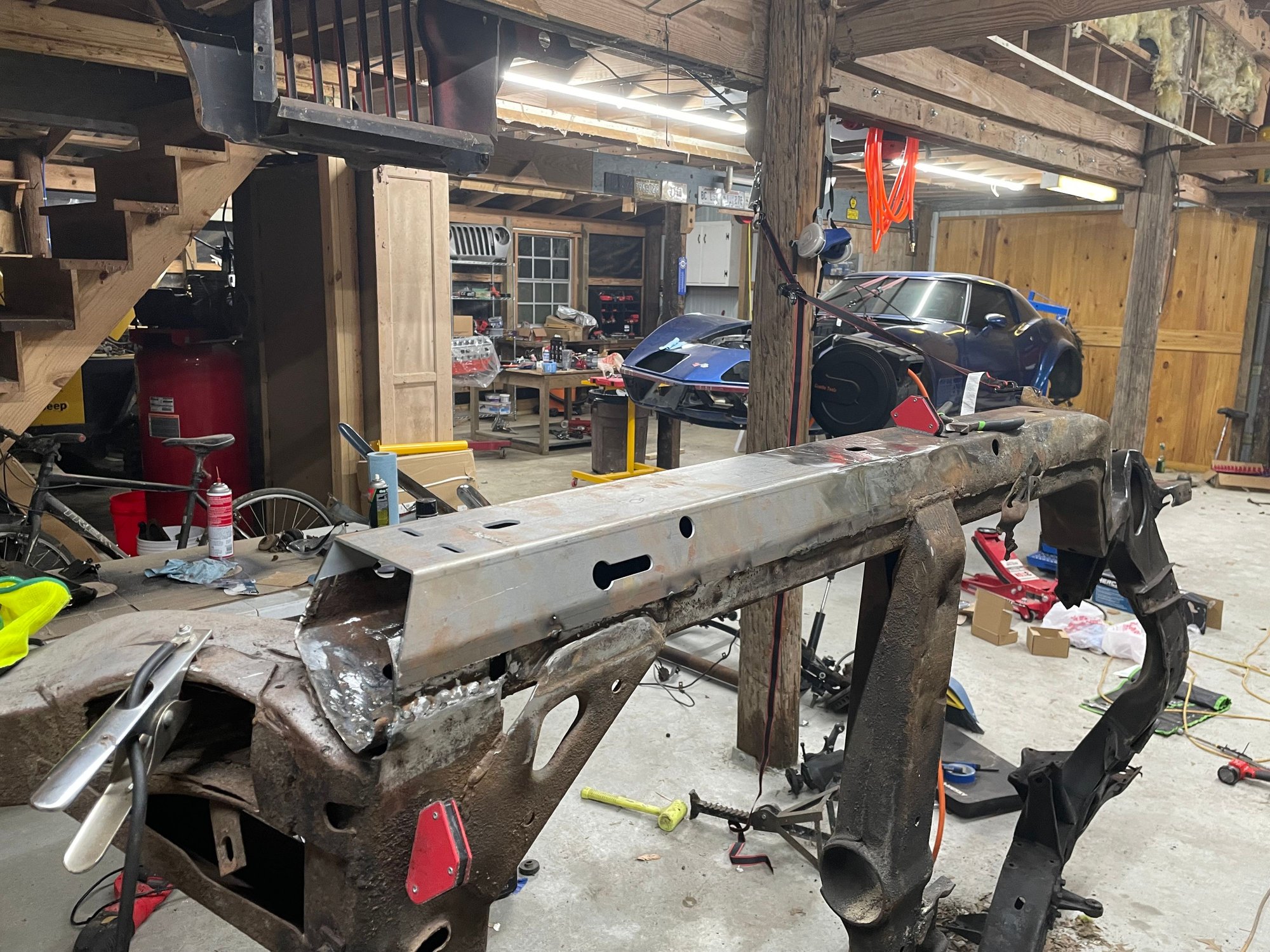

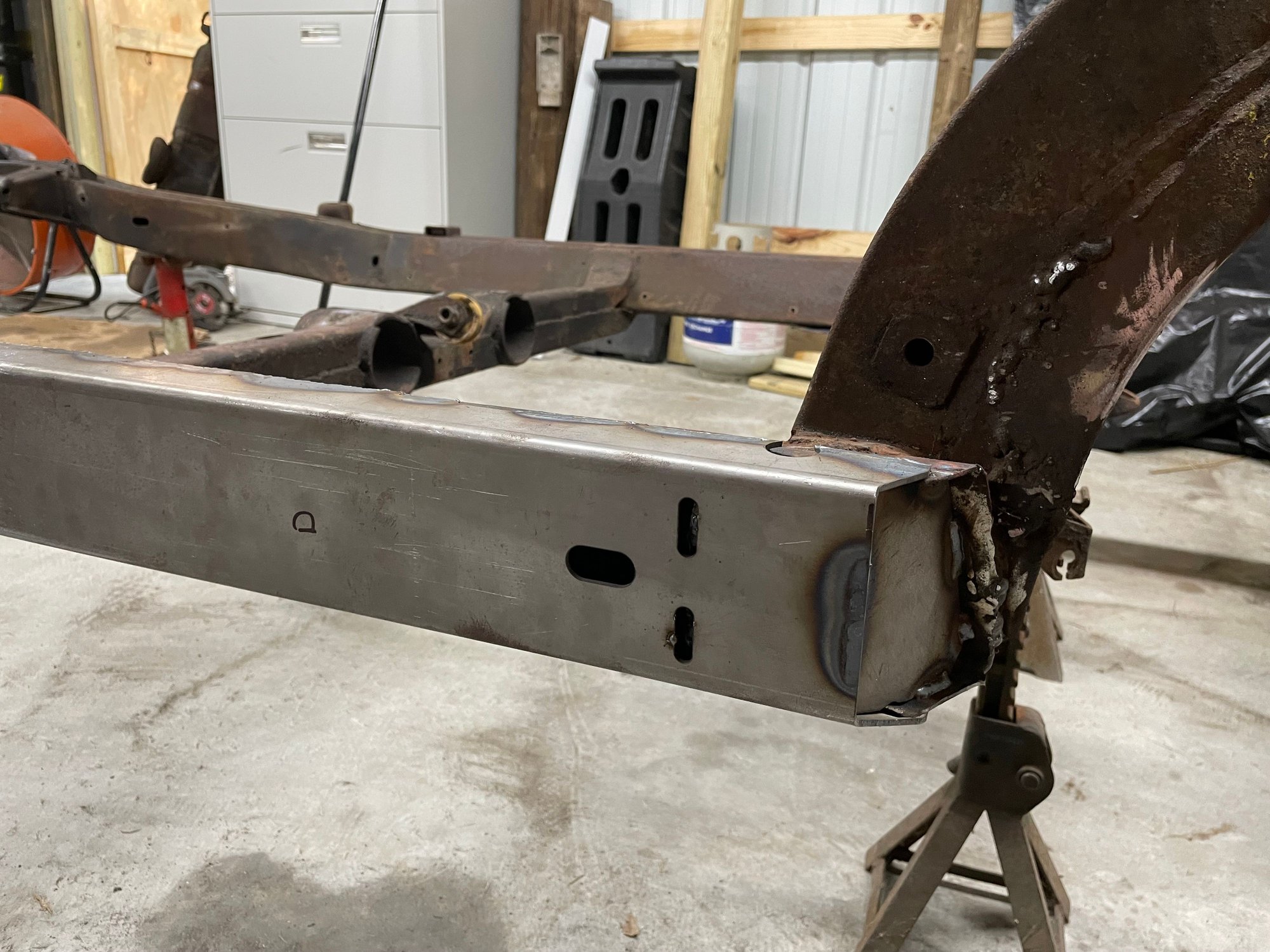

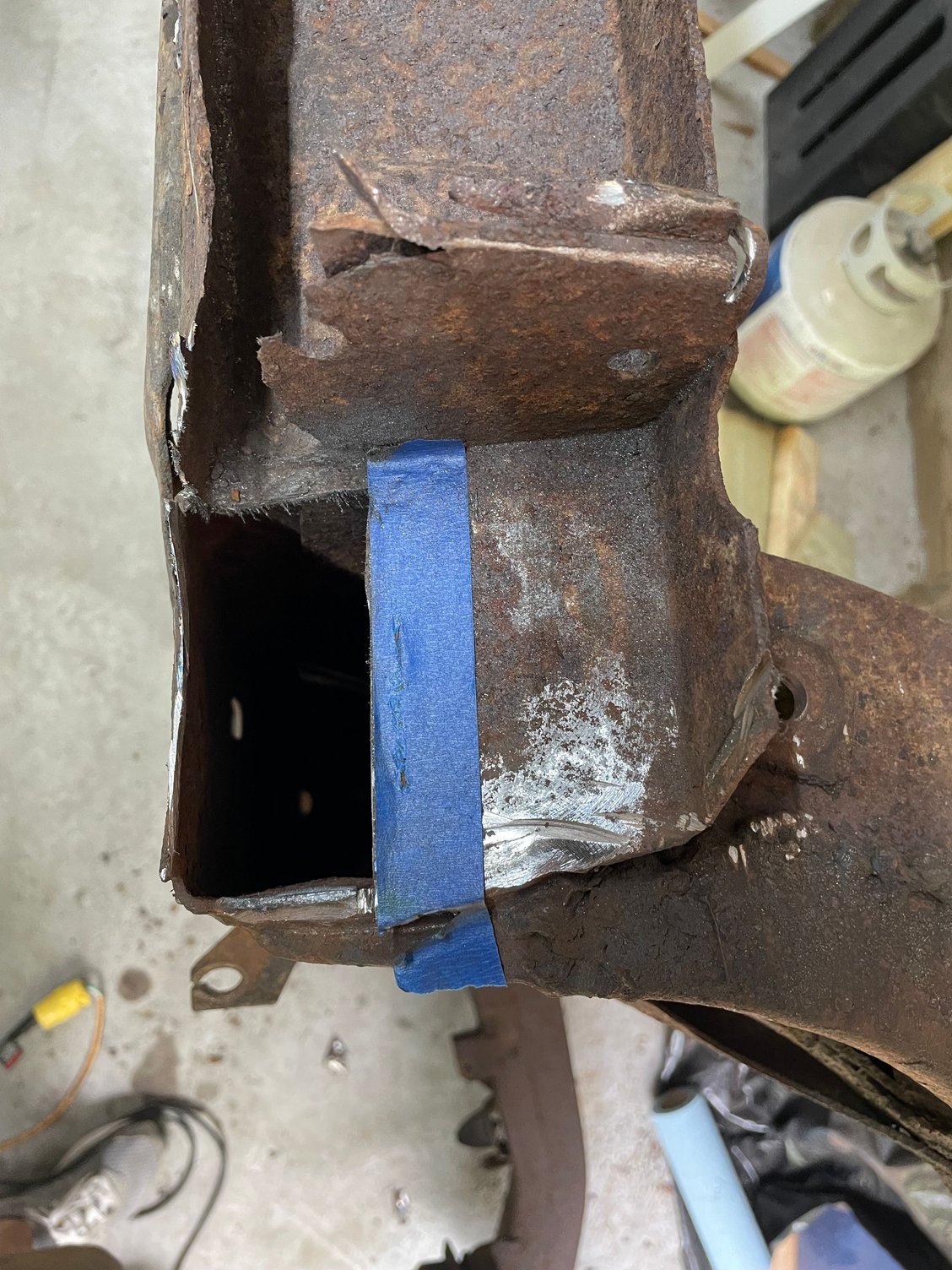

I was able to finish stripping down the frame Friday afternoon: differential, trailing arms, steering box, brake lines, etc.. So she was naked and ready for repairs!
Ready to start cutting!
Starting to cut out the cancer and get ready to cut out the frame section
Another car building buddy (Hebert's Hot Rod's) offered to come help with the frame repair, and I was certainly not turning that down! He's done these repairs before, and gave great guidance through the process.
The frame is in two C shaped sections that are stitch welded together - measure the 22" that match the frame repair panel, cut the stitch welds, and was able to remove the offending metal. We did find a small section of cancer behind it in the kick up, that we had to repair as well.
Cancer inside the frame rail cut out
I ended up using a piece of metal that I had removed from the frame as the patch - I sandblasted it in preparation and FINALLY found my VIN: 7025! It matches my VIN and engine!
Burning in the patch I made
I was now able to burn in the actual patch : I set the frame back down on the ground and welded the whole seam in
Fitted the end cap : never seen my end rails without rot!
Grinded and blended in the welds: will never see the repairs once the frame is blasted and painted

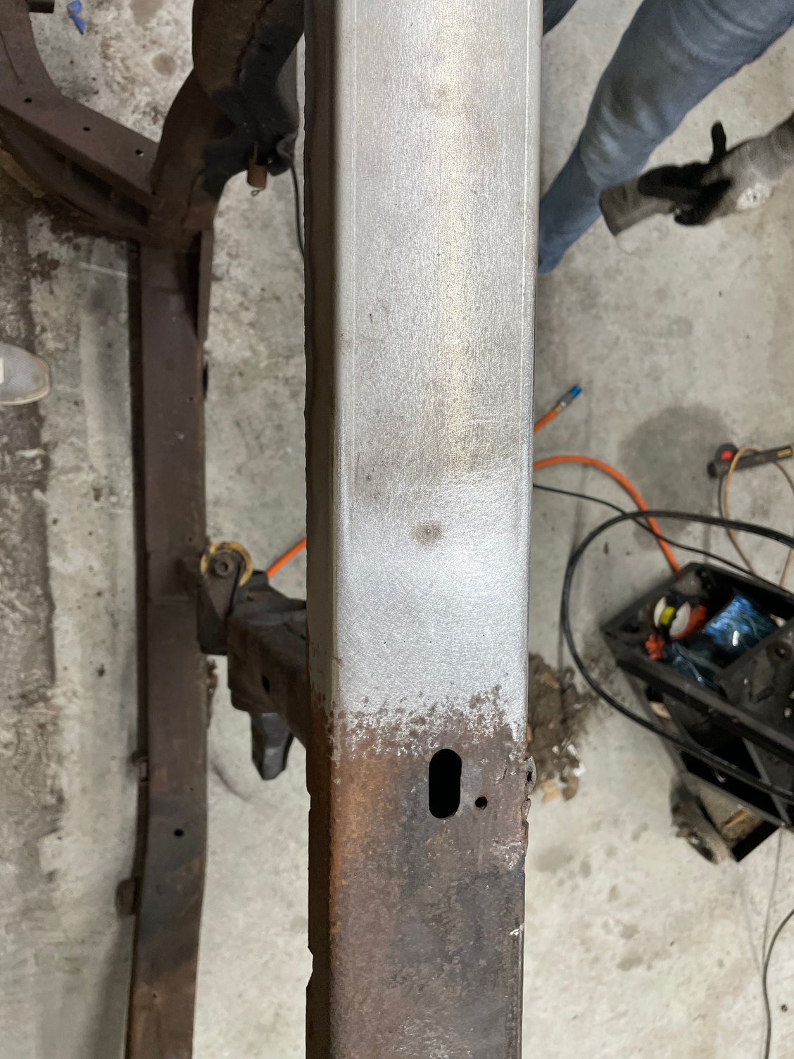

We had good weather Sunday, and I attempted to sandblast my frame... My air compressor thought otherwise , and couldn't keep up the demands of 100PSI and massive CFM! It worked really well for a minute, then pressure would bleed down and I'd have to wait for the compressor to pump up... so I decided to pivot back the frame repair left on the passenger side, and was able to get some blasting done around that area where I'll be working.
Looks like the PS may be worse than the DS?
Rust in the same location as the other side. Will have to create a patch again to reinforce this area.
In the below picture you'll see where I welded in a patch on the frame , after cutting out the bad metal before hand.
New fram rail panel fitted in and starting to burn it in
This is as far as I got tonight, will have to finish burning and grinding tomorrow!
I did get some quotes on sand blasting and powder coating - what kind of cost have ya'll seen on this and whats the long term durability of powder coating?
