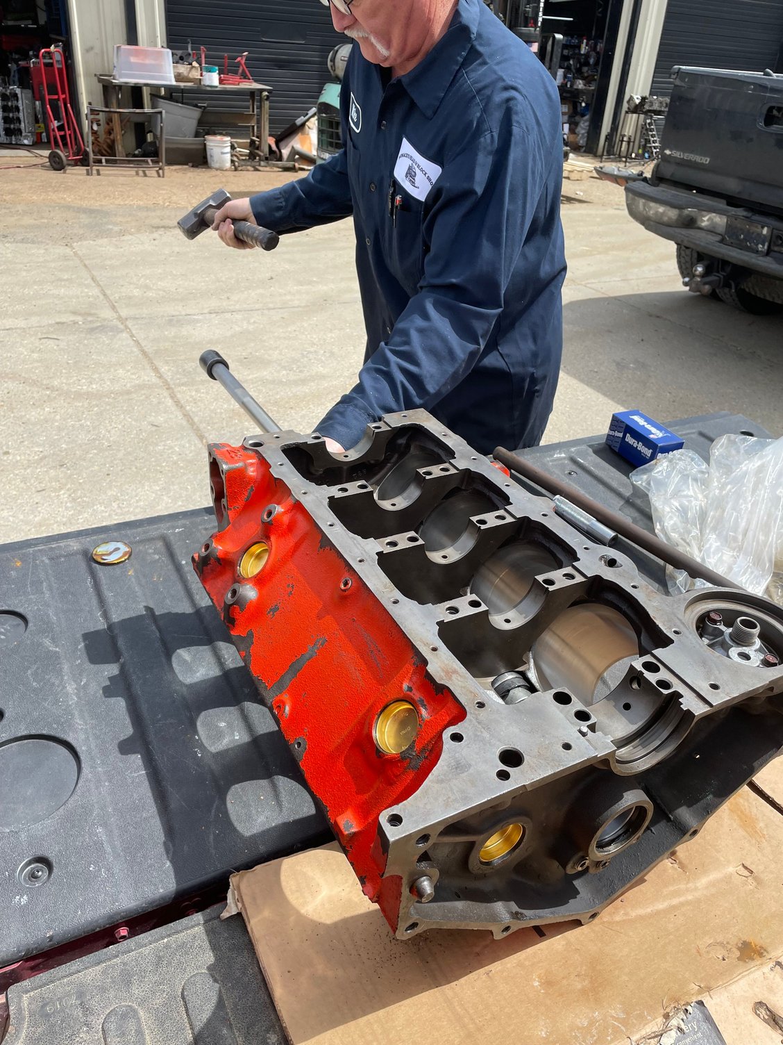

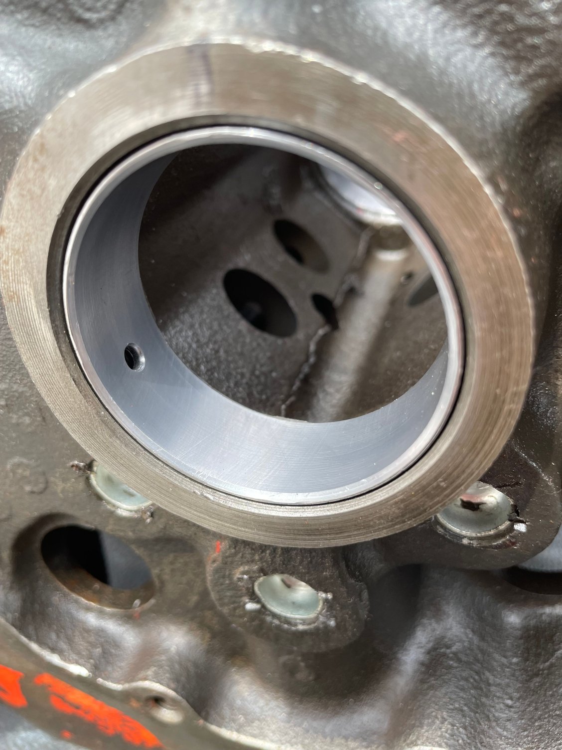

Was able to run by the machine shop at lunch today, and they shook their head when they saw my cam bearings: Said the kid that put them in obviously rough housed it when he test fit the bearings with the test cam.
He popped new ones in on my tailgate, and it took all of 15min! Pretty simple process: FInal result is what I expected the first time

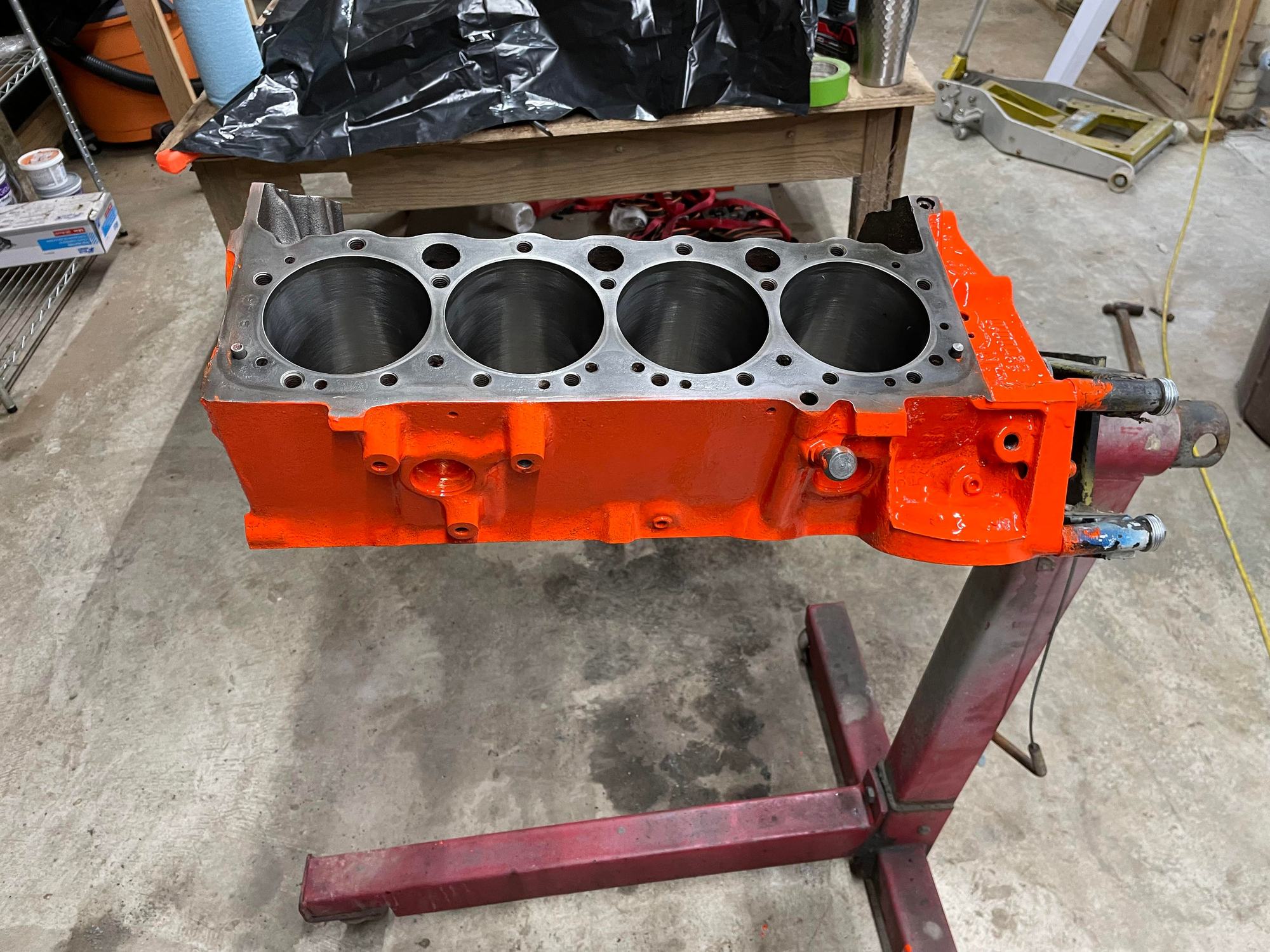

Nothing like a fresh coat of Chevrolet Orange: adds 100HP, adds 2" to your pecker, and puts women in heat!!!!

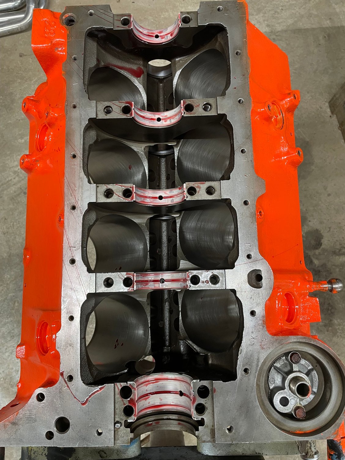

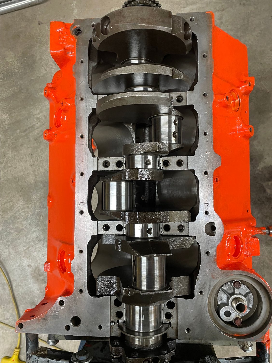

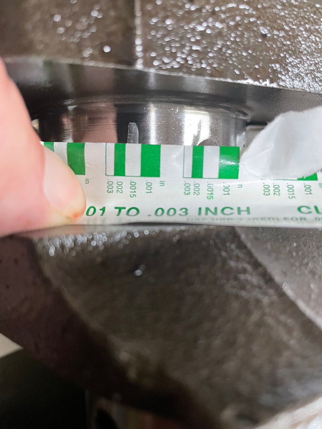

Started my engine assembly with the crank tonight by testing my new Clevite bearings with a plasti gauge: all mains passed!
Once I confirmed all the bearing were within spec, I went ahead and slicked them all down with Permatex Slick Stuff
Next was installing my new cam: I slicked it down with the same stuff, and carefully installed it to not damage my new cam bearings: went in easy - peasy!

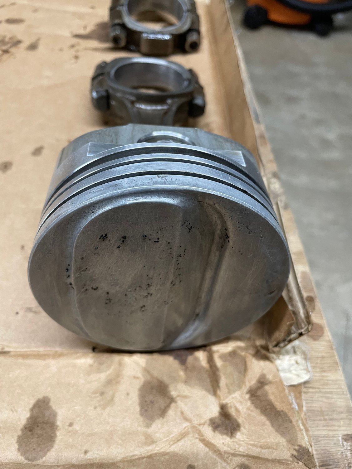

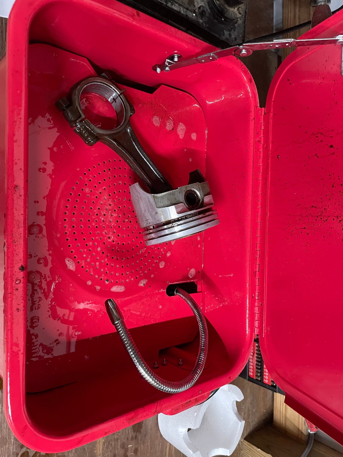

Next it was time to clean off those Forged TRW piston and get the carbon off the tops, and clean out the ringlands. Got to break out my new parts washer and get to work:

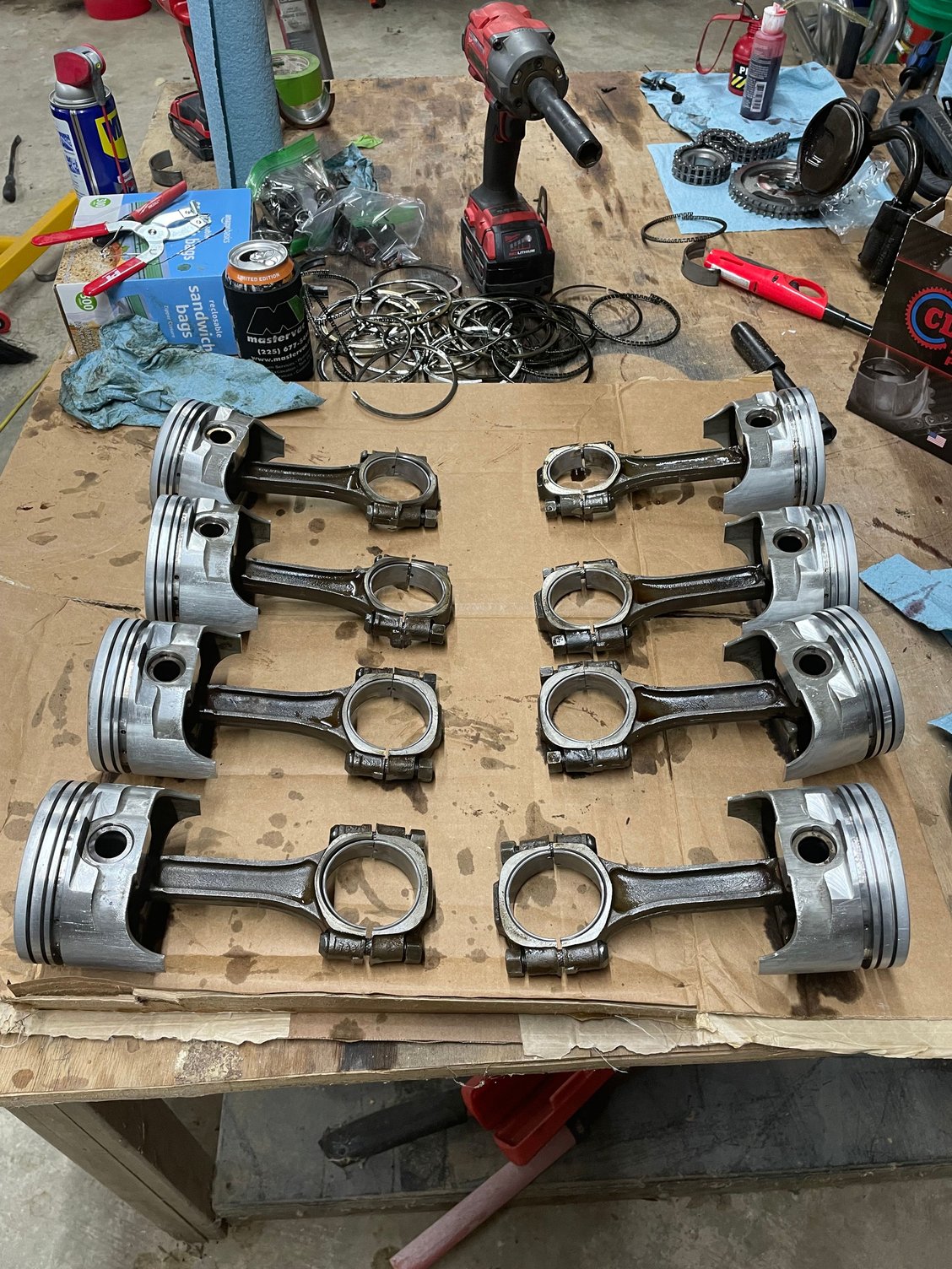

One I had the pistons cleaned off and old rings removed, I went to start measuring ring gaps on the new rings...
#1 top ring: 0.40"
#2 top ring: 0.40"!!!
#3 top ring: 0.40"!!!!!!!
I don't know if I have the wrong rings or what, but calling the manufacturer in the morning to sort this out. Glad I checked them!

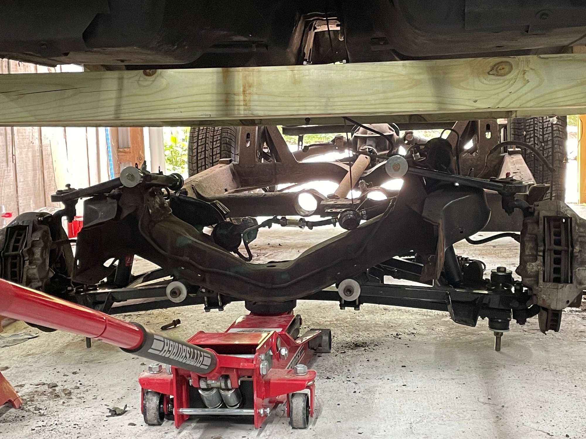

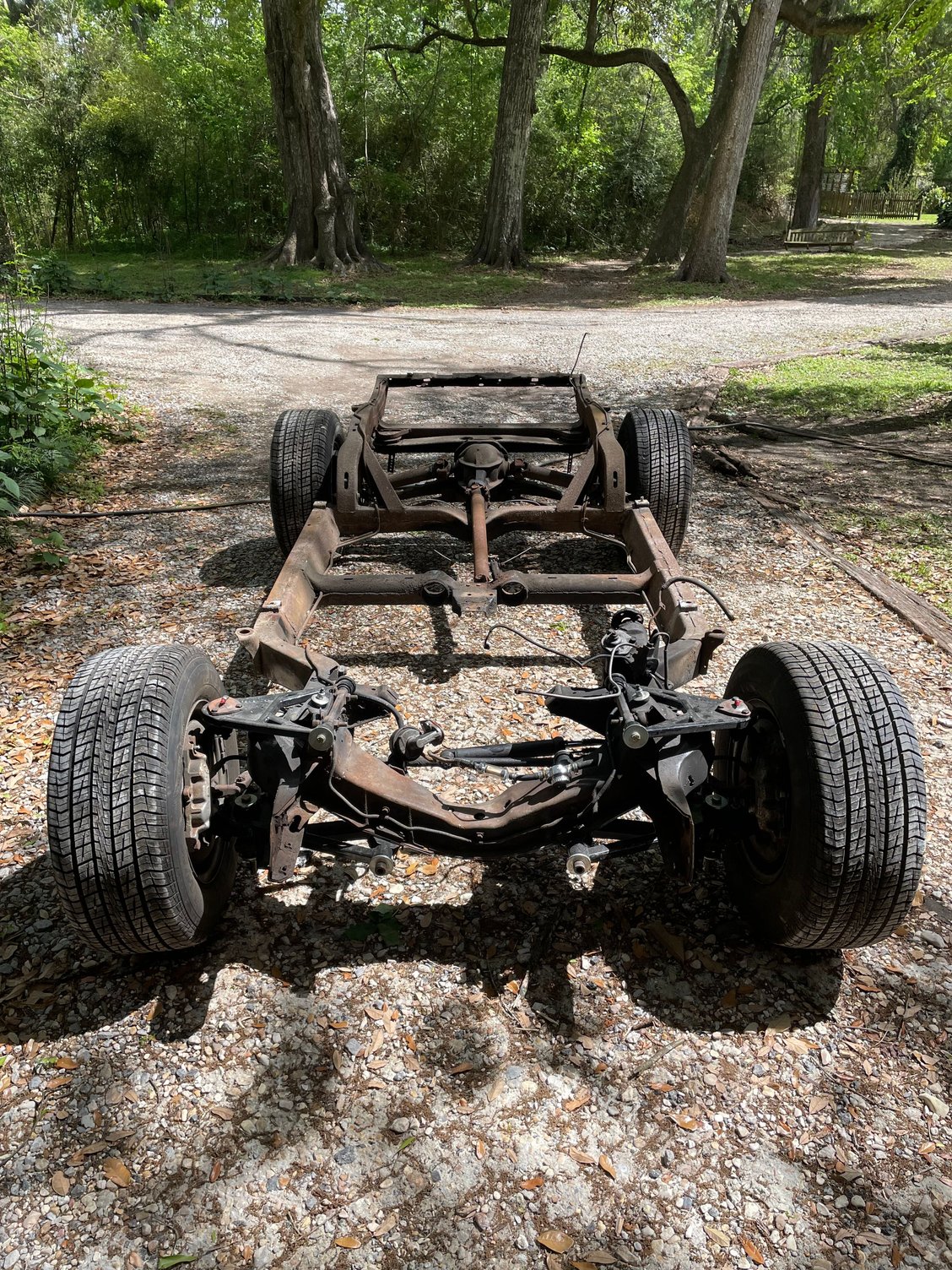

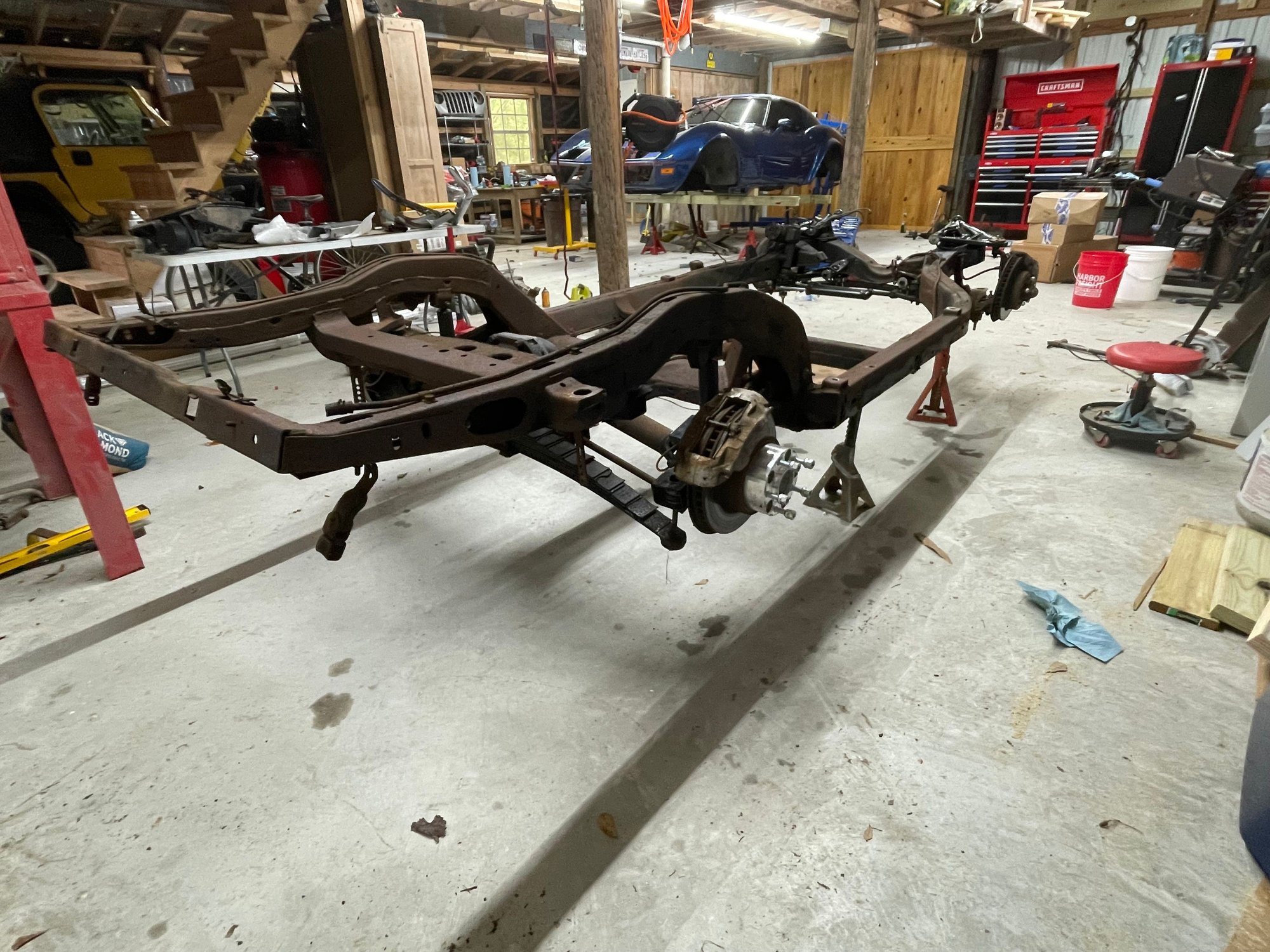

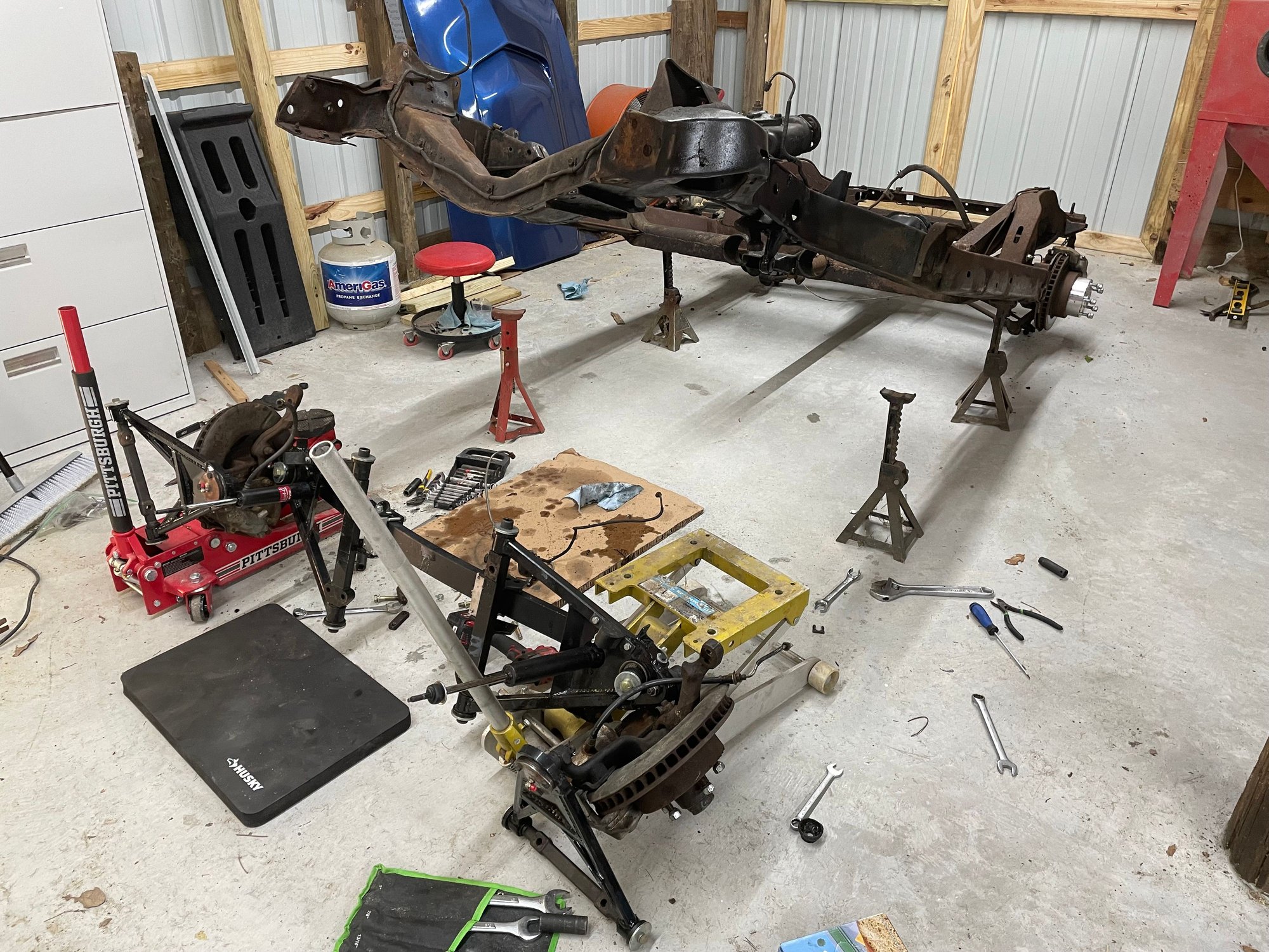

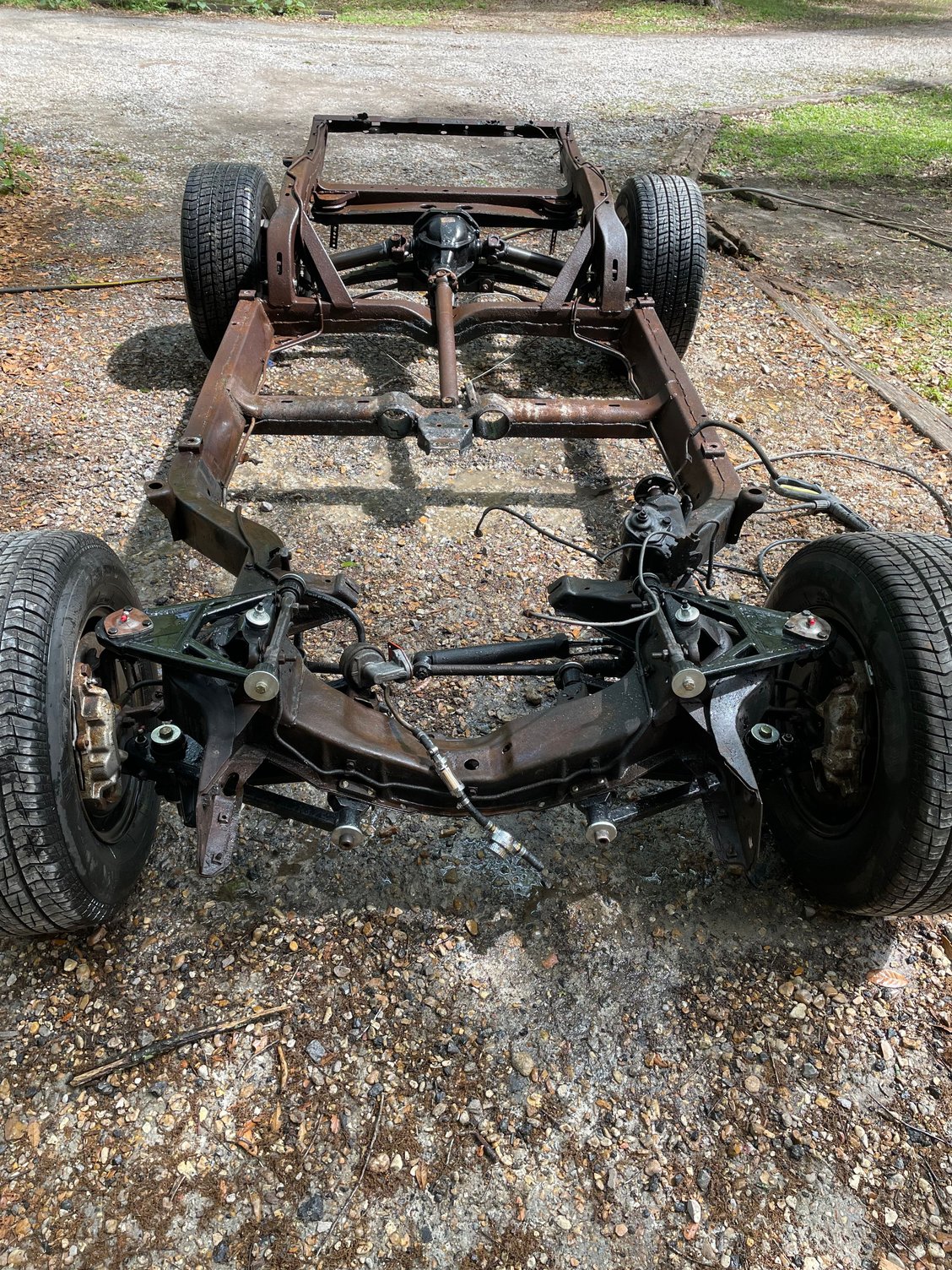

Sunday was nice and cool, and I was able to spend the day wrenching on my Vette. First priority was to get the chassis rolled out from under the body and into a different bay of the shop to work on . This was tricky because I couldn't get it up high enough on the 6 ton jack stands and the steering box and tires wouldn't clear the 4x4's.. I thought I could just air down the tires to clear: still needed another inch! I ended up removing the front wheels and rolling the chassis out on the jack: Success!
Finally able to have the chassis out in the daylight, for the first time since 1971!

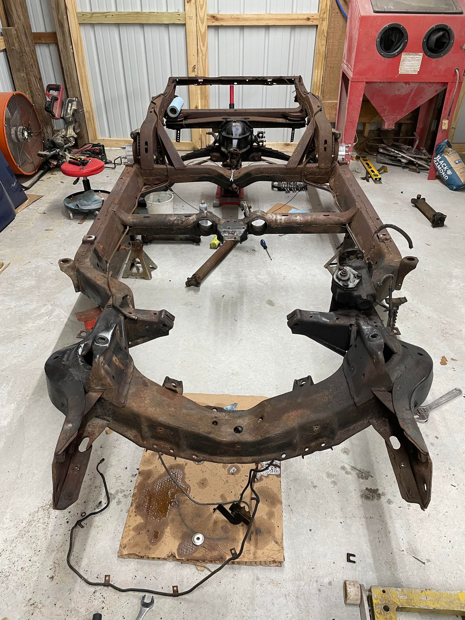

First order of business was to degrease and pressure wash the frame
I was then able to drag the frame around to the other side of the barn to get it into a different bay.

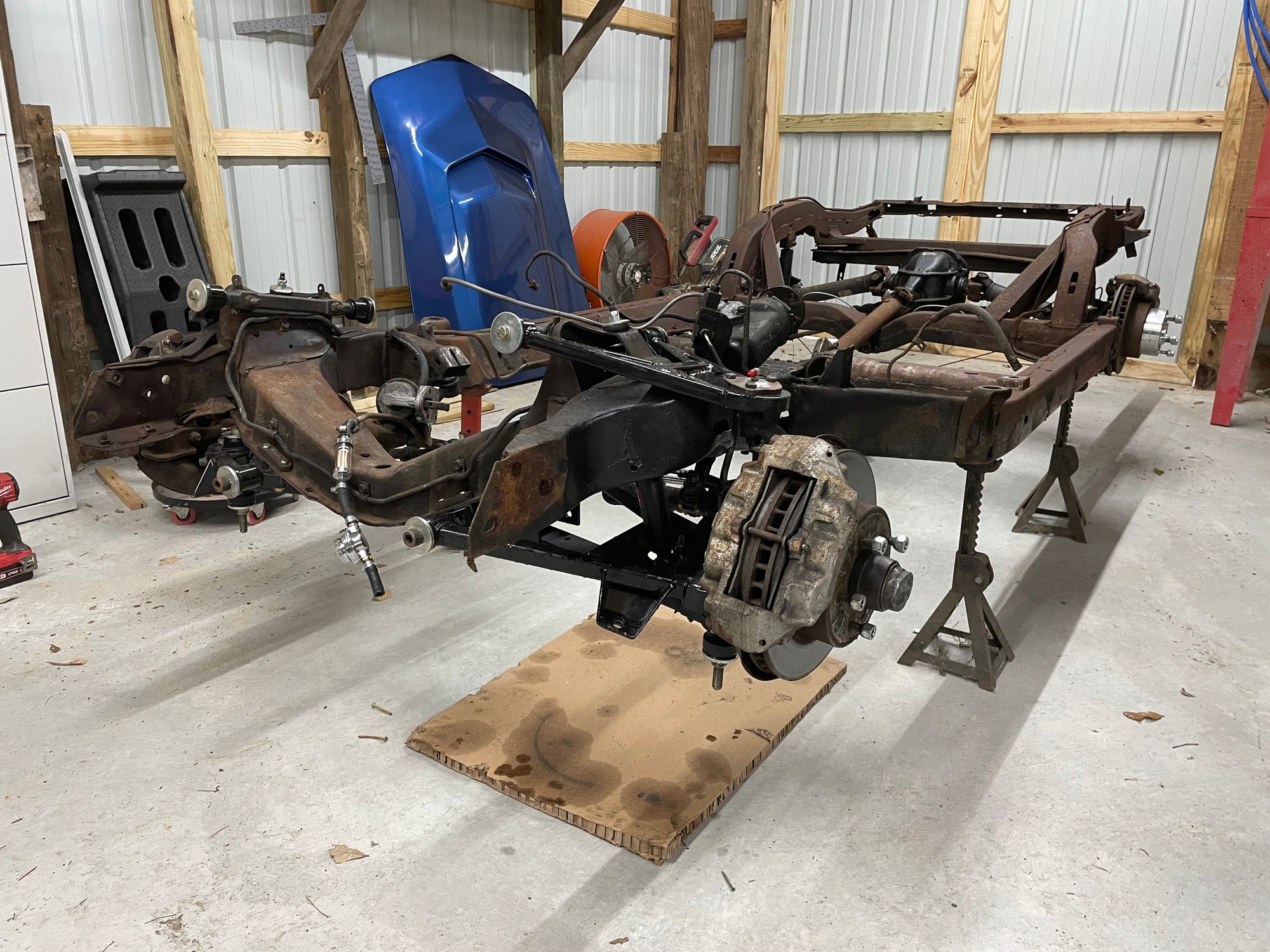

I went to work stripping down the chassis. PRO TIP: Don't be a dummy like me and forget to support the rear end when you remove the front suspension
After that learning experience, I was able to finish stripping down the front, and work my way to the back. Got everything pulled away and ready for the rear end to drop down:
