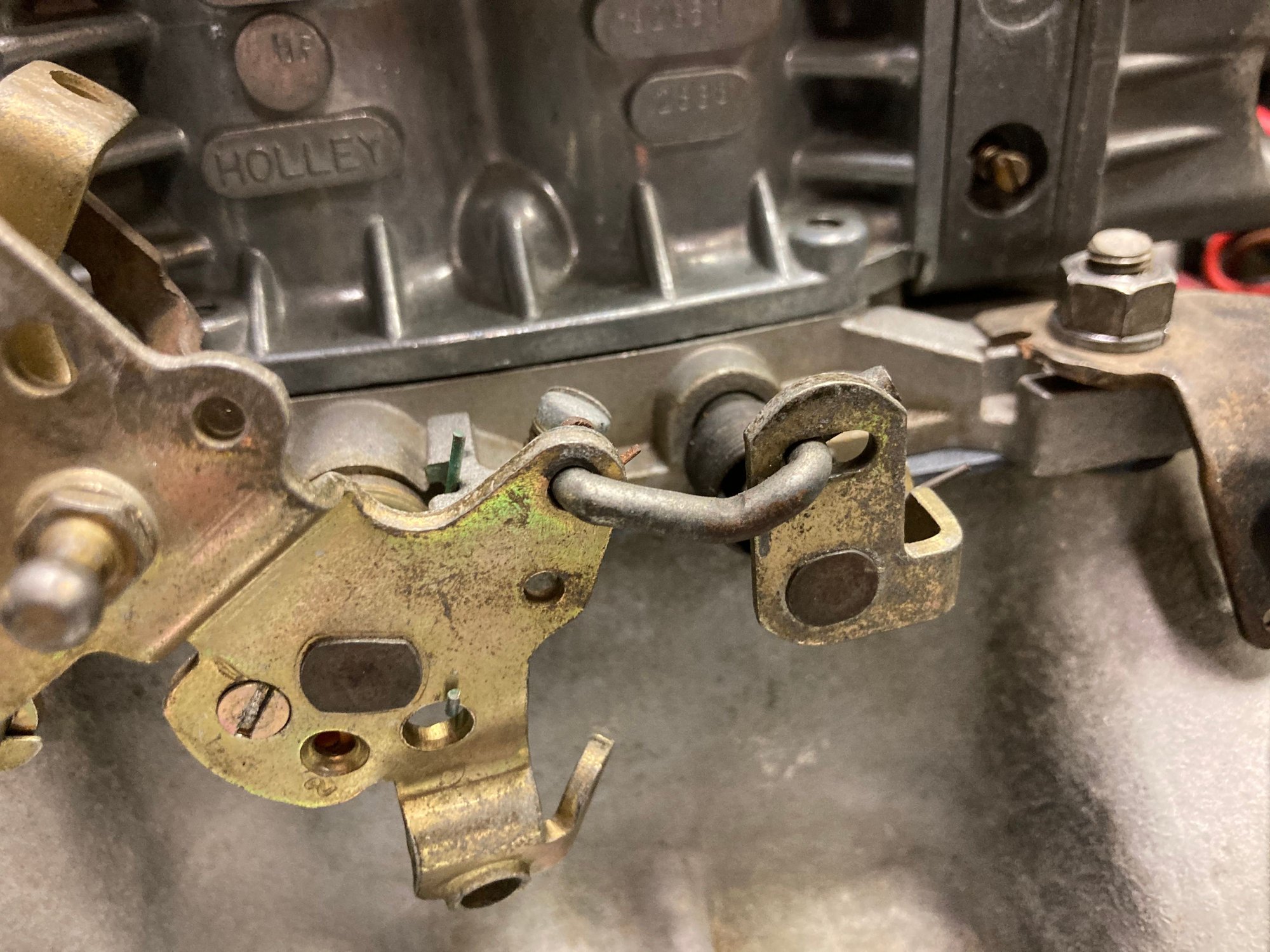

It could be the carb is just too big for what your engine demand is. I would leave the squirter situation as it is unless you can find a smaller secondary squirter. Run it like that until you do see an issue but i dont forsee it.
The only thing i can see being the issue is the scondaries openning too soon and the demand isnt there. You would have to adjust the mechanical arm to tune that in so that yhe secondaries open a few degrees later but again, its finally working, i would drive it for a while and see how it goes.
It's only a 650 CFM, so it should be sized correctly. Yes I'm going to drive it for a while like this, and if I see any issues with my "single pumper" setup I'll mess with the secondary opening rate.

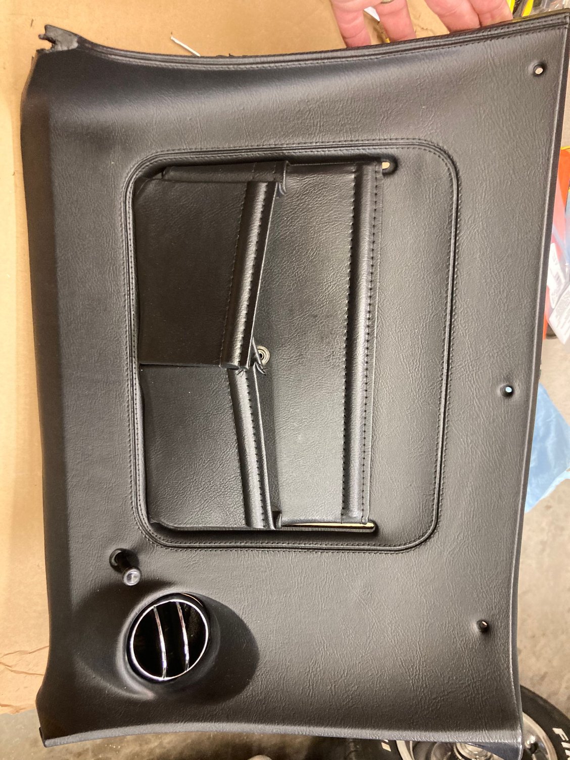

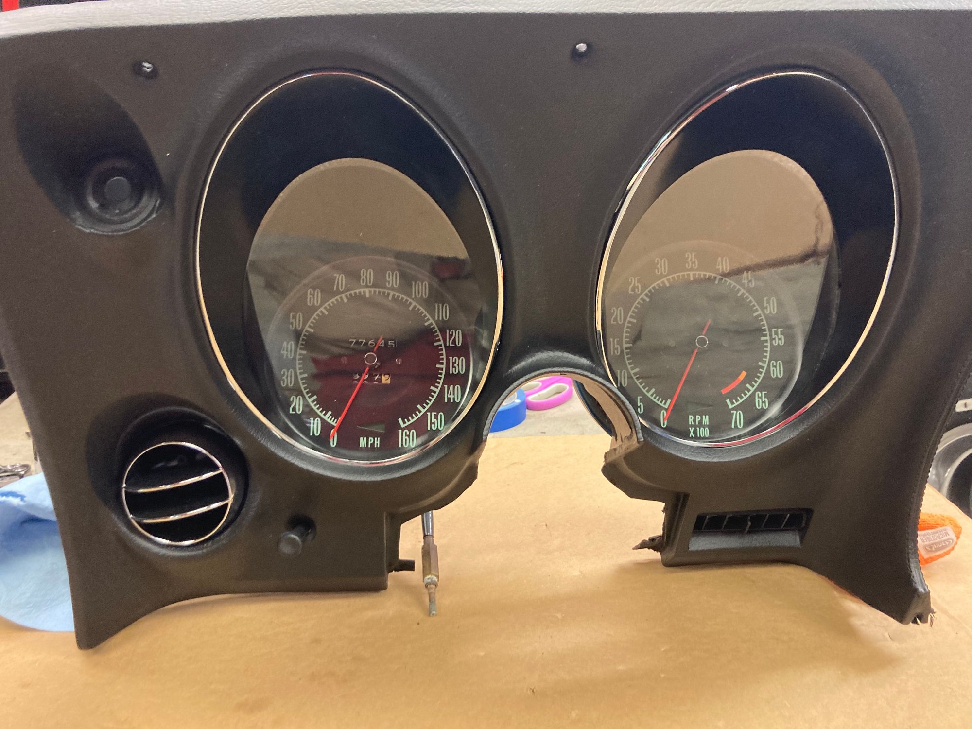

Did get my air duct vents in so I can install the chrome ***** into my dash. I didn't even know I needed these, and it's amazing all the little crap I have to buy to put this interior back to original! But I was able to finish my dashes finally, and can't wait to get them in:

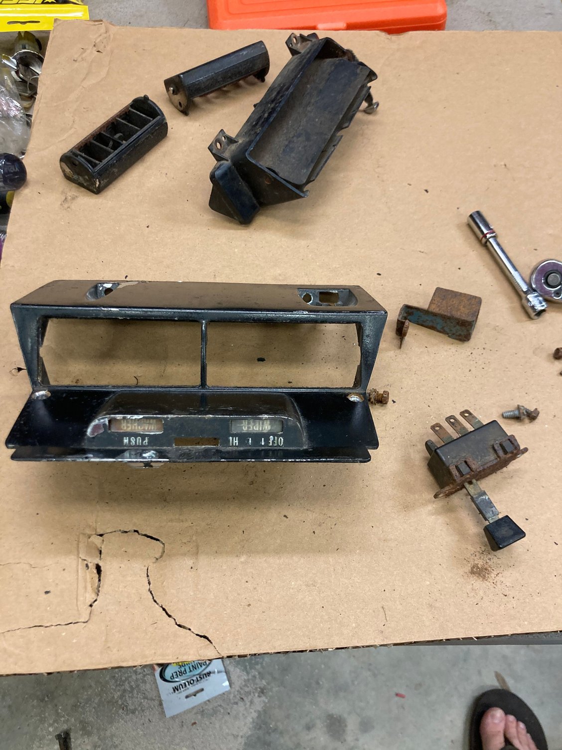

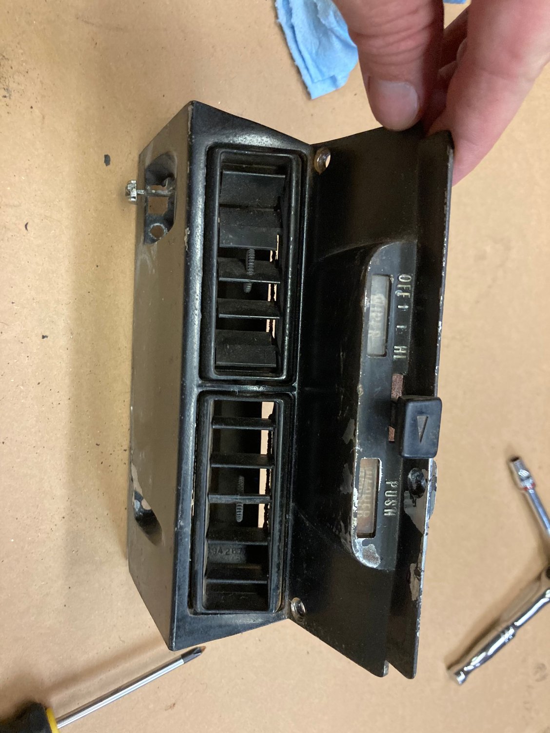

The last piece I have to restore for my gauge bezel is this old wiper/vent assembly I bought. It's rough, but new paint and a clean up will transform it. How do I remove the labels and replace them?

The wiper switch, the **** with the arrow and the clear lens with the lettering are all available from Corvette Central.
I just received mine and the pieces are really nice.
I think I’ve spent more money on the interior, gauges and all the little clips, hardware and do dads than I did anywhere else.

Great developments with my Holley tuning: I fixed the rich WOT bog with both squirters working! On my Holley tuning thread, it was suggested that I should close my secondaries, instead of having it open with a matching light gap to the secondary.. I did this , and put the pink cam back on at the 2 & 2 (fully retarded) position and went and drove it: MONEY! at low RPM I was getting a slight bog that instantaneously went away, and at high RPM I was actually going lean when i floored it. So I went back home and put the pink secondary cam in the 1 & 1 position: Hard WOT pulls!!! At higher RPM (above 3K) it's now perfect!! not sure how the secondary position has this much effect, but my accel pump situation and WOT pulls are wayyy better!
The second thing I changed was the primary jets, now that I have gotten rid of my light throttle tip in lean condition with the 10.5 PV. I would get horrible lean hiccups when I last ran the #64 primaries at light throttle tip in, despite having a nice cruising AFR in the low 14's. Now with the #64 primaries I have the nice cruising AFR of the low 14's when i'm on the primaries, and NO lean condition with throttle tip in! I went on a highway run and could not get it to go lean!
So looks like the big issues I had were resolved by a quicker opening PV, and reducing my squirters and closing the secondaries! Will report back after I get more miles on this tune, but it just keeps getting better!

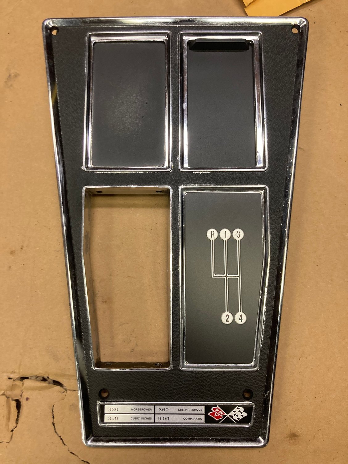

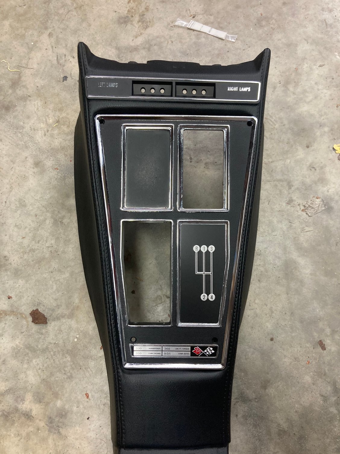

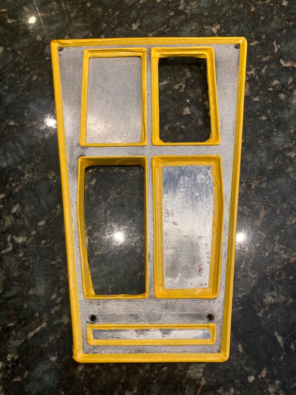

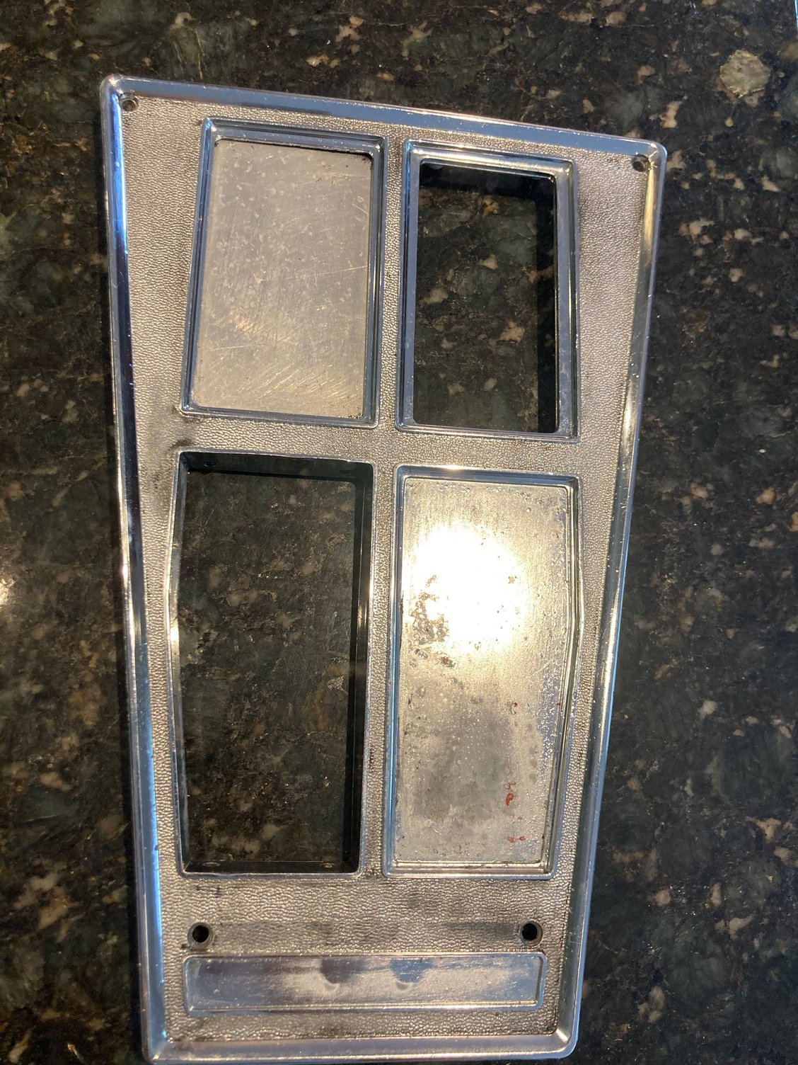

Didn't get to work too much on the Vette this weekend, was busy with projects around the house on projects (got plenty of them around here!). I was able to get back to my interior this evening and finish the shift plate console. I surgically masked it off and sprayed it down with the SEM Landau Black. It's a tedious process to mask, and putting a wood inlay would definitely be the easy way; but I wanted mine black!
Masking tape and a razor blade to get this thing done:
Came out pretty good!
The shift plate came out pretty good, but I have a couple of edges I'm going to touch up with a fine paint brush in order to get it perfect, and it'll be good to go!

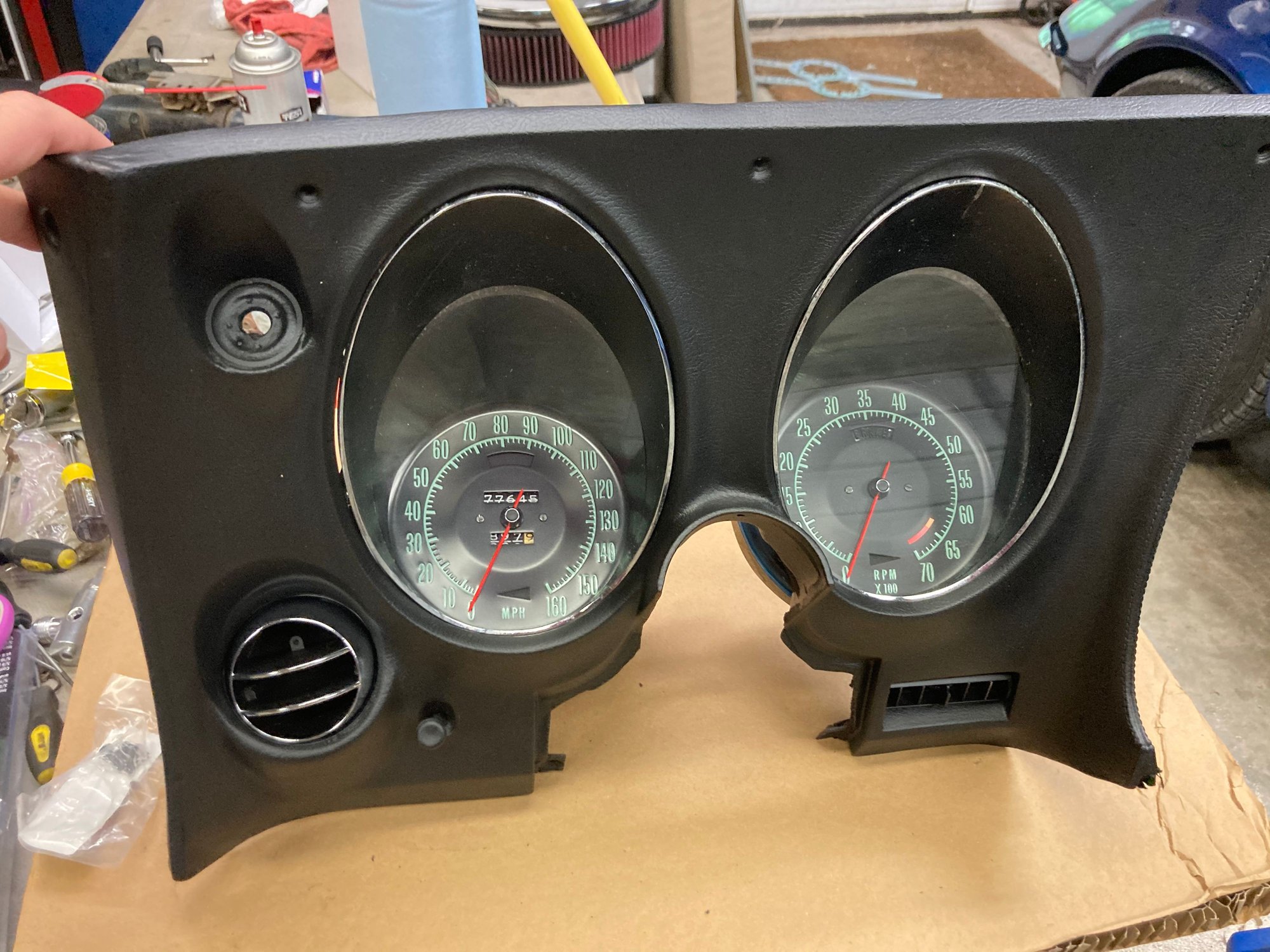

Spent timing this week chasing perfection on my interior parts. I had redone the whole dash, except the metal bezels around the speedo/tach, which what some pitting and scratches . I knew this would bother me in the future, so I took it all back apart and sanded it down, then treated it to some satin black paint. I polished the chrome edges too, it's going to be a lot nicer to look at while driving now!
I then went back to my shift plate with some satin black paint and a fine paintbrush to fix the edges and touch it up

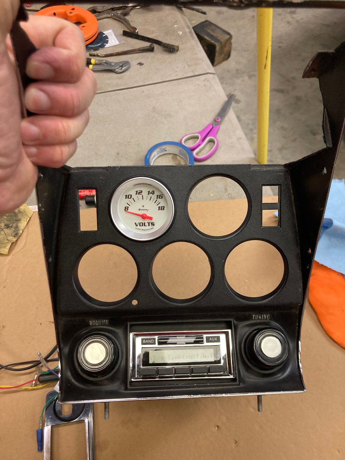

My neighbor is a car builder, and only does resto mods. He had this stereo he pulled out of a '71 Suburban he built a few years ago and gave it to me for the vette. Going to need to do some modifications on the bezel, but it'll work
