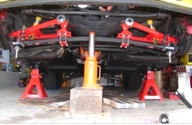

Caught some deals on parts I had to buy this weekend! Funny how fast money goes on these cars! LOL

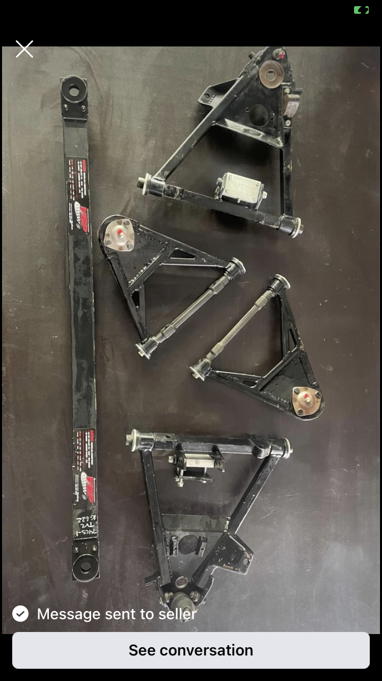

First up I scored a brand new VBP mono-leaf front end with new upper/lower controls arms, bushings, ball joints, and Bilstein shocks for $600! This is going to save me a lot of time rebuilding my front end, and give me a big upgrade on handling/performance!
This is what it looks like installed: front leaf setup like the C4/C5 Corvettes have

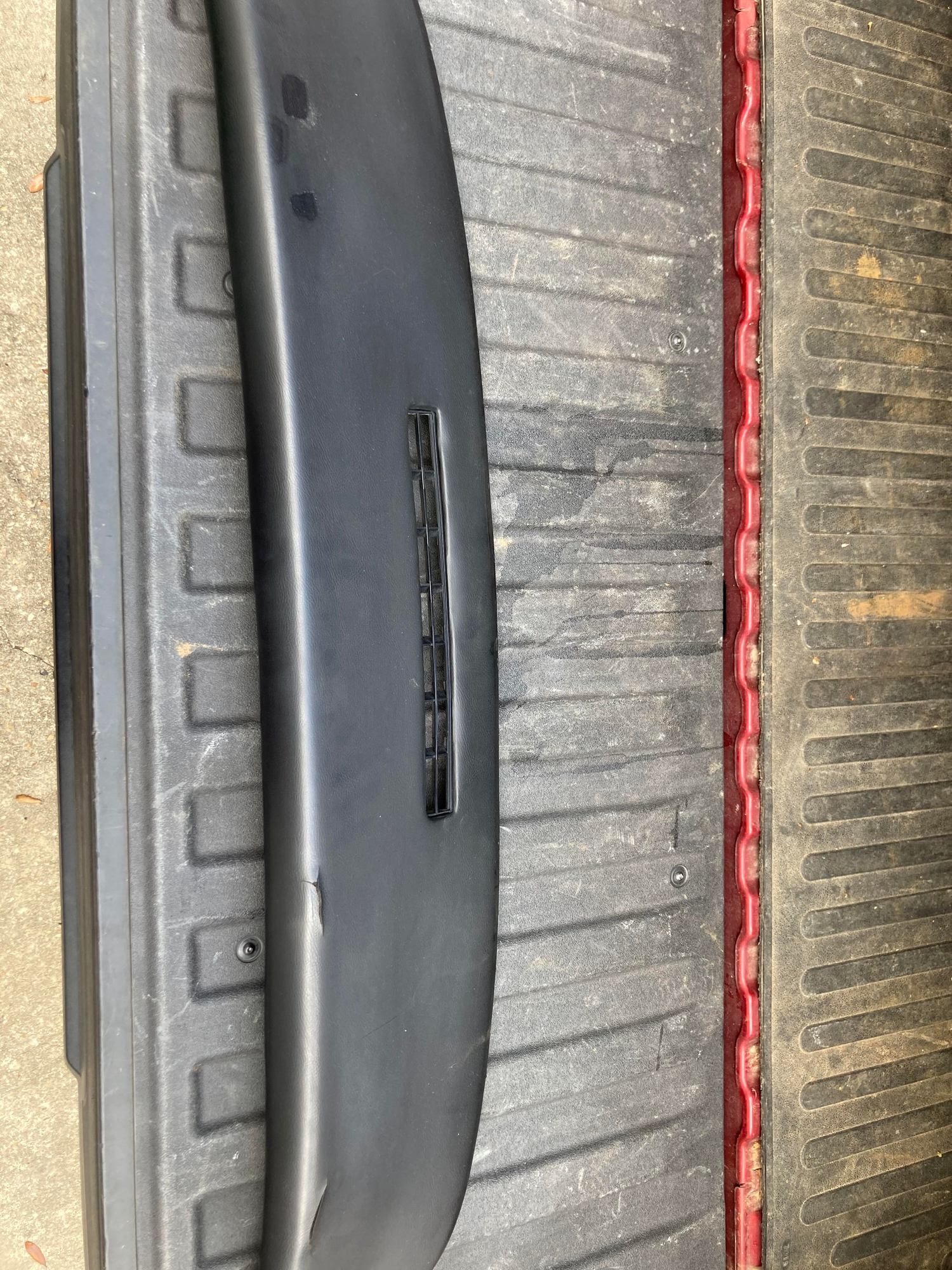

I also scored a really nice 1968 Dash for $80. Great shape except for the two cracks. I didn't realize that these don't have speaker mounts... Maybe good to use as a core to build a custom dash, or trade for a later one? Doesn't seem like a easy way for a stereo on the C3 without speakers in the dash lol

68/69 has the speakers in the A pillar at the base behind the kick panels right above #2 body mount bolt. The OEM speakers are 4x10, 10ohm. You could mount your speakers like that which would save you drilling a boat load of holes in this dash pad, LOL's
Or, trade it out like you say for a 70+ dash.
Front suspension looks way cool to me and a great bargain considering new Bilsteins shocks are $100/pc now!

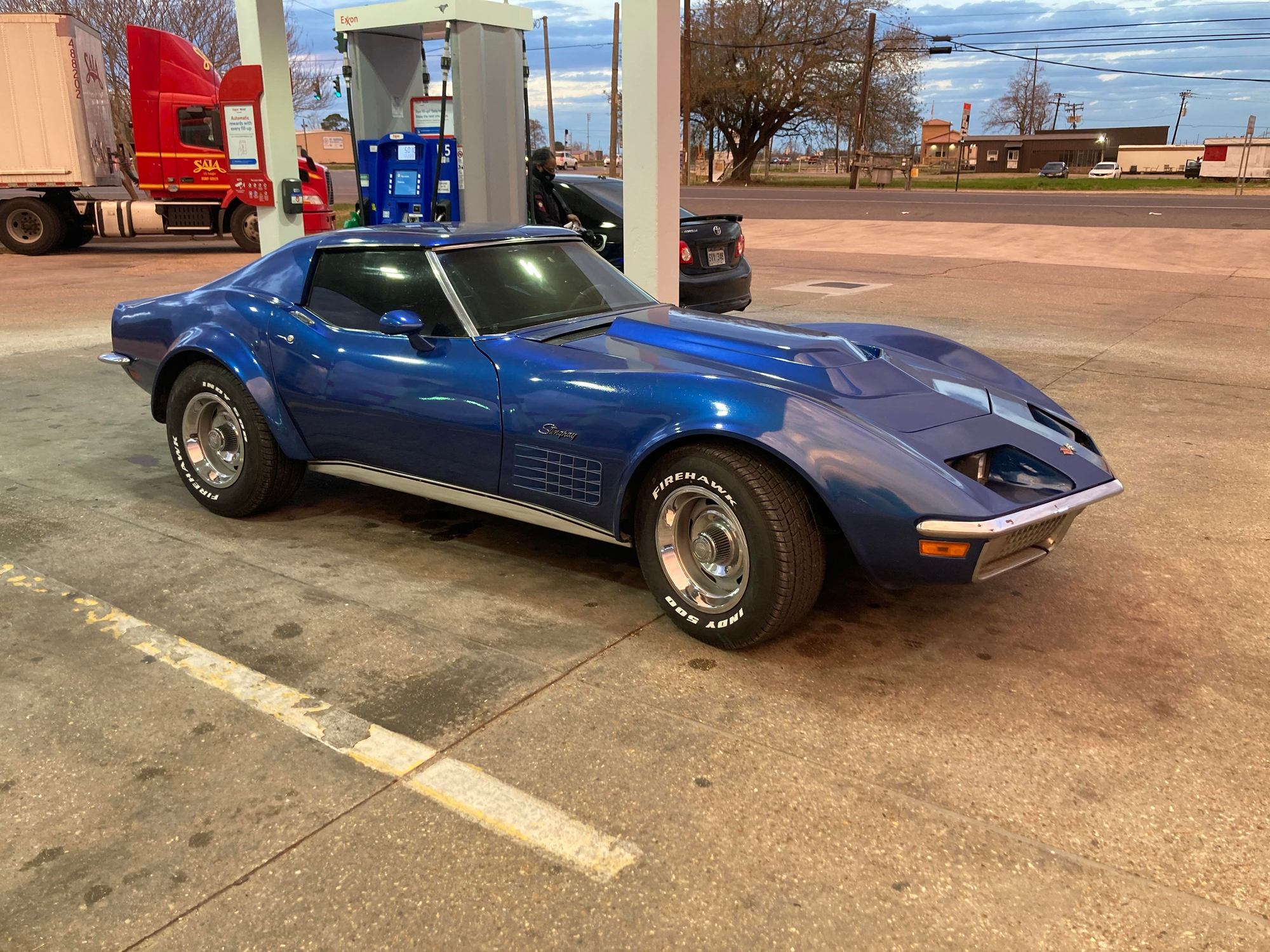

When I got home from work, I jumped in the vette and put her down the highway for the first time to do a thorough shake down (and fuel up with gas & beers): Car cruises nicely down the road, oil pressure is excellent, car stays cool, tracks straight, no weird wobbles or vibrations, and is a lot of fun! She pulled some compliments too!
I also added a finishing touch: "1971 LT1 Corvette" License plate

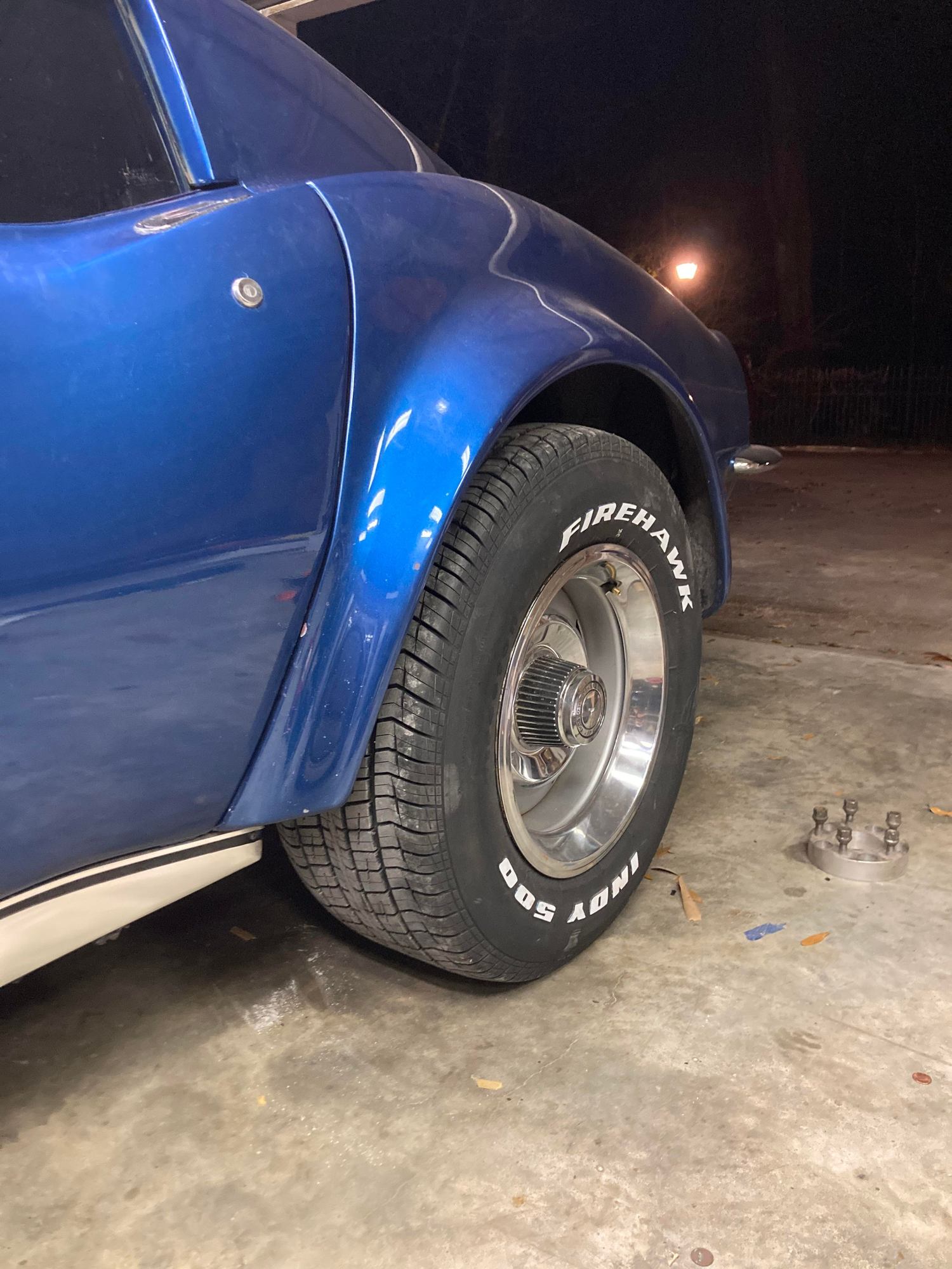

When I got back, I went to work on putting my wheel spacers on so I would have the proper stance on my car. The spacers were too tight on the wheel hub, and I couldn't get them on. Quick work with the die grinder, and I got them fitted. They pushed the wheels out perfectly into the flare, and gave it the proper stance it needed:

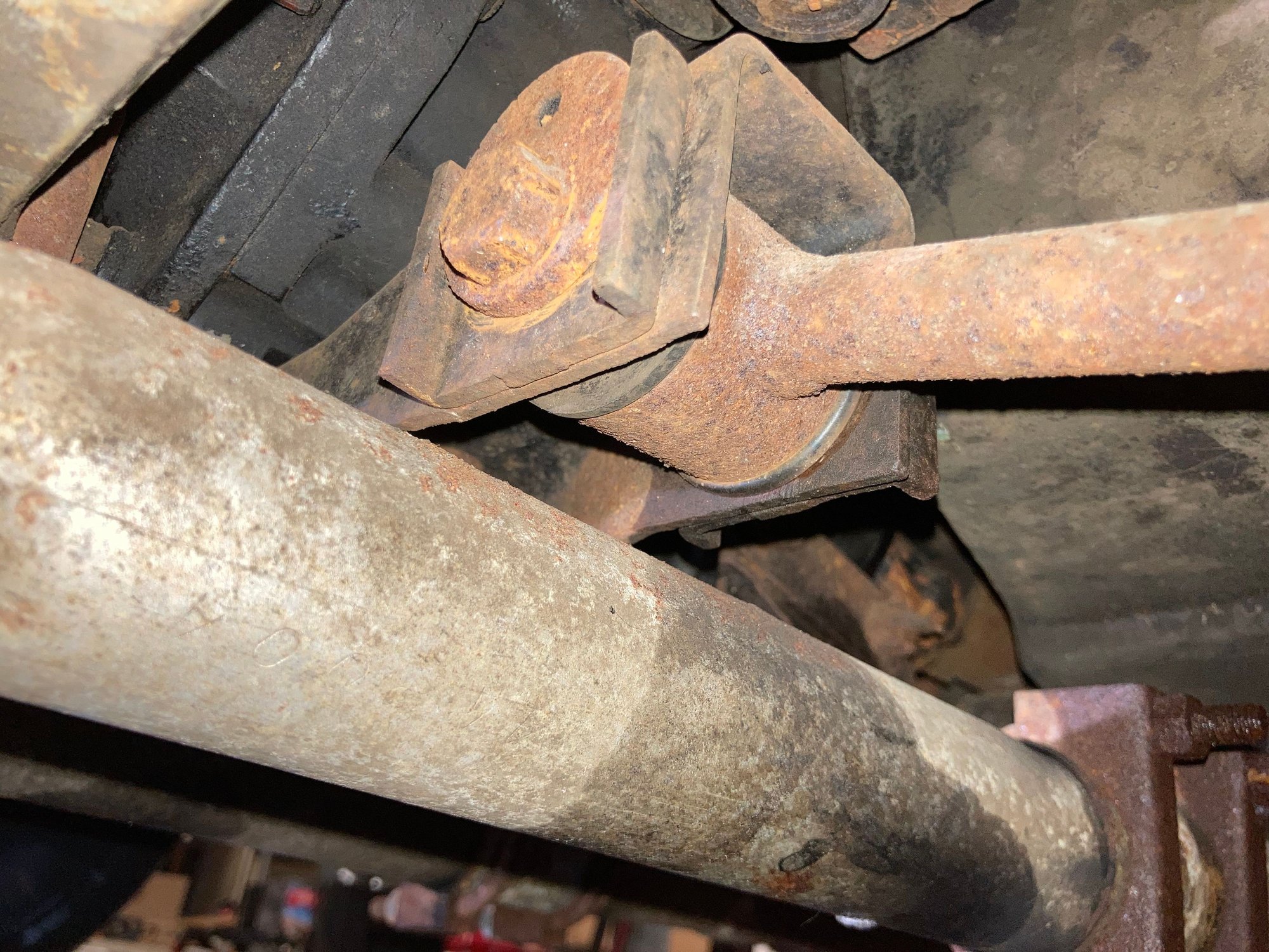

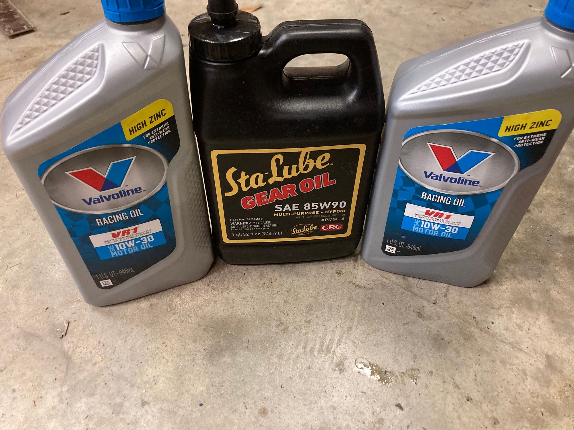

Took the car out cruising for lunch yesterday in that beautiful sunshine and 75F weather! Spent some time in Baton Rouge stop and go traffic, and the engine steadily stayed at 170F, happy about that! Car is doing great, but I noticed one of my rear wheels had way too much negative camber, so I went ahead and adjusted that to avoid destroying my new tires. Simple adjustment with the eccentric bolt on the strut arm, and so expert eyeballing with a bubble level, and I feel good it's damn close! lol
Then I decided to stop doing cosmetic stuff, and do some important maintenance! The oil was fresh in the engine, as the PO changed it before he tried to get the car running. I had no idea what kind of oil was in it, and I know the engine had been sitting, so I considered that as a flush now that I got a little driving time on the car. Some fresh VR1 10W-30 and a Wix filter now. I also had to order GL4 gear oil for the trans, as that's hard to find! Gear oil in the trans didn't look bad, but now it's fresh and clean!

Well done, glad the car is running well for you.
I’ll preface what I’m about to say with a caveat, I thought I read that if you were going to replace the differential oil, you were supposed to add some GM additive to it and then do some figure eights in a parking lot . I’m sure someone with more knowledge will chime in.
Regards
Regards
Roy
Thanks for the advice! The figure 8's are to work the friction modifier into the clutches - which who knows if mine actually work anymore. The only reason I didn't drain the diff was there's no freaking drain plug in it! Stupid design, I'll have to order an oil suction pump.
Just be really careful with the tube on the suction pump.
Many members have had them slip off the pump and drop down into the differential.
Lots and lots of cuss words beginning with the letter “F” have been spoken!

FWIW, what I use to suck out these "no drain" rears and 4sp's is a cheapy gas suction pump from Walmart with clear plastic tubing on each end and a black suction bulb. So, no pieces to drop off. Takes awhile, so you get the suction siphon started and come back much later.
Ross Downing in Hammond sponsors multible Corvette clubs in Louisiana and they have a couple of super C3 mechanics that run a sub Corvette service that can properly align your C3 rear and front.

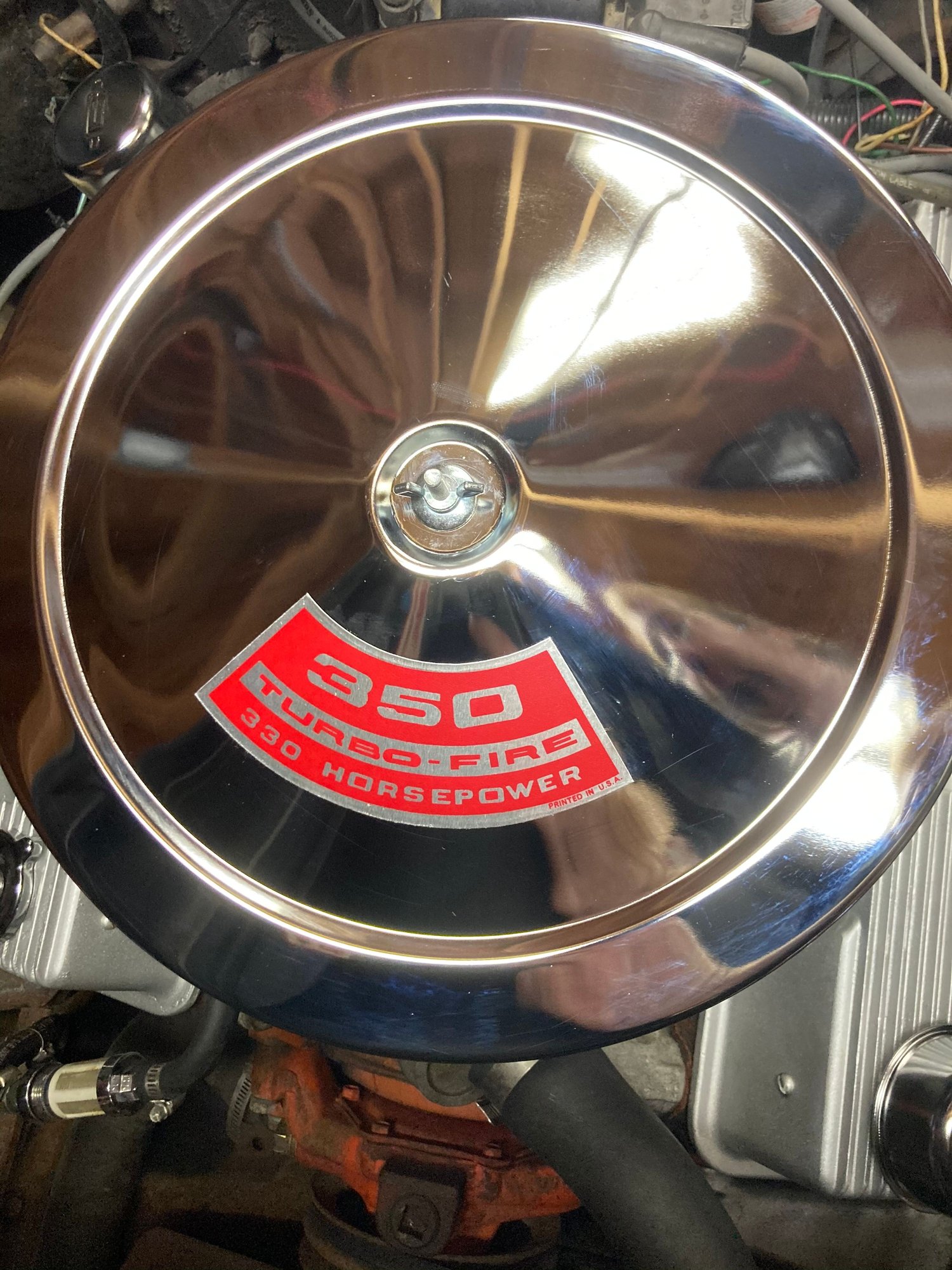

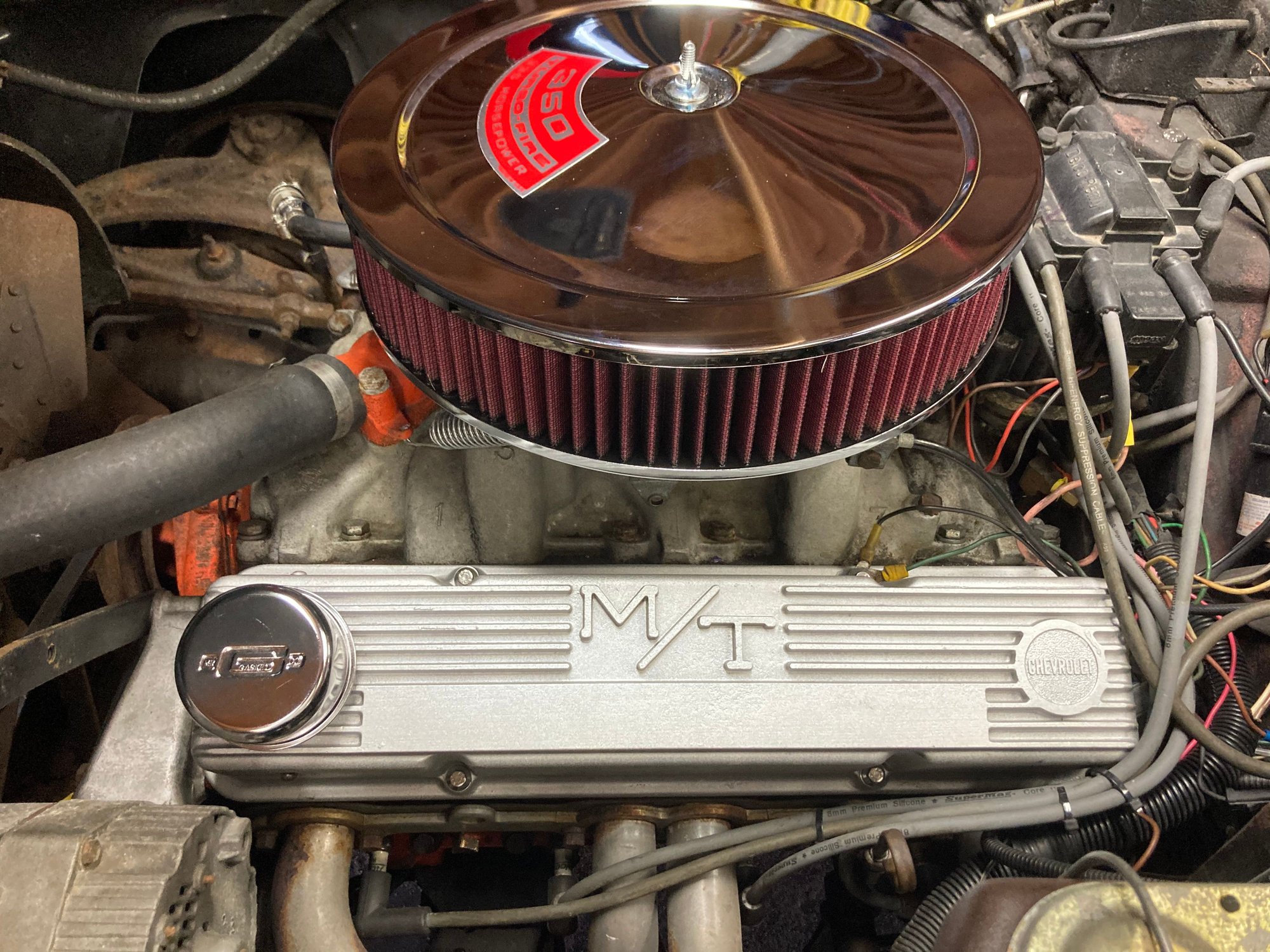

I did manage to get a proper air filter fitted that would clear the HEI, and deleted the PCV so I wouldn't oil up my engine. Engine bay is looking much better than when I bought it! Going to eventually do some serious detailing in there , but it's a nice start!
