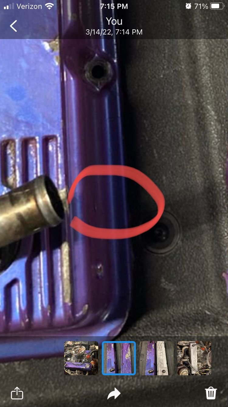

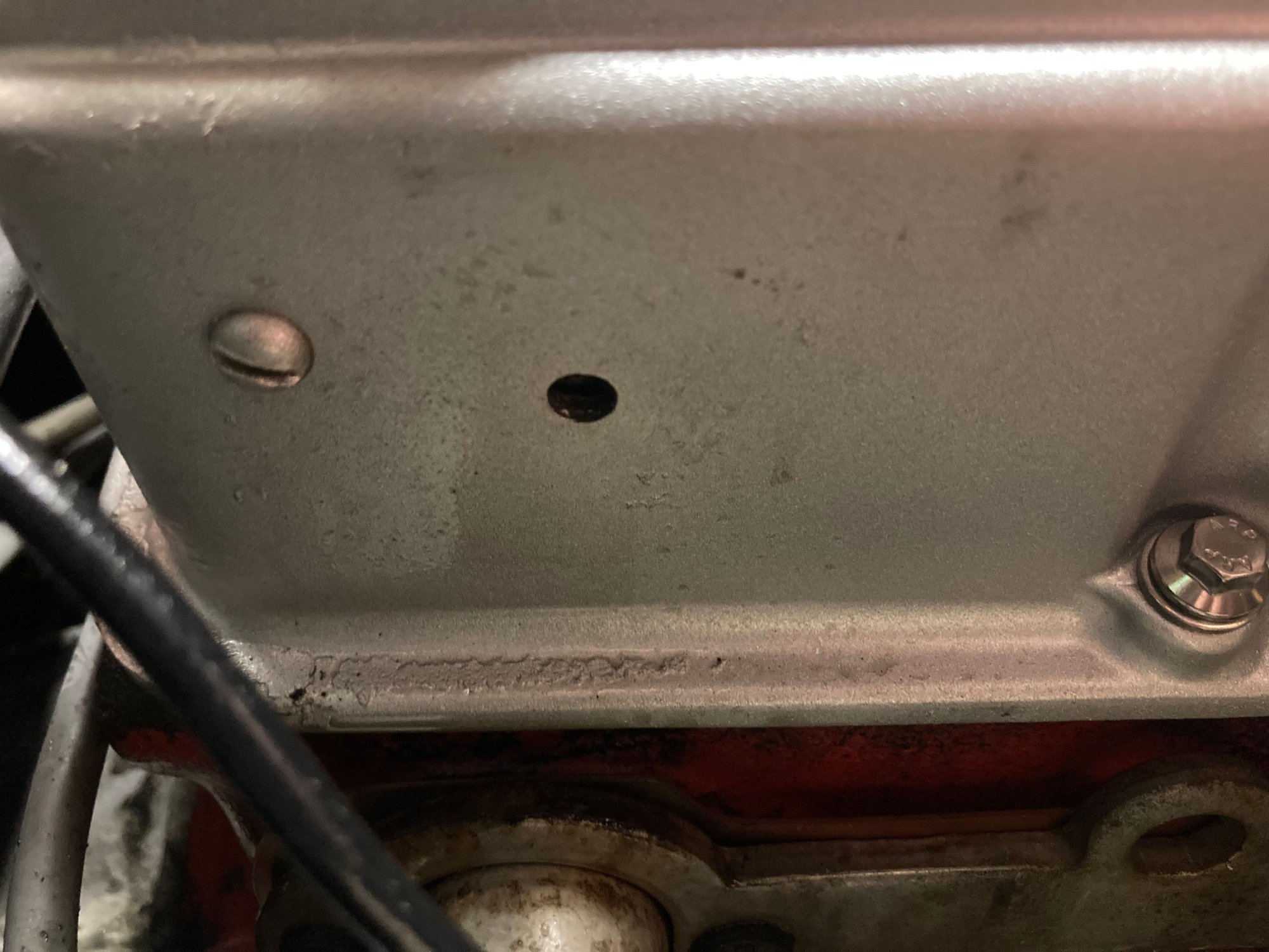

Noticed something odd when I was doing redline pulls the other day: smoke coming in my cab, that was from oil burning off. I thought about it, and it could only be three things:
1) God awful blow-by coming out of my valve cover filter (unlikely)
2) spilled oil on header from oil change (likely)
3) valve cover leaking and getting oil on header (likely)
When I got back to my garage I noticed some oil on the firewall by the passenger side head, but couldn't pinpoint the leak. so I revved the engine up high and watched it: smoke coming from the valve cover, and when I looked closer there was a hole in the valve cover! How did I over look this?! I know there were baffles put in by the previous owner, with bolts... Did one of the bolts come undone and wreaking havoc in my engine?!?! I started searching through my pics, and finally found that the hole was there when I bought the car! Don't have to have a sleepless anxiety ridden night thinking about a bolt swimming in my engine lol
Look like I'll have to pop it off real quick and seal it off, problem solved!

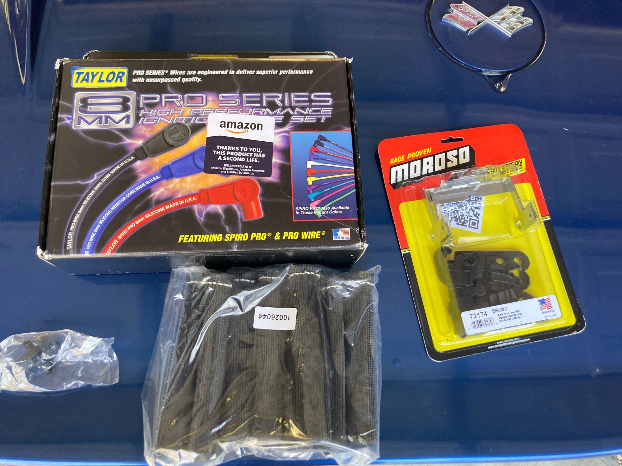

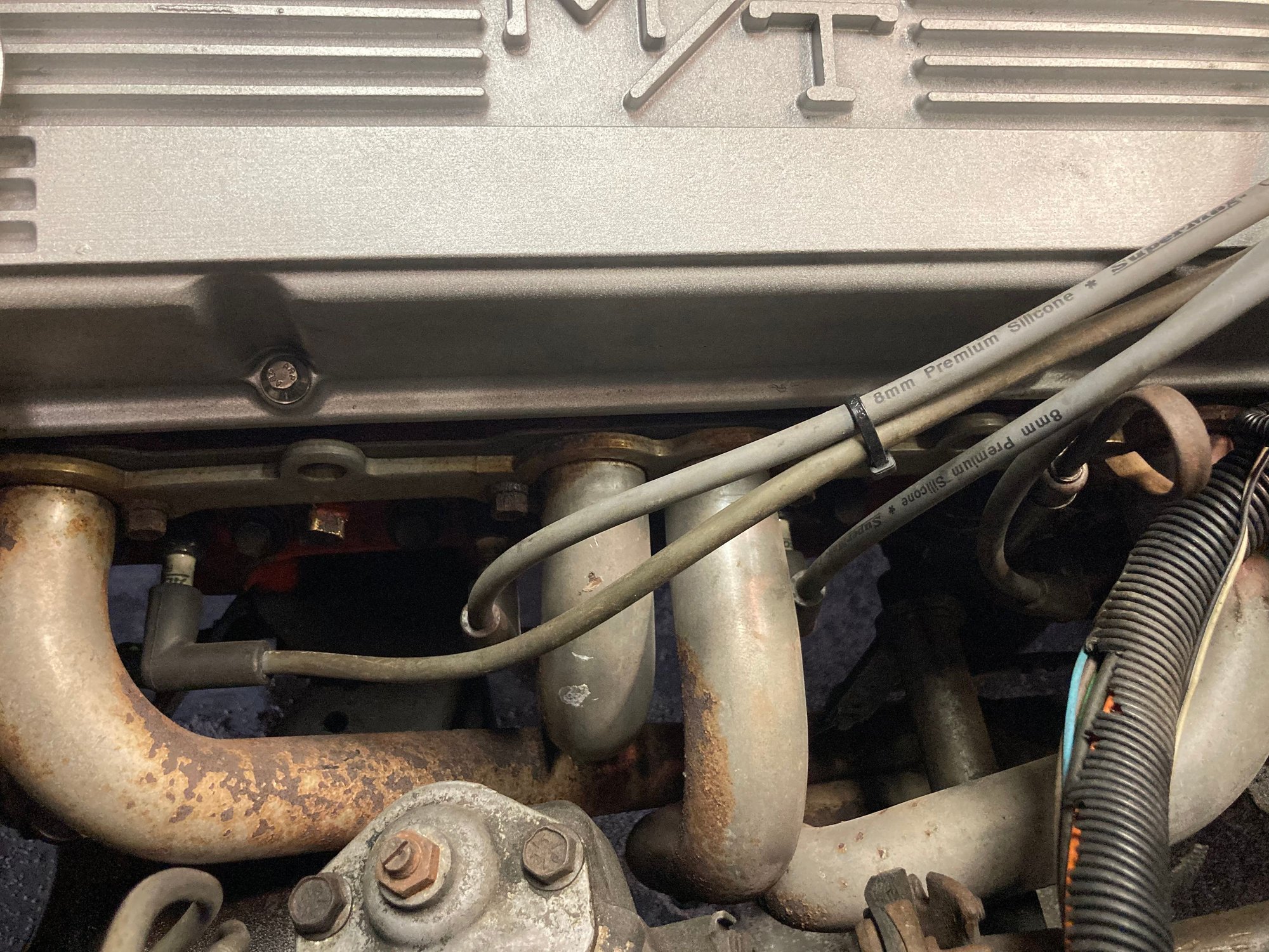

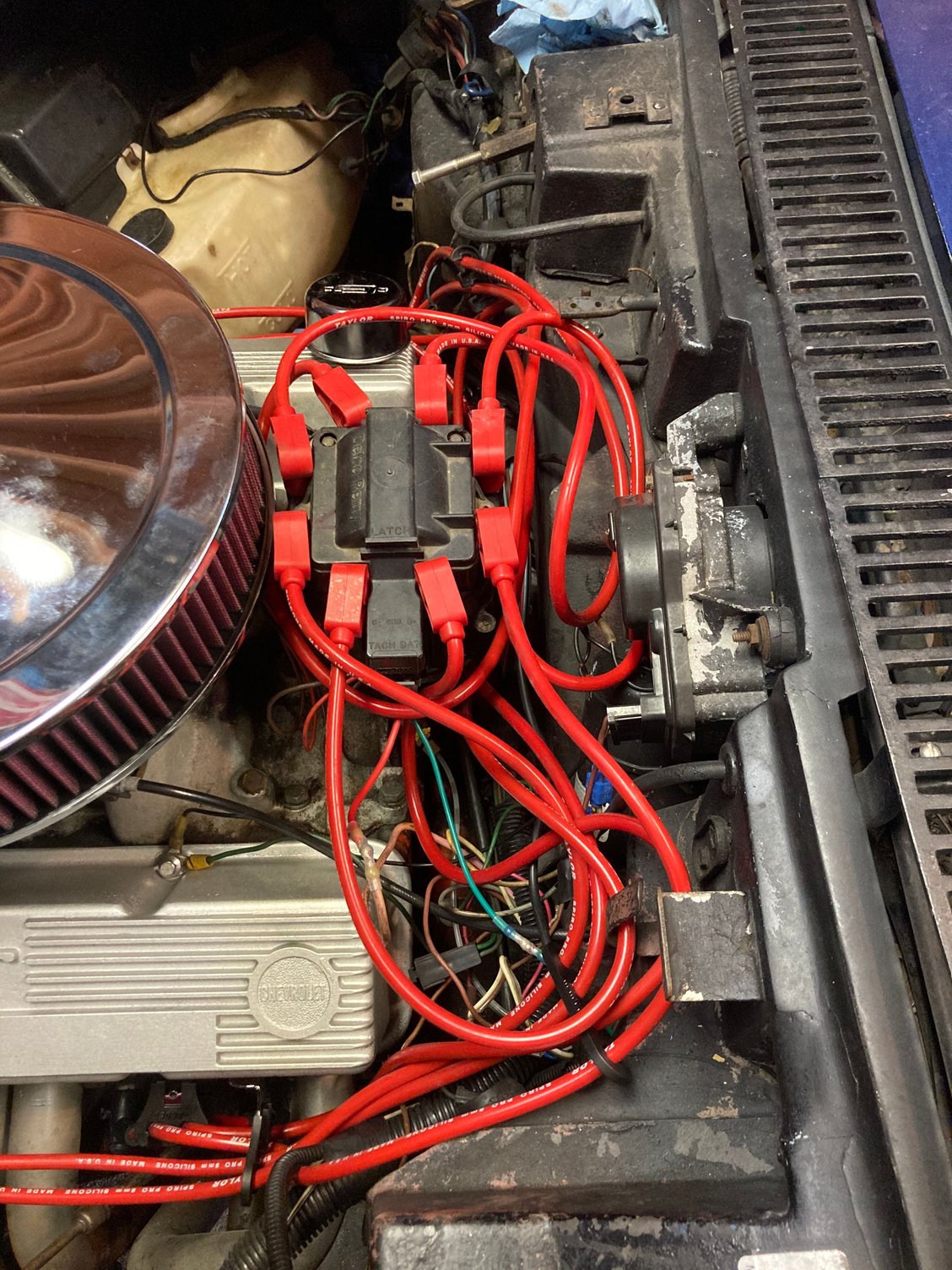

Next little project for me was to prevent a break down: Plug wires were dangerously close to headers, and already had some spots melt. I order wire looms, new plug wires, and heat shields (that couldn't be used) to make a setup that wouldn't melt my wires while joyfully hot-rodding
down the back roads!

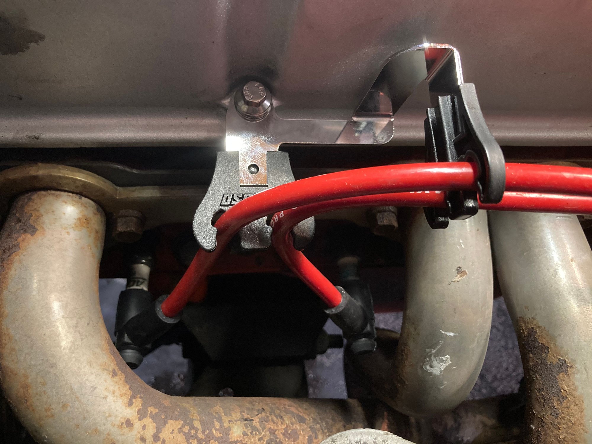

So I ran beautiful new spark plug wires to my new previously installed plugs, and ran the Moroso wire loom kit , which work excellent to organize the wires and keep the off the headers.
everything did it's job and look great, except the wires were way too long! I'm not a fan of a bird nest next to my HEI, so I'm going to cut and re crimp all these wires so they look proper!

I ran into the same thing on an old Pontiac that had a SBC swapped in, I needed wire heat shields but had to make my own wires in order to get them installed.
It's odd that they make them so long! The ones I ordered were SBC specific wires too.

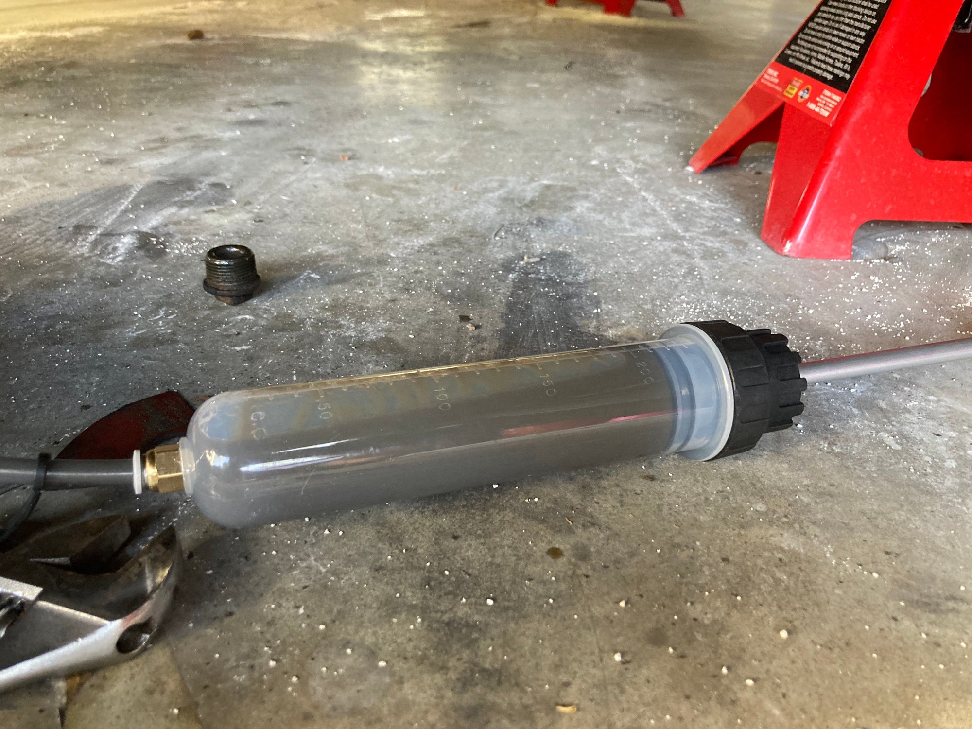

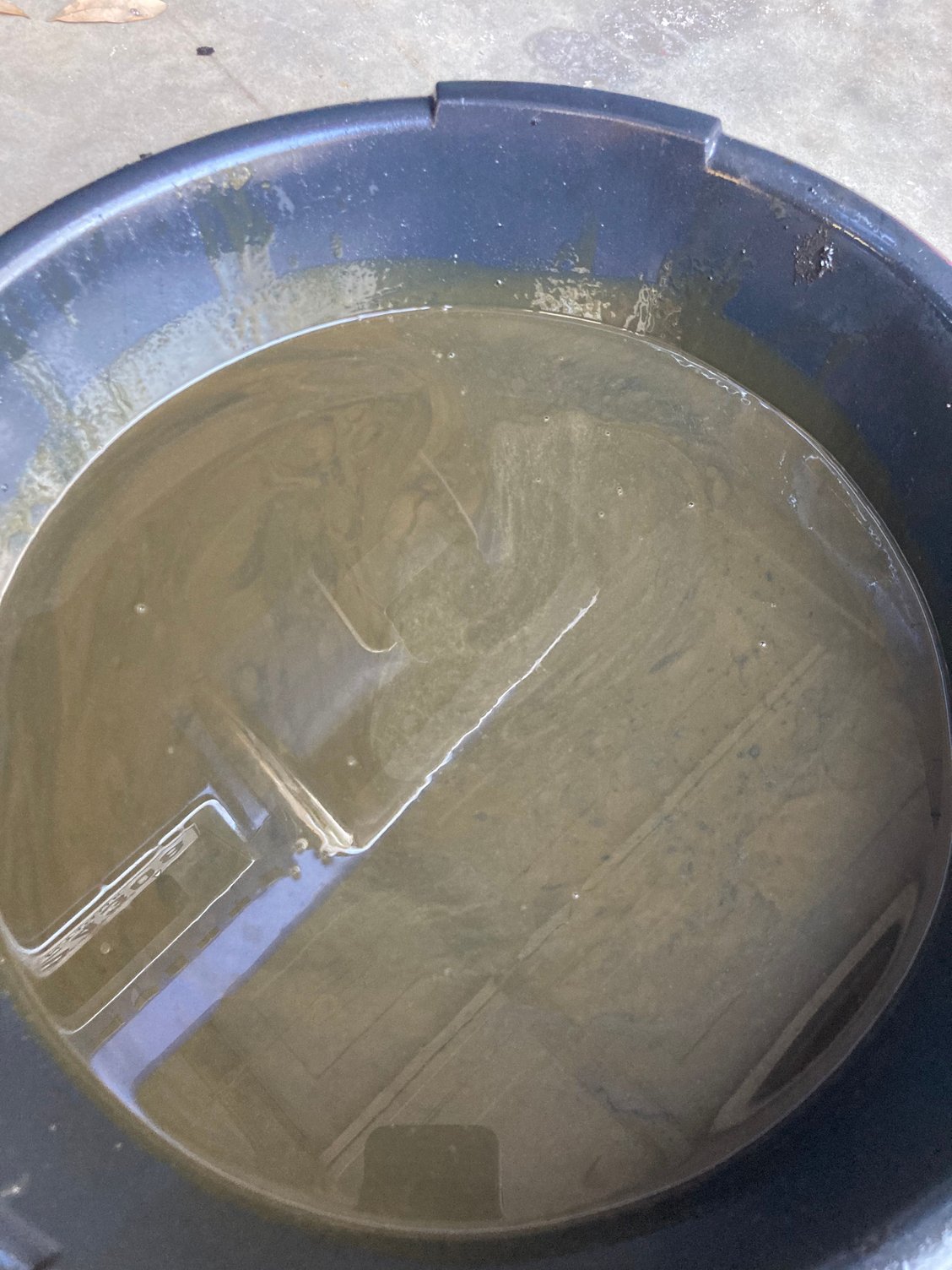

I finally got a fluid extractor so I could suck all the old gear oil out the differential - it looks like this chore hasn't been done in 20 years!

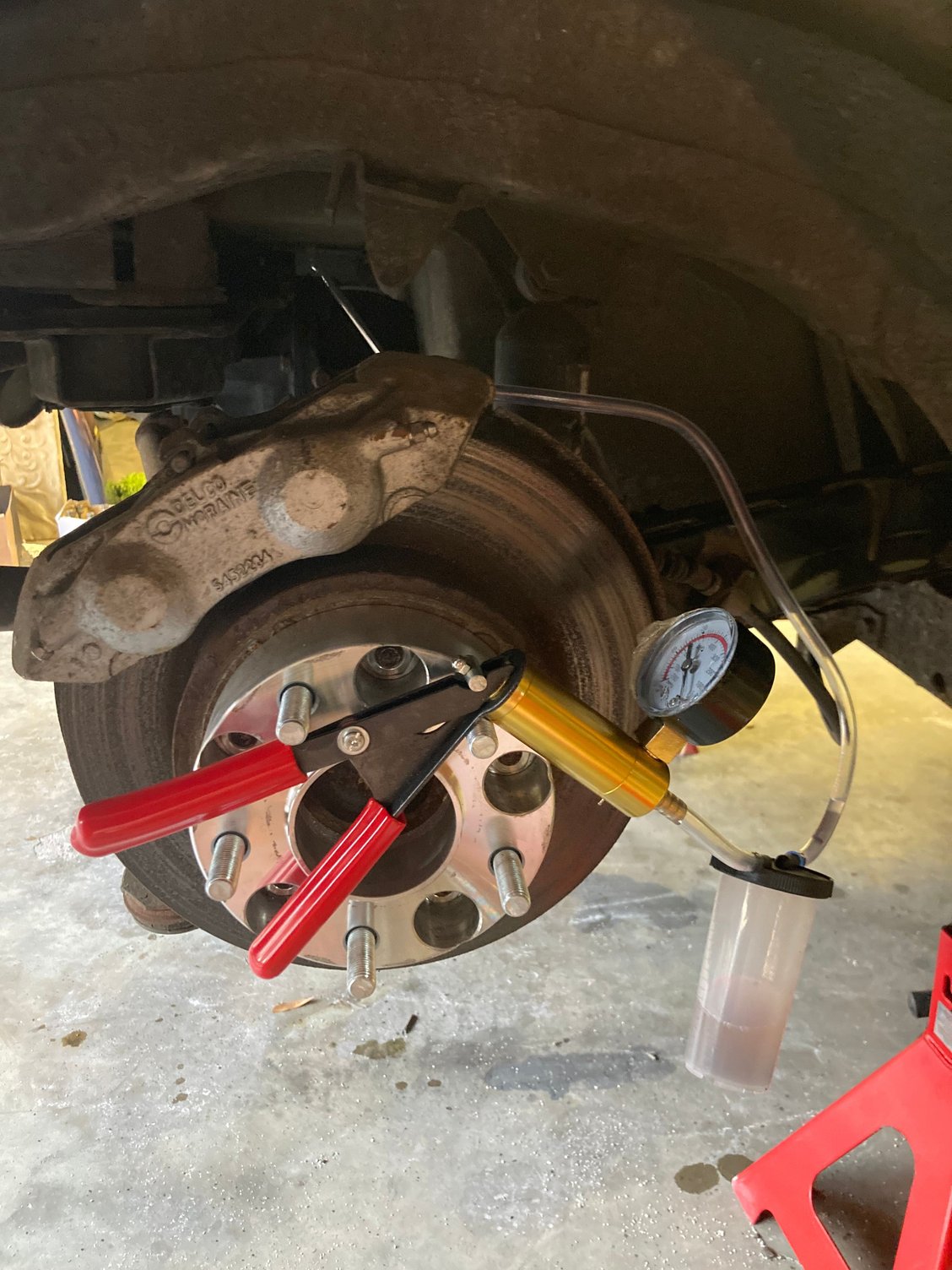

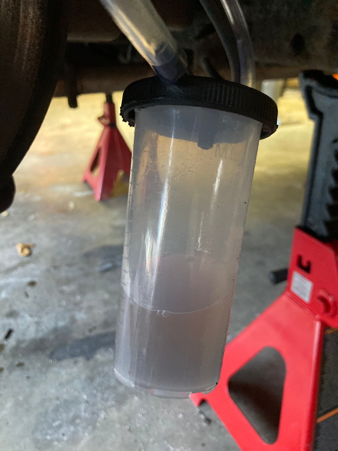

Next up were the brakes: brakes work and have good pedal pressure, but there was certainly room for improvement and I have no idea how old the brake fluid was so i went to work flushing and bleeding the whole system. Thank god I did, because I've never seen so much trash come out of a brake system!
First thing I did was suction the old brake fluid out the MC, then topped her off with fresh fluid:
There's your answer. They are to be routed straightish down from the distributor, and under the exhaust manifold, and buried in shielding for radio noise suppression.

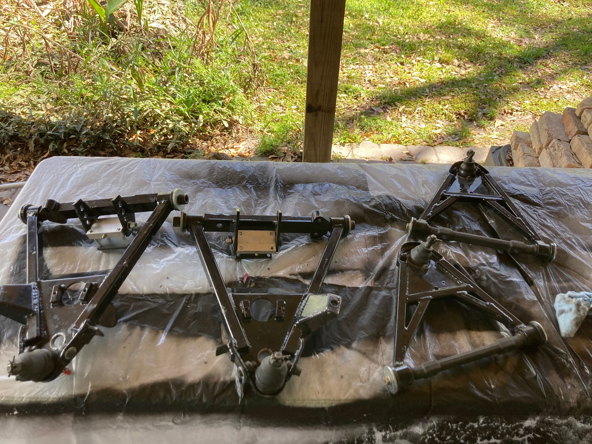

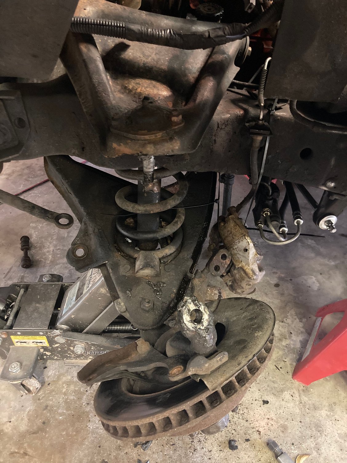

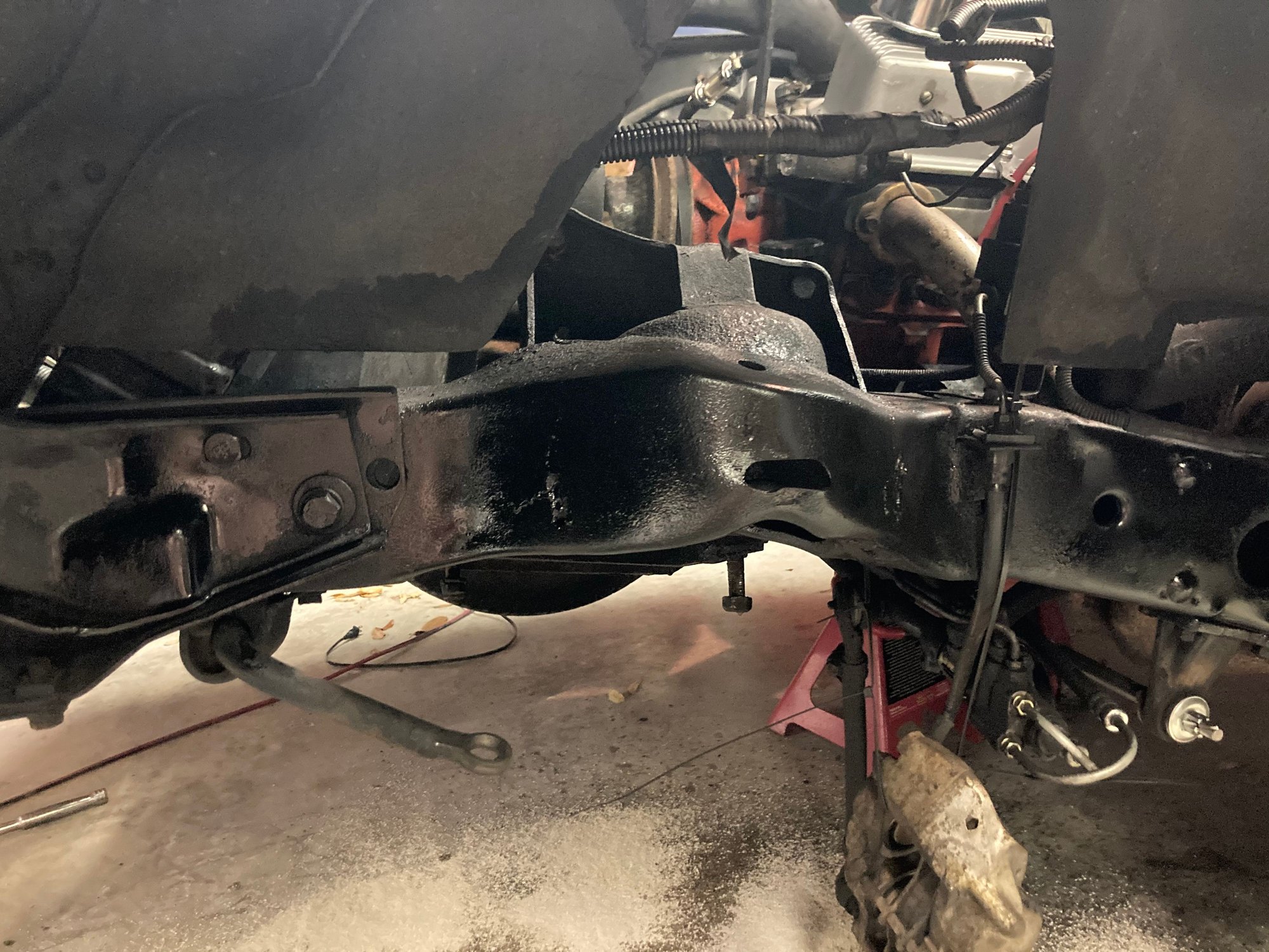

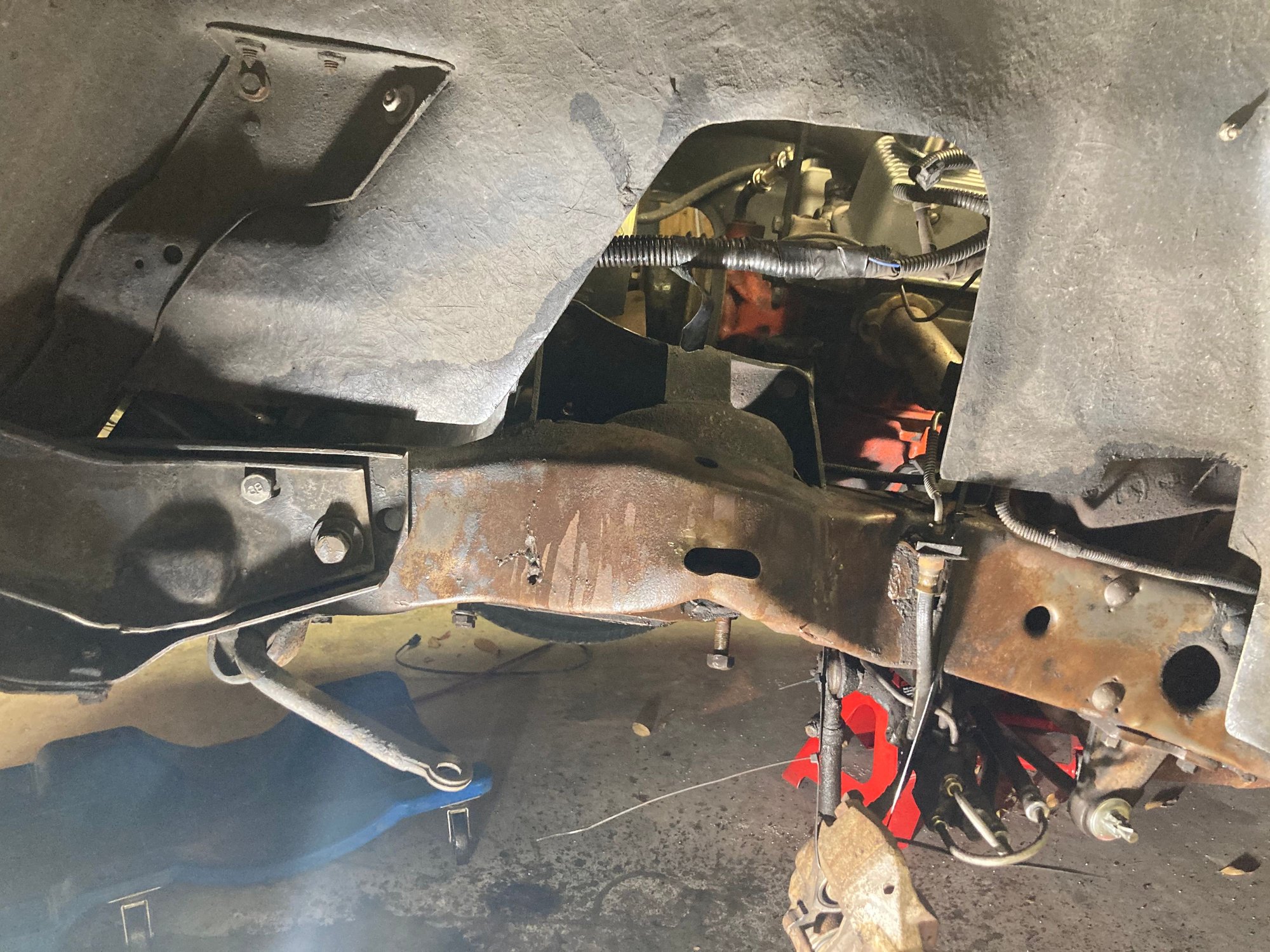

Sunday sunshine and 70F, so you bet I was out and about in my C3 cruising with the T-tops off! I rolled over my first 100 miles on the car, did a run on the interstate, and cruised all over town. Car gets more compliments and crowds than anything I've ever owned, it's wild! Car is running fantastic and cruises great. The suspension is just shot, and I'm bouncing all over the place, it's super annoying! Since I have the nice new VBP front suspension, it's time to put it on!
The VBP kit I picked up was NOS - someone purchased and never installed. Came with beautiful new controls arms with new bushings and ball joints.
Started on the drivers side, and had to fight some parts off the car: Upper ball joint took some serious BFG work. There was some cursing and sweating in my garage this evening! lol
After I got everything removed I cleaned the frame with a wire wheel on my grinder then hit it with brake cleaner. No surprises or rot, just a nice clean frame.
Treated that bare metal to some chassis paint to clean it up and prevent future rusting.
