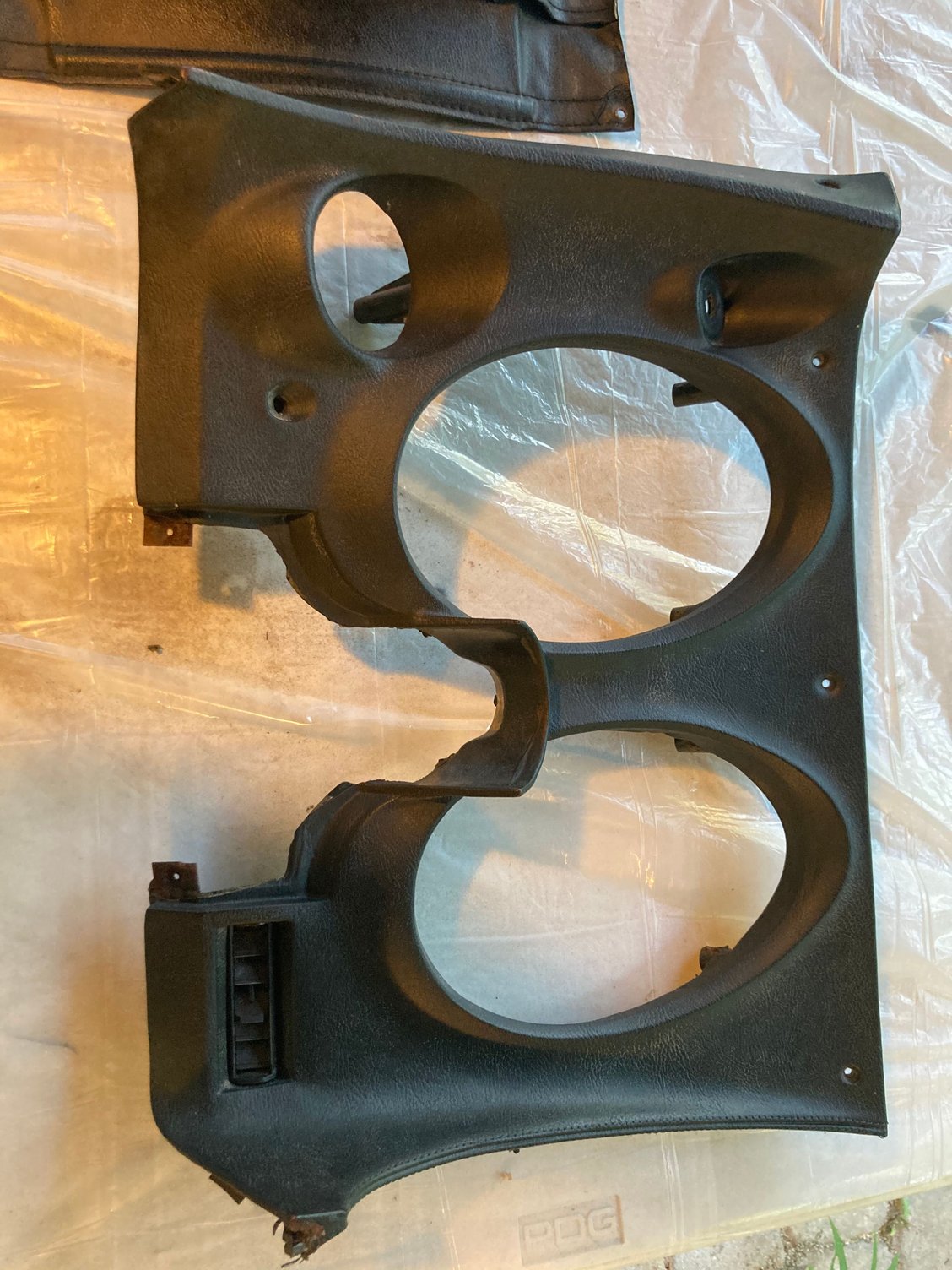

Since i've almost completed my mechanical goals on the car, i've shifted back to my interior, and I've been slowly collecting parts in the background as I find deals! I have a nice black dash out of a '75 Mercury20 gave me and while it was in good condition, it needed to be dyed black. Since the Duplicolor dyes didn't give me the satin finish I wanted (only gloss or flat), I decided to order some SEM Landau Black since I heard so many great things about it: they're all true!!! Covers much better and gives a perfect finish with the perfect satin!

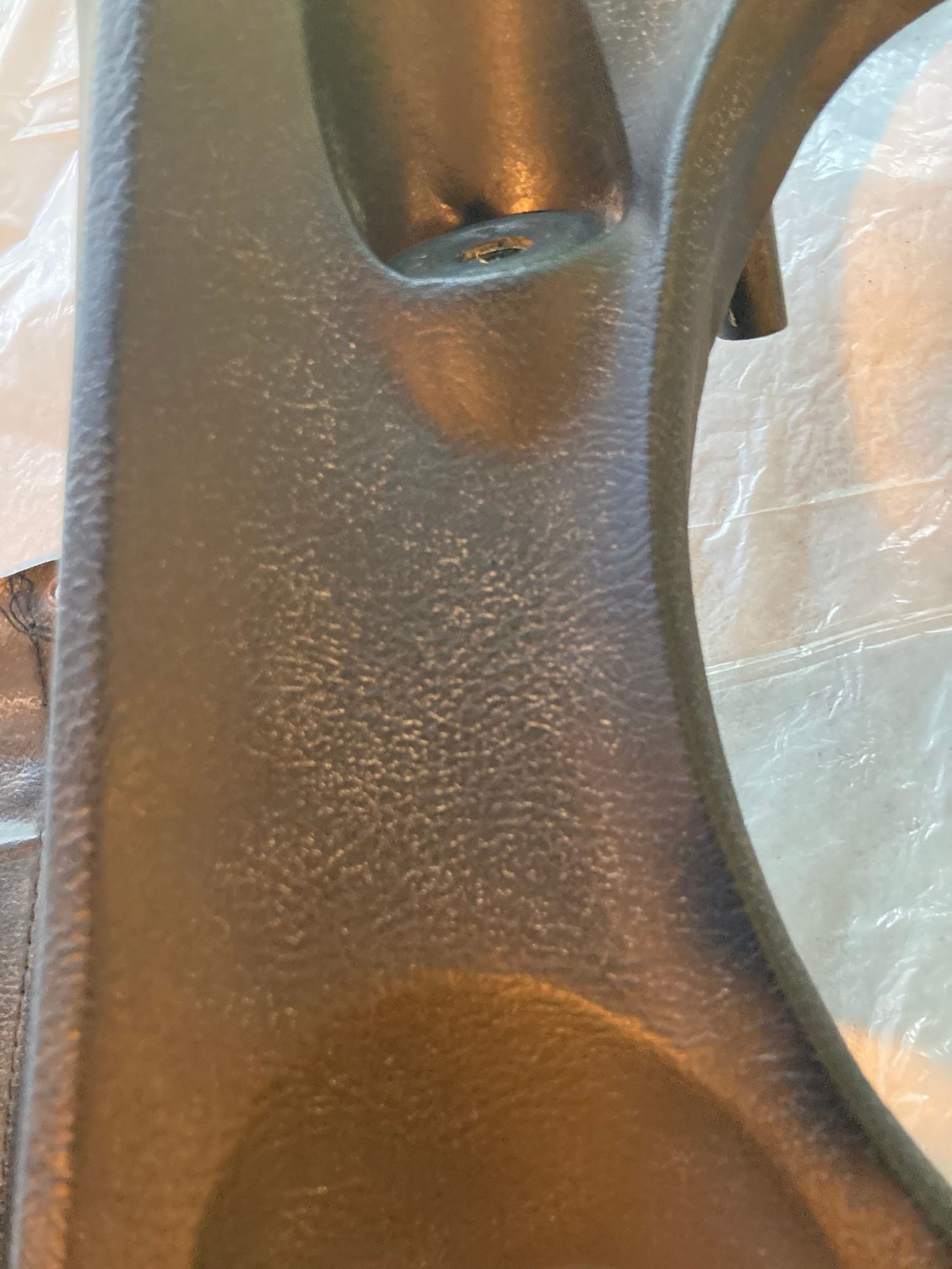

First order of business was to wash with warm soapy water and scrub all the dirt and grease off. There still was a lot of patina left on the pieces:

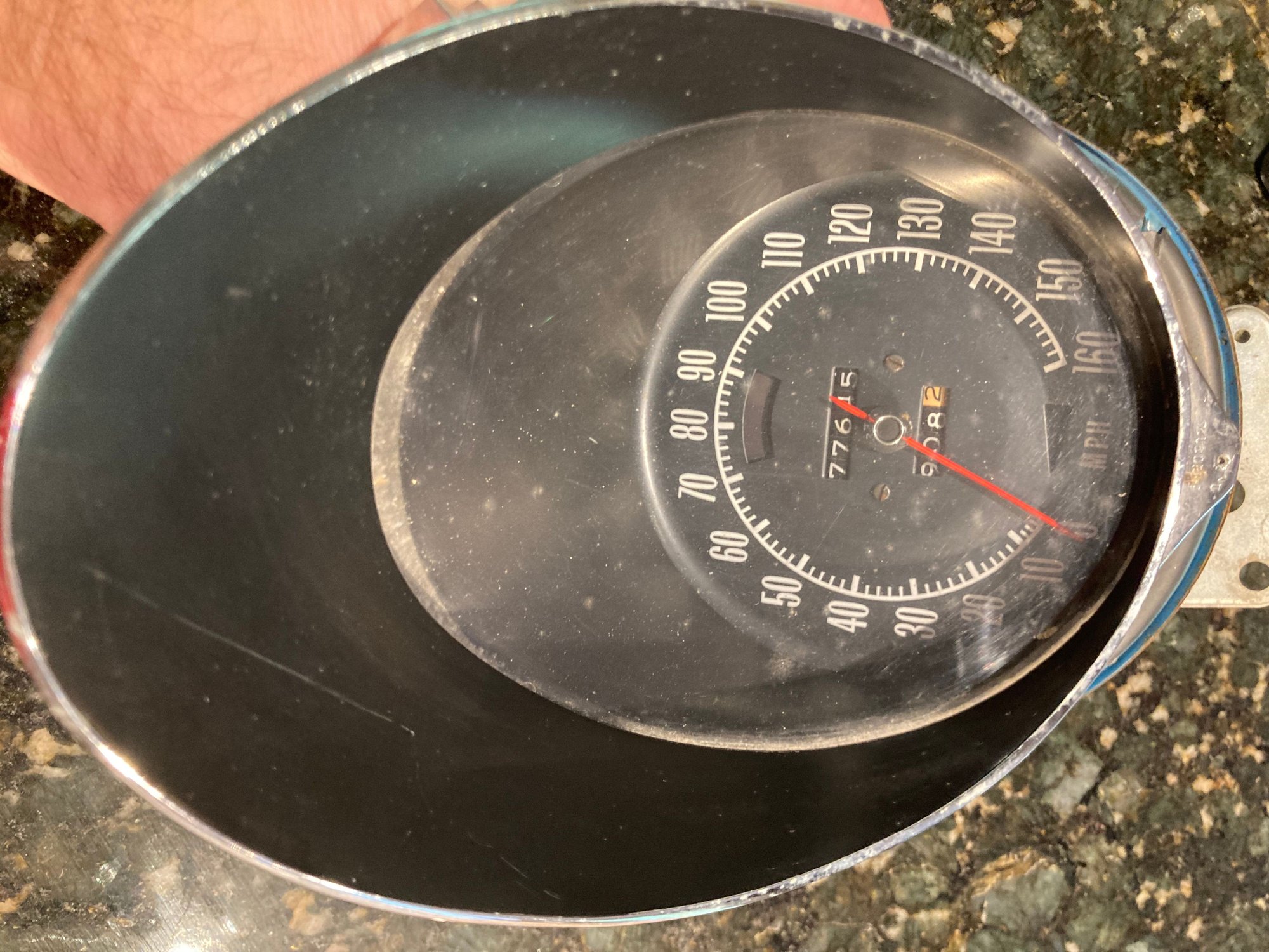

Next I have a set of gauges I got off eBay a while back, think they're off a '73 and have the white faces. My car is far from perfect, but I had to put the green face gauges with the 6500 RPM tach in my '71 LT-1! The face plates were cheap, but the tach face is on back order so I went ahead and took apart the speedometer, cleaned it up, and installed the new gauge face:

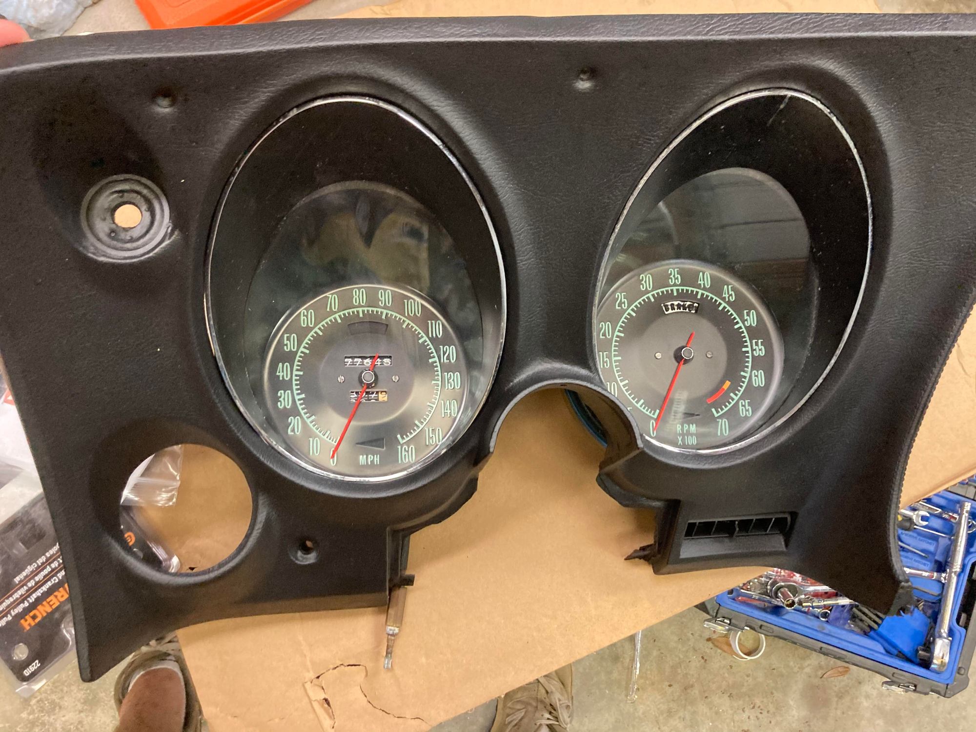

Dash is coming together nicely, and I can't wait to have the proper interior in my car! I have the chrome vents waiting to go in as well.

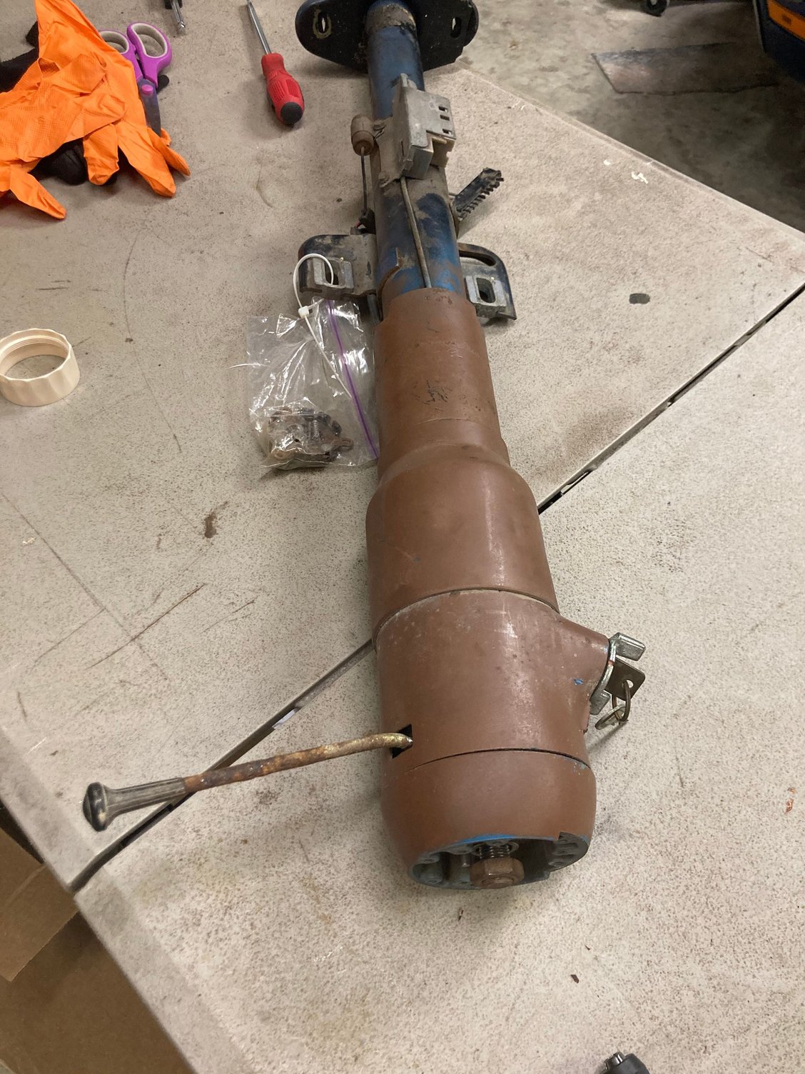

With the long holiday weekend, I was able to get some work done to my girl. Still waiting on Holley parts and dash parts, but I still had an elephant in the room for my interior conversion that I had to address: the steering column. Last time I had the interior apart, I tried to fit the correct '71 dash pad and discovered that the '80 steering column was wider than the earlier steering column by 10mm! This doesn't allow the earlier dash pad to fit around the later steering column. Fortunately, a steering column popped up for free on this site a while back and I was able to get it. While it's old and crusty the bearings are tight, and it just needs a refresh. I'm going to change the: turn signal switch, ignition lock cylinder, ignition switch, turn signal lever, and repaint it black. I watch some videos and got the required pullers to dissect the column:

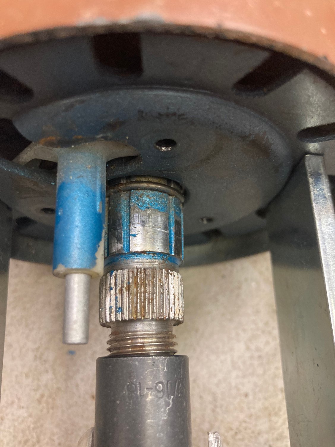

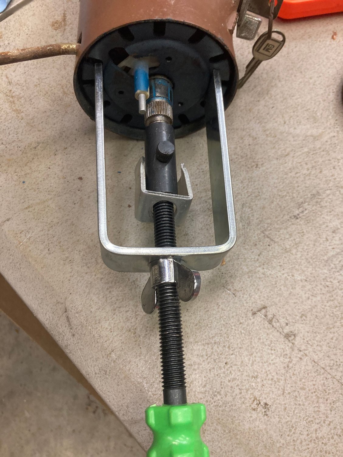

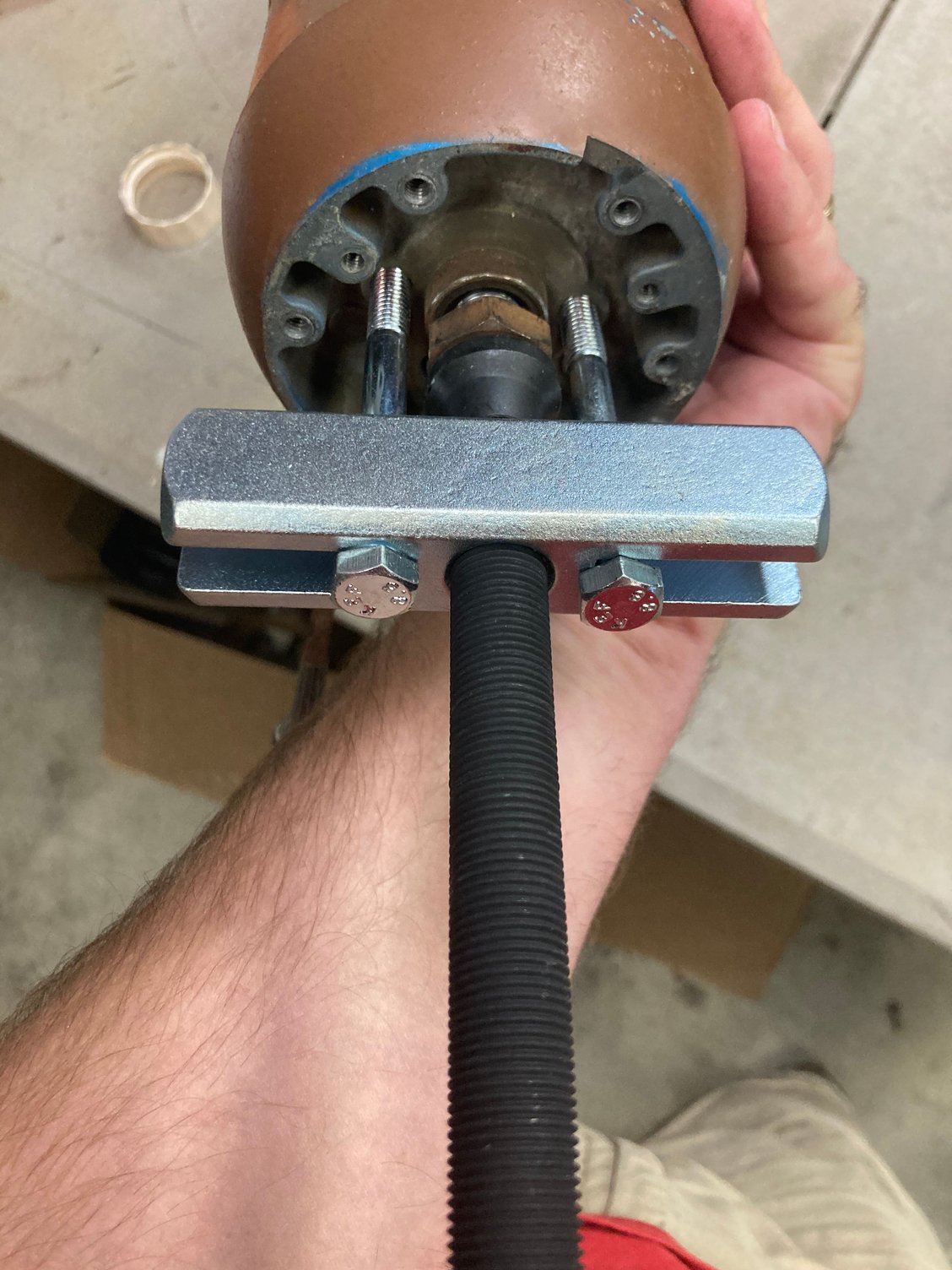

First step is to use a steering wheel puller to remove the hub:
Then you can work your way to the steering wheel lock plate, with this special tool:

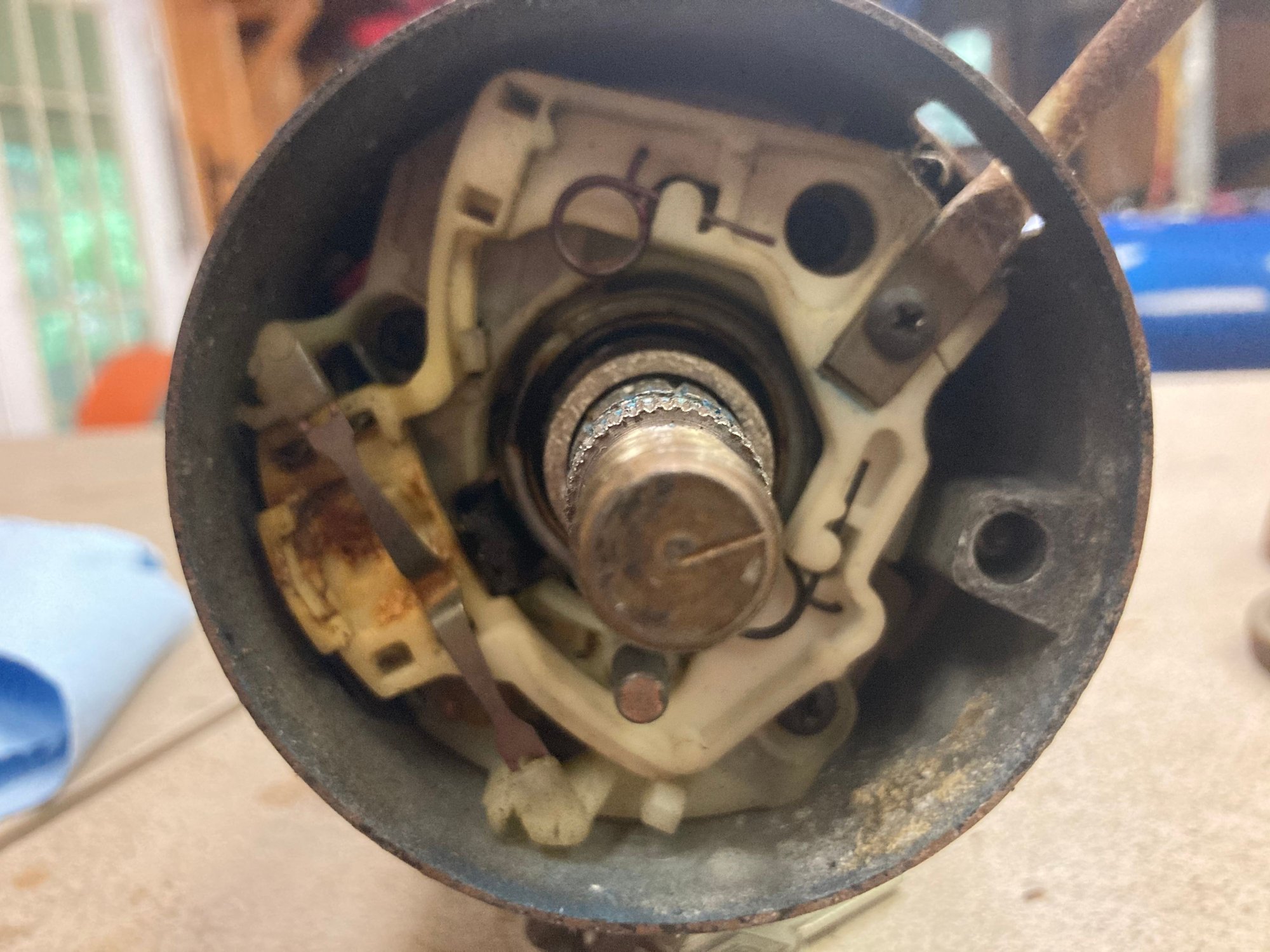

The clip took some work to get out, but wasn't too bad
Then you can FINALLY remove the turn signal lever and turn signal switch!

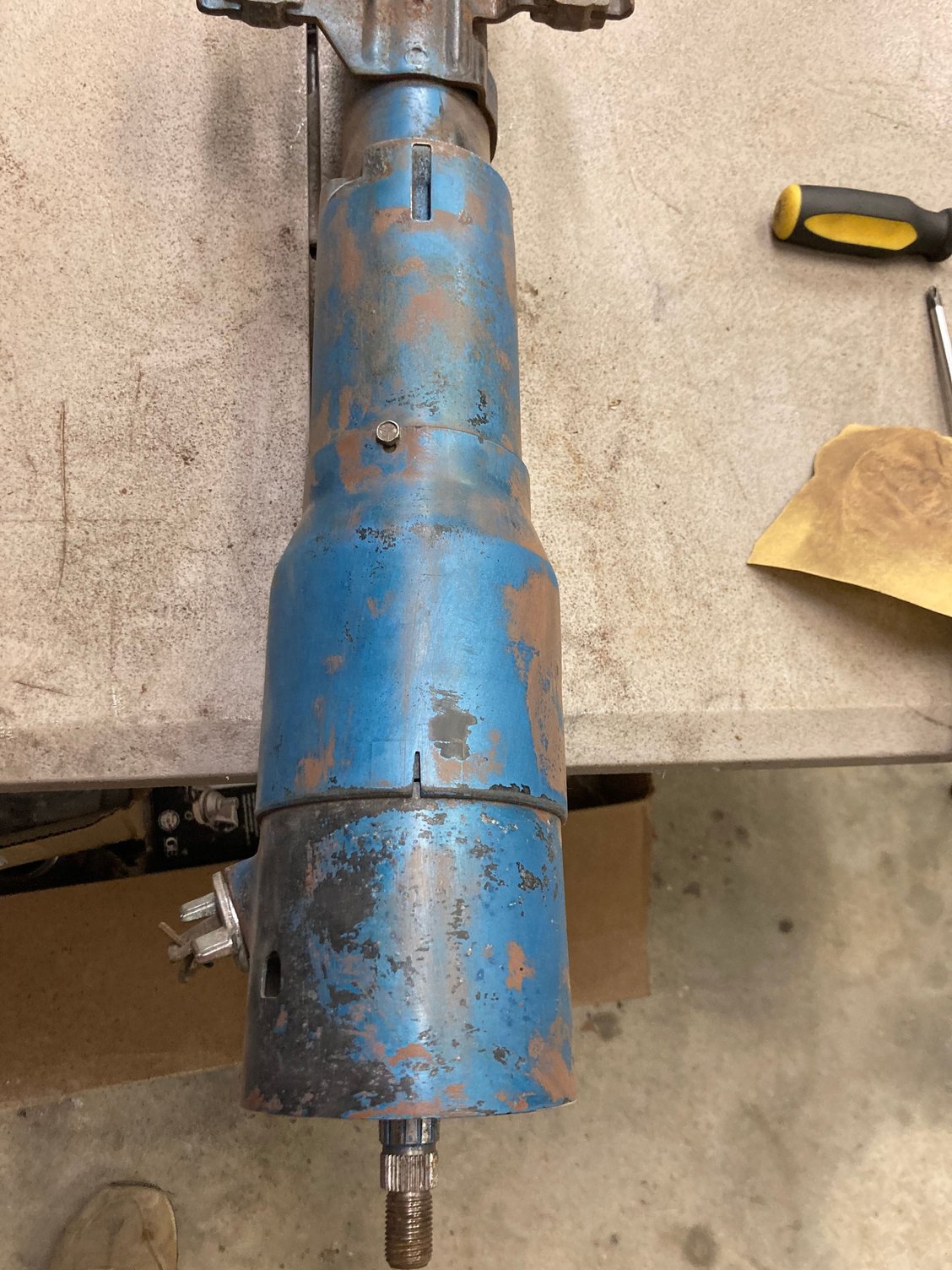

I then started to get all the old paint off. I first wire wheeled it, then sanded it all down with 320 grit.

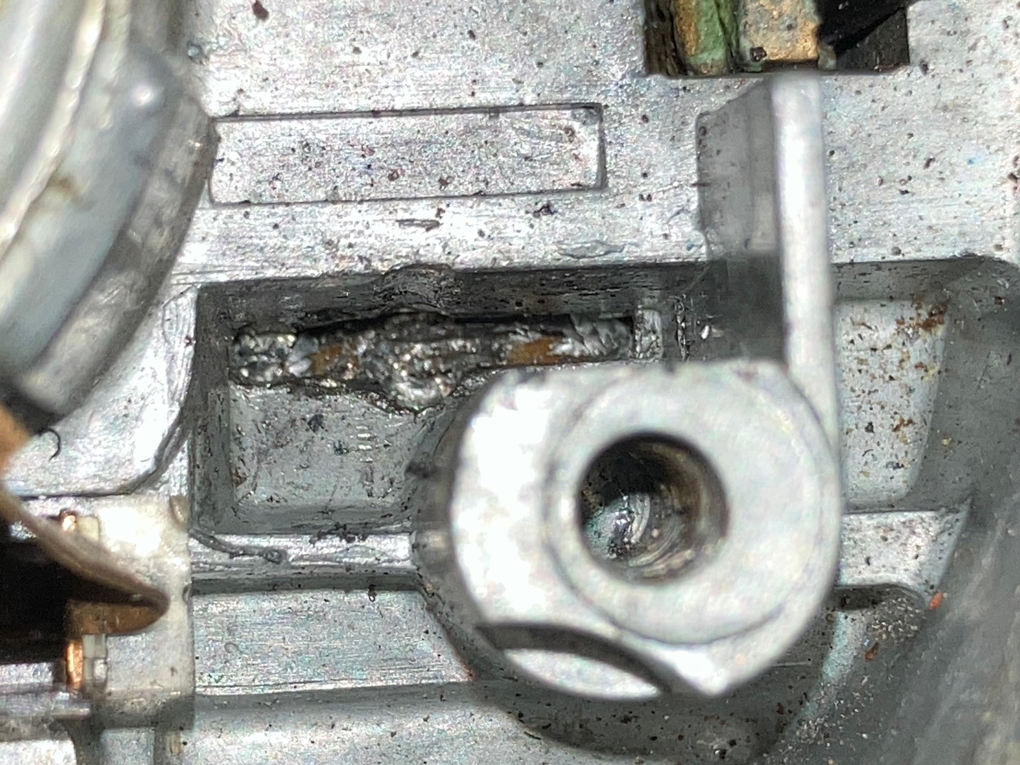

The turn signal switch slid out with ease after I removed the three screws that held it in, and finally I went to remove the ignition lock cylinder: this is where the fun began! This should be an easy task of just depressing the tab and popping it out, but my column had the hole covered with casting (read this is normal) and it took some work to remove it. I even used a drill to get it opened up - and boogered this thing up! I've fought with it for over an hour and cannot get this damn thing out! I can't feel the tab going down like it's supposed to and at the point where I'm going to start hammering it with a punch and having someone pulling on the key cylinder simultaneously! Just need a volunteer! lol So I took a break before I did some damage, anyone got some ideas?!
Here you can see the rectangle hole where you depress the tab on the back of the cylinder holding it in.. Maybe I should keep drilling and get that tab knocked down?

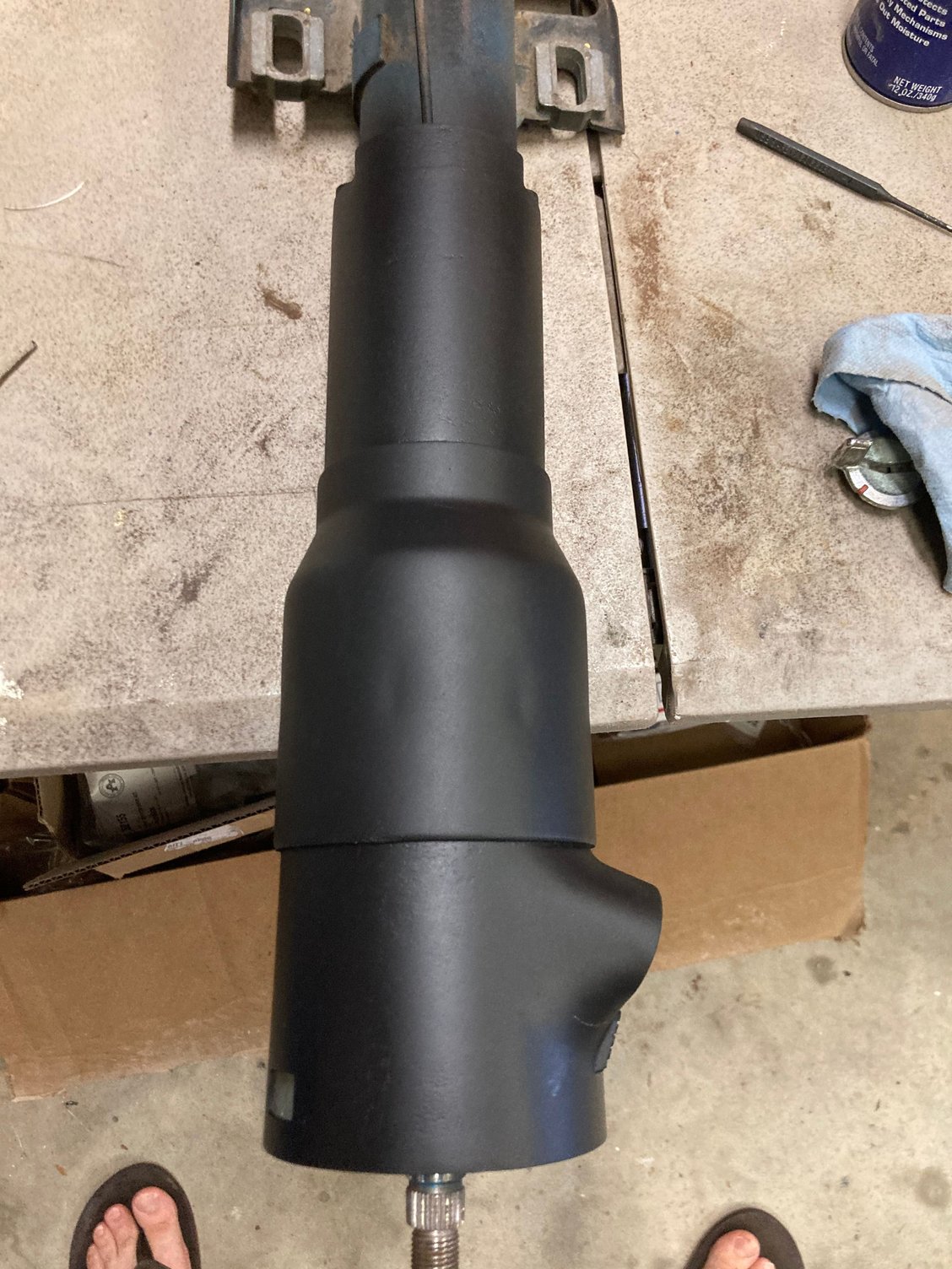

I did move onto priming, then painting the column with the SEM Landau Black, looking good!

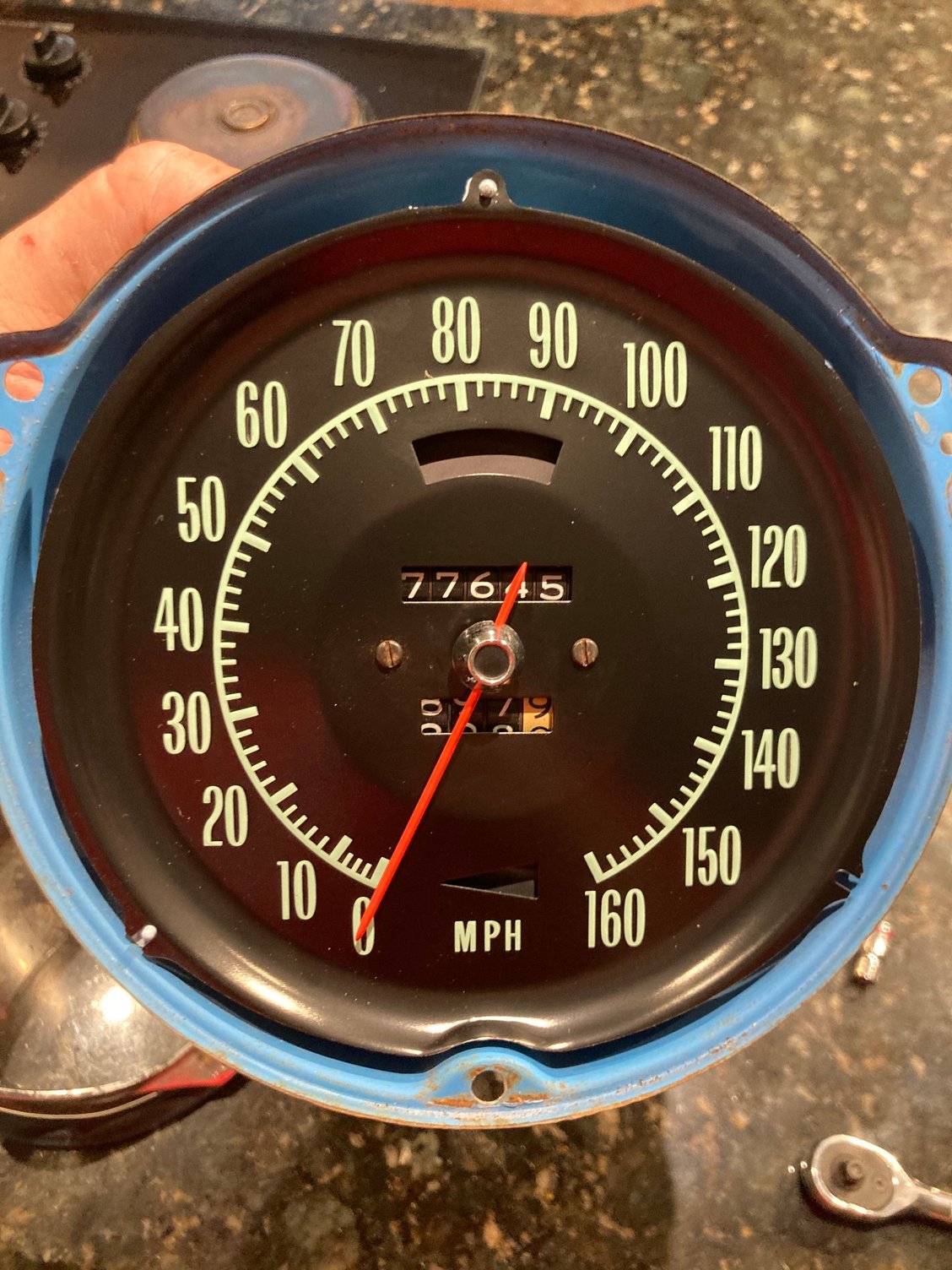

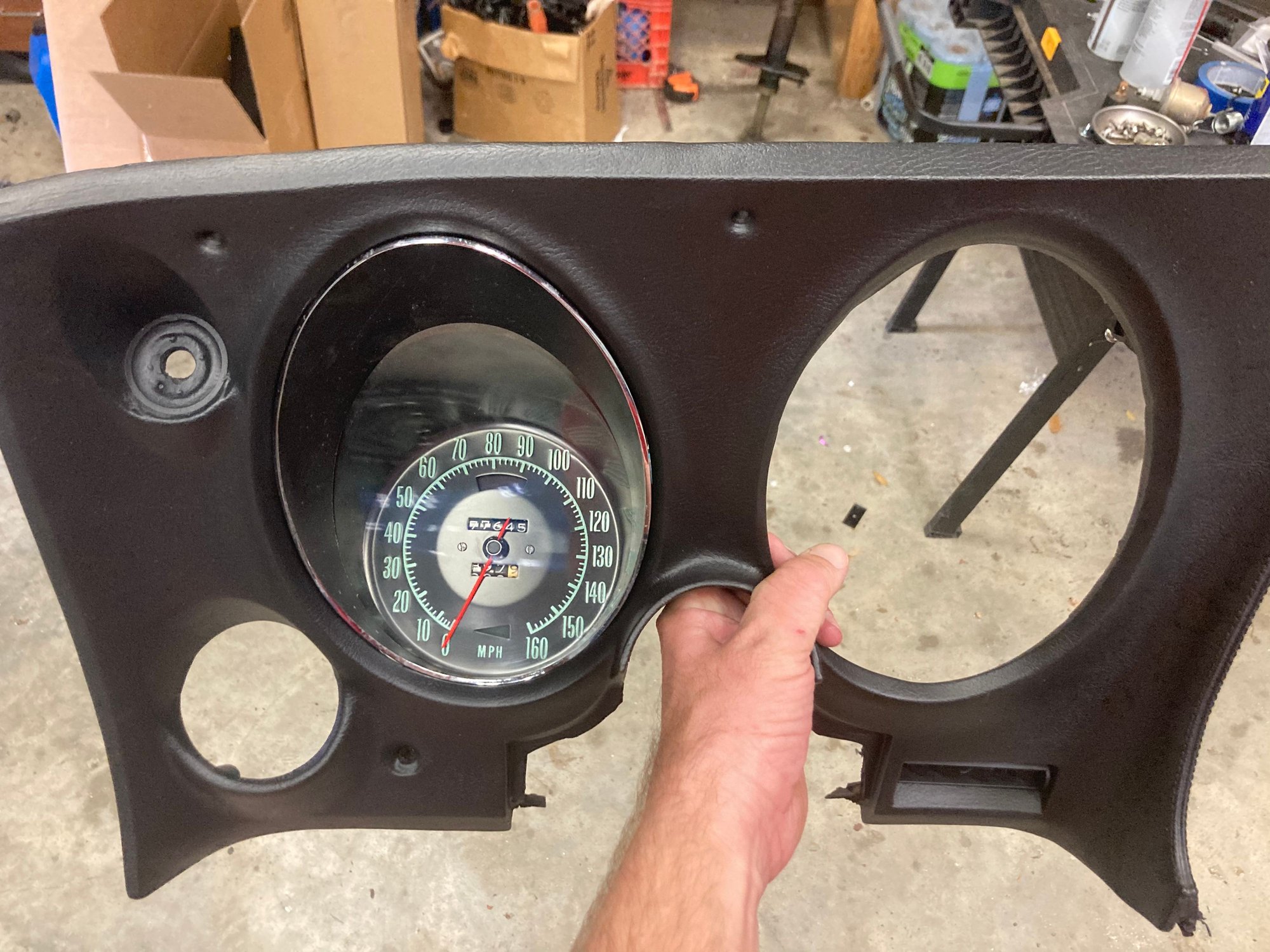

I also had my 6500RPM Tach face plate come in for my dash: The tachometer cleaned up nicely and it's starting to look like a complete dash! Chrome vents coming in this week and it'll be complete!

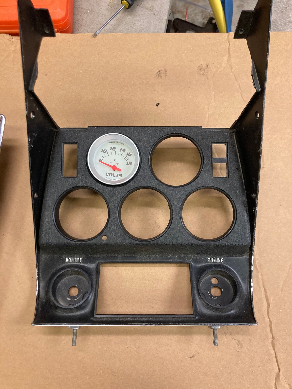

Got my bezel out, and here's a peak at how I'm going to do my gauges: will have AFR and Vacuum in the top two, and Temp/Oil/Volts on the bottom three with these aftermarket gauges I already have. Will probably eventually go to the stock gauges

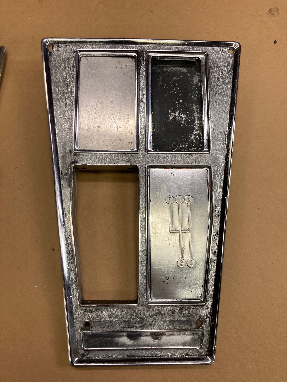

And I removed all the old wood, glue, and paint off this shift bezel. I know it's not a '71 bezel with the fiber optic lights at the bottom, but I got it for free so going to use it!
