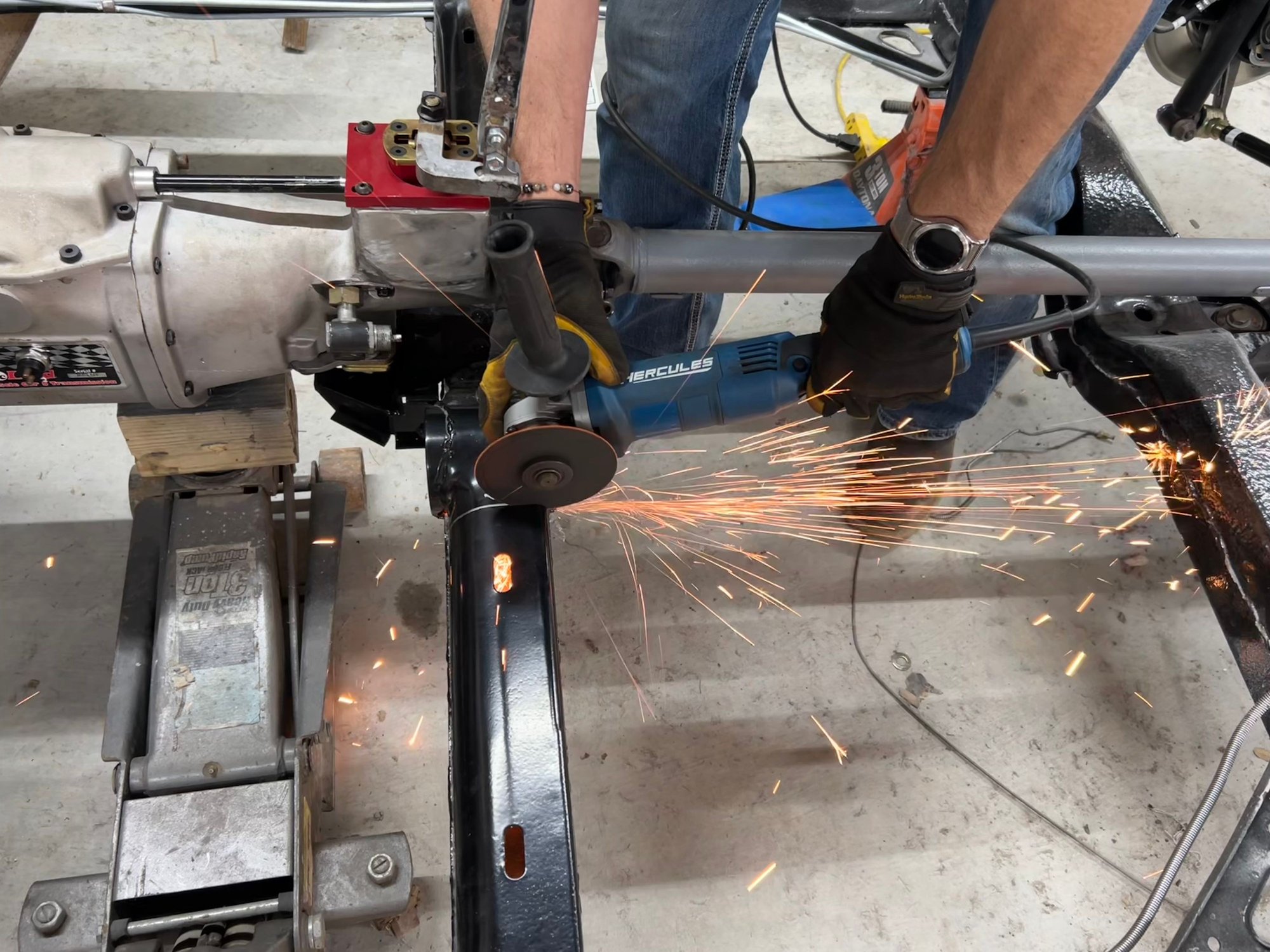

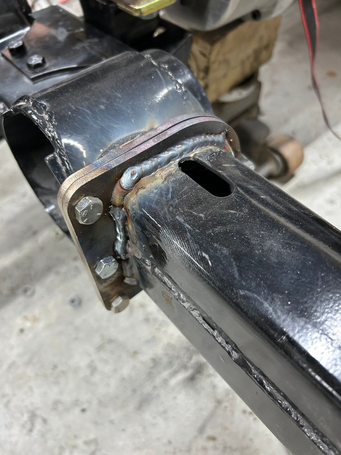

The first few weeks with the baby has gone great and I'm having a LOT more fun with this little guy than I imagined! Of course my wife owning a new born baby nursery in the past and having this all down to a science has been a huge help! They let me have a work afternoon in the shop today and my good friend came in to help with the welding on the crossmember with his new MIG, we got it done and had fun!
Started by getting my lines carefully drawn on with a square to ensure a straight line:
Then surgically cut it to ensure a straight and square cut:

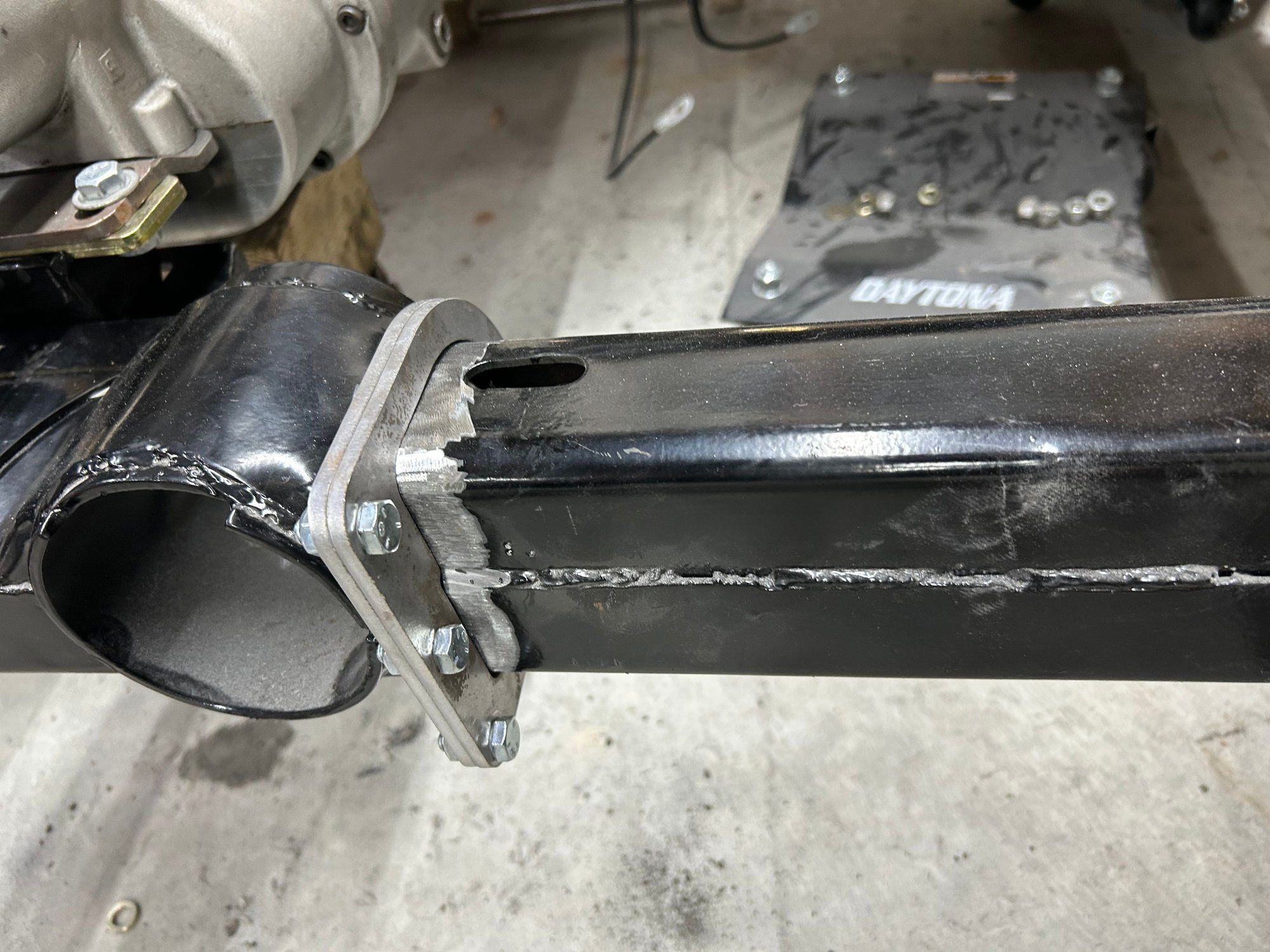

Removed the crossmember, grinded back the powder coating, then put the flanges on an it all back together. Getting it straight an square involved jacks and ratchet straps until I was happy before we burned it in:
welding went much better with my pro buddy this time:
Then finished with some VHT high heat enamel while still hot to bake in:

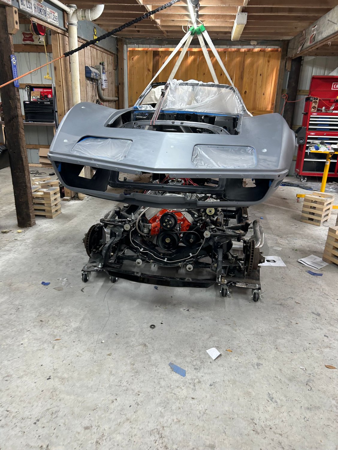

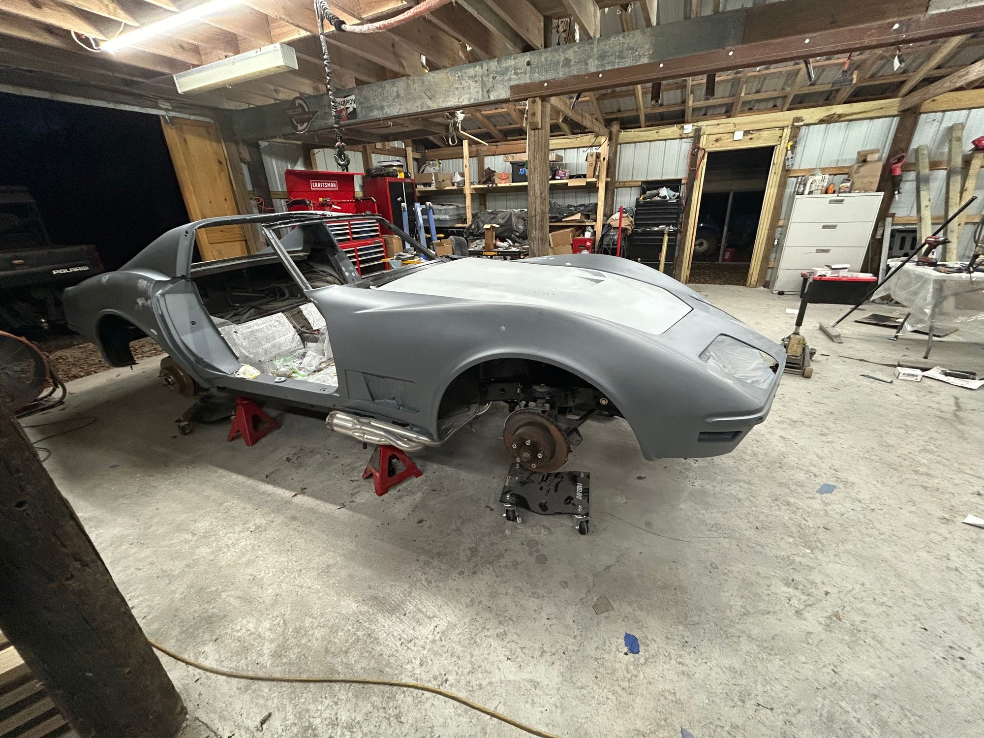

I spent time buttoning up the chassis last week and getting everything to ready to drop the body on over the weekend. Being the third time i've done this, it went pretty smooth! I had to trim the console to fit the new trans and it settled in nicely. I shimmed accordingly per my last fitting and will have to fine tune once I get the doors back on.

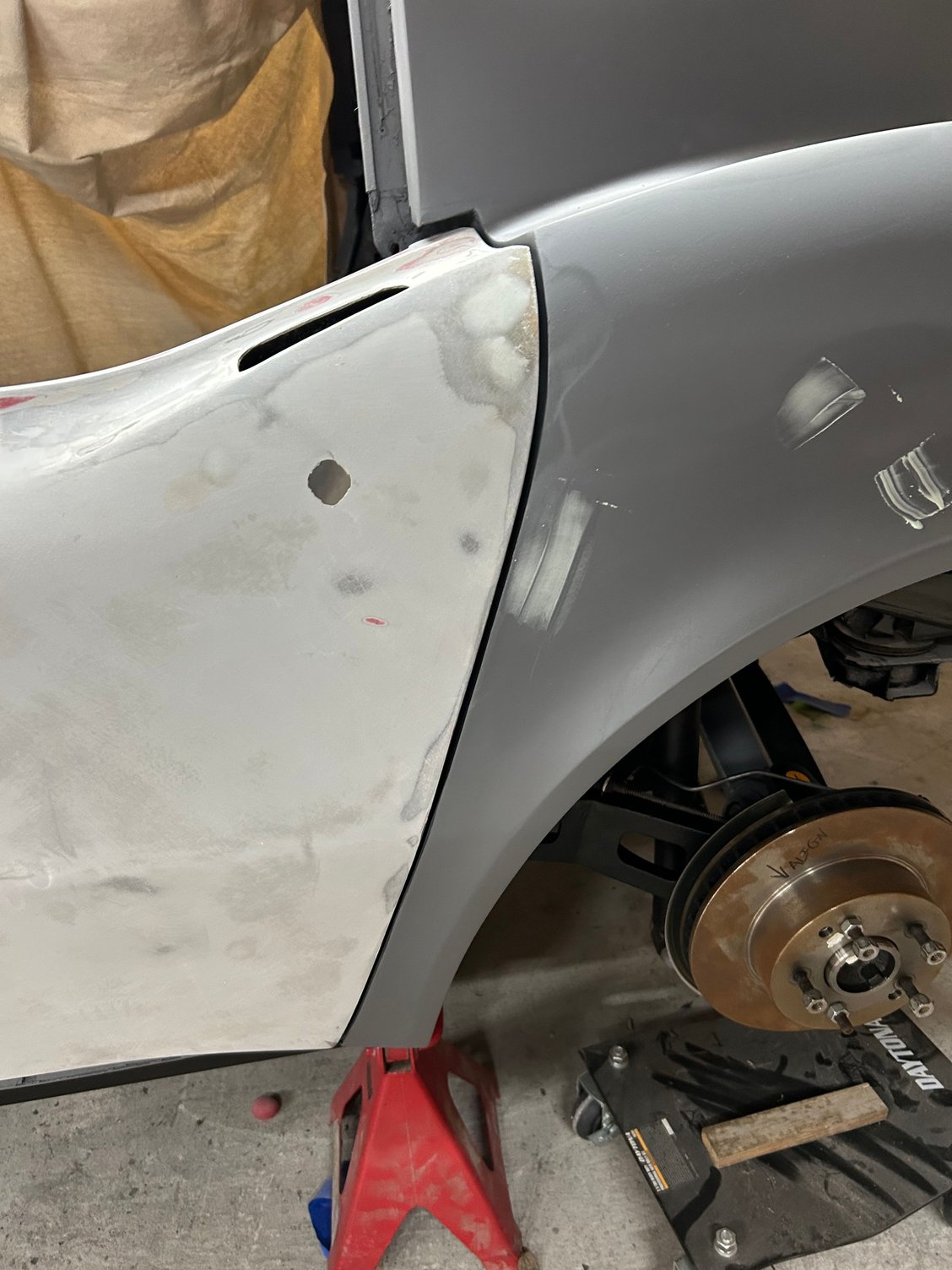

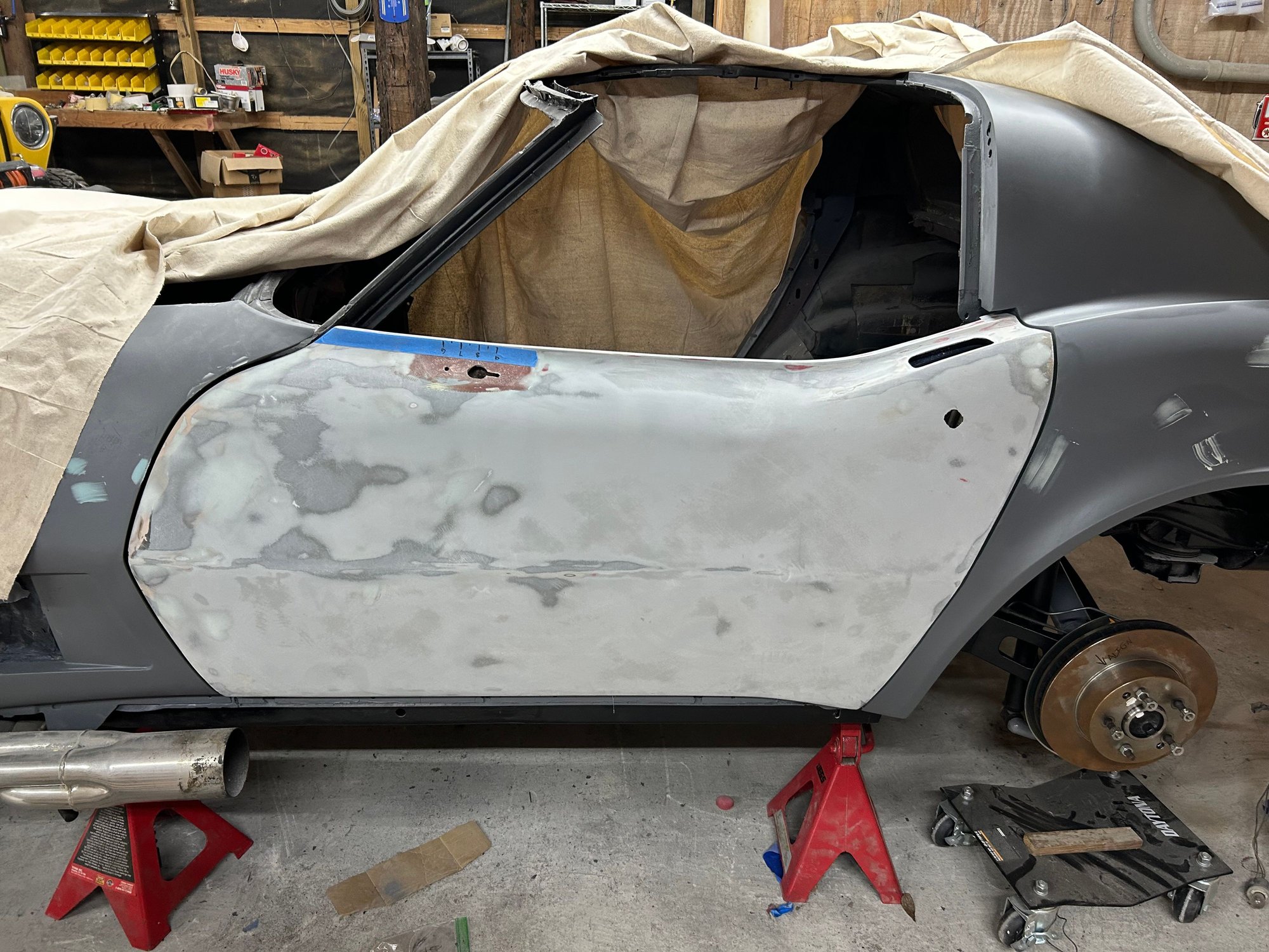

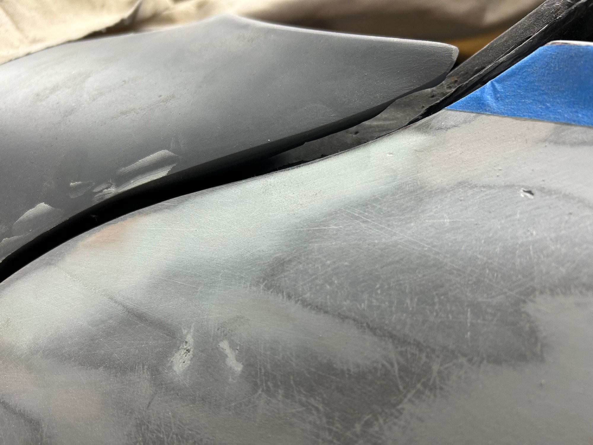

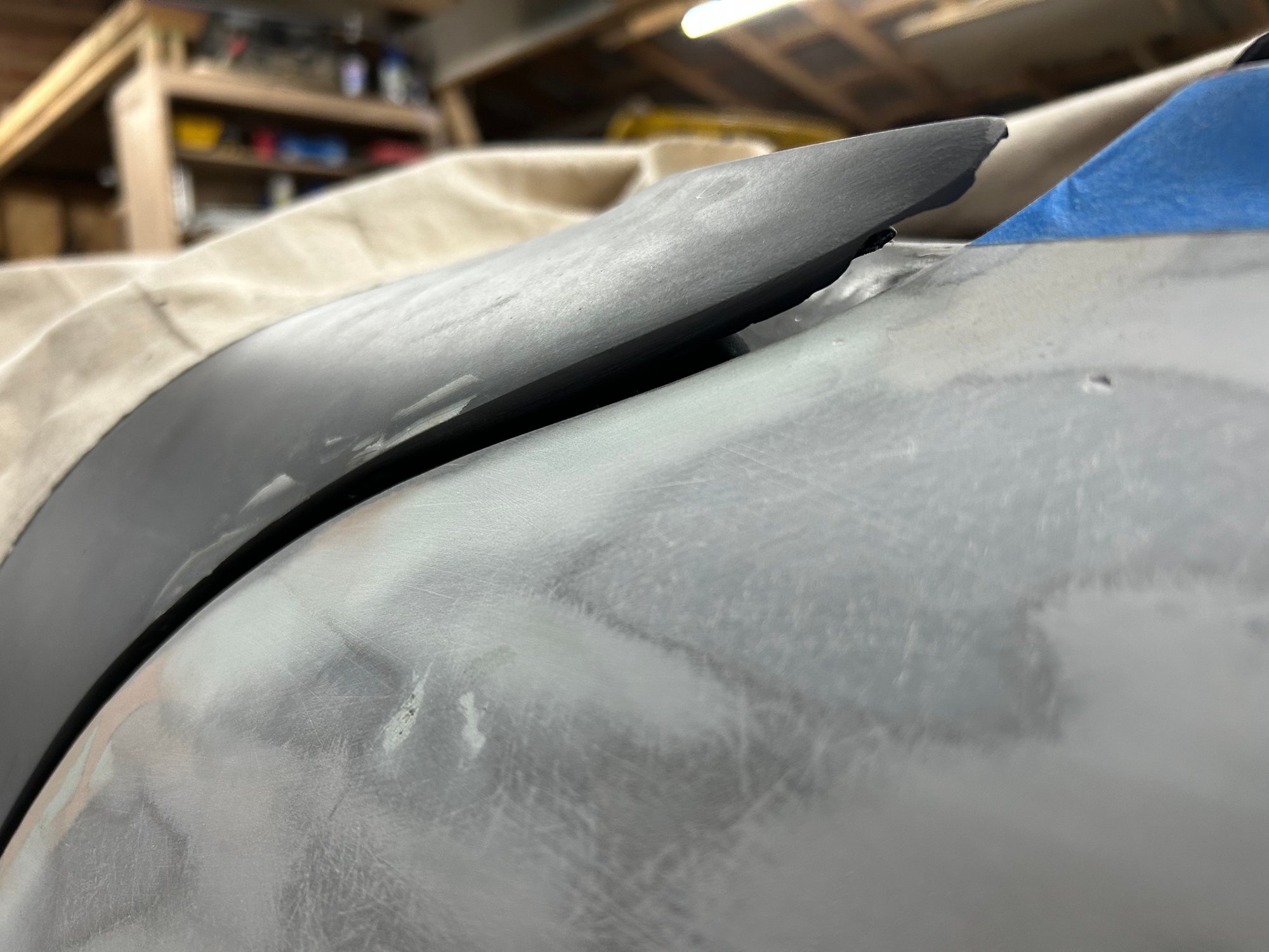

I put the door hinges back on today and got the driver's door back on to start aligning and working my gaps. My gaps aren't that bad and I got the alignment pretty good! The only area that concerns me it the top of the fender where it meets with the door is a 1/4" difference! It was never perfect there and now I know why there was filler built up on the door where it meets that area. I can make it better with filler but I'm not sure how to get it perfect?

I remember someone else posting about that area. The feedback was that in that area they were never really gapped well, even from the factory. If I ever do a repaint on mine my ocd will have me looking at it as you are, and would probably want to better fill that gap as well.
