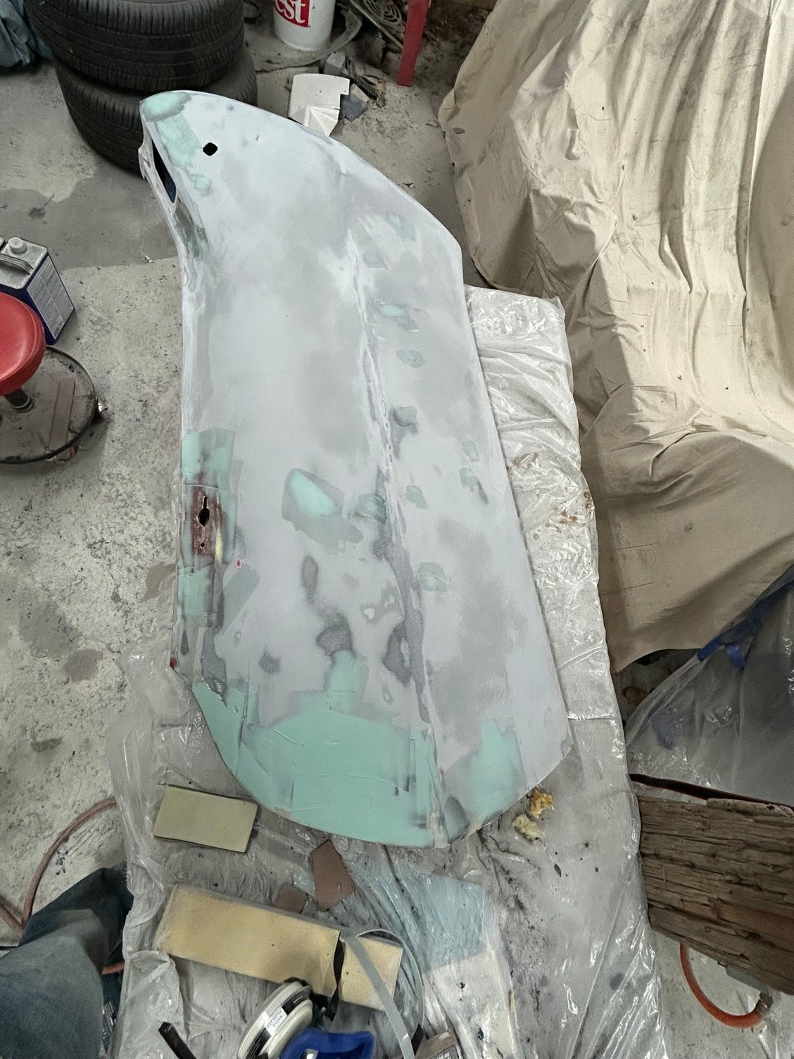

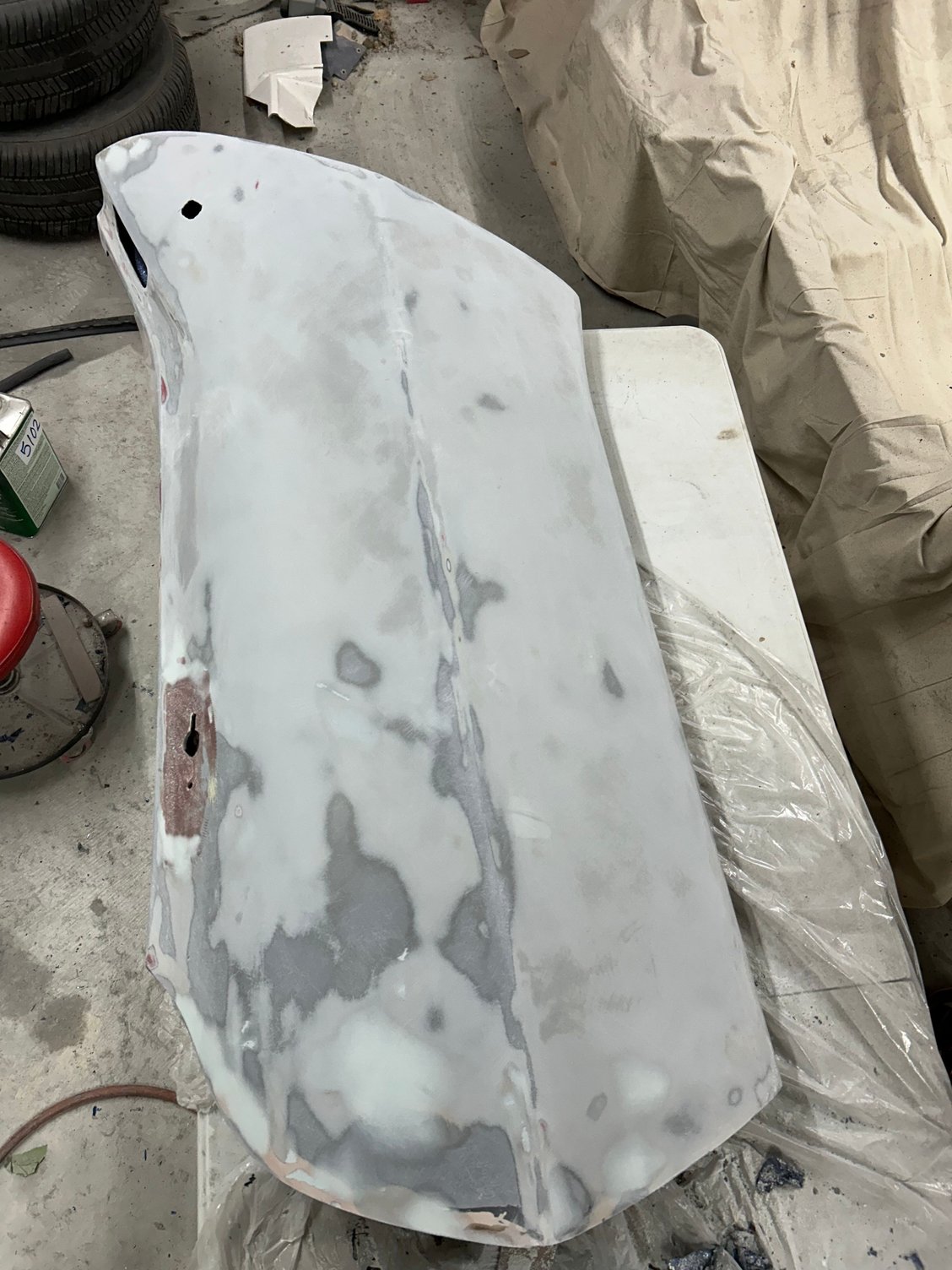

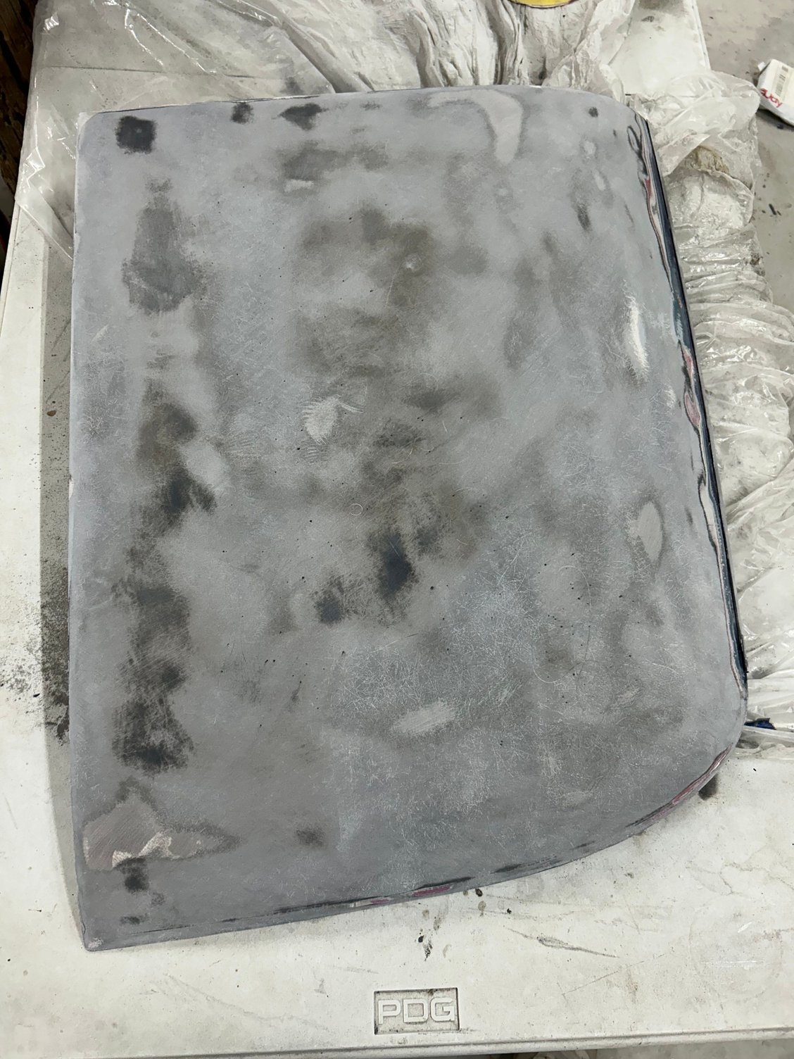

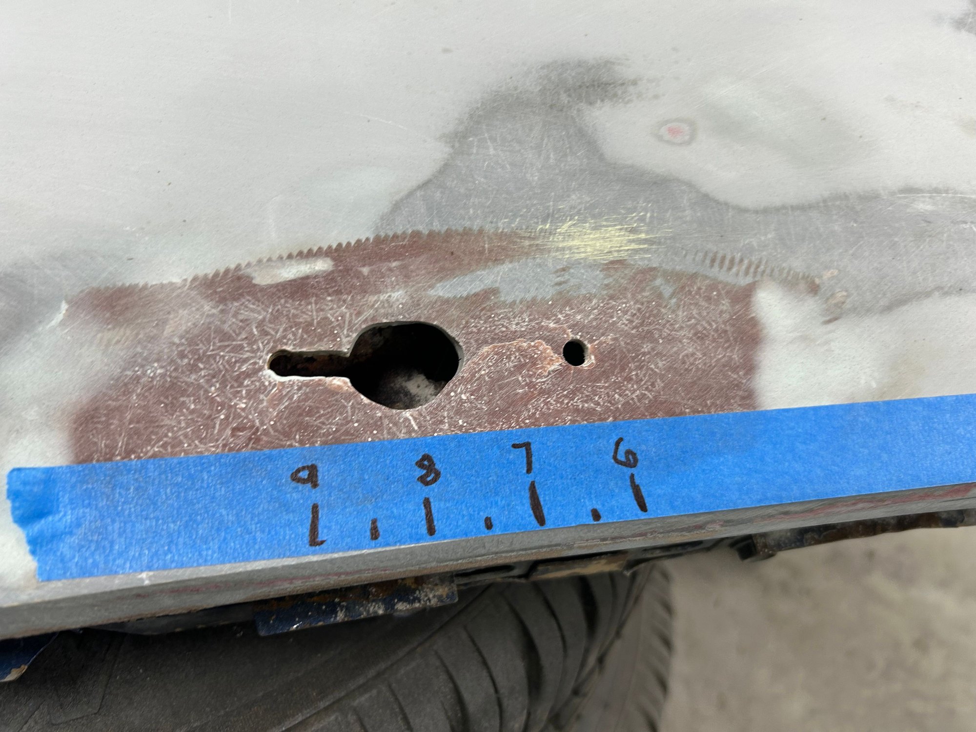

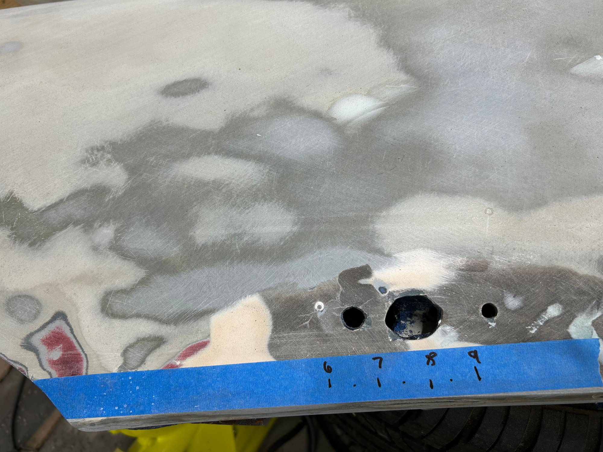

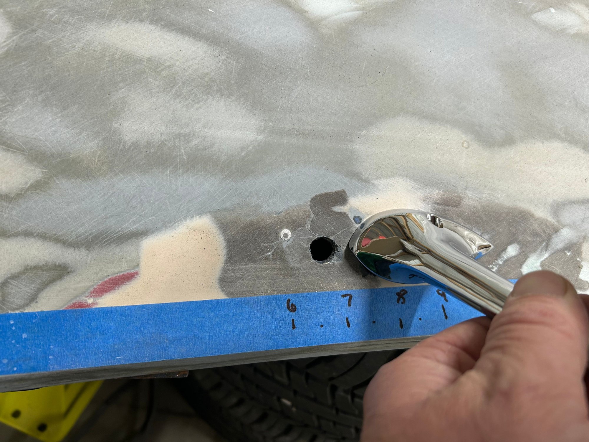

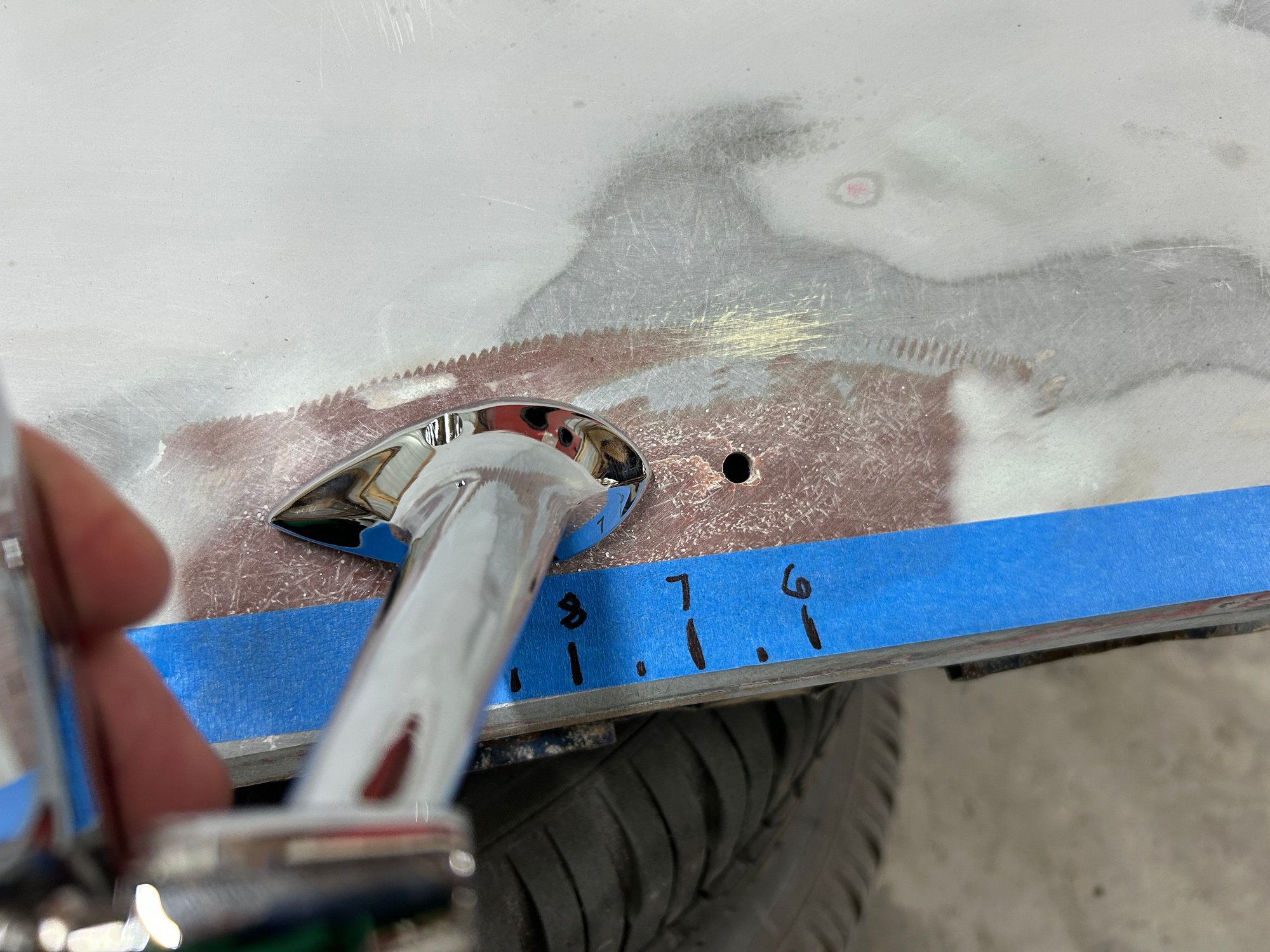

Spent my time finishing up body working my doors and finishing them up. I got my mirrors in on Friday so I can locate and mock up the brackets to determine ho much glass work on the holes has to be done:

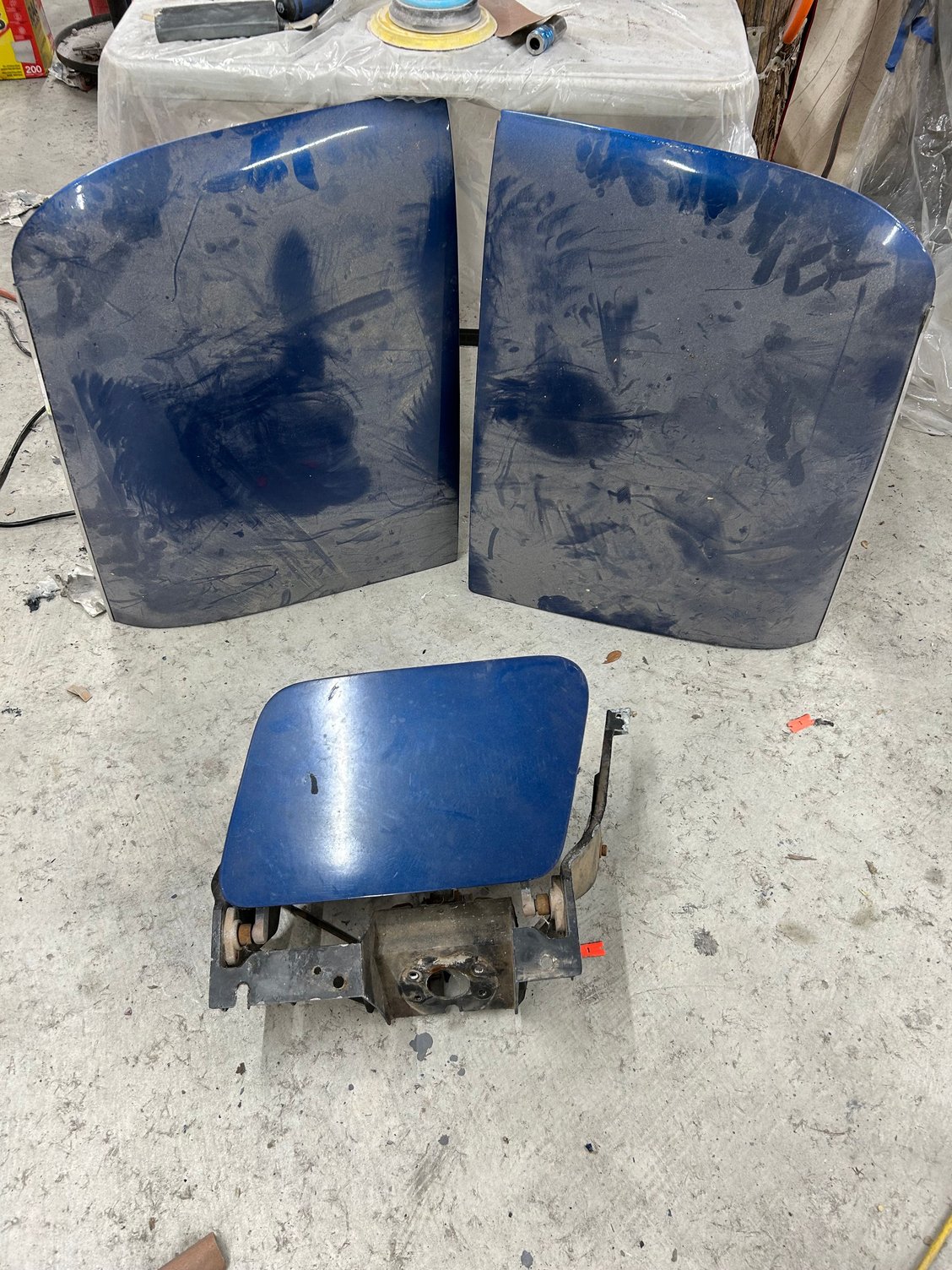

It was then time to work on the last few pieces I had left to sand down:
I got one top fully stripped and blocked. I starte removing the SS trim molding and some of the screws stripped, so I get to fight that with an easy out today..

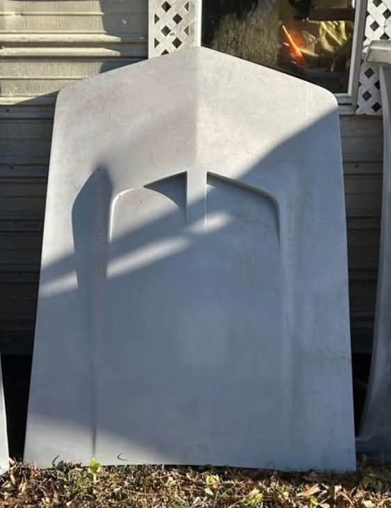

I've been looking for a reasonable deal on an LT-1 or BB hood that's in reasonable driving distance and finally found one 3 hours away. The seller couldn't tell me much about it, he was cleaning out his father's shed that used to restore Vette's and sent me a video with a full inspection: looked great! So I made an offer and plans to make the trip there today. To my delight the hood was an OEM BB hood from a '71 in perfect condition! Seller threw in a metal '71 headlight bezel too and sold me a Holley 3310 (rebuidable core) for another $50. So a good haul for $550 total today! Took the wife along and we had lunch on the coast an did some sight seeing on the way home, it was a fun adventure! Now I have the final piece of the puzzle for my LT-1!

That’s better than any aftermarket hood.
Nice find.
Now you get to fit it to your car.
Nice find.
I'm hoping it's pretty close since it's OEM, I didn't want to fight an aftermarket hood! I'll find out soon! lol

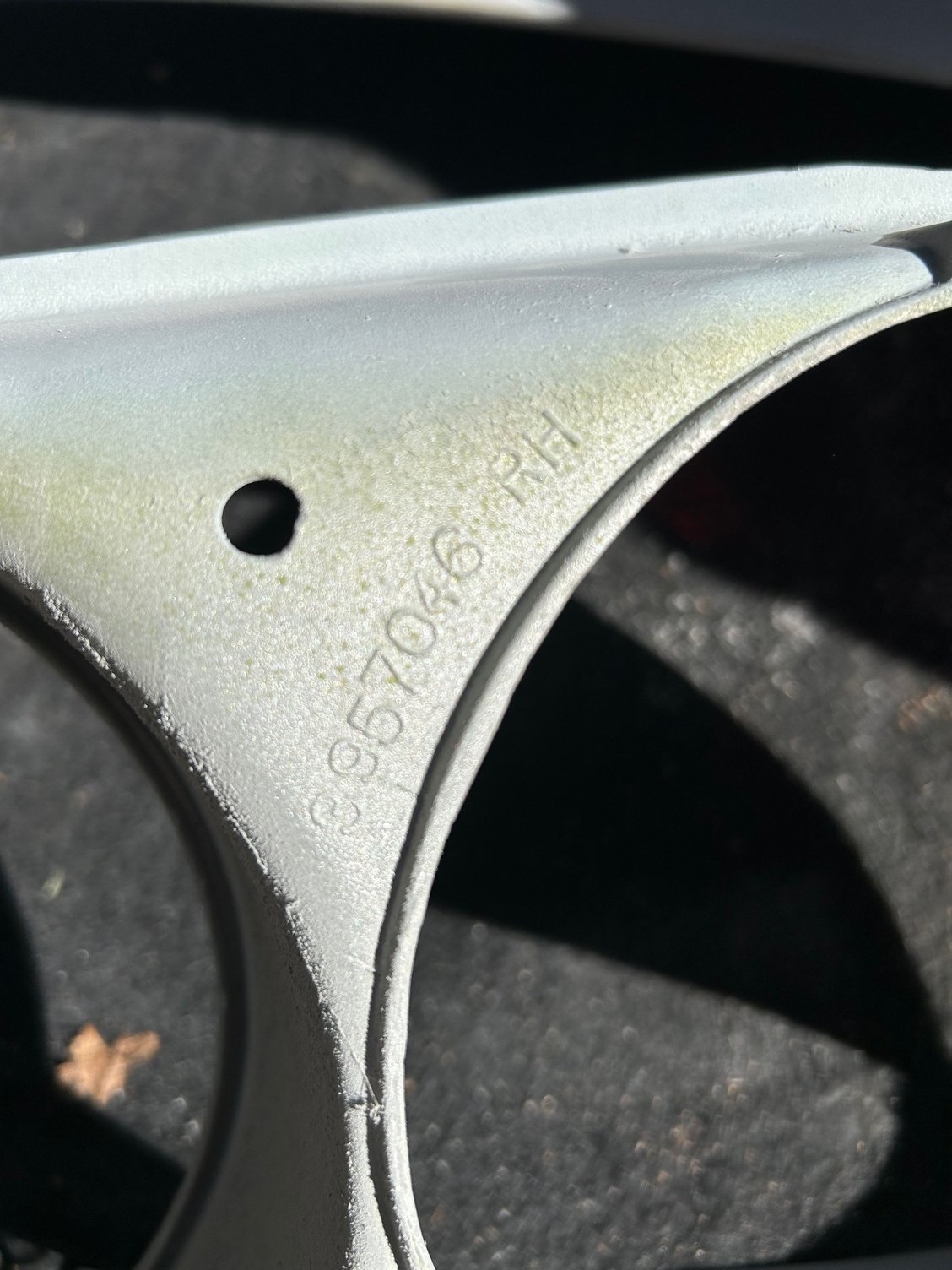

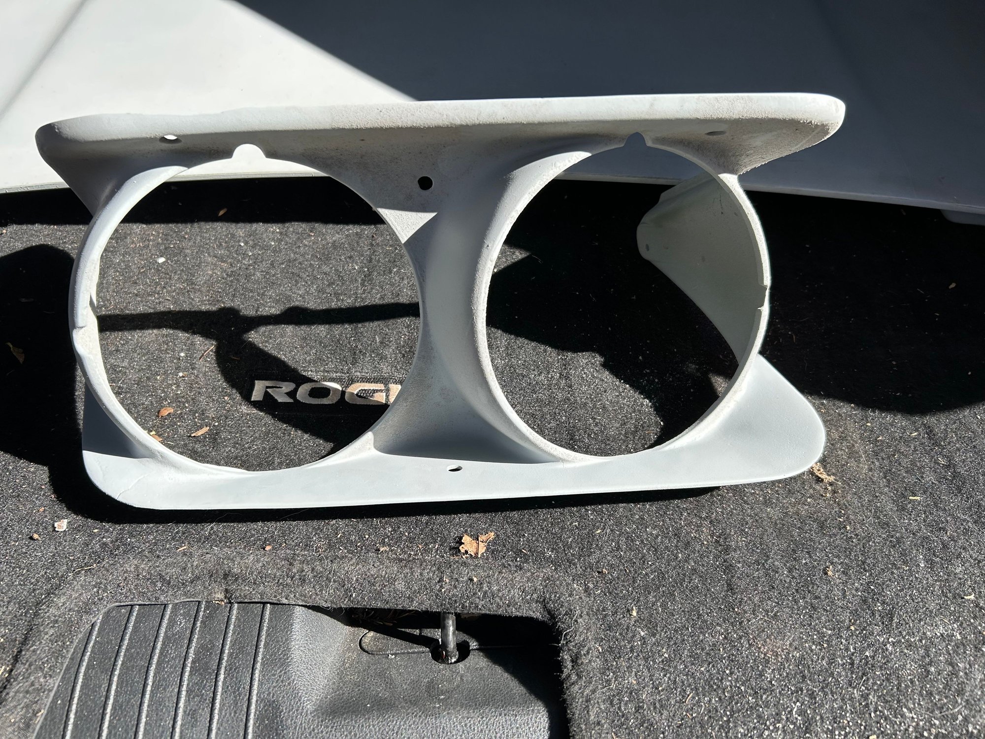

After some research, it looks like I got lucky and the headlight bezel I got is a correct '71 bezel:

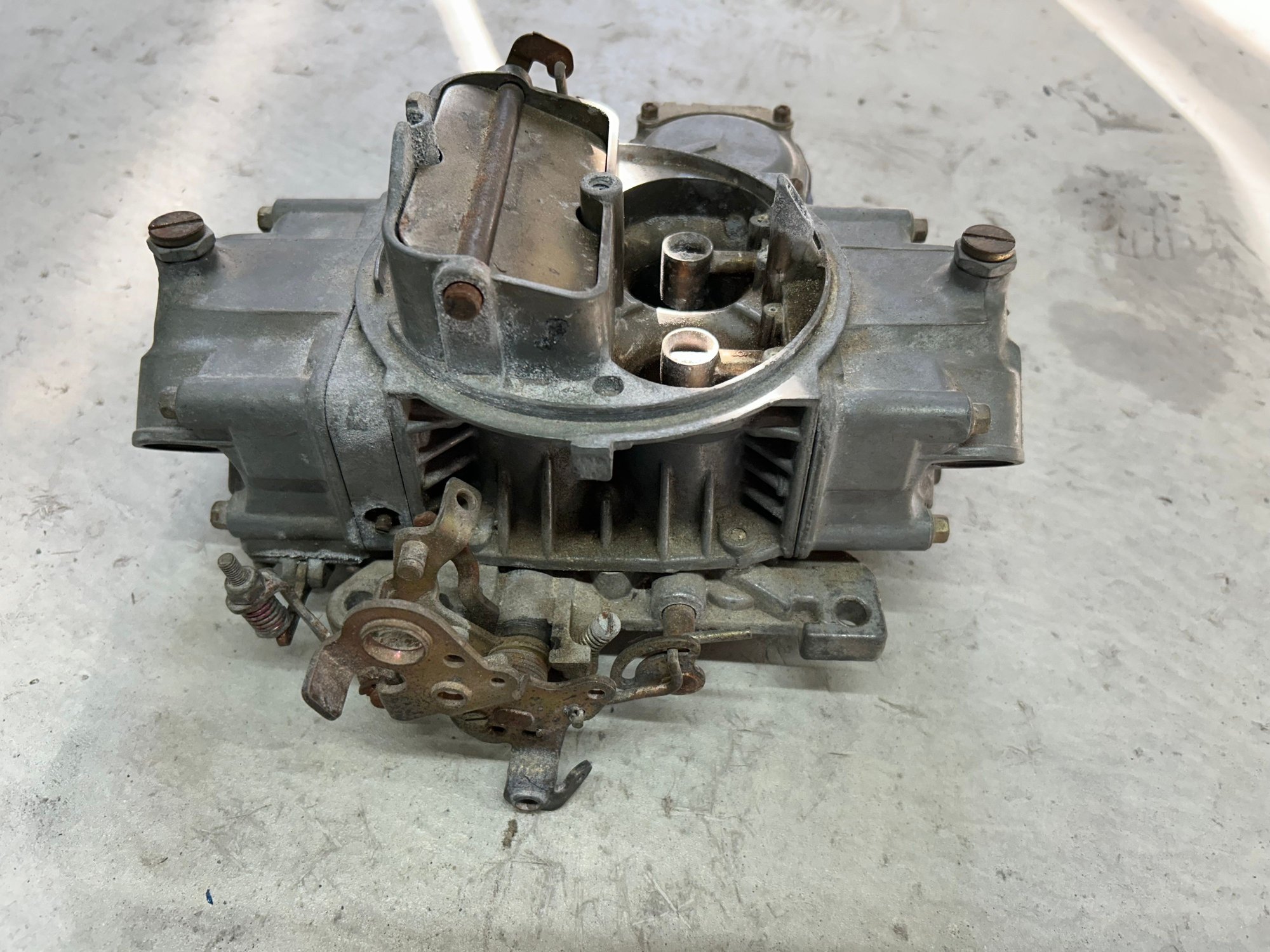

And here's the Holley 3310-6 I got. It needs a full overhaul, but will give me the option to go VS if I choose to:

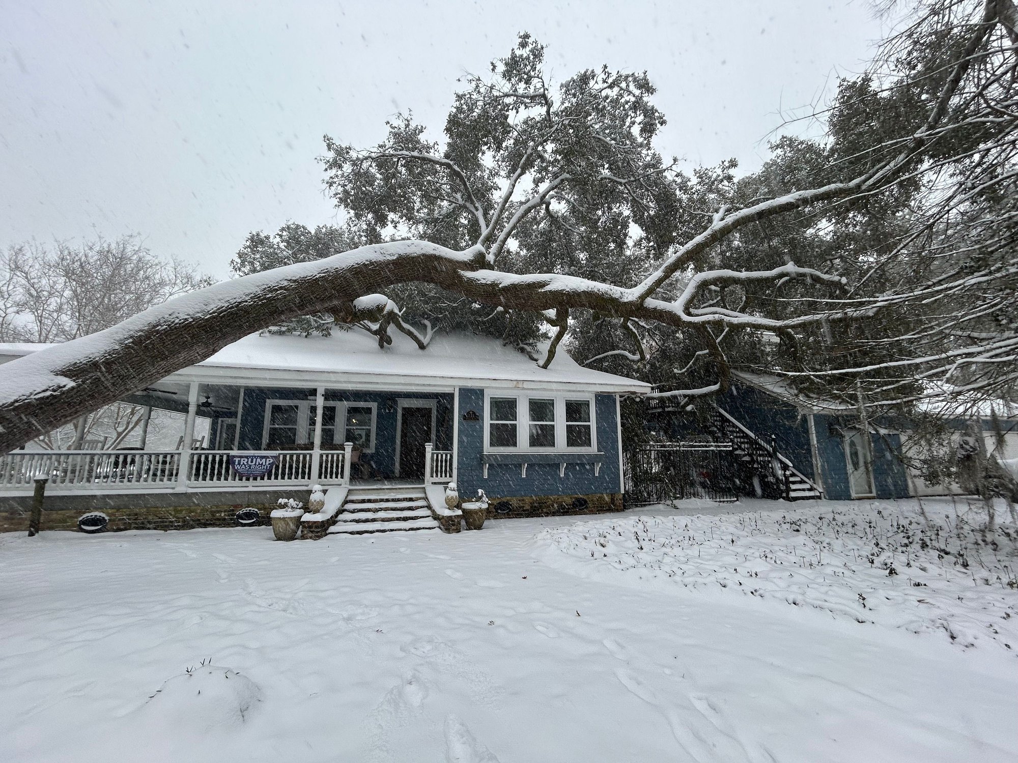

Last week there was a massive snowocalpse on the Gulf Coast that brought 10" of snow to my house! It was a beautiful winter wonderland until the snow caused a beautiful 100 year old Live Oak to lay down on our house!! It happened very slowly, which mitigated a lot of damage. But unfortunatey, some rafters split and the tree ent through the roof in to spots! This caused the snow melt to do water damage to the baby's nursery! So this was horrible timing with our baby coming out in the next two weeks, so I've been busy dealing with this mess and rushing to get everything fixed.
The tree has been removed, mess cleaned up, and rood tarped over to prevent further leaks. As wait for numbers from the insurance adjuster and contractor, I was able to get a little work done on the C3 tonight:
New mirrors are in so I did some good measuring and mocking to ensure they would cover the majority of the exisitng holes - they will! A little glass work and cleaning up will be required, but nothing bad:

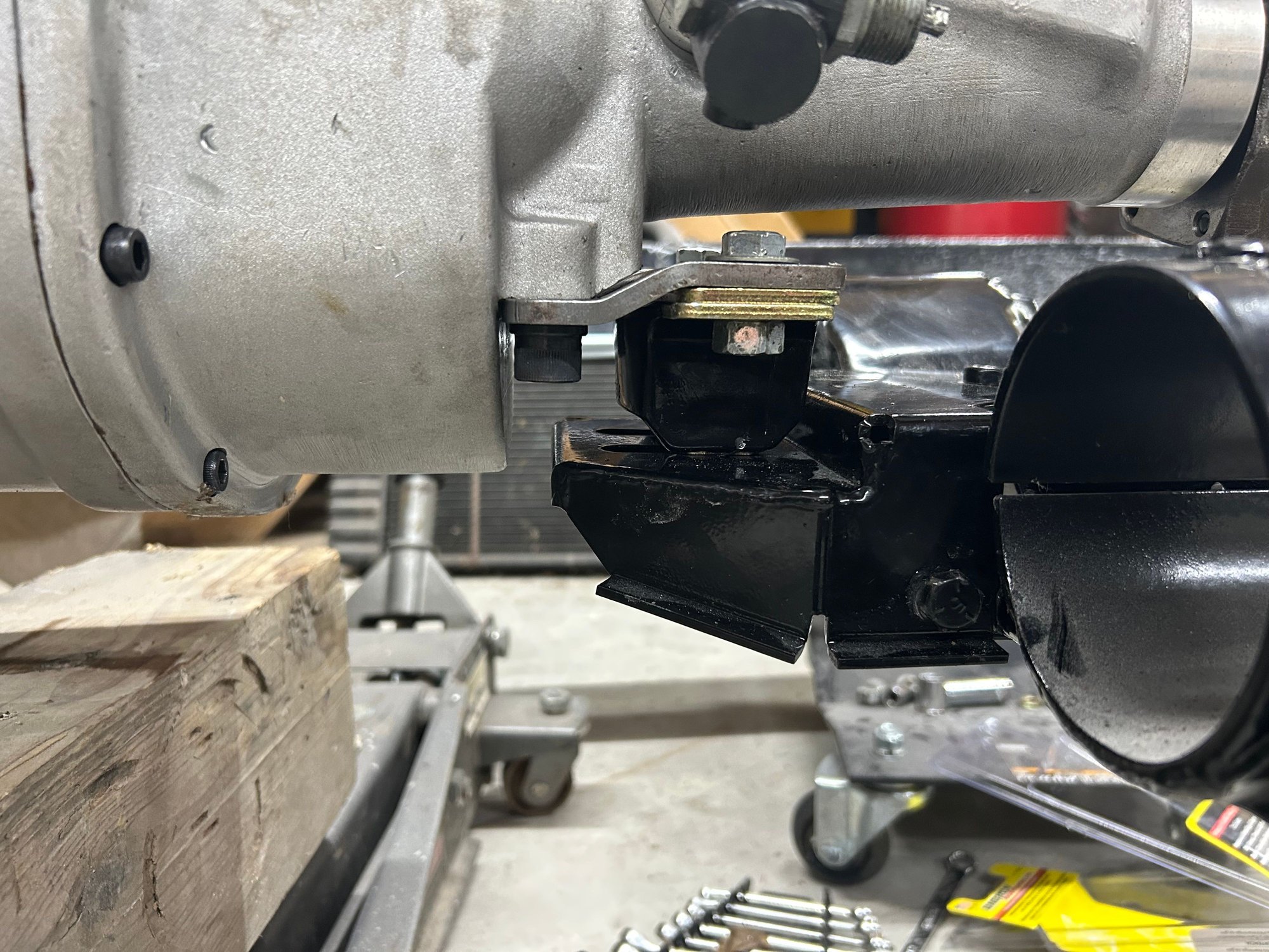

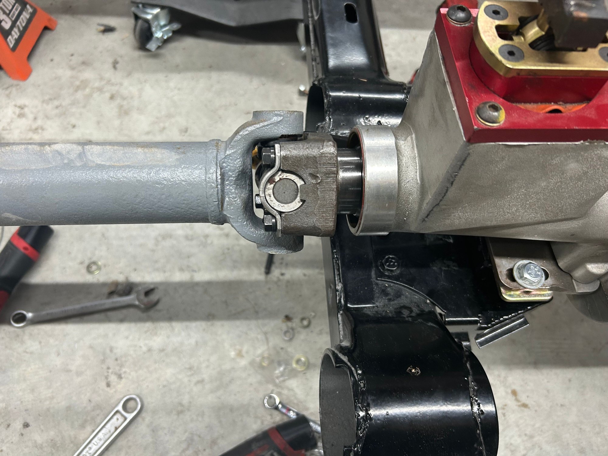

I got a call from Van Steel today and they're building my offset trailing arms, they'll be shipped out at the end of the week! So I needed to assess the chassis to make sure everything was in order to reassembly from the parts I stole for my '69 (mainly trailing arms and brakes).
I needed to finish bolting everything in for the new trans mount setup on the McCleod 5 speed, which came together nicely:

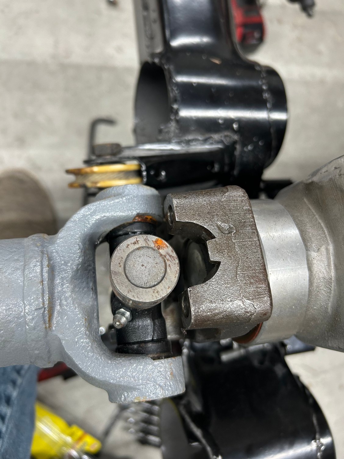

Then there was the driveshaft that needed to be fitted. At first, I thought that it needed to be extended..
Then I thought about it for a minute and remembered the yoke slides back!! LOL

I also had the same drive shaft panic as you until I remembered, oh yah the yoke slides in!
Yeah it was quite the light bulb that went off when I remembered that lol

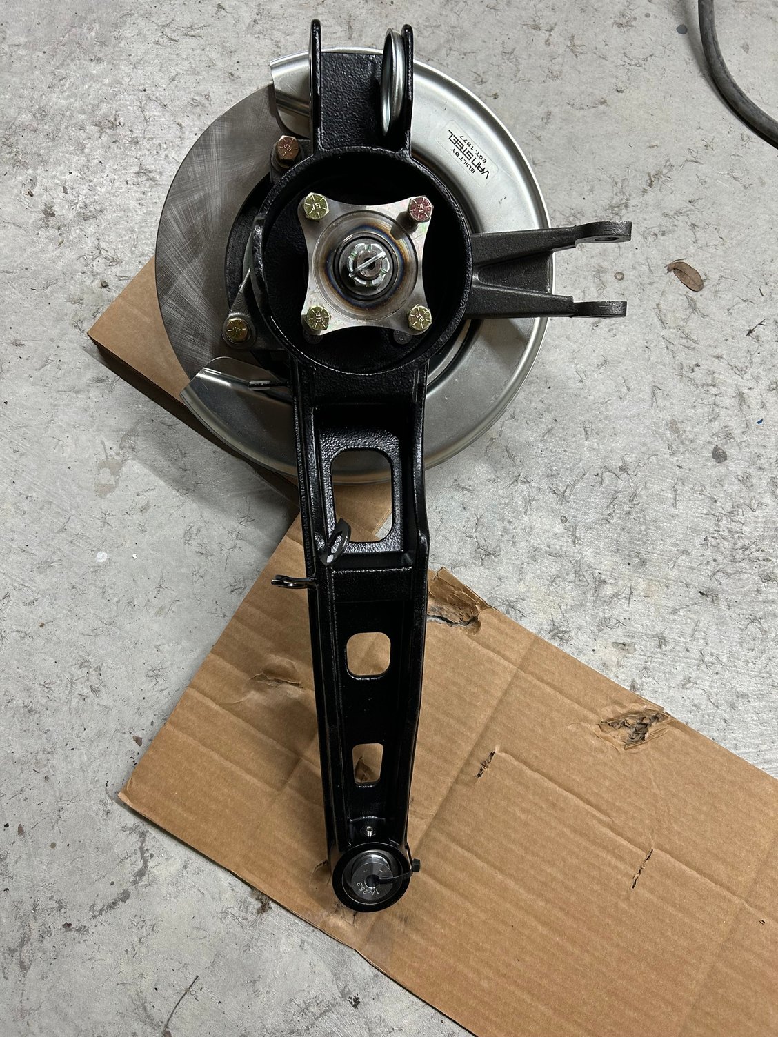

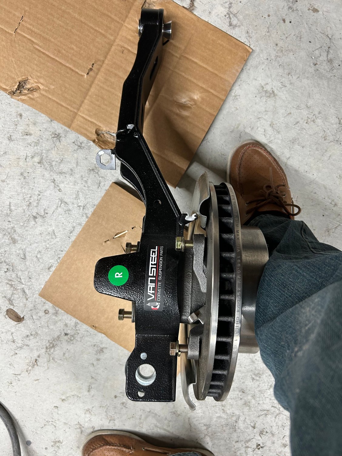

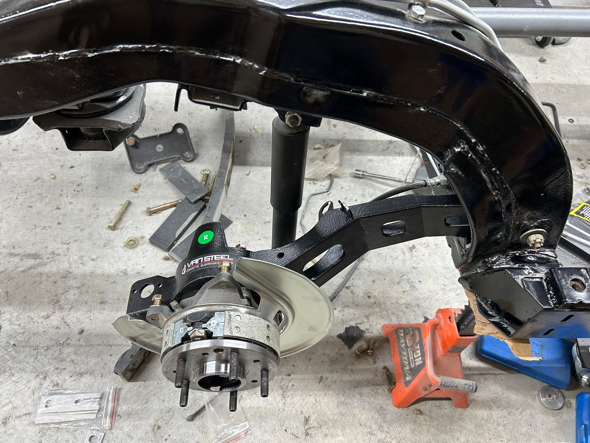

I got my rebuilt offset trailing arms in from Van Steel and they are gorgeous!
I had to put them on the chassis and start getting them shimmed:

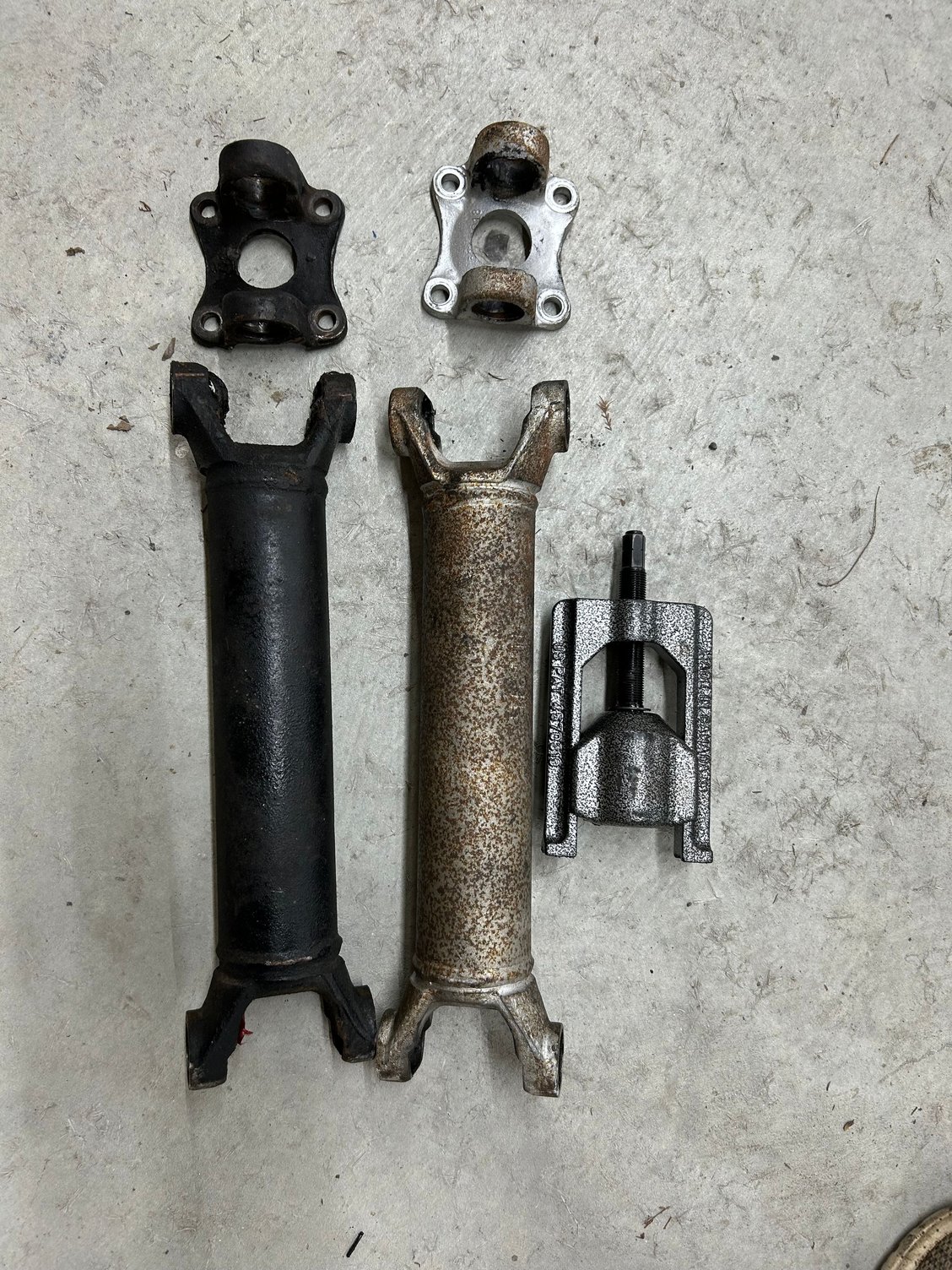

There's a couple of parts (half shafts an shock mount studs) that I had rattled canned and they already rusted from the Louisiana humidity! So I'm going to sandblast and properly paint these parts then finish off my chassis. I did pick up the U Joint tool that RescueRogers recommened and I'm a big fan for breaking down the half shafts!
