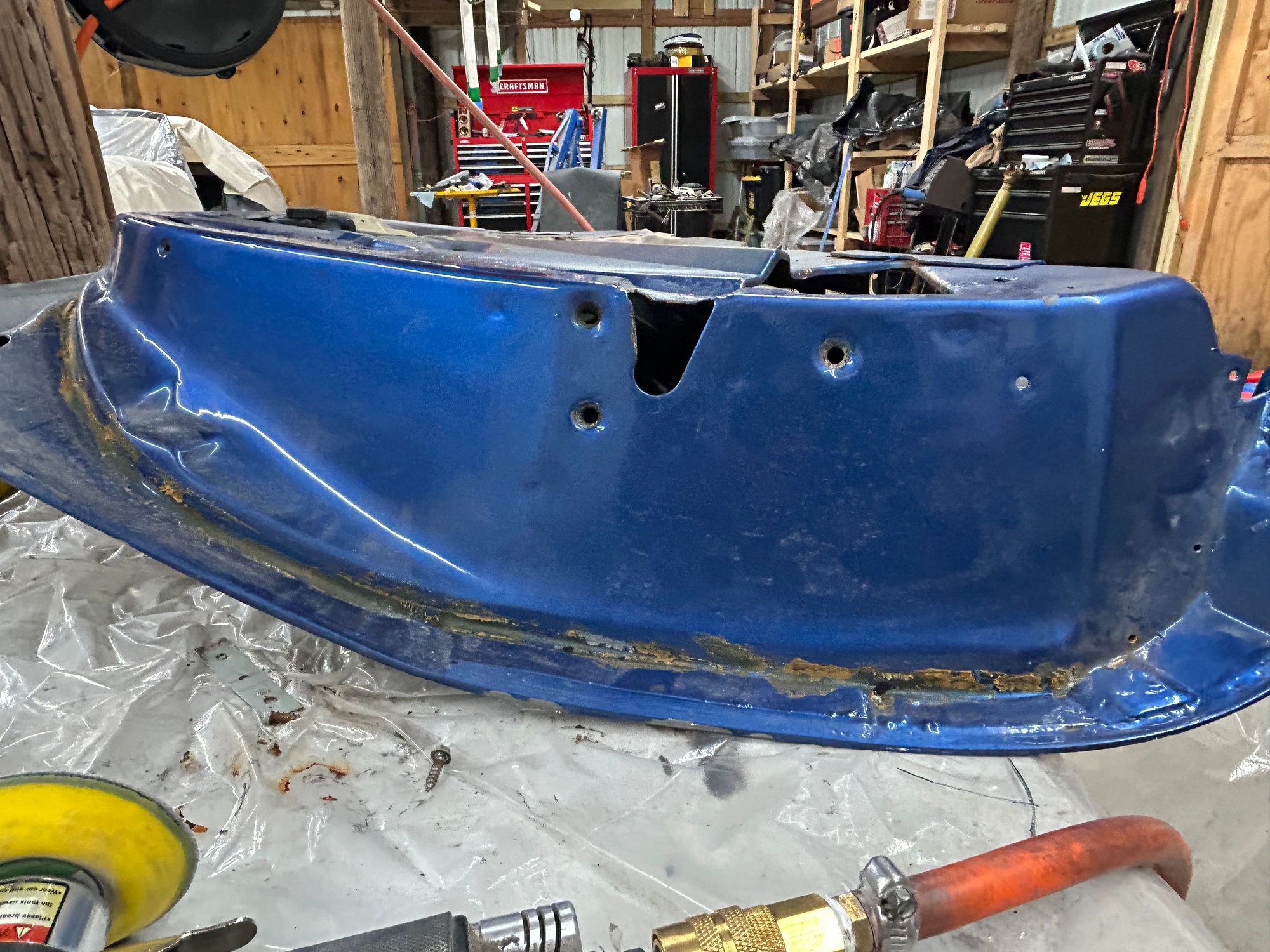

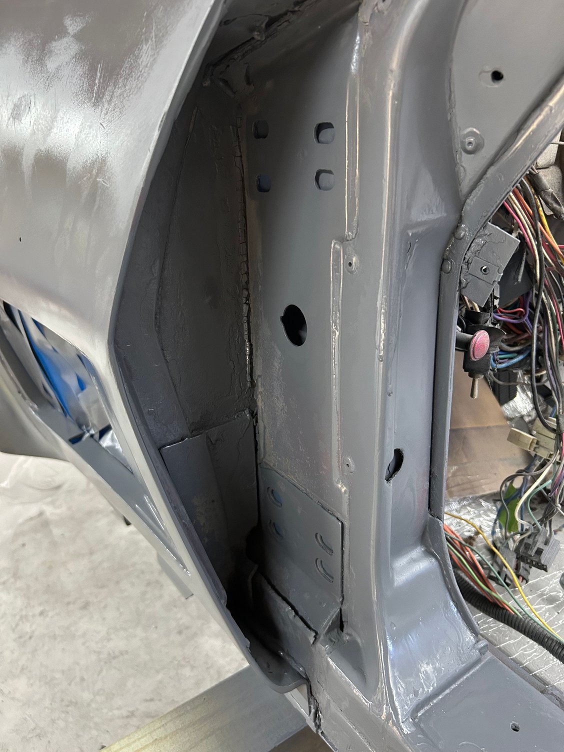

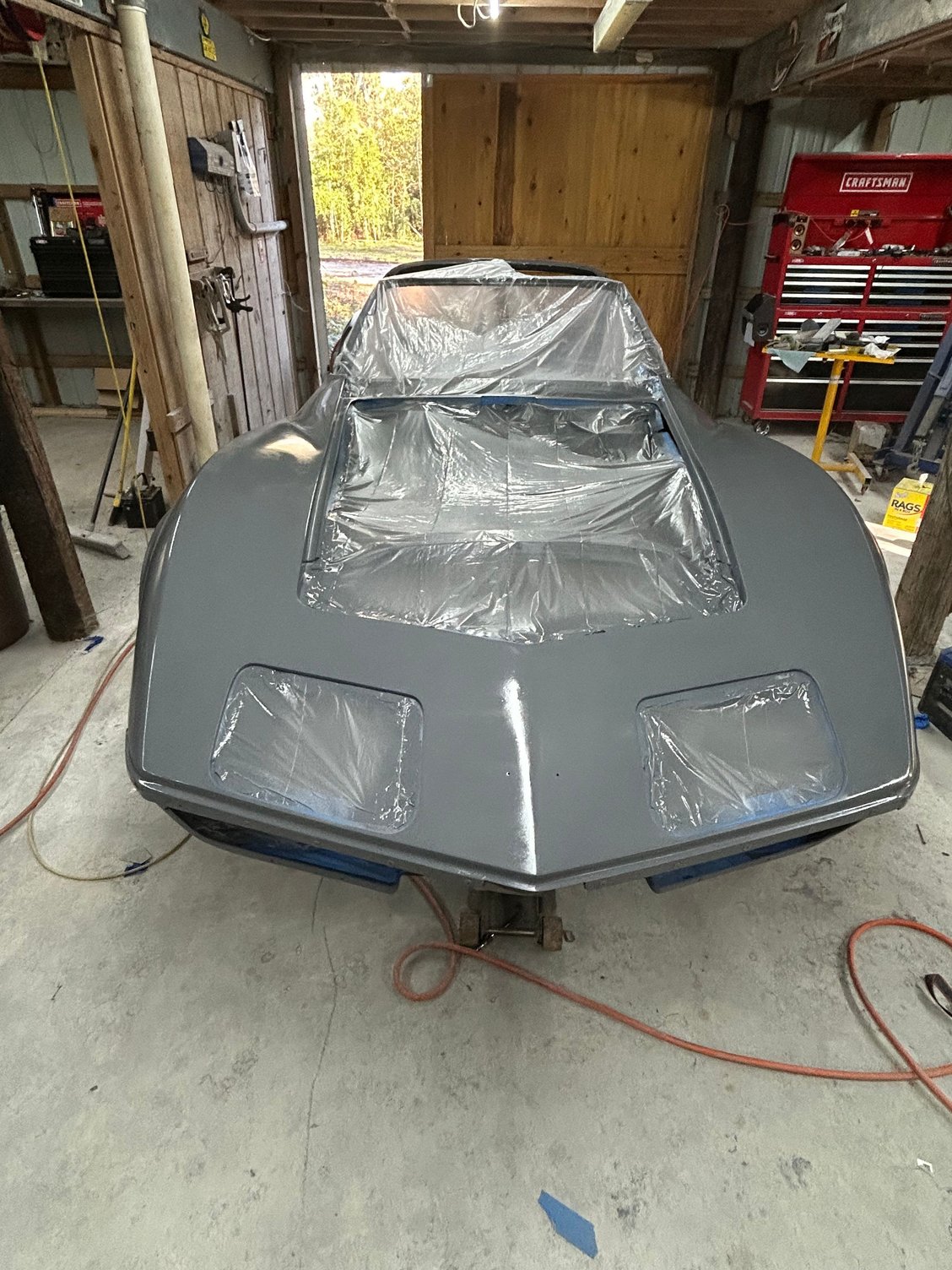

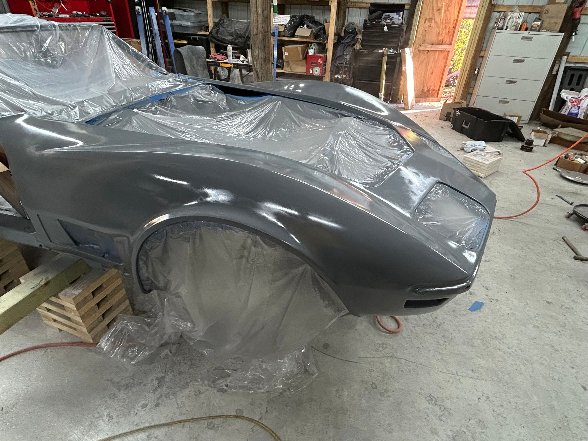

I was fighting off pneumonia recently, but as I got better I would get in the shop and finish up the fine sanding and body work on the C3. I was able to get in Christmas Eve to tape it all off, do second cleaning of the body, then put down two layers of epoxy primer on the body:
Then spray time:

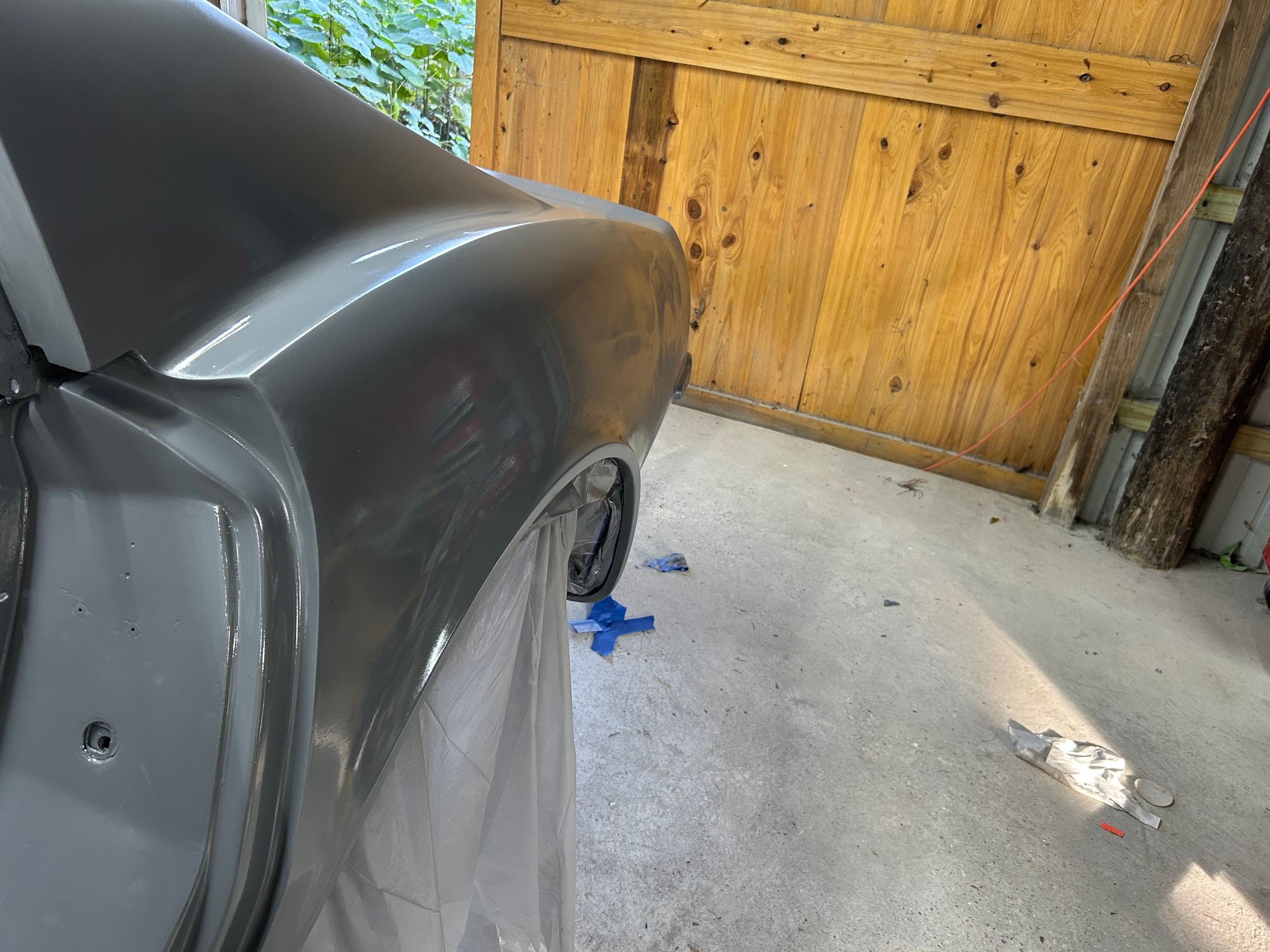

Thanks! It feels like a big accomplishment to get it all one color and the body work completed!!

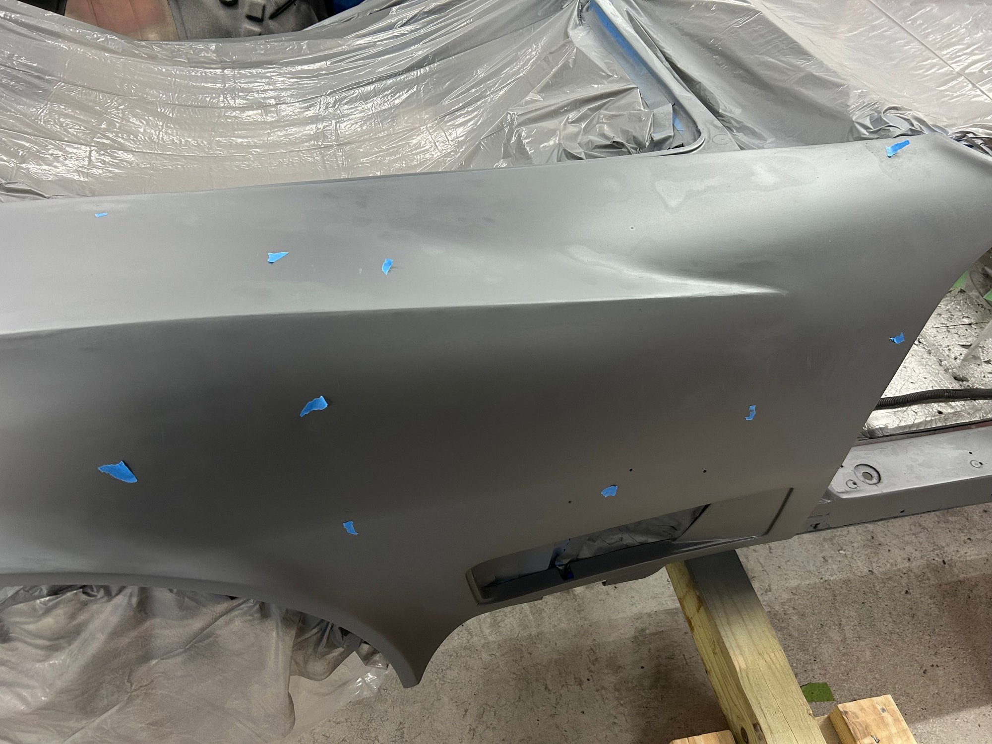

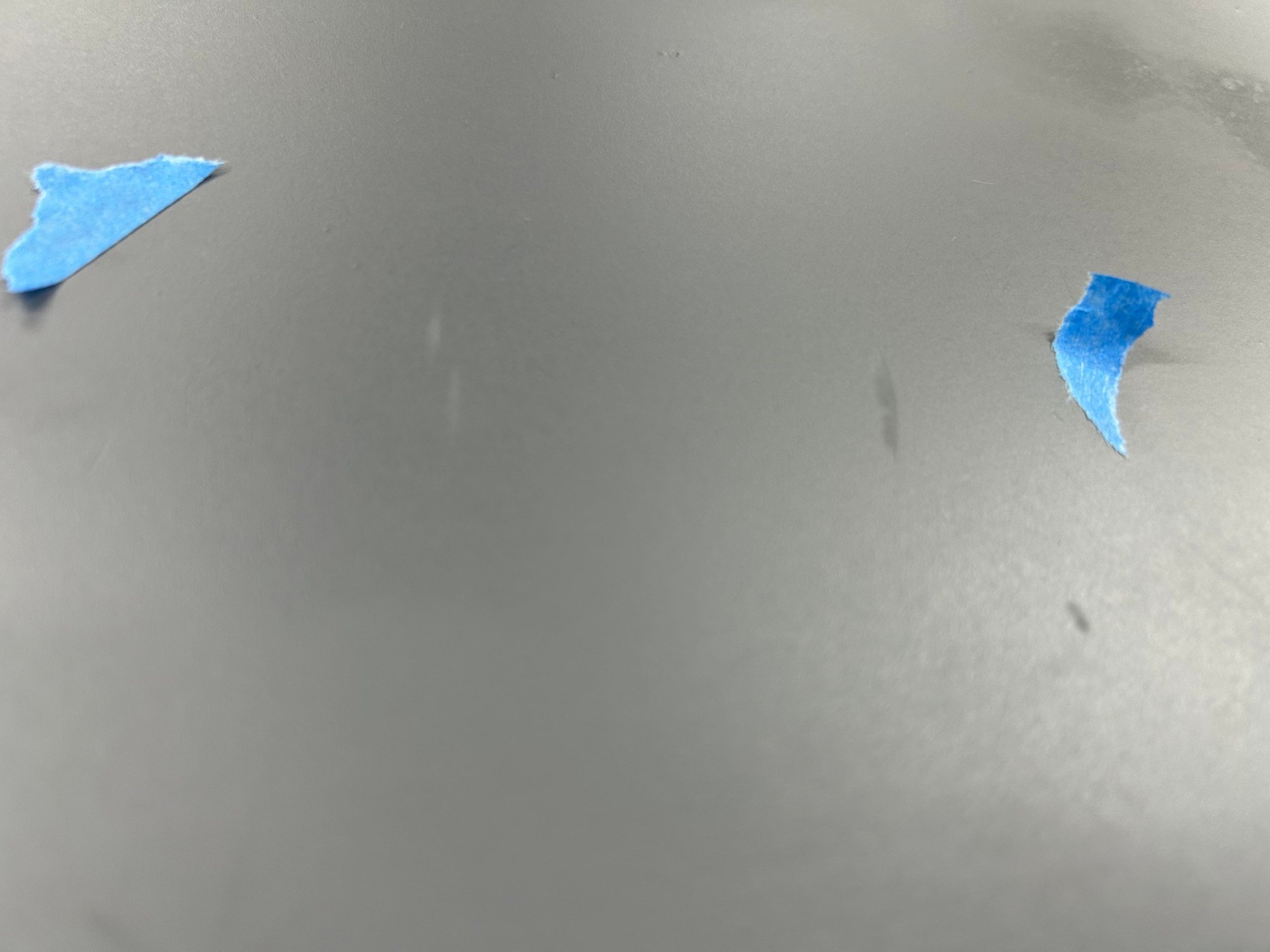

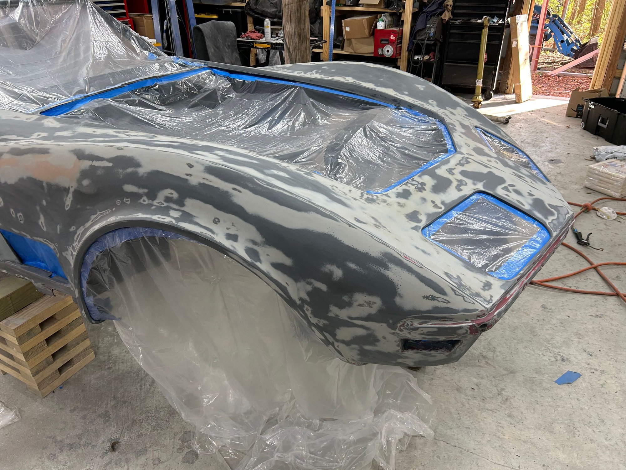

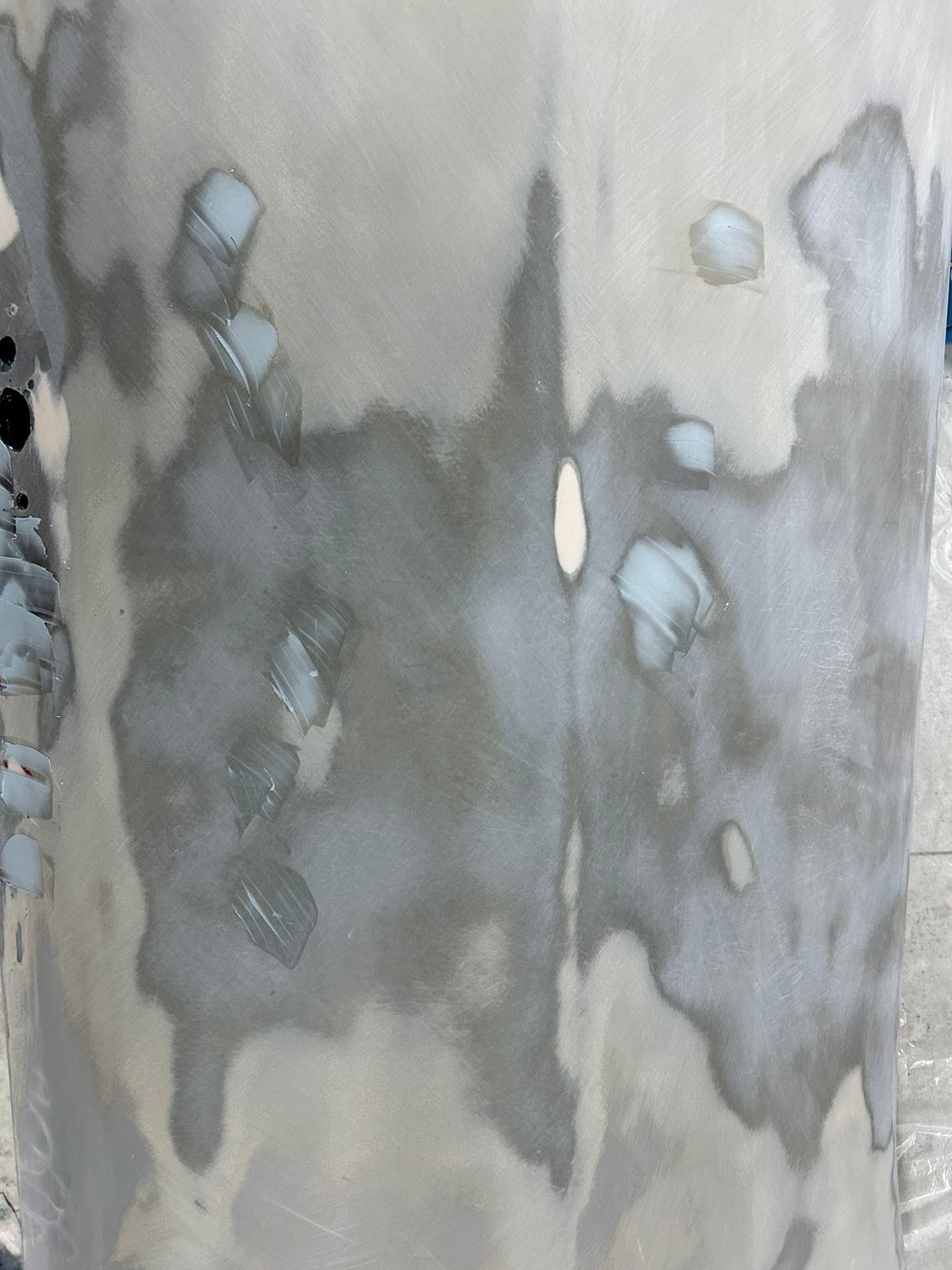

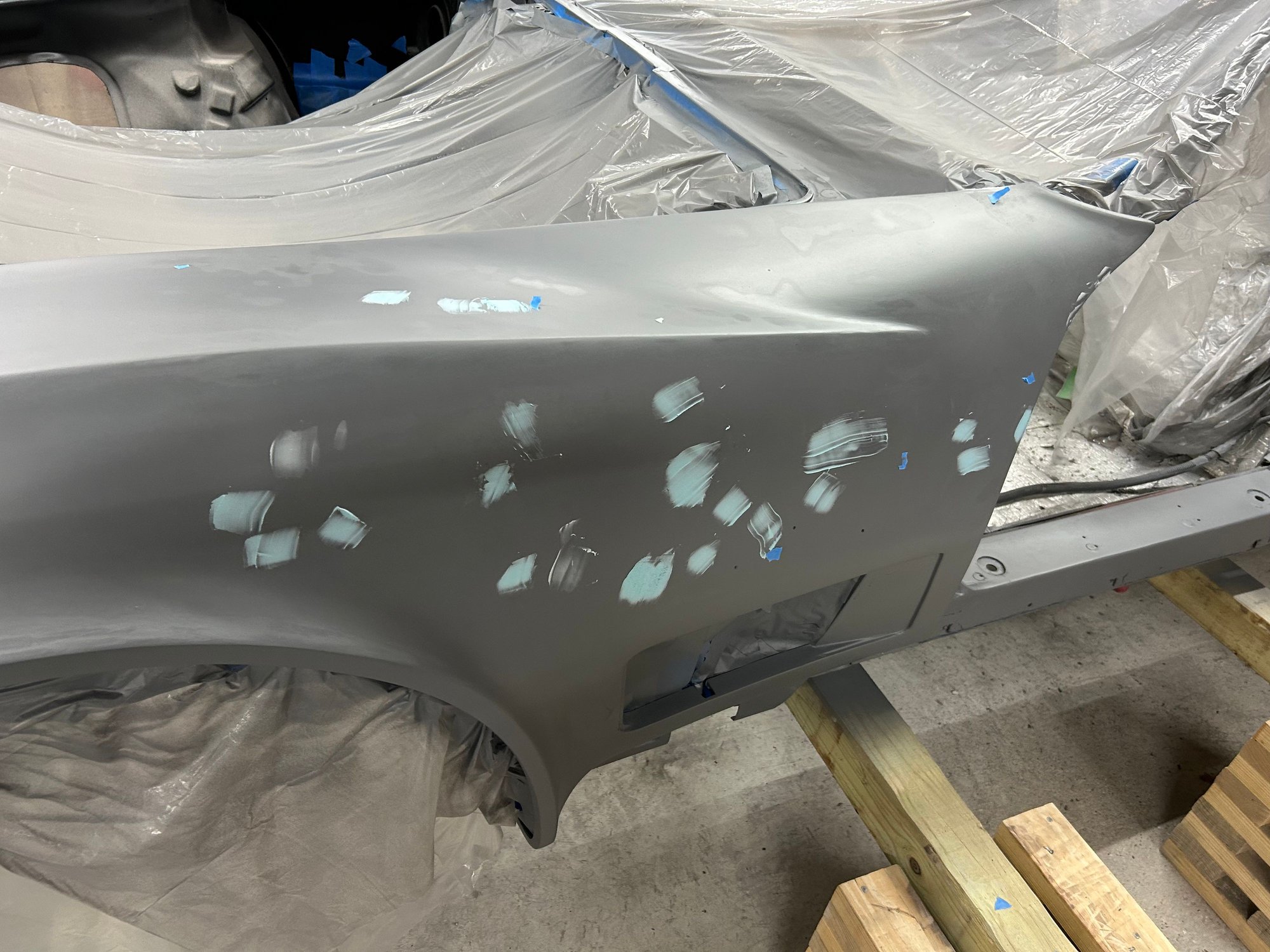

when the primer was curing I noticed a lot of little spots, especially on the front clip that would need to be fixed. Once the primer cured, I went around the car and marked all the spots with masking tape, so i could then go back and fill them with glazing putty and block the primer down with 220 then 320:
So my intent here is to do all spot work and glazing putty fixes on top the epoxy, then come back with the 2K urethane primer and start the final blocking of the body. Now that the body is sealed with epoxy, I don't have to worry about moisture and containmanents eithers. I may leave it as is and get the chassis back under it so I can check/work my gaps and get the doors and hood in primer as well. Any thoughts on this work flow ?

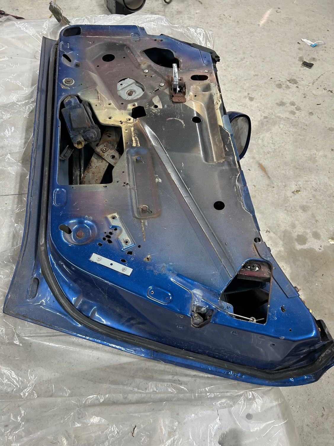

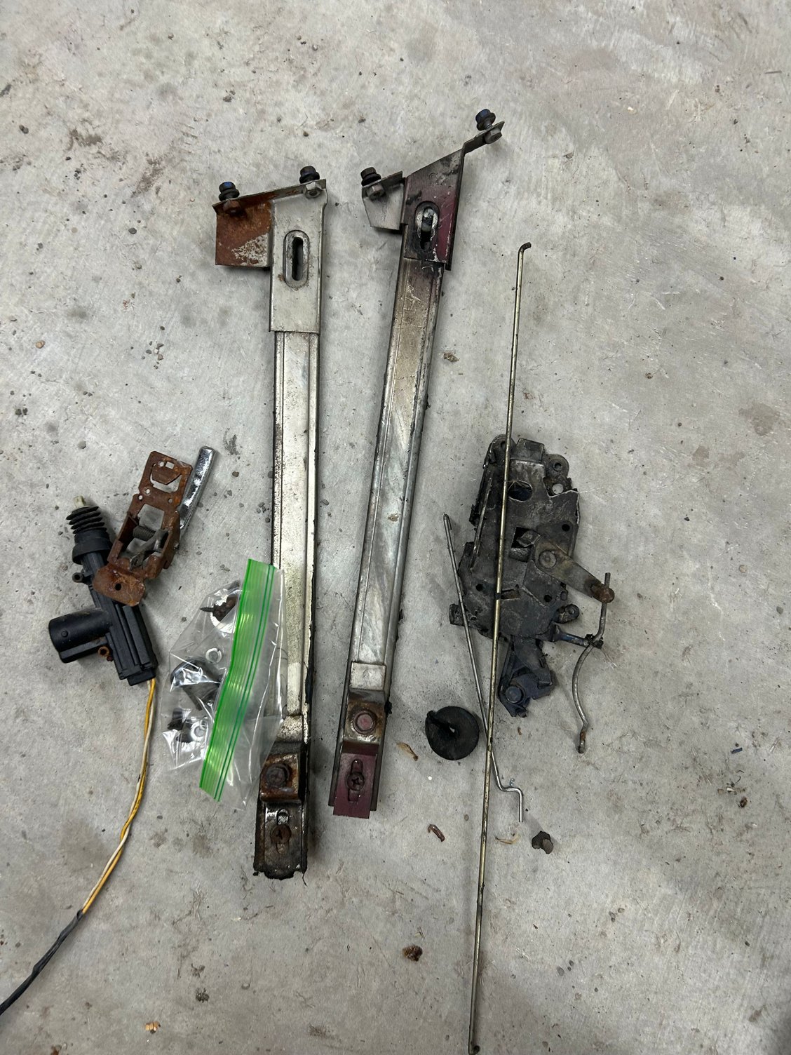

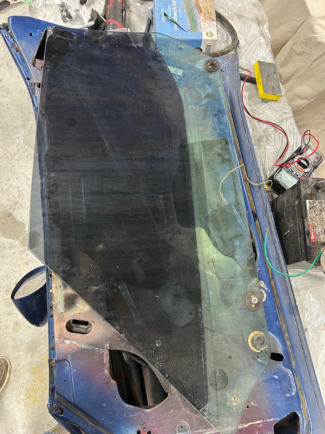

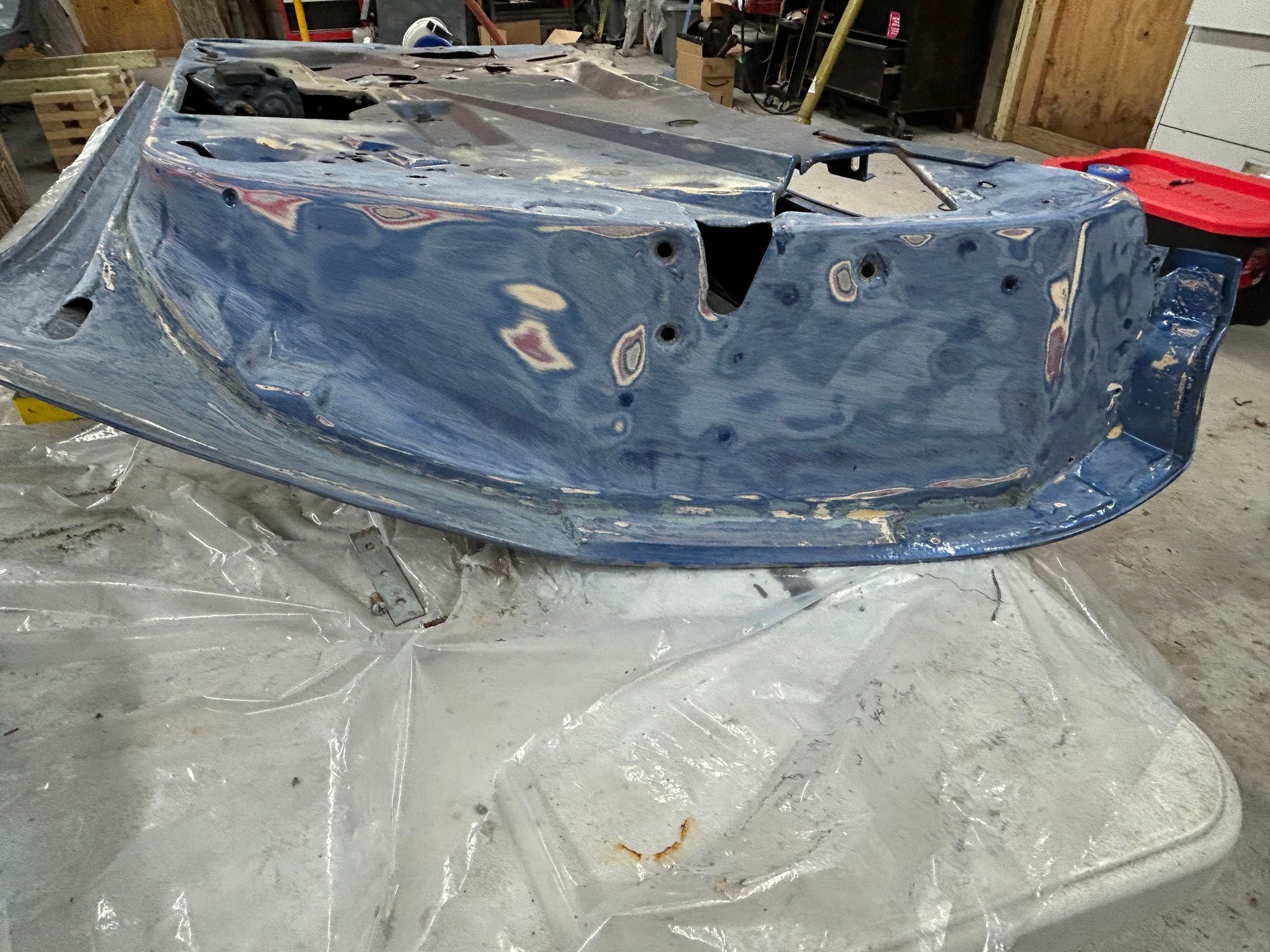

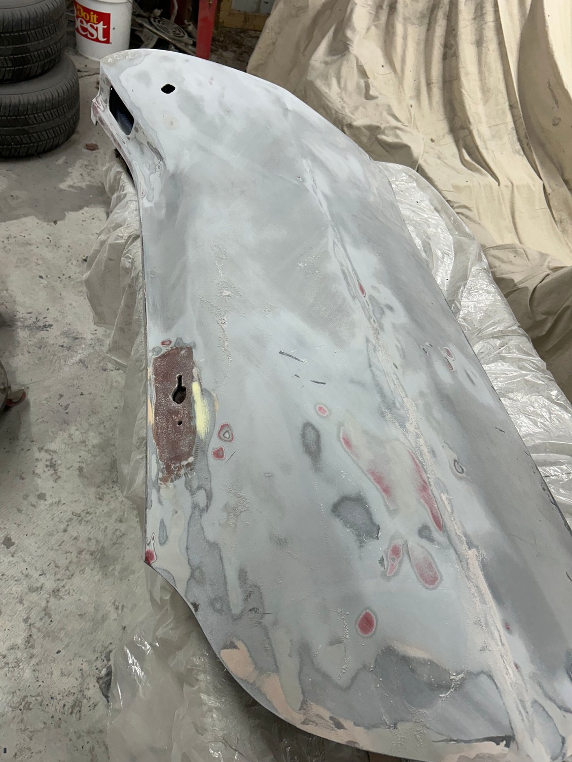

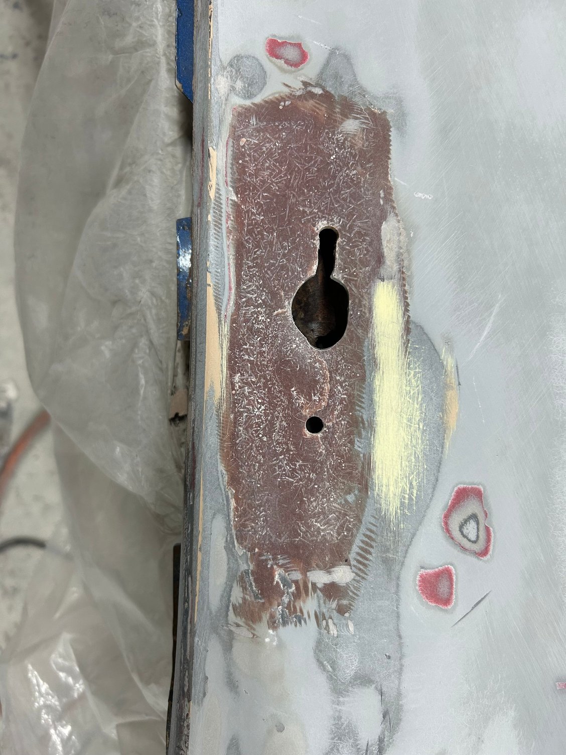

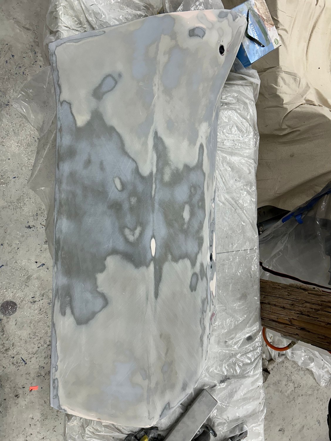

The next piece of the puzzle was the doors. I had managed to remove 95% of the paint from them while they were on the car, but now needed to be fully dissassembled and fully sanded and prepared for primer.
I first removed the windows, tracks, latches, handles, and key tumblers from the doors . Then I tackled getting the sport mirrors that were hacked on the '71 doors by bubba off. Also they had put the '80 door openers when they resto modded the '71 , so I have to convert back to the correct '71 hardware and door panels:
I then sanded down the insides of the doors and made quick work with my 3" DA sander, then came back with a tiny flex block and got all the little spots:
Here you can see what was left of the paint and the holes that were drilled into the car for the sport mirrors. I'm going to measure the mounts off my '69 to see what's needed to make them fit, some glass work seems to be needed here:
Then it was time to get all the paint off and block this panel down lazer straight. I used a heat gun and razor blades to get the rest of the paint off:
Blocked it dow​​​​​​​n with 120 then long then 180 - there w​​​​​​​as feather fill on the door which helped get the panel straight:
Finally, I used icing on the tiny nicks in the door and w​​​​​​​ill come back today with 220 then 320, and the door will be ready for primer!

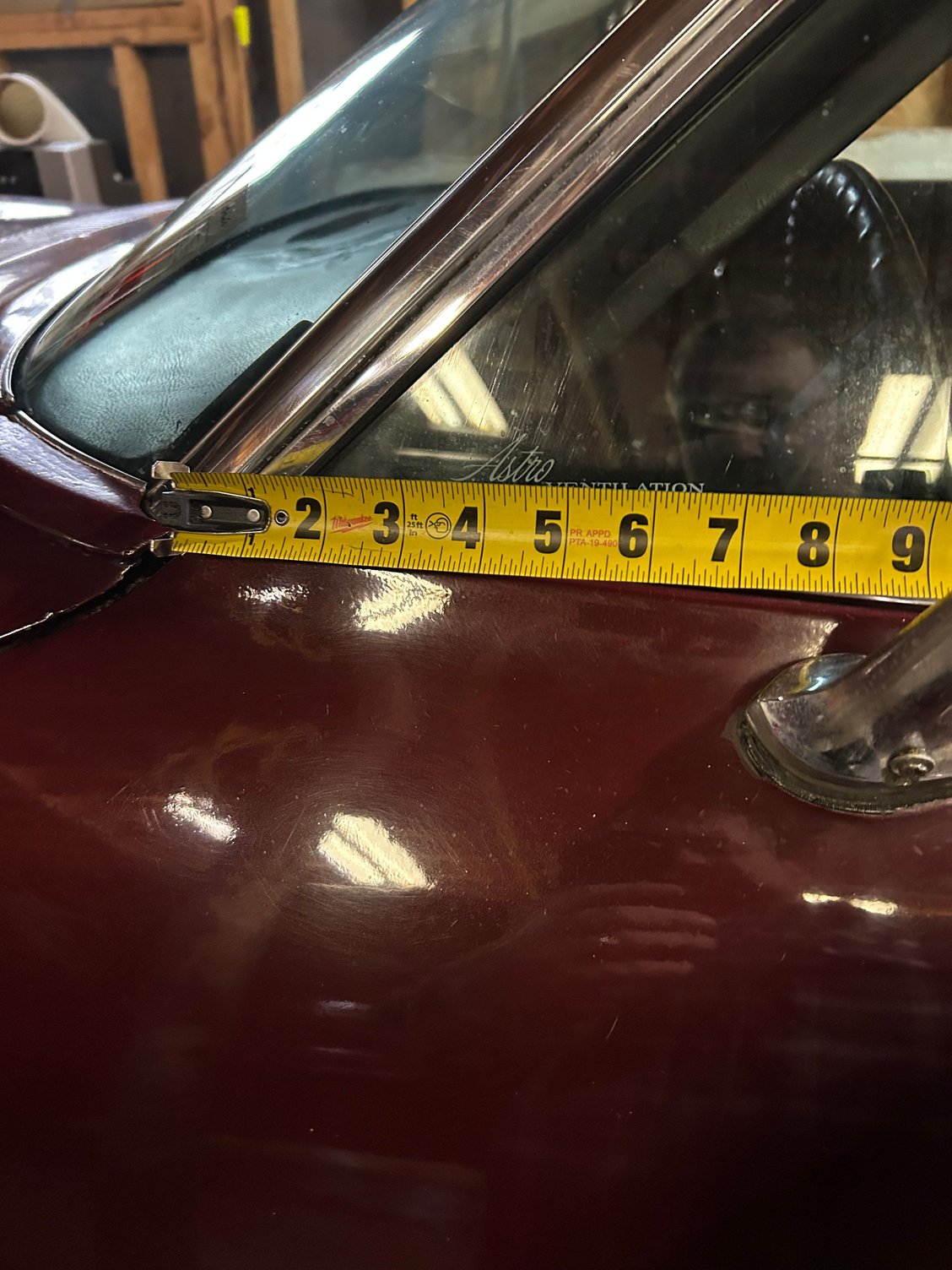

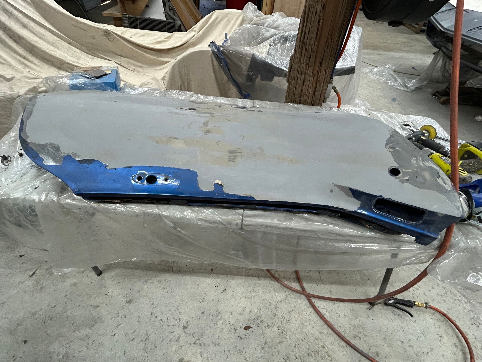

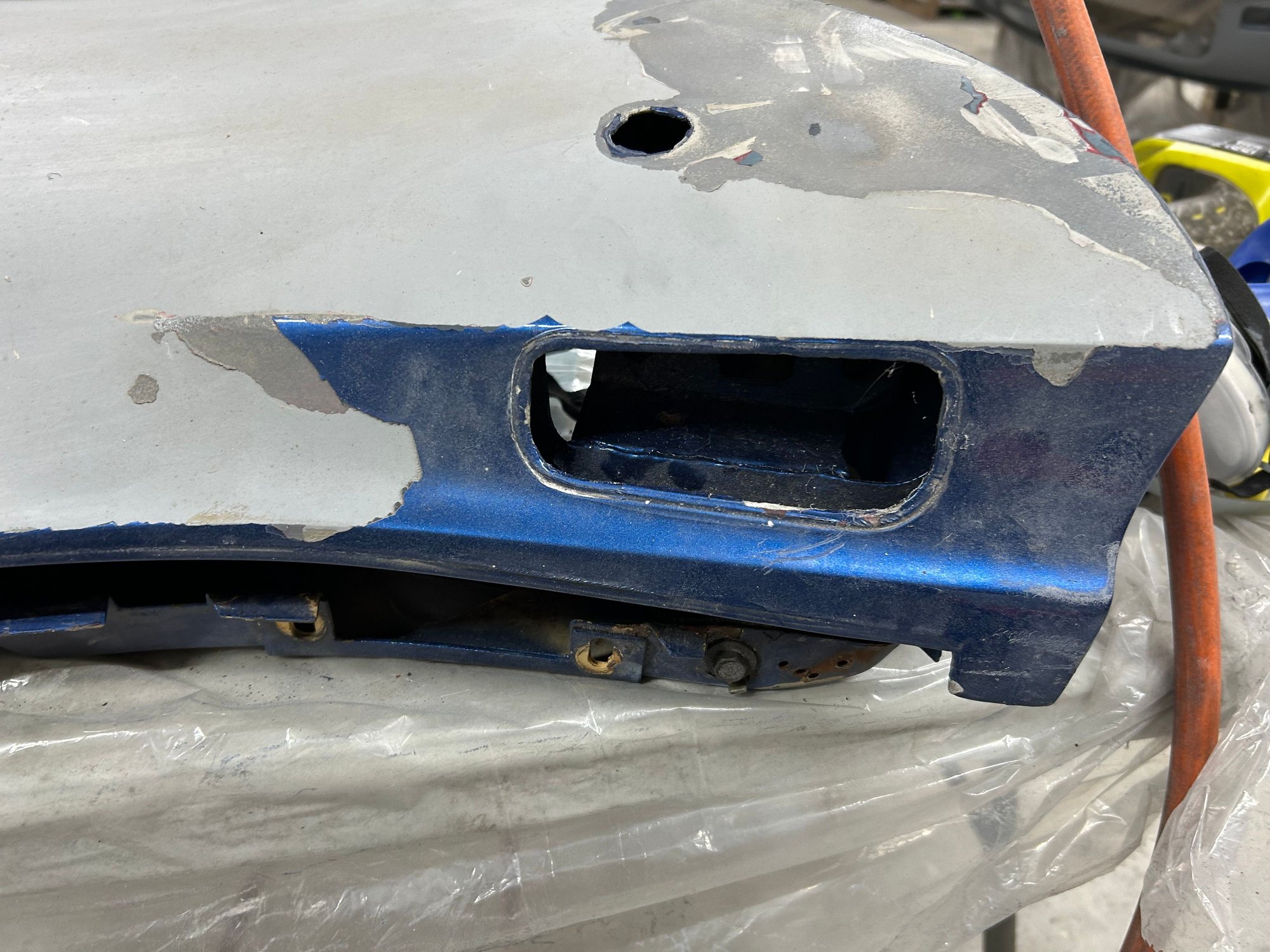

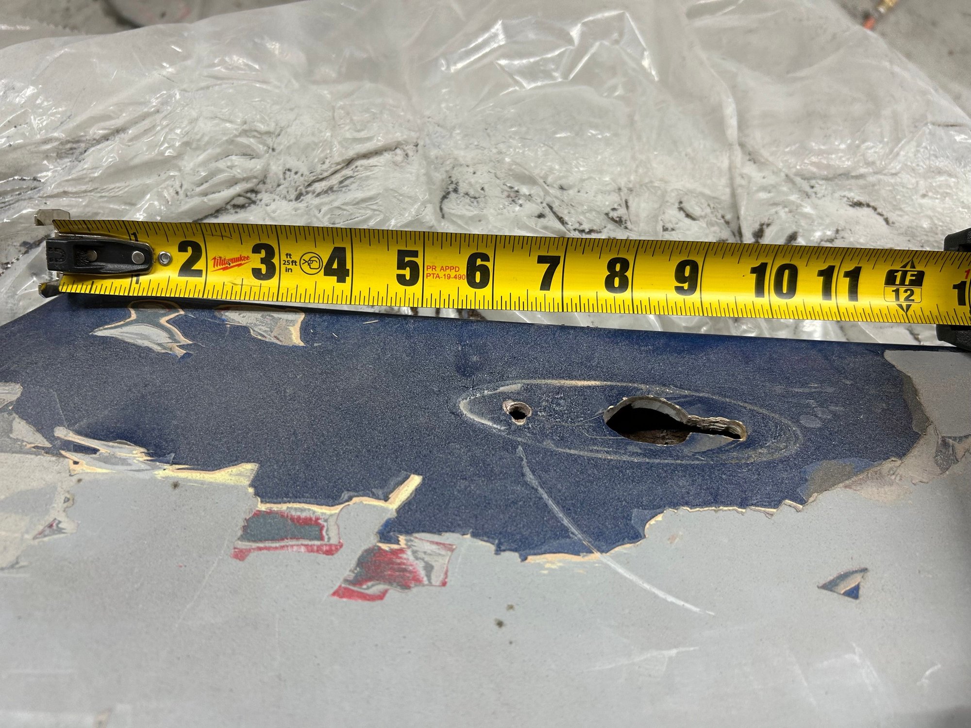

I got busy on the other door today and repeated the same process to get the whole door sanded down. I did find in this door that there was a crappy fiberglass repair and also measure the mirror holes and confirmed that none are usable and they're in the wrong spot when they hacked it up for the sport mirrors!
Took some measurements on the factory mirror on my '69 to compare to the doors on the '71
And it's in a different spot , so I'm going to have to fill these holes with fiberglass
Looks like this repair is Kitty Hair?
So i'm going to have to fill these holes in the door with fiberglass and drill new holes, which isn't a big deal. The problem is there isn't really access to the backside of those holes to sandwich the glass in. Any auggestions to strategy to to a robust fiberglass repair on those mirror holes?

Did some reading this evening to get some strategy together to fix those sport mirror holes in the door. I like the approach this guy does:

DUB (RIP) had a really cool way to get a backing plate in that inaccessible place to attach the OEM outside mirror to.
I had to replace or install a backing plate on my 68 for the RH addition and the replace the missing LH.plate.
Once you get the backing plate in place, I would say you could lay in some glass although I did not have to lay in glass on my 68.
So, in short, maybe you can find DUB's post or I will look to see if I saved it. However, the summary is:
1. now this is for OEM mirrors, if you want sport mirrors, not sure how they attach. So you drill 3 holes in a row where you want the location. Front and rear hole match mirror base and middle hole? well in the middle.
2. make a backing plate (1/8 or 1/16 thick, you want to get a couple or three threads in the thickness) with 3 matching holes, and drill and tap all three, forgot the thread size for the OEM attaching screws.
3. Fish tape 2 wires through the closed box on the backside of the door to the opening on the rear door end.
4. Attach your 2 wires to the front and rear holes of your plate and attach a trailing wire or string (so you can pull all of these wires out the way you came when you are done). You need a knot or something to enable you to pull the wires out the holes in the door and drag your new plate into position.,
5. When you get the plate pulled in to position, install a screw in the middle hole to hold the plate in place making sure your front and rear holes are lined up for the later install of the mirror base.
6. When you get the new plate held in position with the middle screw, pull on your trailing wires/string back out the opening in the box at the rear and allow you fishtaped positioning wires to feed into the door and out the opening following the trailing wires/string out too.
7. In your case I would wax screws and install in the front and rear holes and glass in the opening.
I do not know if your opening to be glassed in is in your desired location or not; does not look like it, right??. If in a separate location you could do this exercise to get a backer plate made from a left over piece of fiberglass in place for the glass repair. Or if the repair hole is in the middle where the above middle hole would be then you might have to do 4 holes, one outside of each mirror base hole.
Anyway you get the idea of fishtaping wires to position a backer.
Hope this helps!
(I suppose instead of a backing plate like GM did it you could also just use those expanding rubber cinch anchor nuts like you would use on a trolling motor bracket where you could not get to the backside to attach a nut under the bow??)
The video is pretty cool too. IHMO, getting a backing plate in place would get you better thickness while easier to maintain the outside curve, I think.

This is a great idea! I think I could use this and cover the big holes and only have one small hole to fill. Do you have any pics of this repair ? I want to get rid of those sport mirrors and put the correct chrome mirrors back on the car.
