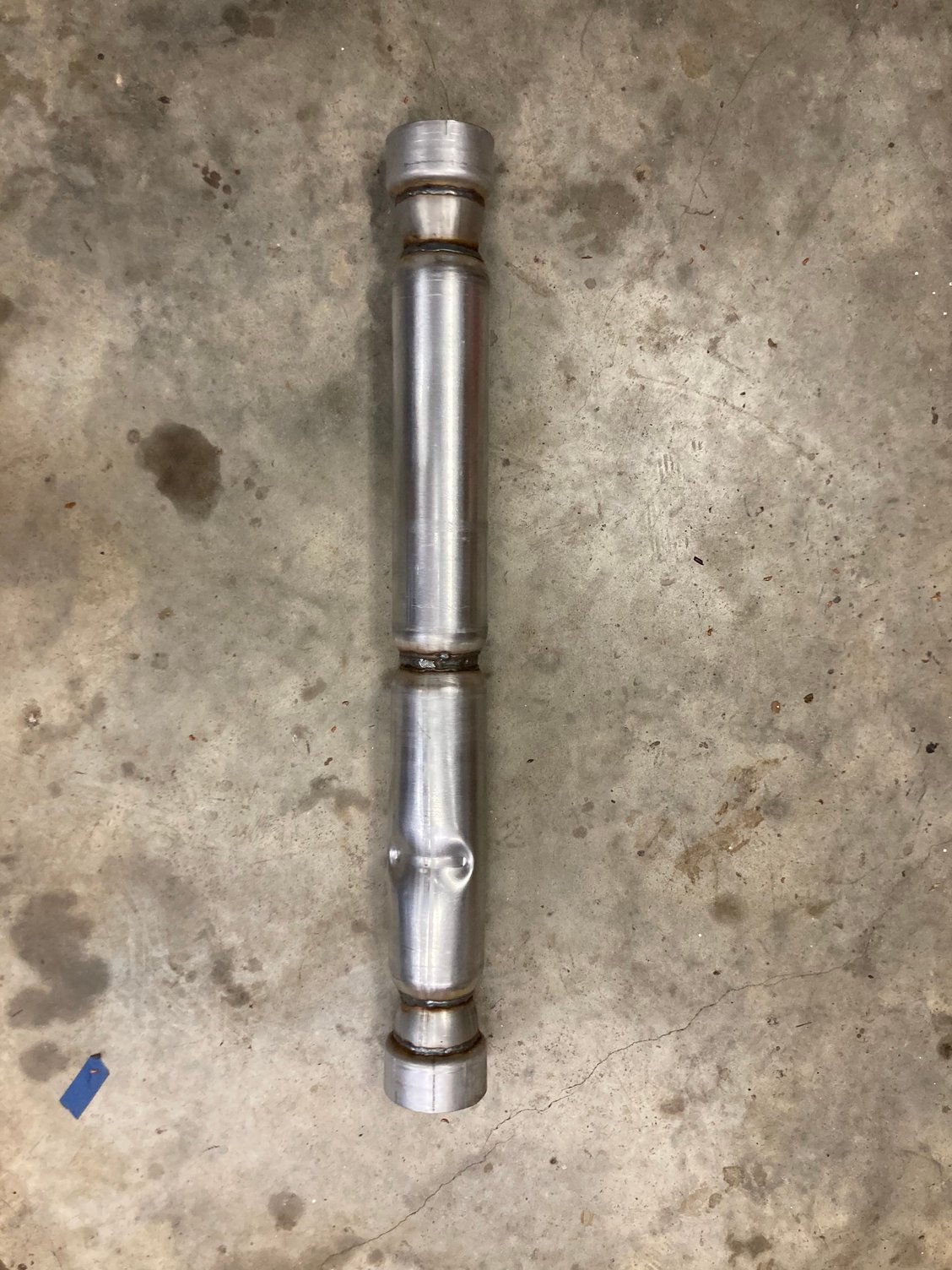

The other package I had come in was a set of Vette Packs from CCE for my side pipes. Yeah you guys were right: way too damn loud with open pipes! lol I loved the sound at idle, but couldn't cruise on the highway unless I wearing some earmuffs! lol Did some research and these were highly recommended. Called CCE, and the owner, Eric, picked up and was really helpful in helping me pick out the correct baffles for my sidepipes. He makes them per order, and is a small business, which I love to support a small business! These will be going on first this weekend, as they'll affect my tune, then it's Double Pumper time

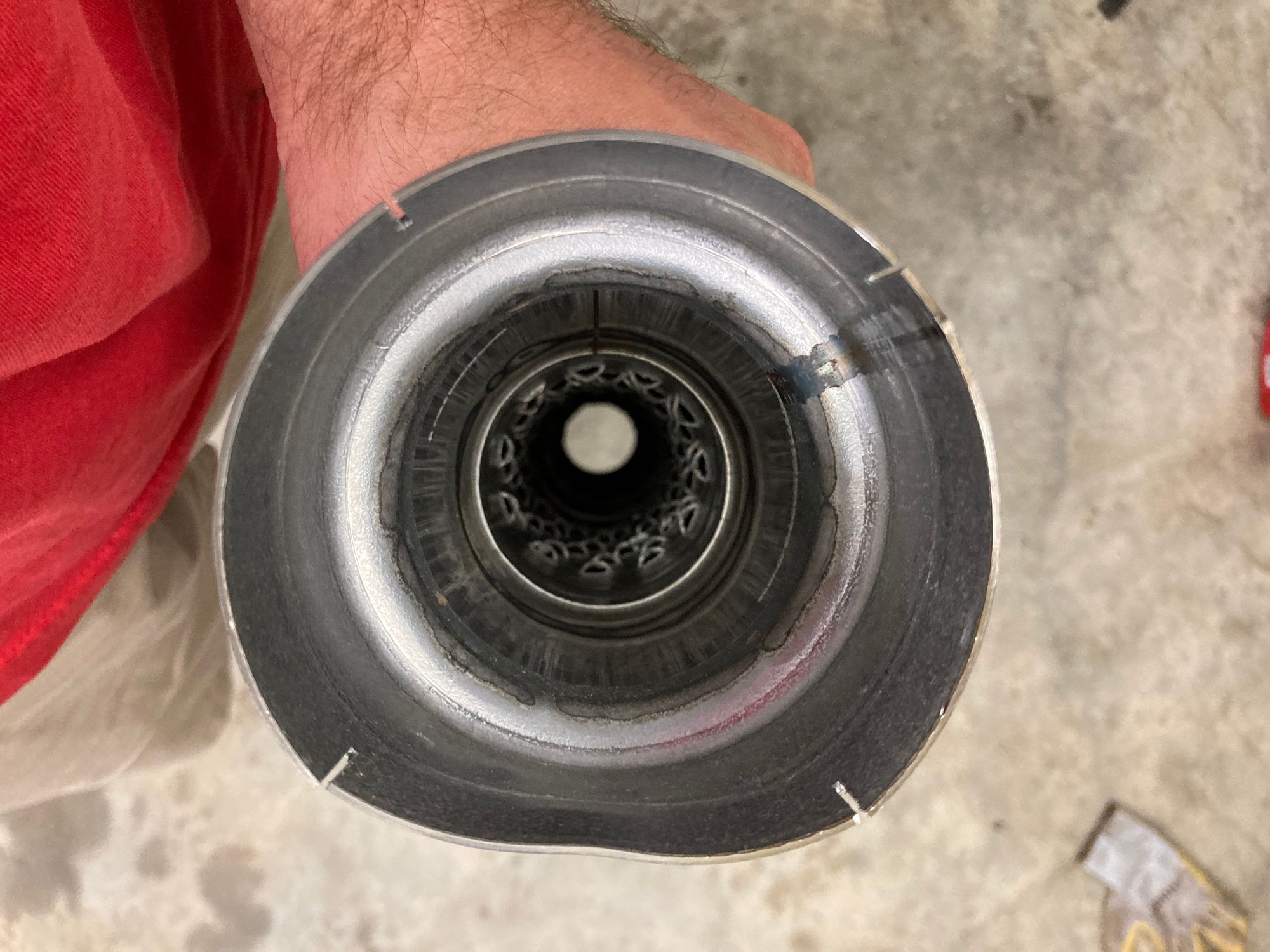

I had a chance tonight to put my Vette Packs in my side pipes, and installation was pretty simple: pull side pipe off, put baffle in , bend out ends until you get the desired tension, then bolt side pipe back on. The Vette Packs themselves were excellent quality, with nice welds done by Eric. These baffles consist of one chambered part and a glass pack. The result was a quieter idle - I miss the angry open pipe idle! But the tone of the pipes when I rev it sounds so much better! I now don't need ear muffs when cruising, and the old ladies on my street won't call the cops on my, so mission accomplished! I now have everything finally finished in order to put my Holley on, so I can start that project next this weekend!

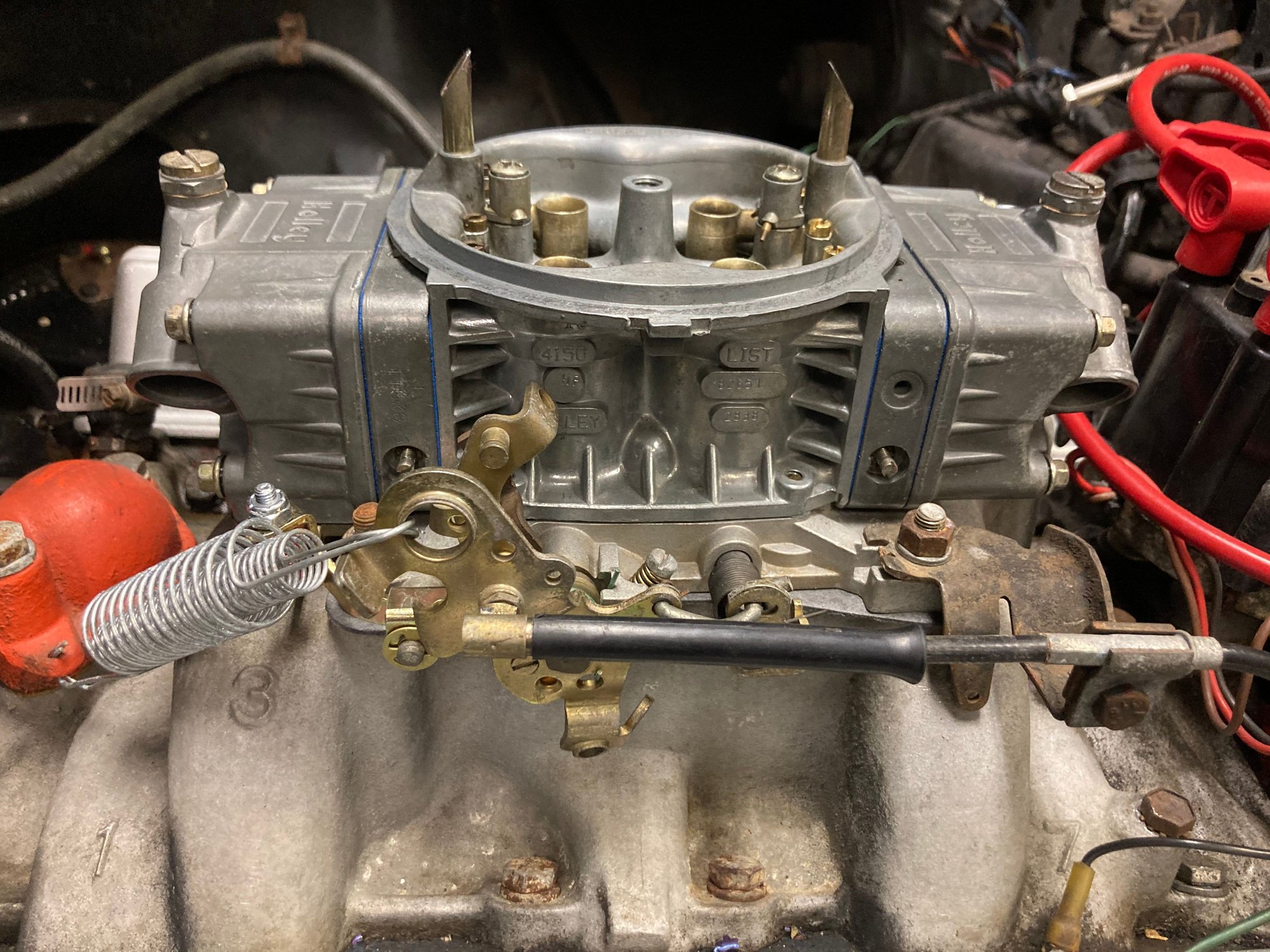

Got my Holley on this weekend and worked on dialing it in. Besides the idle mixtures, I was surprised how close this carb is with the factory tune! Had to turn the idle mixture screws in to close to half a turn, and damn they are sensitive at that point! but got my idle in the low 14's. Car cruises at 50MPH in the mid to low 13's , but when I get up to 65MPH it's in the low 12's. My assumption is the power valve is kicking in when I'm cruising at the higher RPM and enriching the mixture. I need to put a vacuum gauge on then verify. The primary accelerator pump is spot on with the orange cam. The secondary is too rich, I swapped the pink cam back in and it's still too rich, so I need to reduce my squirter size: It's currently a 31, should I go down to 29? What AFR are y'all targeting while cruising on the primaries? high 13's/low 14's is where i'd like to be and drop down to 12's with the PV.

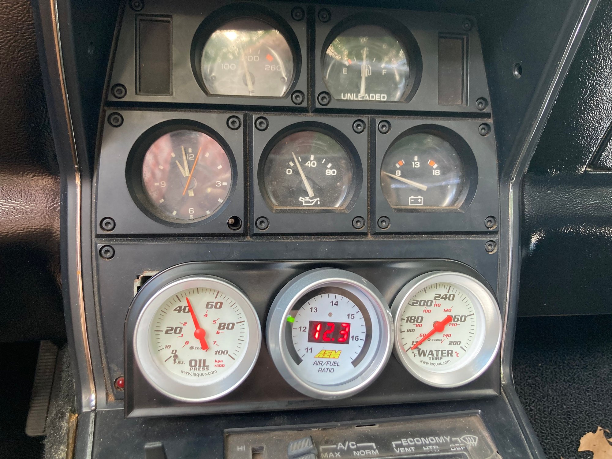

Here's a look at how the wideband helps: can see the AFR and paint a precise picture on what's going on with the carb. You can see when I floor it , it bogs down to the 10's , which indicates that my secondary accelerator pump has too rich of a shot.

YOu definitely should check and see what your power valve is and see what your vacuum is doing. I have mine around high 14 to mid 15 on a flat cruise. It gets to the high 15s and touches 16 on an incline as the power valve opens and it drops right down into the 13s. If I jump on mine it dives into the 10s, ITs a tripower so I have to change the plates to aftermarket ones that accept jets. You can look for a cam set that has a smaller ramp rate or drop to the 29s. They are easy to change so it isnt a big deal like the jets. Does it come back up after the bog? What does it do ion the highway under load when you floor it. It should act differently than just doing it in the driveway. DOnt forget you have mechanical secondairies which is just dumping fuel as soon as they open, so you could have some huge jets in there as well. I would check it on the highway and go from there
It does immediately come back up after the bog, it's definitely the secondary accel pump. When cruising down the highway at 65 it's in the high 11's, and when I tip in the throttle it doesn't change - which seems to me like the PV is open in cruise. It's currently the 6.5 PV, so I need to take a vacuum reading and go up a couple of sizes. the WOT AFR is great - low 13/high12. I likely need to go up a few sizes on the PV, and maybe down a little on the primary jets. But the starting point isn't far off!

The power vavle woupld be going down as well. YOur vacuum is highest at cruise so if a 6.5 is openning you probably arent to far above 10 inches at cruise. I would look for a 5.5 or a 4.5 and tune from there. Once you get out of the power valve if you are still in the low 14s at idle and thats your best go one size smaller in your jets and you should see the idle AFR come up. If its still rich we can talk about your idle versus transition circuits an dhow your throttle screw settings affect that

Okay, got a vacuum gauge in and double checked my timing. Here's where I currently sit:
16 base timing, 34 all in by 3K.
idle vacuum is 12in/hg at 850RPM with 13.5 AFR
45 MPH at 2000 RPM = 15in/hg with 13 AFR
65 MPH at 3000 RPM = 20in/hg with 11.8 AFR
I'm certain I need to drop from a 69 primary down to a 67. Think this rules out my 6.5 PV opening at cruise too with the 15 - 20in/hg.

Correct, your main jets are just too big. After you change them you may have to readjust your idle circuit screws as well. Right down all your references that you told us about and change one thing at a time. Keep good records so you can go backwards of things go too lean

Got some parts in and made some adjustments today: Went from a 69 primary to a 67, it's getting closer but I still want to take a little more fuel out. Should I drop down to a 65 primary from here?
45 MPH at 2000 RPM = 13.6 AFR
65 MPH at 3000 RPM = 13 AFR
I also reduced the secondary squirter from a 31 to 29: still got a rich bog on my initial hit. What should my next adjustment be?
