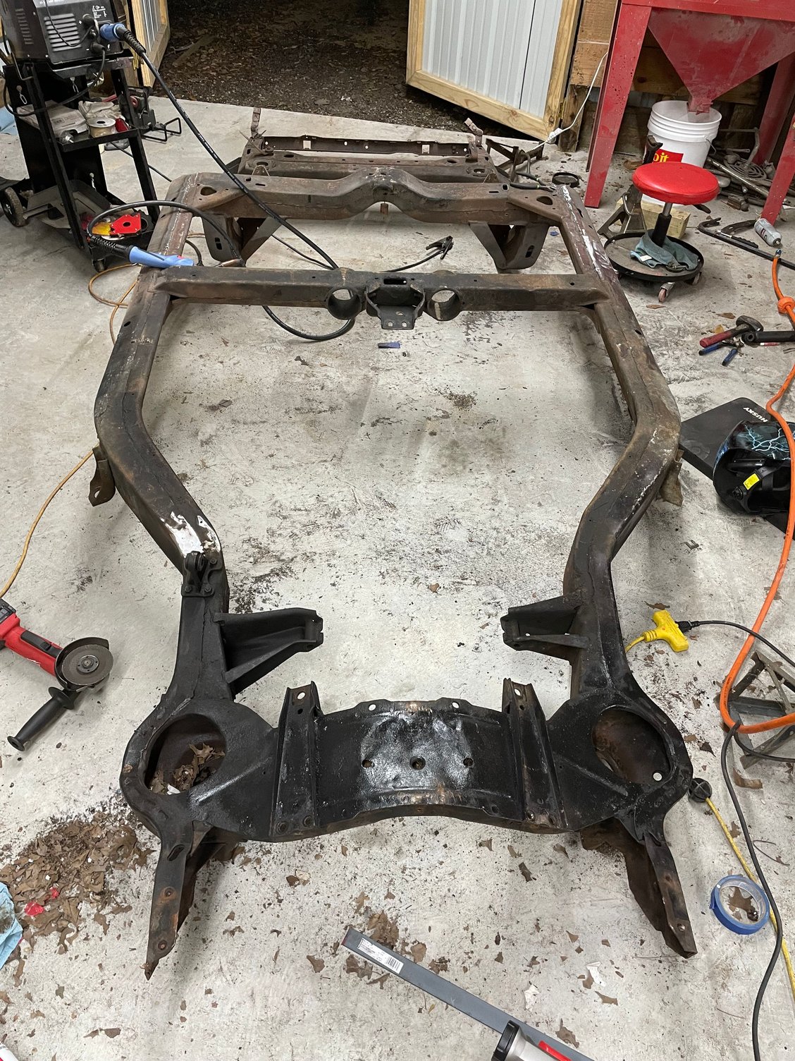

I'm doing this right now, and have been spending a lot of time welding on the frame. Cut out rotted end rails, welded in new ones, new end caps, then filled every hole on the frame, and smoothed and grinded it out. Replacing all fuel and brake lines. New fuel tank. Trailing arms and front suspension already redone. Sandblasting and powder coating next week, then time to put back together! Also I'm pulling that dent out the cross member, and have been reinforcing the sway bar mounts! You'll find plenty to do , and plenty to spend money on!! lol

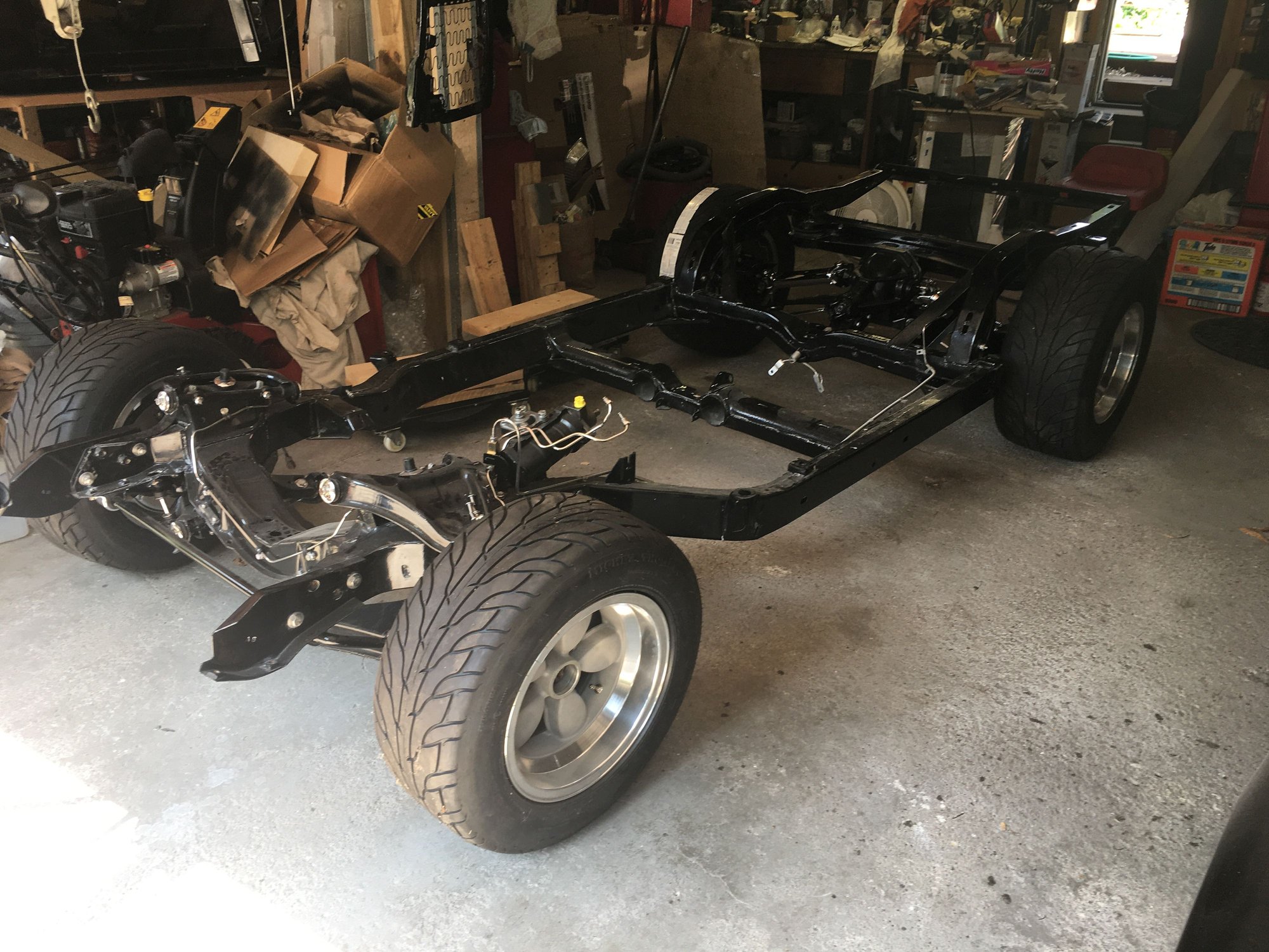

The below frame was sand blasted (outsourced @ $150) and I painted it with PPG DP90LF in my side yard while hanging from an engine hoist.

I did all the above 35 years ago and this is what it looks like today.
How are you getting that dent out ?? It is bothering me as well

There’s a thread called free dent removal tool, or something close to that, where people lend out a tool that gets that dent out. I believe it’s in the general section. If not that, you could buy the tool that’s made to remove that dent.
