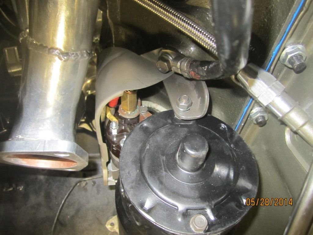

Were the bolts loose?
Do you use a torque wrench?
Did the engine originally use a brace and you no longer have one?
Starter Brace

You can buy one for $14 plus shipping. I gave you the link above.
Here it is again.
https://www.zip-corvette.com/66-74-4...unt-brace.html

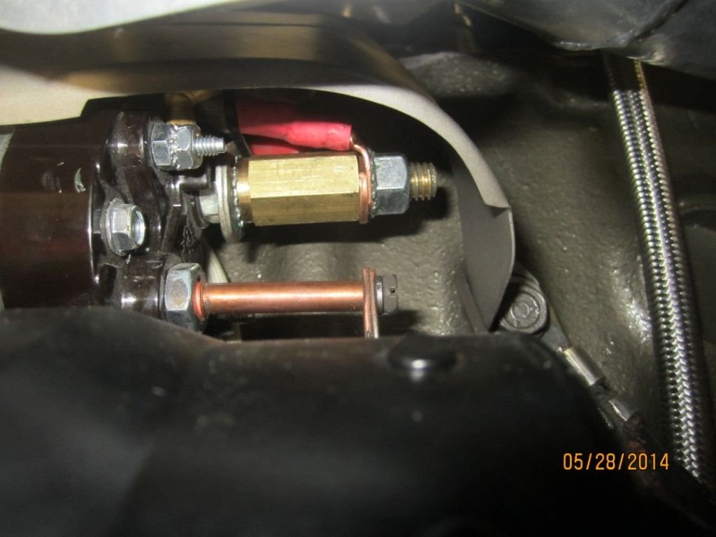

We need to figure out which starter you have. GM made two different kinds, one for small blocks and the other for big blocks. A big block capable GM starter will have a copper spacer sleeve between the solenoid motor terminal and the motor contact that comes out of the motor housing through a river grommet. Small block starters bolt the motor contact directly to the solenoid motor terminal. This is because the motor housing on BB starters is longer.

Starter Brace
Extended connection with the longer starter

Thanks, Mooser! Try to get a correct rebuilt starter at the local parts store and they think you're crazy. You can ipen a dozen of em and they're the short case starter.

The starter brace can only be used if you are using a starter that is the same size as the factory starter. a lot of mini starters would be too short for that brace.
Pat
