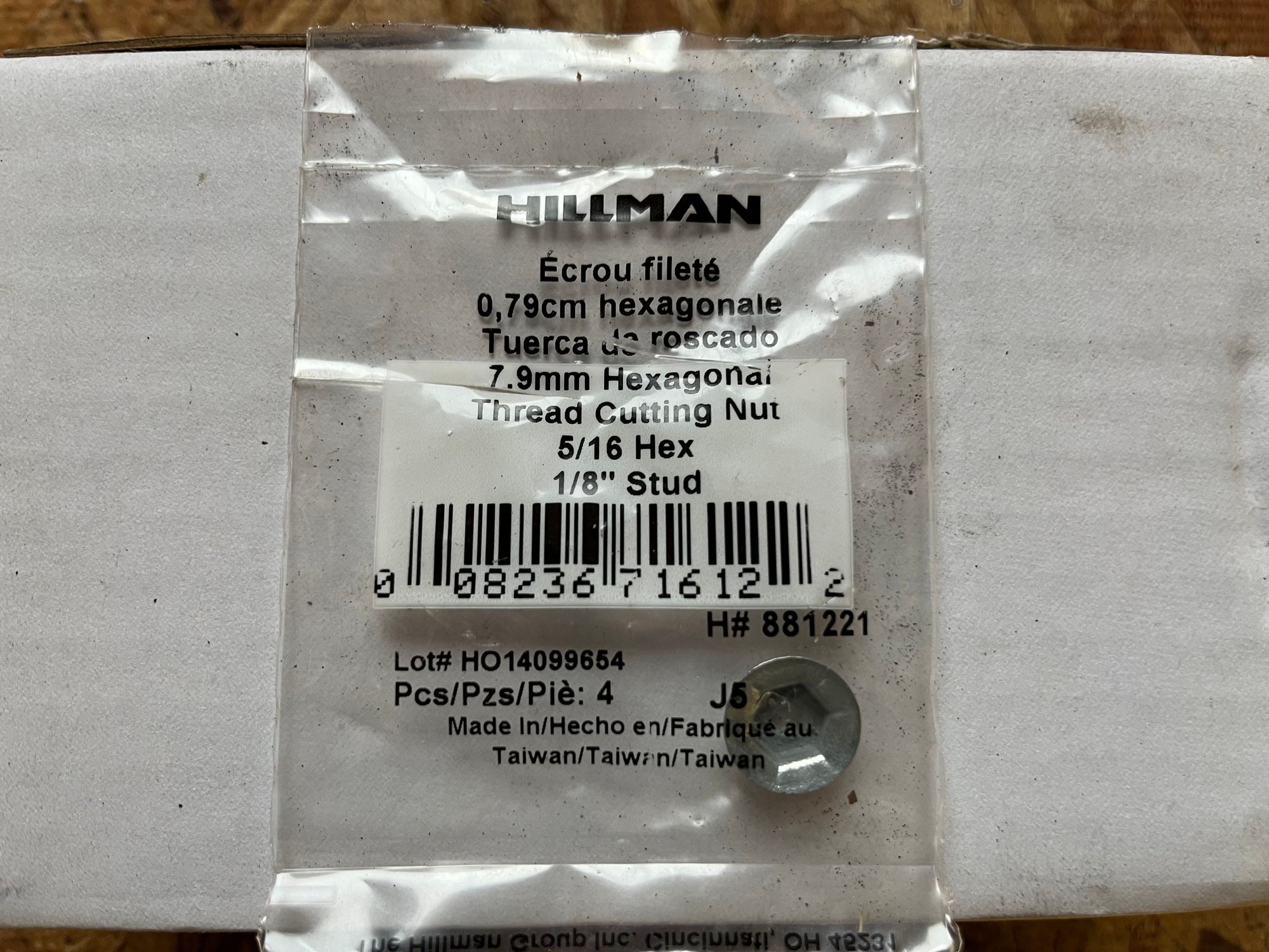

Just a note maybe will help someone. These little guys work perfect for screwing onto the posts in the side Stingray emblem on early C3’s.
I lost (or someone stole) mine last year so I wanted something better than the adhesive.
The rear post is pretty much inaccessible, but 3 is more than enough to secure it.

Speed nuts work fine for that purpose. But I also put some clear Gorilla emblem tape under the emblem....just so it won't rub the paint from vibration AND the absolute confidence that it will NEVER fall off.
