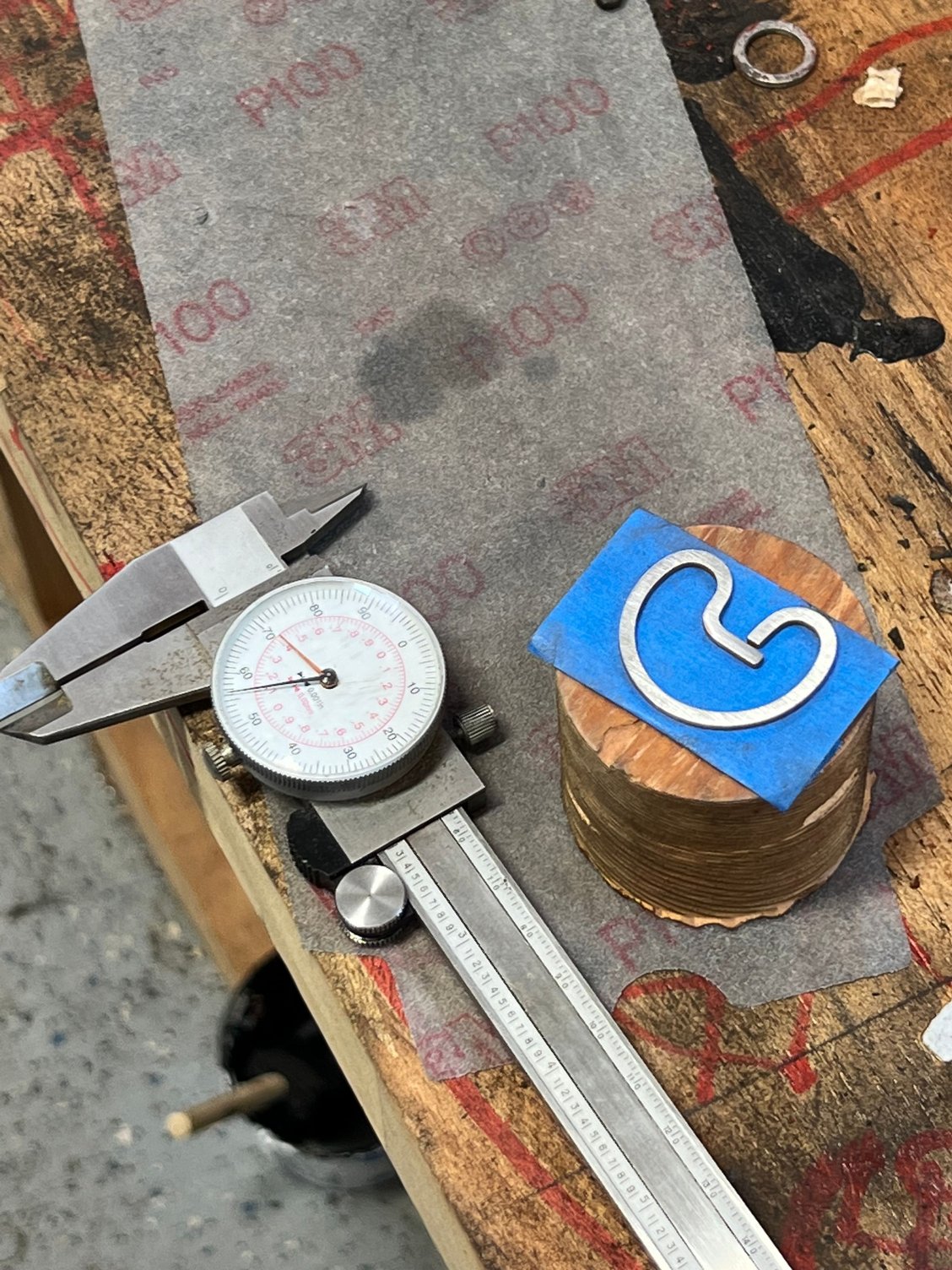

Since this is a relatively recent thread about U-joints, mentioning Spicer 1350s, I would point out that others have previously mentioned they're a tight fit. That said, you can make them work by removing material from the end clips. It's important, because if you try to cram them in there it puts quite a lot of resistance on the joints (think barely able to move them by hand sort of tight).
I used a small round of wood, some inside out masking tape loops, and some 150 grit sandpaper. Had to take anywhere from .005-.008" off of them, depending on which joint location.
That's what it looks like when it's too tight.
My method
Hope this is helpful.
My method
Excellent advice. The key is the picture with the end of the clip sticking up. That tells you the u-joint cap is pressing against the clip. Remove material as shown until the clip end lies flat against the cap. Be careful not to remove too much material as that will allow the cap to move inside the shaft (or flange), causing wear and issues down the road.

My Spicer U-Joints came with a kit of different thickness clips that were color coded. I found the copper coloured ones were the thinnest and fit snug but the U-Joint moves somewhat freely.
