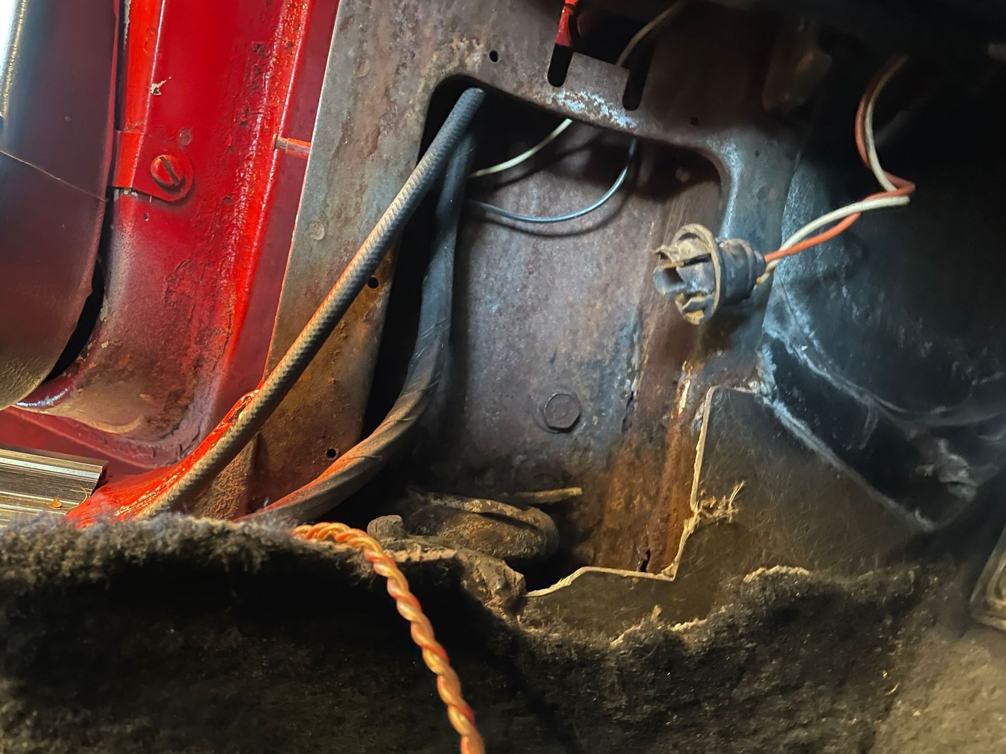

Hi Forum,
I am finally releasing my dream of buying a C3 - reading all kind of buyers tips for months now.
Now I found a 74 Cabriolet with a little rust issue on the bird cage.
Questions to the experts:
How bad does the rust look? Is it worth buying? Too risky?

That picture does not provide very much to form an opinion....remove the speaker. But....you can count on there being rust on a C3 Corvette. Unless it was living in a dry state like Arizone or California.....its rusted and probably needs major repairs. Much of the rust is hidden.....but its there. Sorry....but that is just reality.

Have to agree. With that speaker in the way really hard to see down inside the pocket. And down inside is what you need to see.
And yes, some rust is expected. Some cars are better than others.
my car comes from the salt belt. Yet my birdcage is in really good condition. But then I have owned it since dirt was new and it was never driven in winter.
So, location can obviously help. But is not always the total answer.
Bottom line, get that speaker out of the way and look down inside at the number 2 body mount. Do this on both sides. Then get a look at the windshield frame.

In Sweden this is not a cheap car. Insist on removing the trim around the windshield. And look closely at these number 2 body mount areas as well as the rest of the frame.

I simply would not buy a car with any birdcage rot. Usually the areas not easily checked are far worse than what you can see. Only exception would be if you were doing the work yourself. I would rather replace a frame than virtually any birdcage work.

From what I see the left side of the speaker looks good but the right-side is bad. I bet water is coming from from the windshield.

i just came back from the car and it looked really good underneath from the frame etc.
there is also some pictures attached after the owner took the speaker apart - I would say it doesn’t look that bad, what do you guys say?

Looks pretty rough with open hole rust areas....I would recommend pass.

Yea, I am torn for you. I have seen so many horror stories over the years. In my case with my 69, my #1,2, and 3 body mounts looked great, with nice green color and hardly any rust. And my windshield frame needed extensive work. Just no way of knowing without extensive disassembly to know. I realize also where you are, you don't have a lot of cars to chose from. Such is the problem, but I would still recommend buying a car that has a solid birdcage, to whatever extent you need to go to confirm it.

Thanks! Guess I’ll pass then…
