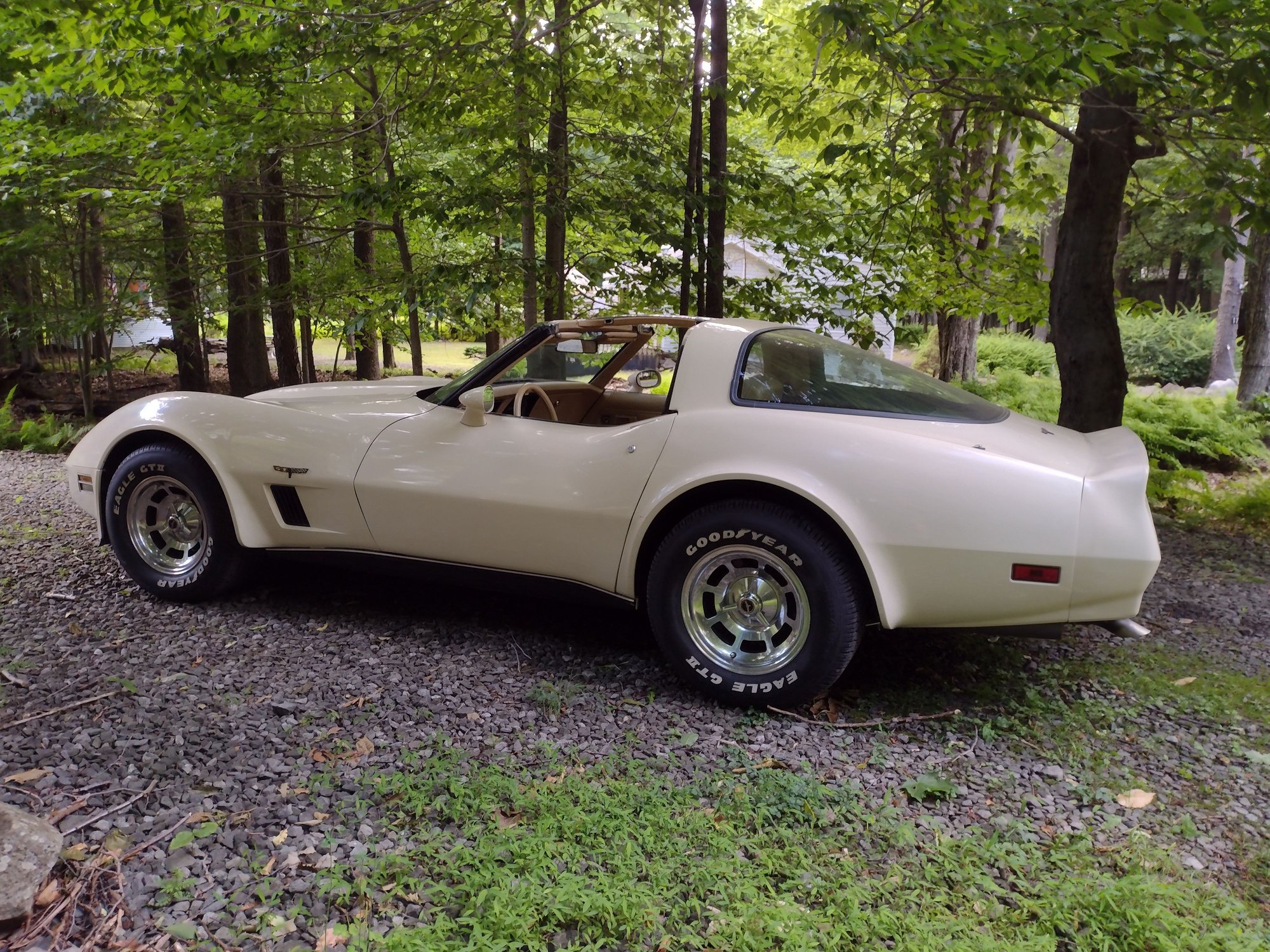

Originally Posted by Bikespace
80 4-speed is peak Corvette!
It was exactly what I was looking for and I absolutely love it. An added bonus of sorts, I was born in 1980. It's silly, but makes me smile anyway. Besides, it probably makes me a little more willing to tolerate that she's got some rattles and lots of imperfections when I think about my knees and sore back etc. being the same age she is! :P
I'll confess, when I was shopping I wished I could afford to buy a 68-69 roadster like I had twenty years ago but I love the '80's looks almost as much and she's so much more comfortable and polished feeling to sit in and drive. I always coveted these deep bucket late C3 seats too.
Wait, did we already talk about Corvairs last year? I see a Stinger or Stinger clone in your photos... I was a hardcore Corvair Nut for many years, and always will be in my heart. I think maybe I asked you this already and you said you didn't own that 'vair you just like them?
Your 80 looks fantastic too, I love the red/black interior for some contrast. I keep thinking I might put black carpet (including door panel carpet) in my 80 when I eventually replace the carpet.
