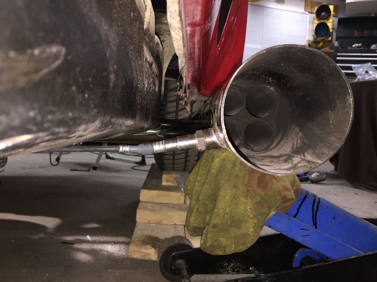

  2. Place the O2 sensor on the side (possibly with a slightly downward angle) and install it slightly below the frame. (As pictured)
There are folks who have done it both ways. Doing the latter way can (but won't necessarily) lead to premature O2 sensor failure due to thermal shock from moisture build up on the sensor.

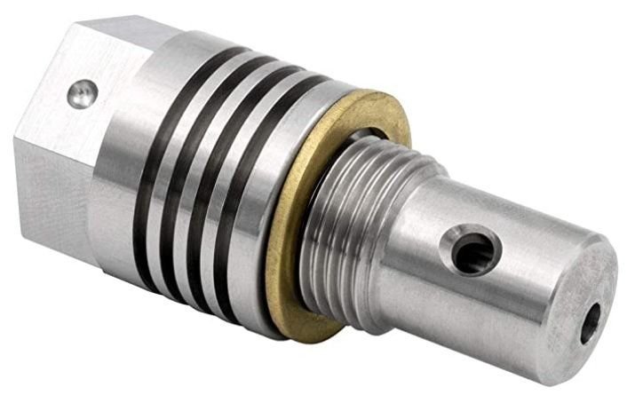

I personally did it via option #2, and I have over 5000 miles on that O2 sensor. I would recommend using this O2 bung extender (which is really a heat sink / flow port): the HBX-1
Using the HBX-1 and "hiding" my O2 sensor has worked flawlessly. However, the counter-point always cites the "moisture failure" due to non-ideal mounting angle. In my experience, that just hasn't happened yet. Perhaps the O2 sensor won't make it to 100,000 miles, but at the rate I put miles on my C3, It'll take me 25 years to fail a sensor this way. By the way, I am not running the "Holley Provided" O2 sensor, that actually was erratic out of the box - so I got rid of it. Been on the "non Holley" sensor ever since.
