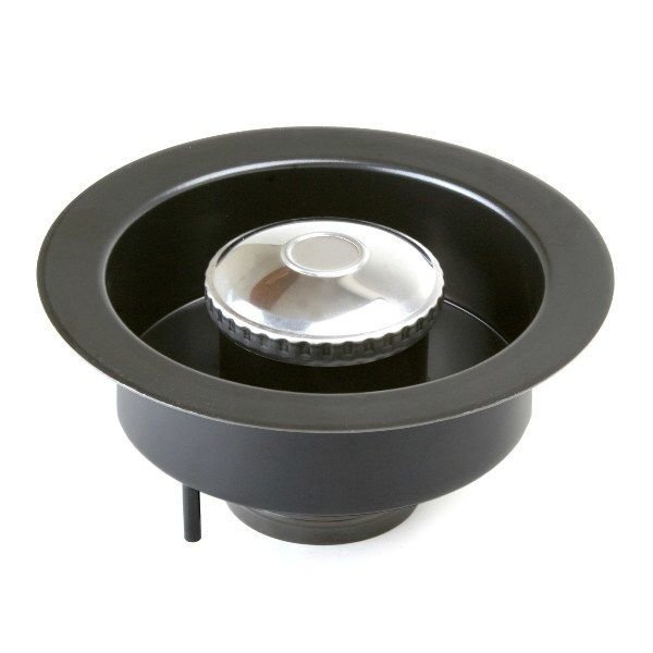

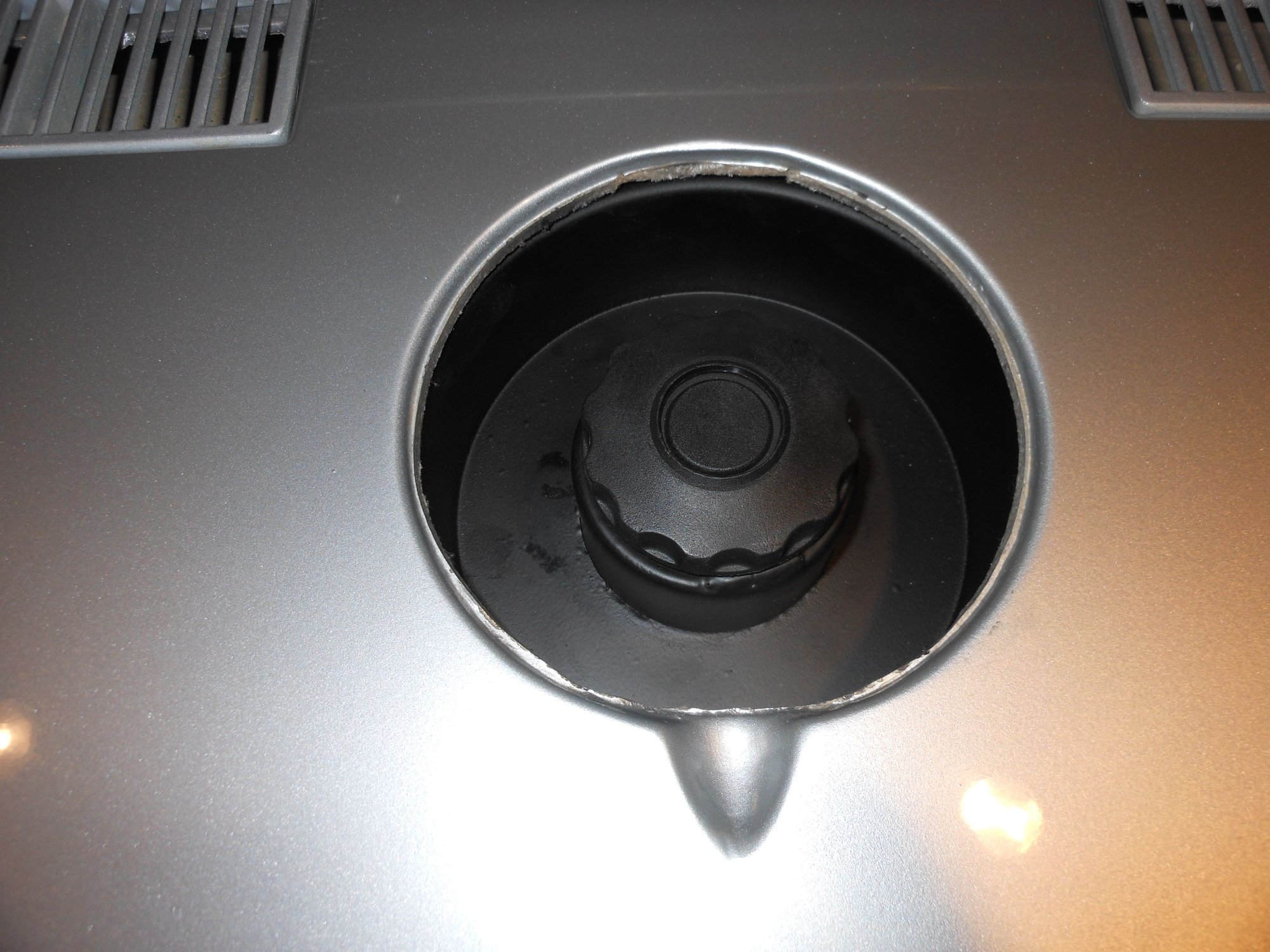

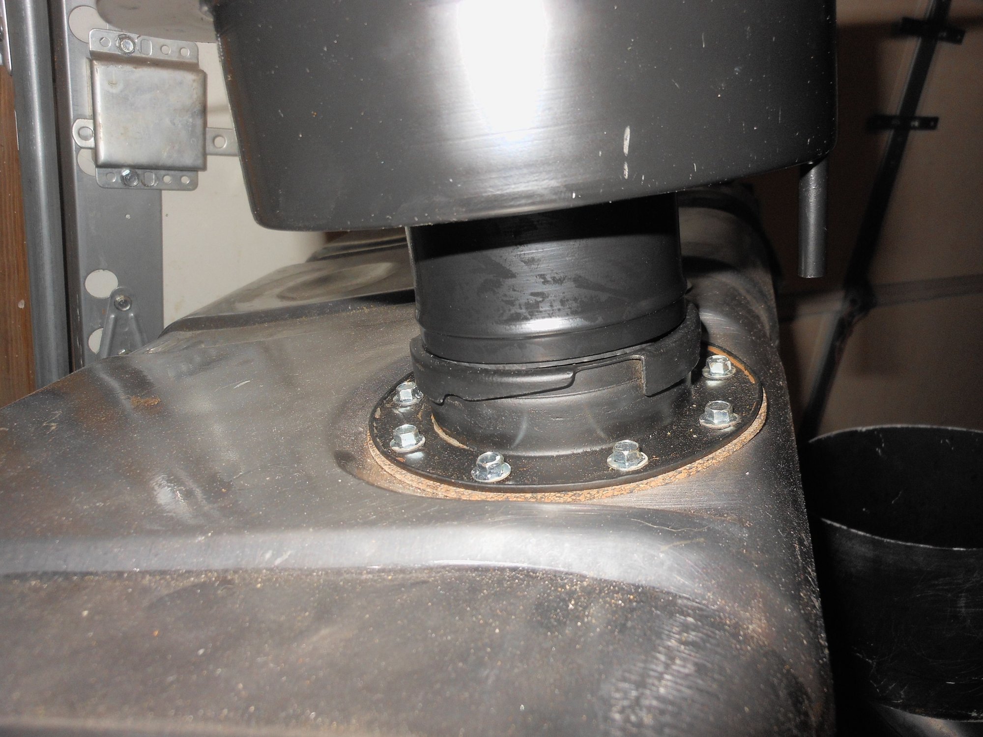

I did that mod as well- wanted a sealed cap- as I am running FI and have a real vent/rollover piece in place.
I got one of these- some dealer selling race/sprint car parts- can't remember who.
Almost a perfect fit- had it welded to the filler/neck piece
Here it is on the car- has the drain and works WAY better than GM's rubber piece. powdercoated it after it was welded. Tanks Cap (mines actually of a 2016 Ford Mustang) fit perfect

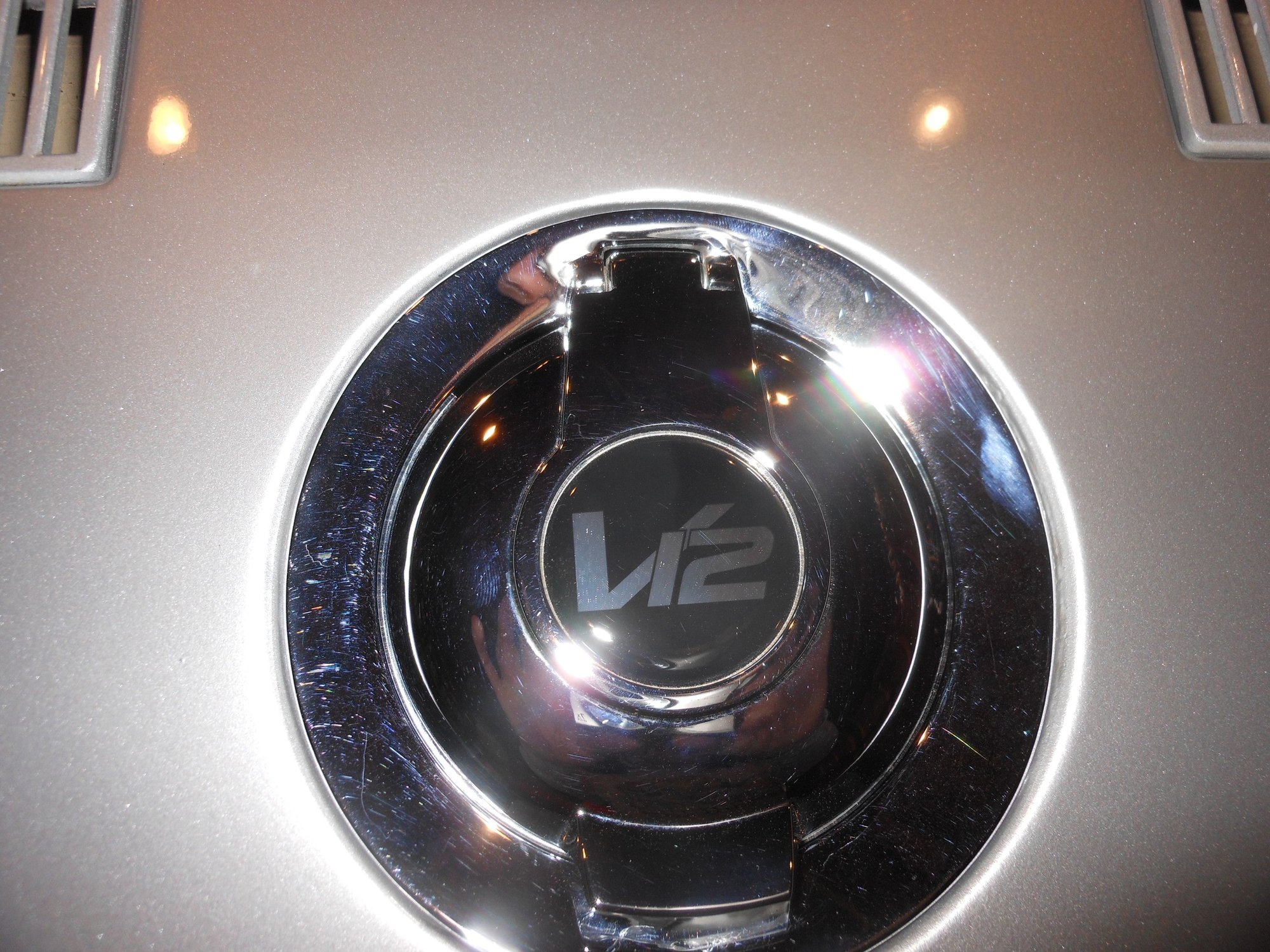

here's the custom cap- off a Challenger. Had the V12 emblem made up
cap came off this car-

Here you go- this is the piece I used-
https://www.mooreparts.com/steel-rem...s-3-fuel-hose/
Specs:
8" Outside Diameter Flange
6-1/4" Outside Diameter Barrel
3" Outside Diameter Filler Neck
3-3/4" Overall Height
Vented Gas Cap Included
