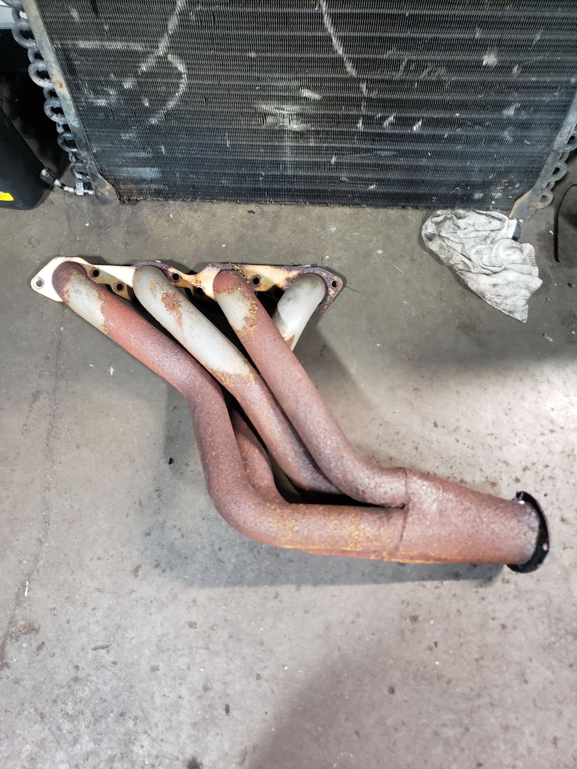

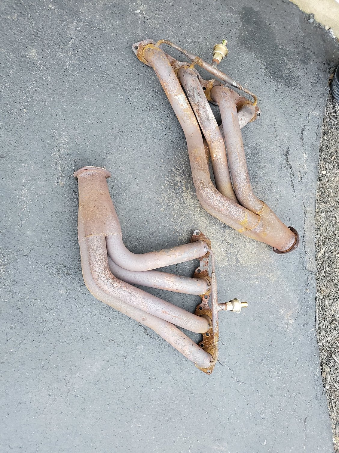

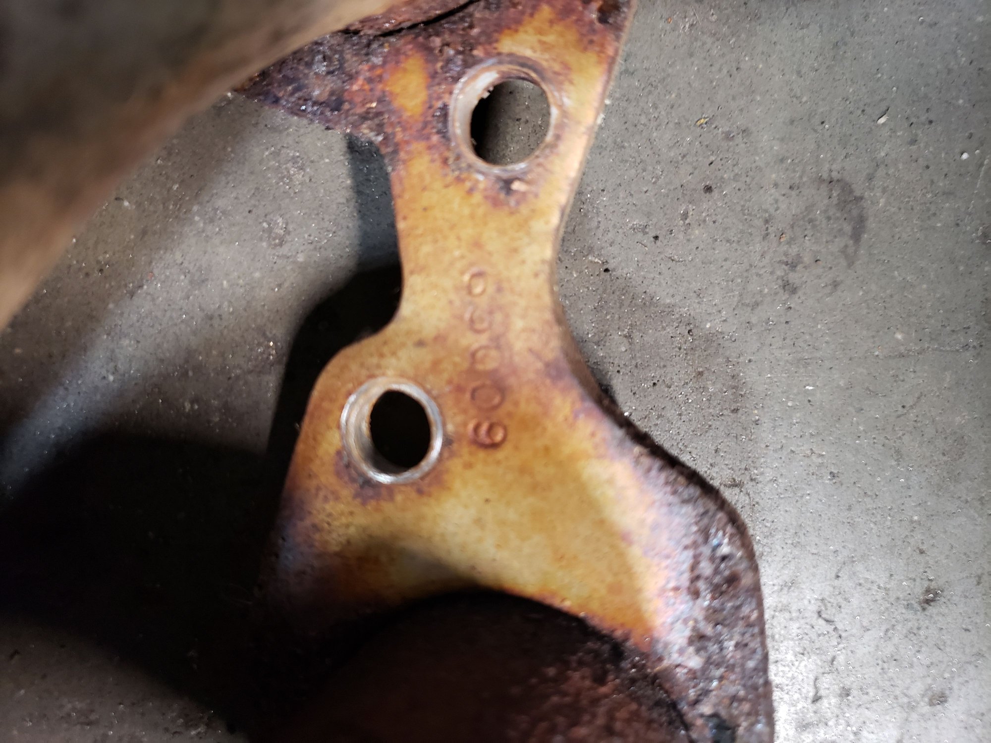

Trying to match up these old rotted headers. Think they might be Hedman but i can't seem to find a listing on the number stamped on them. The rest of the exhaust is in great shape so ultimately i would like to get an exact match to these and bolt them up to the existing exhaust.

I think you're right about them being Hedman. I couldn't make out your part number but I found this link that shows a photo of Hedman headers that appear to be just like yours: https://www.autoaccessoriesgarage.co...inted-Headers? I couldn't come up with a part number for them though. Maybe contact Hedman and send them your photos?

i believe the number is 65009 but the second number isnt completely stamped so its hard to tell.

One issue you may have with Hedman is that i think most if not all of there headers use the ball & socket system on the collector so it will not be a simple R&R. you will have to cut off the reducer you currently have and weld or clamp on the new style reducer. not a big deal but a little extra work will be involved.

That shouldnt be an issue, I'll just weld on new ends. I just want the length to be the same so i dont have to redo the whole exhaust.
