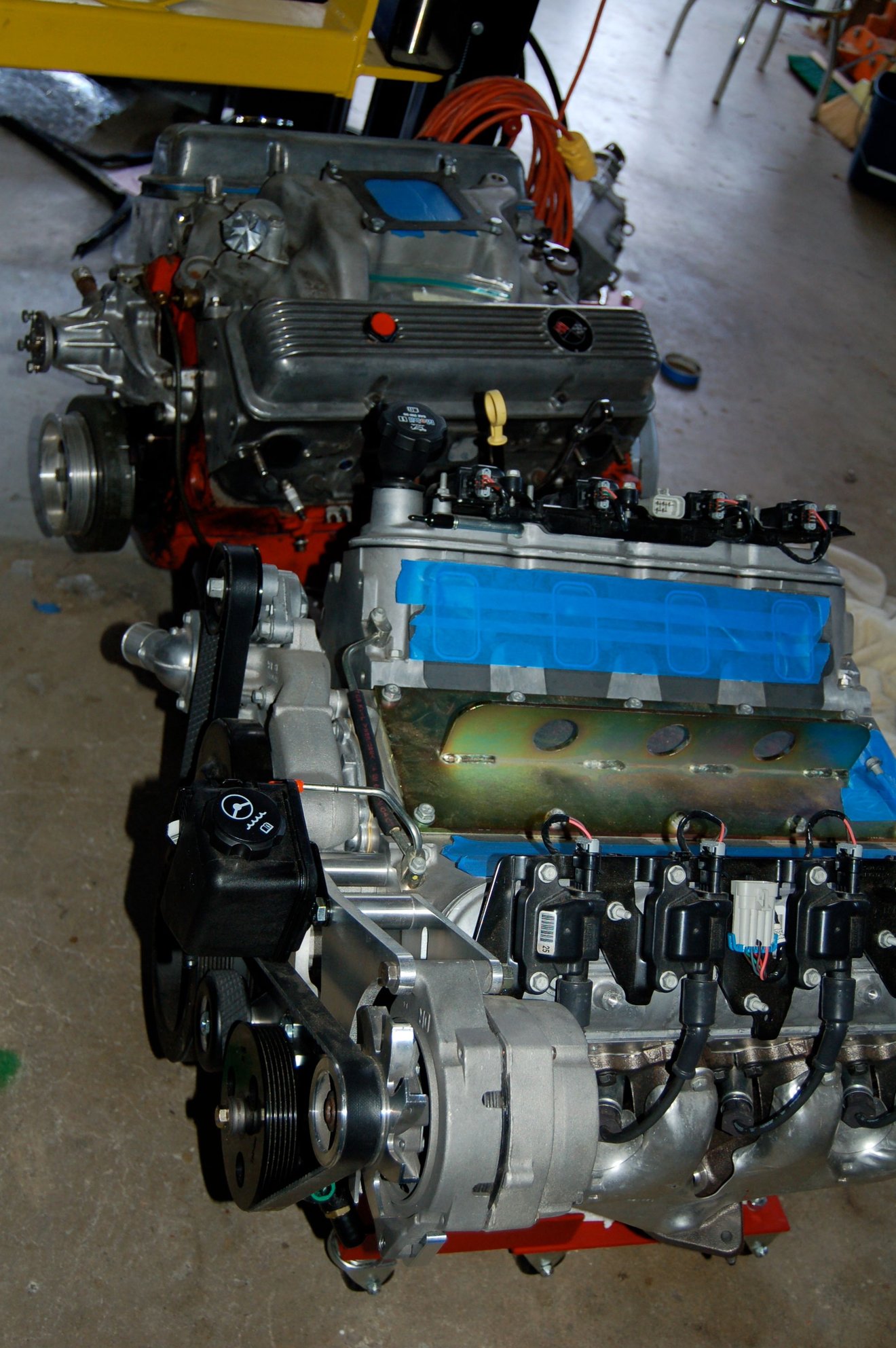

Have you thought about a GM crate LS motor at all? They make big power out of the box and are light and reliable. More work, and more money maybe but the end product is very satisfactory.
No decision needed, remove and replace.
