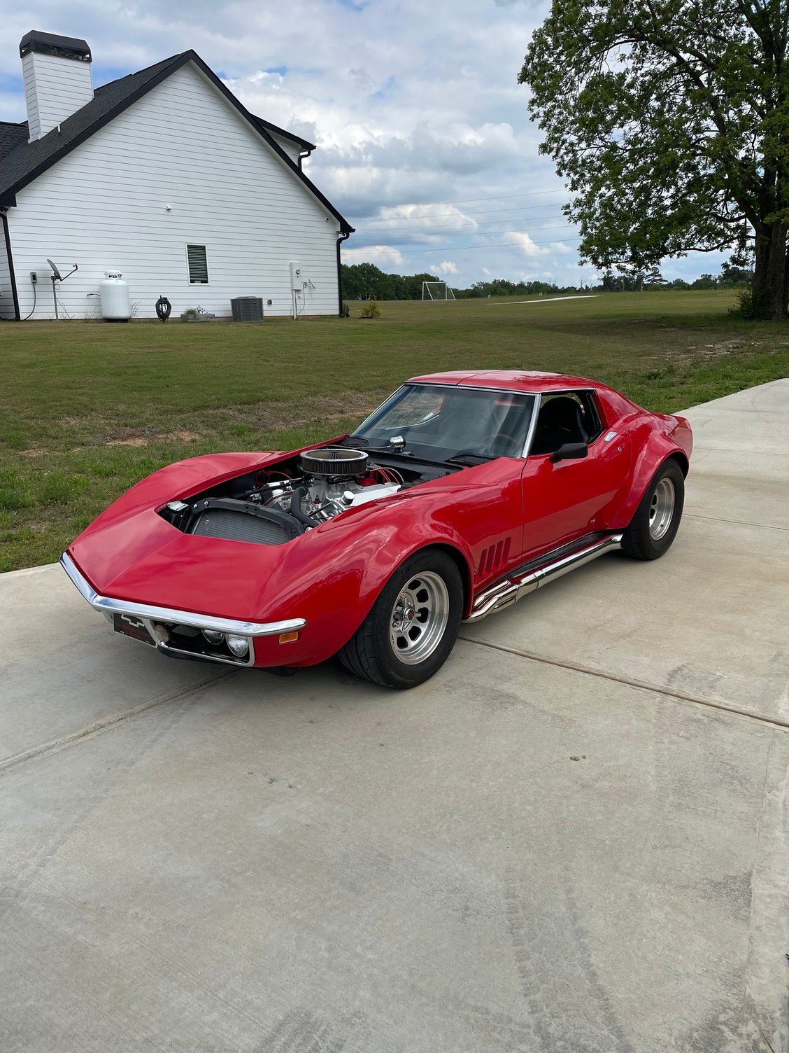

I did a 496 about 10 years ago. Full 4340 forged internals (internal balance) short block from a guy who did offshore boat engines (name escapes me right now). He also specced and installed cam. AirWolf cylinder heads from Dr J. About 6k in long block.
I ran carbs for two years (stock tripower and then mechanical secondary tripower). Went EFI with FAST XFI ECU back in 2014. Worth it for the driveability and ease of start. Cam is 240/245@.050" lift. Idles at 850 rpm. Pulls to 6000+.
If you get the right block, you will have the Z-Bar mounting hole. Mine is a MkIV BBC so I have two piece seal, mechanica fuel pump provisions and the clutch hole. I beleive the Gen 6 has the hole (if not, there is a bracket you can get). The Gen 6 would also give you a one piece rear main seal (mine leaks). Mechanical fuel pump provision is not needed if going EFI.
Older pic, but you get the idea.
