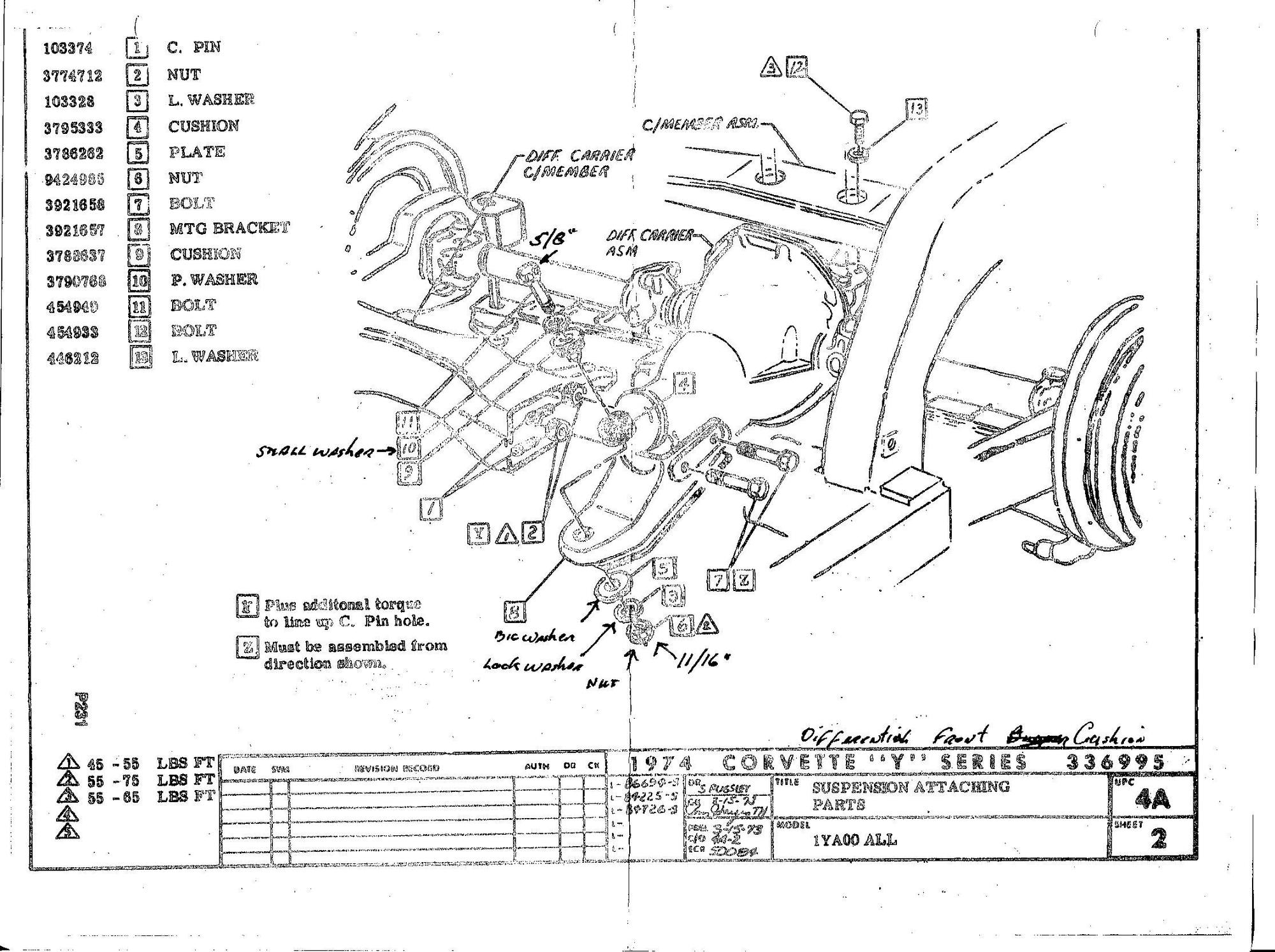

Not familiar with snubber bushing? Where is it located, what does it look like.

It is actually a pair of large rubber bushings located at the front of the differential. They typically rot, allowing the differential to move up and down, hence the knocking noise.
Fairly easy to replace but you’ll need a pry bar to push the differential down to create a gap large enough to install the new (taller) bushing. Best to do with the car on a lift.
Something I could do myself? Not a mechanic but am somewhat mechanically inclined.
Thank Both of you for your HELP.

Thank You so much, I did find it, and it was rubber and in good shape and tight
tried the pry bar and it was solid, no cracks etc. Will bring to garage next week
and check out U-joints, and look at other bushings you all described. Also don't
know what to do about checking rear axles or if they can be checked?

I guess my inspection of the snubber bushing was a bust. Brought it to a shop
to have a REAL mechanic inspection......he checked out what he could find externally
and could not find anything out of the ordinary, however, he did find that the snubber bushing
was shot, embarrassing!!! He did try to make me feel somewhat better by saying that it would
look OK from the bottom but that it was shot when looking at it from above on a hoist and trying
to see from below would be hard. $200.00 for inspection and snubber replacement, worth it for
peace of mind that it wasn't anything more critical. Once again Thank all of you for the assistance.
